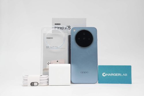

ChargerLAB has previously tested the OPPO Find X8 Pro, which was impressive for its excellent photography performance and thin body. The 5910mAh battery and 80W charging power are also significant improvements. Today we will test the charging performance of the OPPO Find X8.
5630mAh + 80W | Charging Review of OPPO Find X8-Chargerlab
Its packaging box is exactly the same as that of OPPO Find X8 Pro, except that the text on the top is Find X8.
The box contains the OPPO Find X8, an 80W charging set, and some documents.
