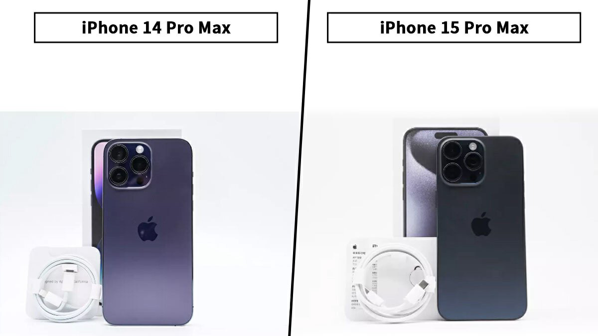

In September 2023, Apple launched the iPhone 15 series. Compared with the iPhone 14 series, it has upgrades, such as changing to a USB-C port and a slightly larger battery capacity.
ChargerLAB has done a similar iPhone 14 Pro Max MagSafe test before, so we will compare the iPhone 15 Pro Max and iPhone 14 Pro Max this time. The comparison includes maximum charging power and full charging, to help you clearly understand these two phones.
Which One Is Faster? | Charging Comparison of iPhone 14 Pro Max & 15 Pro Max-Chargerlab
Neither phone comes with a charger but all come with cables. The difference is that the iPhone 14 Pro Max comes with a USB-C to Lightning cable, while the iPhone 15 Pro Max comes with a USB-C to USB-C braided cable.
