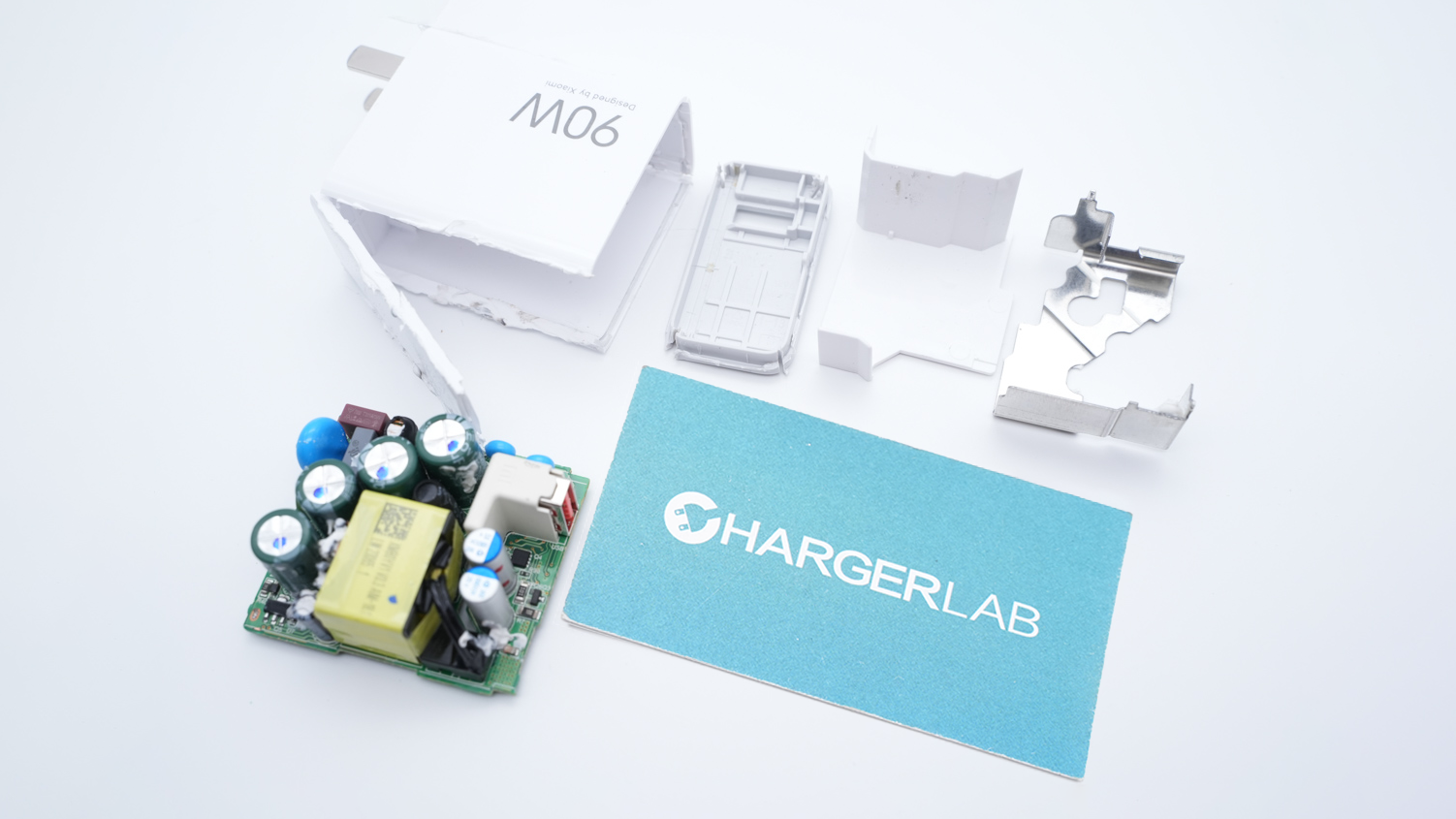

Use the cutting machine to cut off the outer case, and take out the PCBA module.
Teardown of Xiaomi 90W GaN Charger (MDY-14-EC)-Chargerlab
There are some foams inside the case for buffering.
And the PCBA module is wrapped by a layer of irregular heat sink.
A combination of plastic board and copper foil are located on the back for heat dissipation.
The length of the PCBA is 50.3mm (1.98 inches).
The width is 44.3mm (1.74 inches).
And the height is about 20.3mm (0.80 inches).
The fuse, NTC thermistor, common mode choke, high voltage filter capacitor and transformer are on the front of PCBA module.
And rectifier diode, master control chip, feedback optocoupler, synchronous rectifier controller, protocol chip and synchronous rectifier MOSFET are on the back.
ChargerLAB found that this Xiaomi 90W GaN charger adopts QR flyback topology, and the output voltage is controlled by the protocol chip. Both the switch-mode power supply controller and the synchronous rectifier controller are from Hyasic Semi, the GaN IC is from Navitas, and the protocol chip is from Injoinic. Next, let's introduce all the major components.
