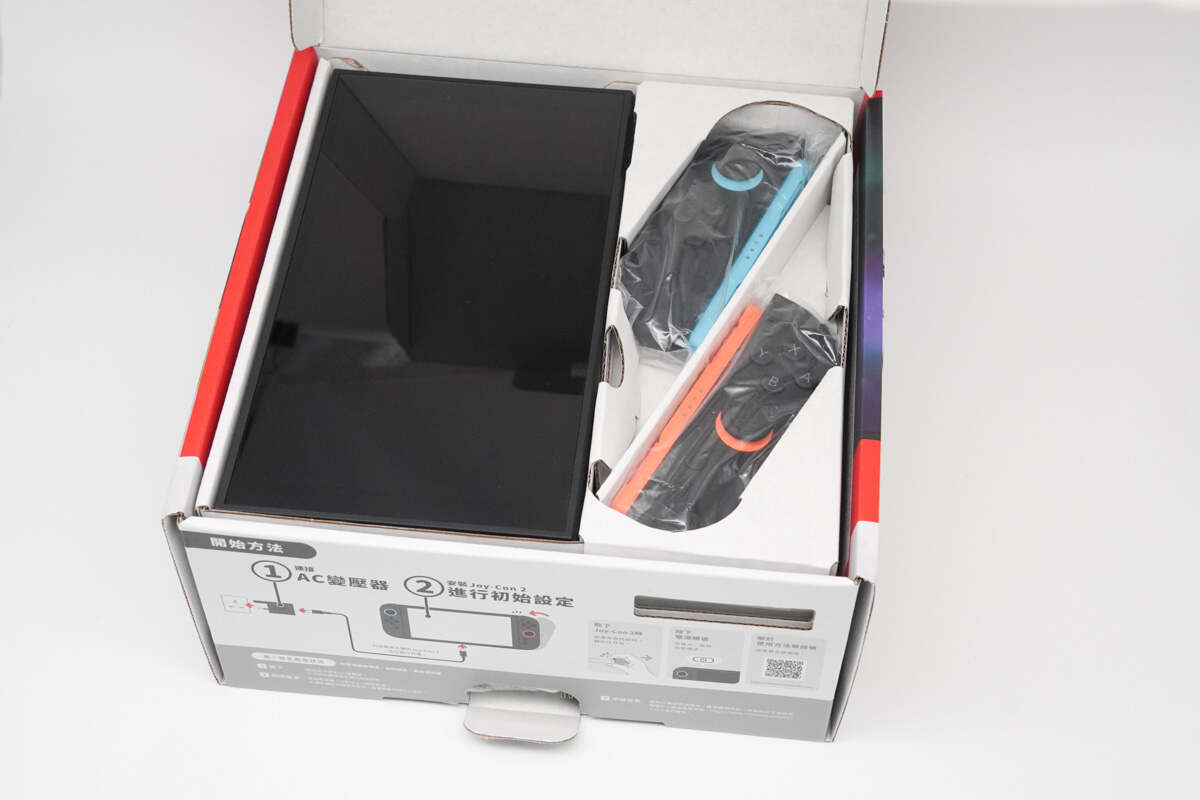

The package includes the Switch 2 console, Joy-Con set, dock, charger kit, HDMI cable, and more.
Teardown of Nintendo Switch 2 Official Charging Dock-Chargerlab

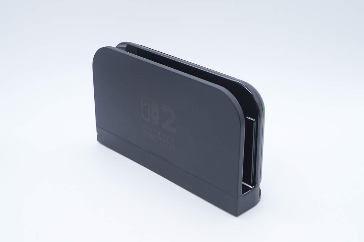

The official charging dock continues the minimalist design style, featuring a contrast of matte and glossy finishes on the surface and inside the slot.
The front-facing logo is noticeably larger, and the curves at both ends of the top are more pronounced — subtle details that set it apart from the previous model.

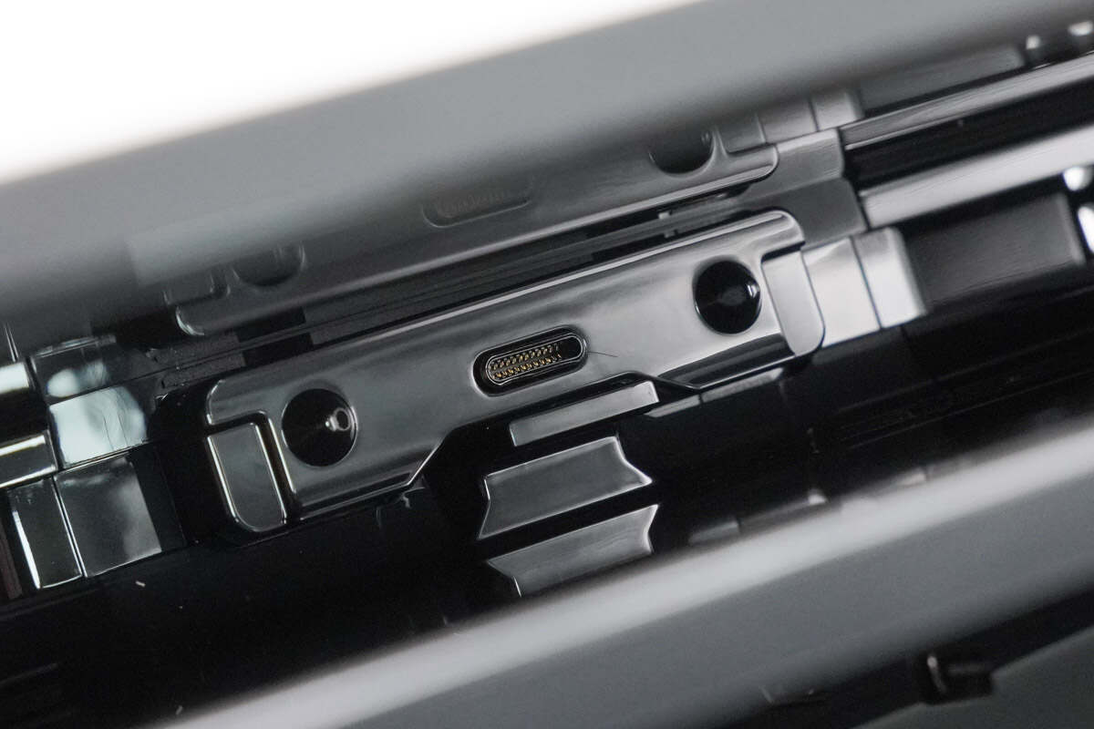

At the center of the slot is a USB-C male connector, with a protective plate held up by an internal spring mechanism.

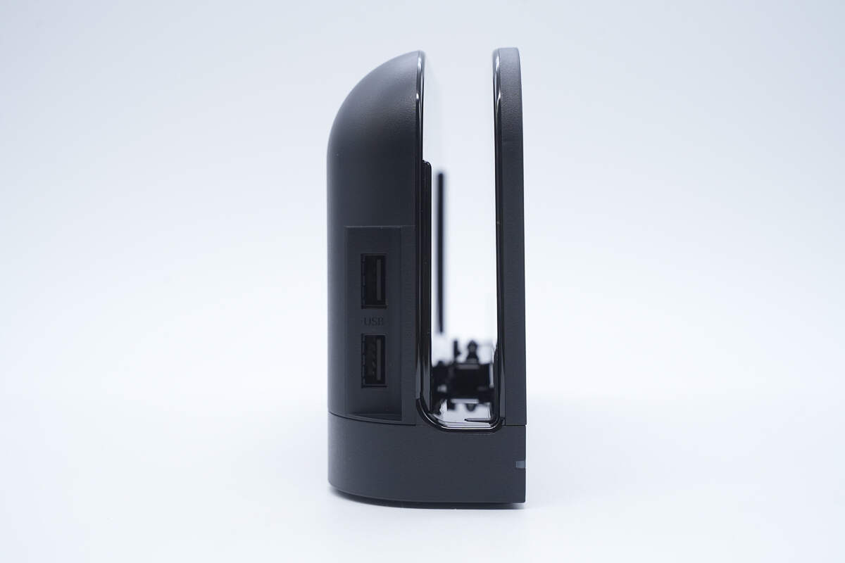

One side of the dock is also equipped with two USB-A ports.

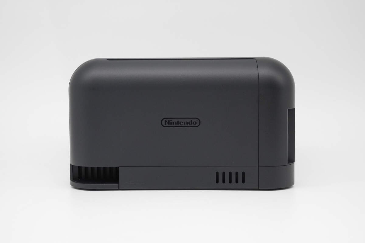

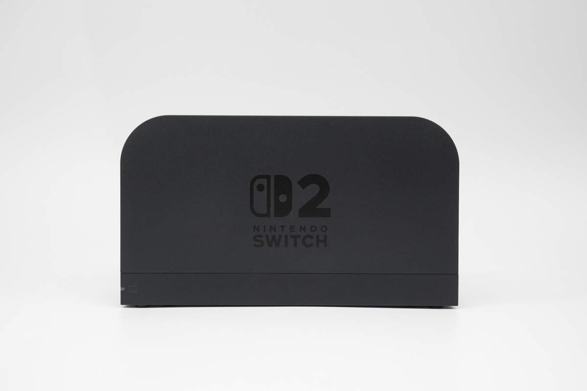

The edges at the back are smoothly rounded, with the Nintendo logo positioned at the center.

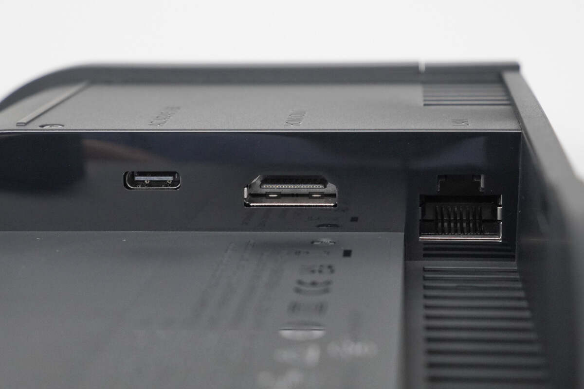

Located here are the USB-C, HDMI, and Ethernet ports.

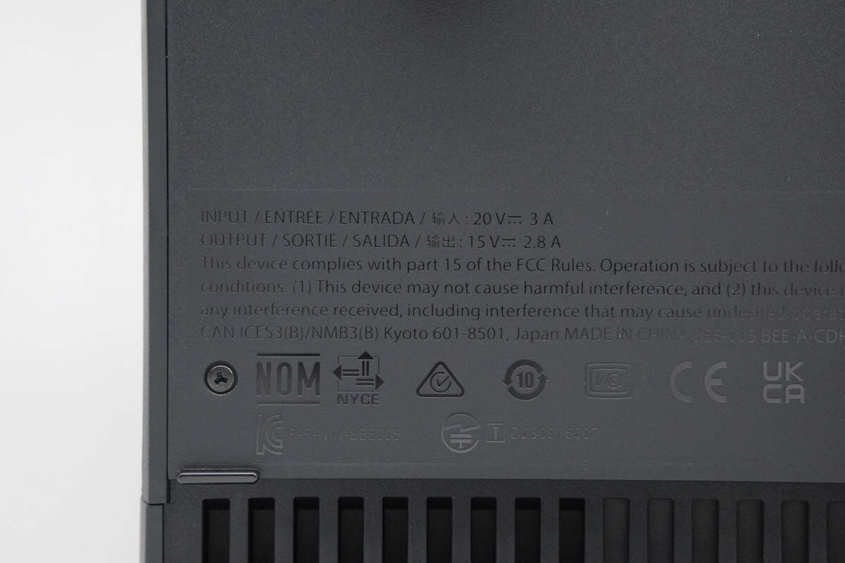

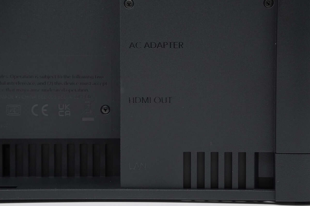

This area displays the labels for AC Adapter, HDMI Out, and LAN ports.
Input: 20V 3A
Output: 15V 2.8A
It is certified by NOM, NYCE, CE, UKCA, KC, and others.

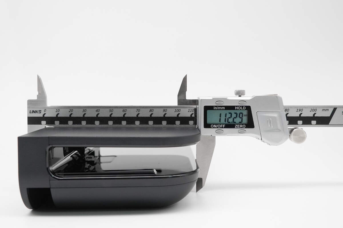

The height is about 112.29 mm (4.42 inches).

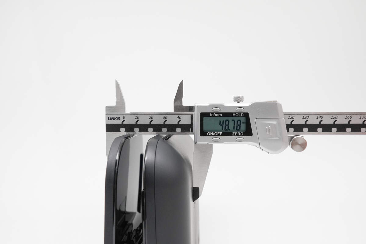

The thickness is about 48.78 mm (1.92 inches).

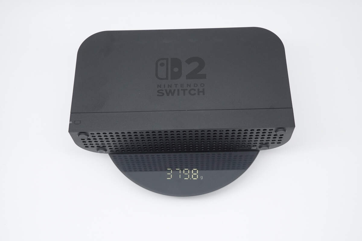

The weight is about 380 g (13.4 oz).

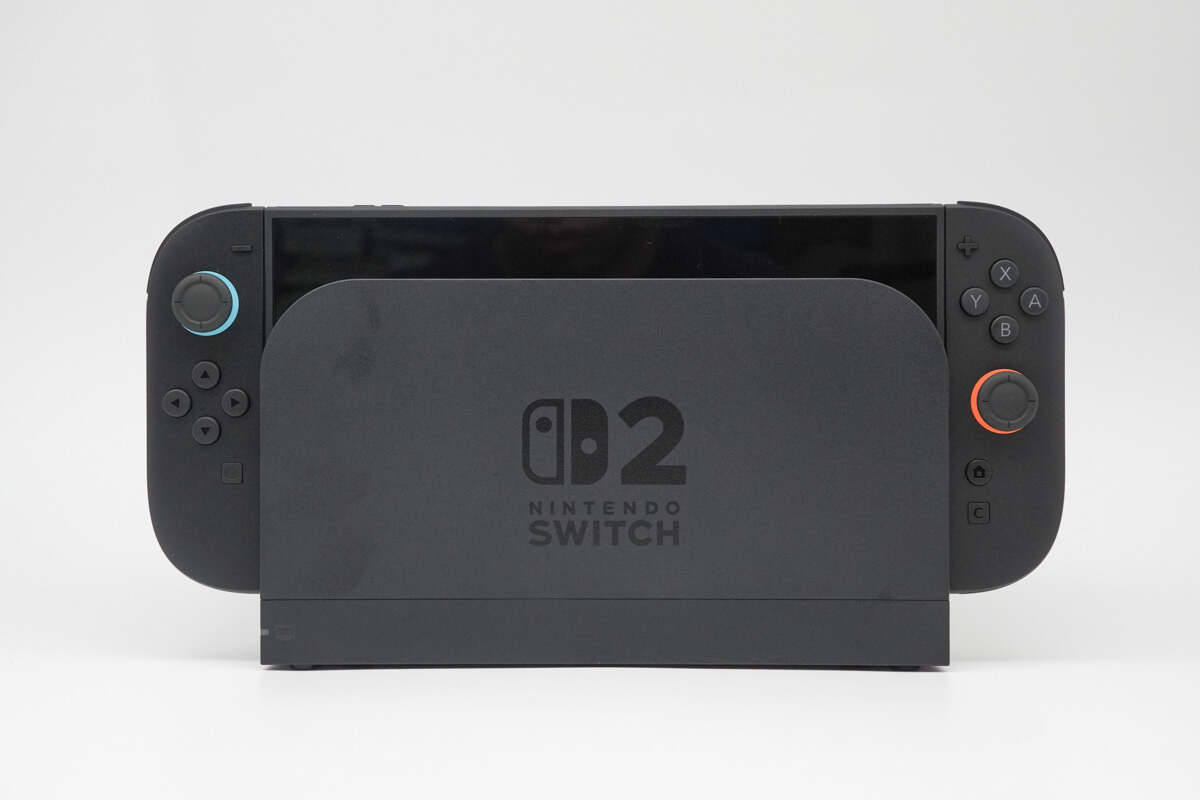

Here’s how the Nintendo Switch 2 looks when placed in the dock.

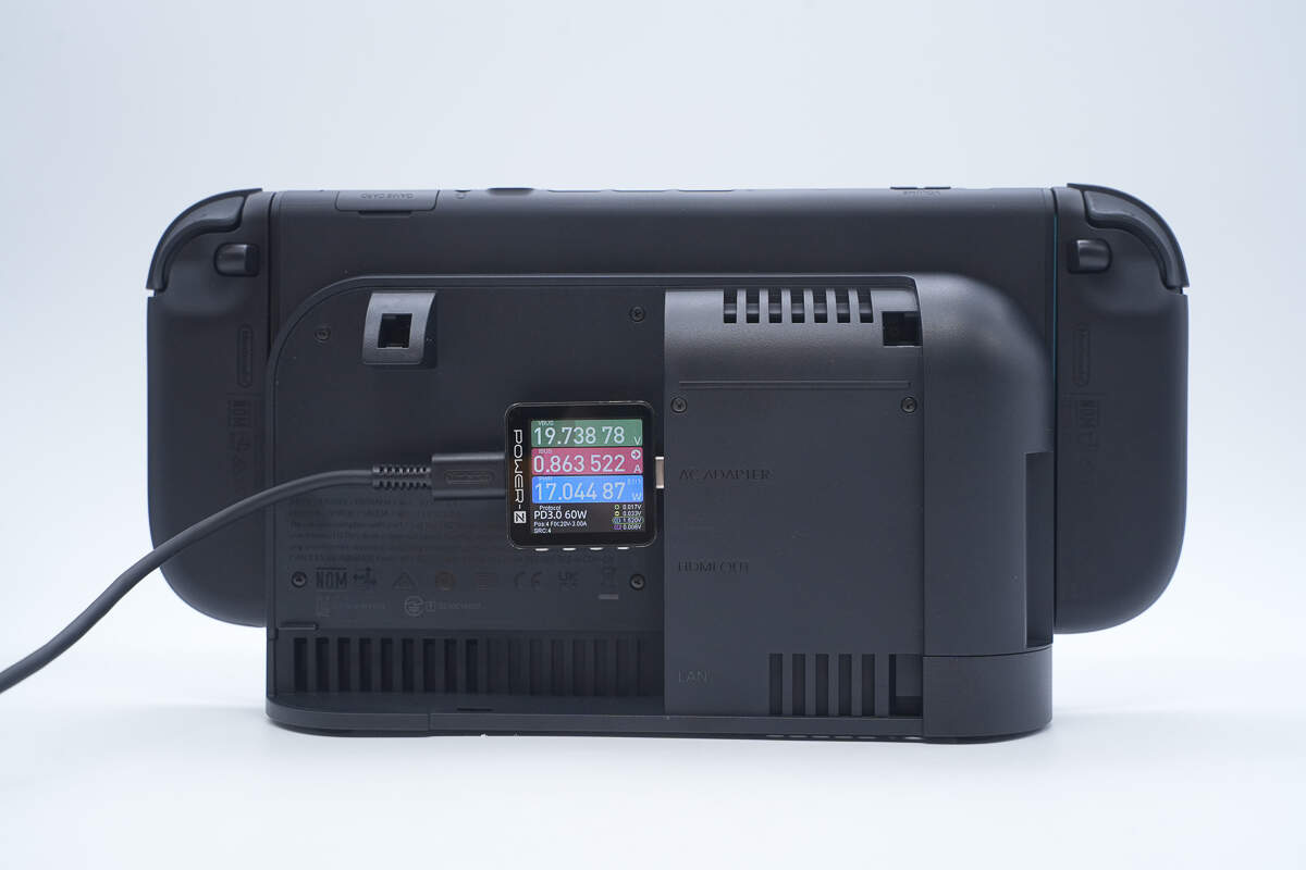

Using the official 60W charger with the dock to charge the Switch 2, the charging power is about 17.04W.

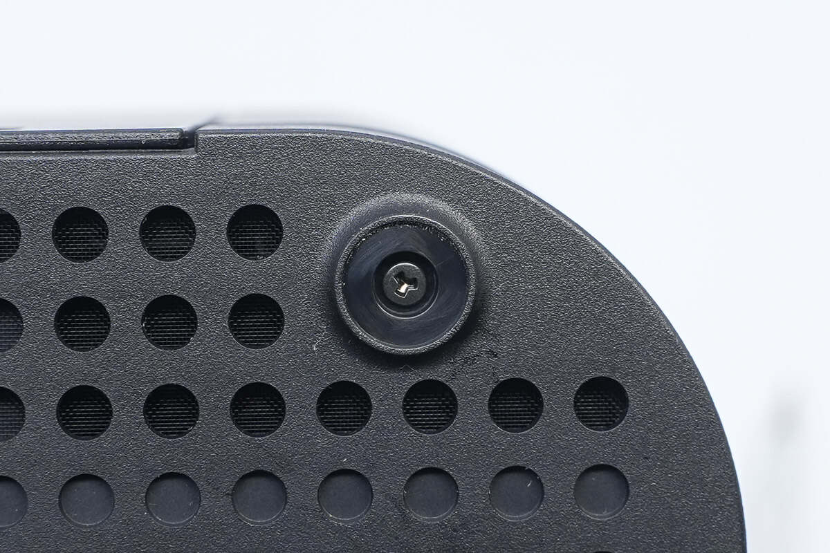

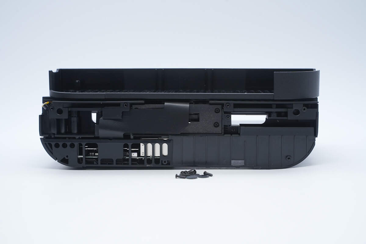

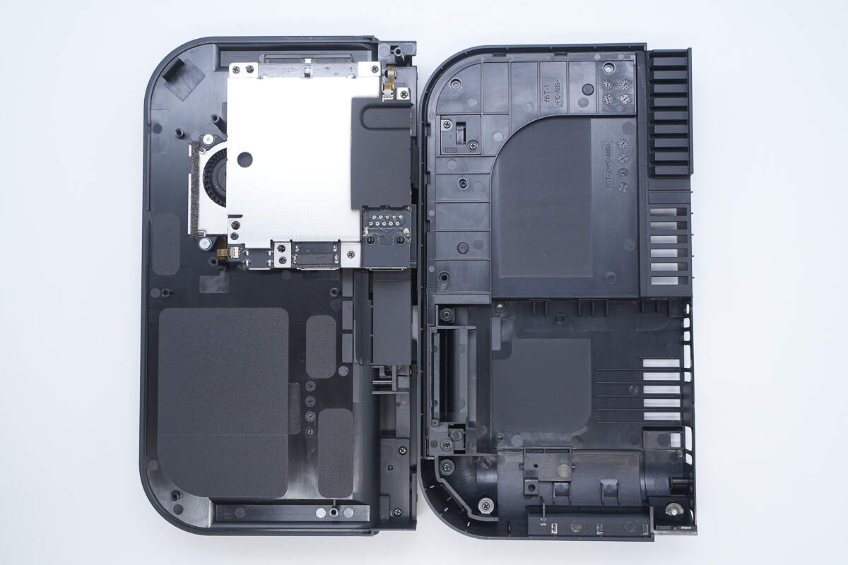

Screws are found under the bottom anti-slip pad.
Remove the screws to open the bottom cover. The central USB-C port is a separate module, secured with screws.

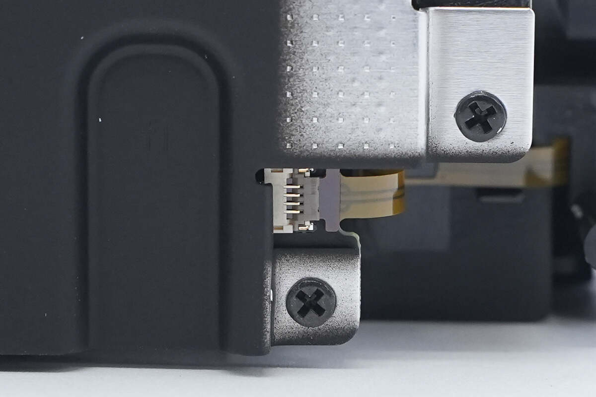

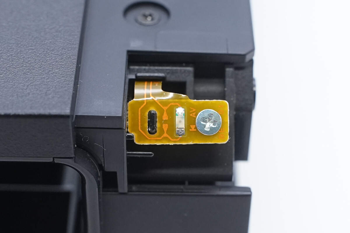

The side LED indicator is soldered to a ribbon cable, which is secured with a screw.

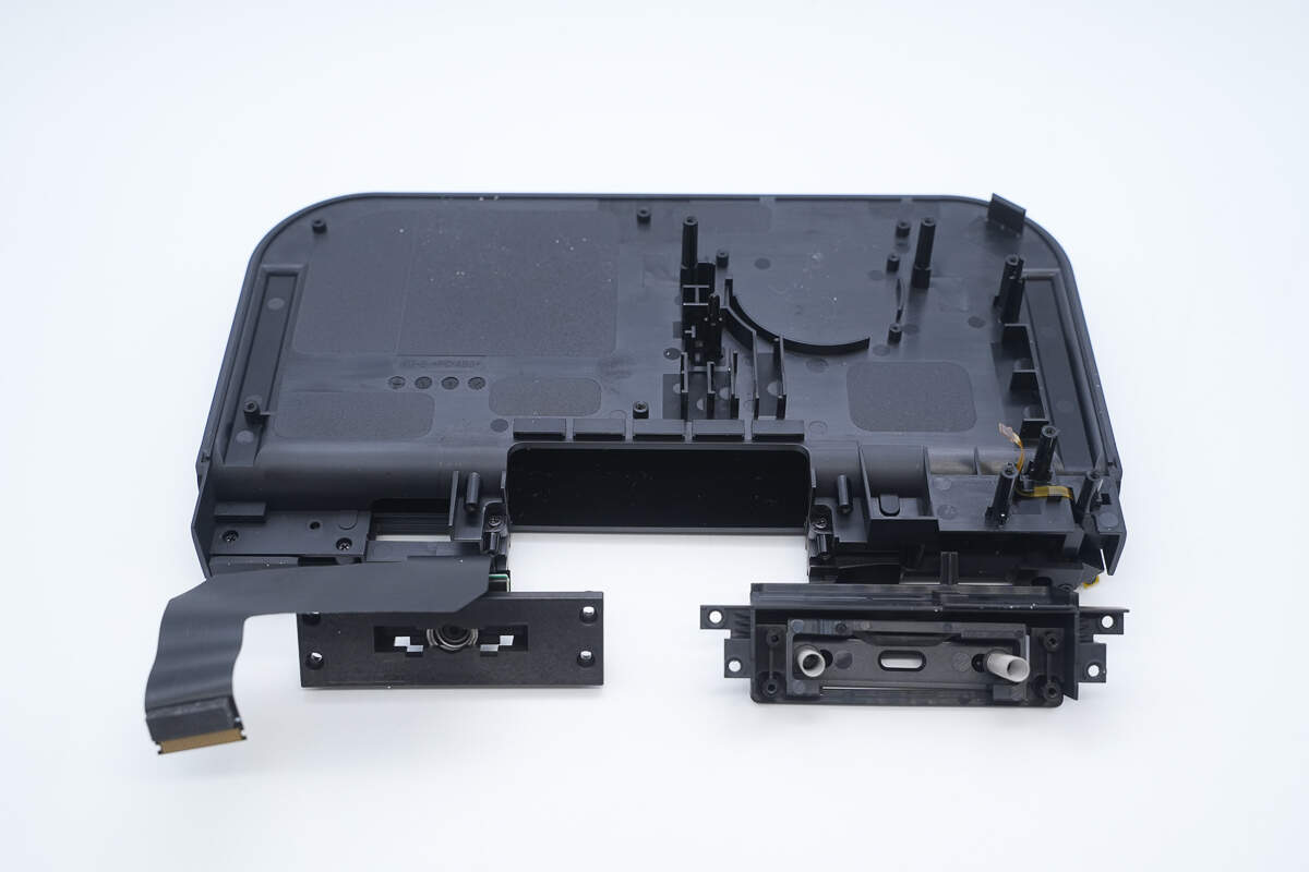

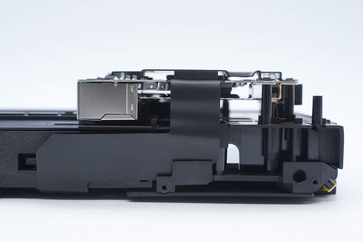

Open the back cover, the casing is made of fire-resistant PC+ABS material.

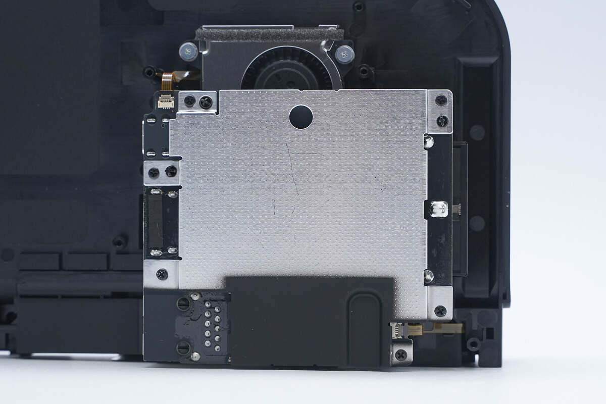

The casing houses the PCBA module and a fan. The PCB is covered with a metal shielding plate and secured with screws.

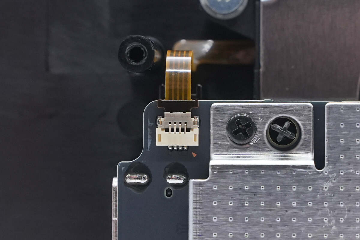

The other end of the indicator light’s ribbon cable is also a plug-and-play connector.

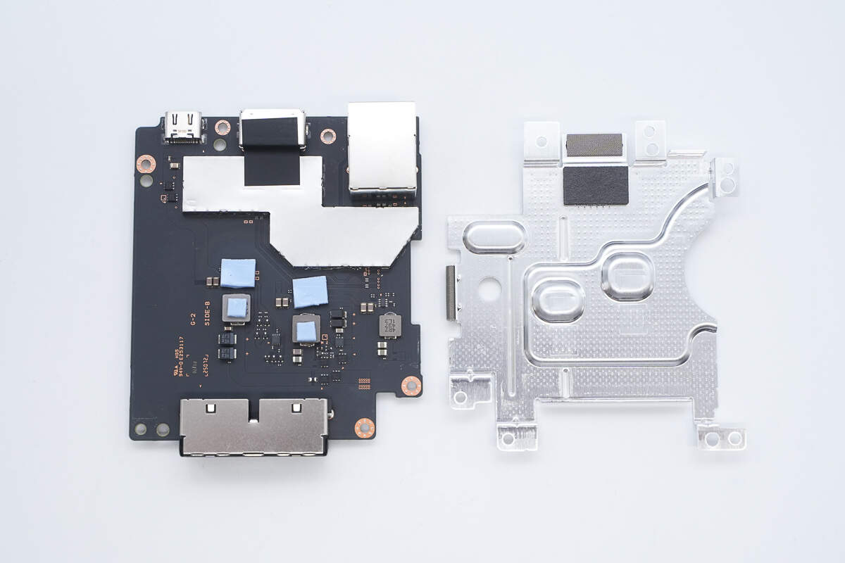

Removing the metal shielding plate reveals that the PCB is also secured by mounting posts, with a reinforcement pad attached to the ribbon cable on the left side.

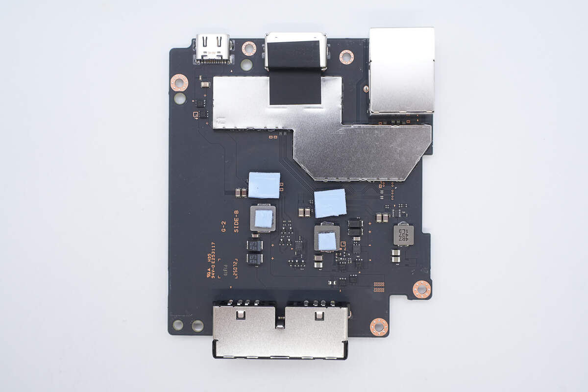

The back of the PCBA module is equipped with a metal heat sink.

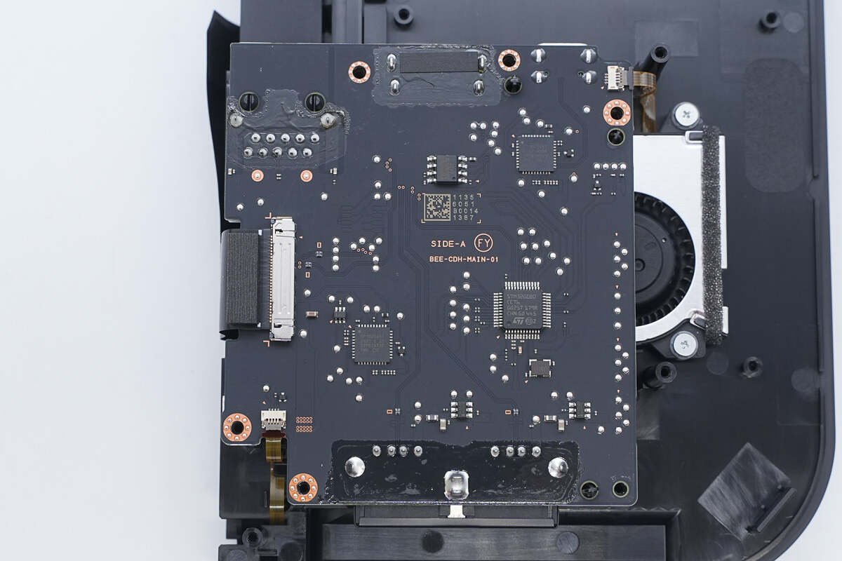

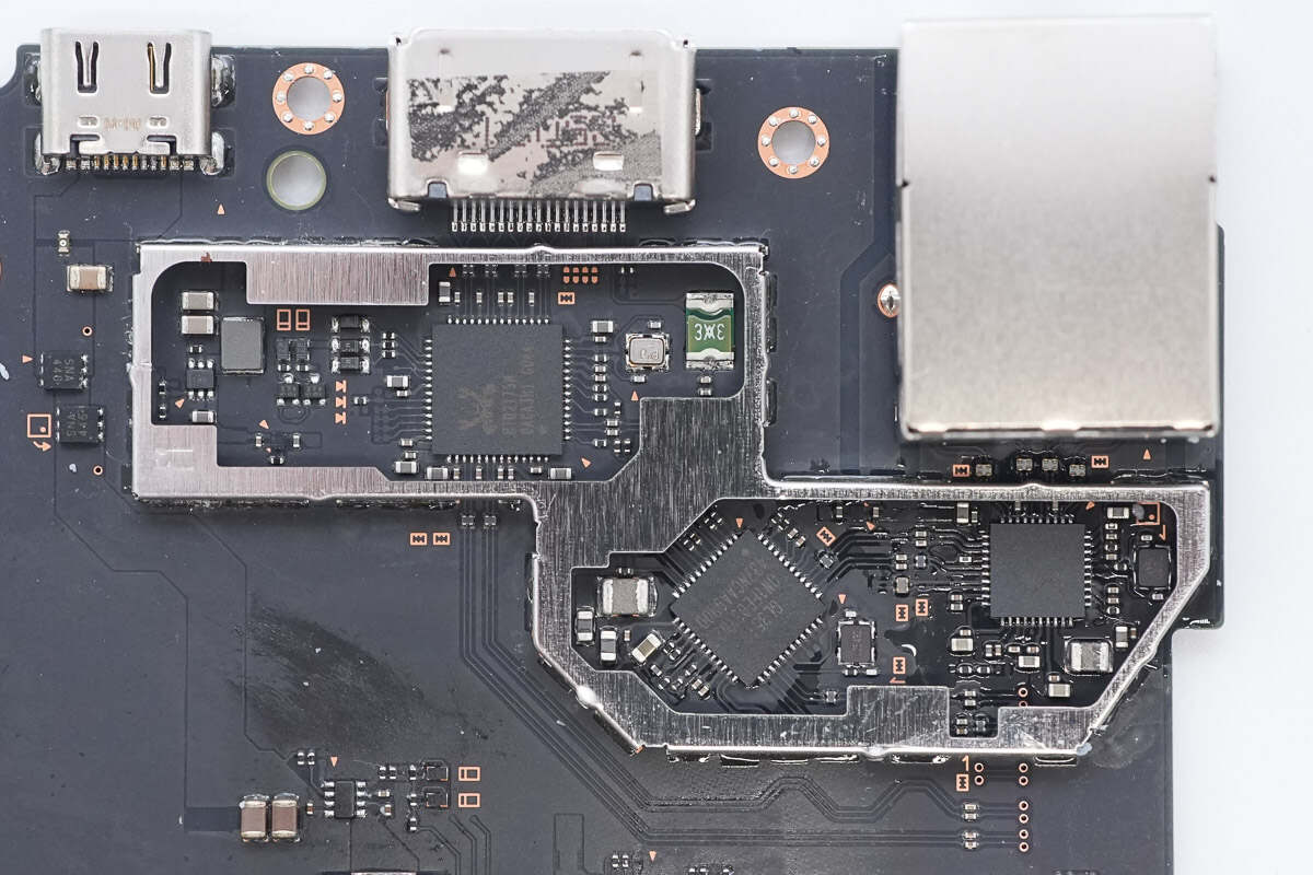

USB-C, HDMI, RJ45, and USB-A connectors are soldered on both sides of the PCB, with a shielding cover over the hub circuitry area.
Opening the shield reveals components such as the hub controller, video converter chip, and Ethernet controller.

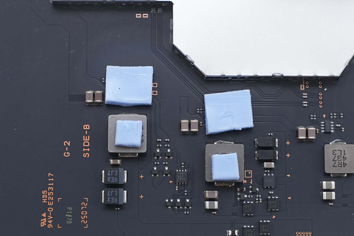

Thermal pads are attached to the synchronous buck converter and buck inductor used for step-down output to the USB-A ports.
On the back, there are components including an MCU, two USB-C port controllers, and a memory chip.

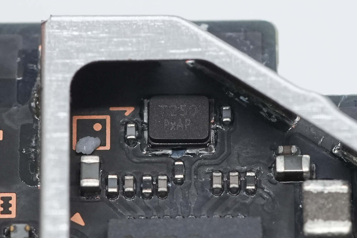

For power control of the USB-C input port, there are two back-to-back MOSFETs marked with "SNA".

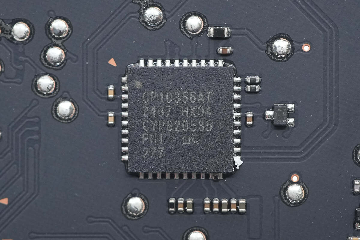

The USB-C input port controller is from Infineon, marked with CP10356AT, and uses a QFN40 package.

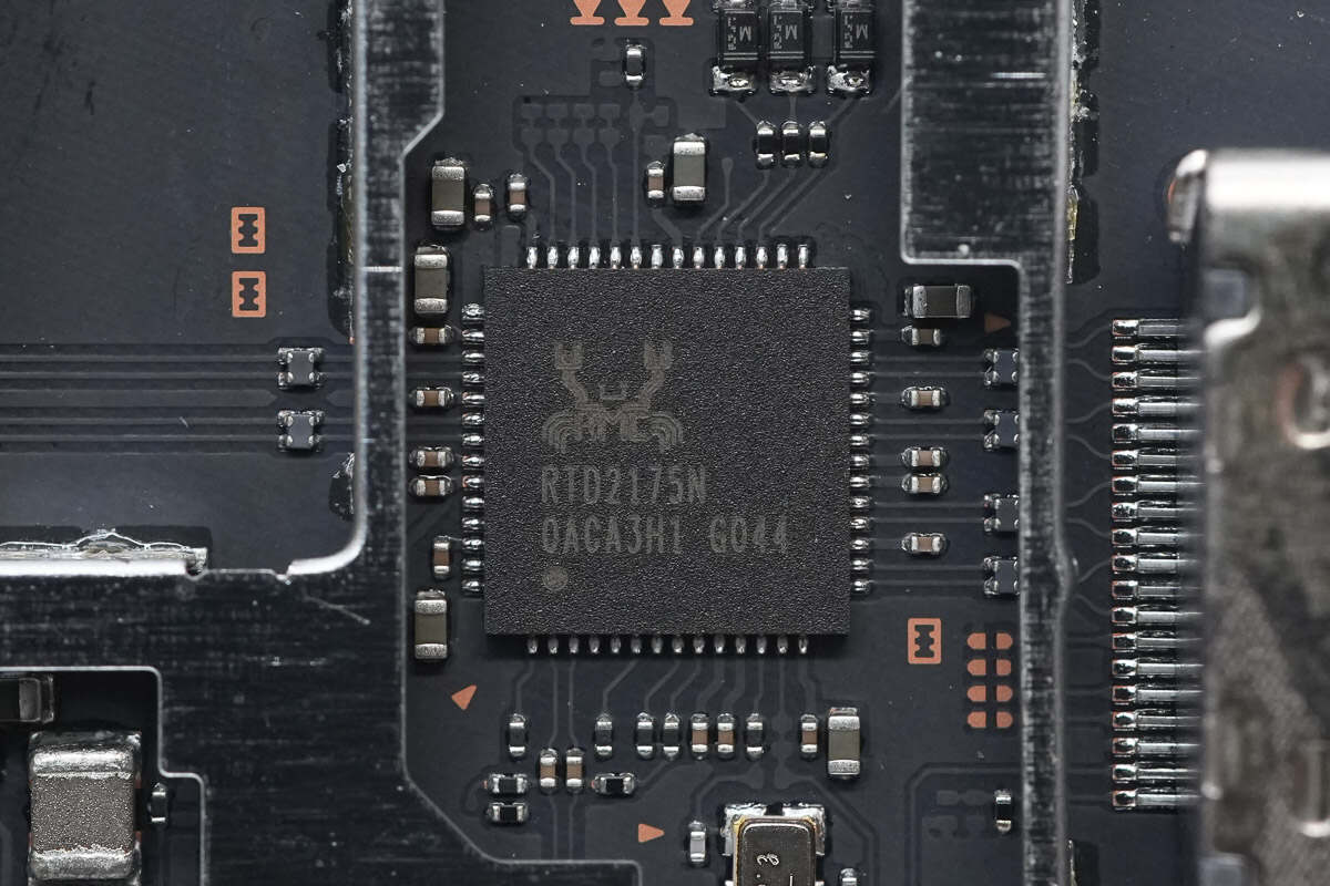

The video converter chip is from REALTEK, model RTD2175N, which is a DP-to-HDMI conversion chip.

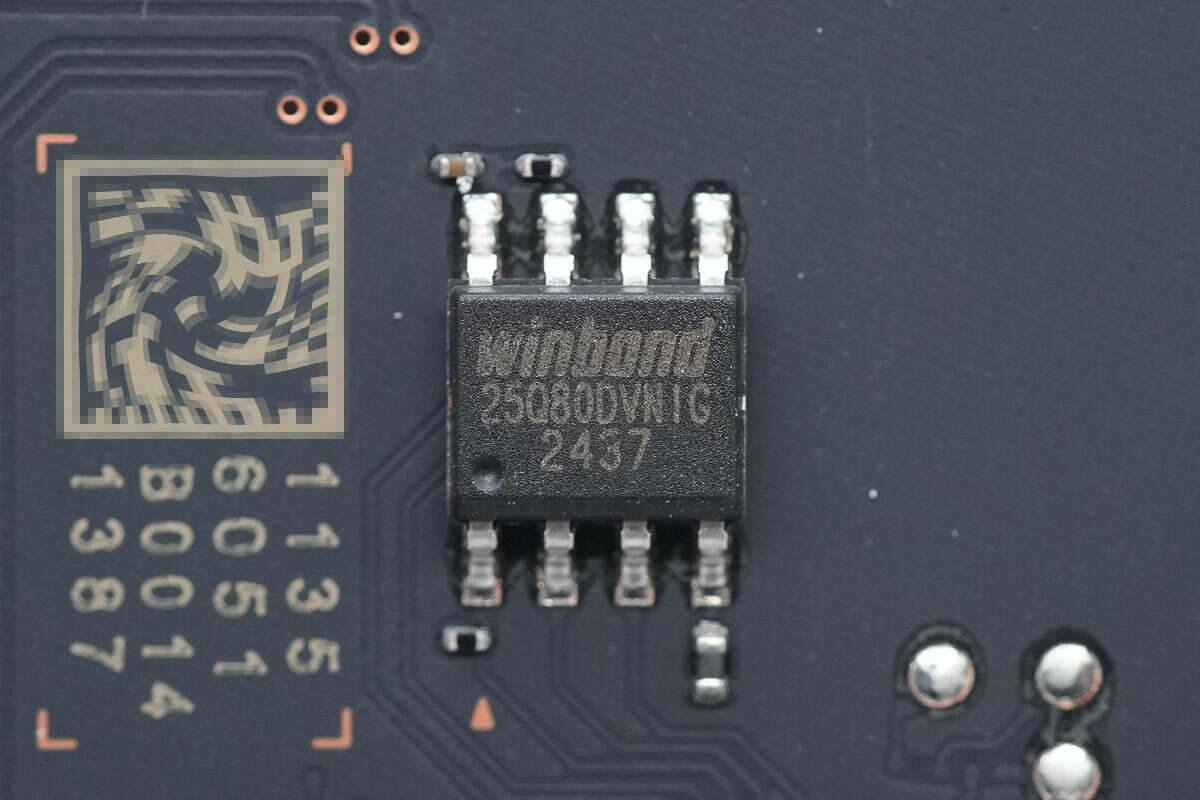

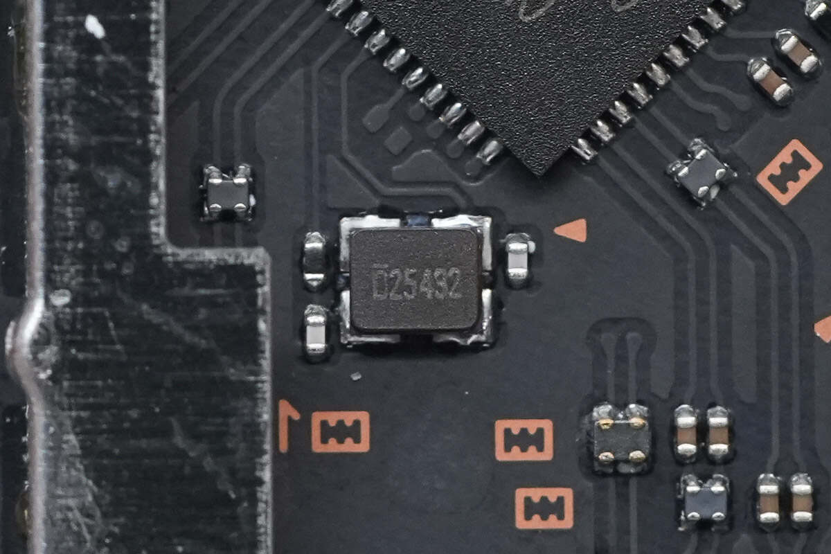

The memory chip is from Winbond, model W25Q80DV. It is a serial NOR flash memory that operates on a single 2.7–3.6V power supply, with standby power consumption as low as 1µA. The entire series comes in compact packages.

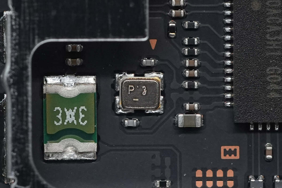

Close-up of a self-resetting fuse.

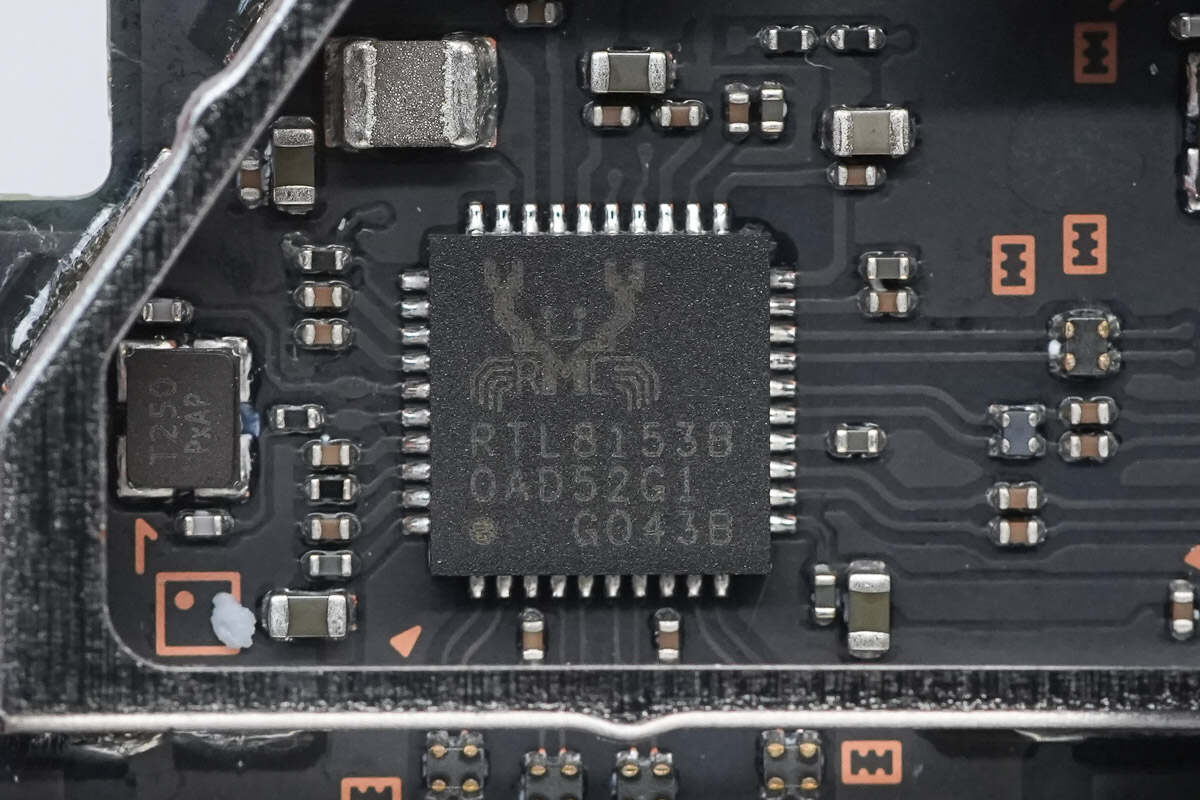

The Ethernet controller is from REALTEK, model RTL8153B. It supports gigabit transfer speeds and comes in a QFN40 package.

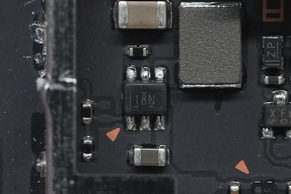

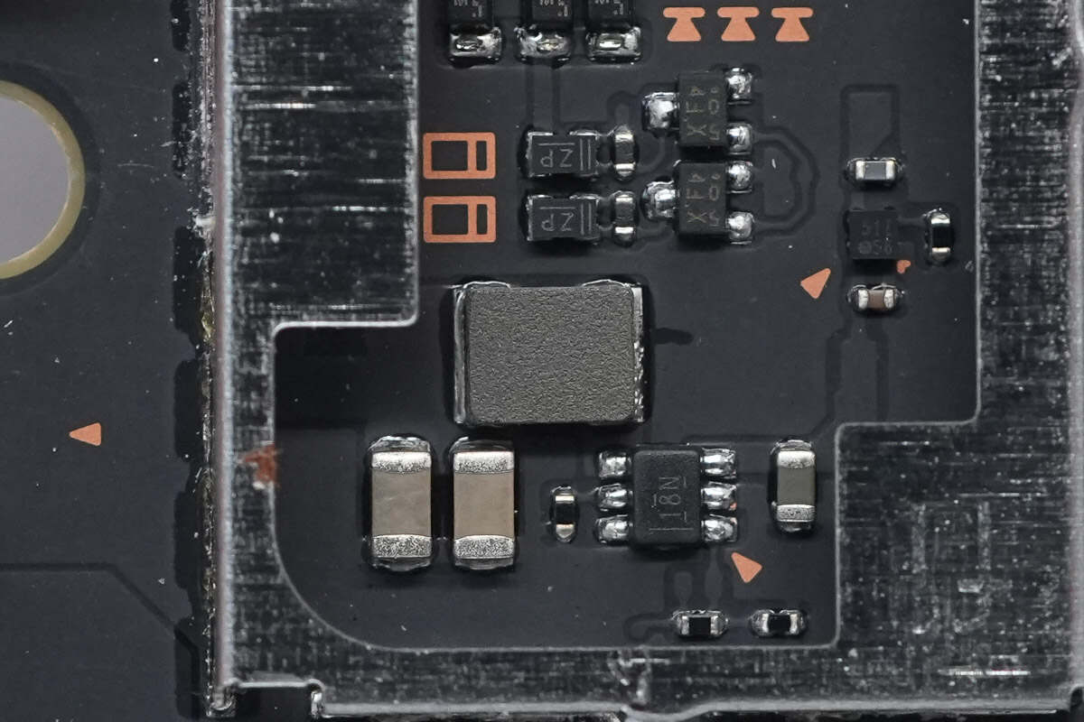

The buck chip is from TI, marked with 18N, model TLV62568. It is a synchronous buck converter with a 5.5V input, 1A output current, and comes in a SOT563 package.
Close-up of the accompanying SMD buck inductor.

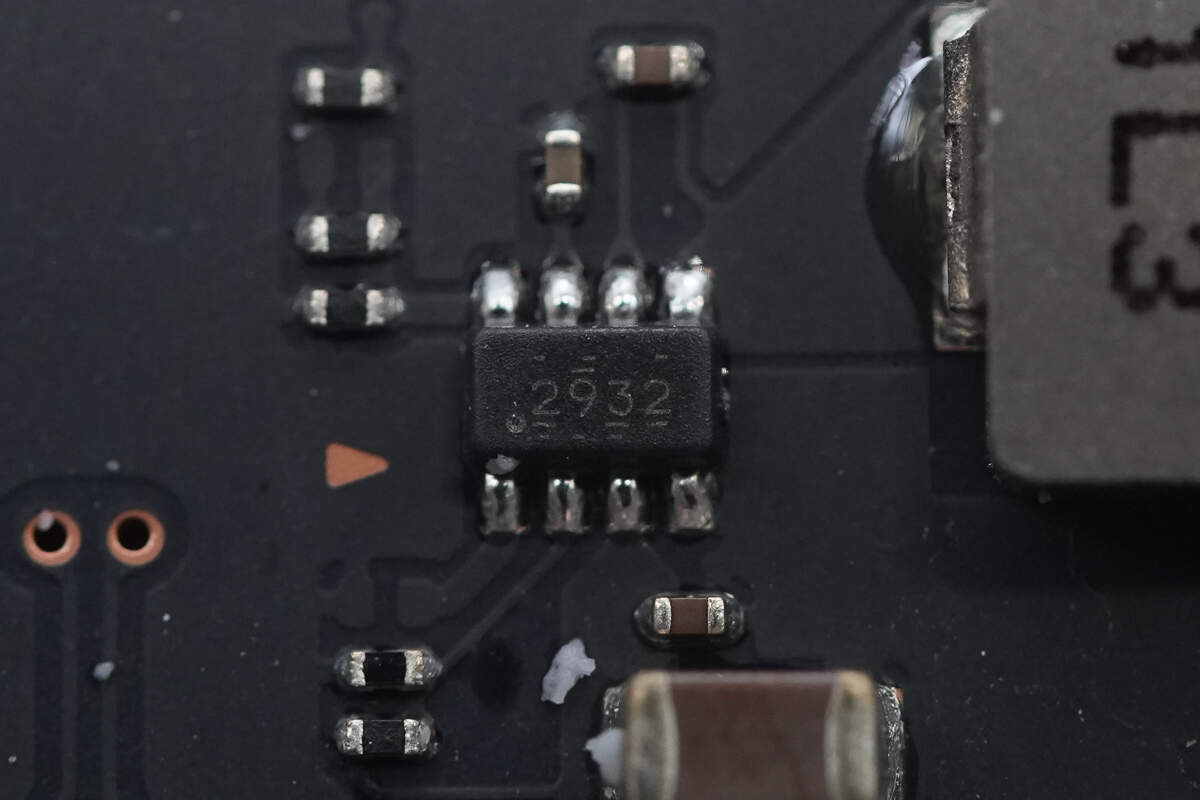

The synchronous buck chips used for the two step-down circuits powering the USB-A ports are both from TI, marked with 2933, model TPS62933. They support a 30V input voltage and 3A output current. The chips integrate MOSFETs internally, support up to 22V output voltage, and come in SOT583 packages.

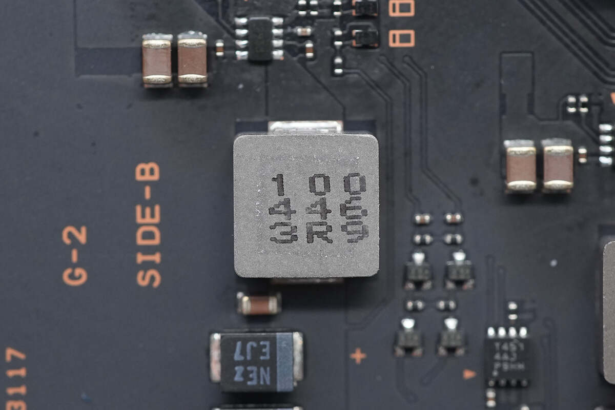

Close-up of the accompanying 3.9μH buck inductor.

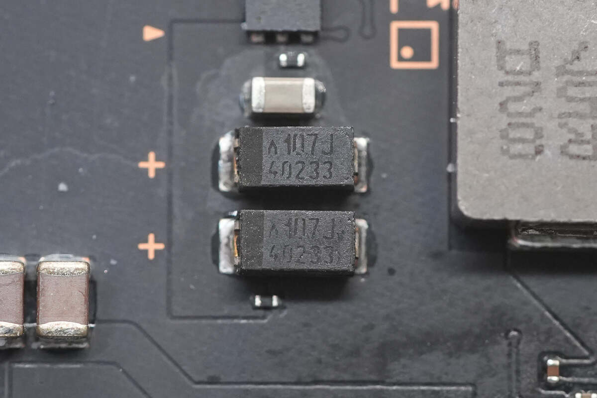

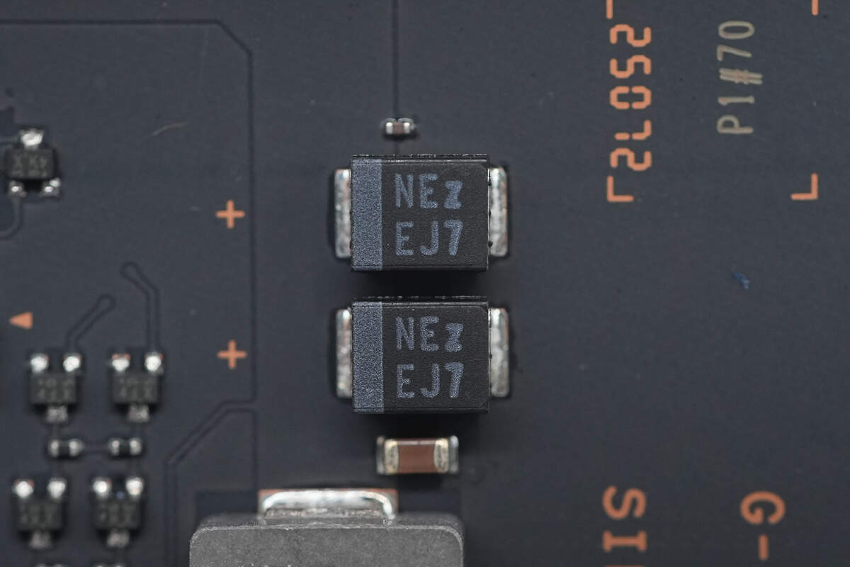

Close-up of the tantalum capacitor used for buck output filtering.

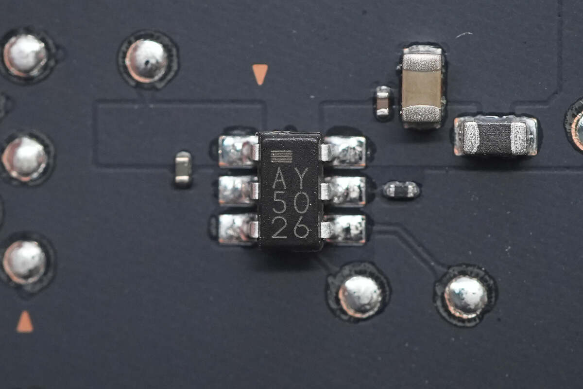

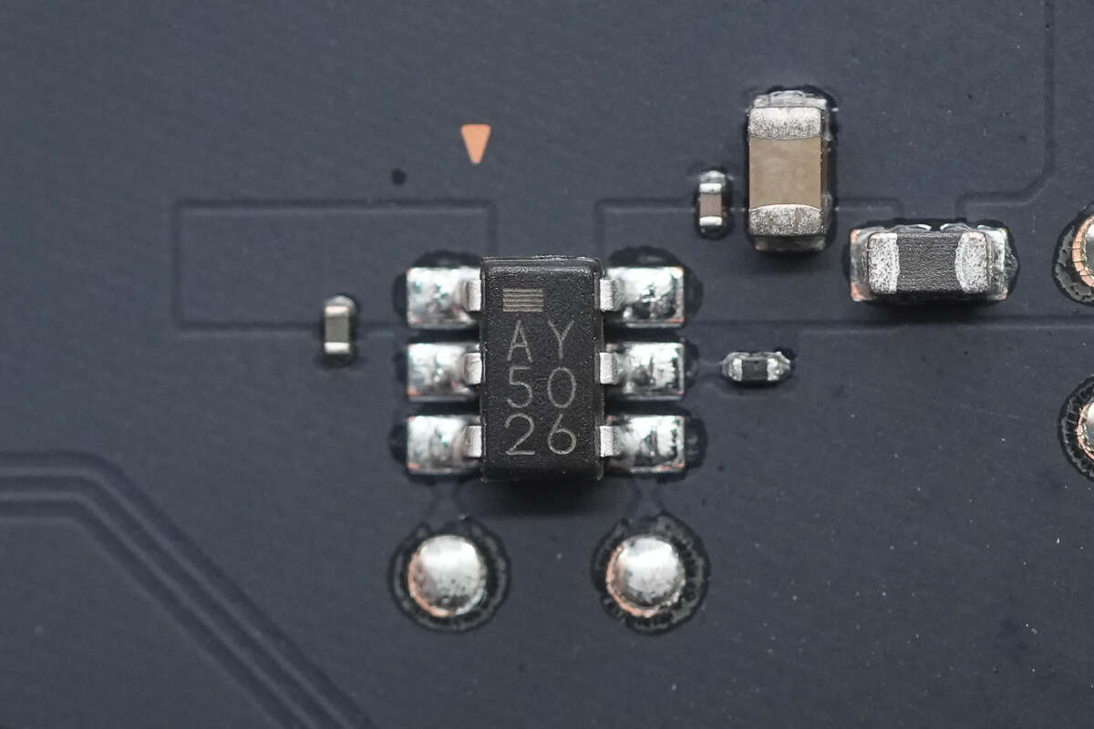

The USB-A port current-limiting chip is from ROHM, marked AY, model BD2242G. It features a built-in low-resistance MOSFET, adjustable current limit from 0.2 to 1.7A, supports output discharge, and comes in an SSOP6 package.

The two tantalum capacitors are rated at 100μF, 6V.

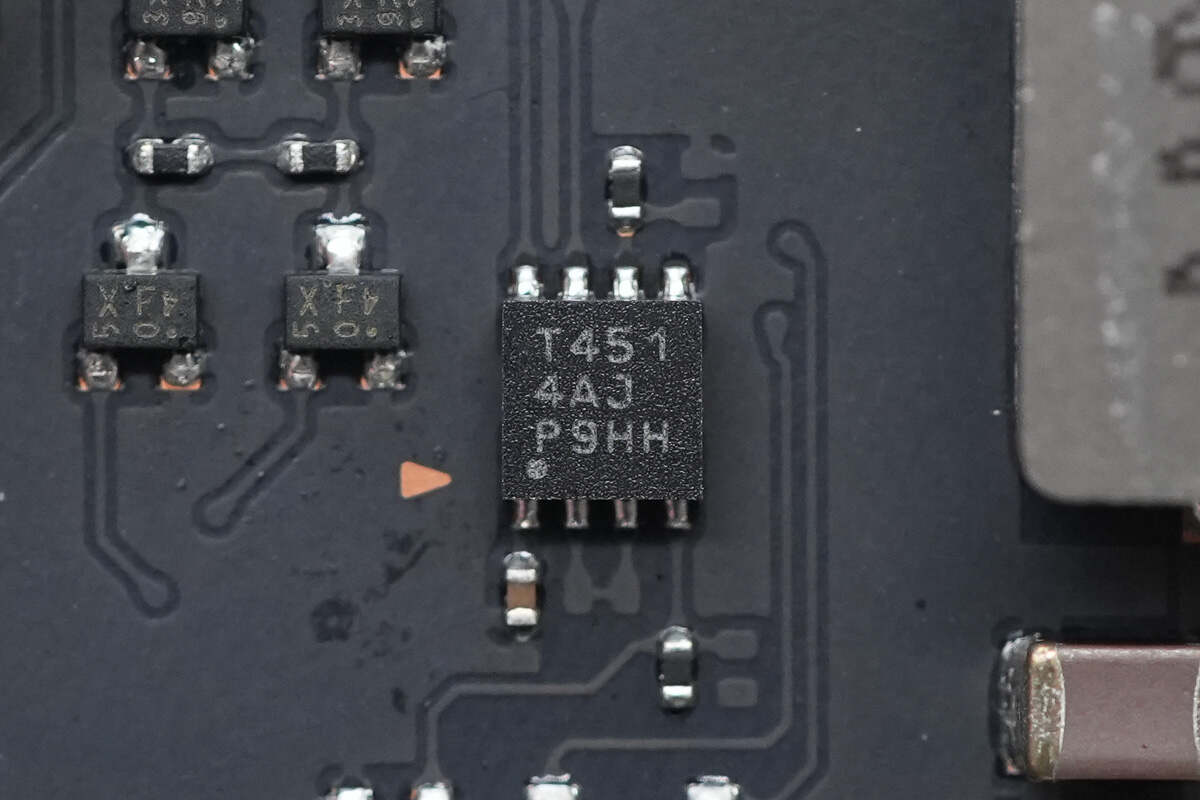

A temperature sensor is used in the two buck circuits, from TI, marked T451, model TMP451. It supports external sensing and comes in a WSON8 package.

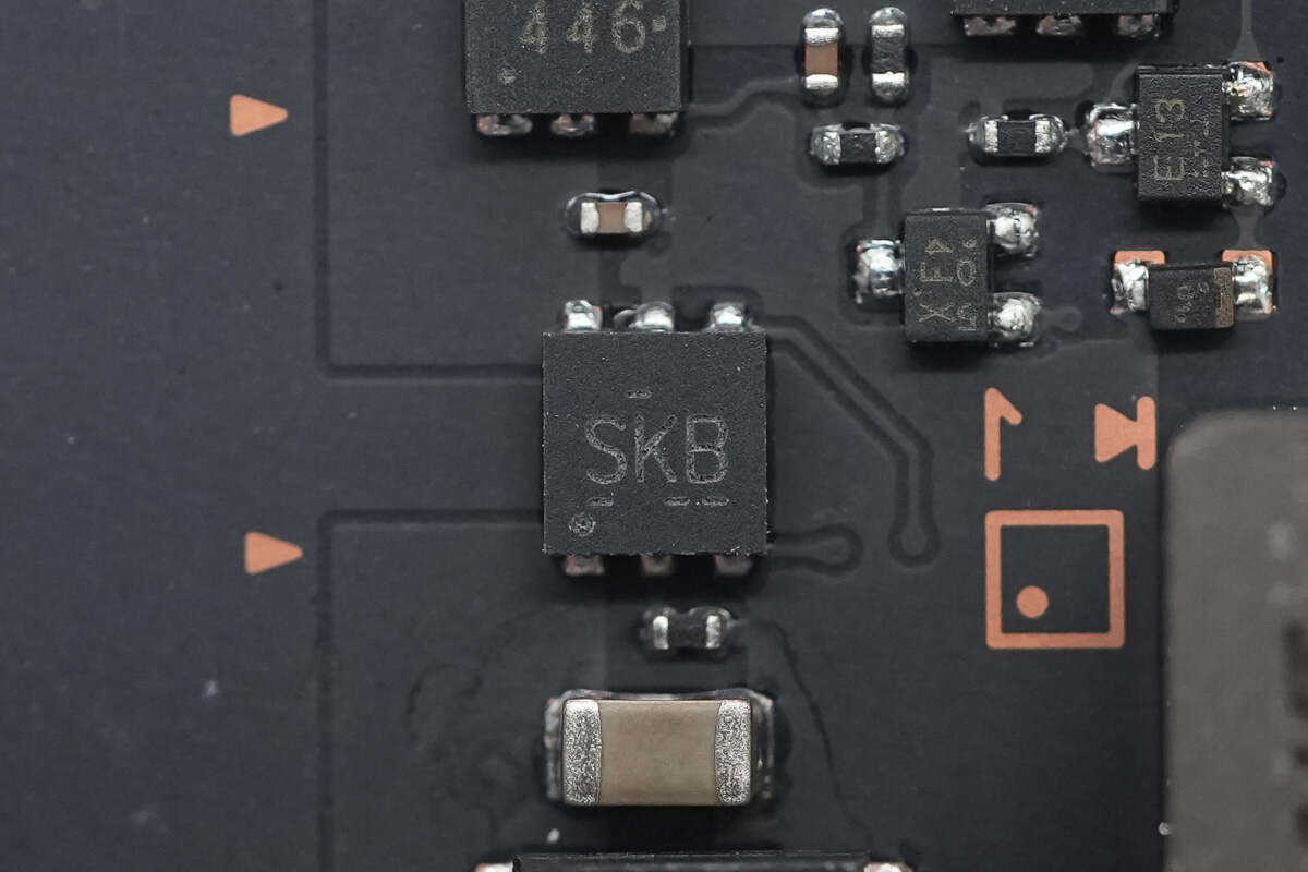

The load switch is from TI, marked with SKB, model TPS25200. It is an eFuse that supports reverse current blocking, with an operating voltage of 6.5V and a current rating of 2.9A. It comes in a WSON6 package.

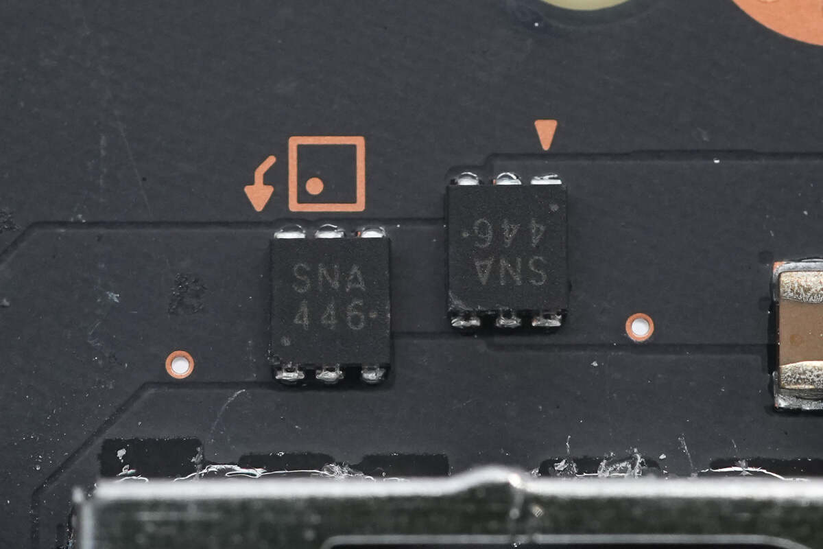

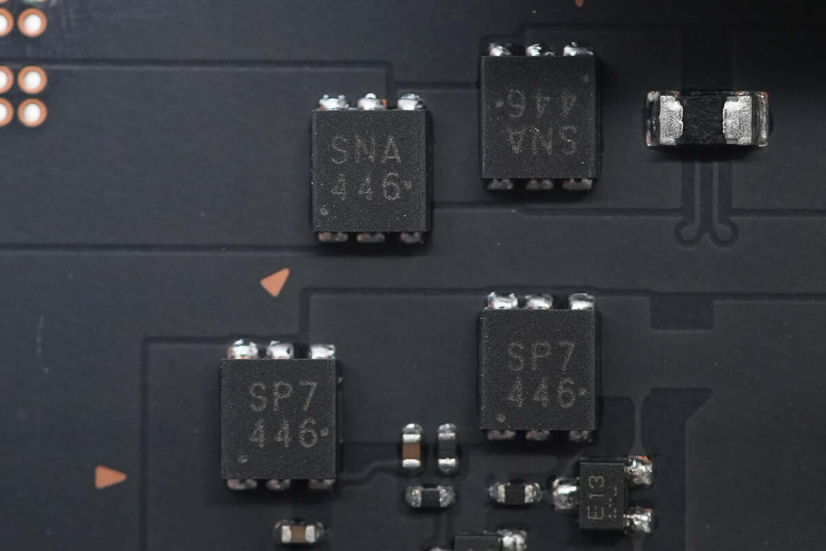

The VBUS MOSFETs marked with SNA and SP7 are used for power switching.

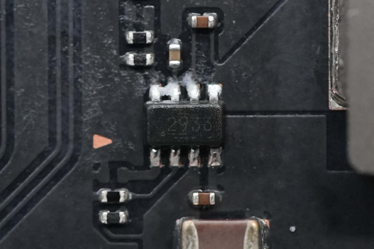

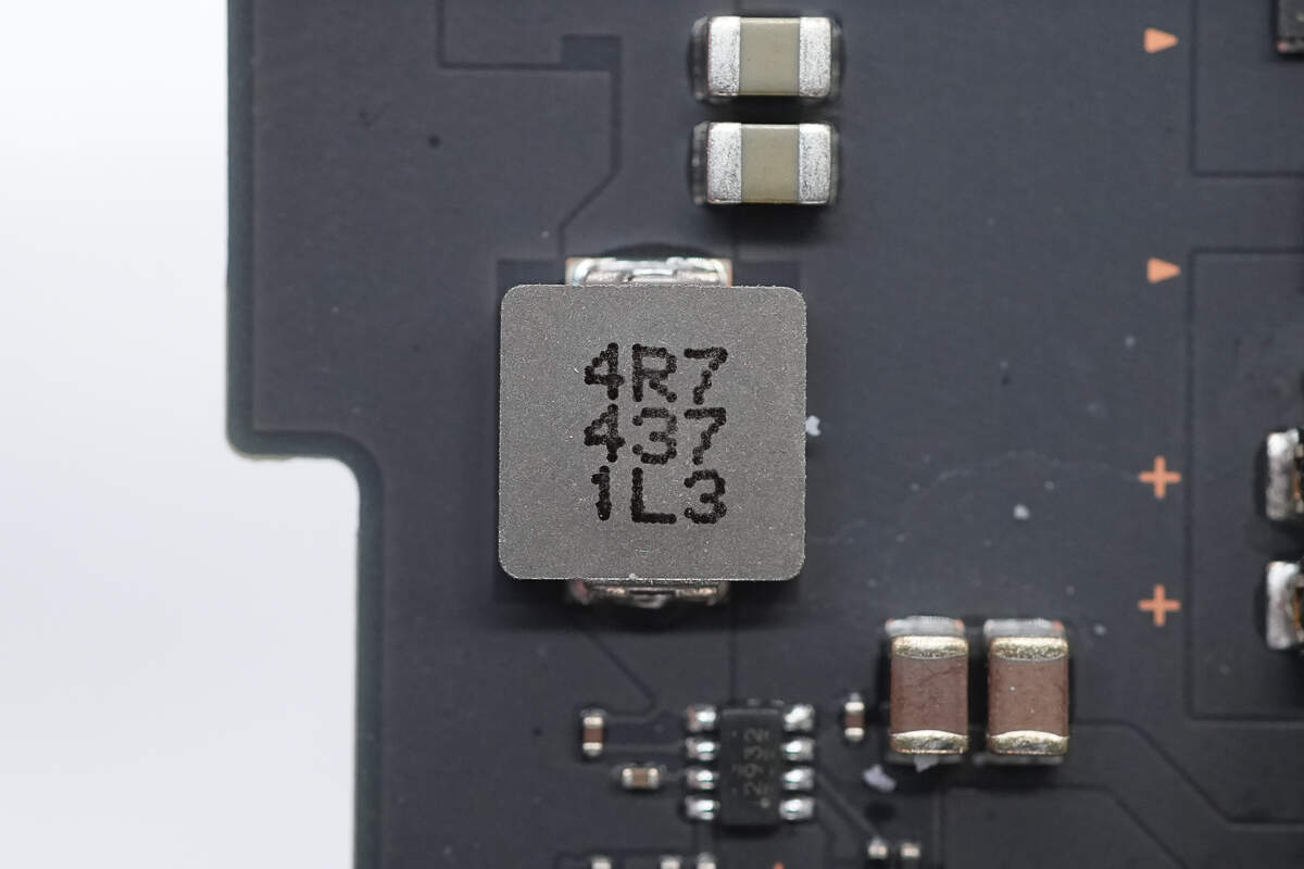

The synchronous buck converter used for the USB-C output port is the TI TPS62932. It integrates internal switching transistors and supports a wide input voltage range of 3.8–30V, with an output voltage range of 0.8–22V. It delivers a continuous output current of 2A and comes in a SOT583 package.
Close-up of the accompanying 4.7μH buck inductor.

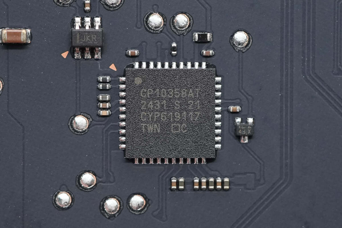

The USB-C output port controller is also from Infineon, marked CP10358AT, and comes in a QFN40 package.

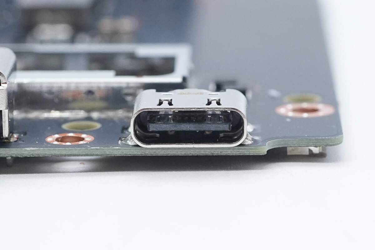

The USB-C input socket is soldered using through-hole technology.

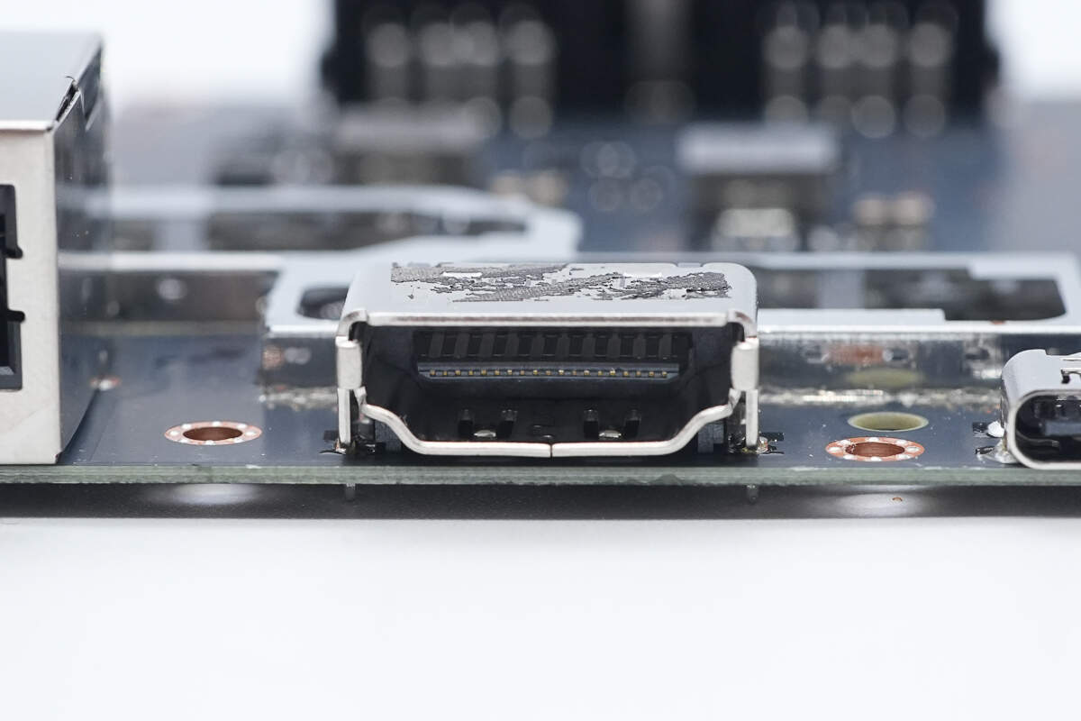

The HDMI socket is also soldered using through-hole technology.

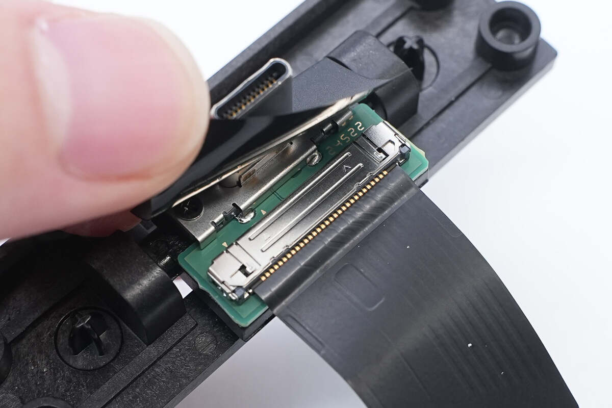

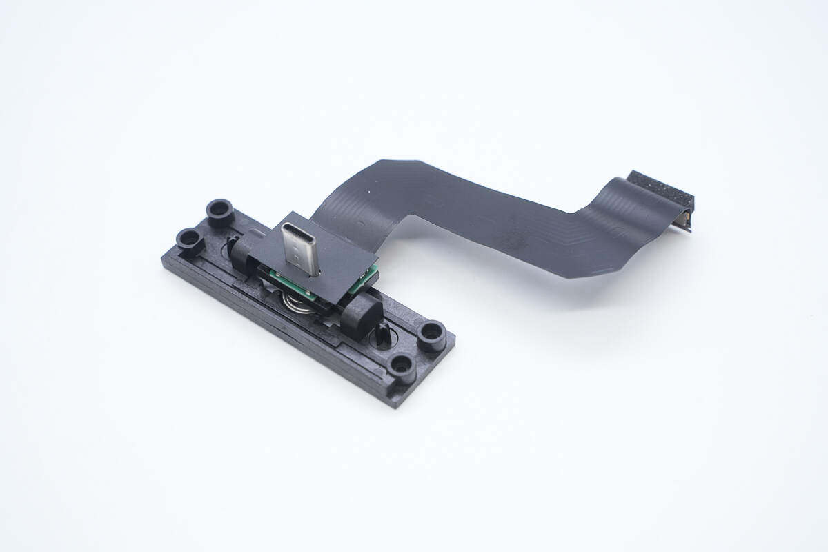

The USB-C male connector is mounted on a separate plastic board.
The USB-C male connector is connected to the socket via a ribbon cable.
The USB-C male connector features a full-pin design.

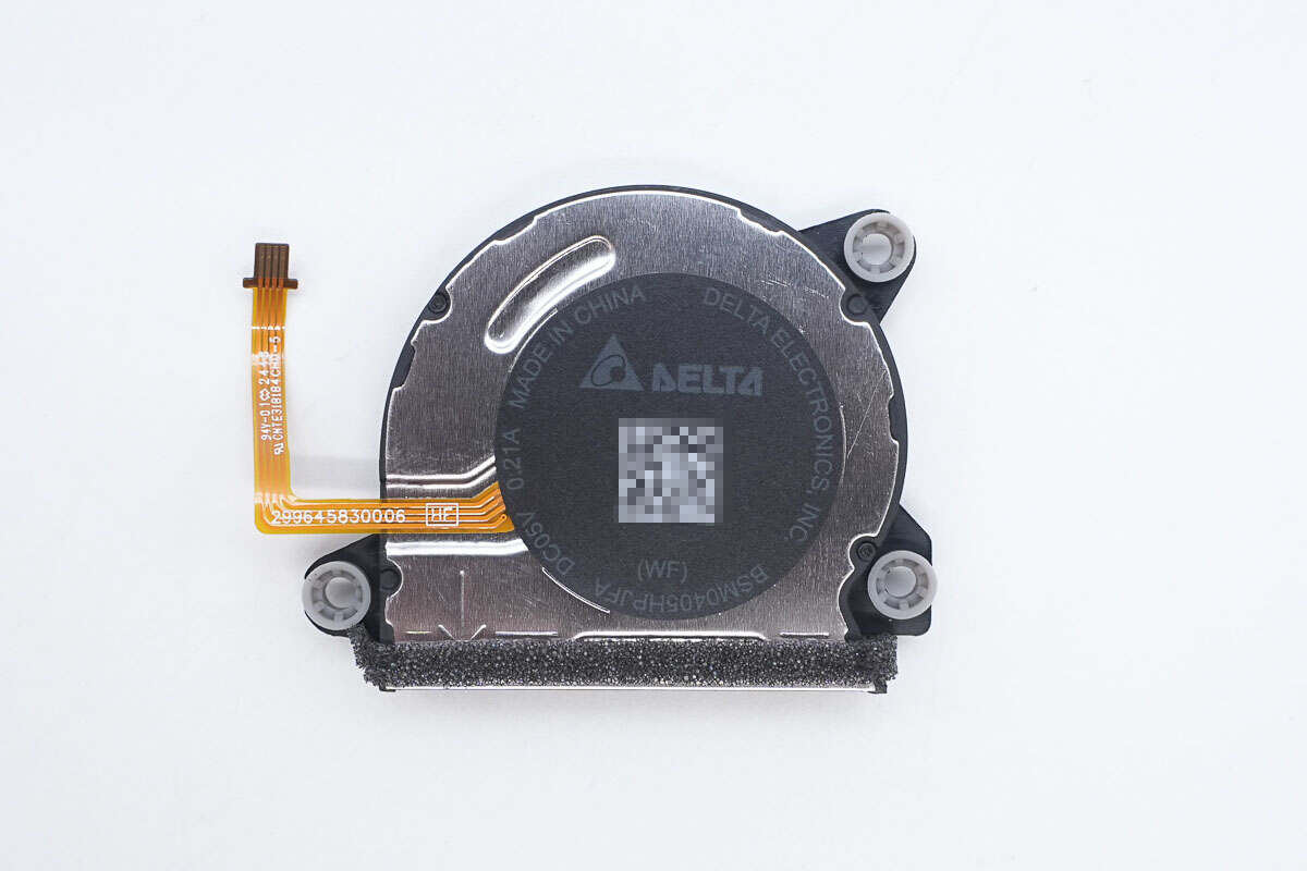

The cooling fan is from Delta, model BSM0405HPJFA, rated at 5V, 0.21A.
