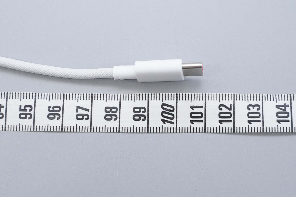

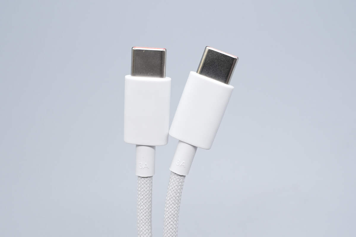

The included cable is a braided USB-C to USB-C cable.
Teardown of Xiaomi 30W 2-in-1 Magnetic Wireless Charger (MDY-20-EC)-Chargerlab
The length of the cable is about 101 cm (39.76 inches).

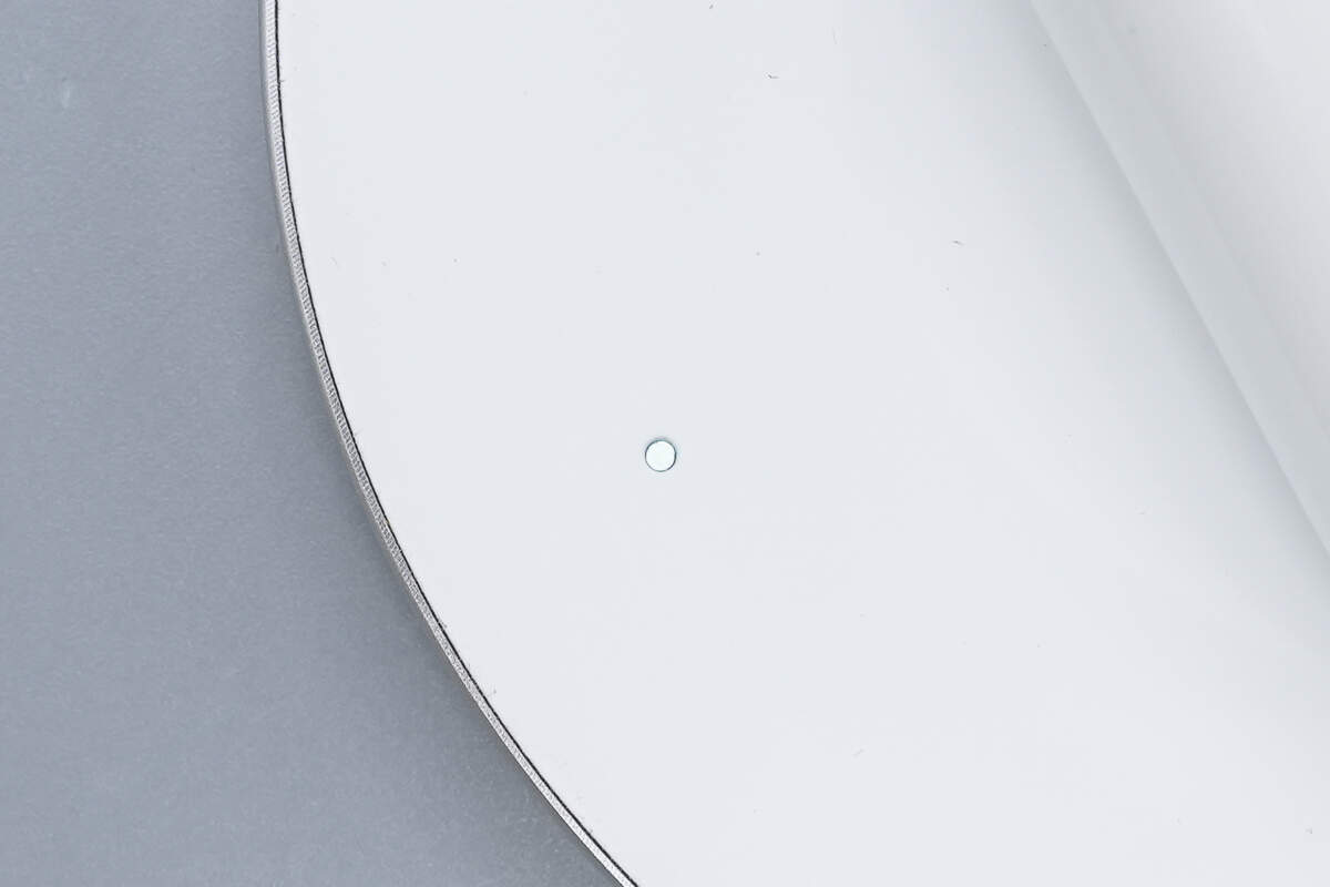

The top of the base is covered with a silicone panel and features an indicator light.
When charging normally, the LED indicator remains steadily lit. If there is a protocol mismatch or the device cannot charge properly, the LED will flash continuously.

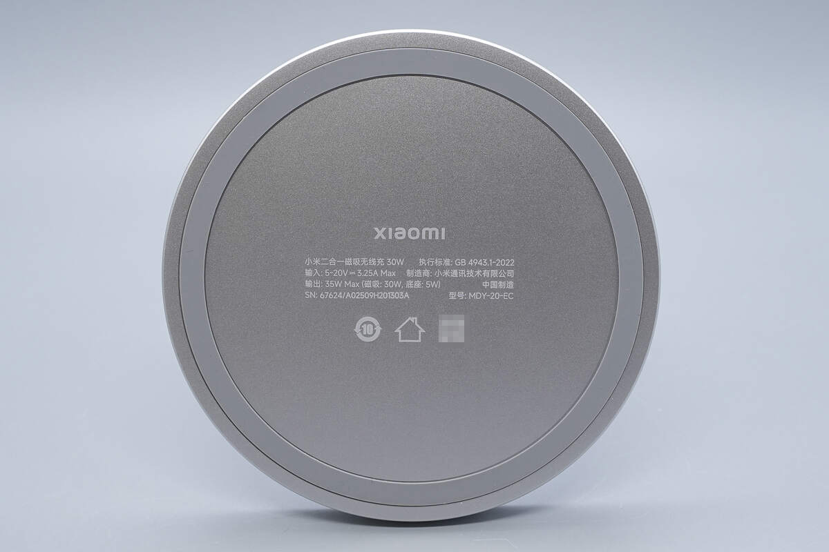

The bottom has a circular anti-slip pad, with the product specifications printed at the center.
Model: MDY-20-EC
Input: 5-20V 3.25A Max
Output: 35W Max (Magnetic: 30W, Base: 5W)

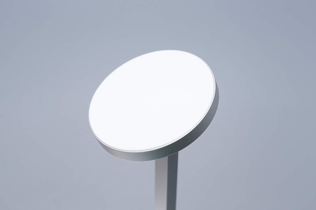

The front of the magnetic wireless charging panel is also covered with silicone material.

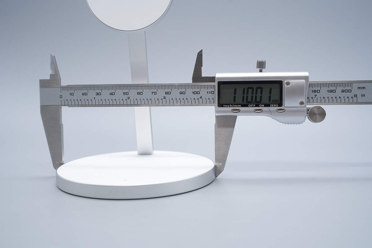

The diameter of the base is about 110.01 mm (4.33 inches).

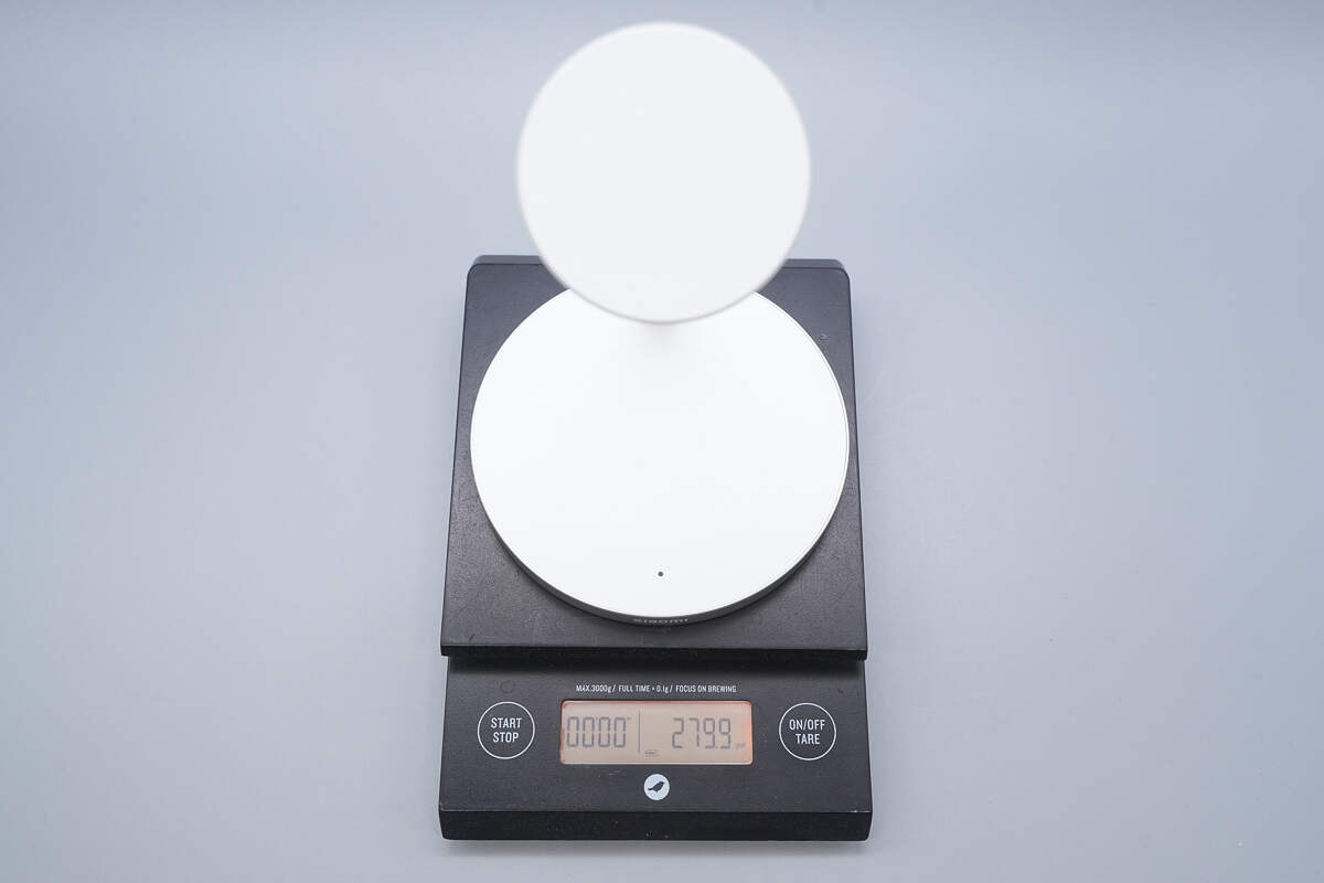

The weight is about 280 g (9.88 oz).

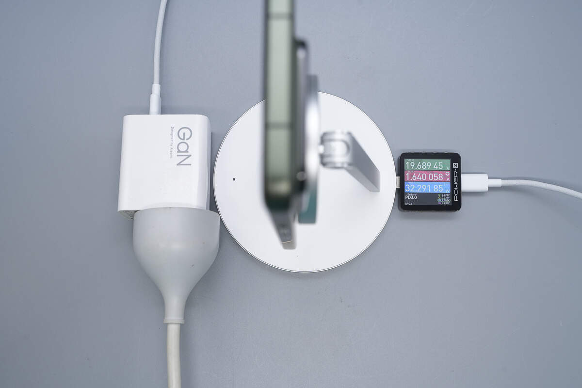

Charging the Xiaomi 15 Pro via the magnetic wireless charging panel successfully activates 30W fast wireless charging on the phone.
At this moment, the input power is about 32.29W.

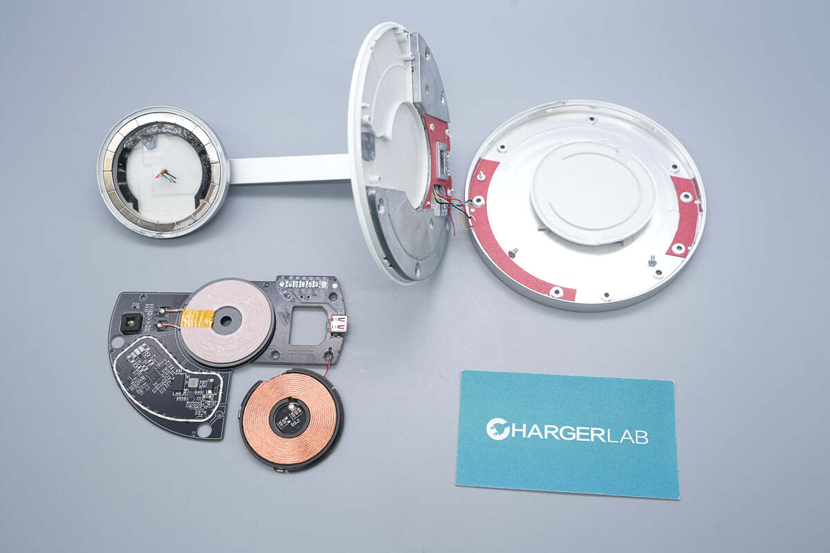

Next, let's start to take it apart and take a look at the internal components.

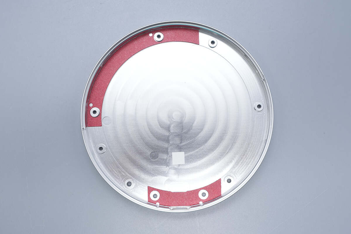

There are screws hidden beneath the anti-slip pad on the base; removing them allows the outer casing to be opened.
Red insulating paper is applied to the inner side of the metal casing, aligned with the edge areas of the PCB.
The PCB inside the base has an irregular shape. The remaining space is occupied by two counterweights, precisely shaped to fit the internal structure.
Both the PCB and the two counterweights are secured with screws.
The support arm is secured to the base with screws.
Remove the screws to take out the PCB.

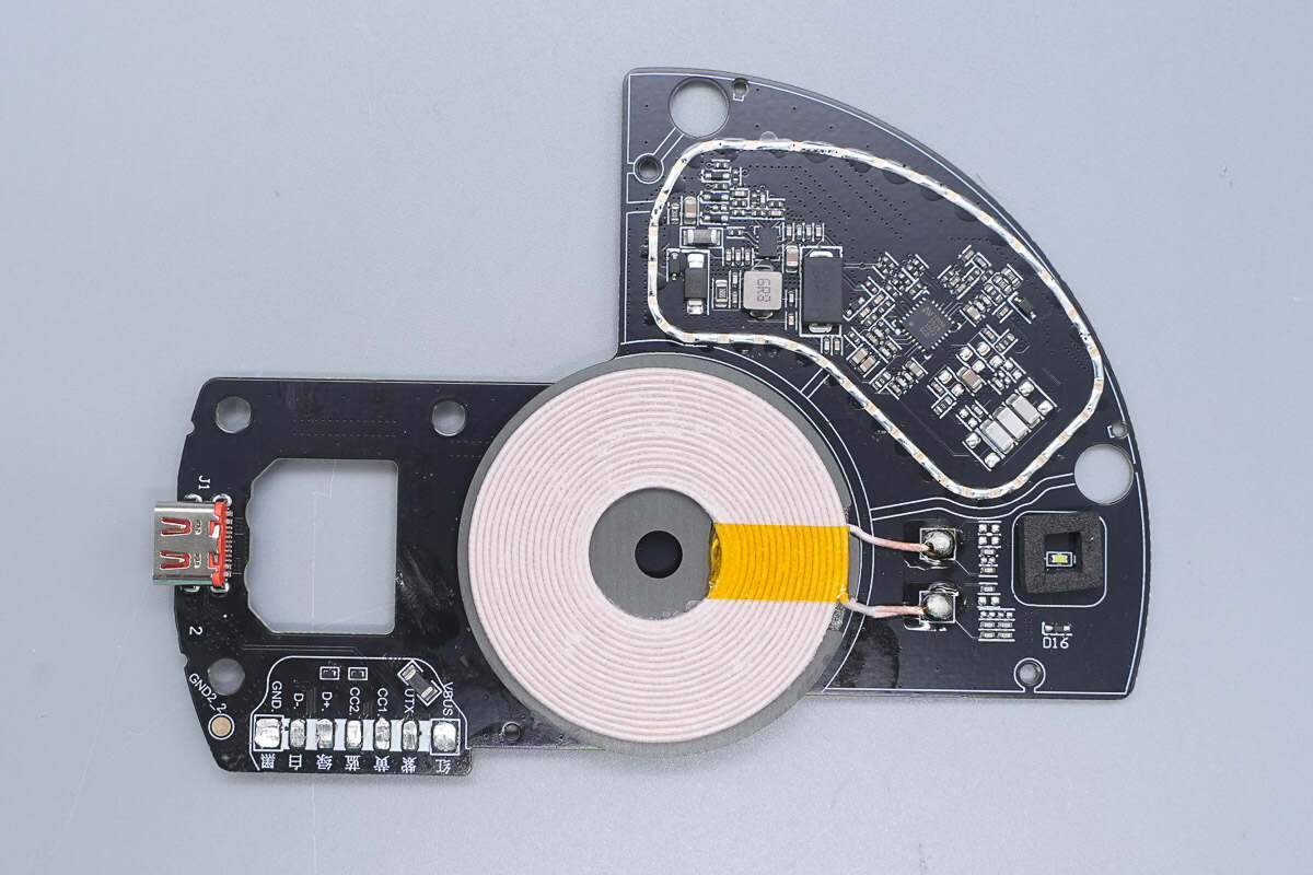

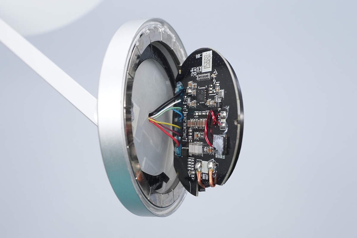

The charging panel is connected to the PCB via a set of wires.
The front side of the PCB features components such as a reverse protection diode, synchronous buck converter, buck inductor, a wireless charging IC, and NPO resonant capacitors.
The back side is lined with foam padding and conductive fabric.

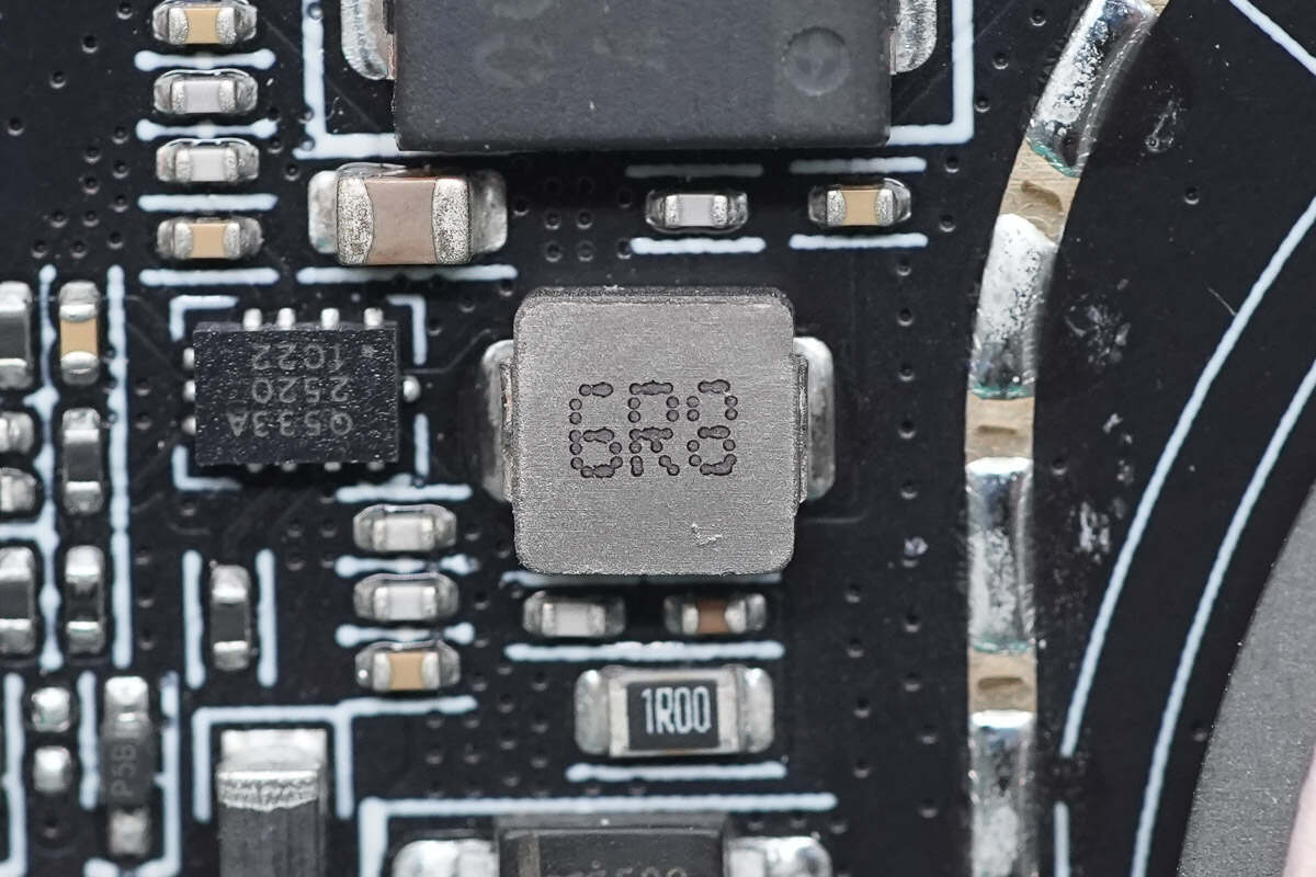

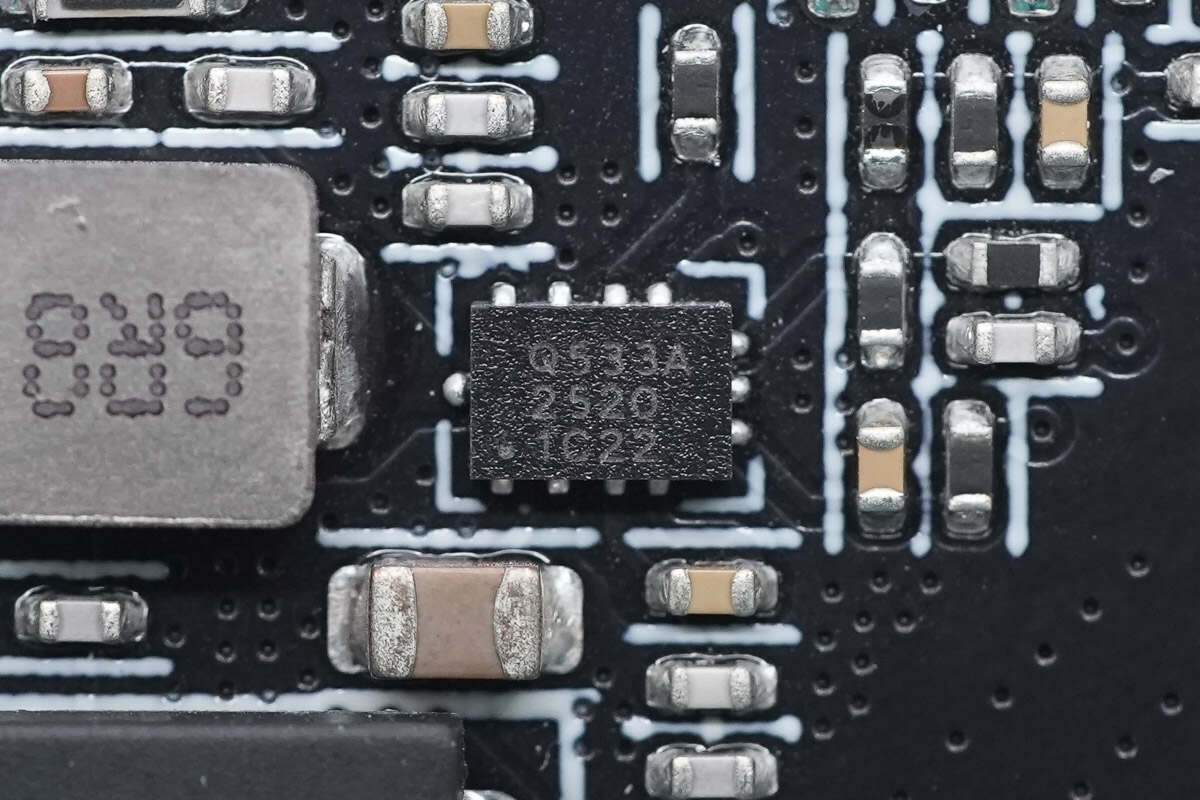

The synchronous buck converter is marked with Q533A and comes in a QFN package.
Close-up of the paired 6.8μH buck inductor.

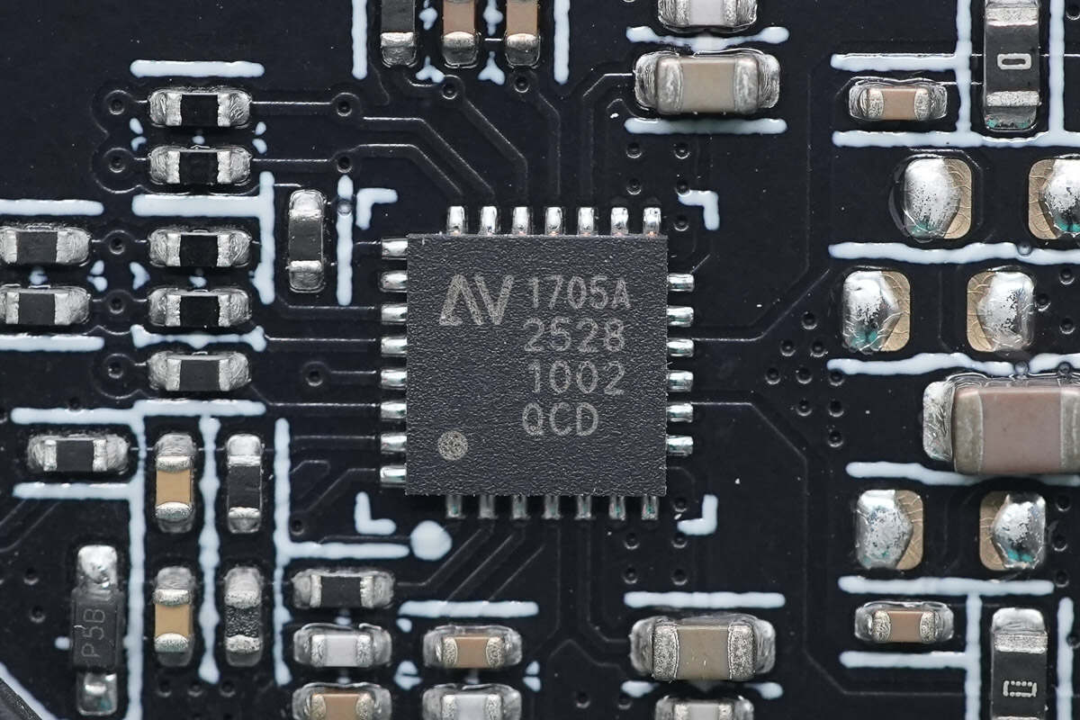

The wireless charging chip is the NU1705A from NuVolta. It integrates a full-bridge power stage architecture suitable for wide frequency ranges along with a 32-bit MCU core. The chip also includes all critical functional modules, such as high-efficiency power MOSFETs, low-EMI FET drivers, bootstrap circuitry, integrated 4.8V/1.8V LDOs, and lossless current sensing technology.
Its patented current sensing circuitry provides accurate current readings, supporting features such as foreign object detection (FOD), power measurement, in-band communication, Q-factor detection, and digital demodulation. The chip is equipped with multiple protection mechanisms, including input undervoltage lockout, overvoltage protection, overcurrent protection, NuVolta’s proprietary “Juggle Protection” dynamic circuit, and thermal shutdown. These features significantly enhance the reliability of the overall system solution. It comes in a 4mm × 4mm QFN package.

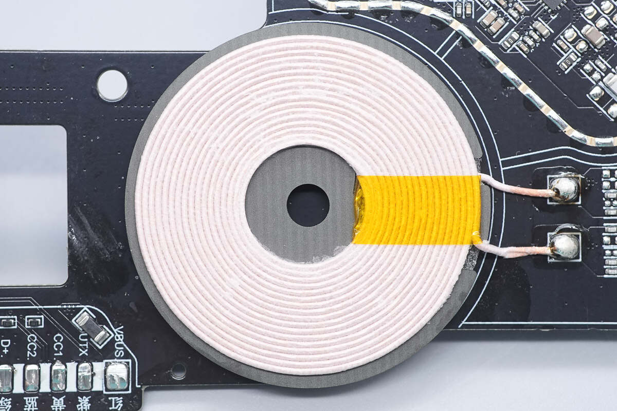

Close-up of the wireless charging coil.
Foam padding is placed beneath the coil and the magnetic shielding sheet.
Remove the front cover of the magnetic wireless charging panel.
The magnetic ring is reinforced with adhesive, and the wireless charging coil is wound with Litz wire.

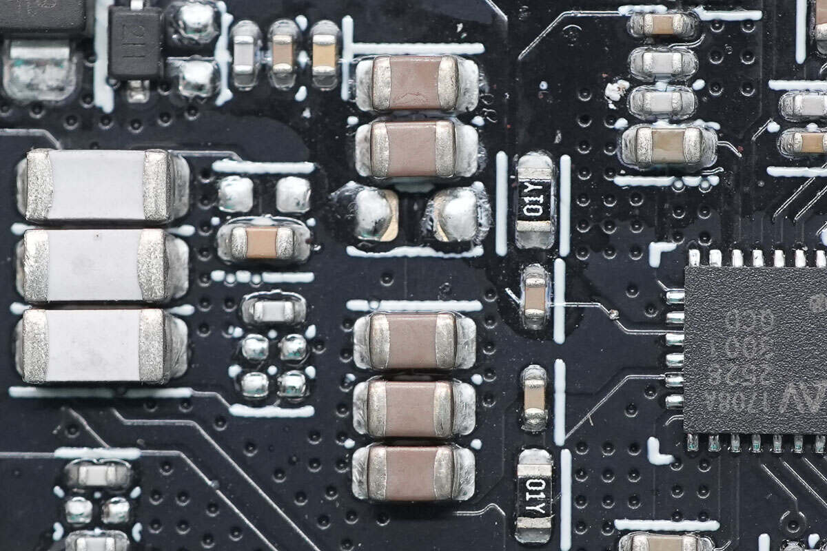

The wireless charging control chip is the NU1708A from NuVolta, a highly integrated wireless charging transmitter IC. It integrates an MCU and wireless charging power stage within a single package, combining the traditional wireless charging controller and power full-bridge chip, significantly saving space. This single chip supports a complete wireless charging design with an output power of up to 30W.
The NU1708A features built-in high-precision lossless current sensing for foreign object detection and in-band communication. It includes integrated protection functions such as input undervoltage lockout, overvoltage protection, overcurrent protection, and thermal shutdown. The chip supports I²C and UART interfaces and has an internal ADC for monitoring charging parameters. It also supports QC and PD fast charging power input, operates with low quiescent current, and comes in a 4×4mm QFN package.

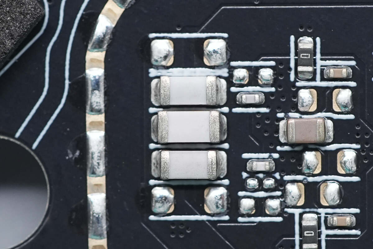

Close-up of the MLCC filtering capacitors.
Close-up of the thermistor.
Close-up of NPO resonant capacitors.
