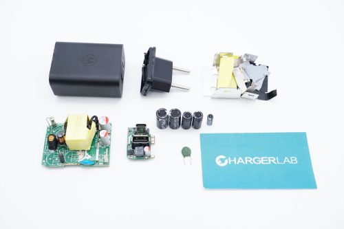

Well, those are all components of the Motorola 50W charger.
Teardown of Motorola 50W Charger (MC-507)-Chargerlab
Here is the component list of the Motorola 50W charger for your convenience.
The Motorola 50W charger has a simple design, with the brand logo and the number 50 on the front and back. It is equipped with USB-A and UAB-C output ports and is compatible with the two universal fast charging protocols, QC3.0 and PD3.0. The USB-C port also supports PPS, with maximum output power of 20W and 50W, respectively, meeting the charging needs of two devices at the same time.
After taking it apart, we found it adopts a PI master control chip and Vergiga synchronous rectifier. It adopts the INJOINIC protocol chip used to control the output of the two ports. The PCBA module has been adequately heat-dissipated and insulated and is well-made.
