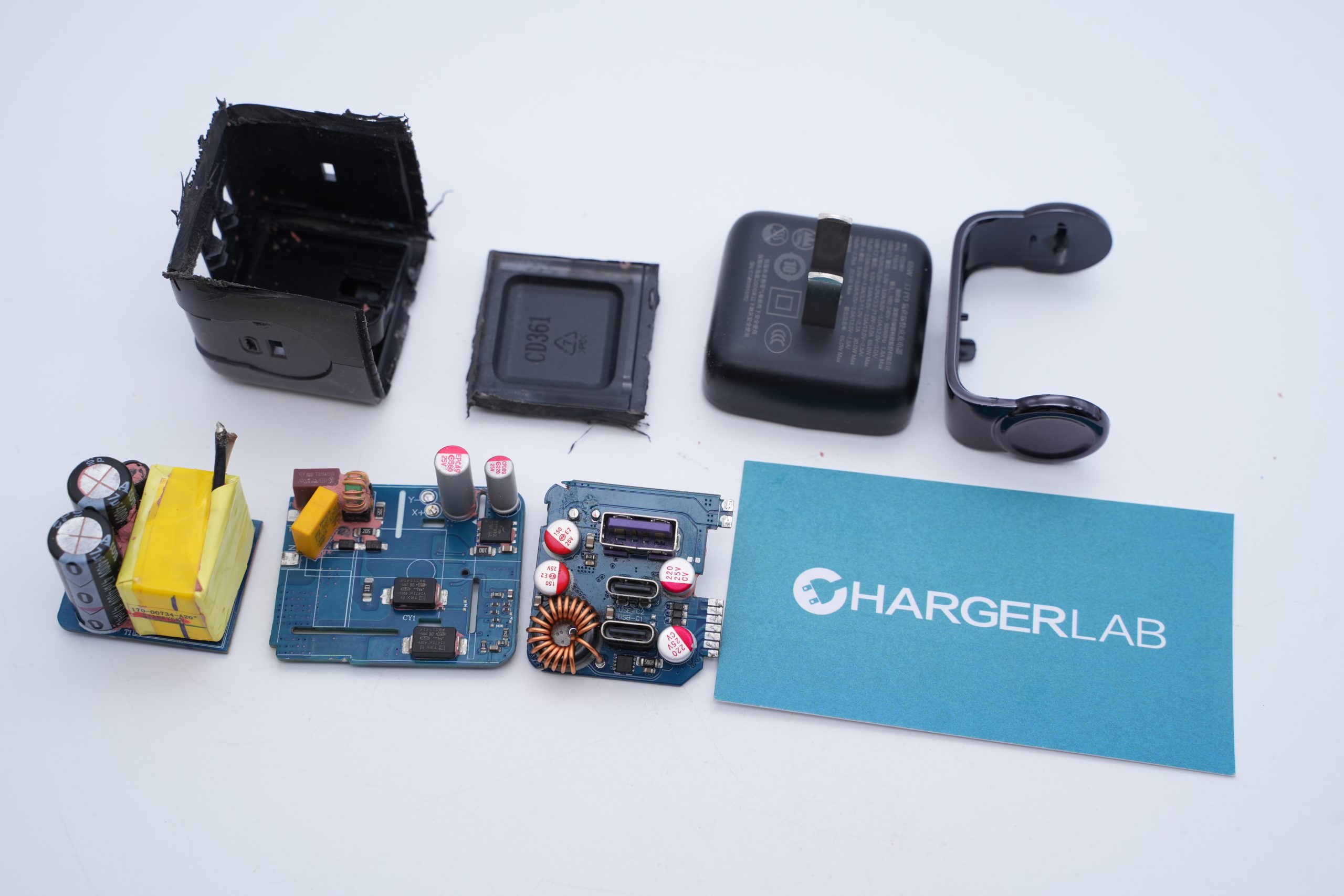

Separate the PCBA module into three small PCBs. The PCB of the switching power supply is on the left, the PCB of input and synchronous rectification is in the middle, and the buck PCB is on the right.
ChargerLAB found it adopts a flyback topology, with synchronous rectification and fixed voltage output. And it has two synchronous buck circuits to achieve three-port fast charging and automatic power distribution.

Well, those are all components of this charger.
The UGREEN 65W 3-in-1 Nexode RG GaN Charger can let you check the output modes through three expressions. And the detachable "shoe covers" make the charger more stable when not in use, they can also protect the AC plugs.
After taking it apart, we found its PCBA module is composed of three small PCBs. It adopts one GaN IC, one synchronous rectifier controller from SouthChip, and two buck master control chips from iSmartWare. Its internal components are arranged compactly to save space. It stands out with its exceptional charm and it also has a charging power of 65W in such a small size. If you are attracted by its appearance and performance, then you might as well give it a try.
