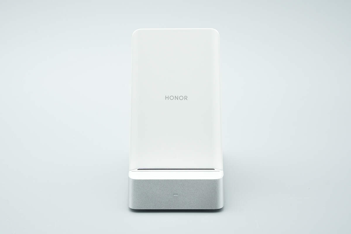

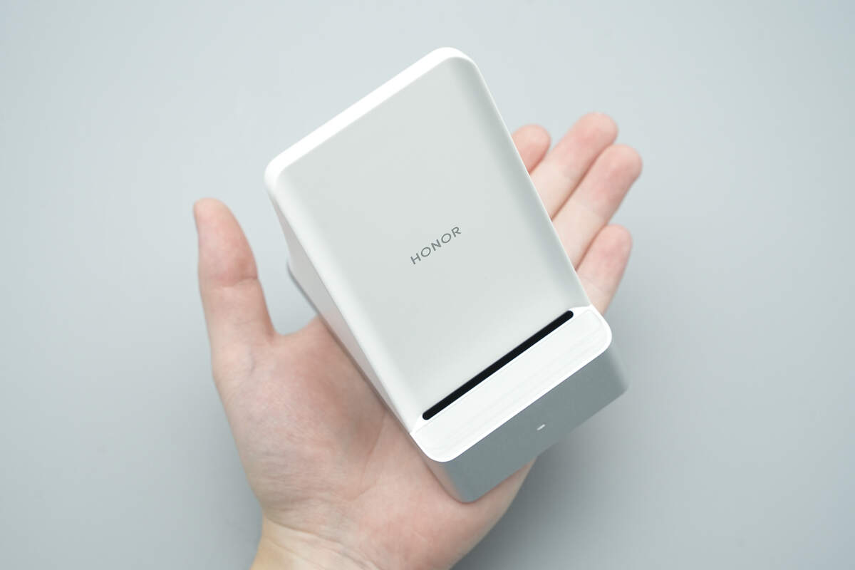

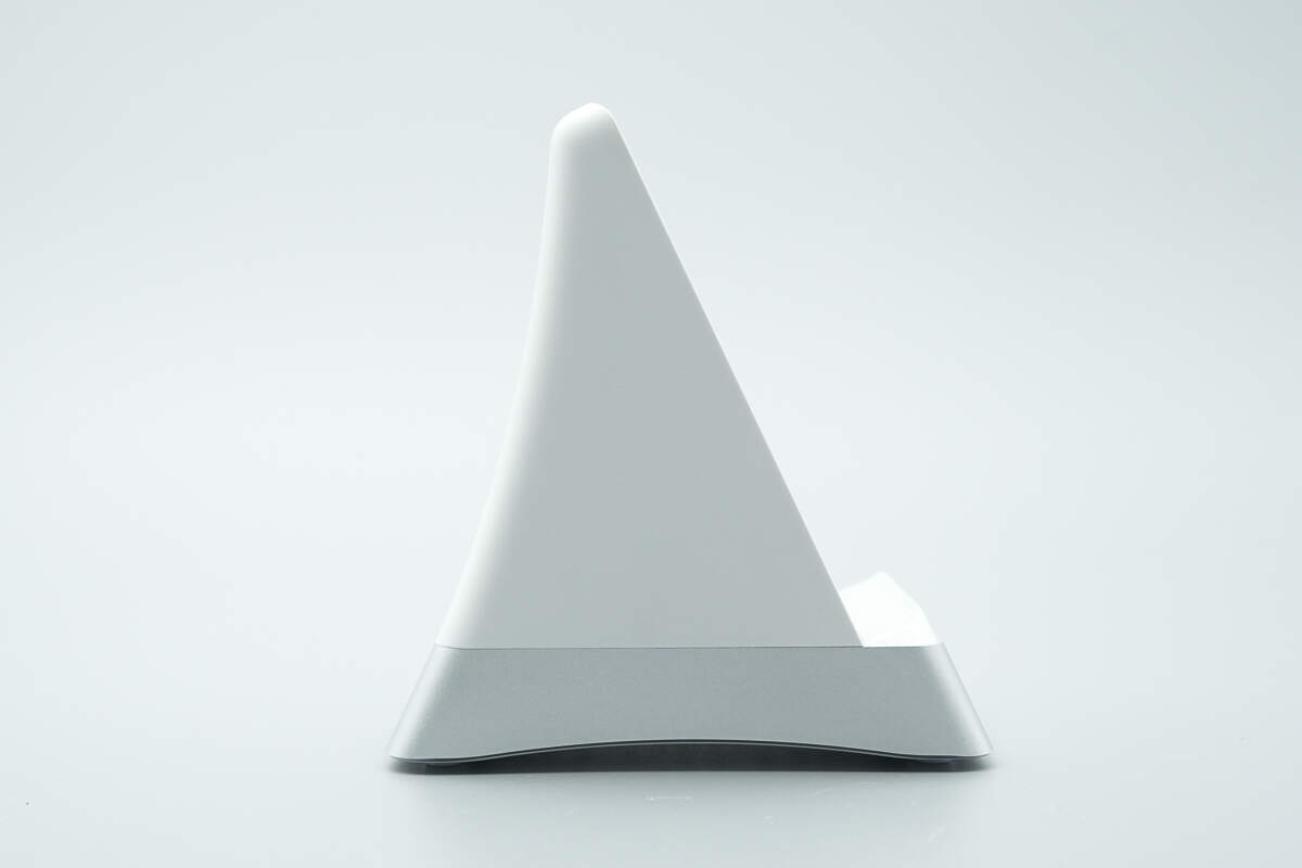

With a 65° inclined design, it serves both as a wireless charging stand and a convenient phone holder.
Teardown of HONOR 80W SuperCharge Wireless Charger Stand (Power-W06)-Chargerlab

The center of the front panel features the HONOR logo.

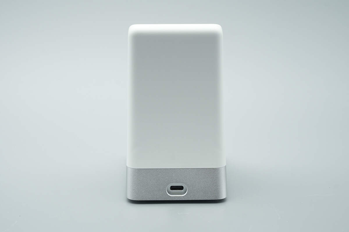

The rear of the charger features a USB-C power input port.

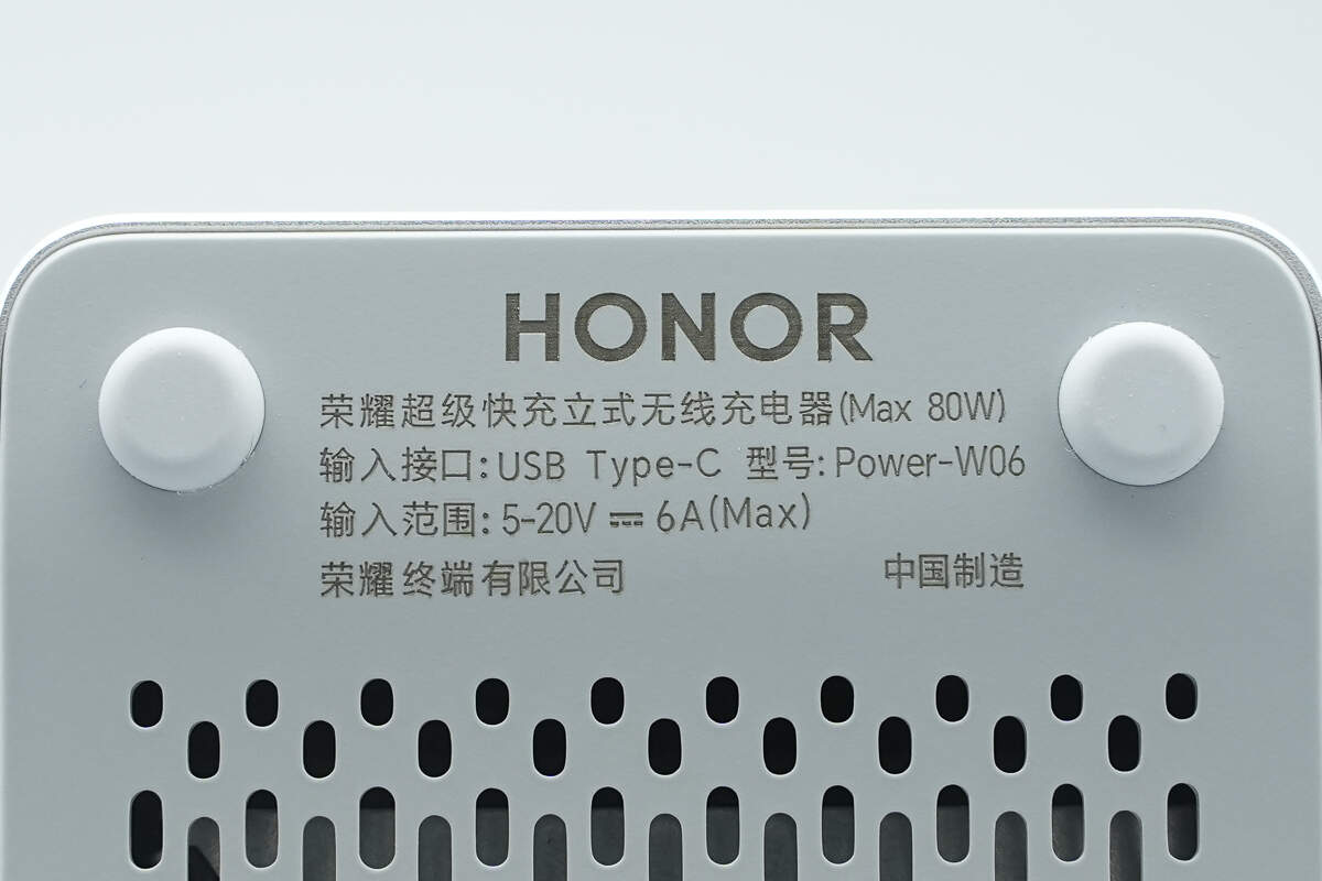

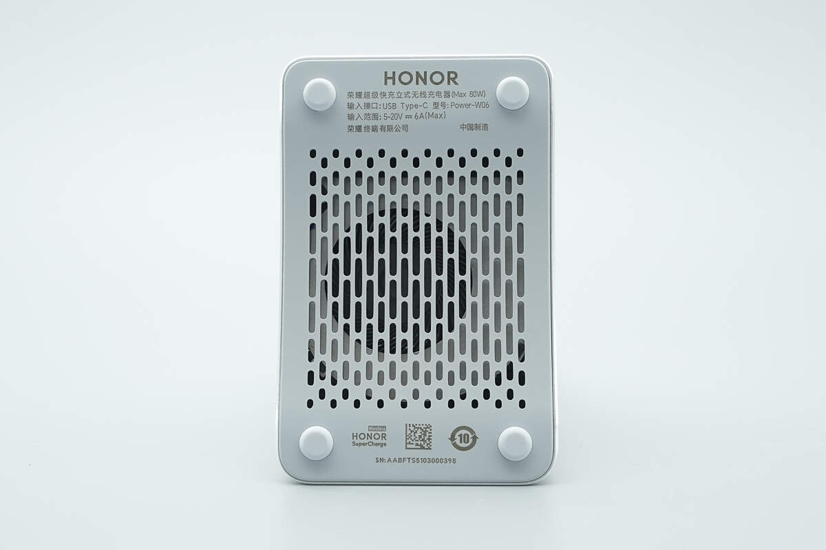

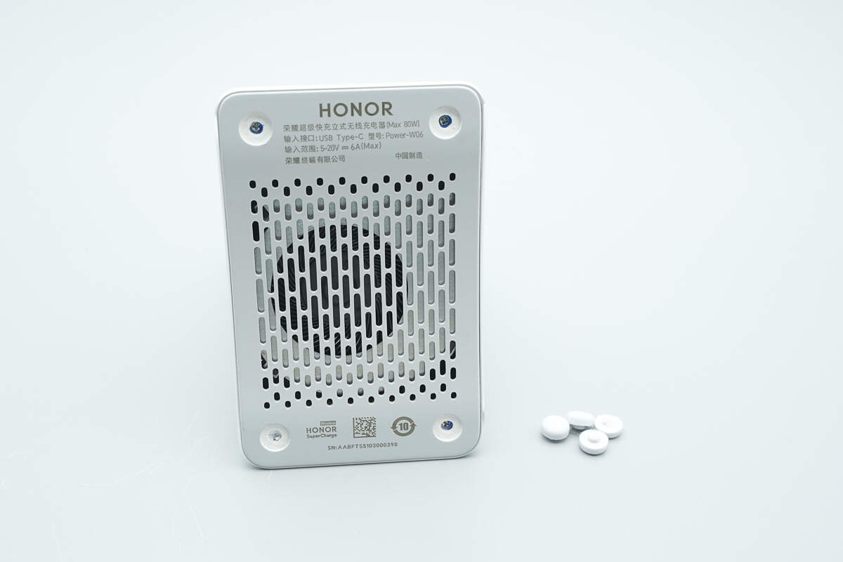

The bottom cover has anti-slip pads at all four corners and also displays the specification information.
Model: Power‑W06
Input Port: USB Type‑C
Input Range: 5–20 V ⎓ 6 A (Max)
The center area of the bottom cover features a grille air intake. A low-noise fan provides active cooling, with intelligent speed control that automatically switches to an ultra-quiet mode at night.

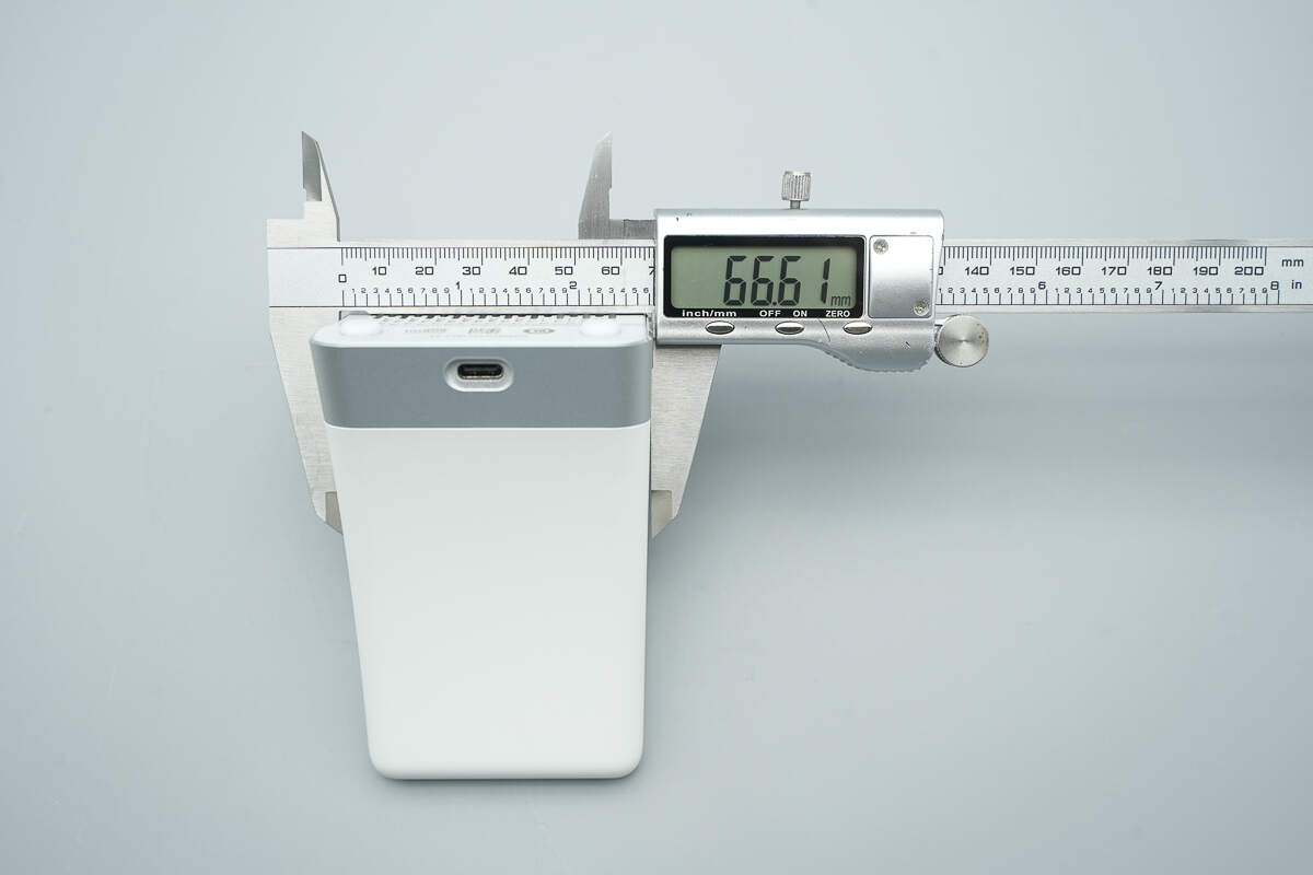

The width is about 66.61 mm (2.62 inches).

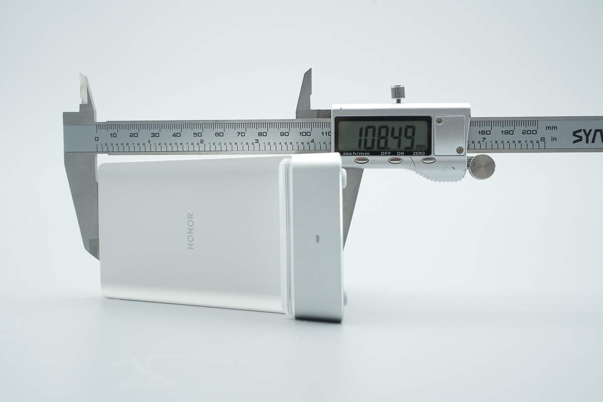

The height is about 108.49 mm (4.27 inches).

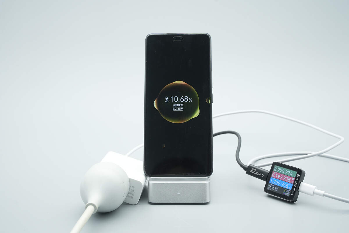

It can charge the HONOR 300 Pro, successfully enabling 80W SuperCharge.

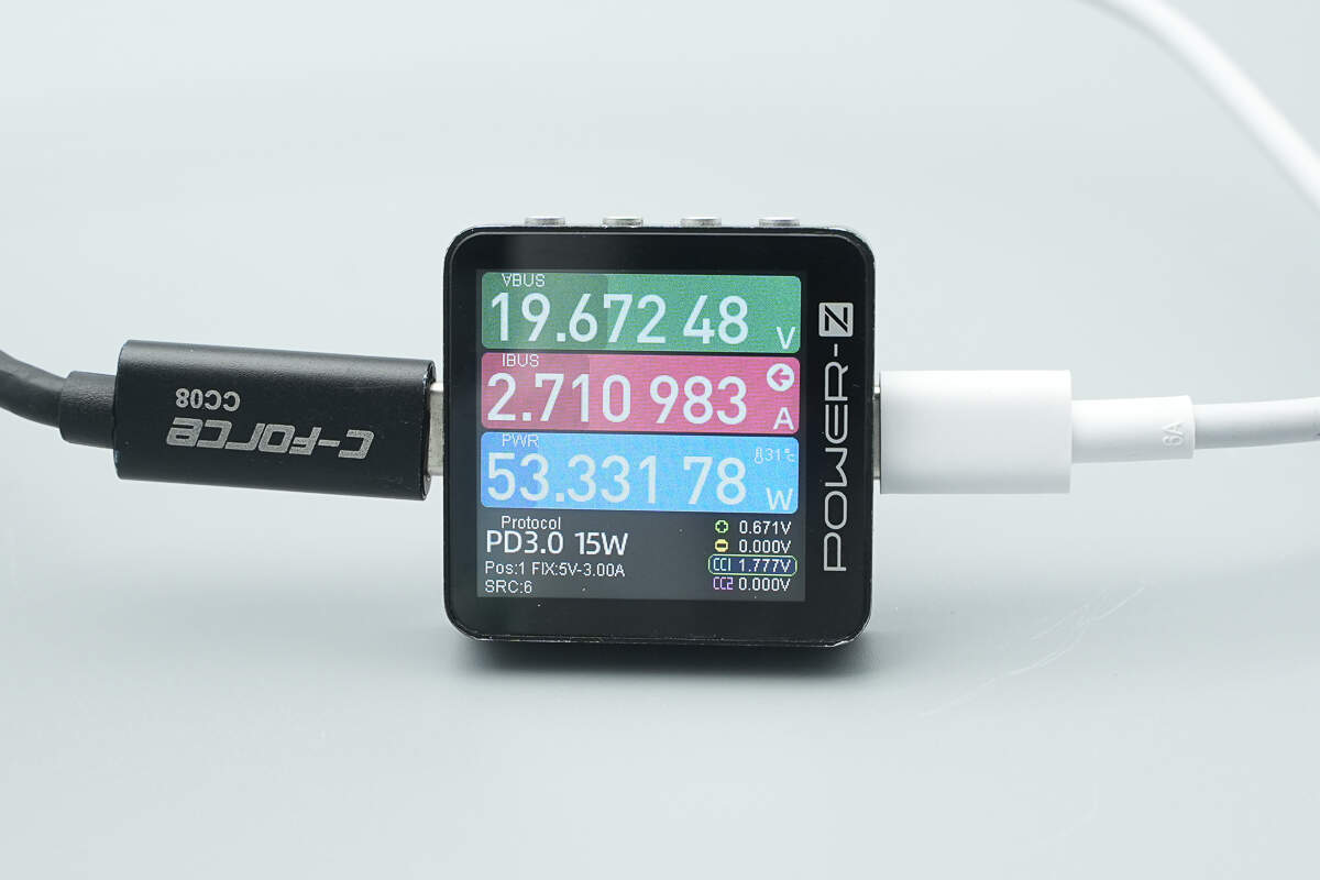

The measured wireless charging output is about 53.33 W.

By removing the four anti-slip pads at the bottom, the hidden screws inside are revealed.

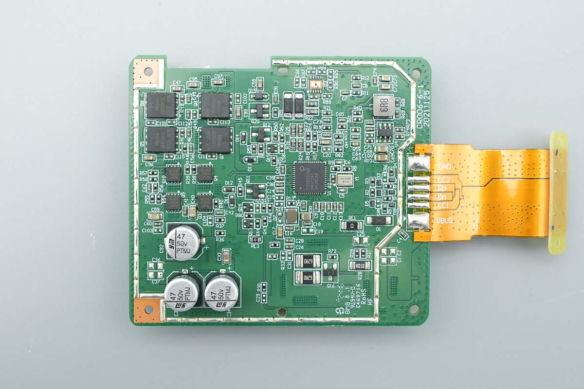

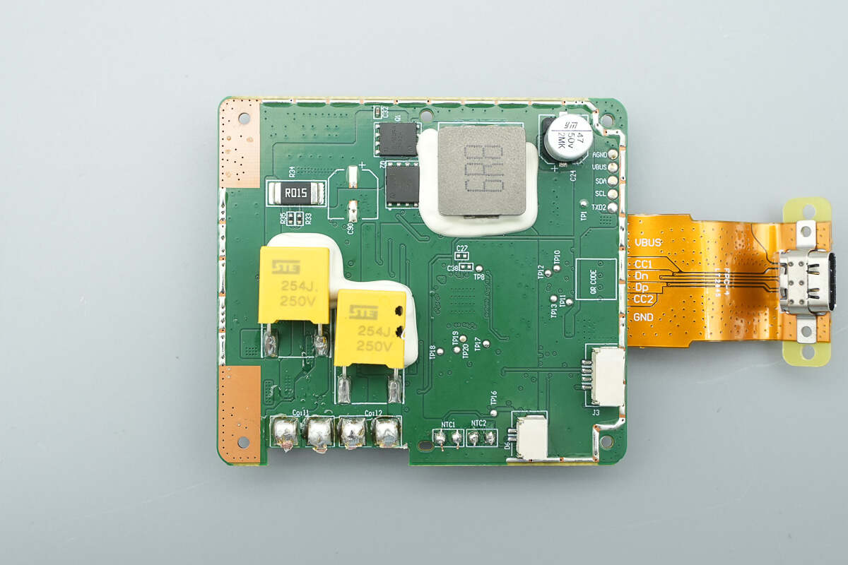

The PCB of the USB-C socket is connected to the main PCB via a ribbon cable. The front houses the wireless charging controller chip, wireless charging power MOSFETs, coil-switching MOSFETs, a synchronous buck converter, solid capacitors, and other components.
The back contains synchronous boost MOSFETs, a boost inductor, a solid capacitor, resonant capacitors, and other related components.

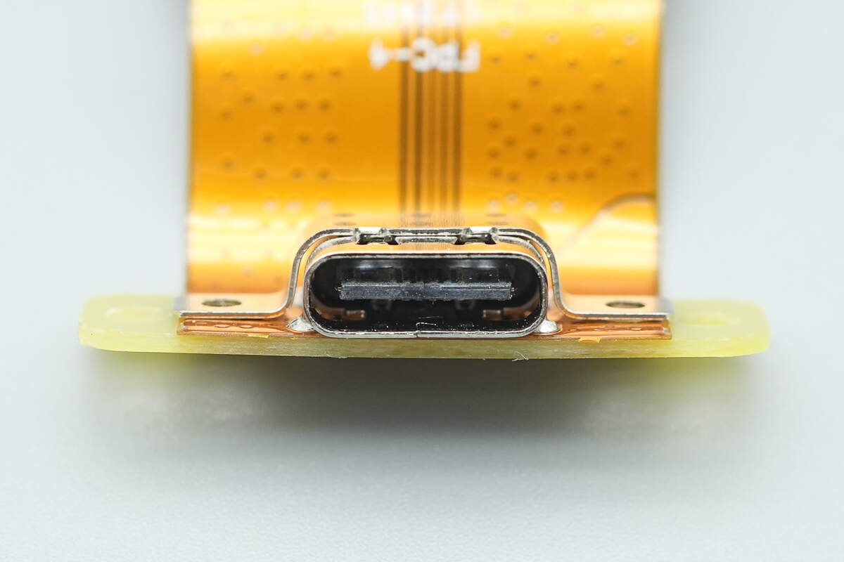

The metal casing of the USB-C socket is spot-welded for reinforcement.

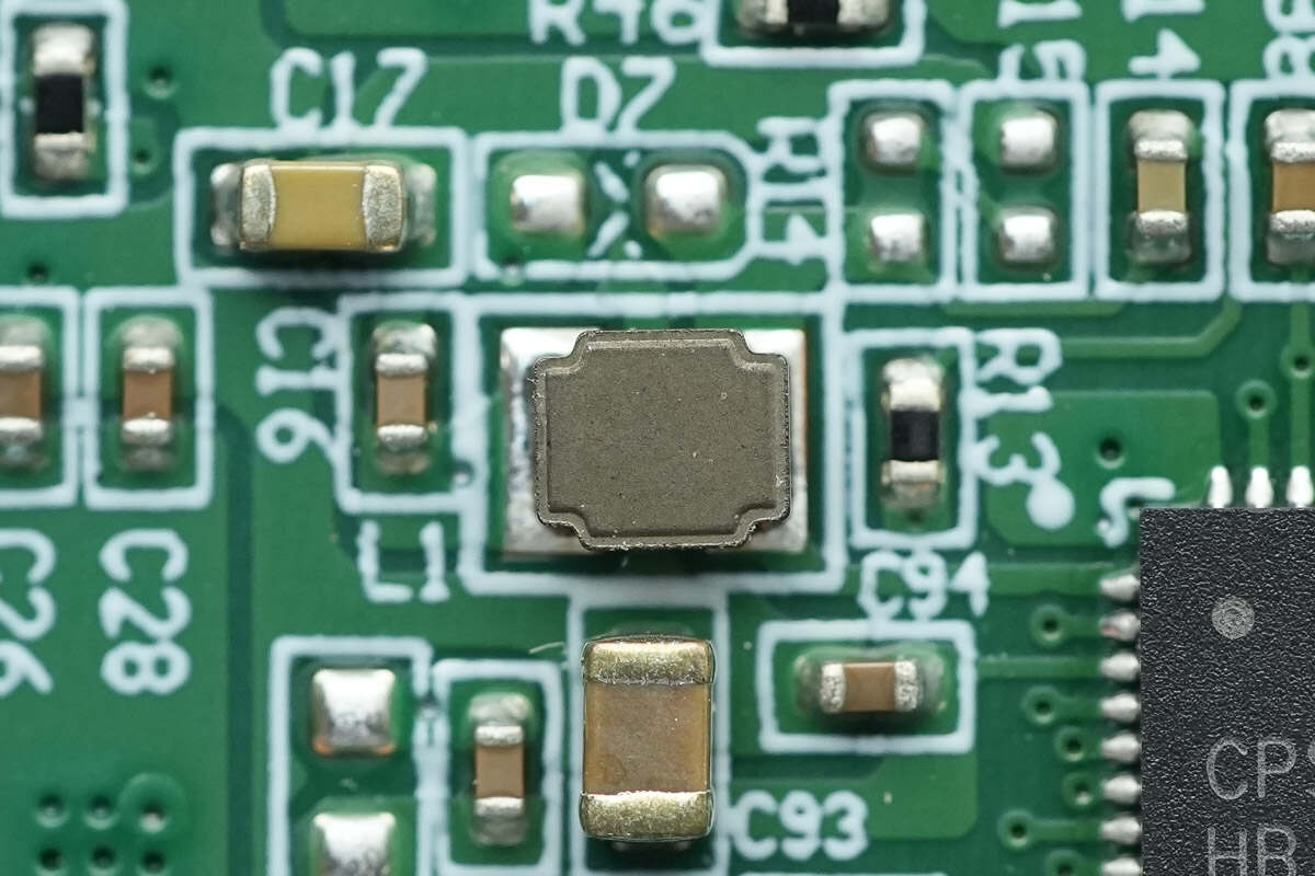

It uses a 10 μH inductor for buck conversion to achieve self-powering.

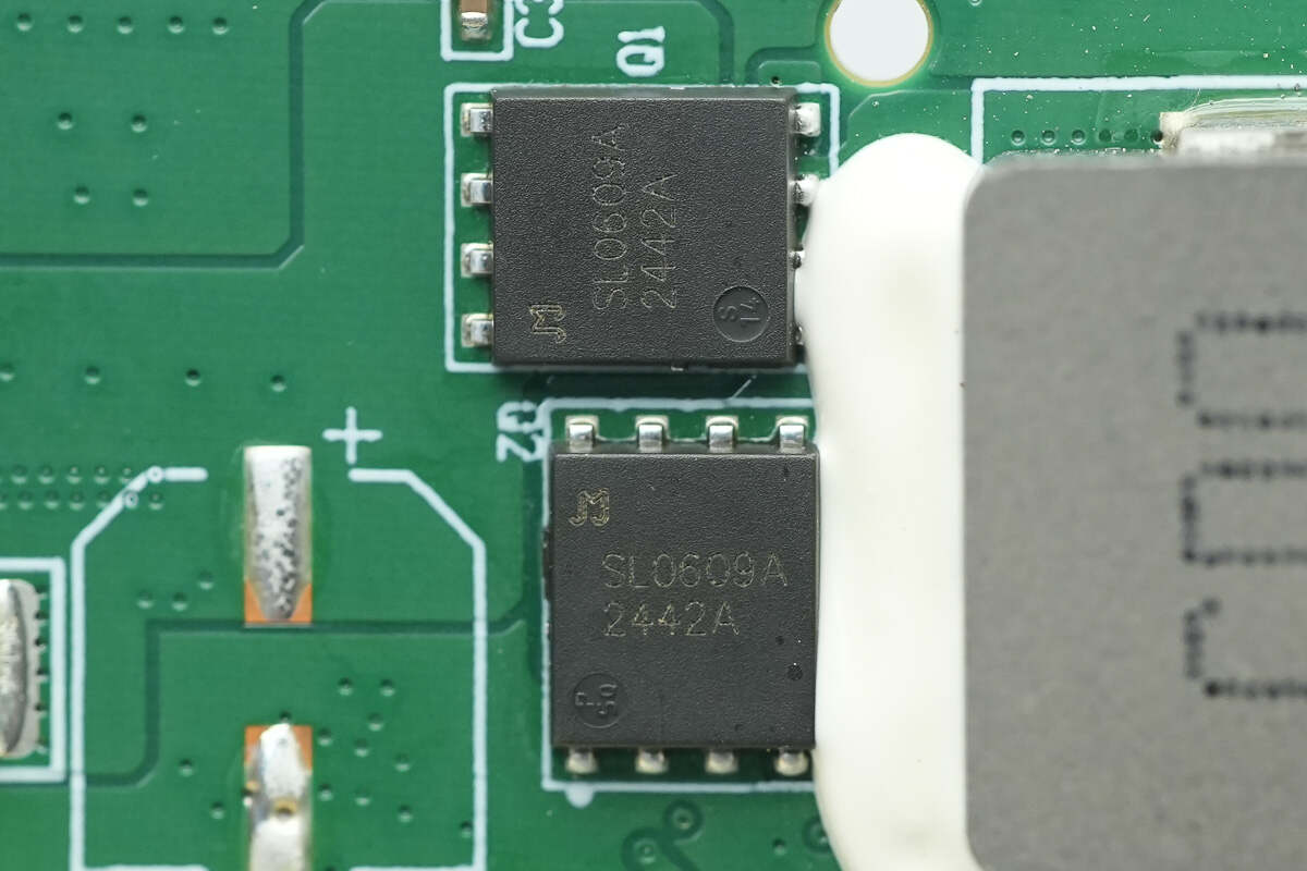

The synchronous boost MOSFETs are from JJWD, model JMSL0609AG. They are NMOS devices with a voltage rating of 60 V and an on-resistance of 5 mΩ, packaged in a PDFN 5 × 6‑8L form factor.

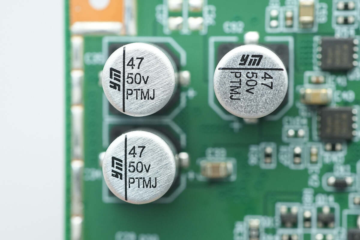

This solid capacitor is from YMIN, with a specification of 50V, 47μF.
The other three solid capacitors are also from YMIN, each with the same specification of 50 V, 47 μF.

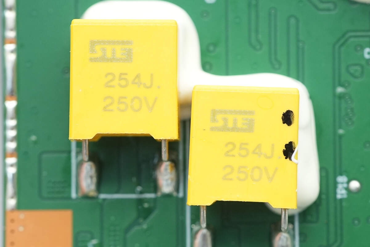

The two resonant capacitors are from STE, each with a specification of 0.25 μF, 250 V.

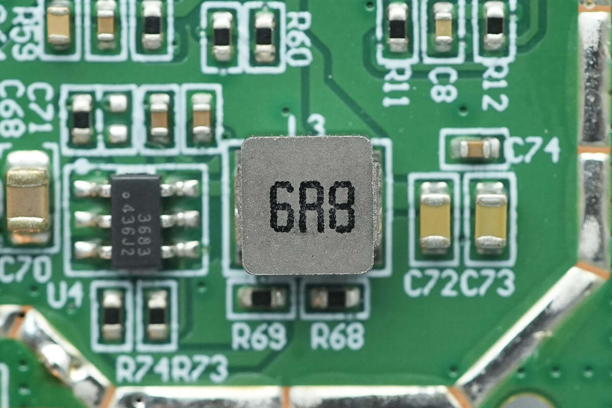

The synchronous buck converter used to step down the voltage for the fan is marked with 3683 and comes in an SOT23-6 package.
Close-up of the paired 6.8 μH buck inductor.

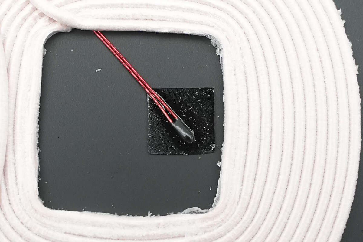

Close-up of the thermistor.
Close-up of another thermistor.

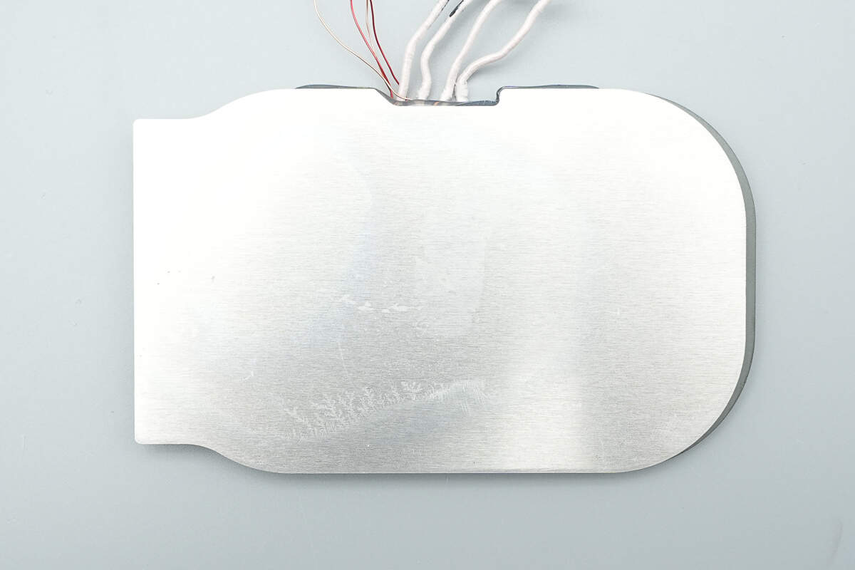

A metal heat sink is installed on the back of the coil.

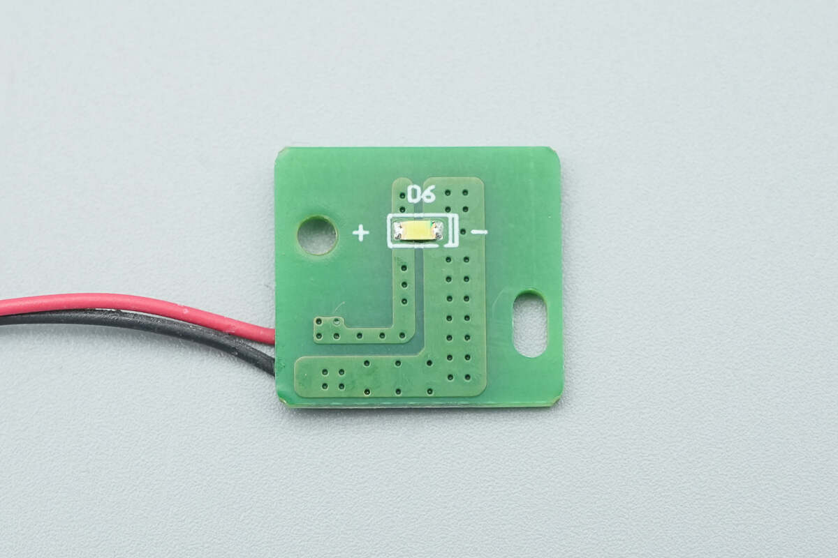

Close-up of the LED indicator PCB.
