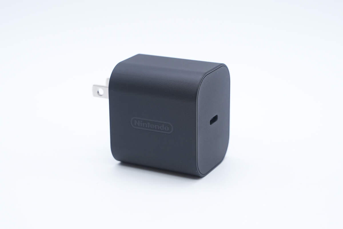

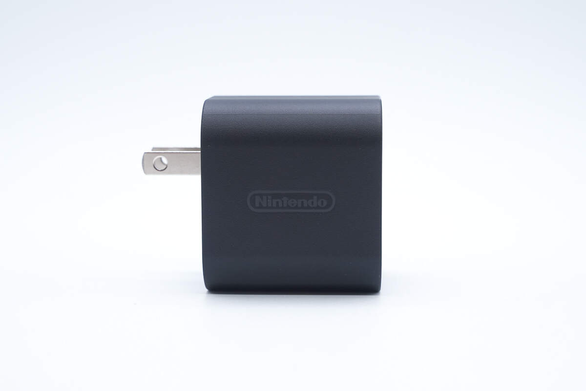

Nintendo is printed on the front of the charger.
Teardown of Nintendo Switch 2 Original 60W PD Fast Charger (Japan Version)-Chargerlab

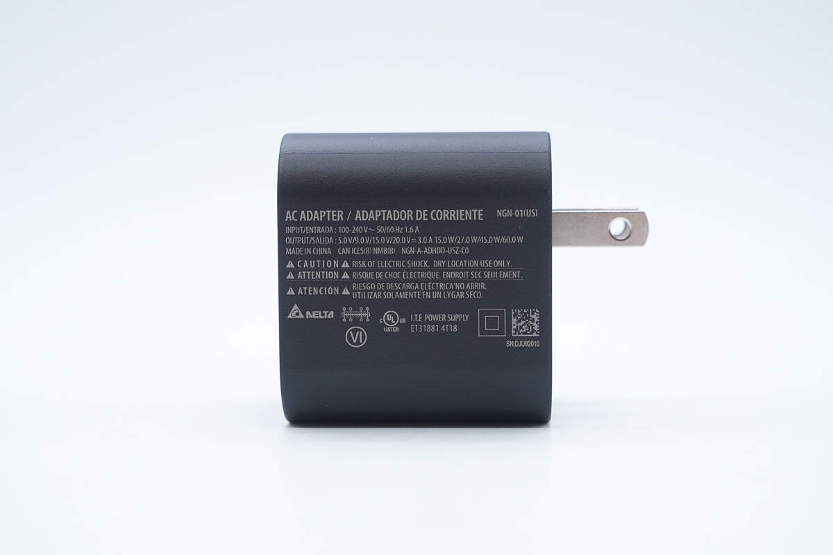

The back of the charger displays the technical specifications.
Input: 100-240V~50/60Hz 1.6A
Output: 5/9/15/20V 3A, 60W Max
Manufacturer: Delta Electronics, Inc.
The charger is UL certified and meets Level VI energy efficiency standards.

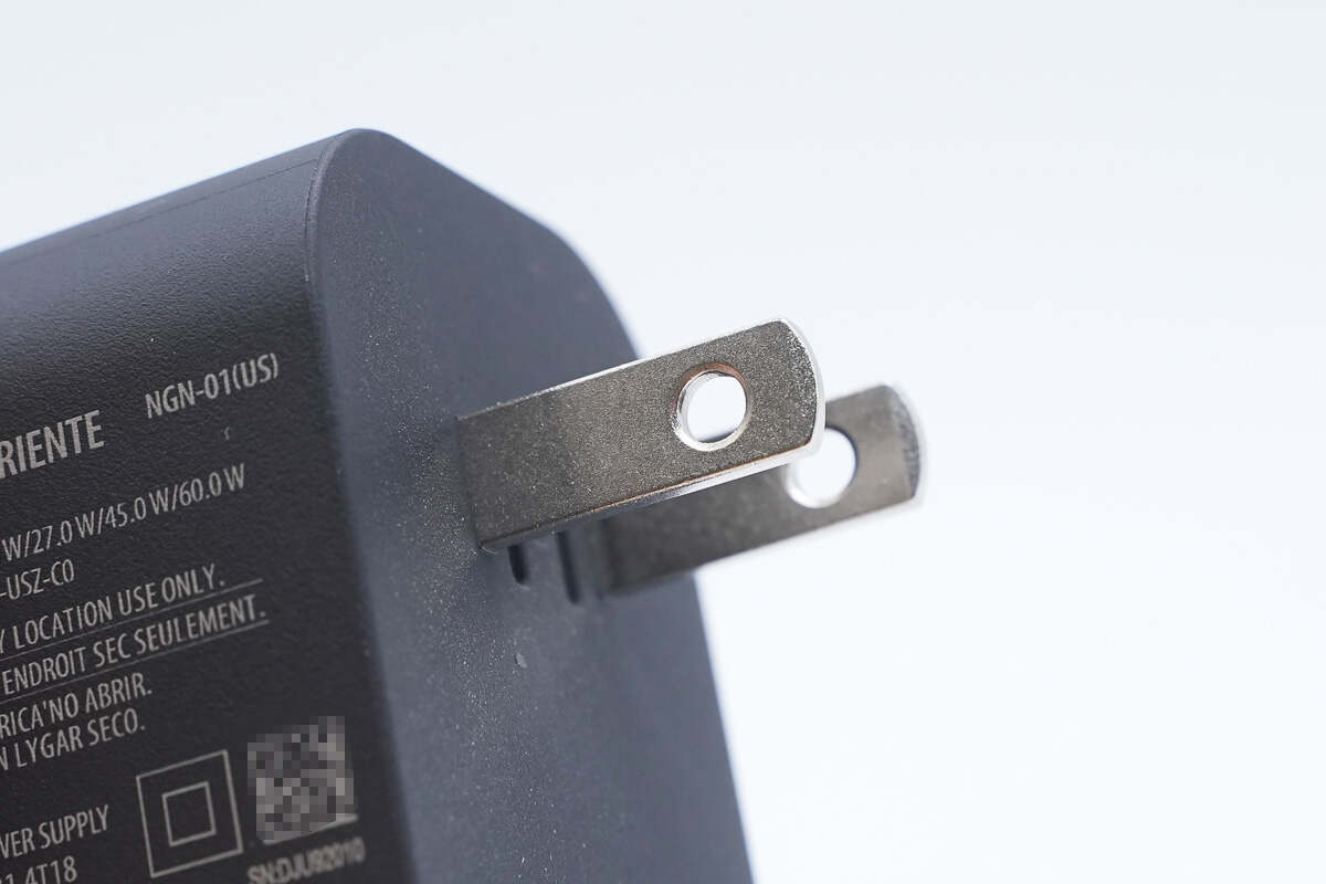

Close-up of the plug.

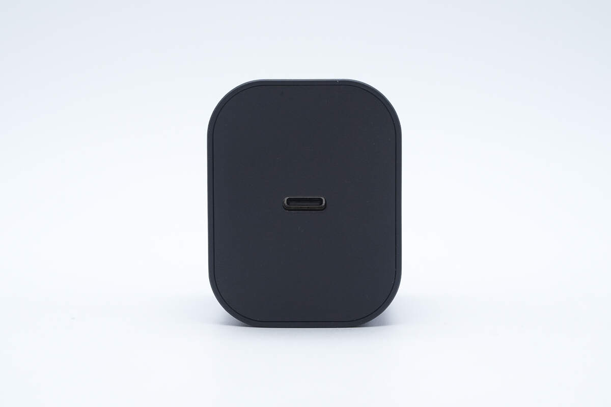

The output side features a centered USB-C port.

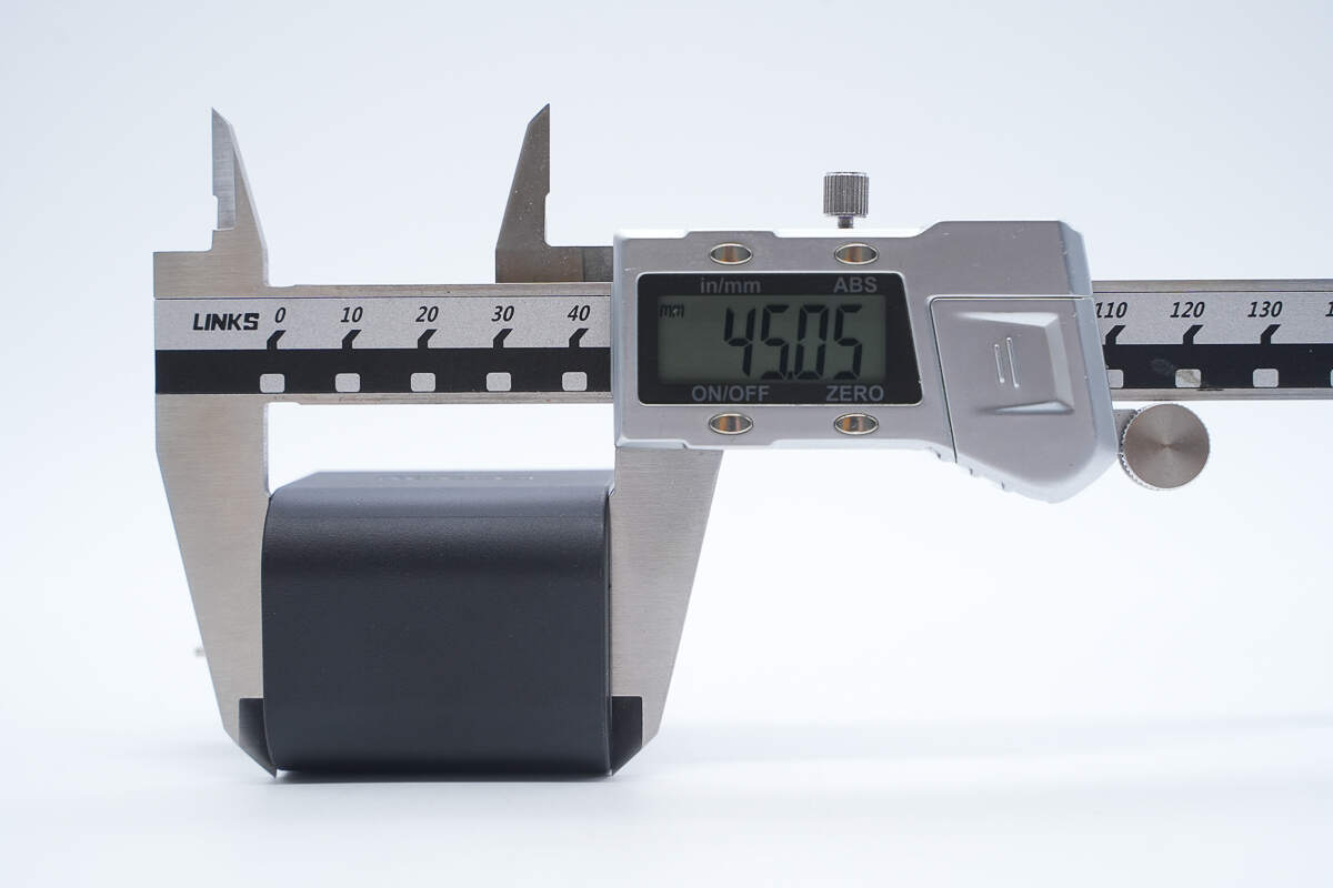

The length is about 45.05 mm (1.77 inches).

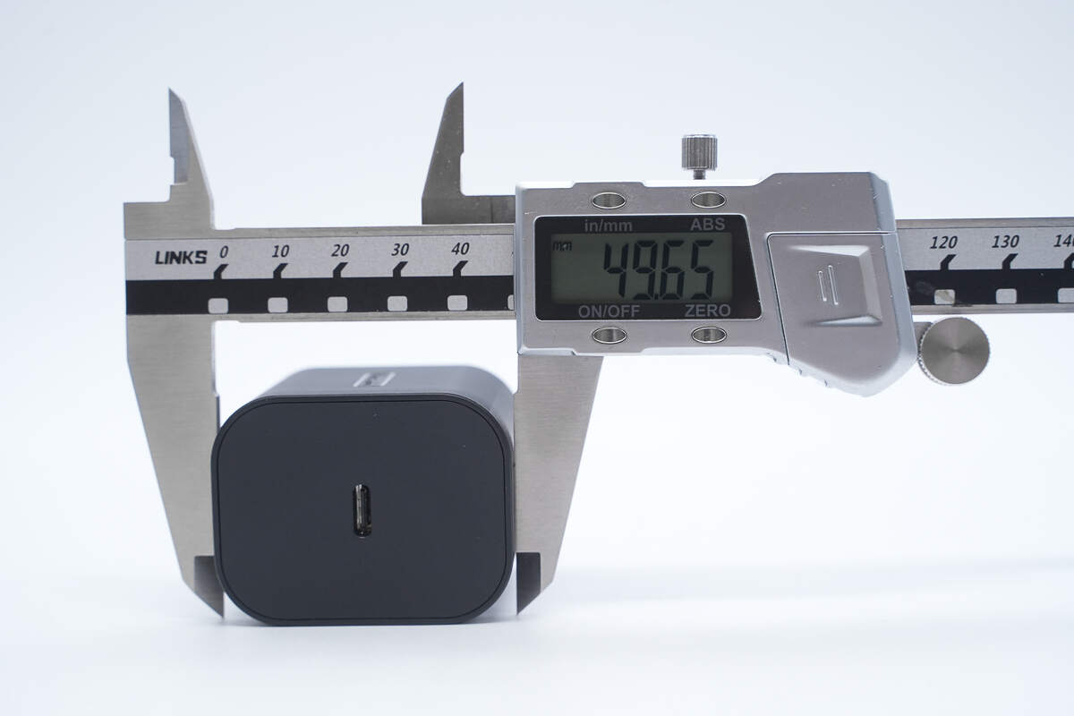

The width is about 49.65 mm (1.95 inches).

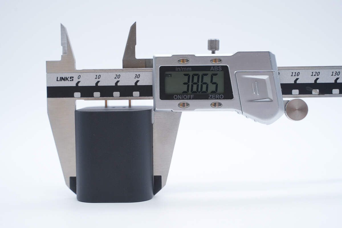

The thickness is about 38.65 mm (1.52 inches).

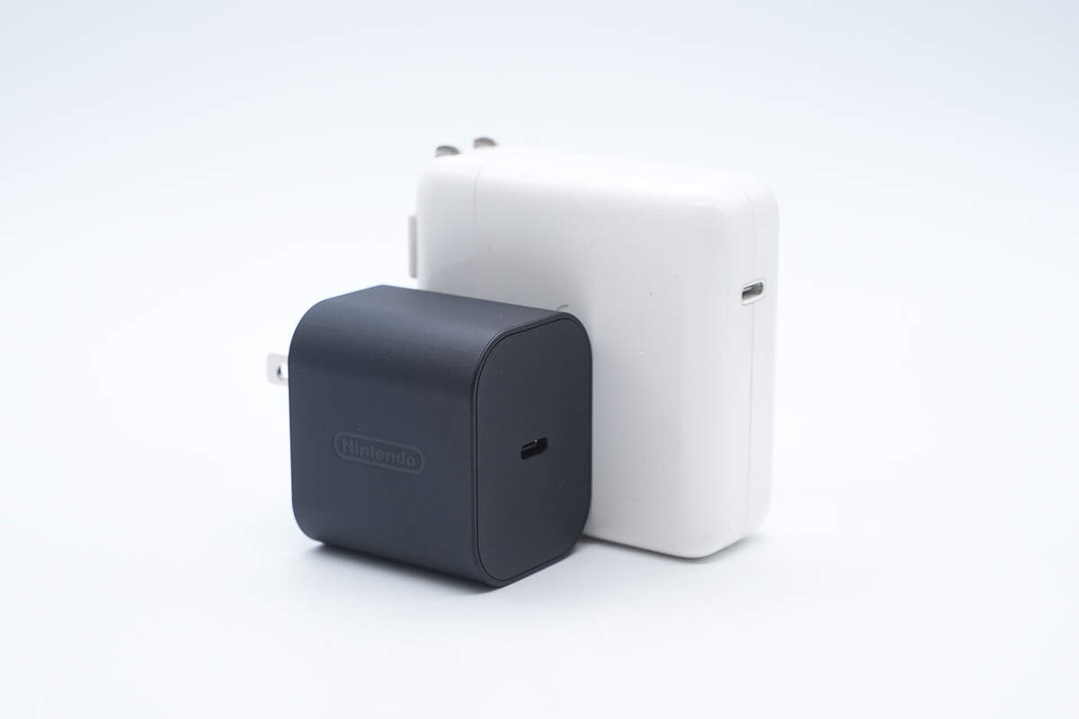

It is much smaller than the Apple 61W charger.

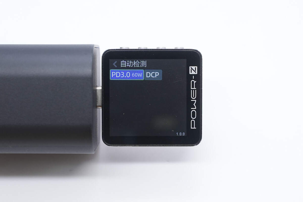

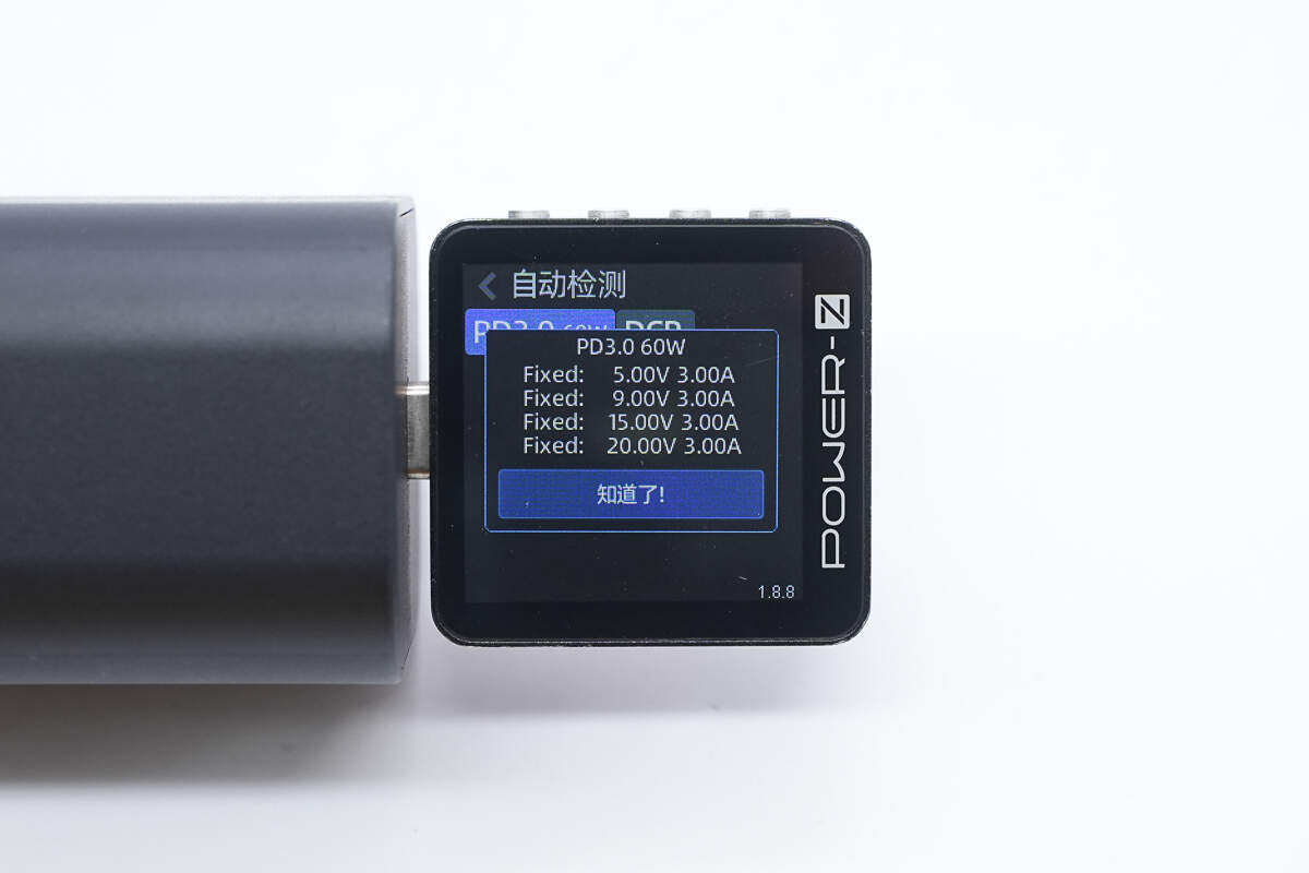

ChargerLAB POWER-Z KM003C shows it supports PD3.0 and DCP protocols.
It has four fixed PDOs of 5V3A, 9V3A, 15V3A, and 20V3A.

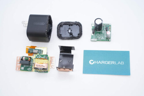

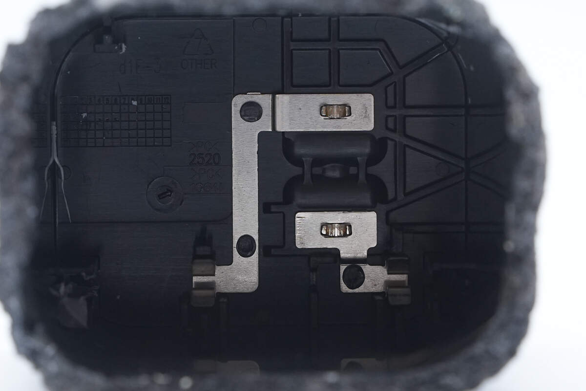

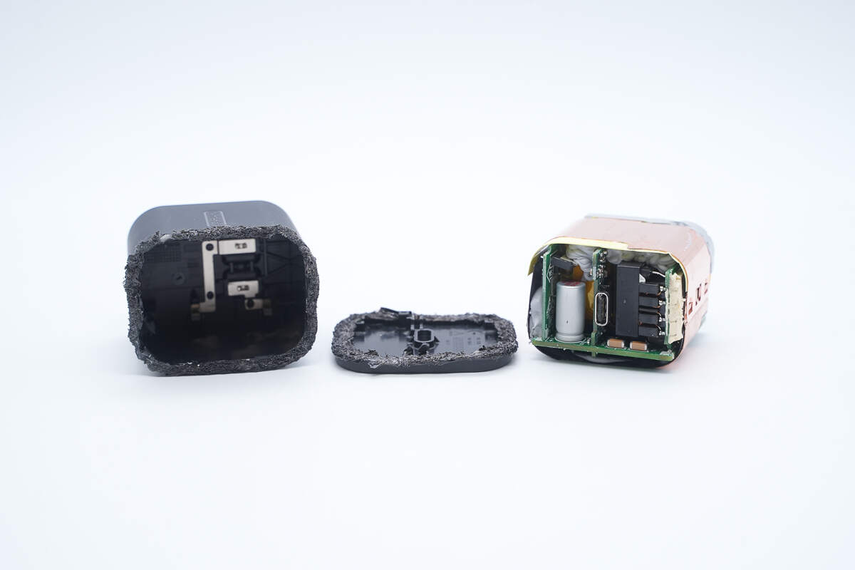

Cut open the top cover. The input uses a contact-based power connection design.
The metal spring clips are crimped onto the plug pins.

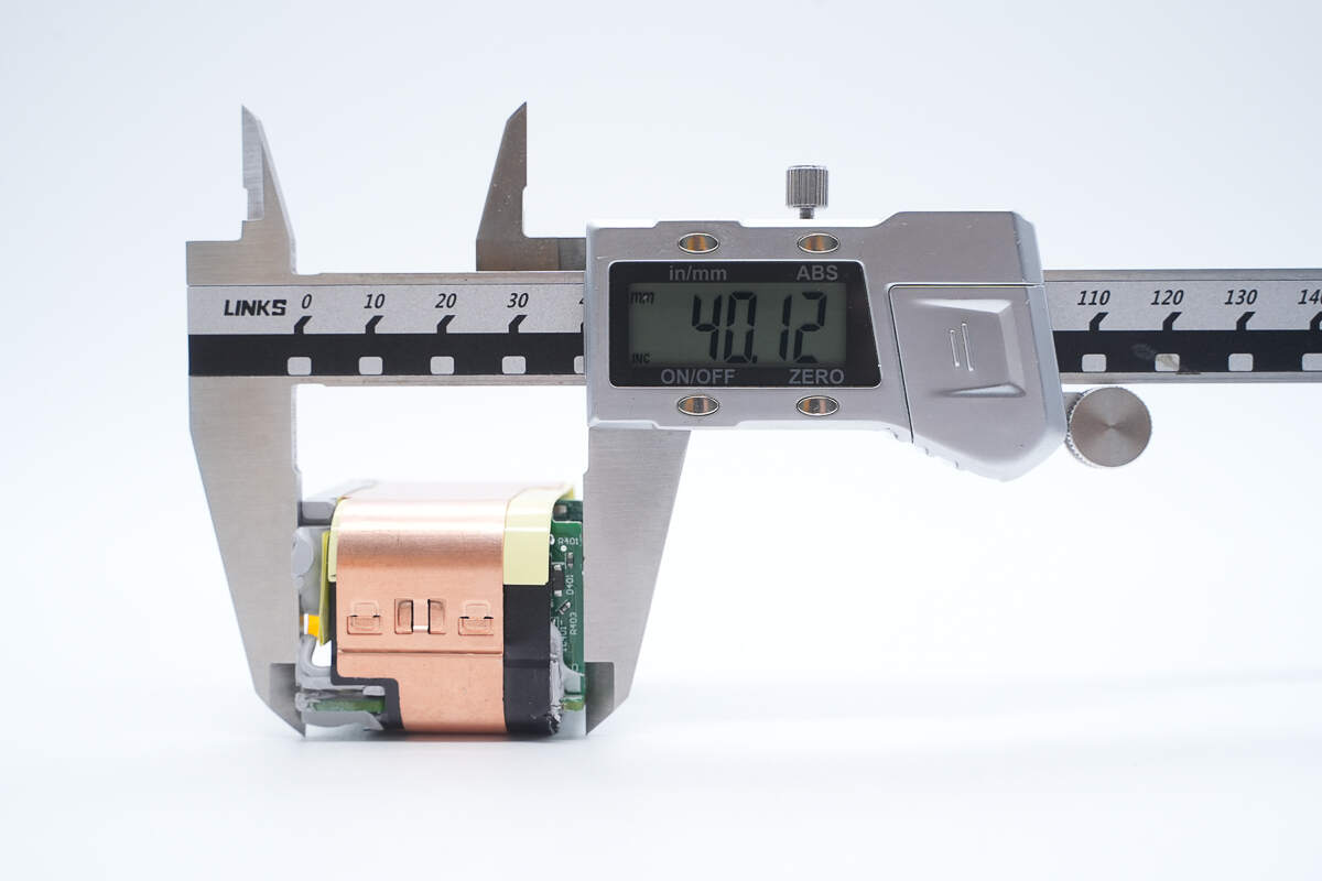

The length of the PCBA module is about 40.12 mm (1.58 inches).

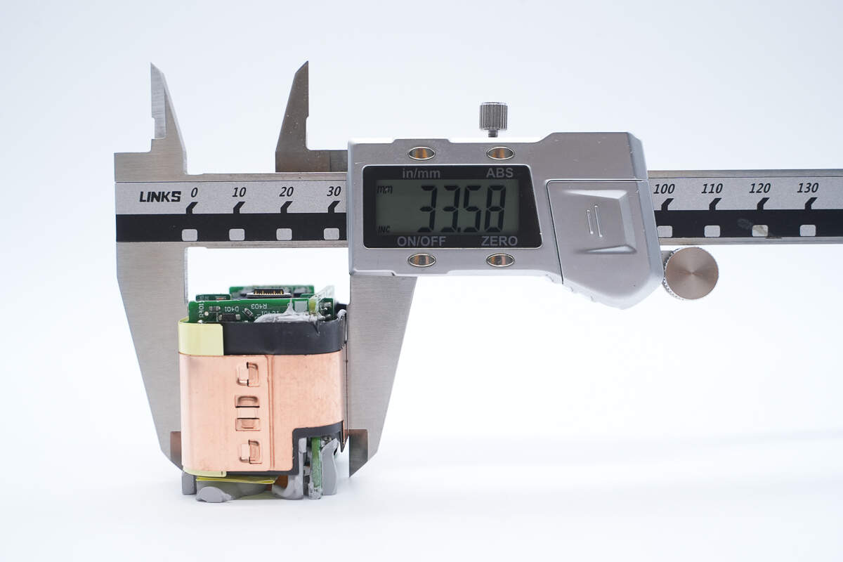

The thickness is about 33.58 mm (1.32 inches).

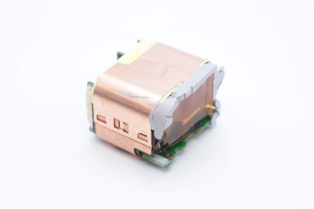

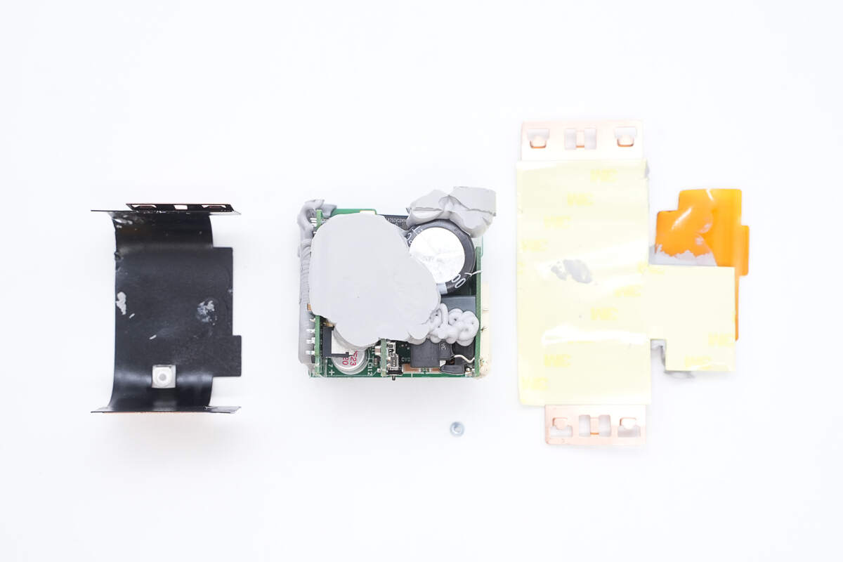

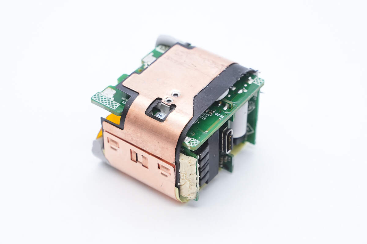

The PCBA module is wrapped in a copper heat sink and secured with a snap-on structure. The input end is glued, and a high-temperature-resistant insulation sheet is attached.
The copper heat sink is also fixed with screws and has Mylar sheets on the inside for insulation.
Remove the heat sink, and you'll find insulation tape applied to the inner side.

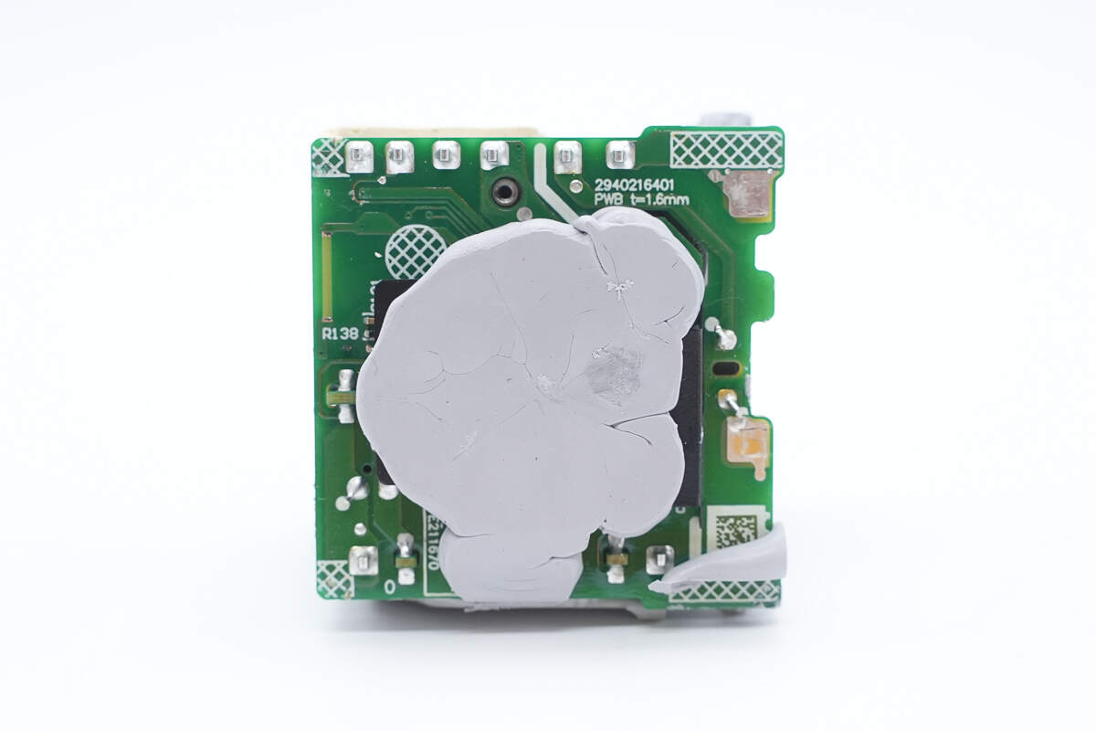

Thermal compound is applied to the PCBA module, and a thermal pad is attached to the small PCB on the side.
The back side is also filled with thermal compound, and a Mylar sheet is placed in the cutout between the primary and secondary sides for isolation.

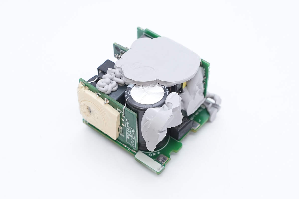

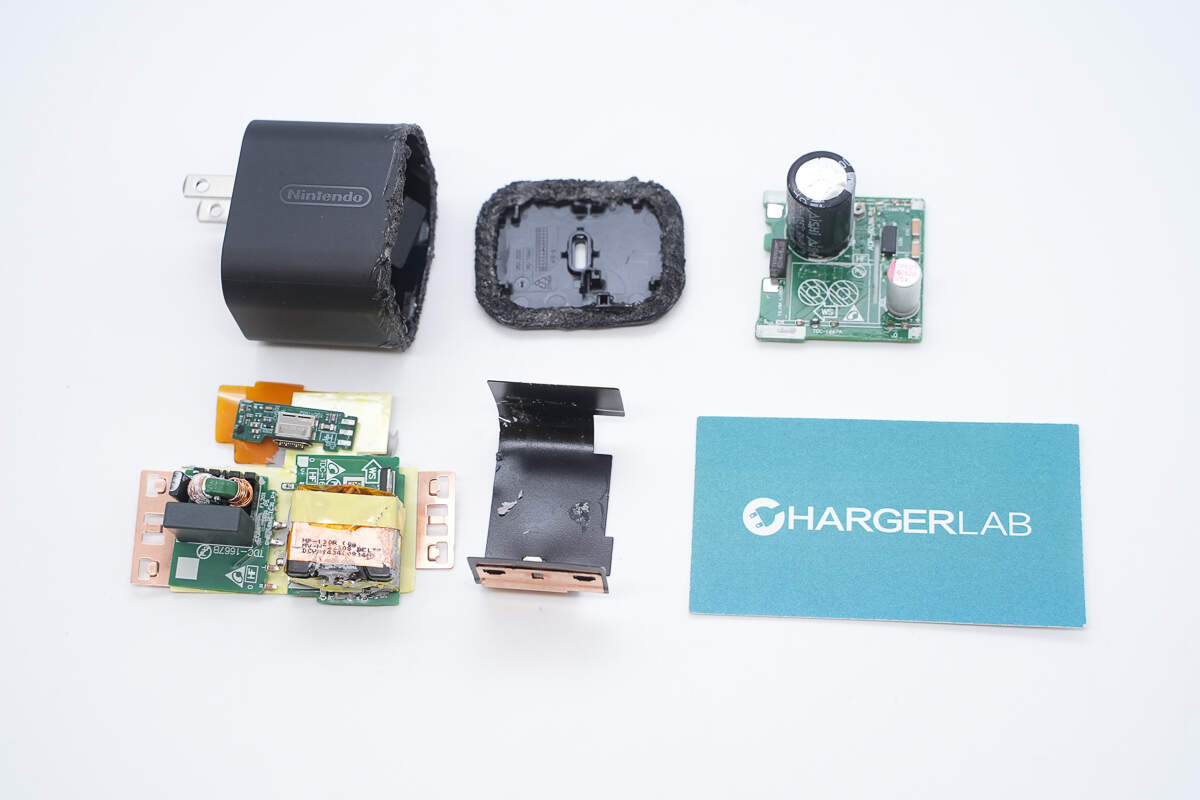

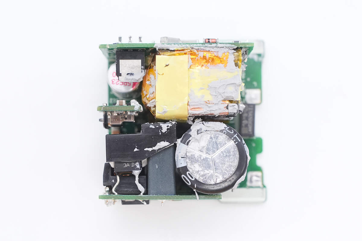

After removing the thermal compound, multiple stacked PCBs can be seen in the module, making efficient use of the internal space.

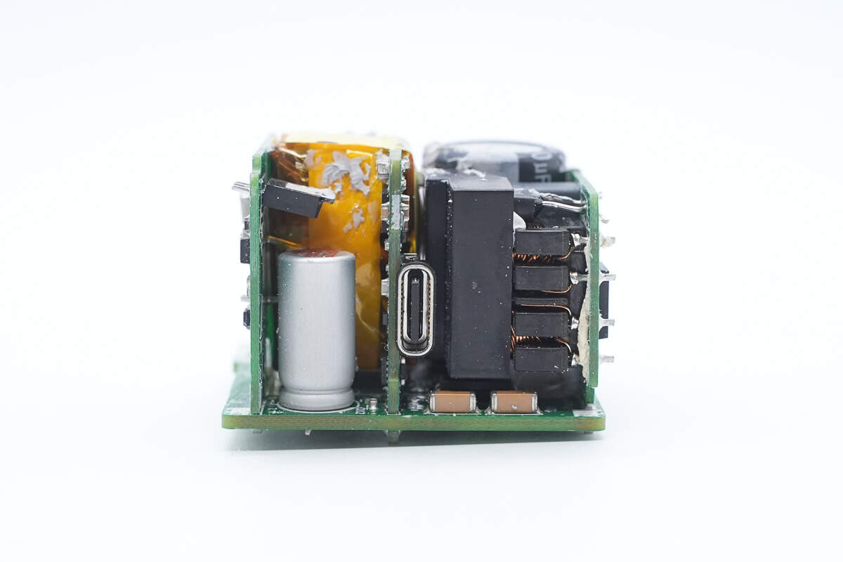

The area between the two small PCBs houses components such as the electrolytic capacitor and the transformer. The side with the output connector features a plastic casing for insulation and isolation.

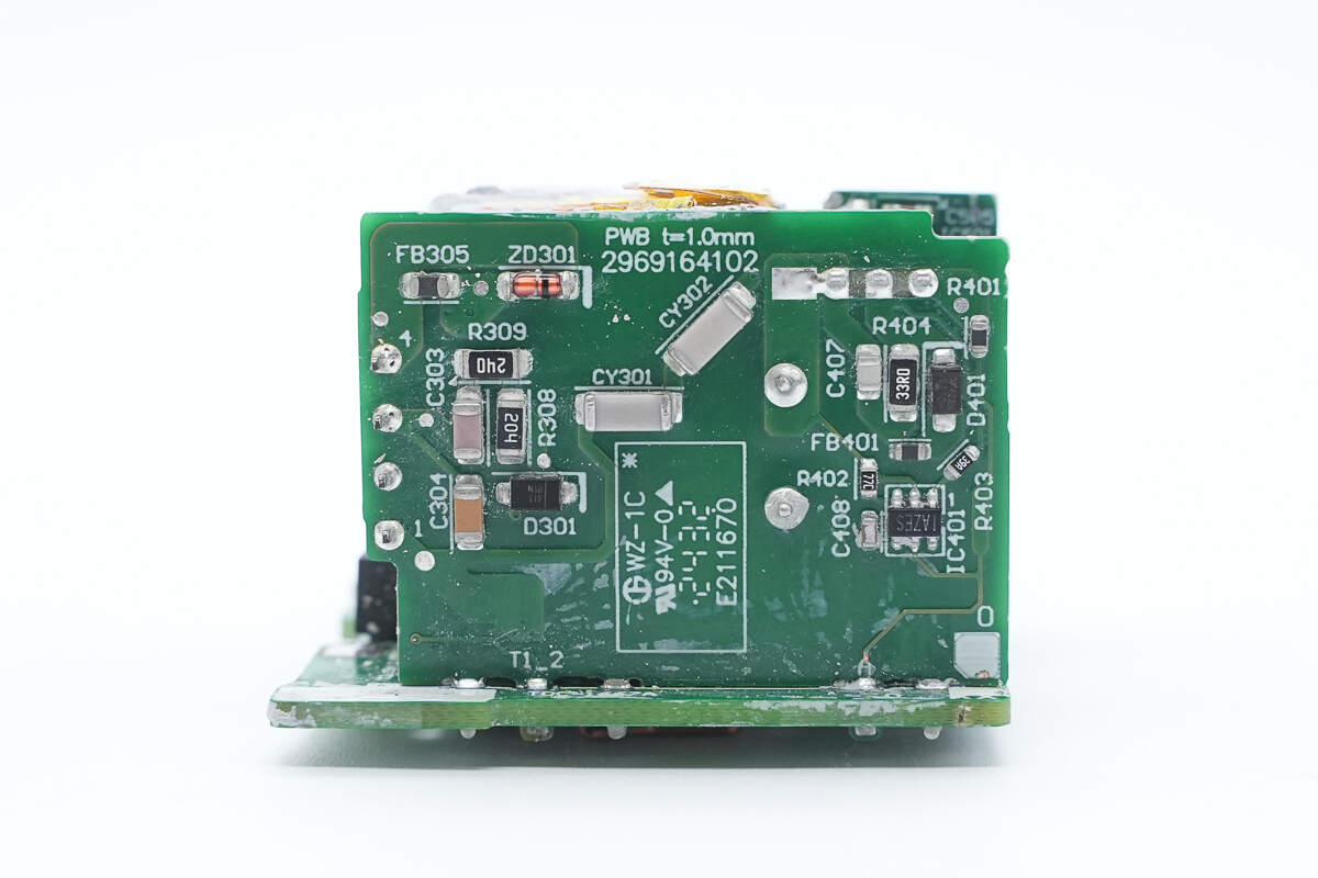

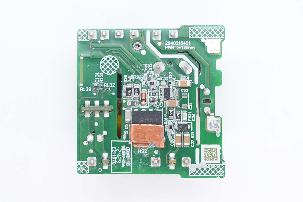

On the back side, the primary controller chip and primary MOSFET are located, with the MOSFET covered by a copper heatsink.

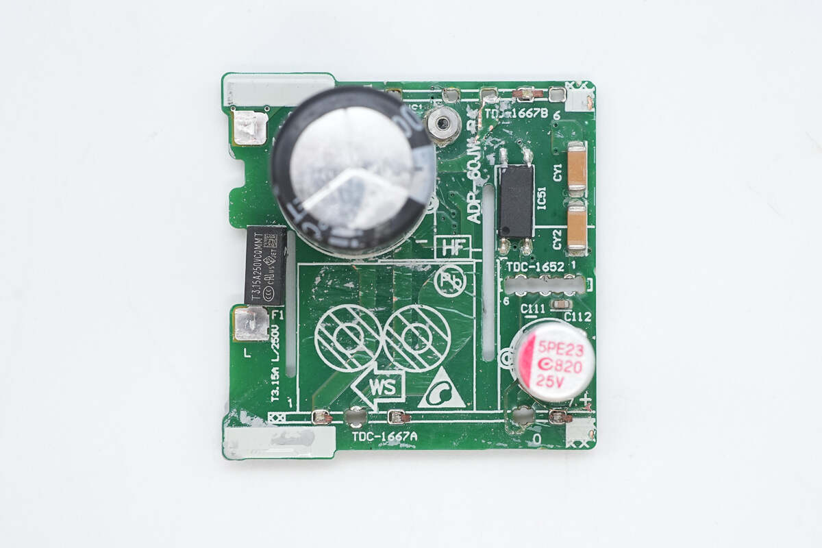

The input side includes a time-delay fuse and a high-voltage filtering electrolytic capacitor.

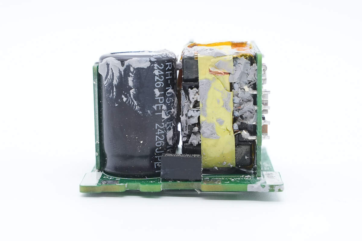

Remove the plastic casing. White adhesive is applied to the components.

The time-delay fuse is rated at 3.15A 250V.

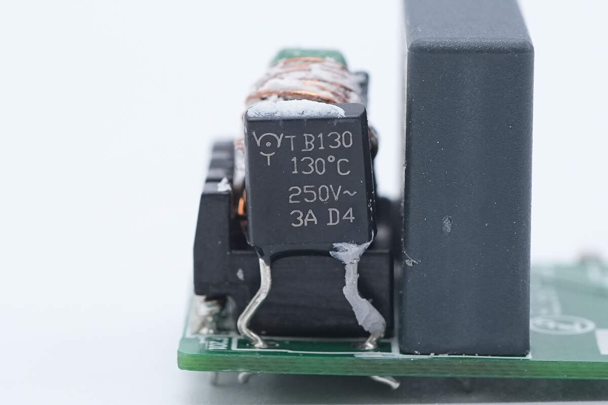

The thermal fuse is manufactured by WalterFuse.

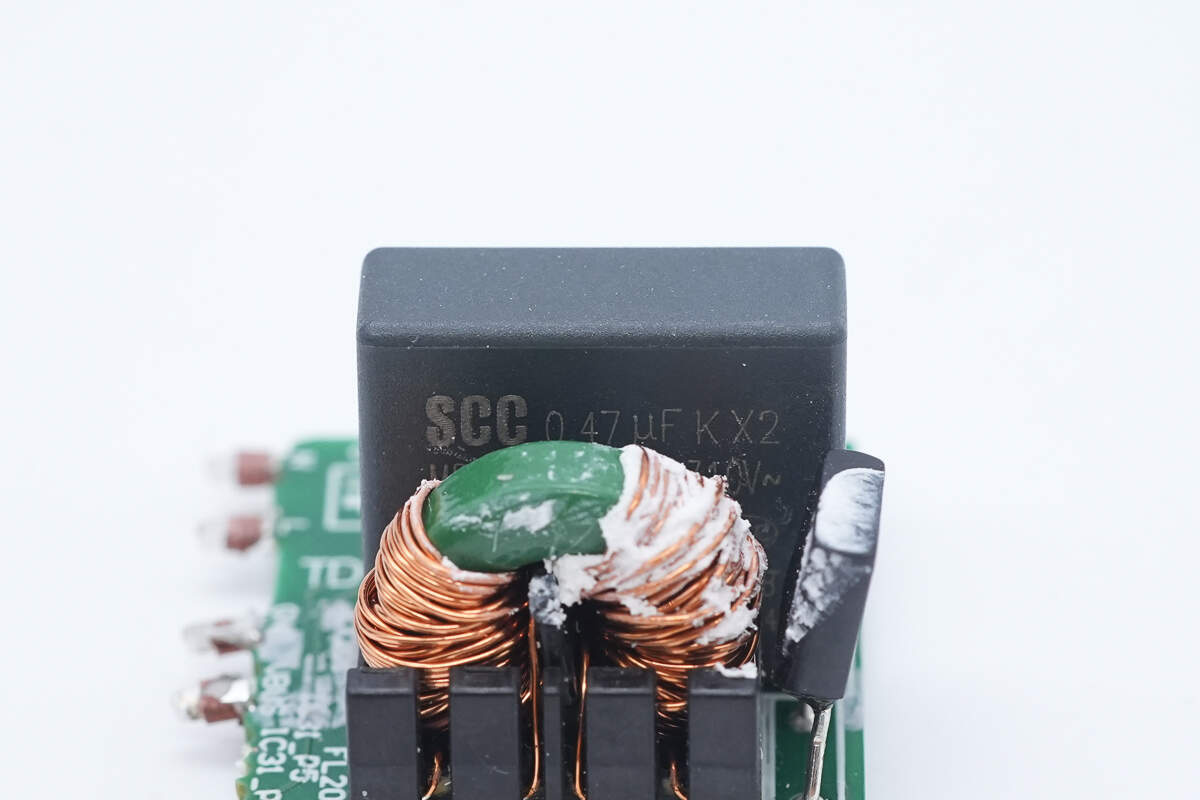

The safety X2 capacitor is from SCC, with a specification of 0.47μF.

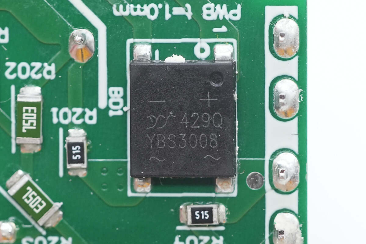

The bridge rectifier is from YJ, model YBS3008, rated at 3A 800V, and uses a YBS package.

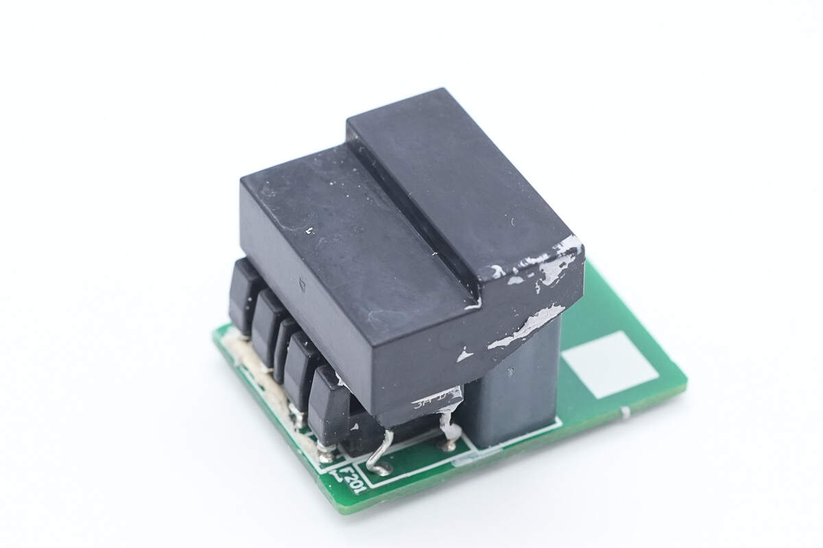

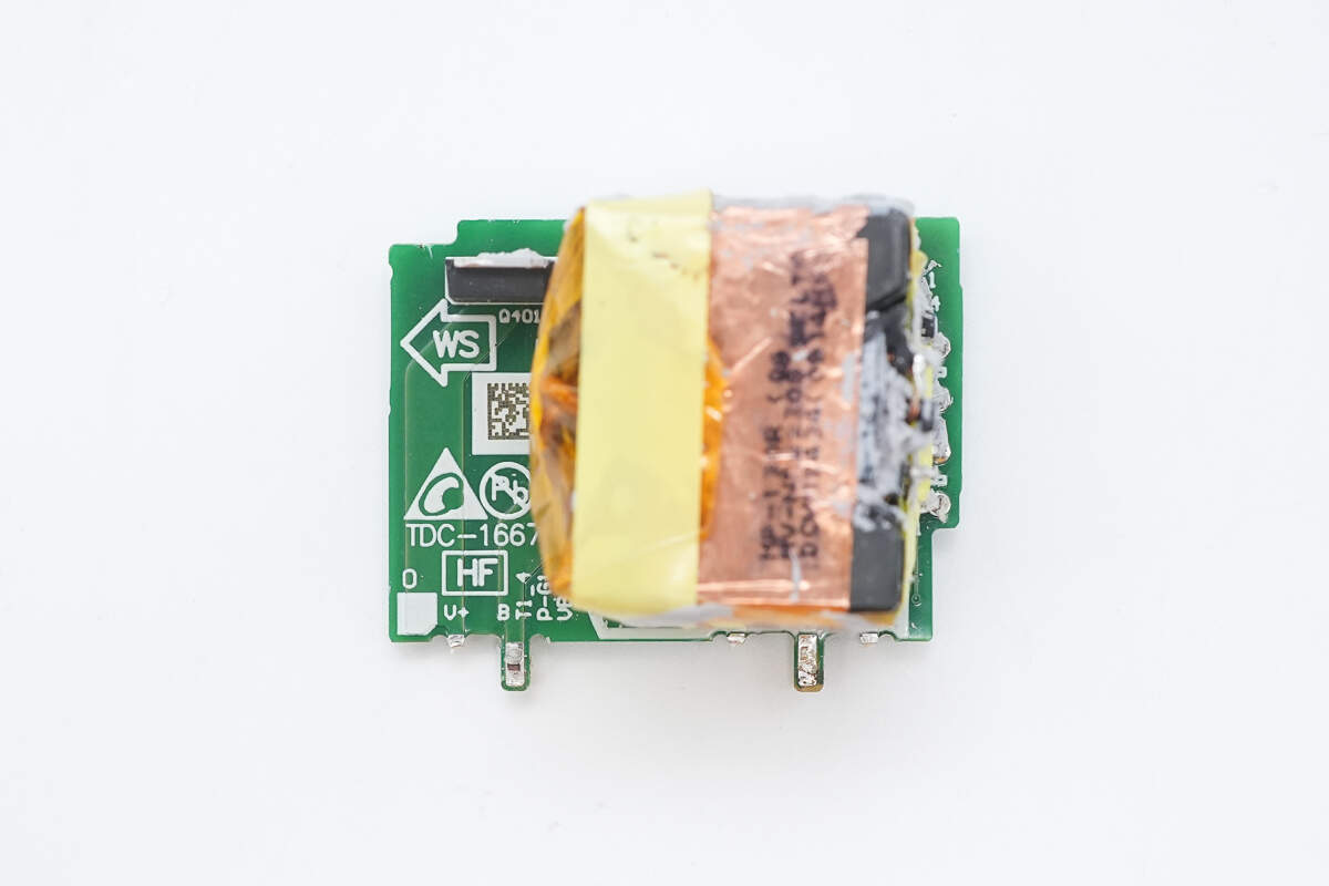

Remove the small PCB. On the other side, there is a transformer and a synchronous rectifier.

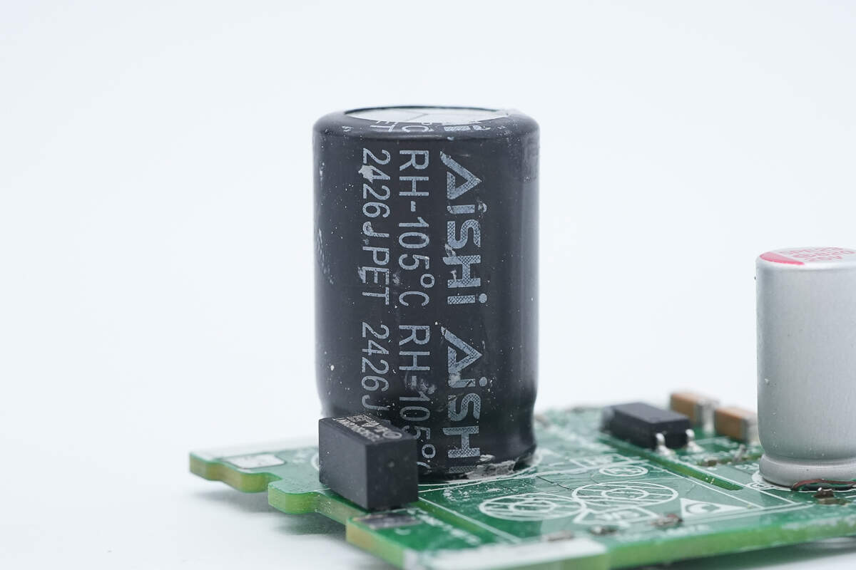

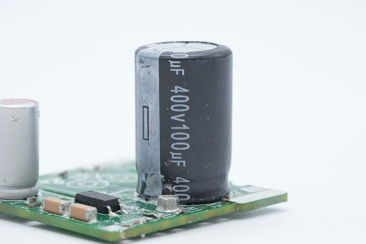

The electrolytic capacitor is from AiSHi.
It is rated at 400V 100μF.

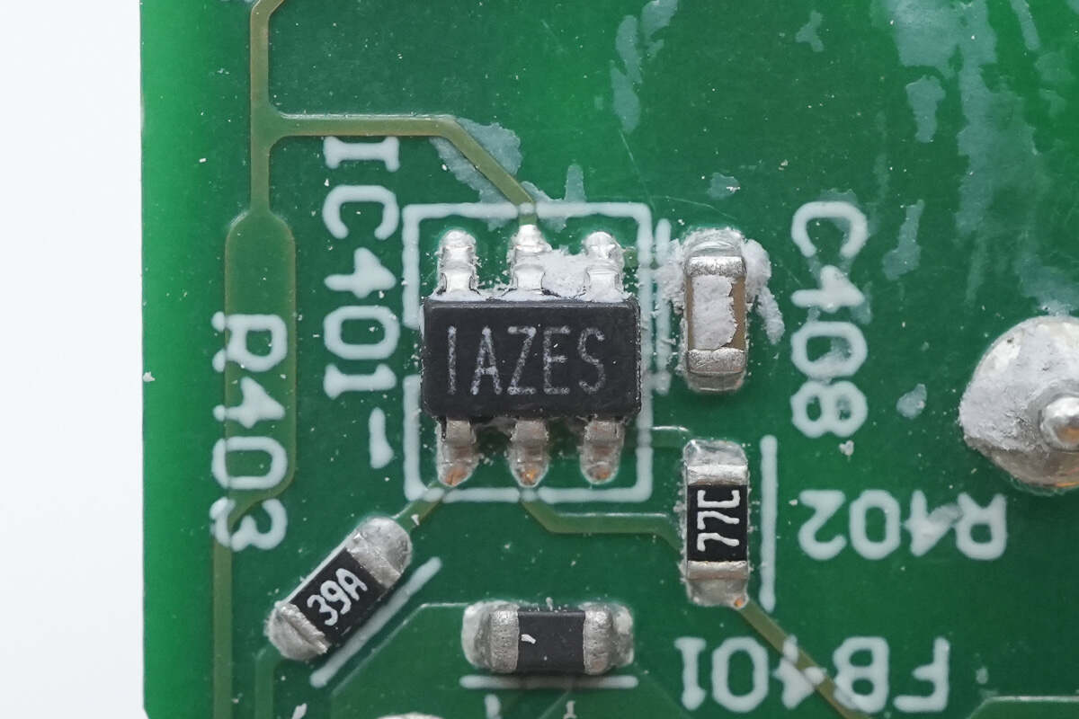

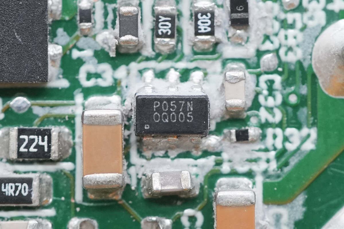

The primary controller chip is marked with P057N and comes in a SOT-23-6 package.

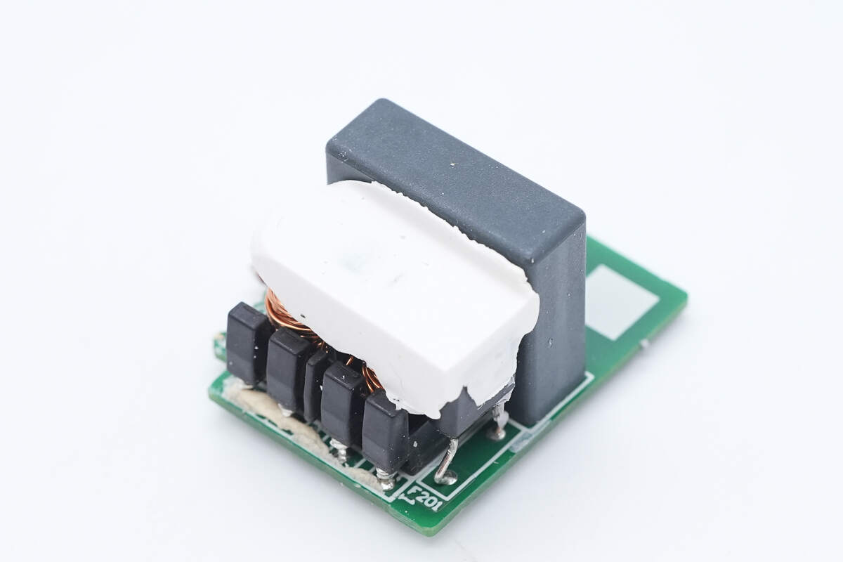

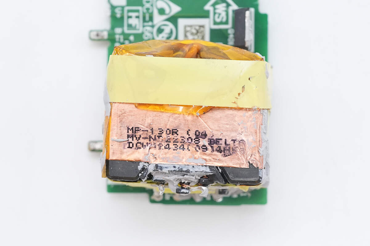

The transformer is wrapped with copper foil and insulation tape.

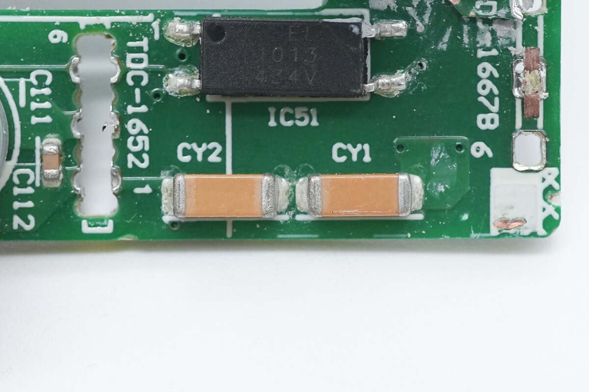

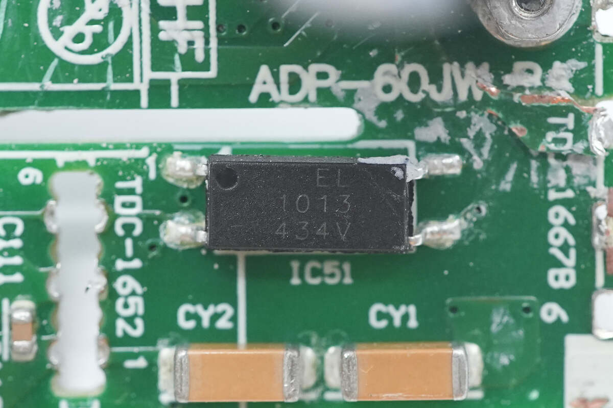

The Everlight EL1013 optocoupler is used for output voltage feedback.
Two SMD Y capacitors are connected in series to increase the voltage rating.

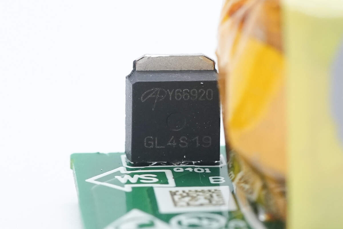

The synchronous rectifier is from AOS, model AOY66920, rated at 100V with an on-resistance of 8.2mΩ, and comes in a TO-251B package.
Here is the information about AOS AOY66920.

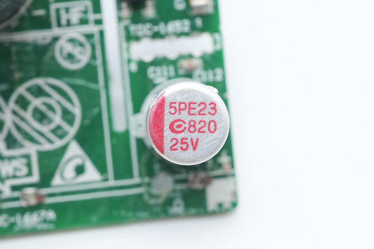

The solid capacitor for output filtering is from APAQ, rated at 25V 820μF.

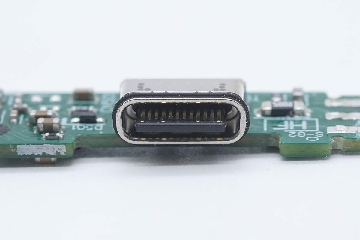

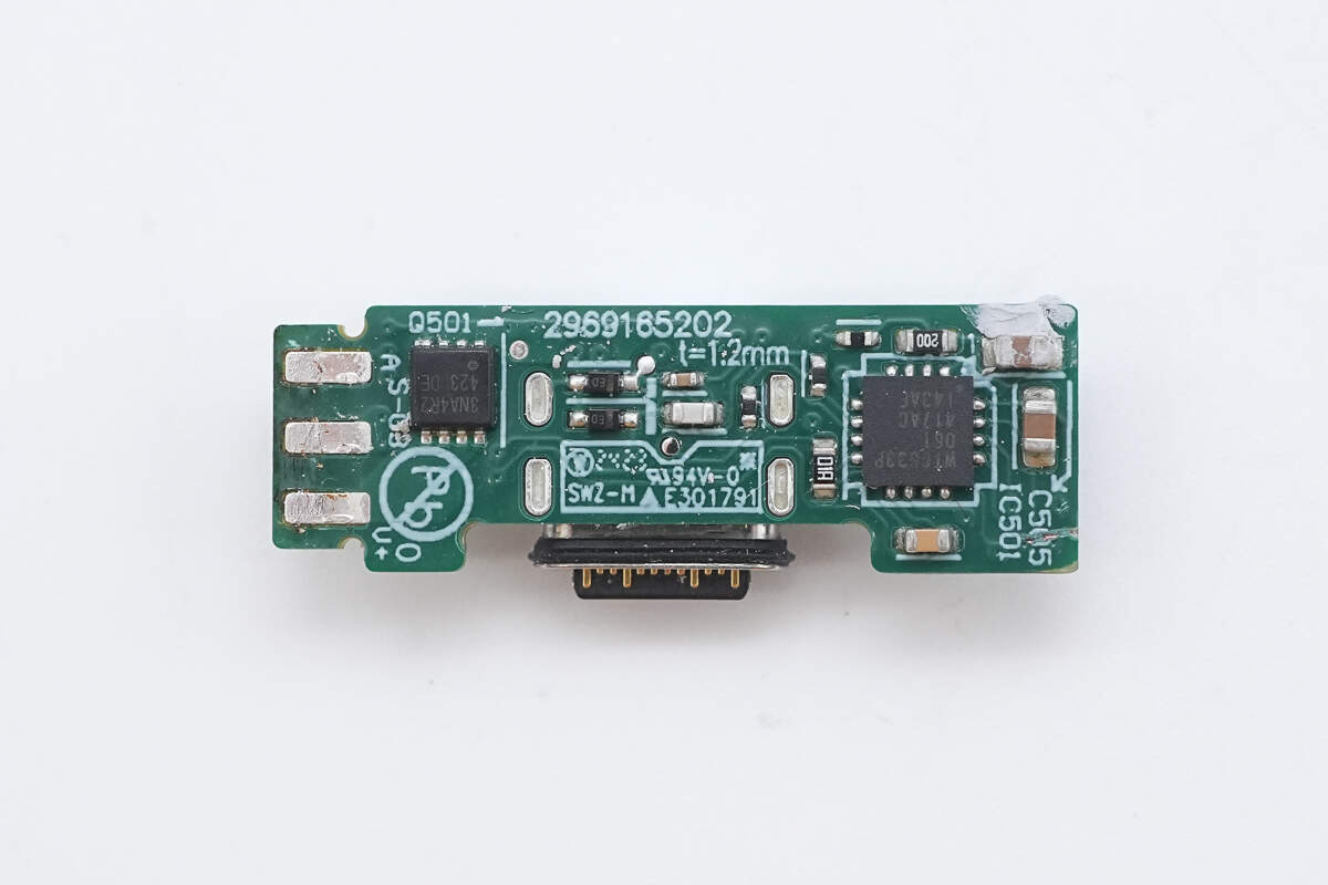

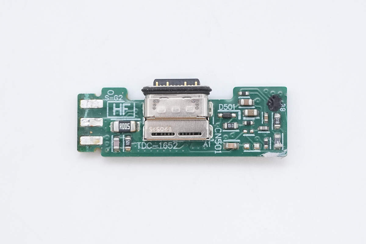

The USB-C socket PCB is soldered at the center of the output end.
The USB-C socket is soldered on the front side of the small PCB.
The back side features a protocol chip and an output VBUS MOSFET.

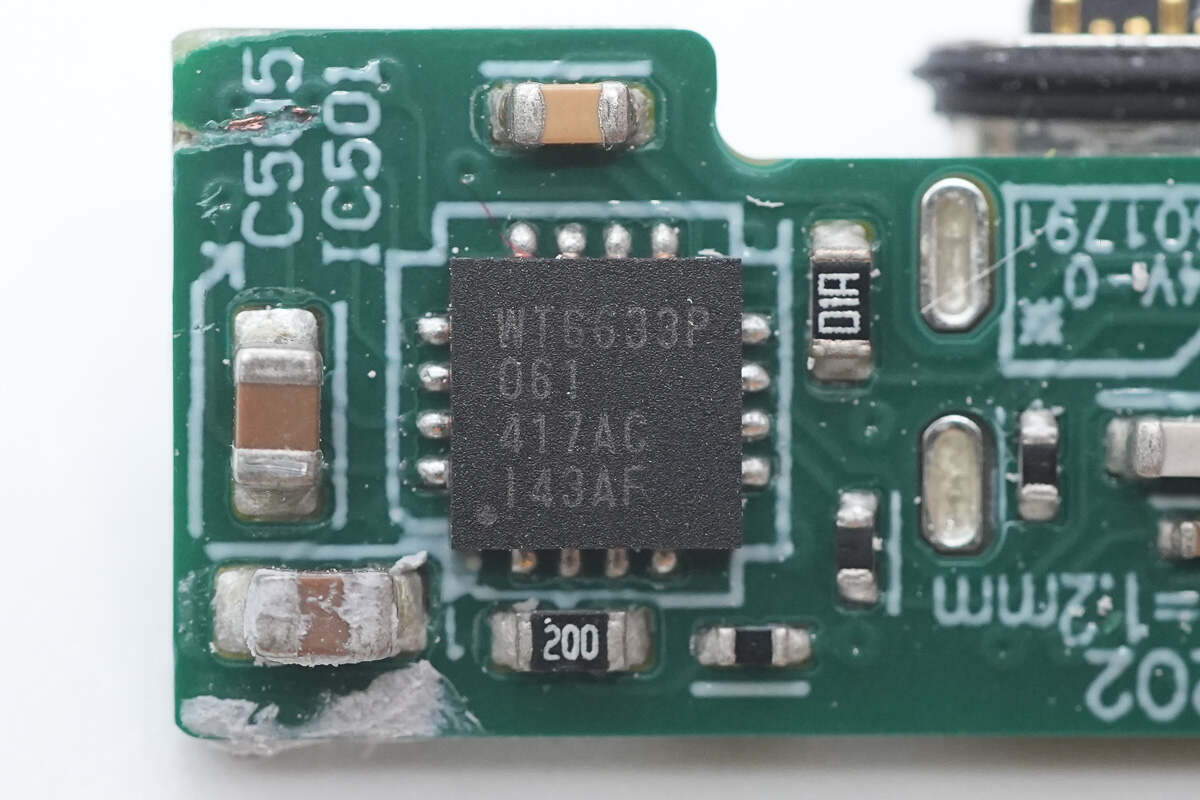

The protocol chip is from Weltrend, model WT6633P. It supports USB PD 3.0 as well as Qualcomm QC4, QC4+, and QC5 protocols. It is USB-IF certified with TID 1070018 and has Qualcomm QC5 certification (ID 4789627043-2) and QC4+ certification (ID 4788566324-2). The chip features a built-in 8051 core, integrated constant voltage and constant current control, output current sensing, line loss compensation, and comprehensive protection functions.
The output VBUS MOSFET is from APEC, model AP3NA4R2YT. It is an N-channel MOSFET rated at 30V with an on-resistance of 4.2mΩ, housed in a PMP3×3 package.
The USB-C socket is reinforced with a steel shell.
