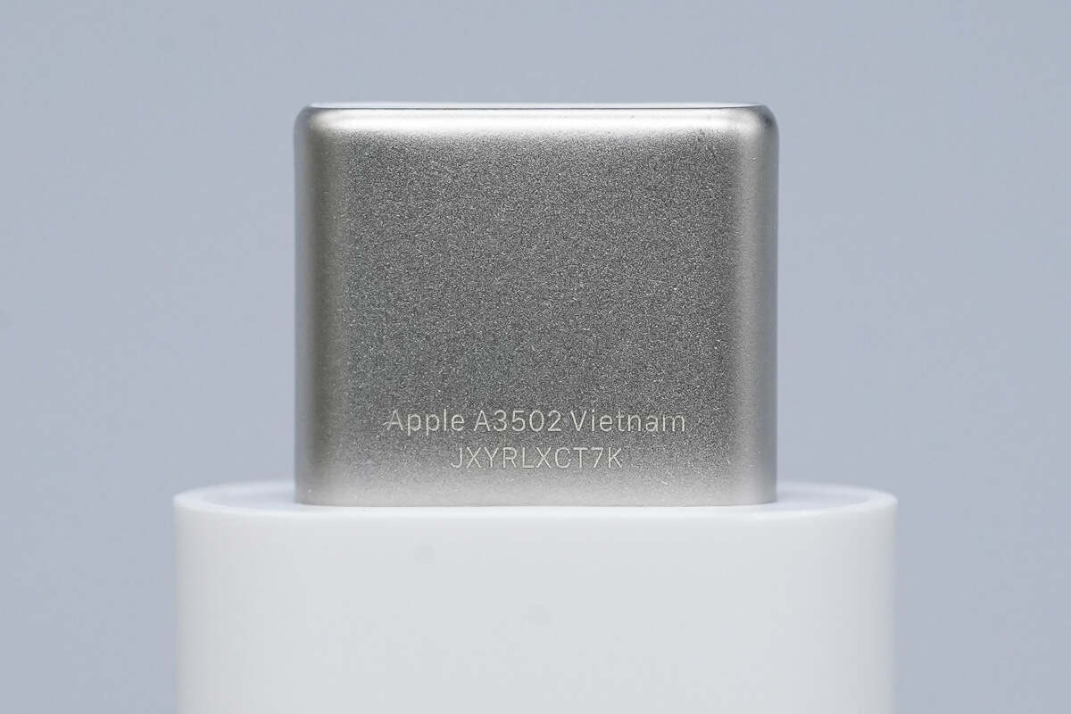

The other side of the plug is printed with the model number and serial number. The casing bears the RCM, R-NZ, and VCCI certification marks.
Teardown of Apple 25W Qi2.2 + MagSafe Charger A3502 (HK Version)-Chargerlab
Close-up of the model number, country of manufacture, and serial number information.

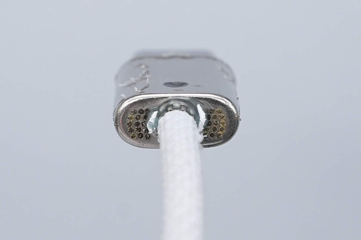

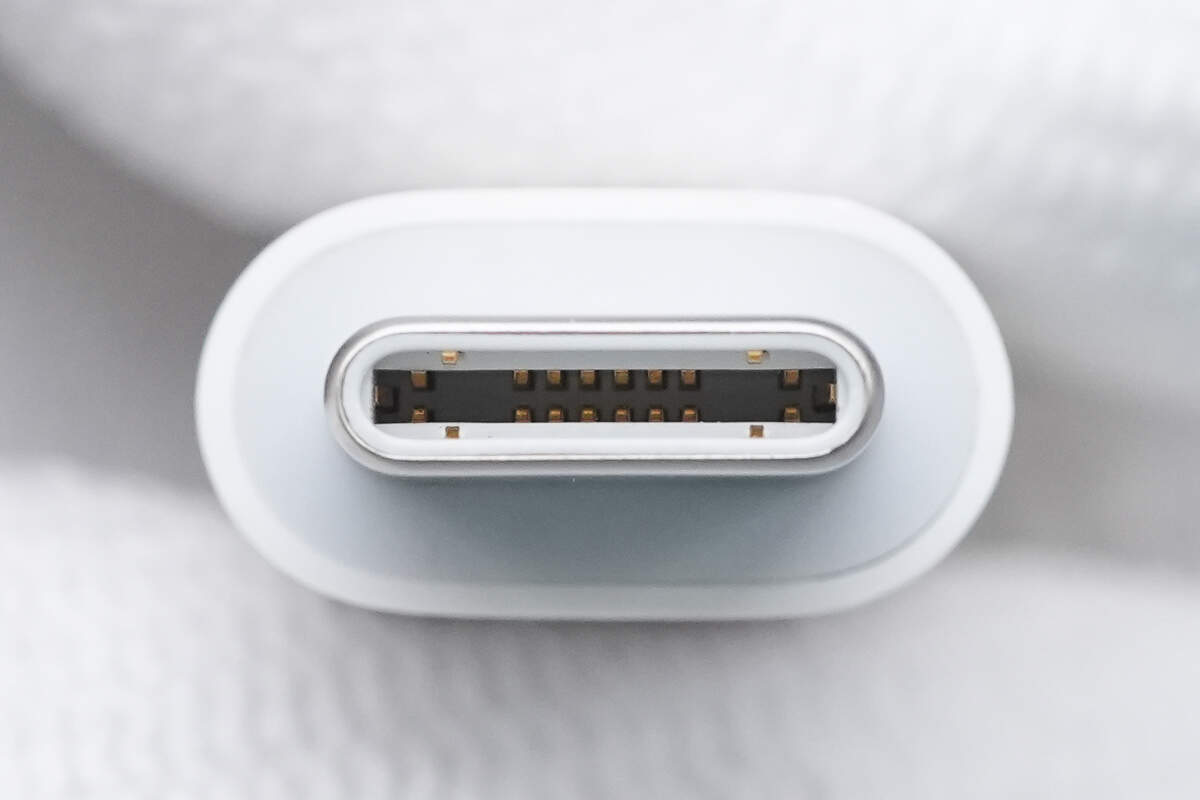

The USB-C connector’s internal pins are gold-plated and feature a non-full pin design.

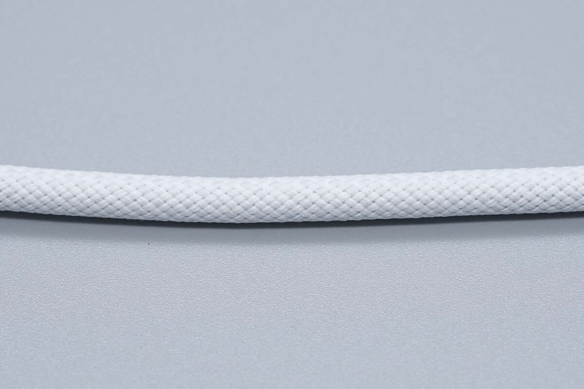

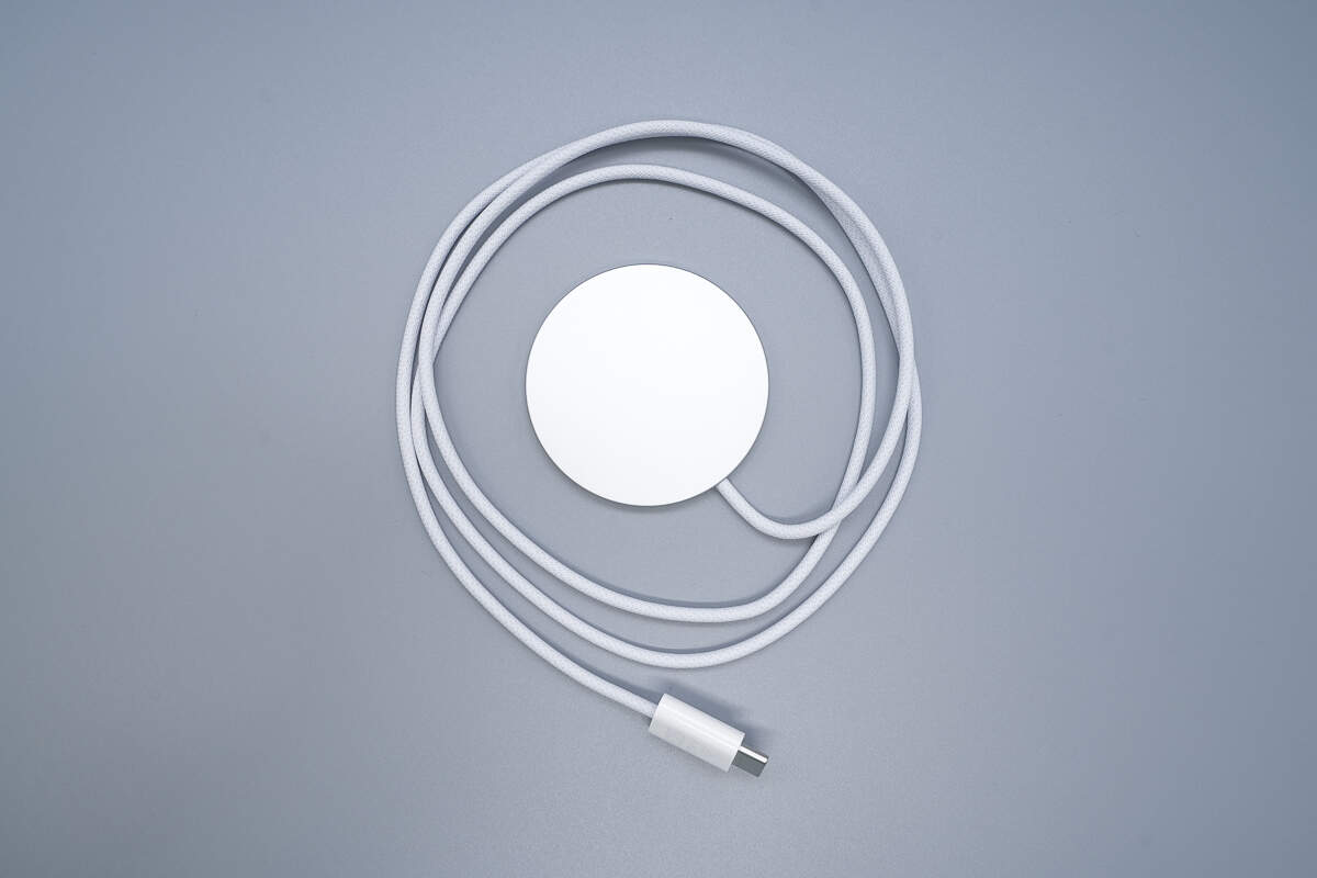

The charger uses a braided cable.
The total length of it is about 110.5 cm (43.5 inches).

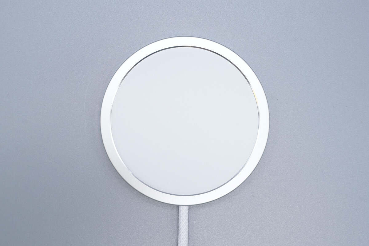

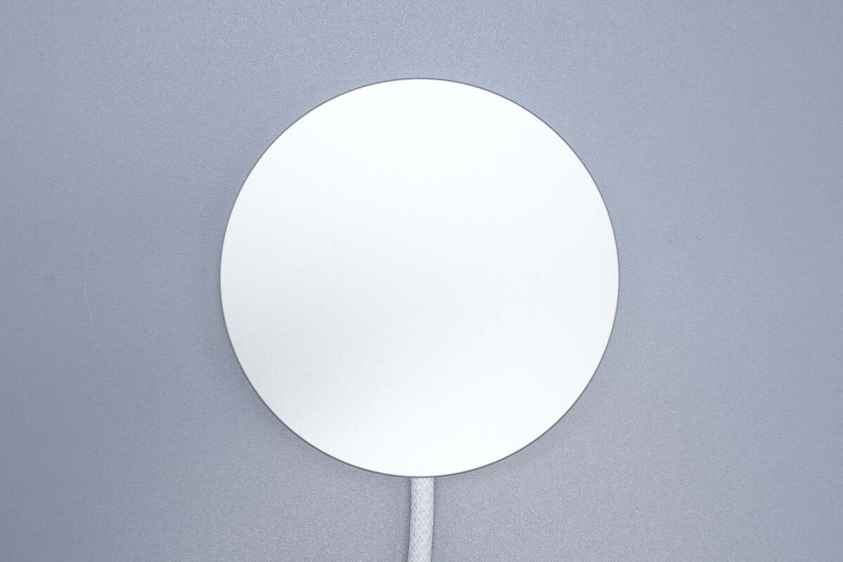

The outer ring is made of aluminum alloy. The center is made of plastic with a smooth, skin-like texture.

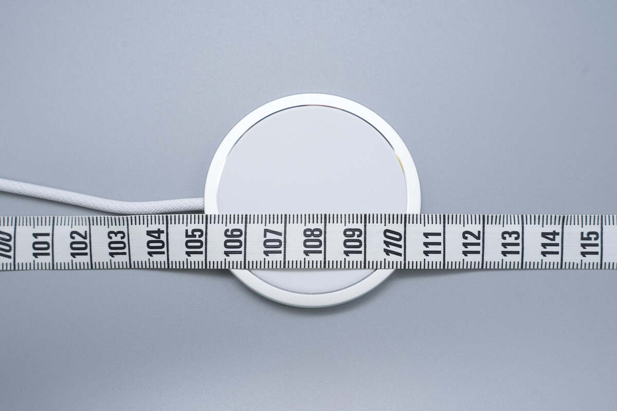

Close-up of the printing on the other side.

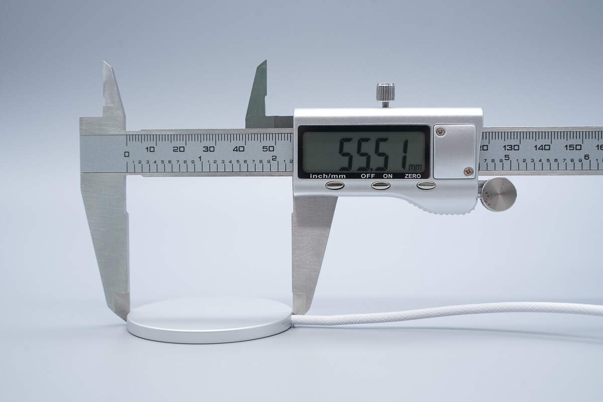

The diameter of the wireless charge panel is about 55.5 mm (2.19 inches).

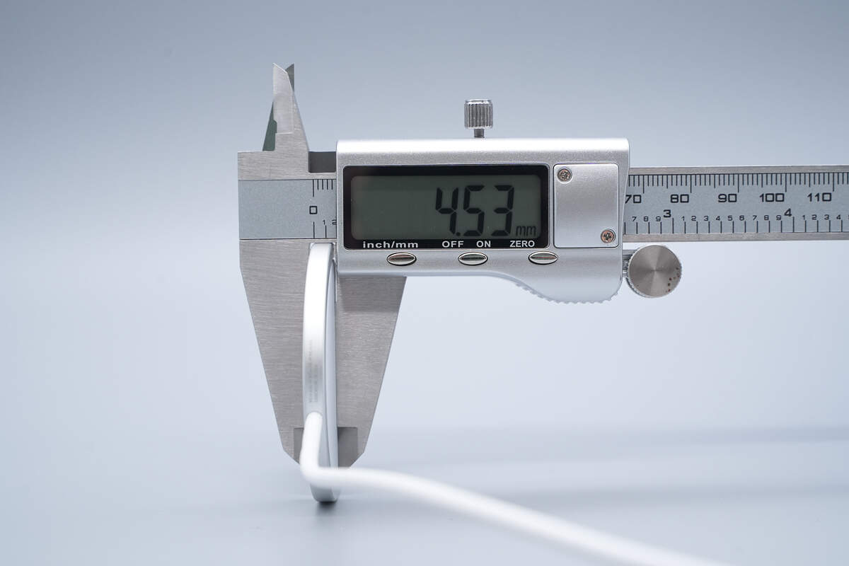

The thickness is about 4.5 mm (0.18 inches).
The weight is about 46.2 g (1.63 oz).

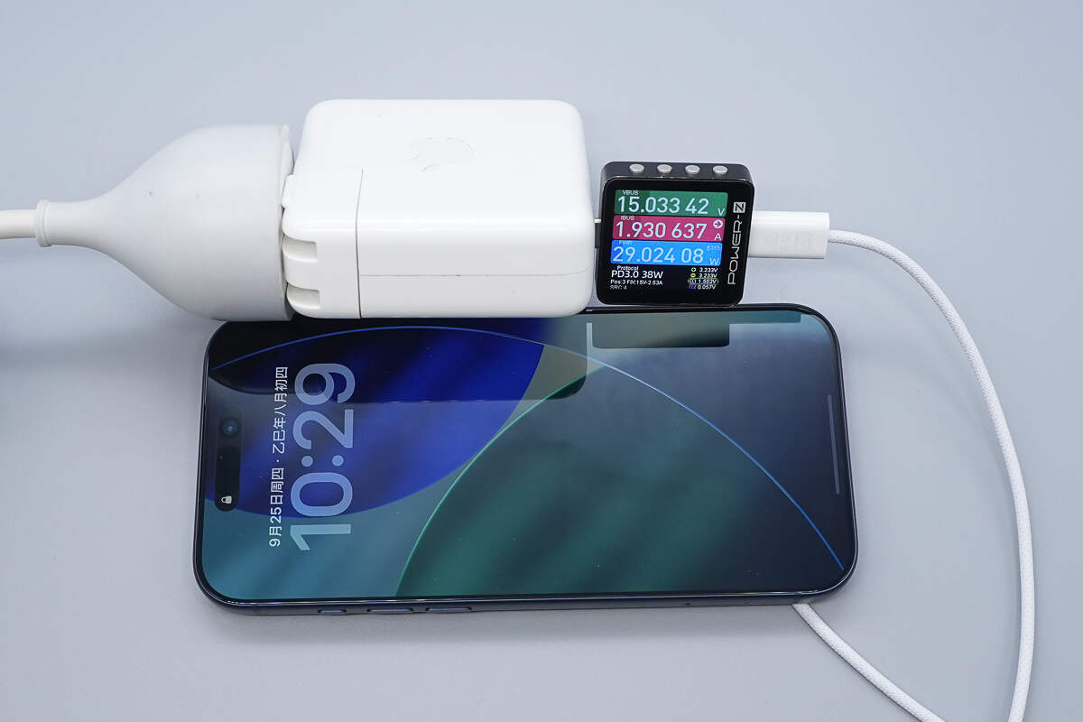

Using an Apple 67W charger paired with it to charge the iPhone 17 Pro Max, the input voltage is 15V, the input current is 1.93A, and the input power is about 29W.

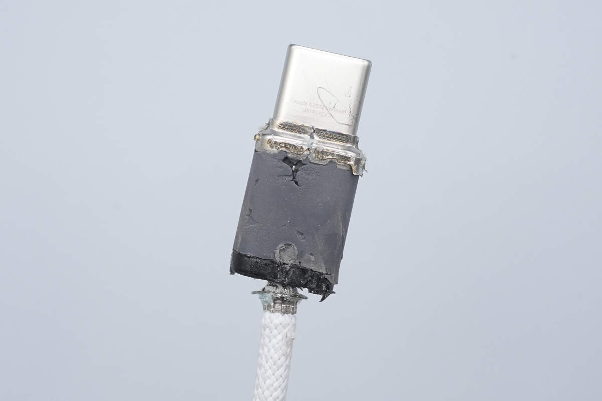

First, use a cutting machine to open the plastic case of the USB-C connector.

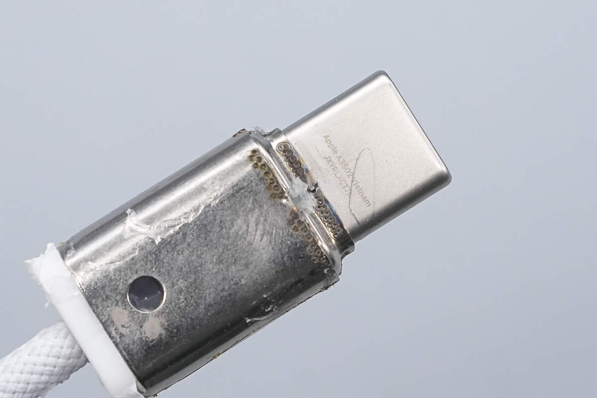

The interior is a stainless steel shell fixed by spot welding.
There is no opening on the other side of the shell.

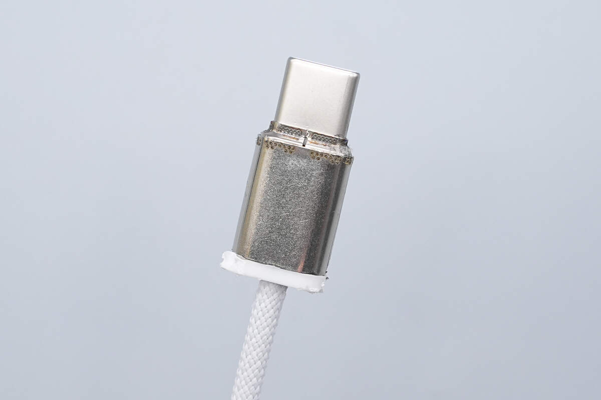

The stainless steel shell and the USB-C plug are fixed by spot-welding.
There are also solder joints at the tail.

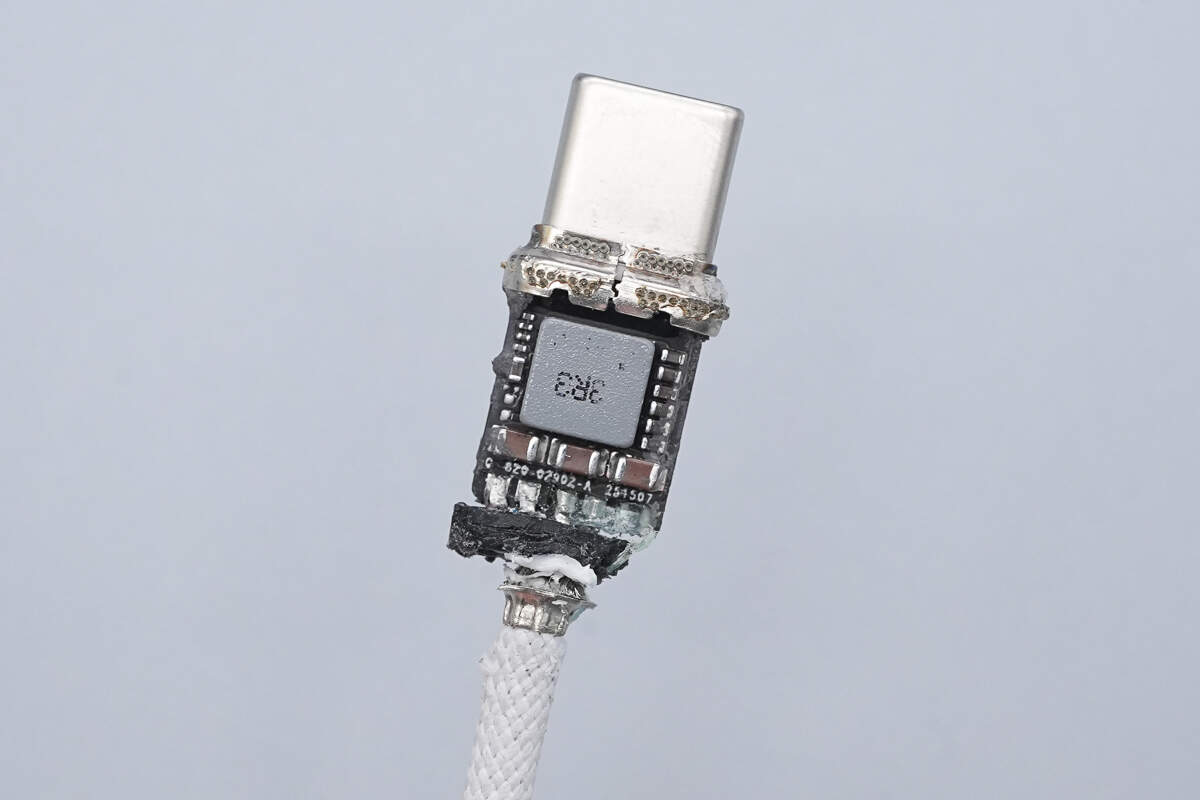

Open the stainless steel shell, and there is a PCBA module inside, and it is filled with glue potting compound. There is a QR code printed on the surface of the inductor.
The other side is filled with potting compound.

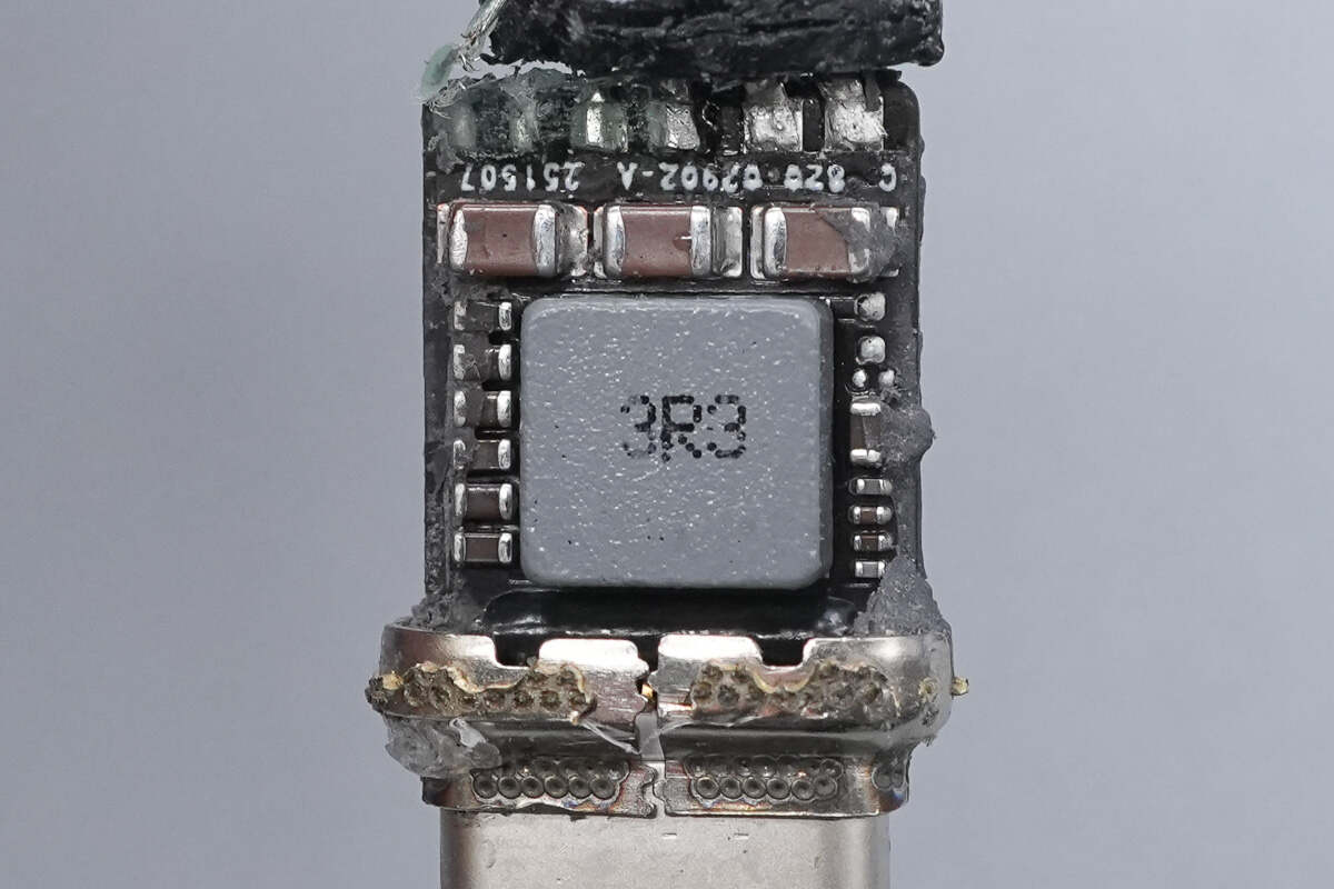

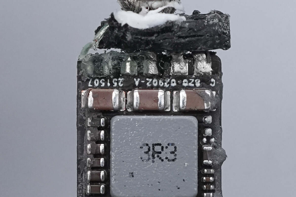

After removing the potting compound, one side of the PCBA module reveals an alloy inductor and filtering capacitors.
The other side has two chips.

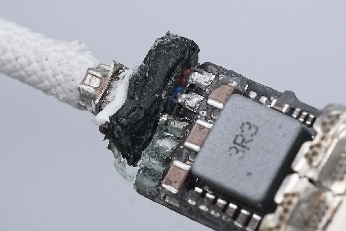

The wires are soldered directly to the PCBA module.

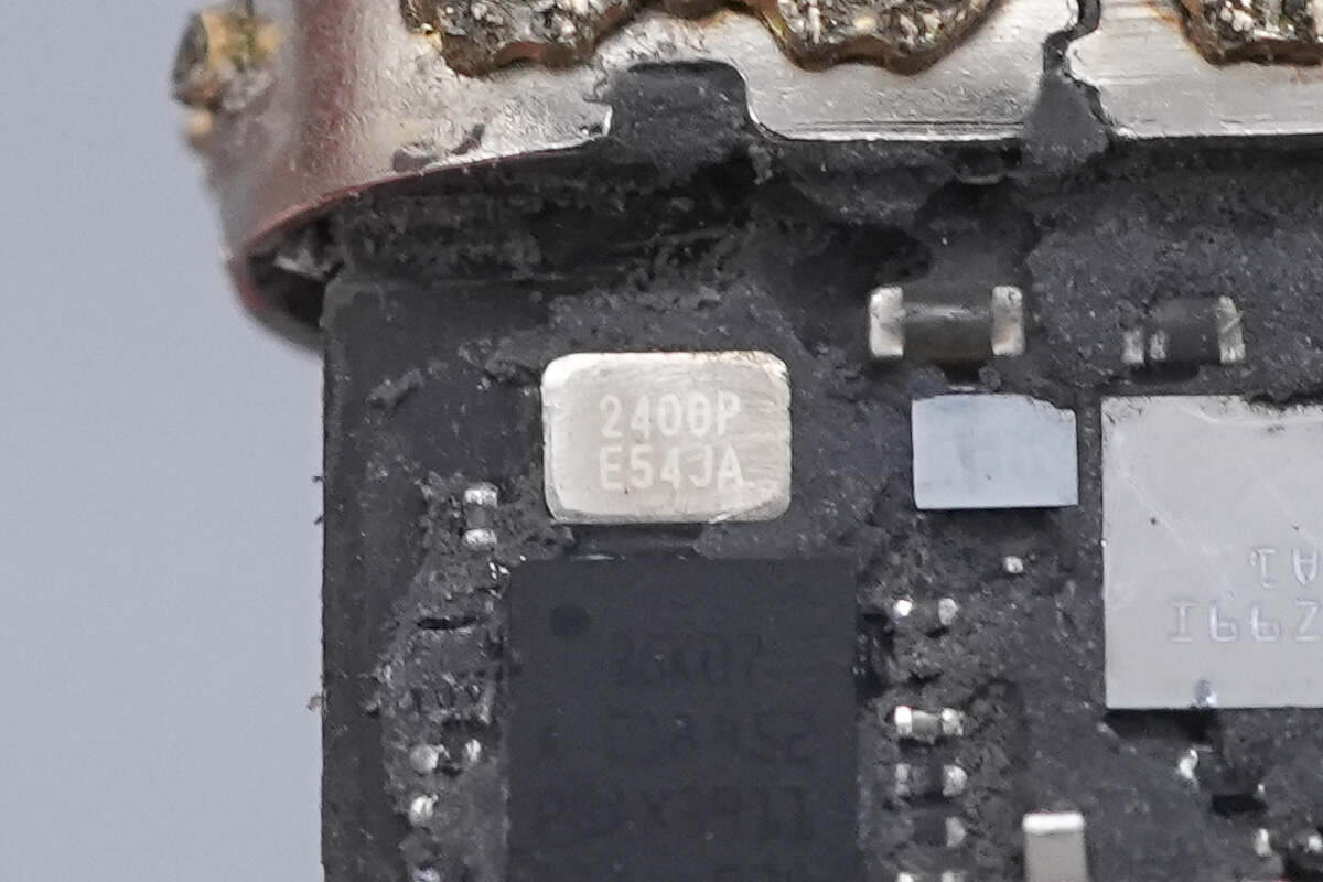

The USB-C interface controller is marked with the code 3GK07.
This is the crystal oscillator used with it.

The power conversion chip is marked CP3100A1 and is manufactured by Texas Instruments.

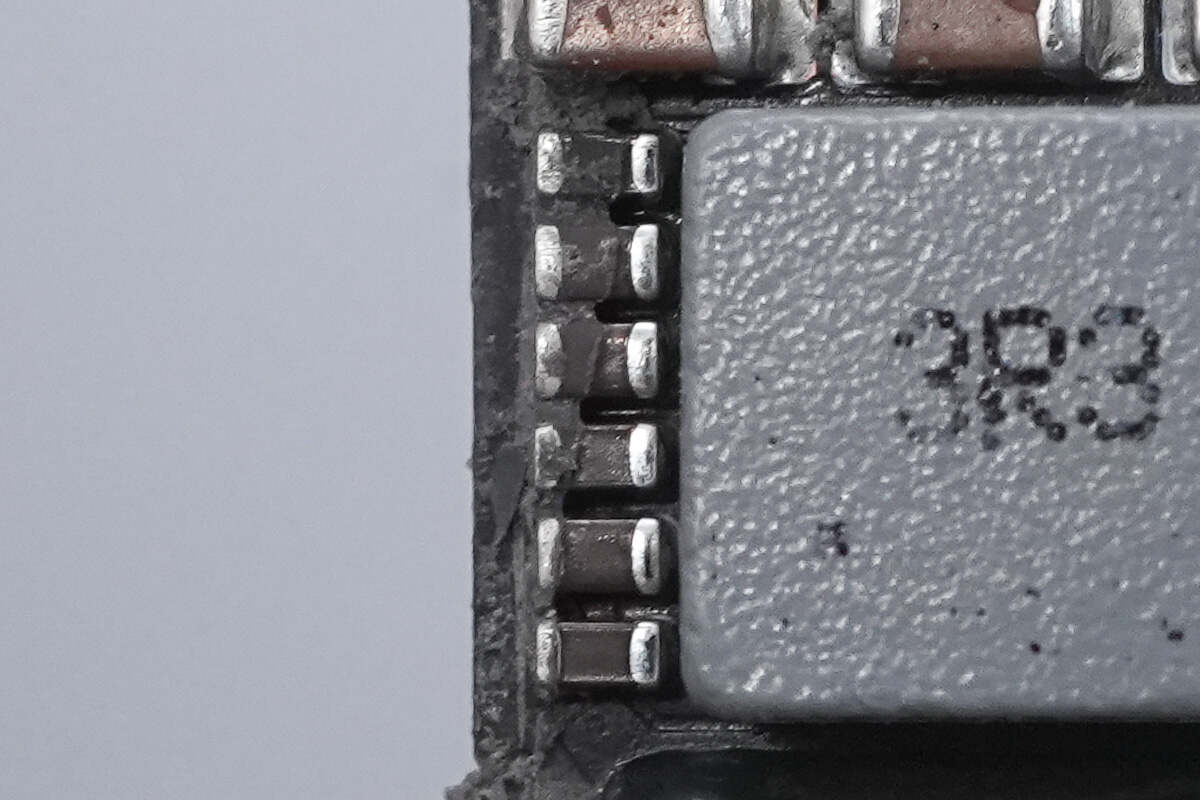

Close-up of the 3.3μH alloy inductor.

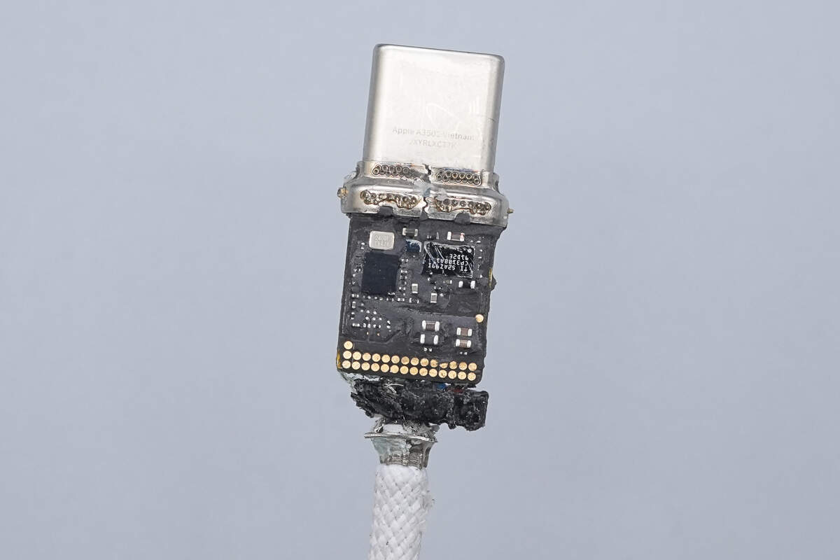

Remove the metal shell and plastic frame of the USB-C plug, and you can see the gold-plated pins inside.
The pins are gold-plated to ensure long-term reliability.

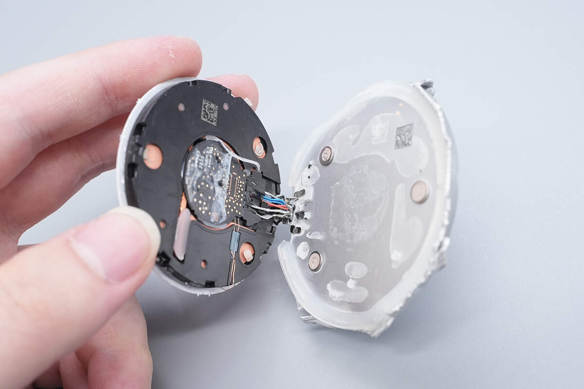

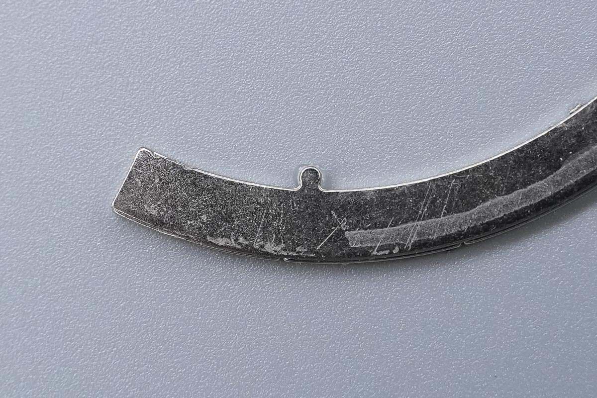

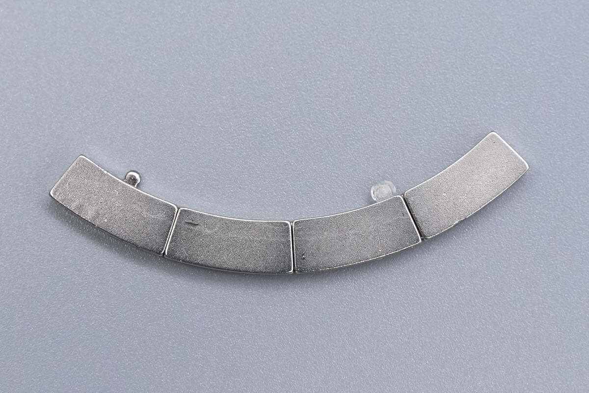

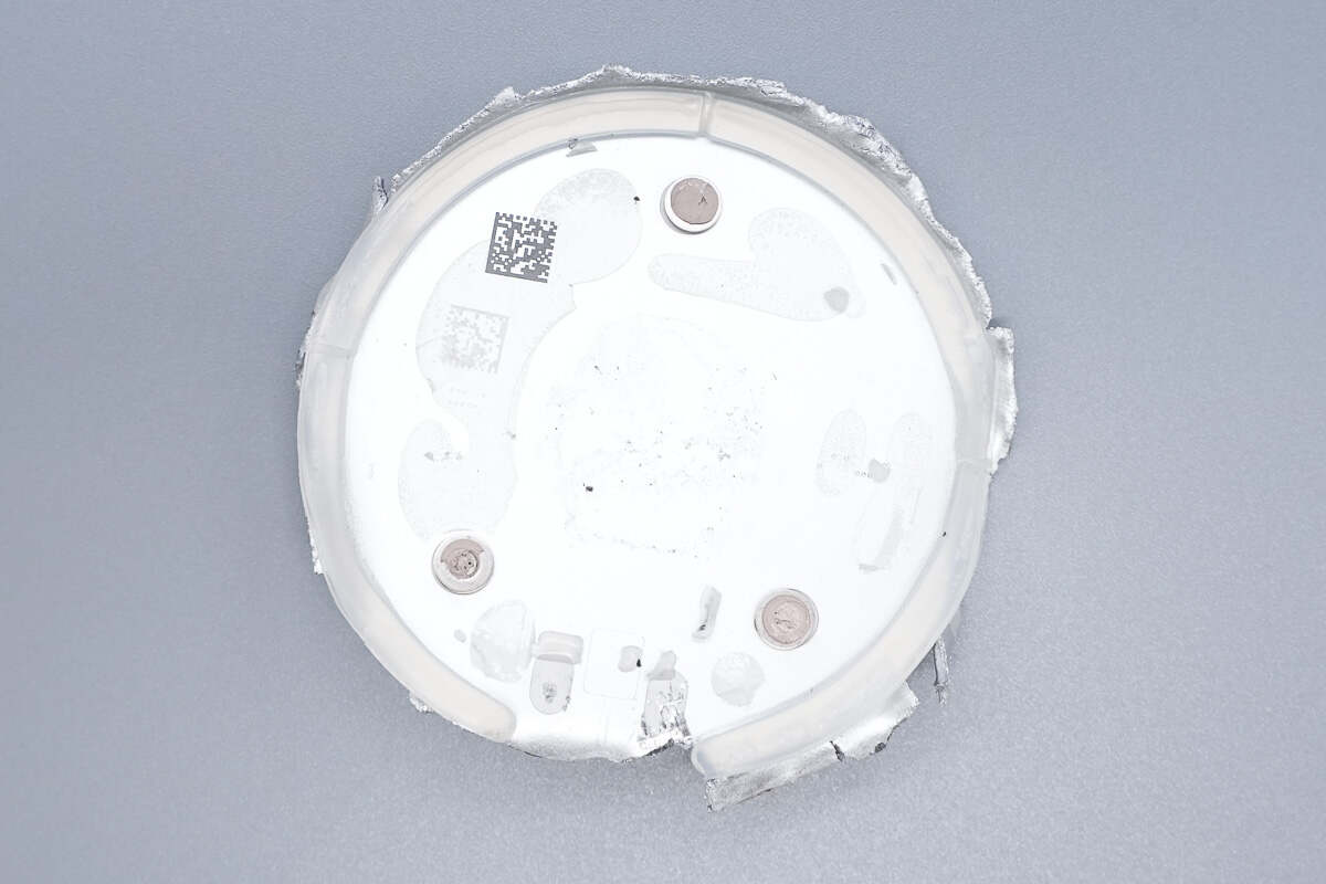

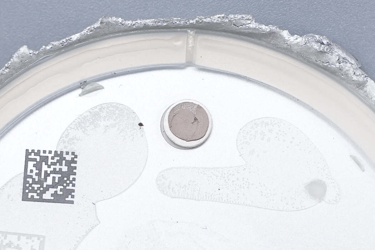

Cut open the aluminum alloy casing of the wireless charging panel. There are four magnets per group, with a total of four groups.
Close-up of the front side of the magnets.
The back side has a mounting plate with positioning pins.
Remove the cover and casing.

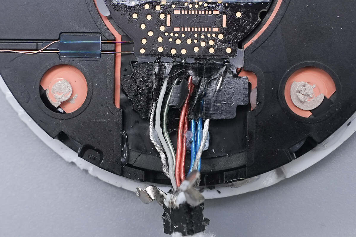

The cable is secured to the casing using clips.
The wires are soldered to the PCBA module.

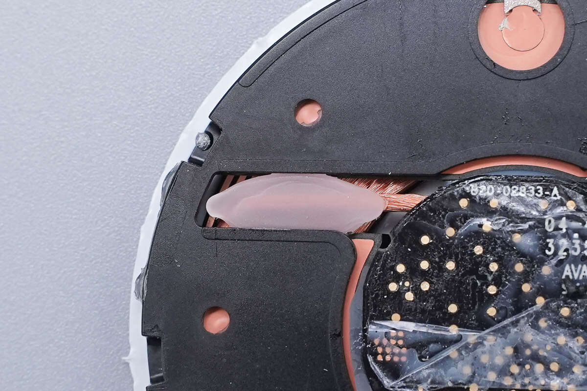

The interior of the casing features raised areas that correspond to the grounding points of the wireless charging panel.
The raised areas are coated with conductive adhesive, and plastic strips are installed along the edge of the casing.

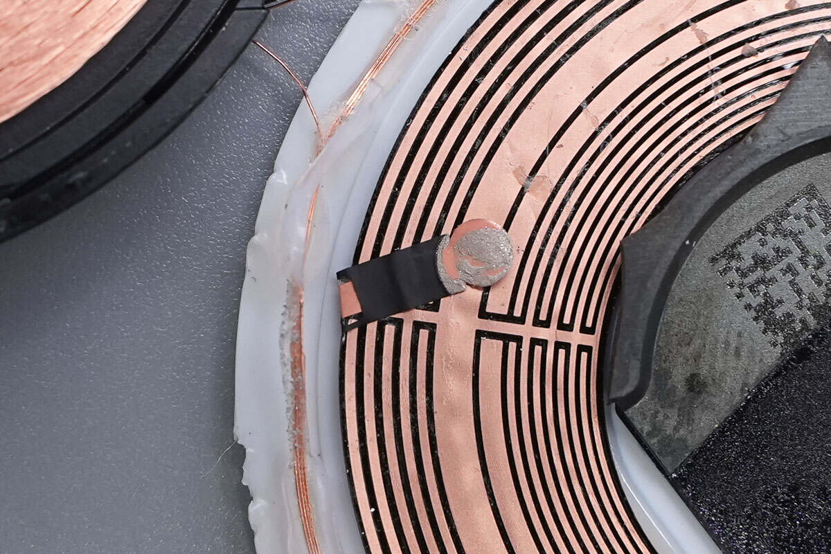

The PCBA module in the center is attached to the casing using double-sided adhesive tape. Black plastic panels along the edges provide insulation and support.

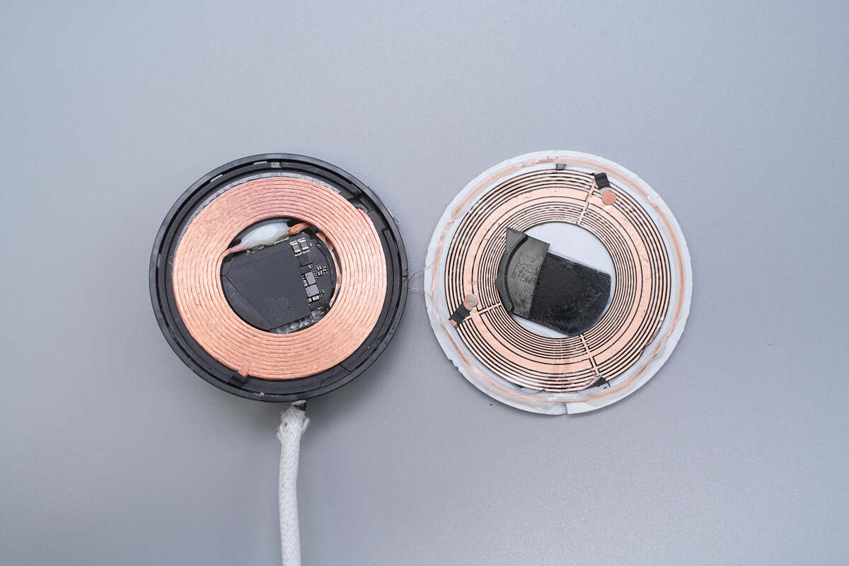

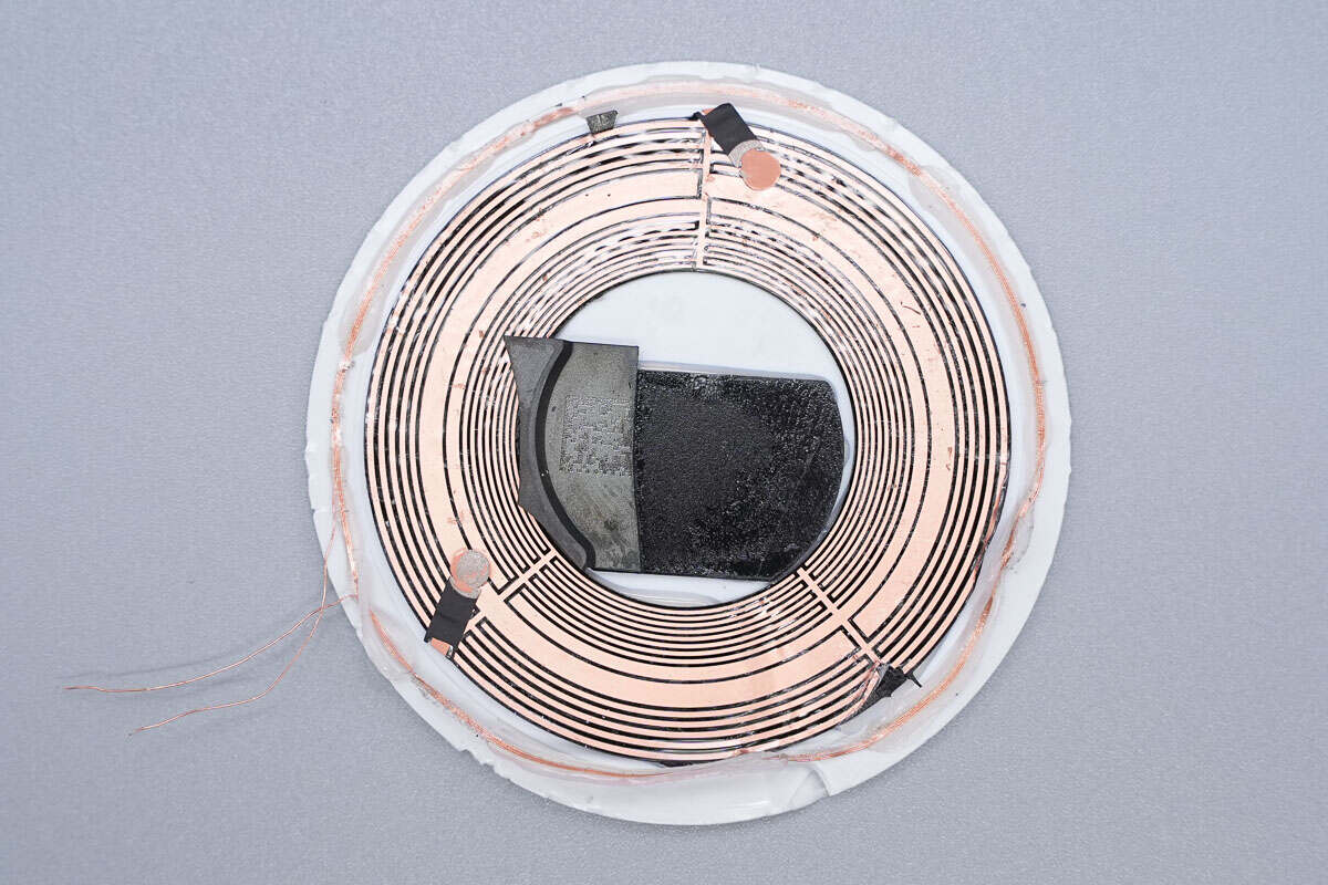

The wireless charging coil is secured with adhesive.
Two thin enameled wires serve as communication coils.
The solder joints of the wires are reinforced with adhesive.
Separate the cover and the wireless charging coil.
The communication coil is connected using enameled wire.
The shielding layer inside the cover plate is connected to the aluminum alloy casing.

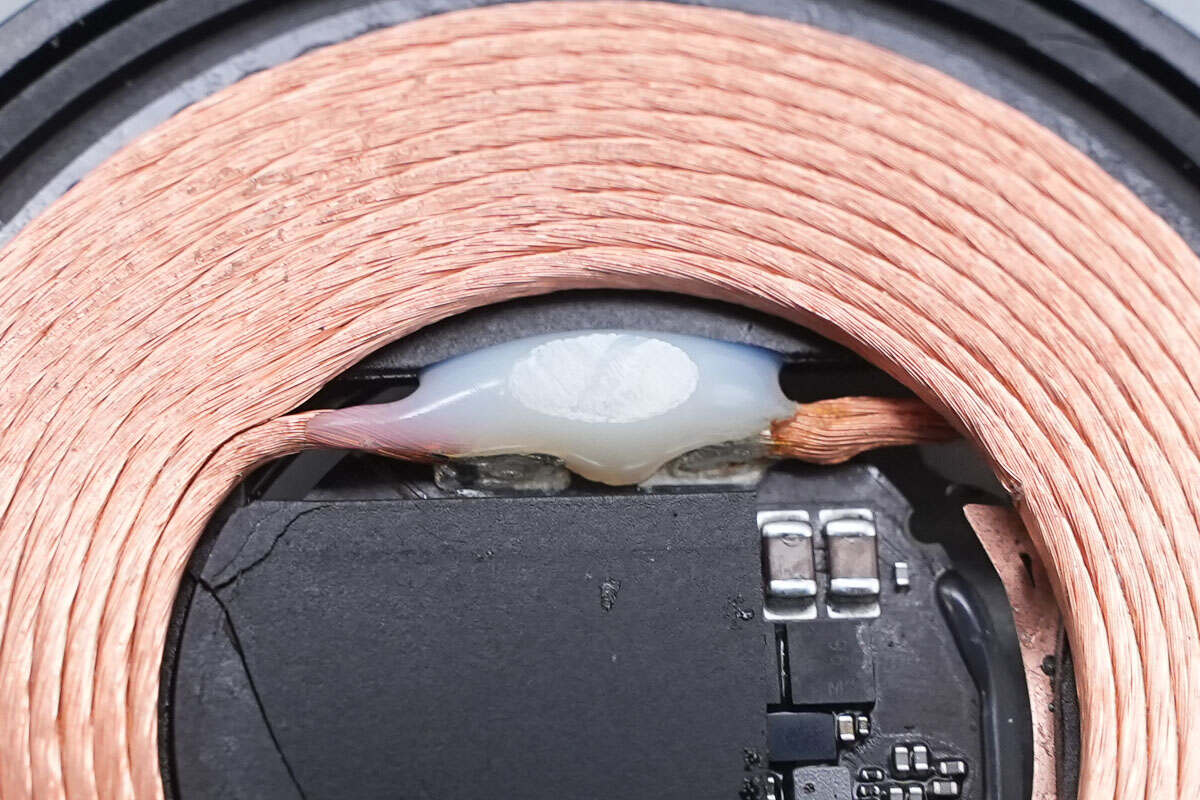

The solder joints of the wireless charging coil are insulated and reinforced with adhesive.

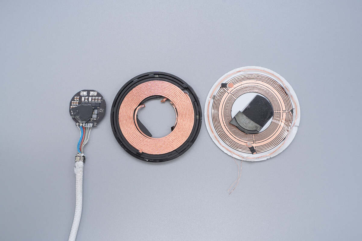

Cut the coil wiring to separate the PCBA module from the wireless charging coil.
There is a magnetic shielding sheet at the bottom of the wireless charging coil.

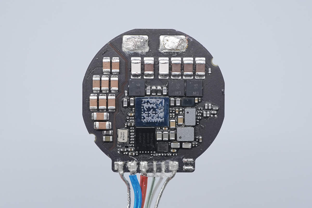

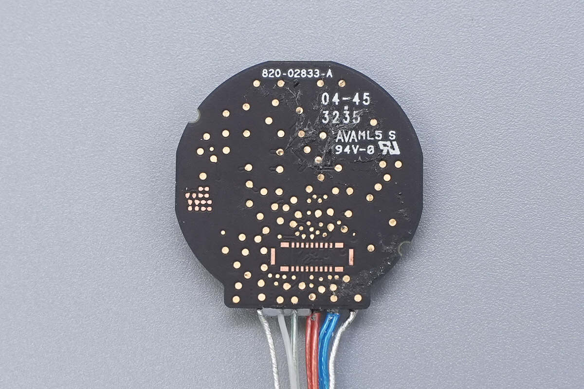

The front side of the PCBA module features filtering capacitors, resonant capacitors, MOSFETs, the wireless charging power stage chip, the wireless charging controller, and memory.
There are no components on the back side.

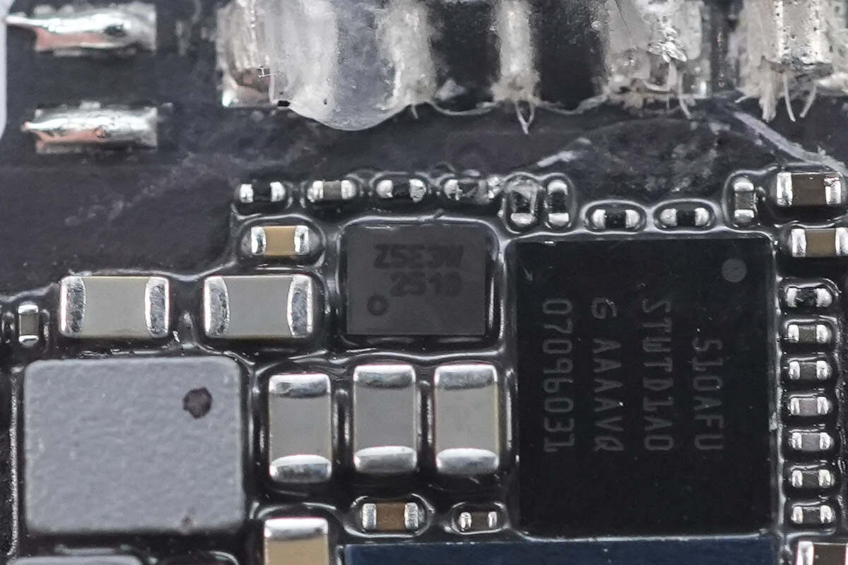

The wireless charging master control chip is from STMicroelectronics, marked with STWTD1A0.
Close-up of the external clock crystal oscillator.
The memory chip is marked with Z5E3W.
The surface of the wireless charging chip is printed with a QR code.
After removing the surface coating, the chip is marked with STWTA1A1.

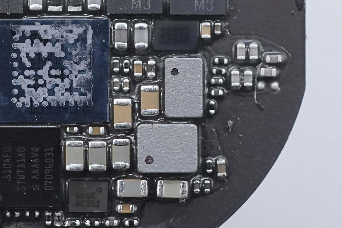

Close-up of the two external alloy inductors.
Close-up of the external MLCC filtering capacitors.

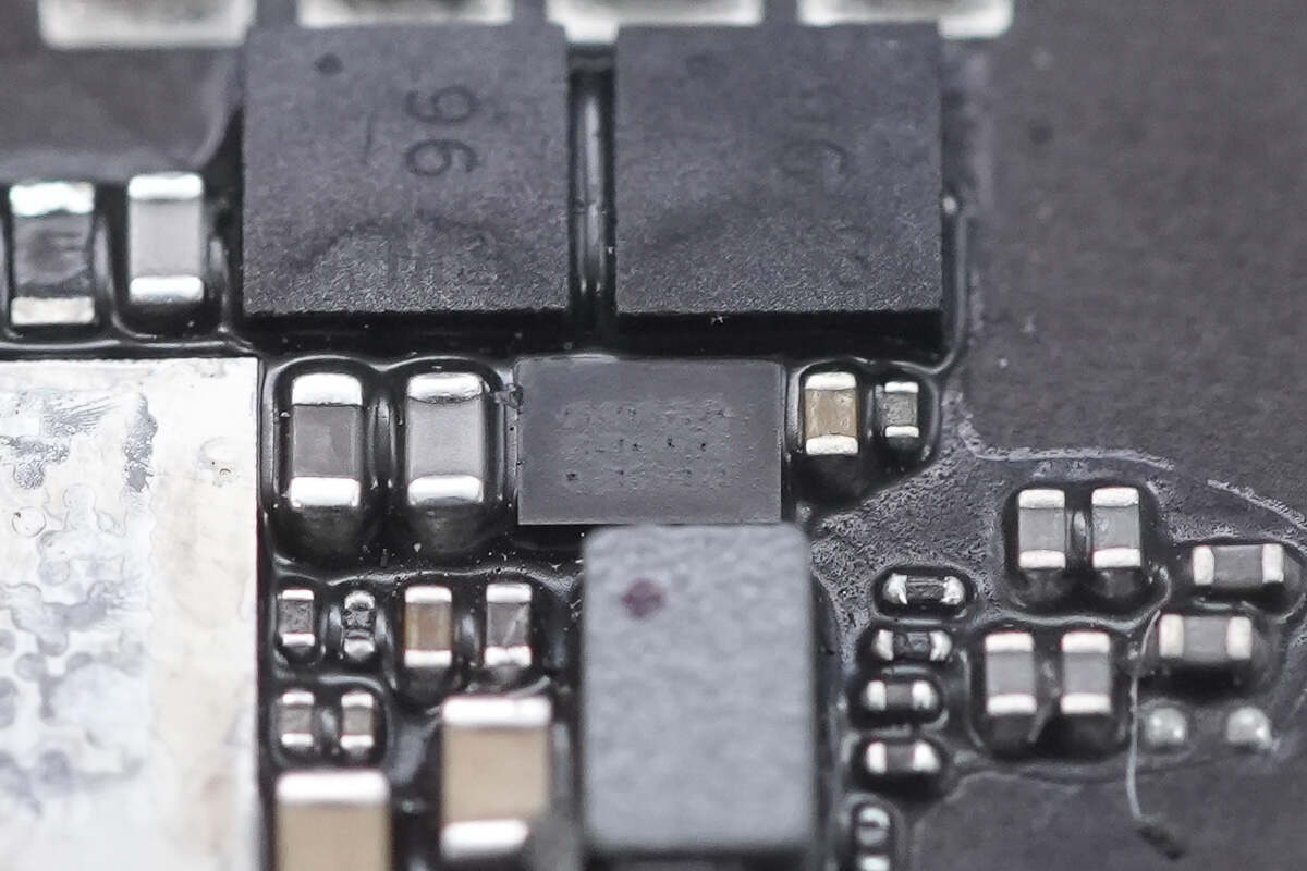

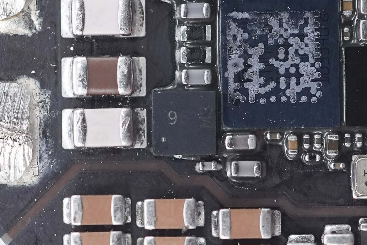

The MOSFET used for switching the resonant capacitors is from DIODES, marked with "96," model DMT12H065LFDF. It is an NMOS with a voltage rating of 115V and an on-resistance of 65mΩ, packaged in a U-DFN2020-6 form factor.
The other MOSFET has the same model.
Close-up of the SMD resonant capacitors.
