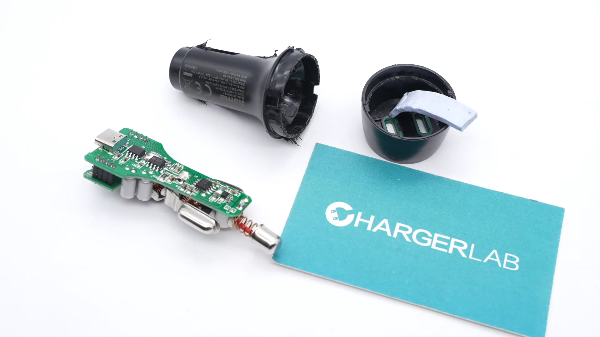

Next, let's go ahead and take it apart.
Teardown of Hama 45W Car Charger (00201632)-Chargerlab
After removing the top case, we found some silicone adhesives between two PCBs for heat dissipation.
The case has two USB-C openings and an opening for an indicator light.
Then, use the cutting machine to cut off the shell and take out the PCBA module.
It is covered with some silicone adhesives for fixing components and dissipating heat.
It's composed of a long strip PCB and a small PCB. Two USB-C connectors are on two PCBs.
The long strip thermal pad on the back can also enhance heat dissipation.

Three solid capacitors and two buck inductor are on the front.
The buck conversion chip, a buck converter and protocol chip are on the back.
There are two buck inductors at the negative side.
And this is the copper alloy spring on the positive side.
The positive side also has a fuse for overcurrent protection.

The USB-C port uses the Injoinic IP6520, which has built-in protocol chip and synchronous buck converter, with a very streamlined peripheral circuit, only requiring 7 resistor-capacitor components and 1 inductor, which can meet the 20W fast charging demand. It can be used for car chargers, fast charging power strips, and multi-port chargers. The conversion efficiency is high, and the protocol support is comprehensive. The IP6520 has passed the USB PD3.0 certification, with a certified TID number of 3277.
This buck inductor can work with the buck IC we just mentioned.
The other buck converter is used for another buck circuit, from Chengxinwei. It can support precise constant voltage and constant current. And the input voltage can be up to 32V. The model is CX8855.
The USB PD protocol chip uses Wing Semiconductor XPD720, which has passed USB PD3.0 certification with a TID of 3479. It supports fast charging protocols such as QC2.0, QC3.0, AFC, FCP, SCP, HVSCP, PD, and PPS. It has an internal 10mΩ VBUS MOSFET and integrates a 10mΩ current detection resistor. The pins support overvoltage protection and have built-in protection functions, which can save peripheral components and reduce costs. It adopts ESOP8 package.

And two USB-C connectors are controlled by two independent buck circuits.

A LED indicator is soldered to the back of the small PCB, used for indicating the power of the car charger.
That's all for the teardown.
Well, that's all components for this 45W dual USB-C car charger from Hama. It can support wide range input of 12-24V and can be used in different vehicles.
After taking it apart, we found it integrates two independent buck circuits. It can ensure two phones are fast-charged at the same time. But the 45W is not enough to charge your laptops or other high-power devices.
