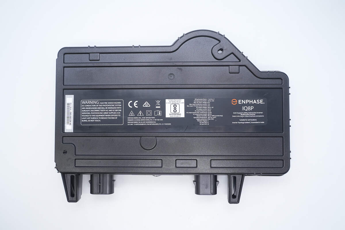

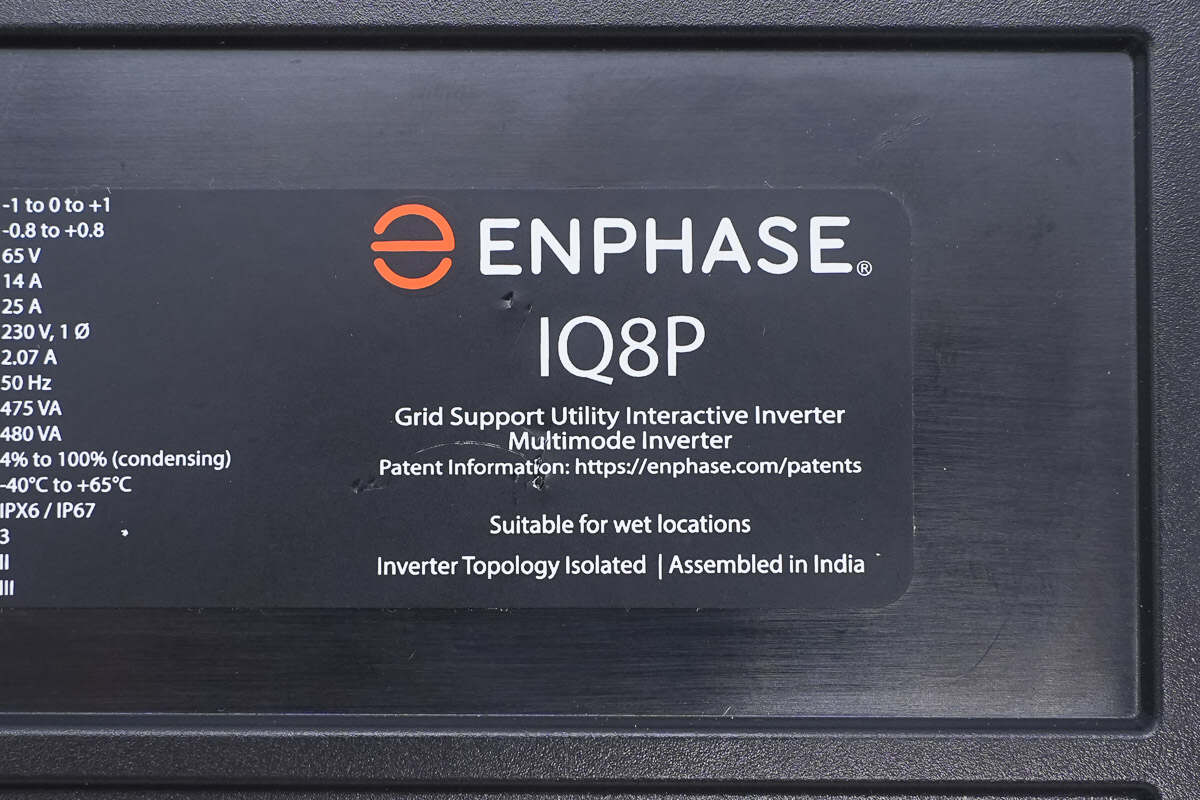

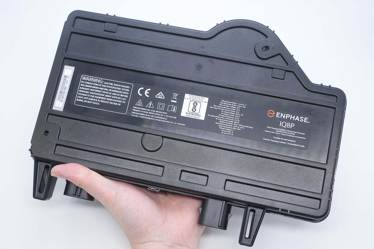

An information label is affixed to the front.
Teardown of Enphase IQ8P 480W Microinverter (IQ8P-72-2-INT)-Chargerlab
The label indicates the brand and model IQ8P, and states that it is suitable for use in wet locations.
Off-grid power factor: -1 to 0 to +1
Grid-tied power factor: -0.8 to +0.8
Maximum DC input voltage: 65 V
Maximum continuous DC input current: 14 A
Maximum DC short-circuit current: 25 A
AC output voltage: 230 V
AC output current: 2.07 A
AC output frequency: 50 Hz
AC output power (maximum continuous): 475 VA
AC output power (peak): 480 VA
Relative humidity: 4%–100%
Operating temperature: -40℃ to 65℃
Ingress protection rating: IP67
Pollution degree: 3
DC port overvoltage category: II
AC port overvoltage category: III

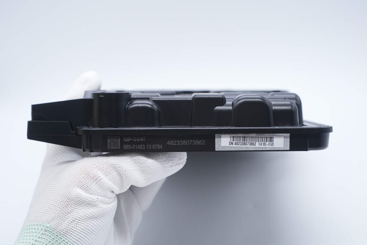

The model number is printed on the side, and a serial number sticker is affixed.

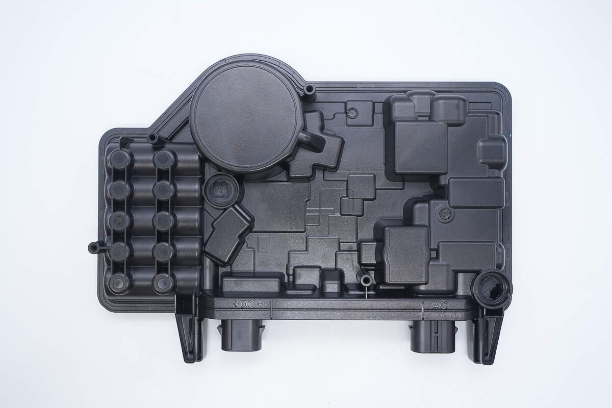

The other side of the enclosure conforms to the shape of the internal components.

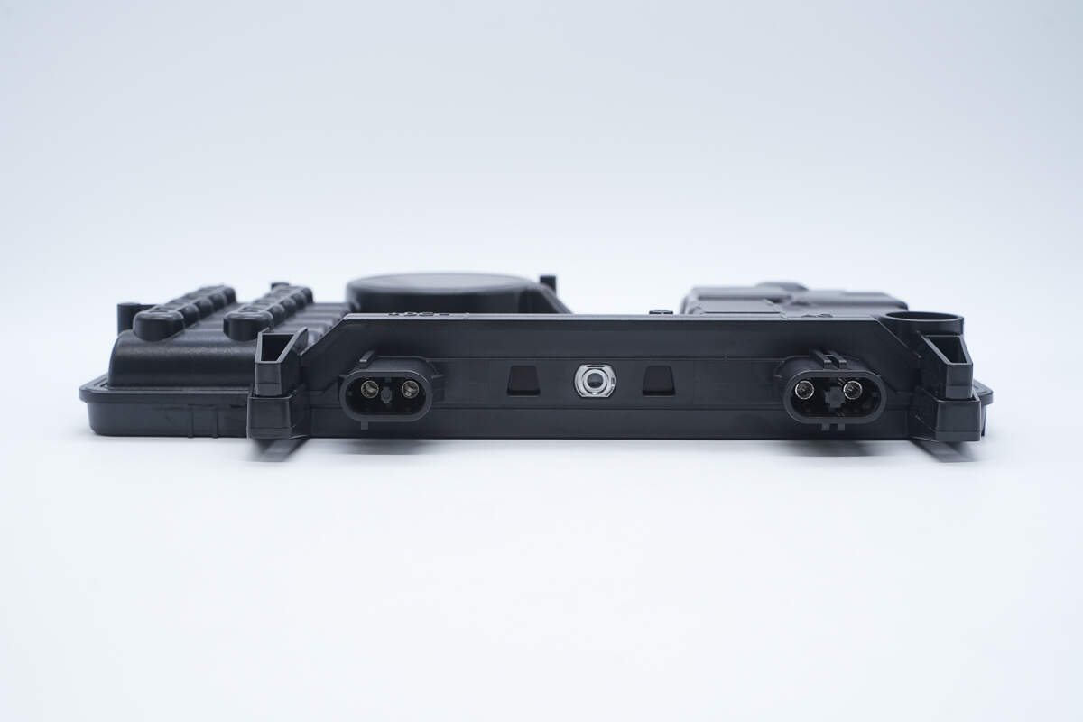

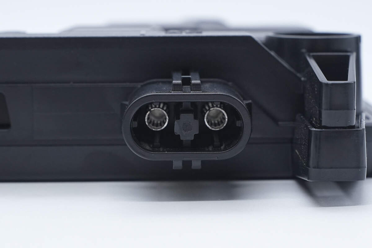

Close-up of the DC input connector, indicator light, and AC output connector.

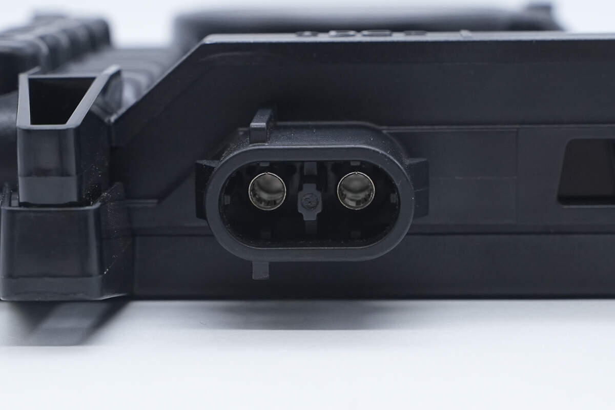

The DC input connector has a reverse polarity protection design.

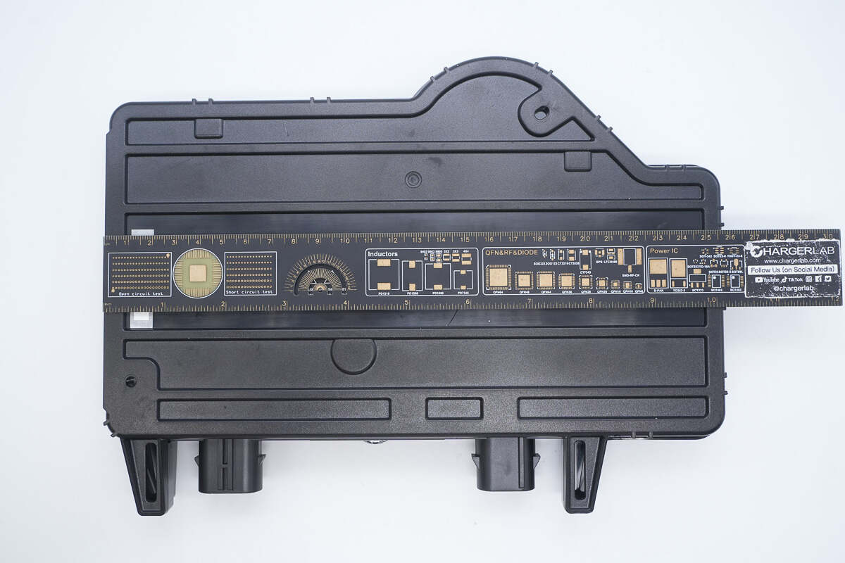

The length of the microinverter is about 26 cm (10.24 inches).

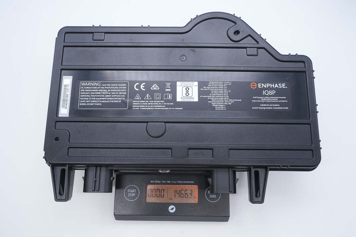

The weight is about 1466 g (3.232 lbs).

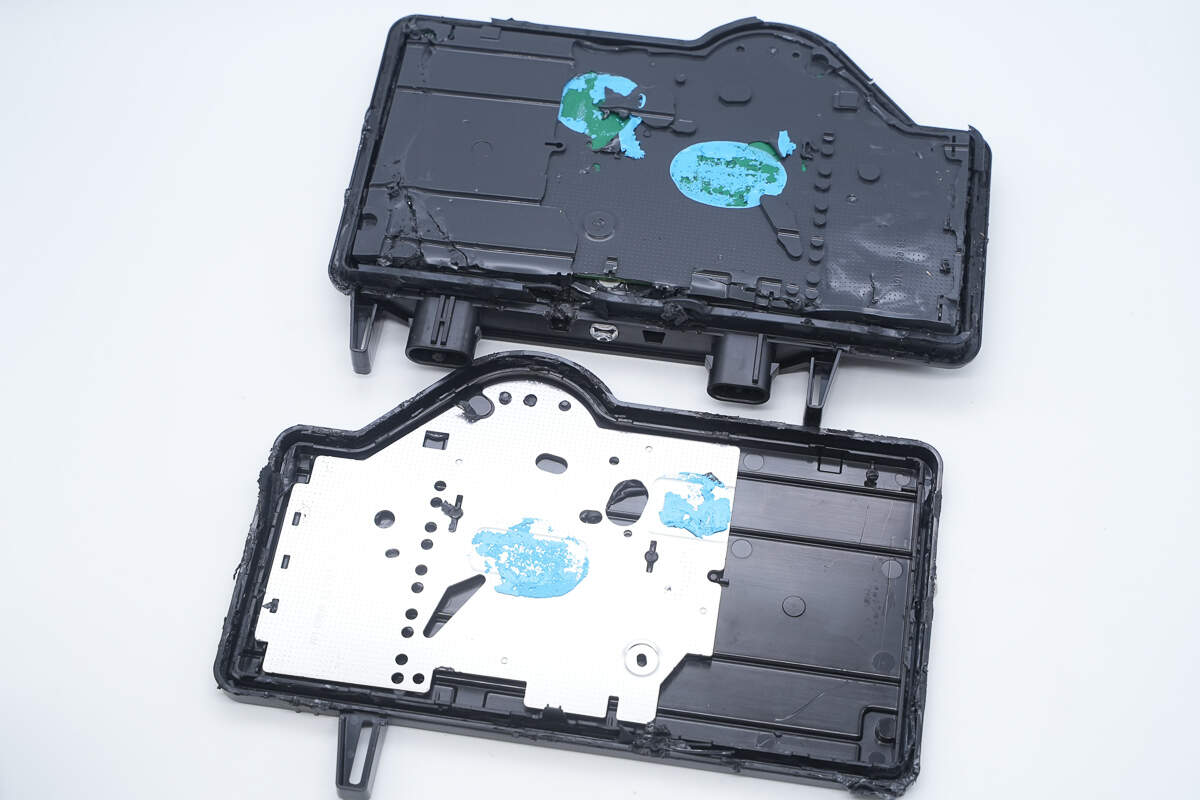

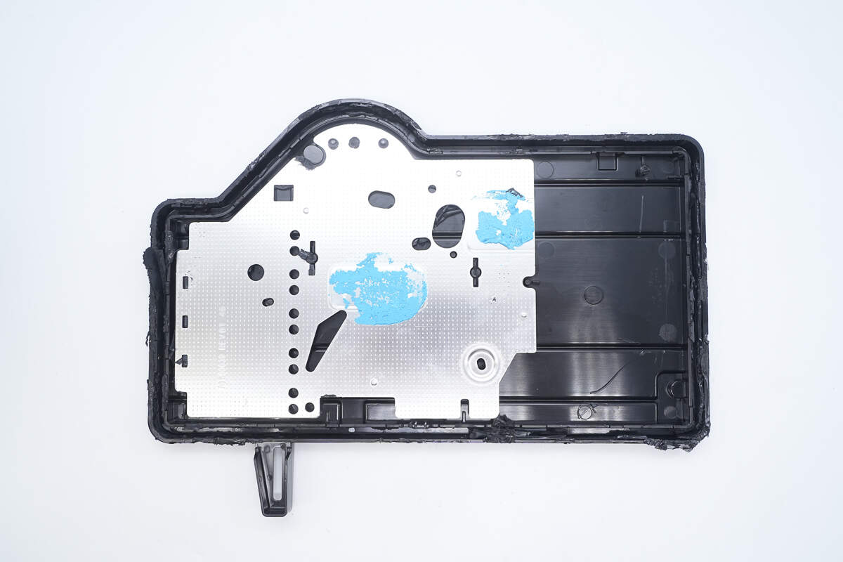

The enclosure is opened along the seam, with the interior filled with black potting compound.
Inside the cover, a heat-dissipating aluminum plate cools the PCBA module through blue thermal gel.
The black potting compound has imprinted the shapes of the heat sink plate and the inside of the cover.

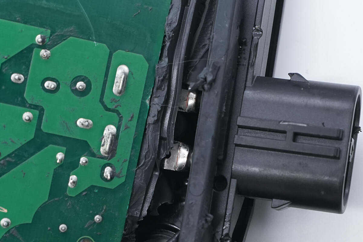

The DC input and AC output connectors are connected by soldering.

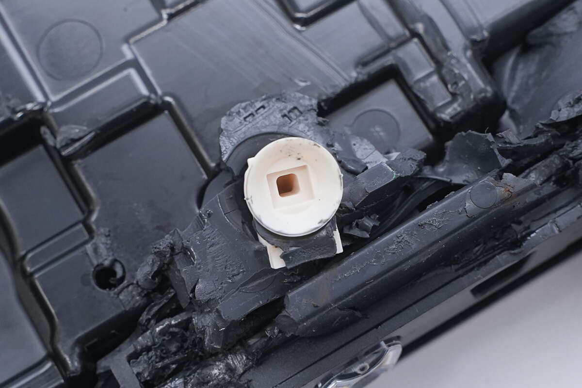

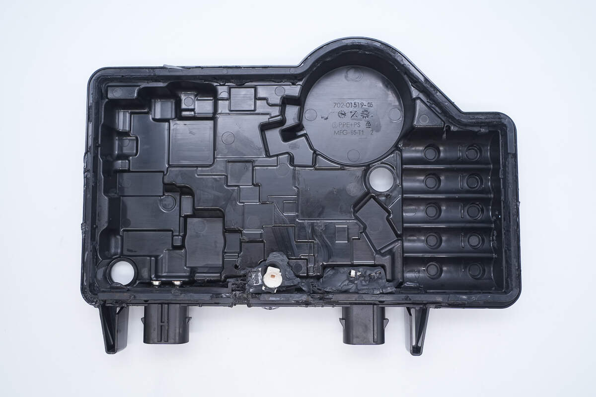

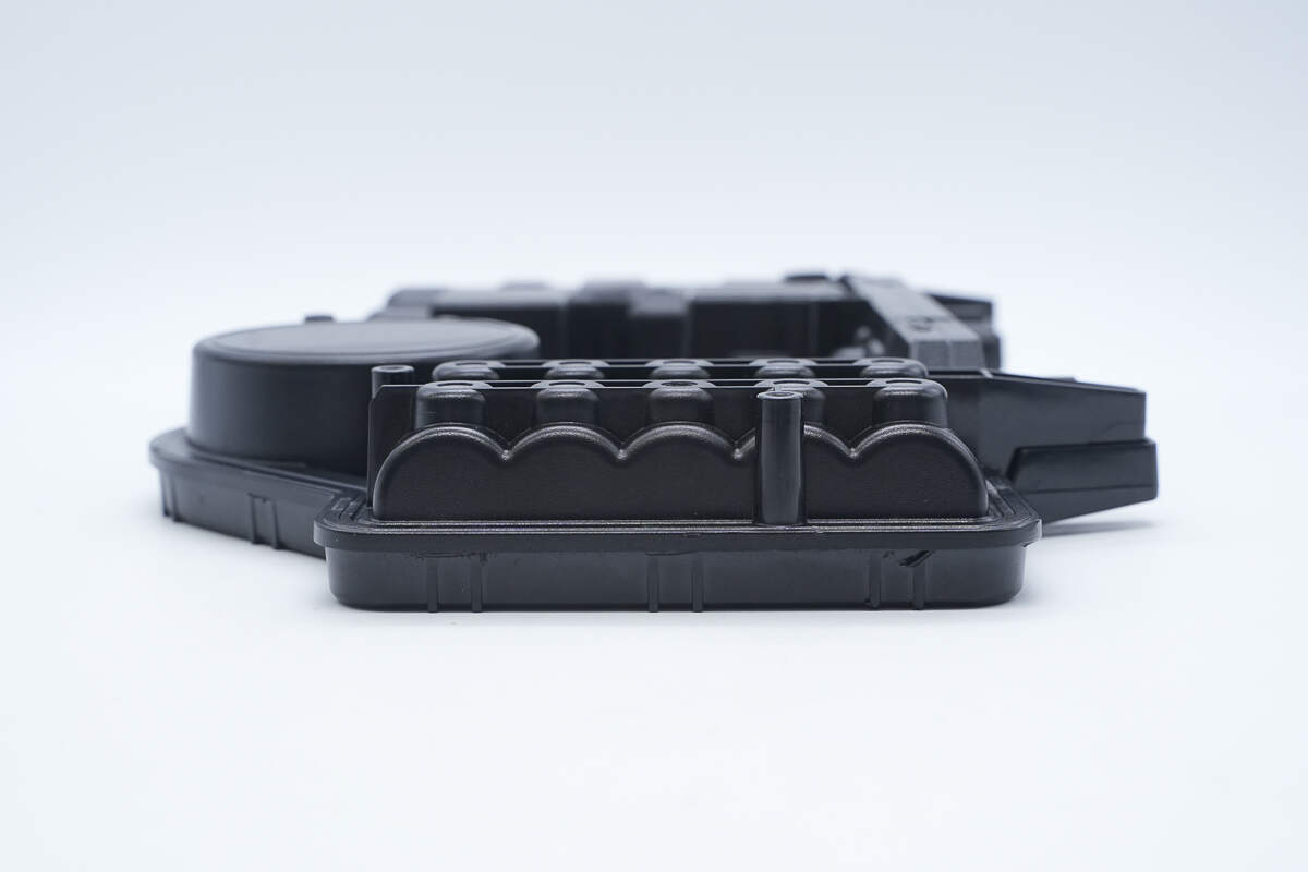

The interior of the enclosure is shaped to fit the components and is made of PPE+PS material.
Close-up of the light guide structure for the indicator LED.

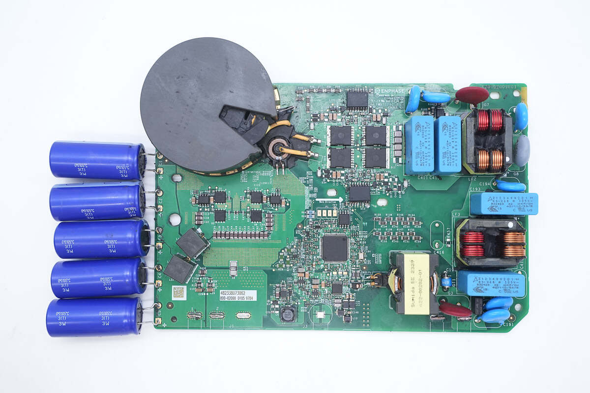

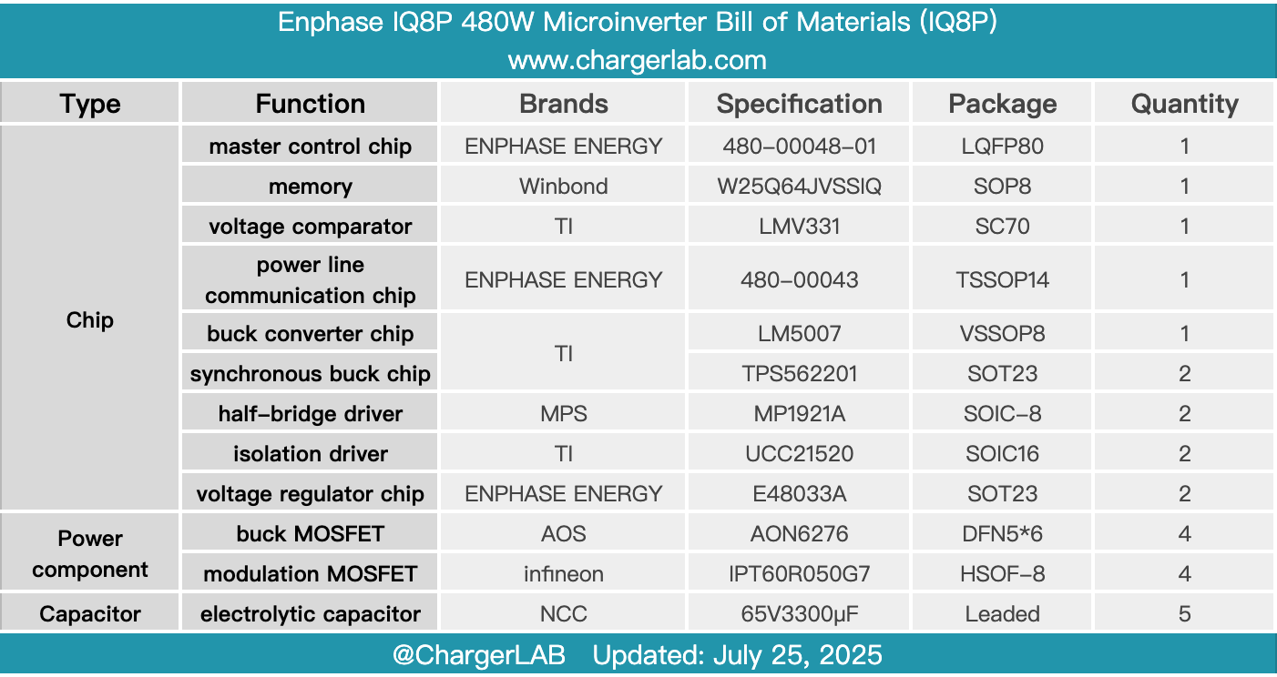

On the left side of the PCBA module is the DC input end, which has filter capacitors, filter inductors, buck MOSFETs, a driver, and a transformer. In the middle, there is a master control chip, isolation drivers, and MOSFETs. On the right side, there is an output filter circuit and a power line communication circuit.
Close-up of the two filter inductors at the input end.
The electrolytic capacitors are from NCC, rated at 65V 3300μF, with five used for input filtering.

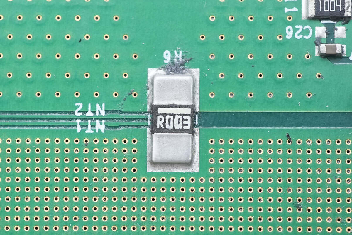

A 3mΩ shunt resistor is used to measure the inverter’s input current.

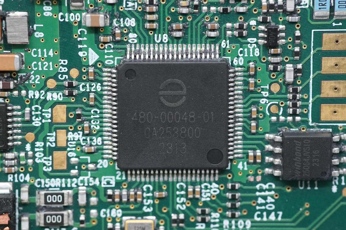

The master control chip, sourced from ENPHASE and marked with 480-00048-01, generates control signals for both DC boost and output modulation. The DC boost is driven by a half-bridge driver, while the AC modulation is driven through isolation drivers. The chip uses an LQFP80 package.

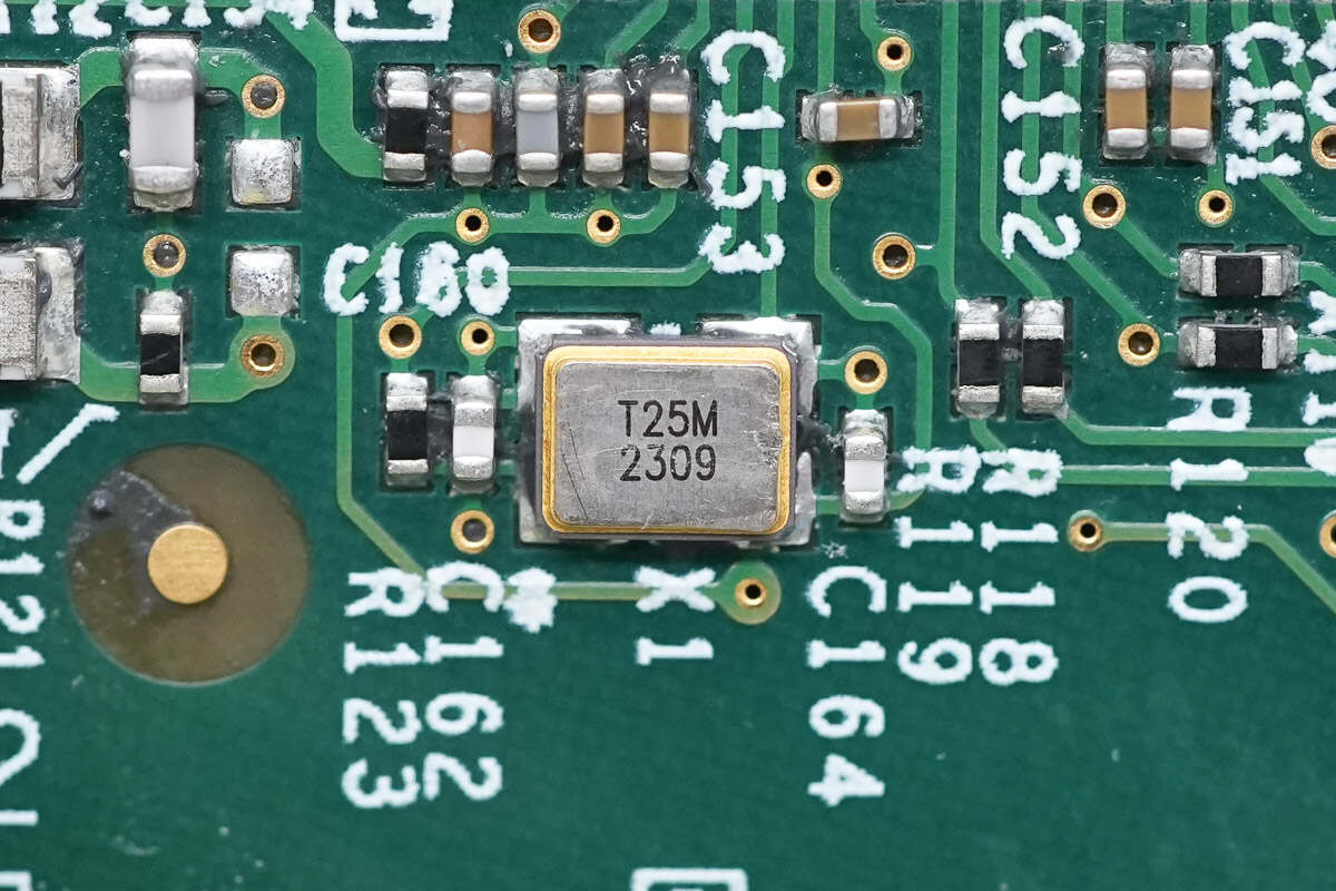

Close-up of the external clock crystal oscillator for the master control chip.
The external memory for the master control chip is from Winbond, model W25Q64JVSSIQ, with a capacity of 8MB, packaged in SOP8.
Close-up of the indicator LED.
The voltage comparator is from TI, marked with R2F, model LMV331. It is a general-purpose low-voltage comparator packaged in SC70.
Close-up of the series voltage divider resistors used for voltage sampling.

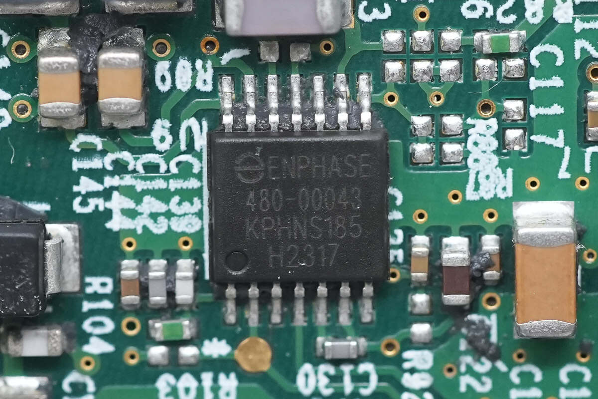

Another ENPHASE custom chip, marked with 480-00043 and housed in a TSSOP14 package, is used for power line communication functionality.
Close-up of the external inductors and capacitors for the power line communication chip.

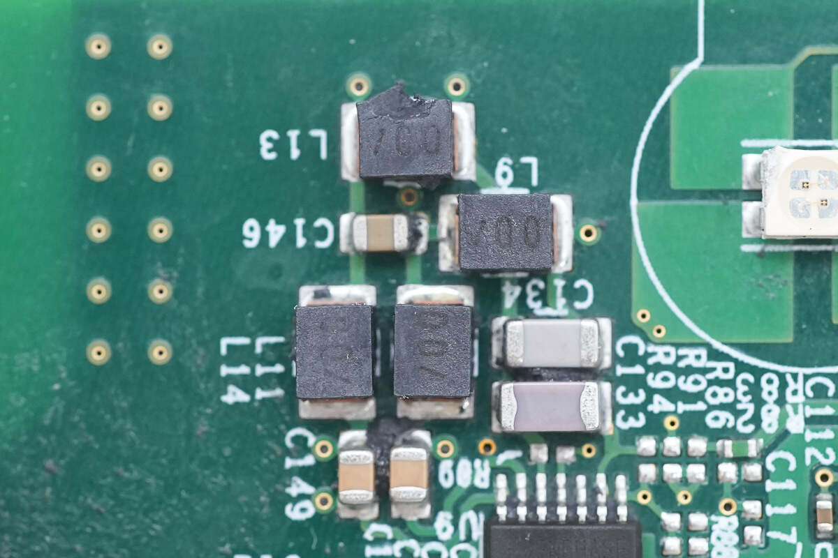

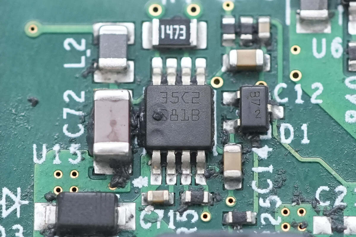

The buck converter chip is from TI, marked with S81B, model LM5007. It features an integrated MOSFET, supports 9–75 V input voltage, 0.5 A output current, ultra-fast transient response, and comprehensive protection functions. It comes in a VSSOP8 package.
Close-up of the buck converter inductor. 220μH.

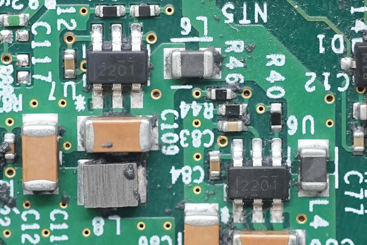

The synchronous buck chip is from TI, model TPS562201. It supports a 17 V input voltage and 2 A output current, and is packaged in SOT23.
Close-up of the DC boost circuit.

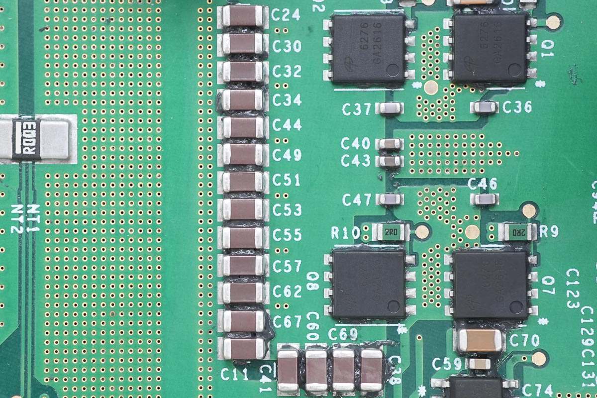

The input end uses 20 parallel-connected MLCC capacitors in 1210 packages for filtering.

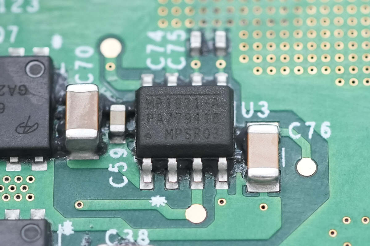

The half-bridge driver is from MPS, model MP1921A. It is a 100V half-bridge driver with a built-in bootstrap diode and comes in an SOIC-8 package.
The buck MOSFETs are from AOS, model AON6276. They are NMOS devices rated for 80V, with a low on-resistance of 2.6mΩ, featuring low gate charge and low output capacitance. They come in a DFN 5×6 package.
Here is the information about AOS AON6276.
The other half-bridge driver also uses the MPS MP1921A.
These two buck MOSFETs also use the AOS AON6276.
The transformer is from SUMIDA.

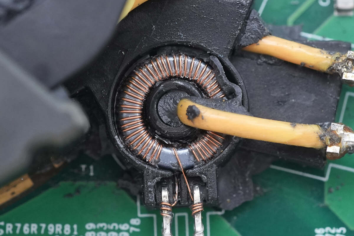

The output wire is equipped with a current transformer.

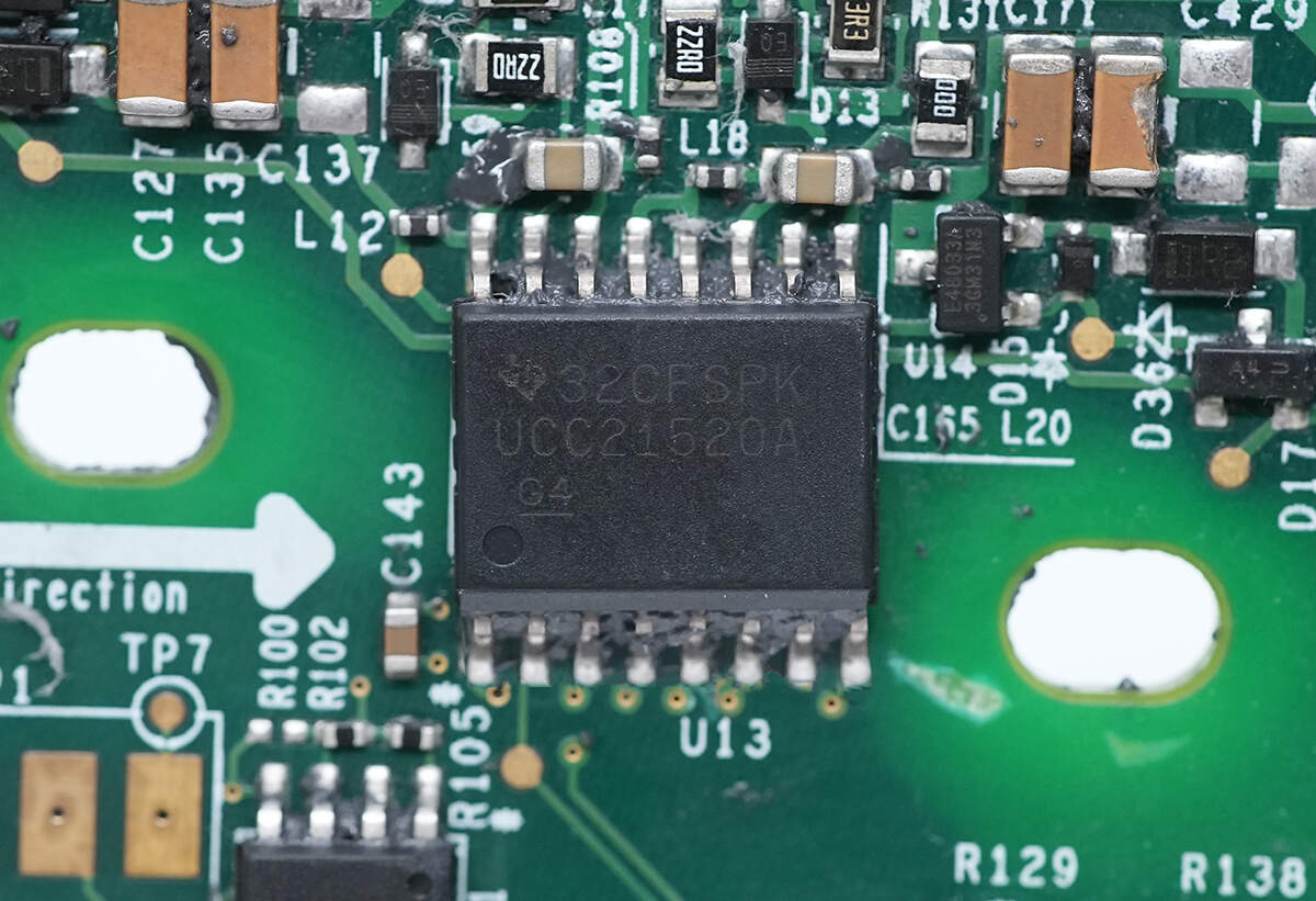

The isolation driver is from TI, model UCC21520. It is a dual-channel driver supporting dual low-side, high-side, and half-bridge applications. It provides 4A sourcing and 6A sinking current output, features capacitive isolation with 5700 Vrms isolation rating, and comes in an SOIC-16 package.
The external voltage regulator chip for the isolation driver is from ENPHASE, marked with E48033A, and comes in an SOT23 package.
The other isolation driver also uses the TI UCC21520.
The voltage regulator chip is marked with E48033A.
The output modulation MOSFETs are from Infineon, model IPT60R050G7. They belong to the CoolMOS G7 series, are NMOS devices rated at 650 V, with an on-resistance of 50 mΩ, and come in an HSOF-8 package.

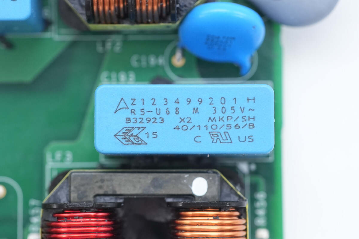

The two safety X2 capacitors are from TDK, each rated at 0.68μF.

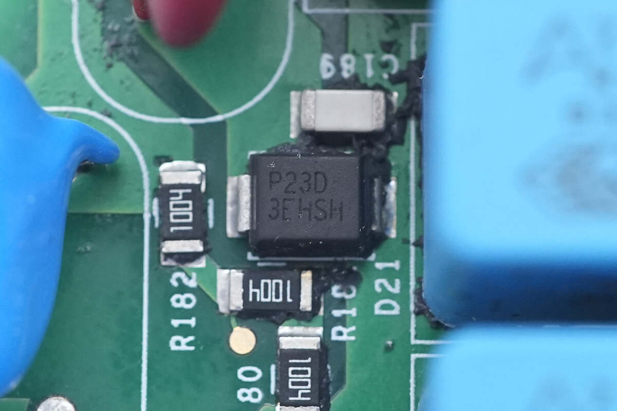

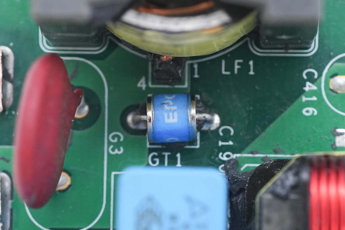

The gas discharge tube is marked with P23D, model P2300SD, used for overvoltage protection.

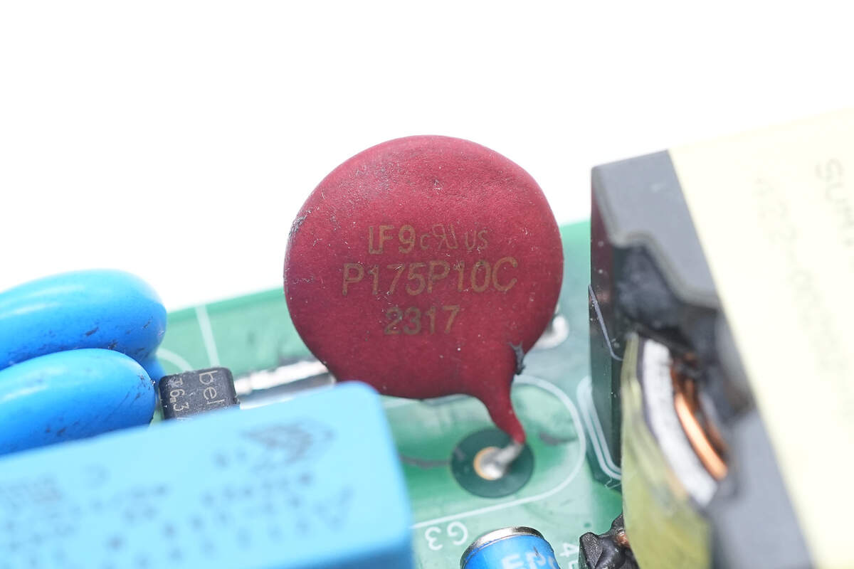

The varistor is from Littelfuse, marked with P175P10C, and used for absorbing overvoltage surges.

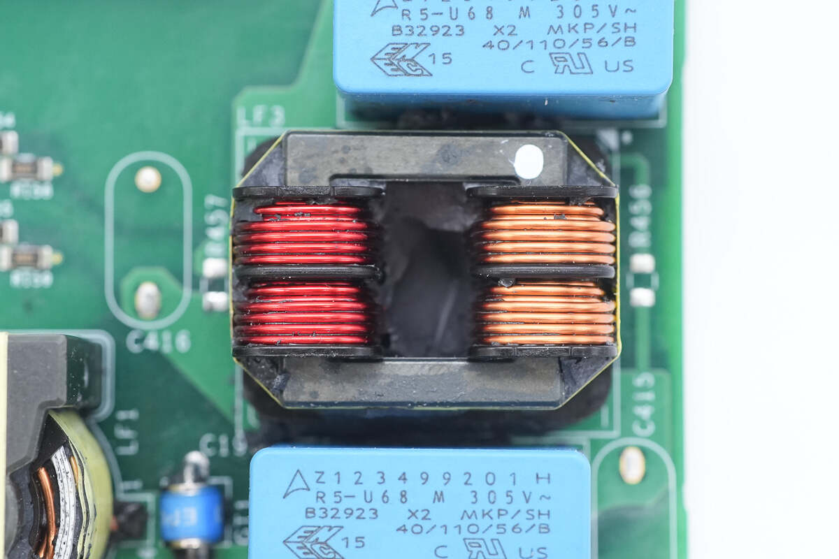

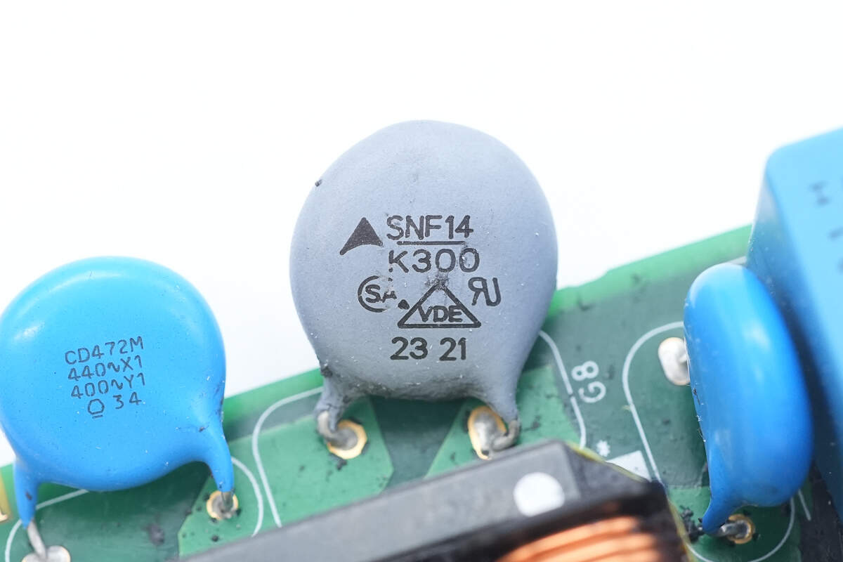

The common mode choke is wound with red and copper-colored enameled wires, and the magnetic core is insulated with wrapping tape.
The varistor is from TDK, marked with SNF14K300, and used for absorbing overvoltage surges.
The safety X2 capacitor is rated at 0.68μF.

Close-up of the blue Y capacitors.

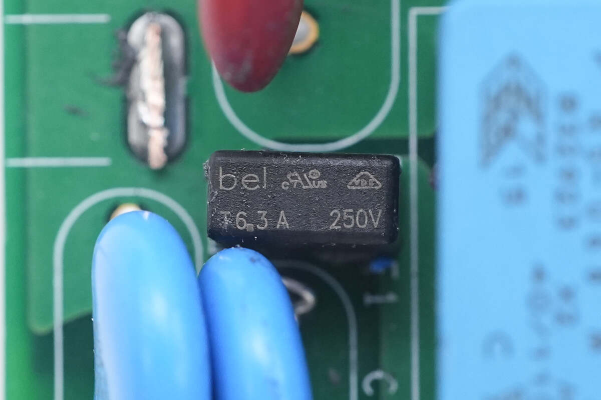

The fuse is from Belfuse, rated at 6.3A 250V.
Close-up of the gas discharge tube used for overvoltage protection.

The Littelfuse varistor is marked with P175P10C.
