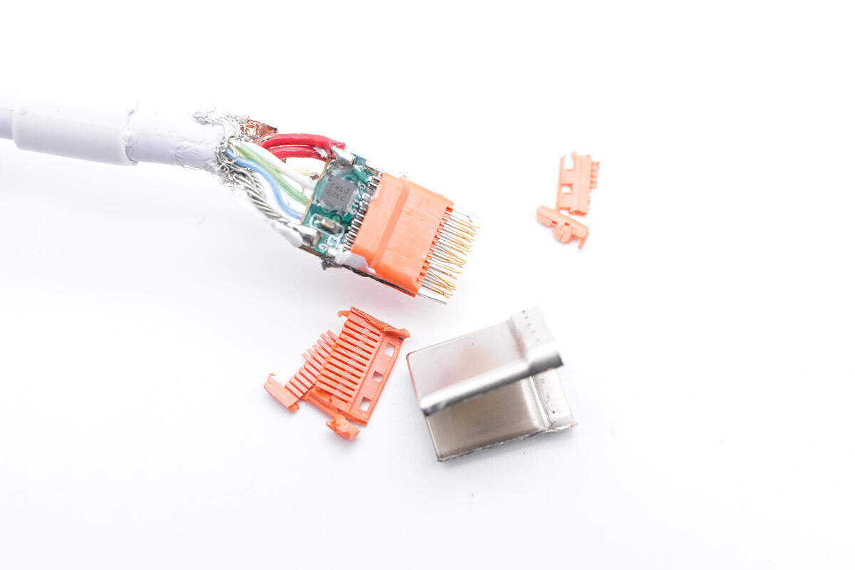

The E-Marker chip is soldered on the front, and the positive and negative wires for power supply are soldered on two sides.
Teardown of Baseus 240W USB-C Cable-Chargerlab
And the D+, D-, CC, and VCONN wires are on the back.
The E-Marker chip is from Hynetek HUSB332B. It is the first chip in the industry to get the USB PD3.1 eMarker certification, with a TID of 6773. It supports PD3.1 EPR 240W power transmission and USB4 Gen3 40Gbps data transmission, suitable for 240W USB Type-C to USB Type-C cables.
The HUSB332B also supports TBT3, USB3.2, USB3.1, and USB2.0. It comes with encryption function, which can be applied to device to cable identification, and its custom key facilitates customization by various manufacturers.

Continue to remove the stainless steel sleeve of the USB-C connector, and it adopts a "full-pin" design.
All internal pins are gold-plated.
