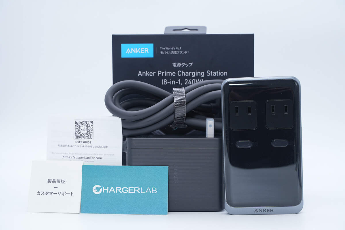

The packaging of the ANKER 240W 8-in-1 charging station contains the charging station, the 253W power adapter, and some documents.

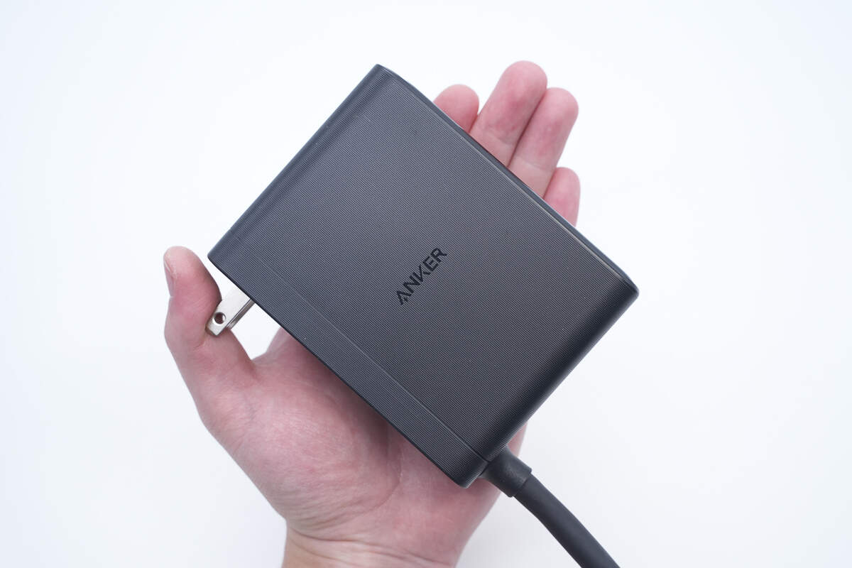

The design style of this power adapter is simple. The DC output end comes with a cable, but the connector is a special plug.
Teardown of ANKER 253W GaN Power Adapter (A91B2-Adapter)-Chargerlab
The power adapter has a bumpy texture on its surface.

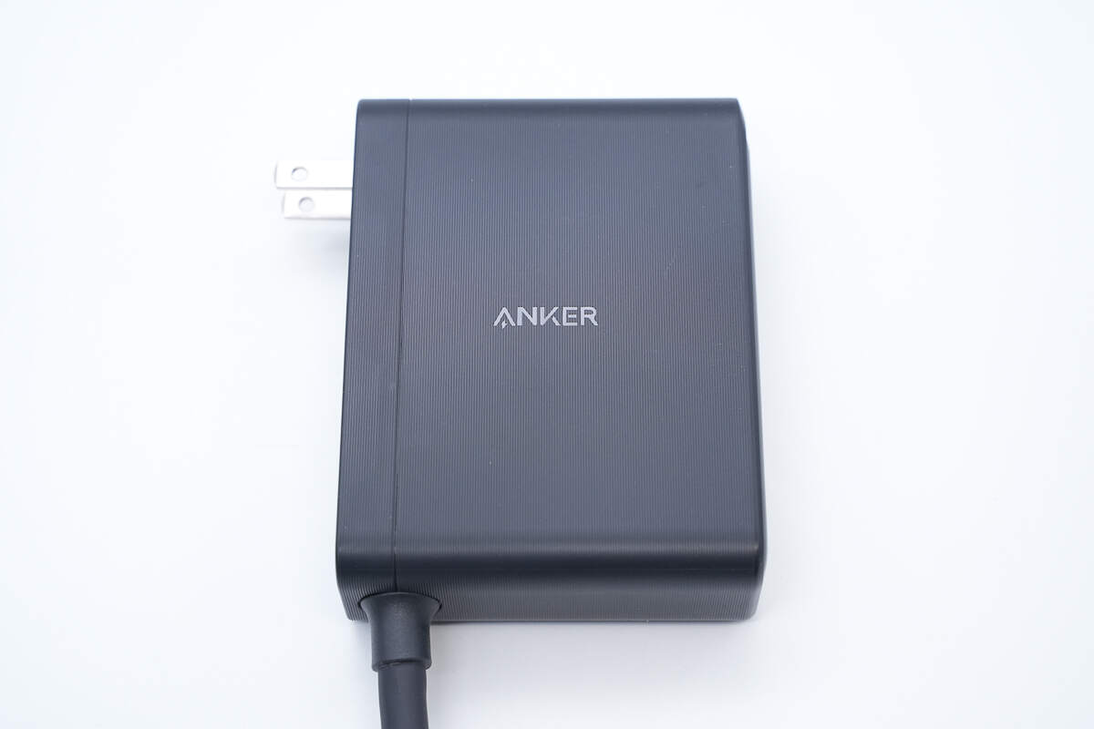

ANKER is engraved in the center of the front.

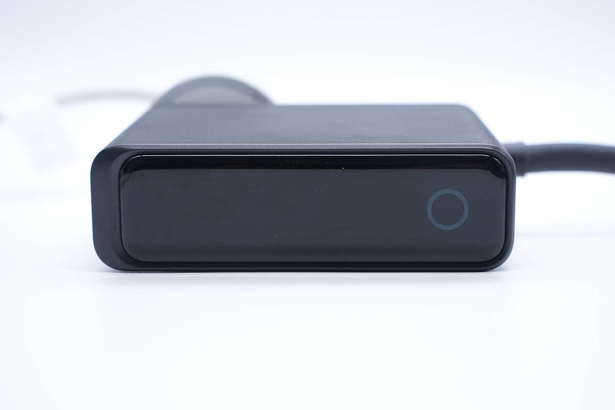

The top is decorated with a bright panel, and there is a light ring on the side close to the output end to indicate whether it is powered on.

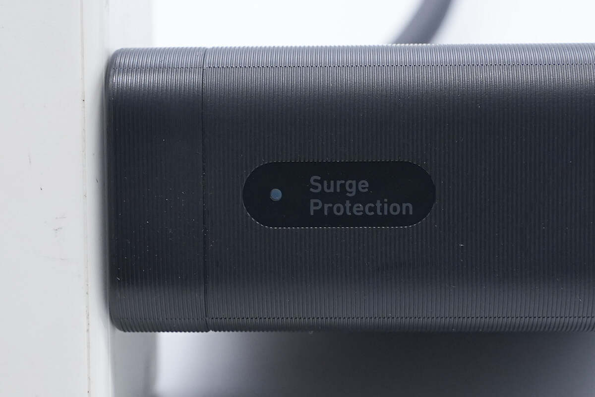

It also has a surge protection indicator light on the front.

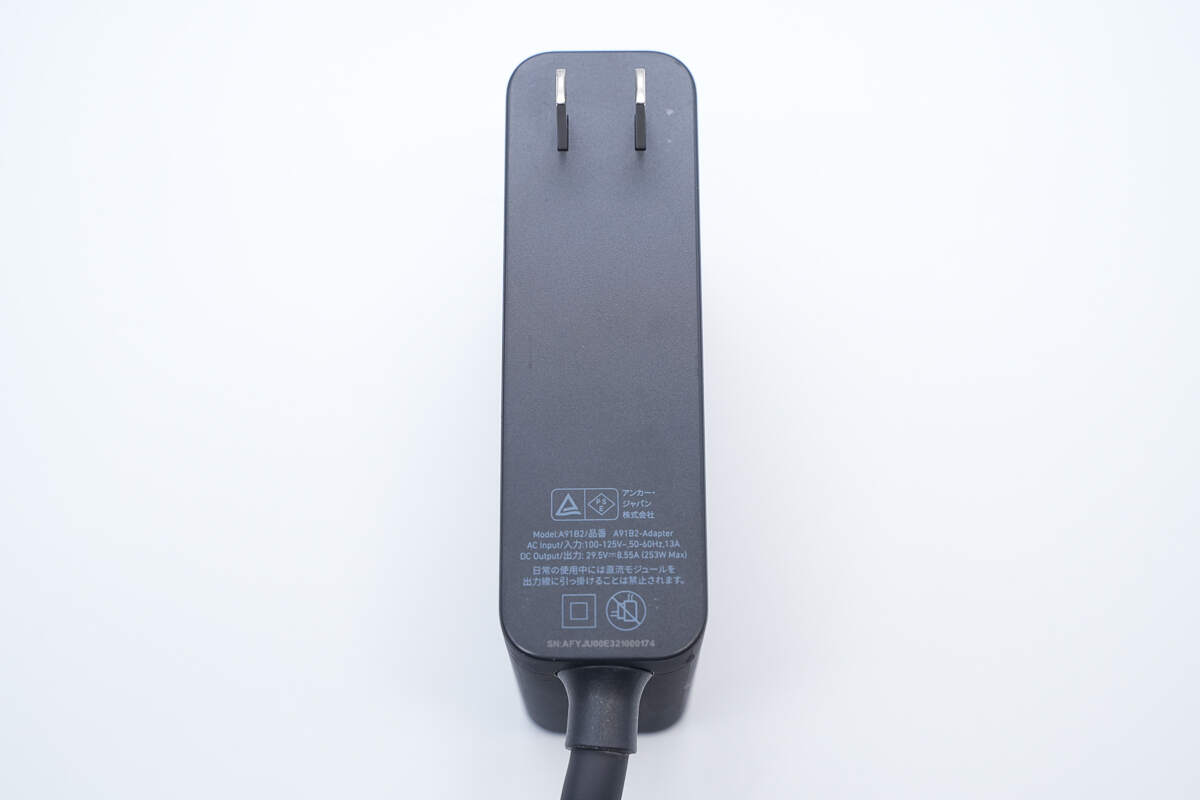

The spec info is printed on the bottom.
Model: A91B2-Adapter
AC Input: 100-125V~50/60Hz 13A
DC Output: 29.5V8.55A (253W Max)
It has passed PSE certification.

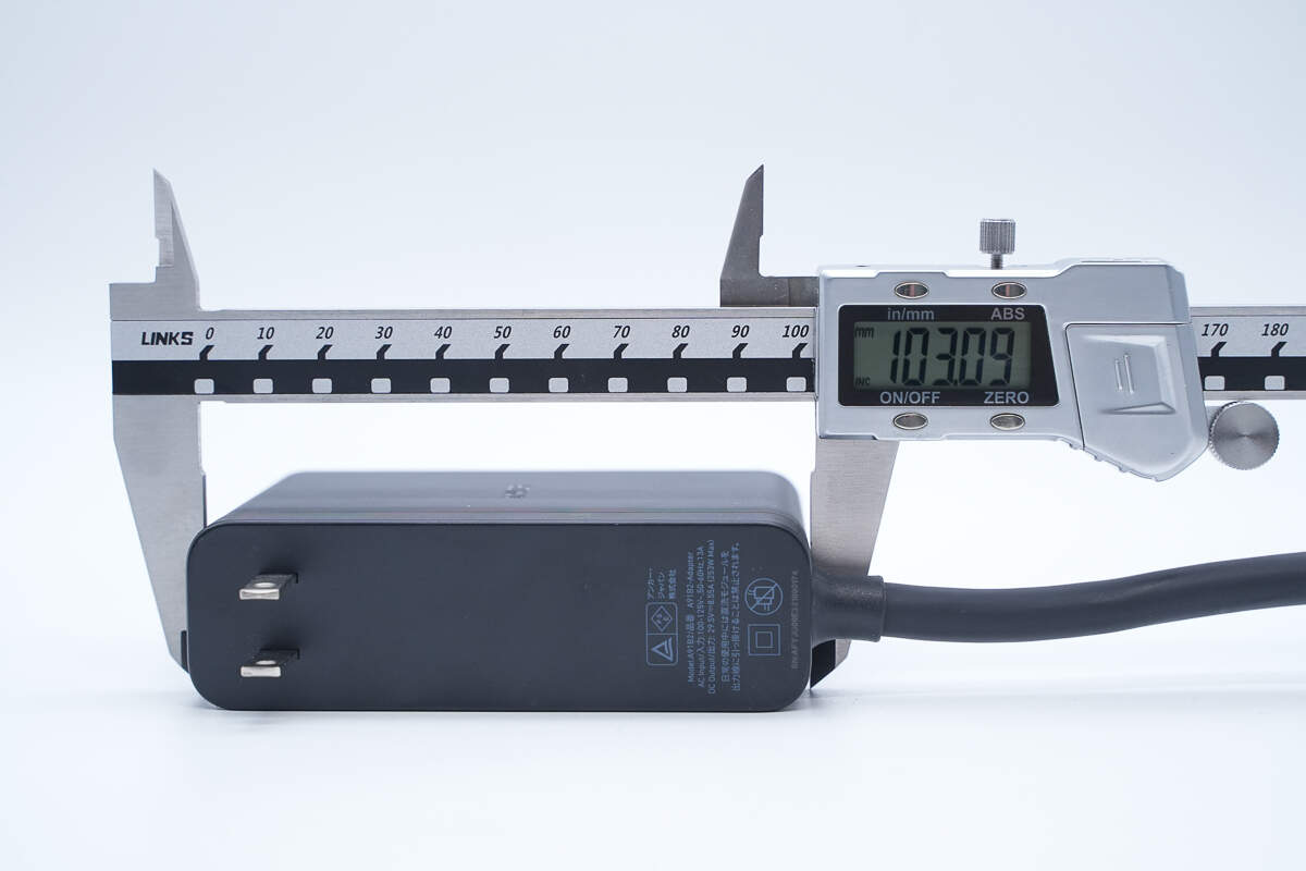

The length of the power adapter is about 103.09 mm (4.059 inches).

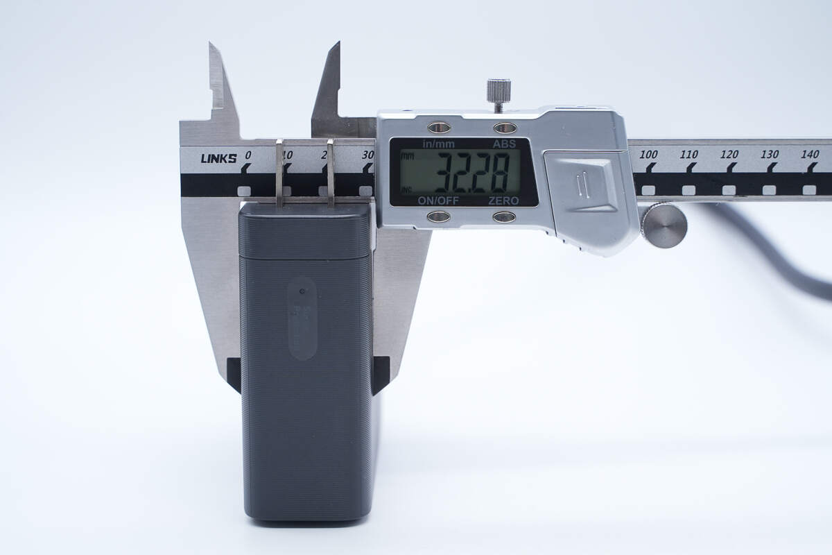

The width is about 32.28 mm (1.27 inches).

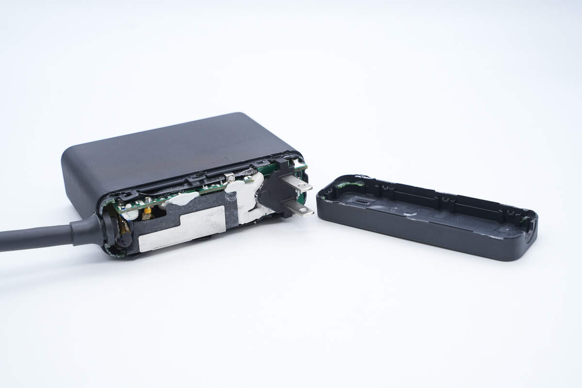

First, pry along the gap to open the input end cover.
The input pins are reinforced and protected by a plastic frame.

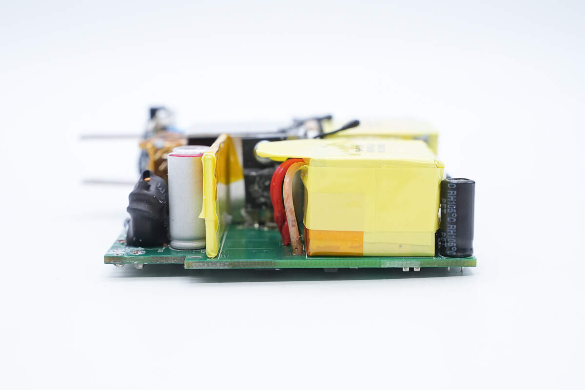

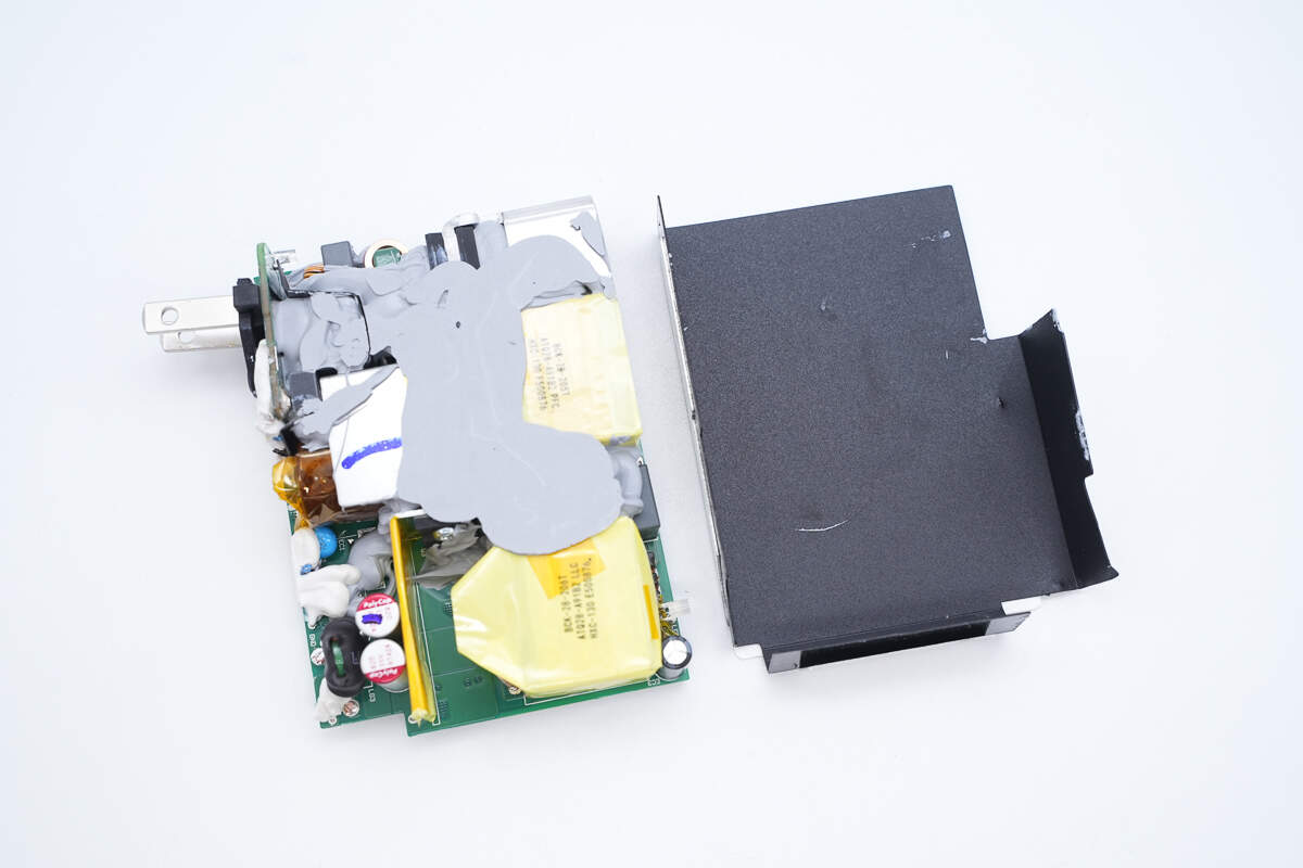

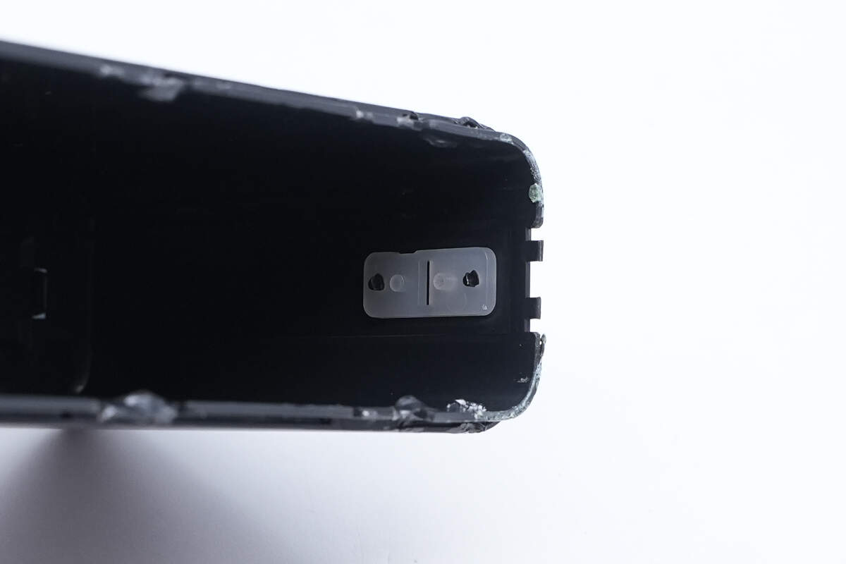

Take out the PCBA module, and there is a light guide on the inside of the case.
The length of the PCBA module is about 96.91 mm (3.82 inches).
The width is about 71.95 mm (2.83 inches).
The thickness is about 27.56 mm (1.085 inches).

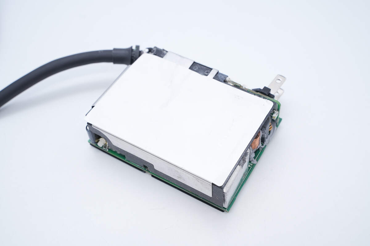

The PCBA module is covered with a heat sink, and the heat sink and the PCBA module are insulated with Mylar sheets.
Remove the heat sink. The components on the front of the PCBA module are filled with potting compounds to help dissipate heat.
The components on the back are also filled with potting compounds to help dissipate heat.

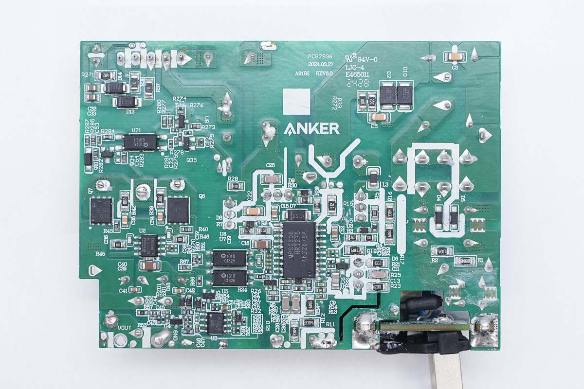

Clean off the potting compound. The front of the PCBA module includes components such as a bridge rectifier, PFC MOSFET, primary MOSFET, and synchronous rectifier. All of them are equipped with heat sinks to help dissipate heat and thermistors for temperature detection.
On the back are components such as a master control chip, synchronous rectifier controller, synchronous rectifier, optocoupler, etc.

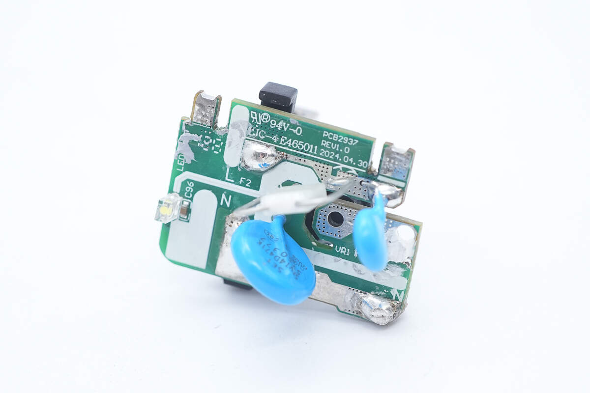

The input pins are soldered on a separate PCB. There is an SMD Y capacitor in the middle of this side. On the right is the electrolytic capacitor for input filtering, wrapped with heat-resistant tape for protection.
Take off the PCB of the pins, there is a varistor, thermal fuse, Y capacitor, and indicator light on the back.

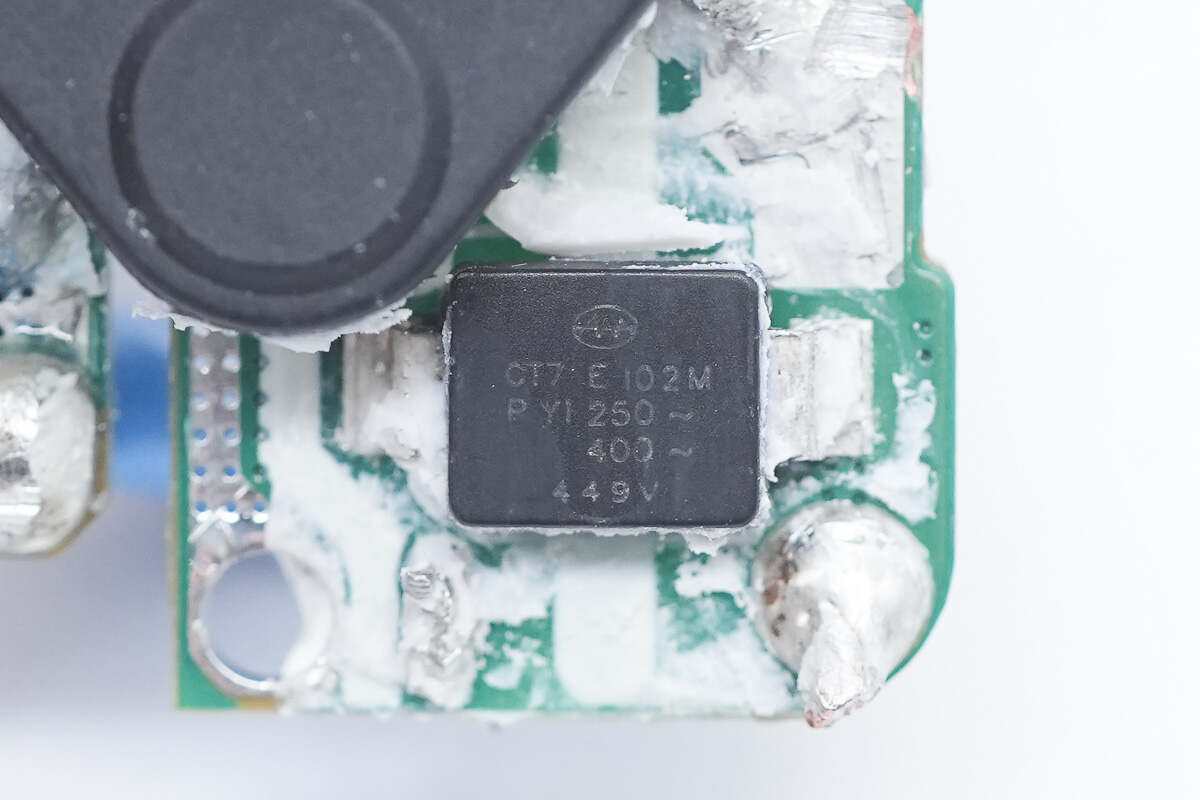

The SMD Y capacitor is from KeiFat.

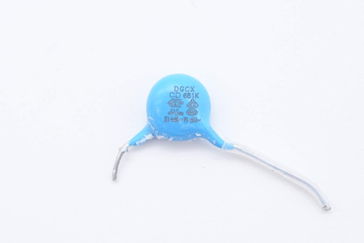

The blue Y capacitor is from DGCX.

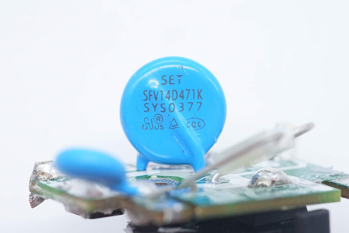

The varistor is from SET. It is an SFV14D series and is used for surge overvoltage protection. 470V. Model is SFV14D471K.

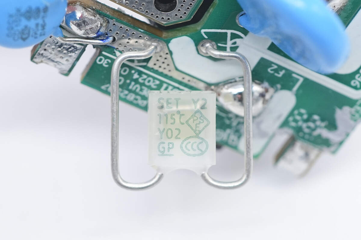

The thermal fuse is also from SET. It is a Y2 series 115℃ thermal fuse, used to detect the temperature rise of the varistor and provide overheat protection.

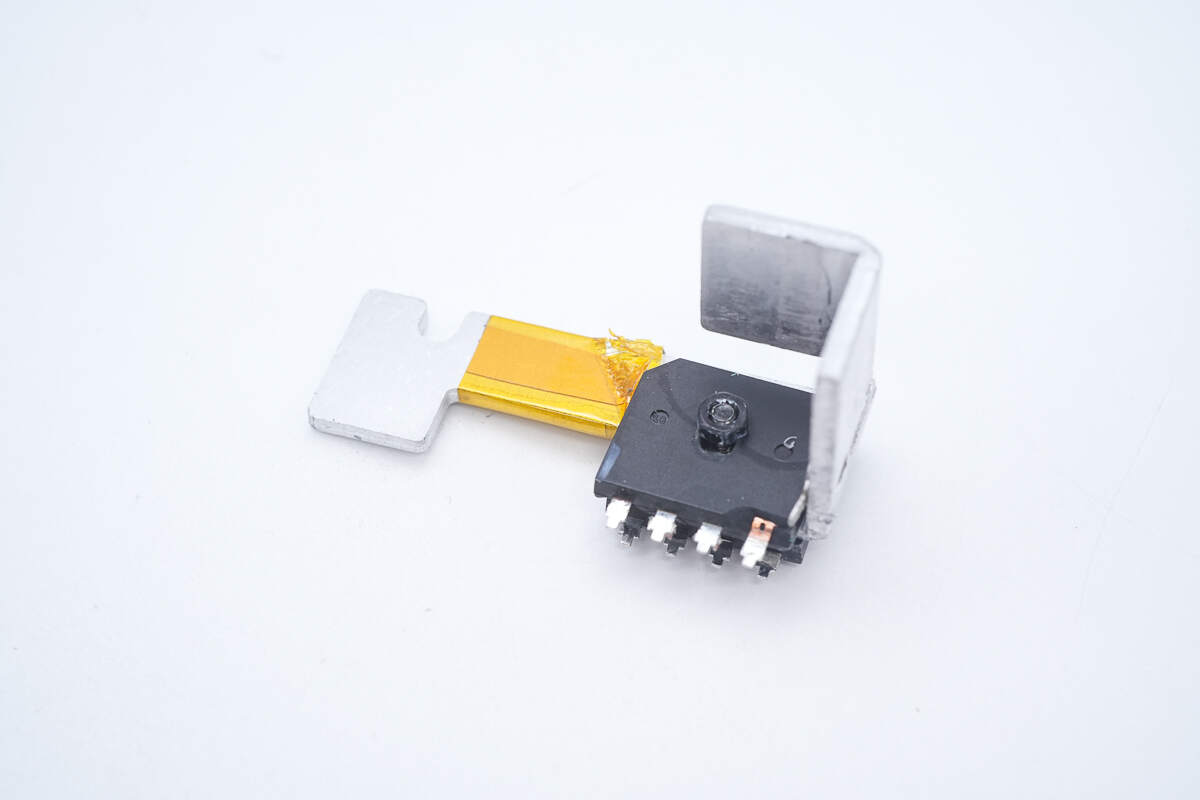

This side of the PCBA module has common mode inductors, safety X2 capacitor, and bridge rectifier.
Remove the bridge rectifiers and heat sink. The two bridge rectifiers are fixed on both sides of the heat sink by screws.

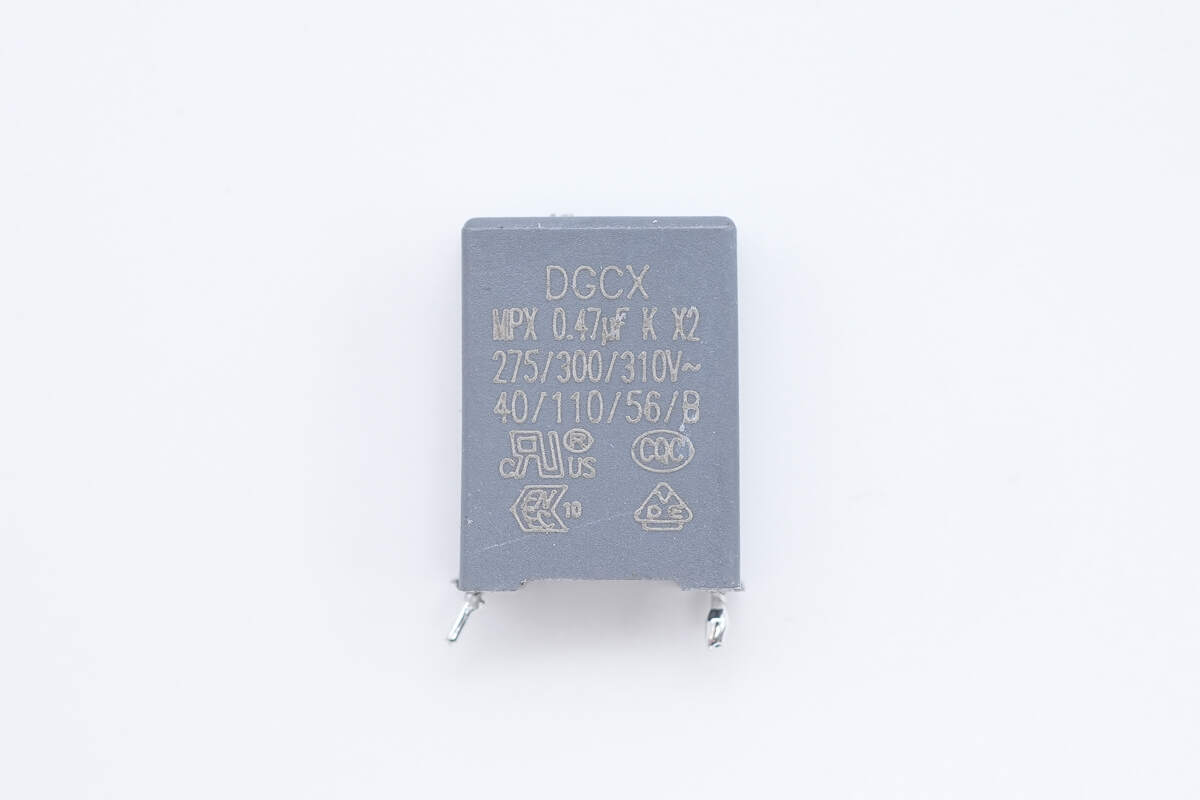

The safety X2 capacitor is from DGCX. 0.47μF.

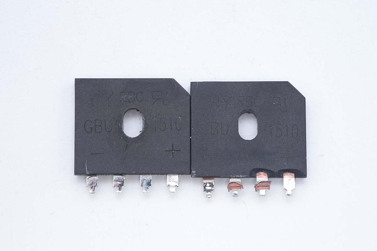

The two bridge rectifiers are from Pingwei and adopt GBU package. 15A 1000V. Model is GBU1510.

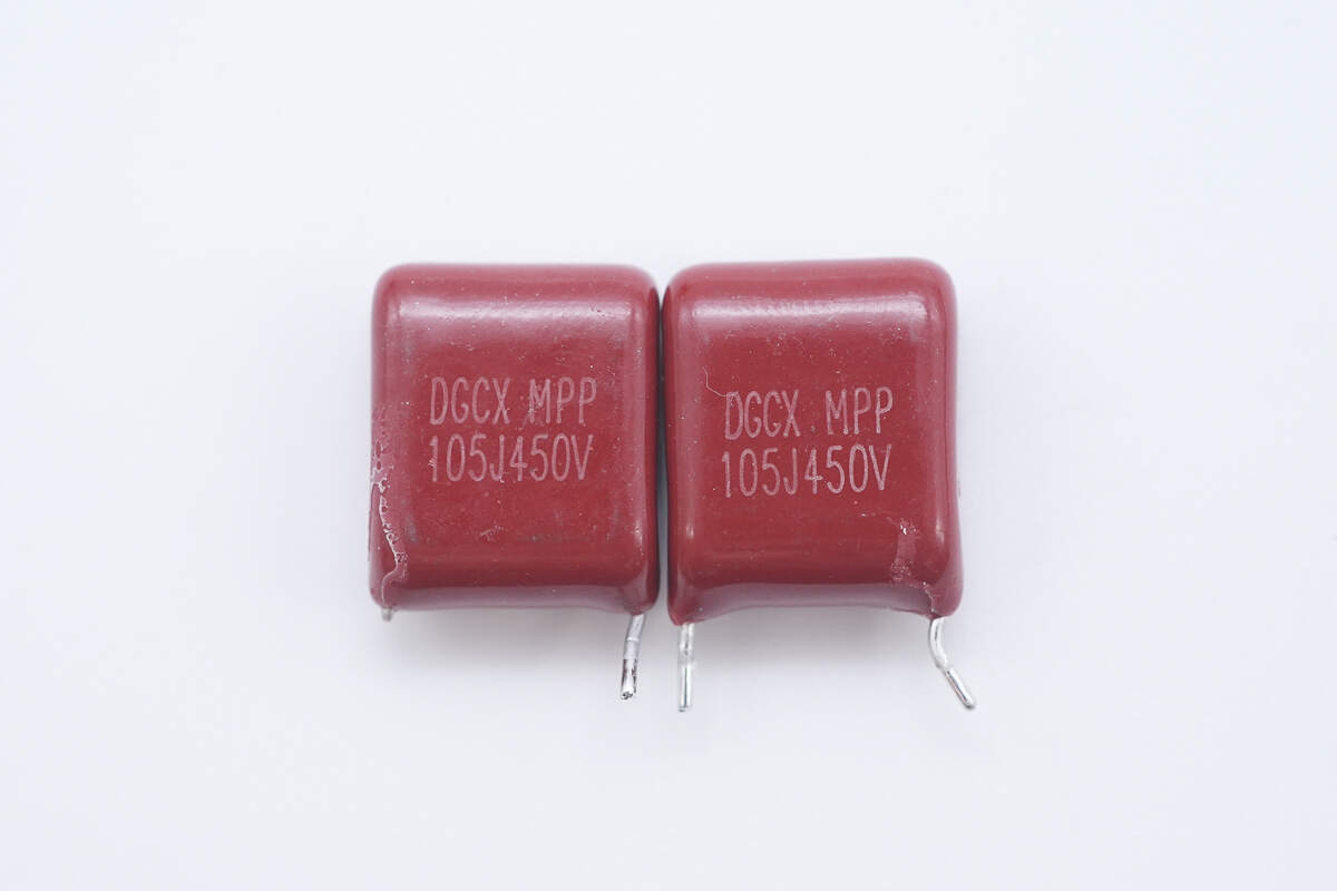

These two MPP film capacitors are also from DGCX. 1μF 450V.

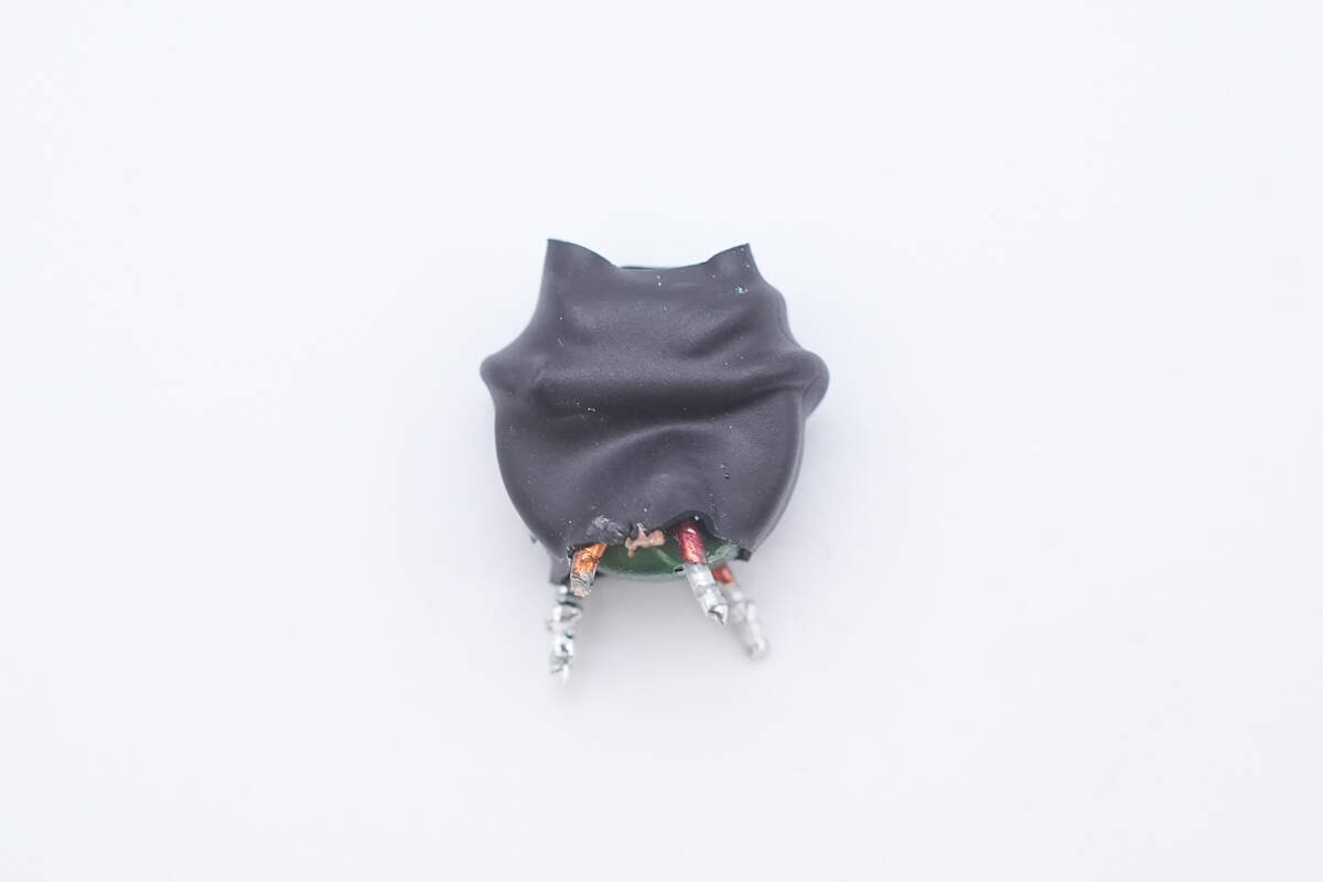

The filter inductor is insulated by heat-shrinkable tubing.

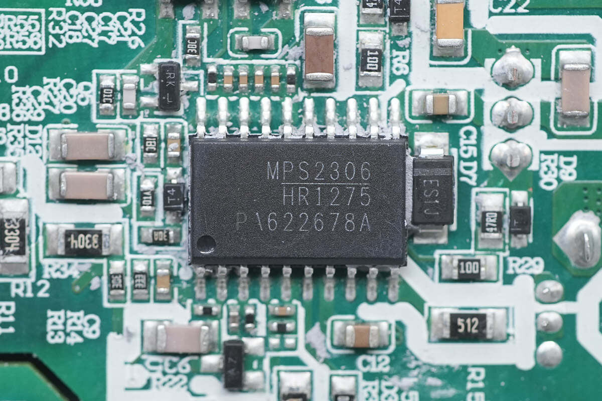

The master control chip is from MPS. It adopts critical and discontinuous mixed-mode PFC control with the current mode, which can be configured through the UART interface. It has built-in power-saving technology to help achieve efficiency optimization in the whole working range. It has built-in high voltage startup and X capacitor discharge and supports PG signal output. Model is HR1275.

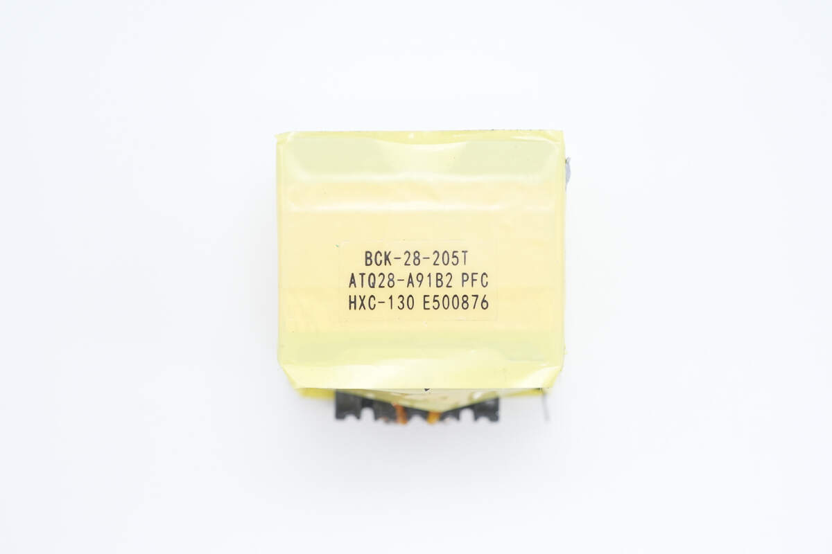

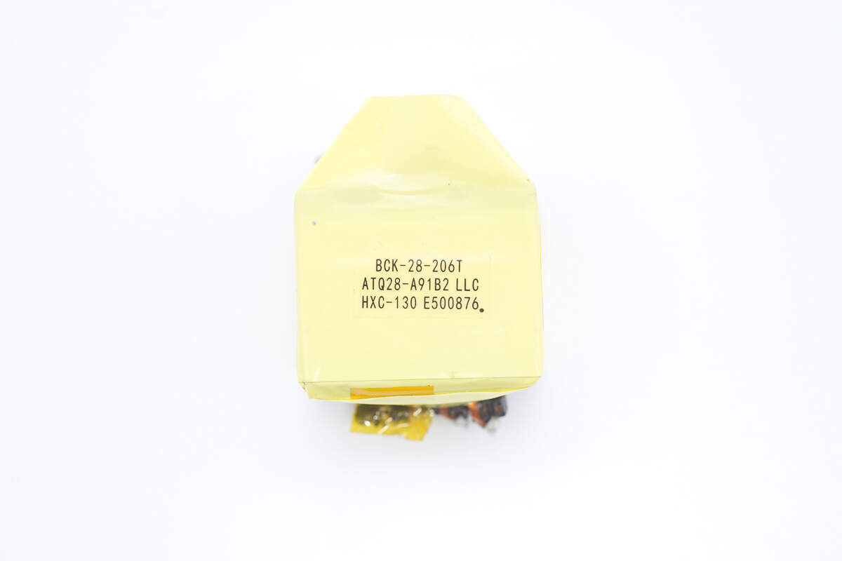

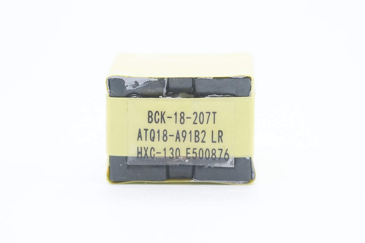

The PFC boost inductor adopts the ATQ28 core.

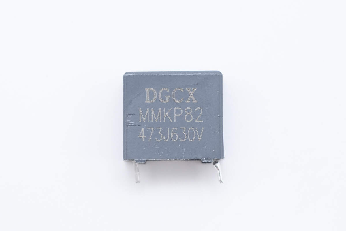

The resonant capacitor is from DGCX. 0.047μF 630V.

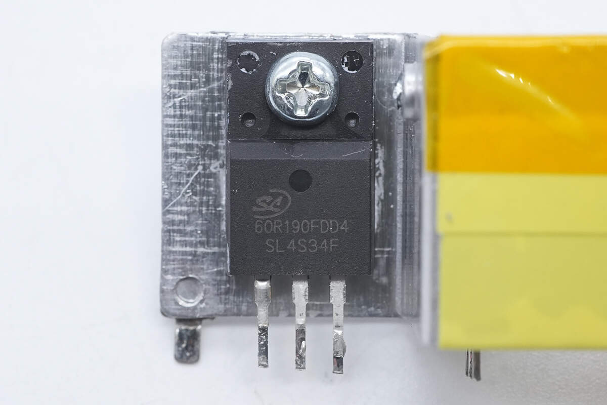

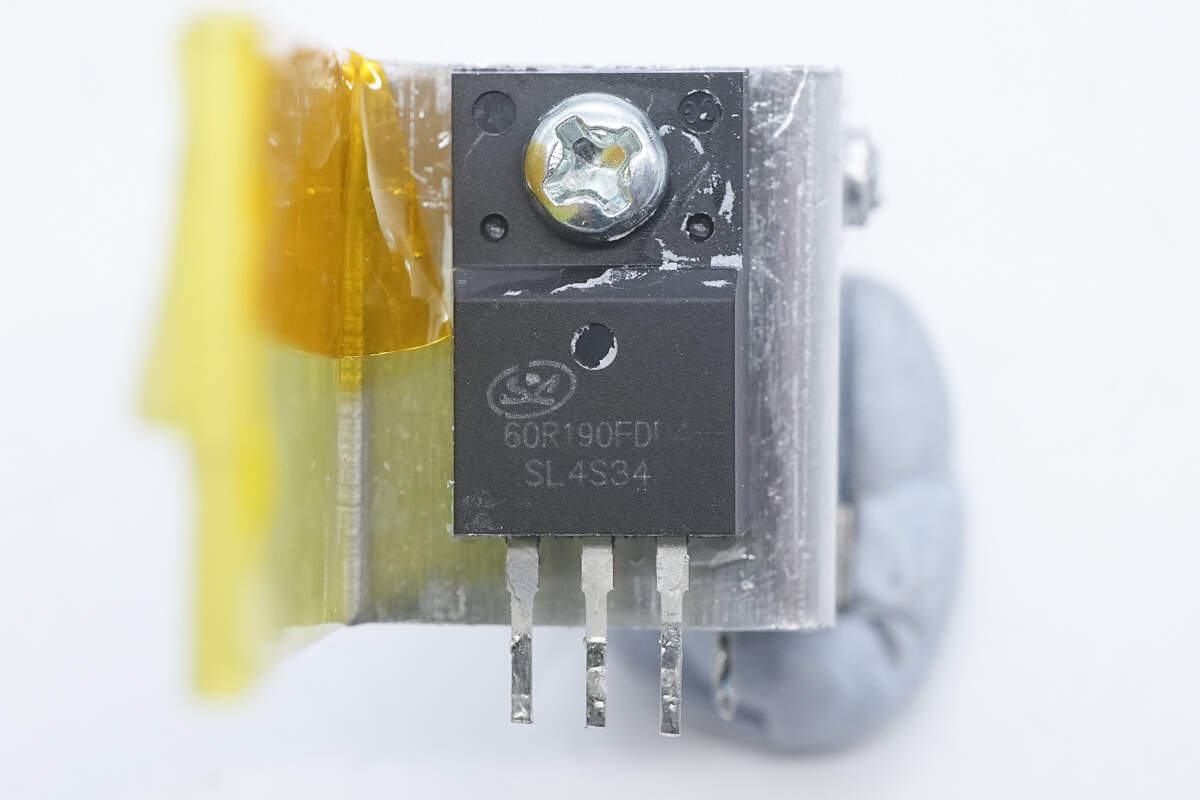

Remove the third heat sink, with two LLC half-bridge MOSFETs fixed on it.
The LLC half-bridge MOSFET is from Silan and adopts TO-220FJD-3L package. It has a withstand voltage of 600V and a resistance of 0.165Ω. Model is SVS60R190FJDD4.
The second LLC half-bridge MOSFET is identical to the first one.

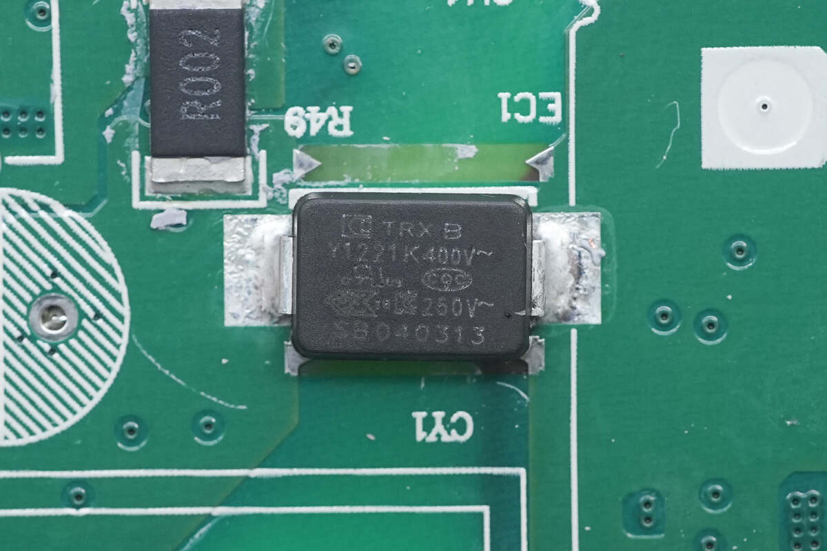

The SMD Y capacitor is from TRX. Its small size and light weight are suitable for high-density power products such as GaN fast chargers.

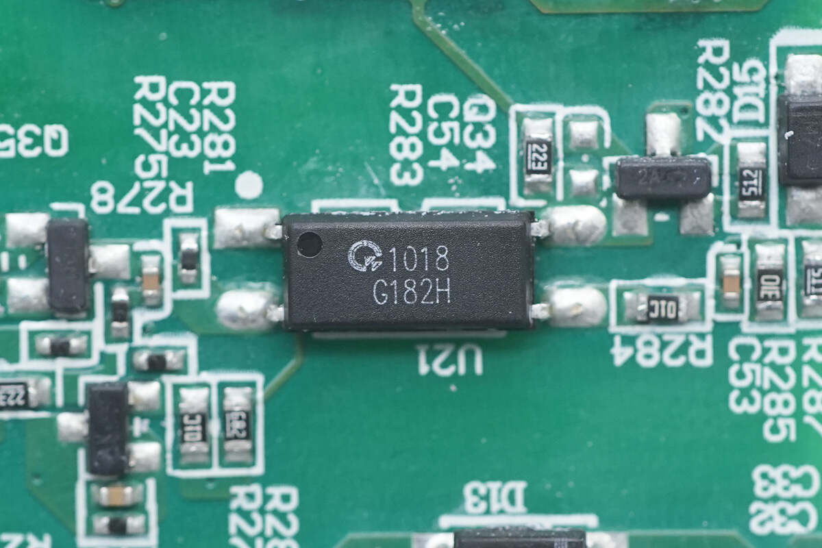

These two optocouplers marked with 1018 are used for output voltage feedback and protection functions.
This is the third optocoupler.

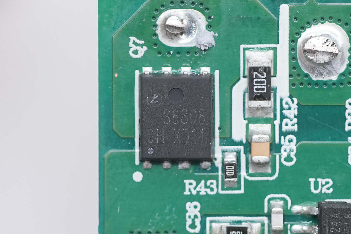

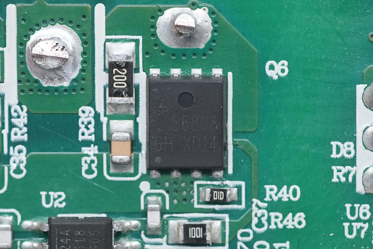

The synchronous rectifier is marked with S6808.
The other synchronous rectifier is also marked with S6808.

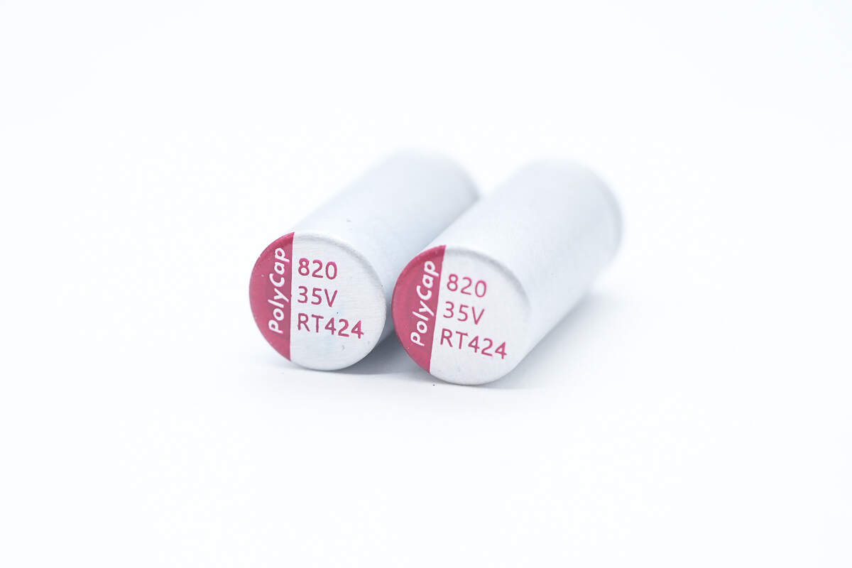

These two solid capacitors for output filtering are from Polycap. 35V 820μF.

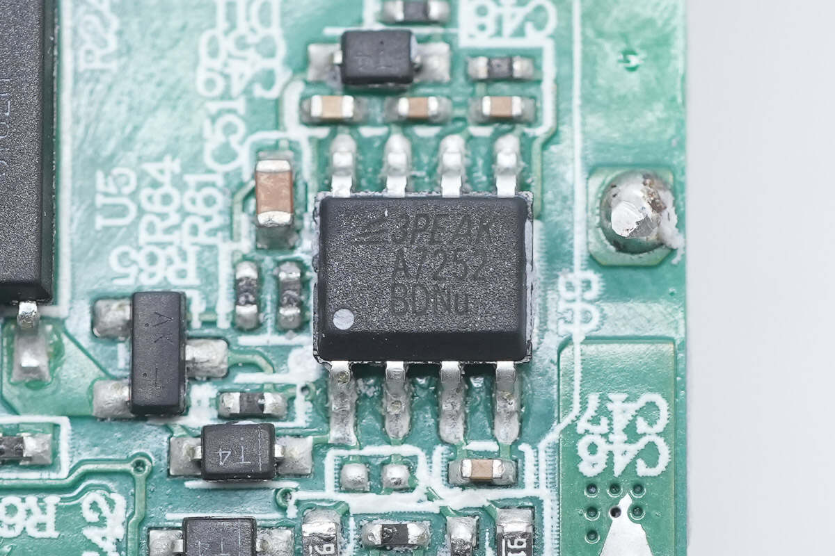

The Op-Amp is from 3PEAK. Model is TPA7252.

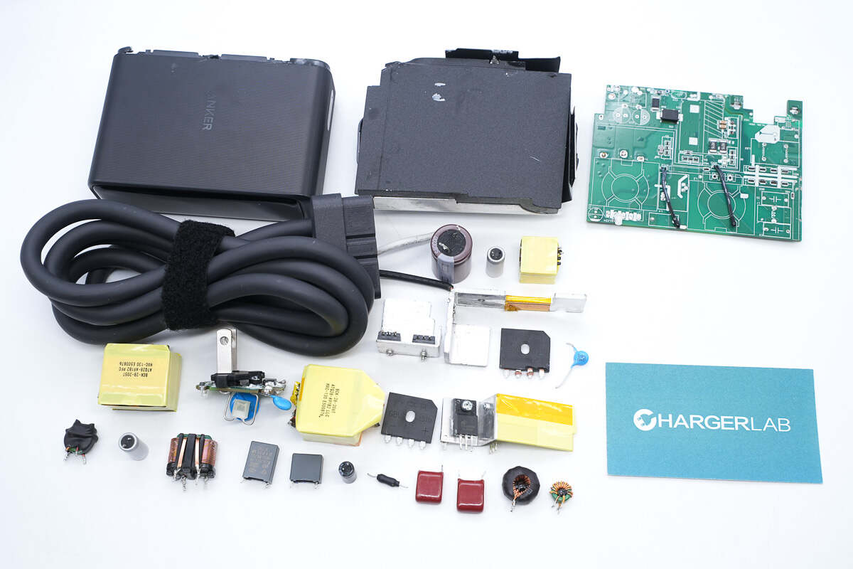

Well, those are all components of the ANKER 253W GaN Power Adapter.

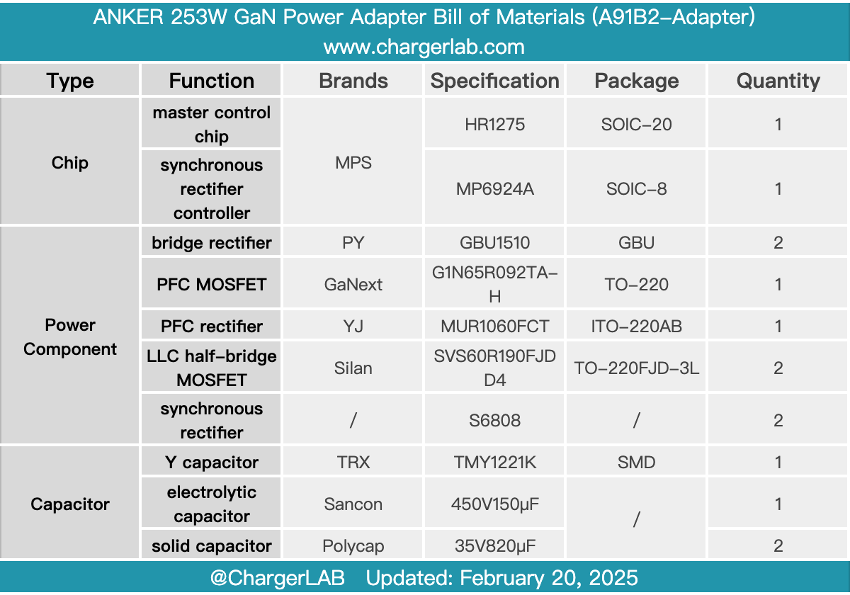

Here is the component list of the ANKER 253W GaN Power Adapter for your convenience.
The design of the Anker 253W GaN power adapter continues its style and is equipped with an indicator light for surge protection and a light ring to indicate whether it is powered on, enhancing the user experience. Because of its unique output connector, it can provide AC or DC power supply.
After taking it apart, we found it adopts a PFC+LLC+SR power supply architecture design. There are many heat sinks inside, the PCBA module is filled with potting compound and covered with a large heat sink to help dissipate heat. The workmanship and materials are solid and reliable.
