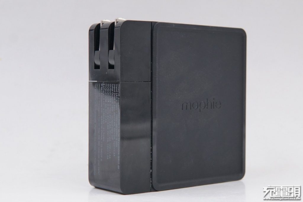

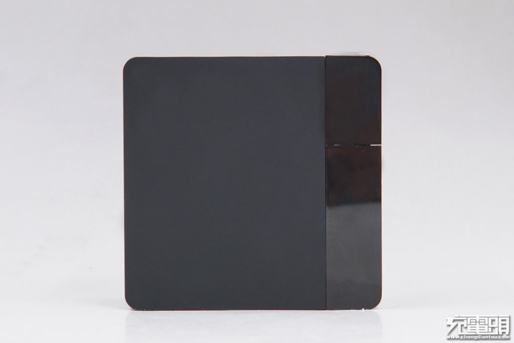

It is a black rounded square with a two-tone matte-and-glossy finish.
Mophie Powerstation Hub Teardown Review: All in One-Chargerlab

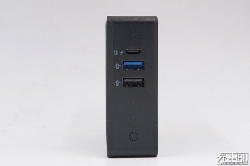

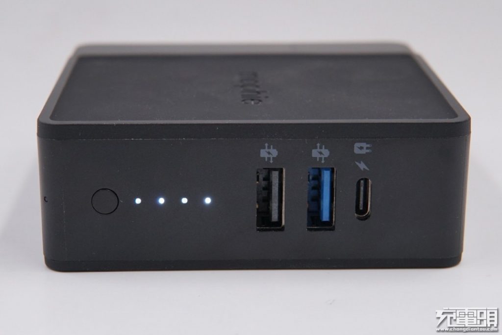

From top to bottom: USB-C bi-directional input and output port, two USB-A output ports, LED indicators, and power button.

Interchangeable adaptor with foldable prongs.

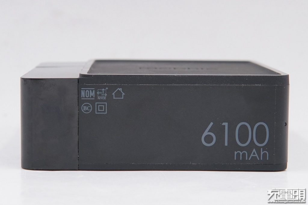

It is also a power bank with 6100mAh capacity.

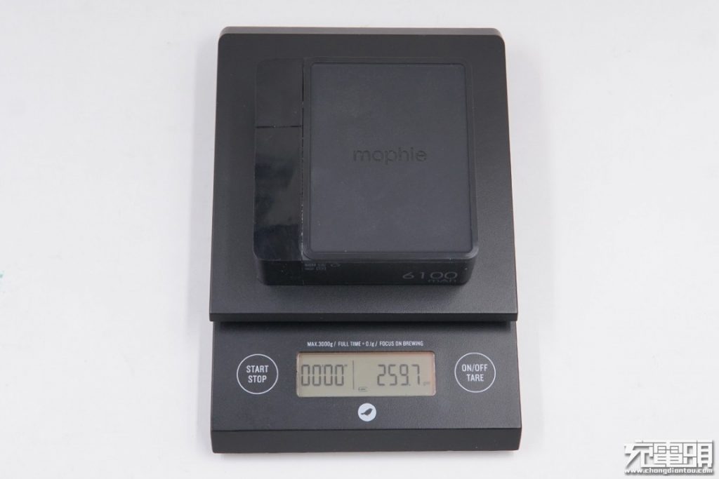

It weights 259.7g/9.16oz.

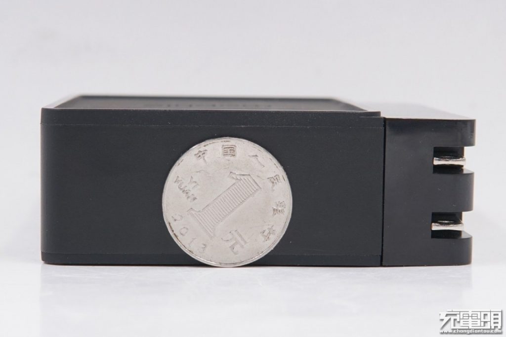

Dimensions: 84 x 84 x 29.5mm. It is slightly bigger than the Apple 87W PD charger for MacBook Pro 15.

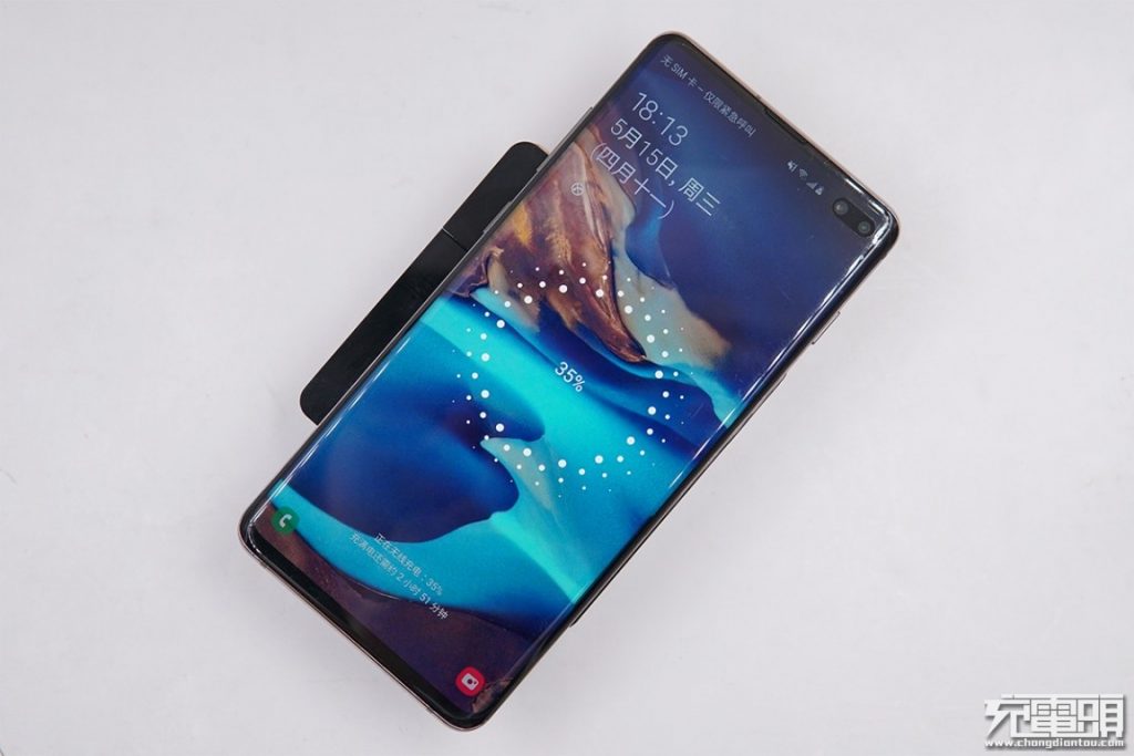

It starts charging instantly when we put the phone on top.

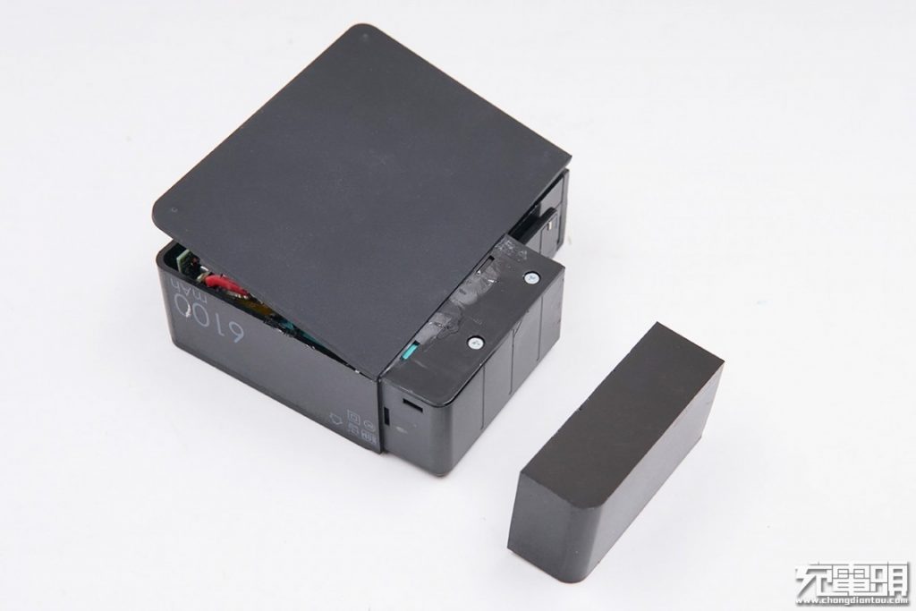

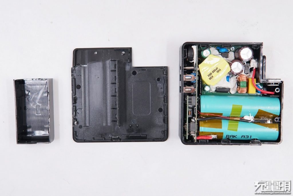

Remove the adapter first.
Remove the glossy part of the casing.
Remove the larger cover.
Taking a look at the components.

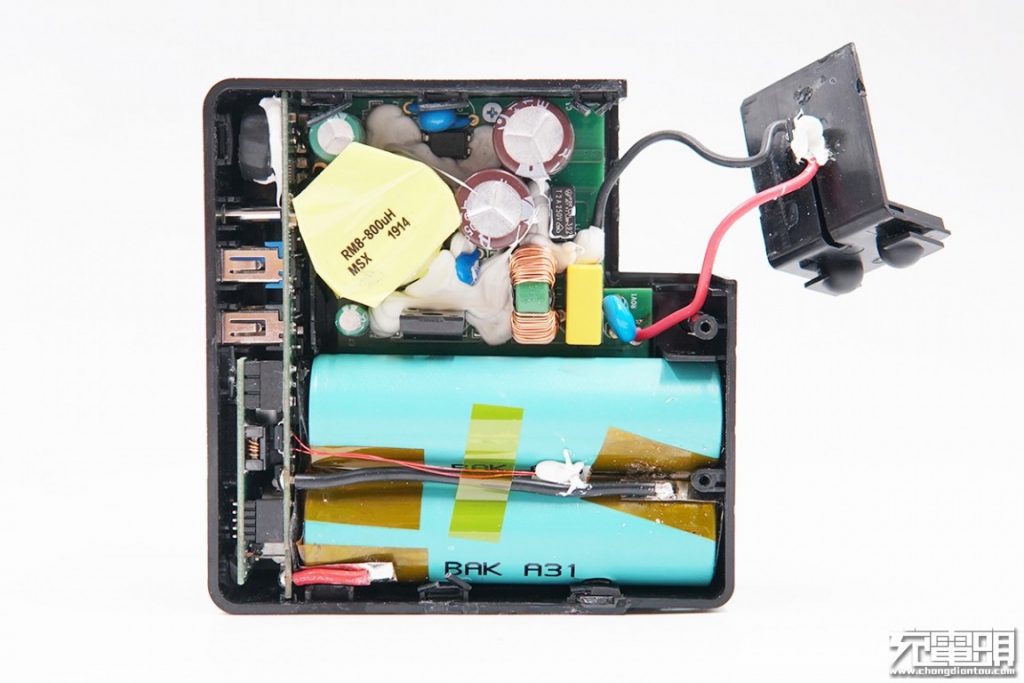

Take the assembly out of the housing. We have a PCBA and two batteries.

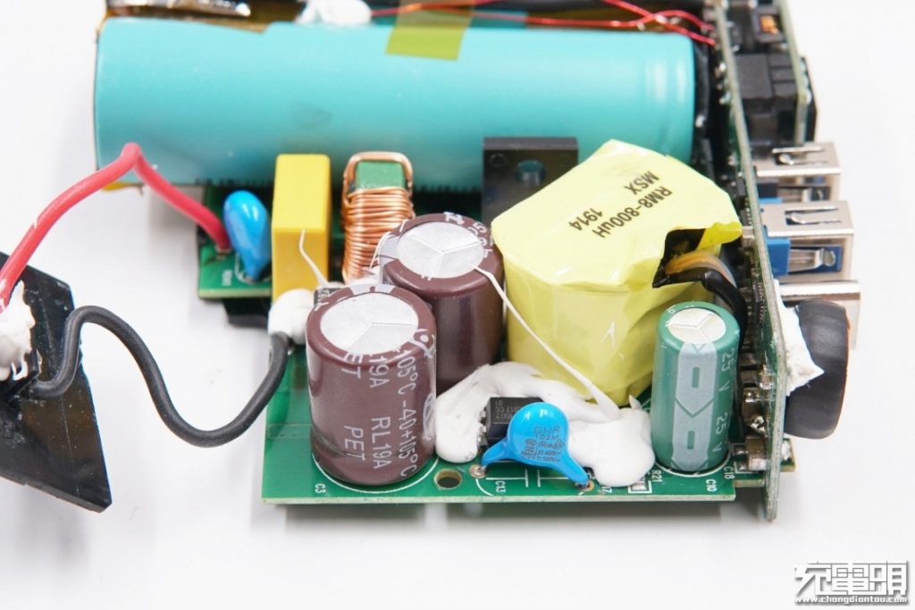

Next to the battery cell are components responsible for the power adapter part.

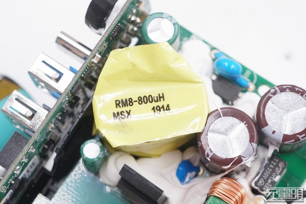

The transformer.
A UTC 7N65KL field effect MOS tube, primary switching tube.

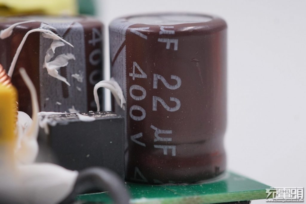

A 400V, 22μF capacitor.

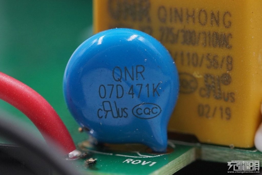

Input protection varistor.

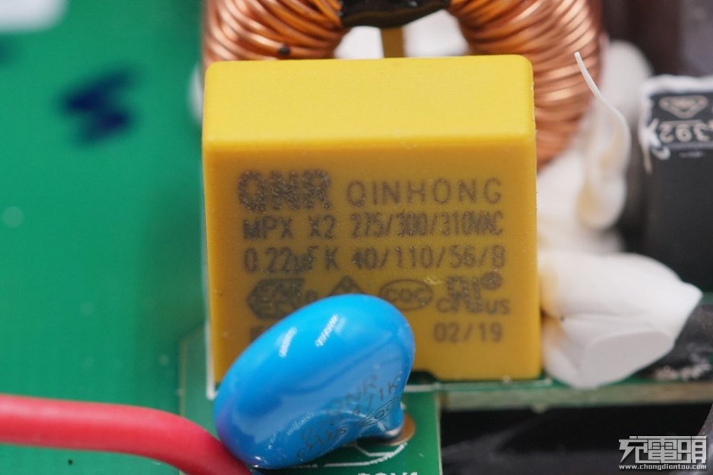

A 0.22μF X capacitor.
A common mode choke.

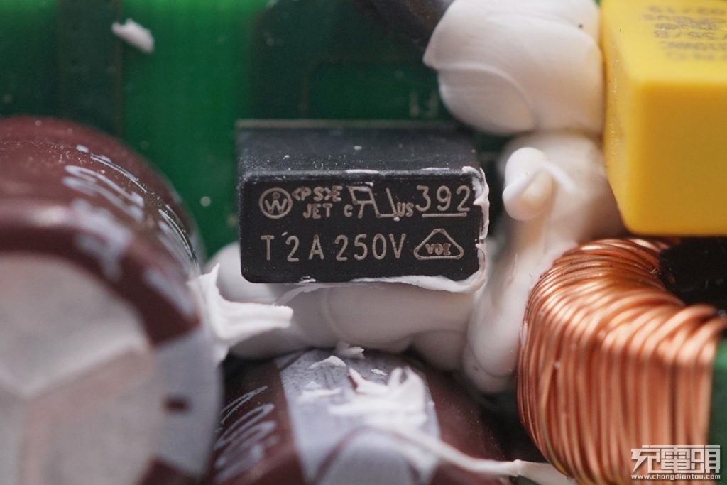

Time delay fuse with letter code T2A for input protection.

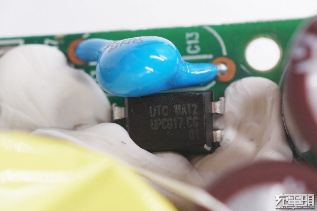

A UTC, UPC817 feedback optocoupler.

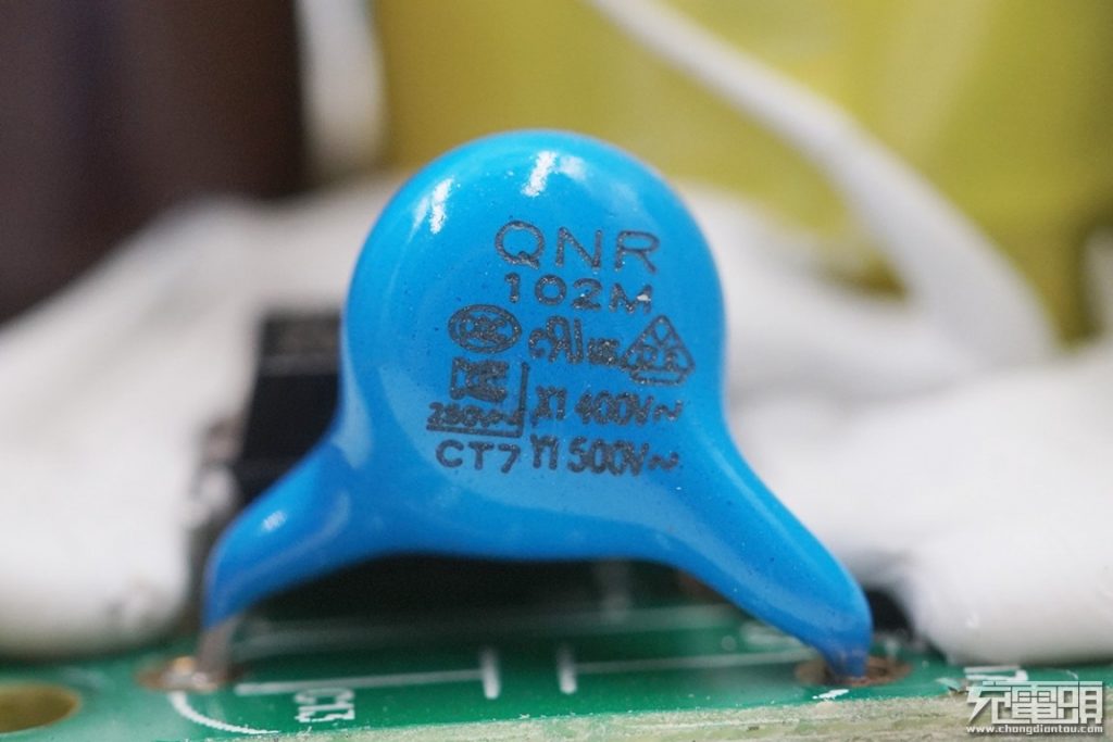

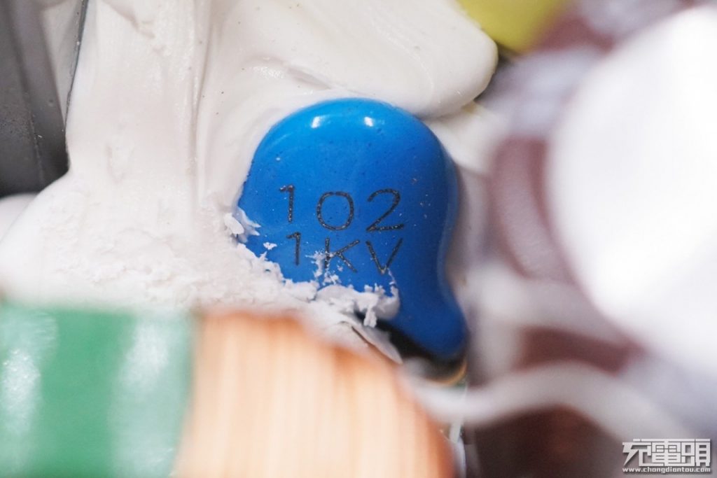

A Y capacitor.

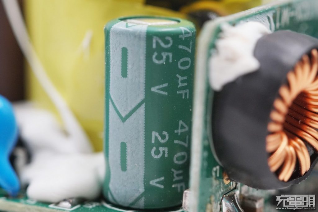

A 25V, 470μF capacitor.
White glue is filled between the components.

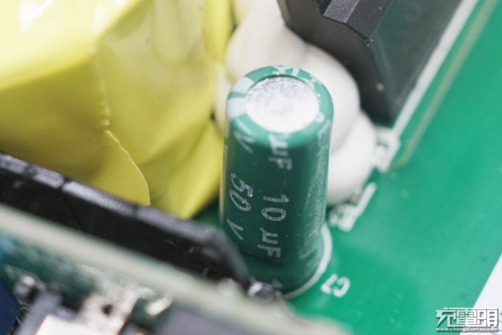

A 50V, 10μF capacitor powers the PWM controller.

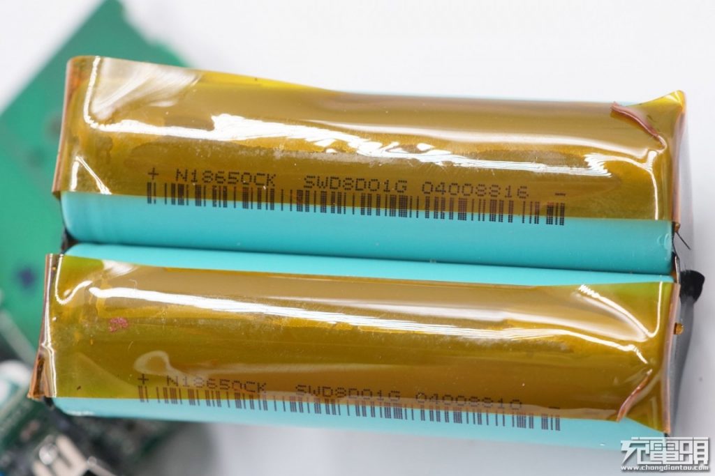

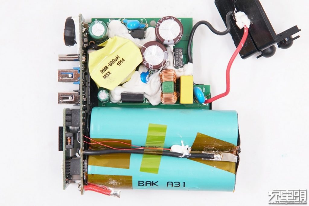

Taking a look at the batteries.
18650 format, made by BAK with A31 letter code.
The battery is insulated with mylar tapes.
Two batteries are connected in parallel.

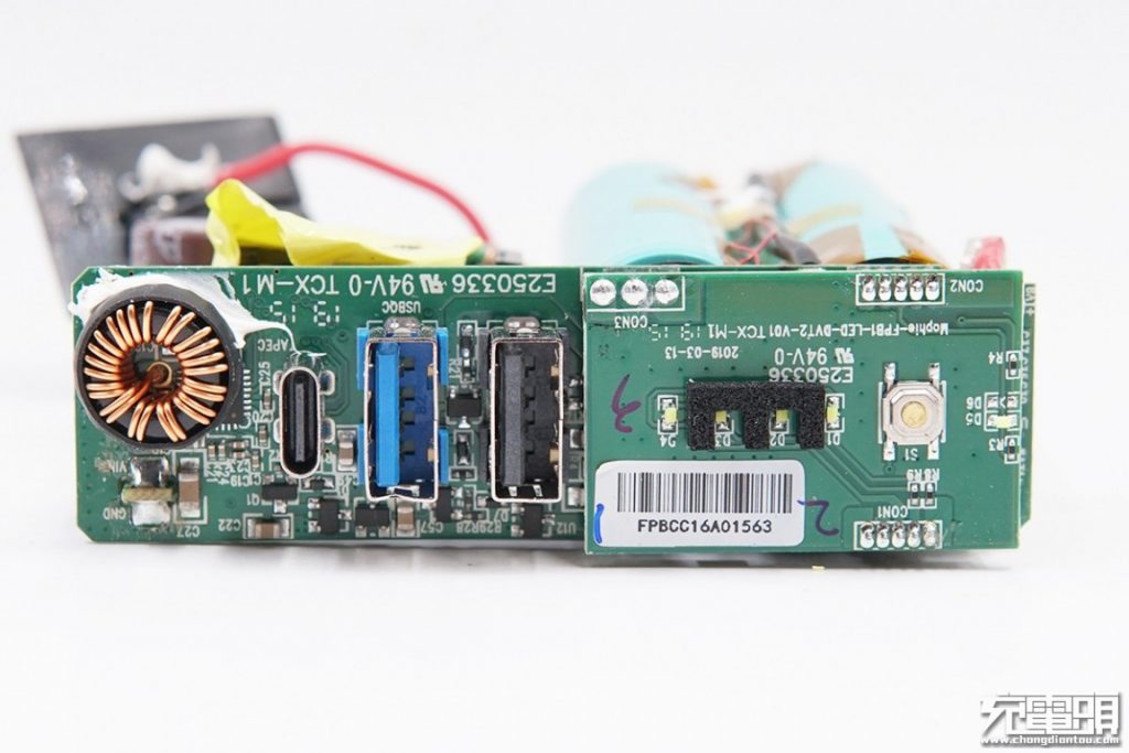

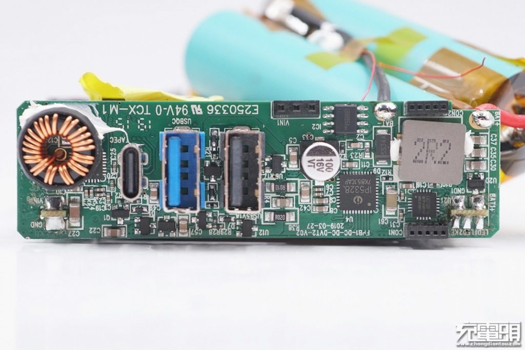

The parts responsible for power management of the charger and the power bank, with a daughter board connected to it with pins.

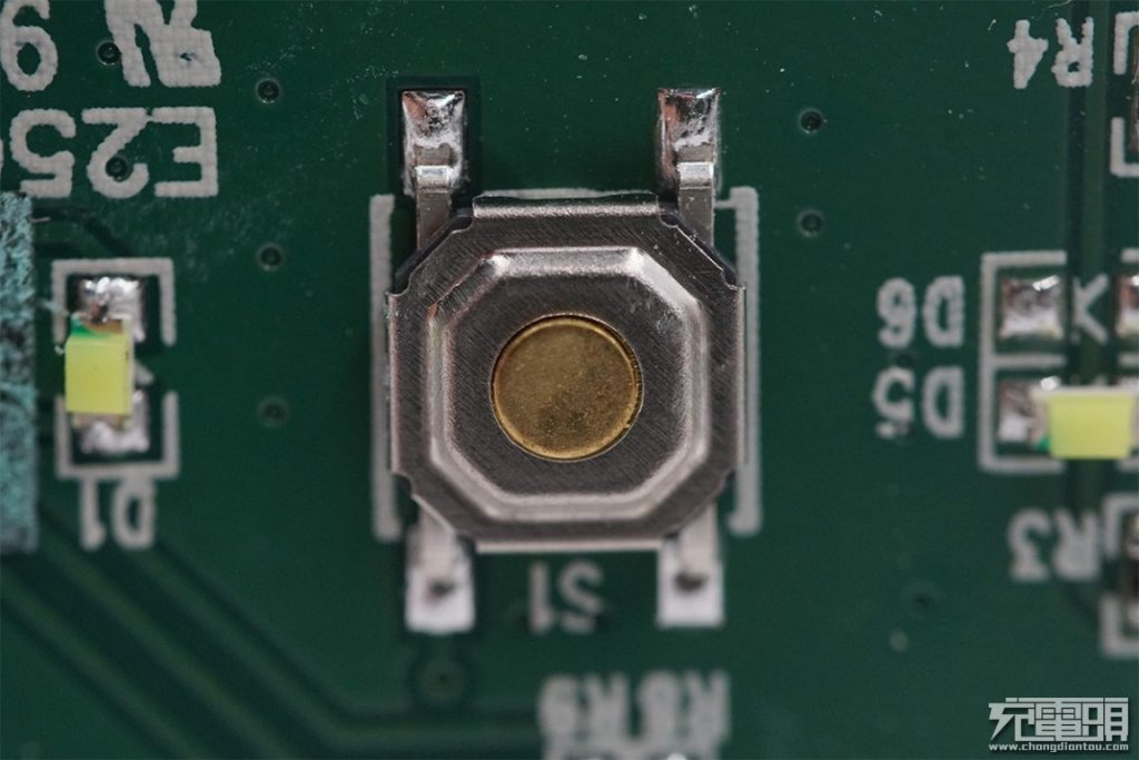

Close-up of the power button.

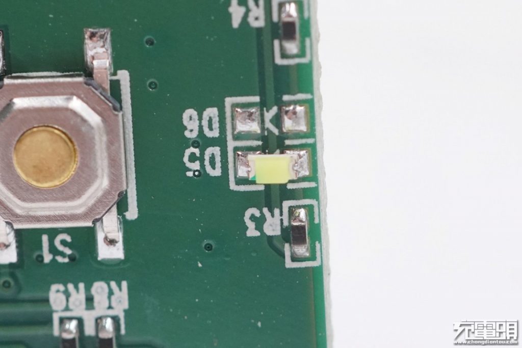

It has an LED indicator besides it.

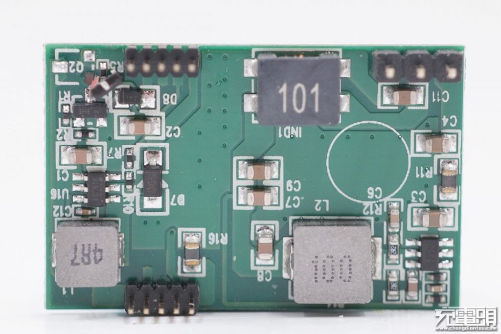

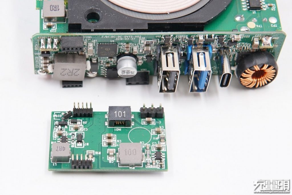

Inductors and a few components on the back.

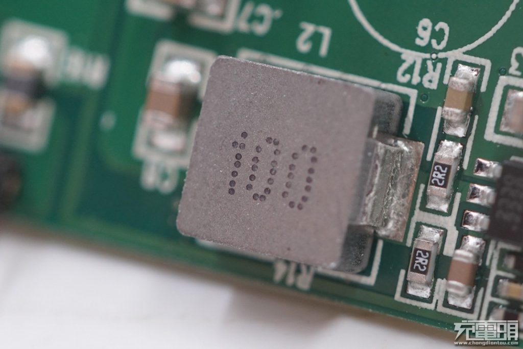

A Metal alloy inductor.

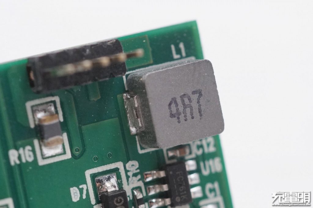

A 4R7 Metal alloy inductor.

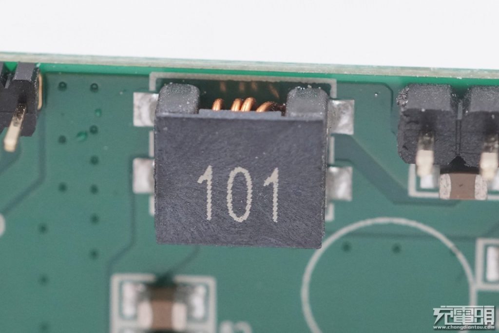

101 filter inductor.

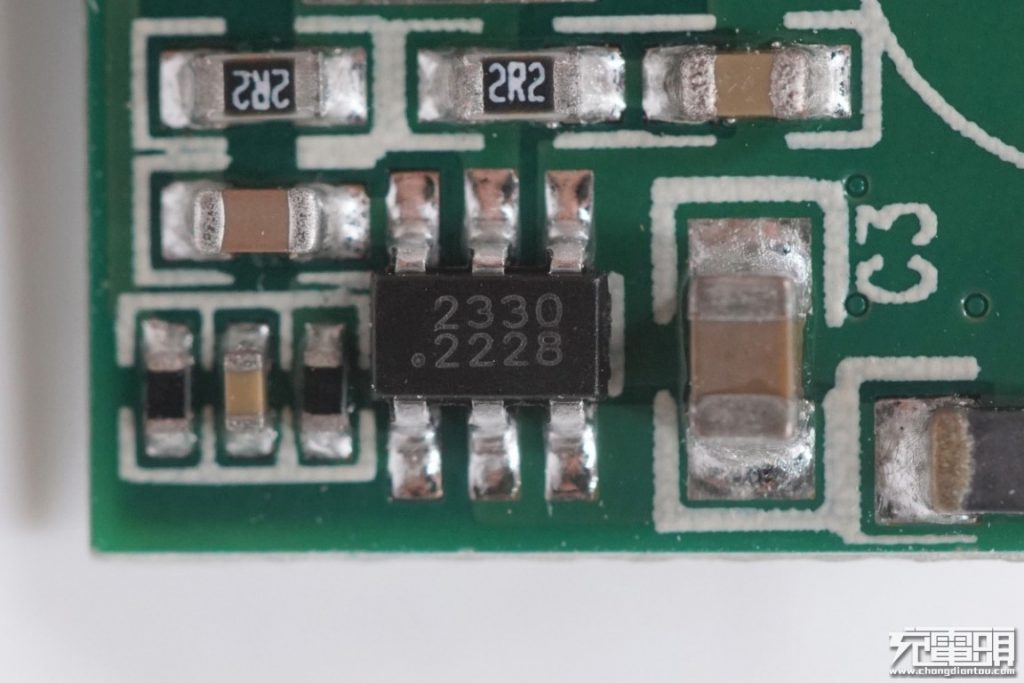

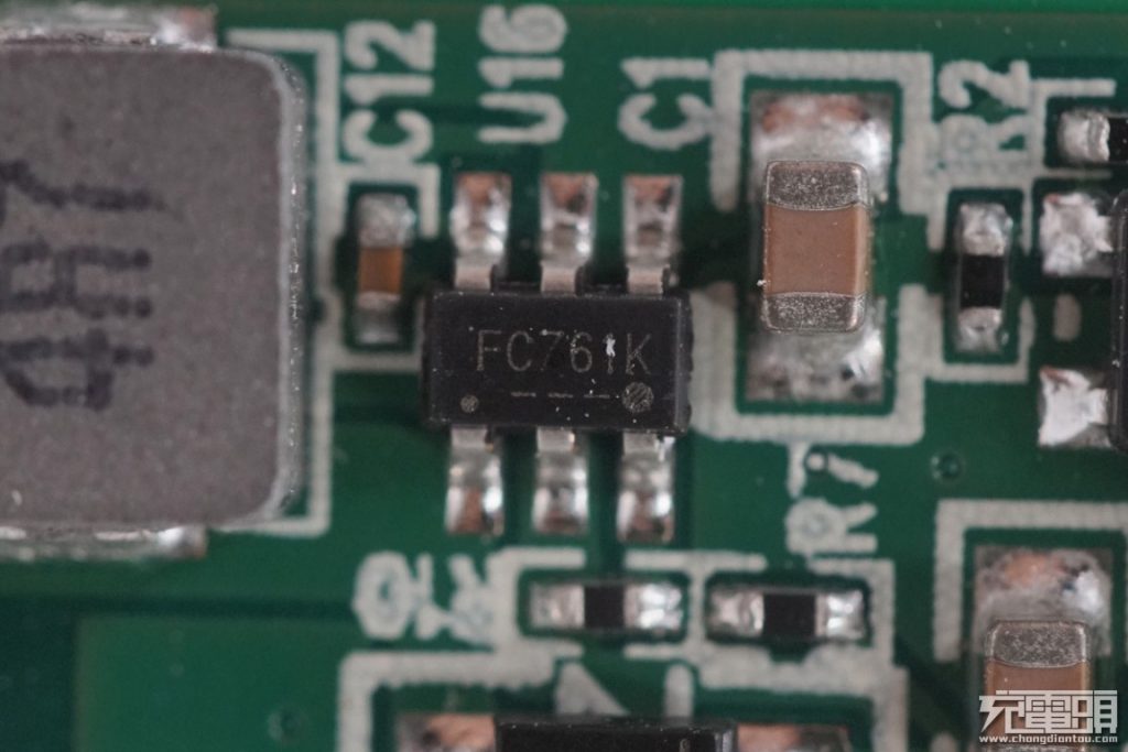

A boost IC with letter code 2330.

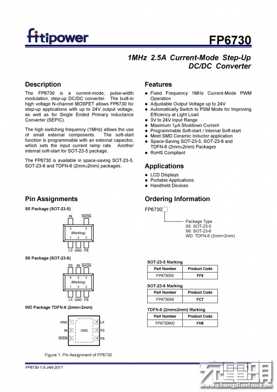

A Fitipower FP6730 step-up converter with letter code FC761K.
Detailed specifications of the Fitipower FP6730.

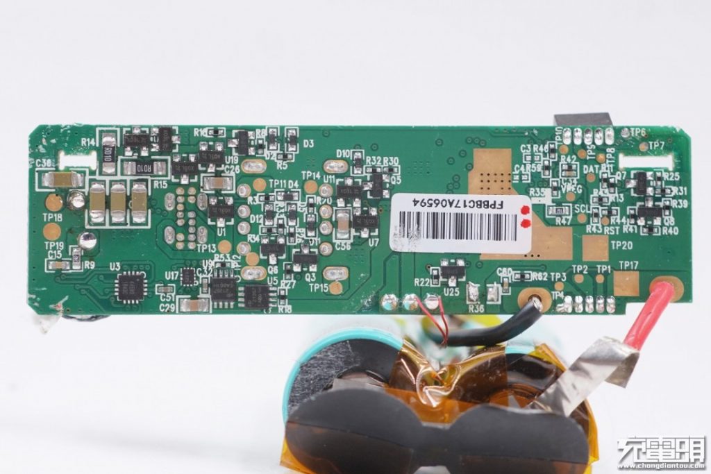

Let's take a look at the power management PCBA.

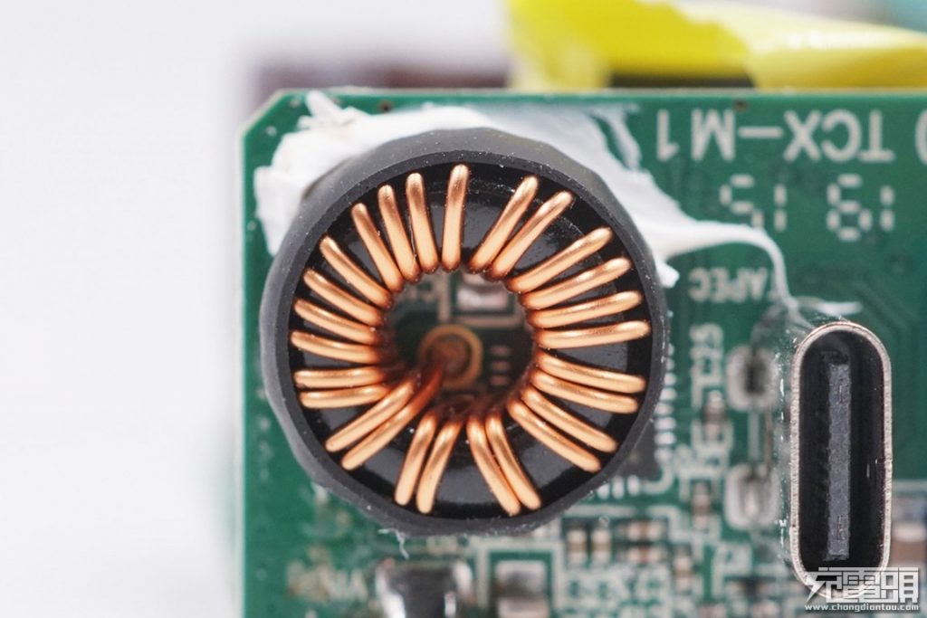

A magnetic loop inductor with heat shrink tube protection on the outside.

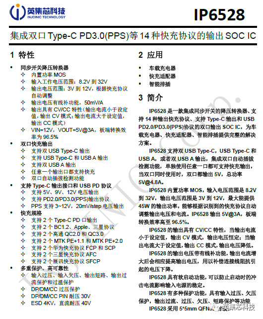

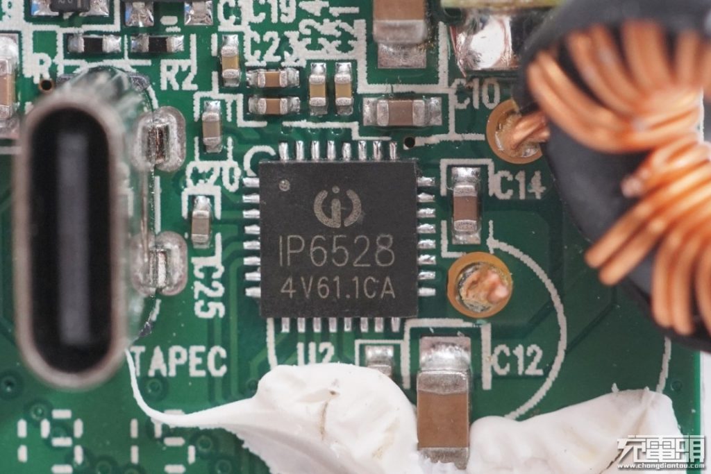

The Injoinic IP6528 is a buck converter with integrated synchronous switch, and an SoC that supports USB-C multi-protocol dual-port output. It supports dual port detection, single port fast charging output, dual port intelligent recognition 5V output, and can provide up to 45W output power. It also has line compensation function, as well as input overvoltage protection, undervoltage protection, output overcurrent protection, overvoltage protection, undervoltage protection, short circuit protection and other functions. It provides an all-rounded solution for applications including car chargers, power adapters, and smart sockets.
Detailed specifications of the Injoinic IP6528.

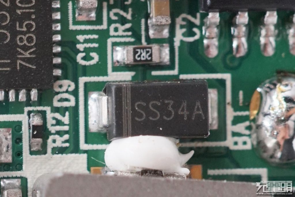

An SS34A Schottky diode.

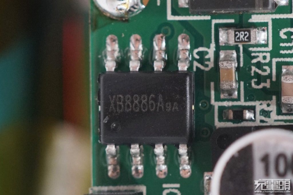

Xysemi XB8886A integrated protection tube for the battery pack.

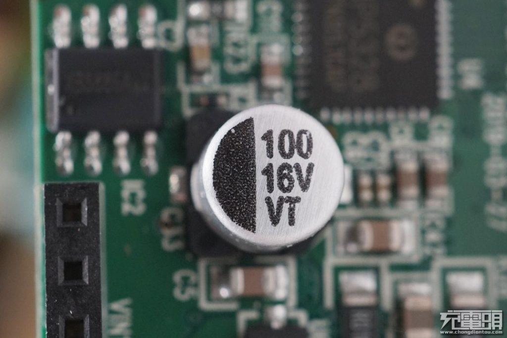

Solid capacitor 100μF, 16V.

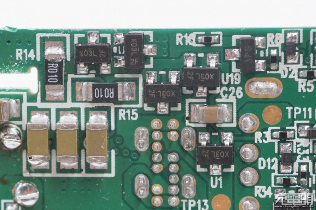

Tiny components fill the back of the PCB.
There are three MLCC capacitors on the left.

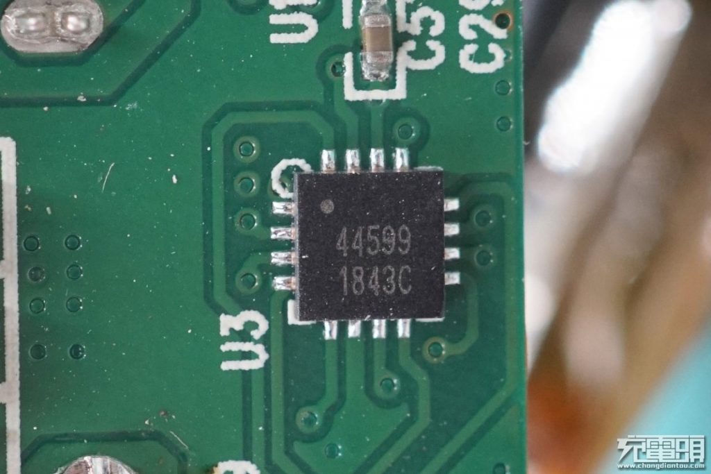

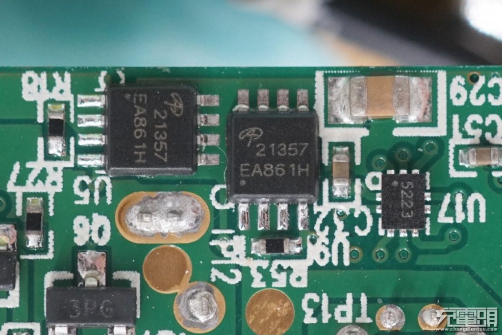

SGM44599 toggle switch.
Two AONR21357 MOS tubes.

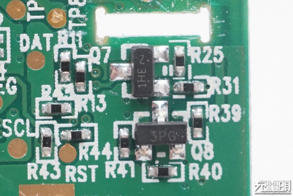

3PG small triode.

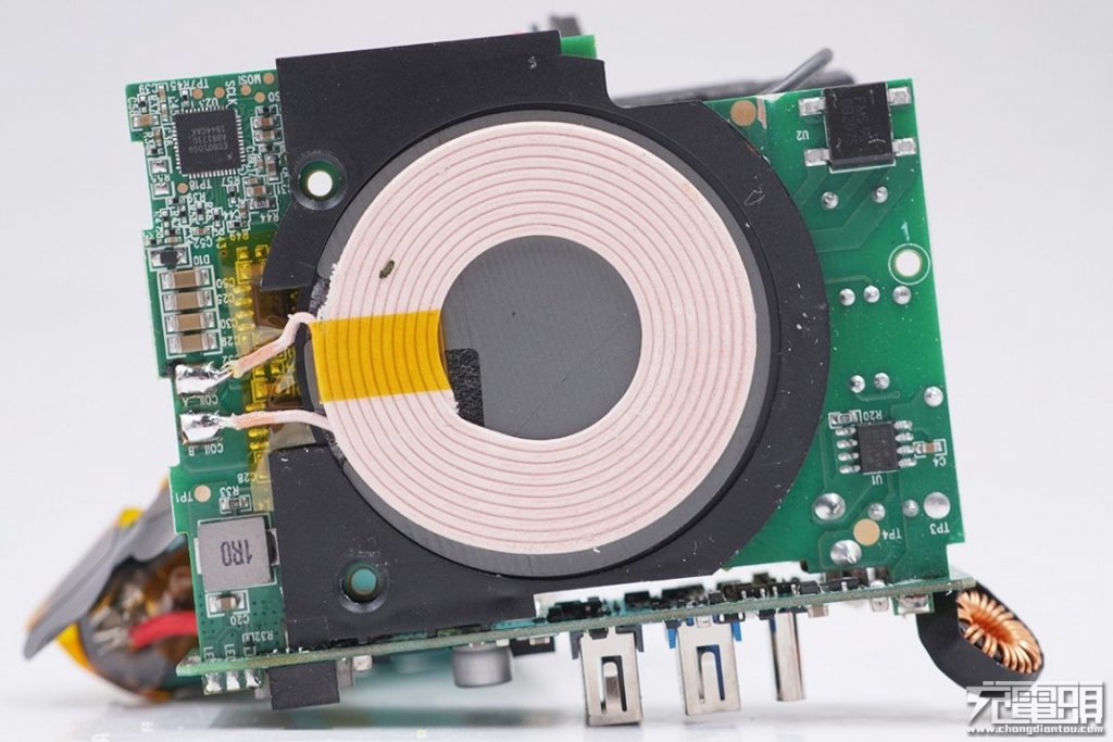

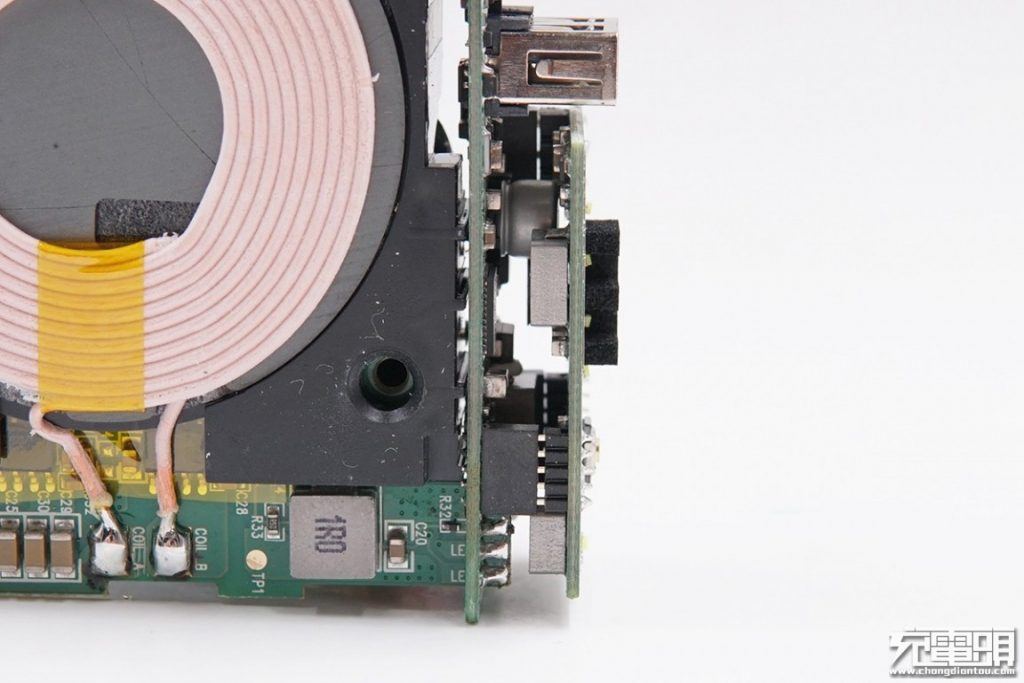

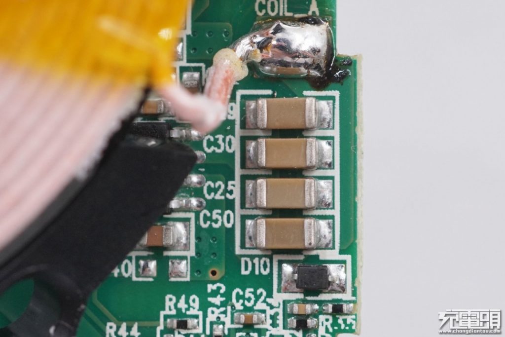

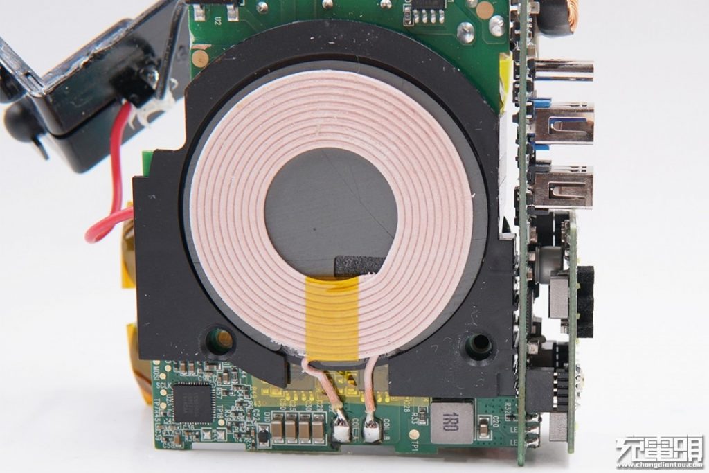

Taking a closer at the wireless charging part.
The wireless charging section is composed of a wireless charging coil, a magnetic isolation sheet, and a large PCBA on the back side.

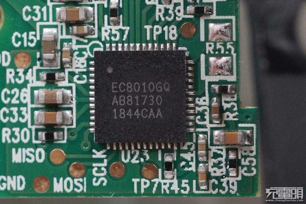

The CPS EC8010 is a highly efficient, Qi-compliant, magnetic inductive wireless power transmitter IC for applications up to 5W. The system-on-chip integrates power controller, micro-controller, voltage regulator, foreign object detection (FOD), full bridge drivers and on-chip voltage and current demodulation. The EC8010 integrates one full bridge driver. Internal protection fuctions are provided for over current and over temperature. It has passed the CE/FCC/Qi-BPP certification.
Detailed specifications of the CPS EC8010.

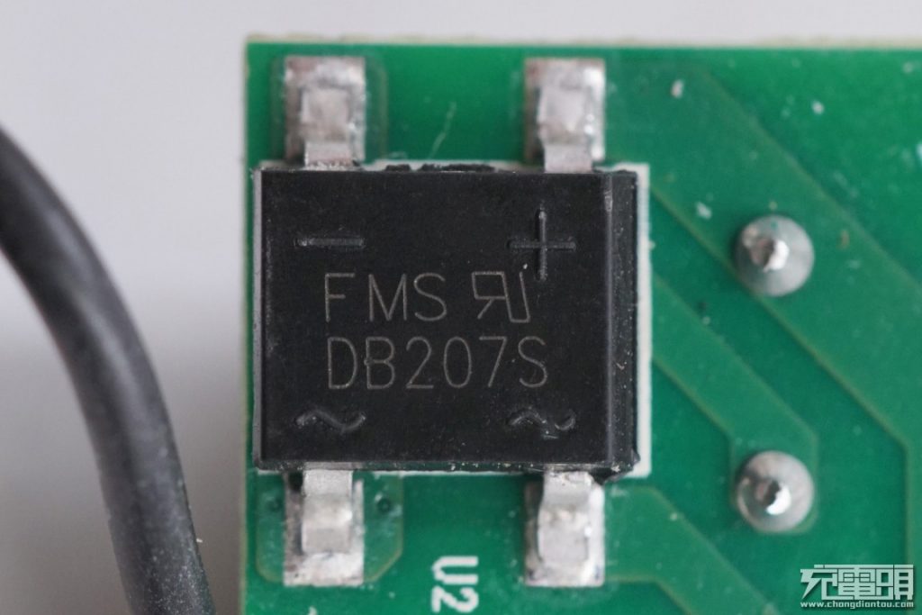

DB207S patch rectifier bridge.

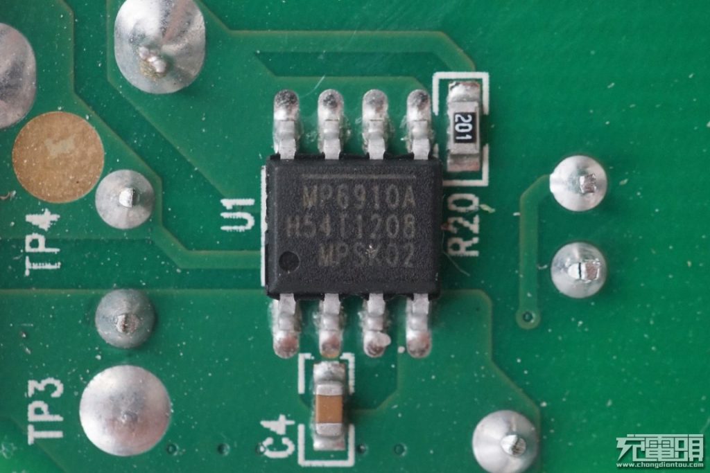

MPS MP6910A built-in MOS synchronous rectification IC.

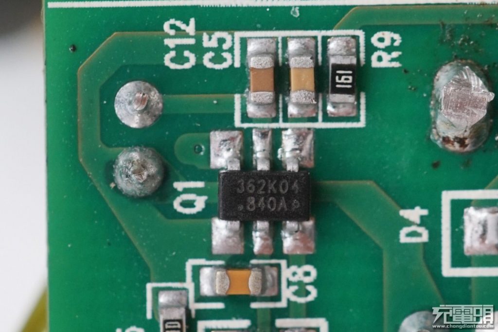

On-bright OB2362 primary PWM controller.

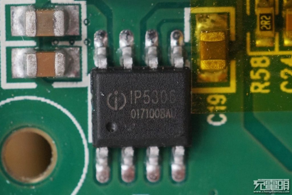

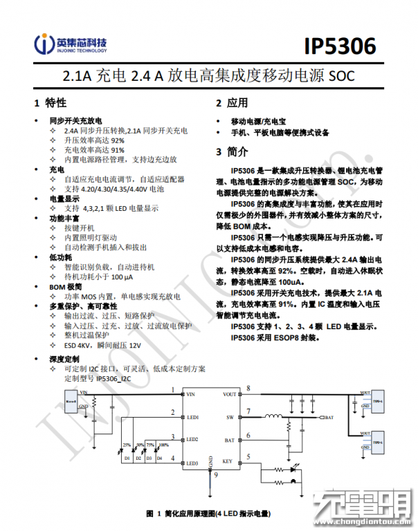

The controller chip for power bank function is a Injoinic IP5306. The IP5306 is a multi-function power management SoC with integrated boost converter, lithium battery charge management, and battery level indication. It requires only one inductor for buck and boost functions. The synchronous boost system provides up to 2.4A of output current with conversion efficiency as high as 91%. It automatically enters sleep state when no load is present, and the quiescent current is reduced to 50uA. The chip requires fewer peripheral compnents, which can effectively reduce the size of the overall solution and reduce the BOM cost.
Detailed specifications of the Injoinic IP5306.

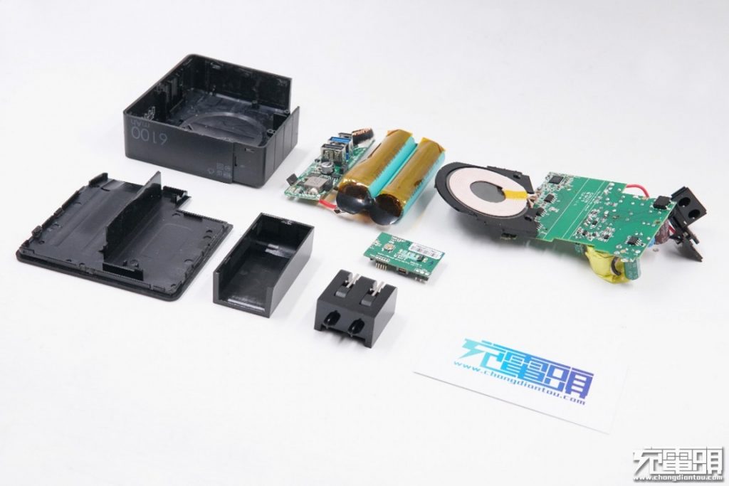

All the components.
