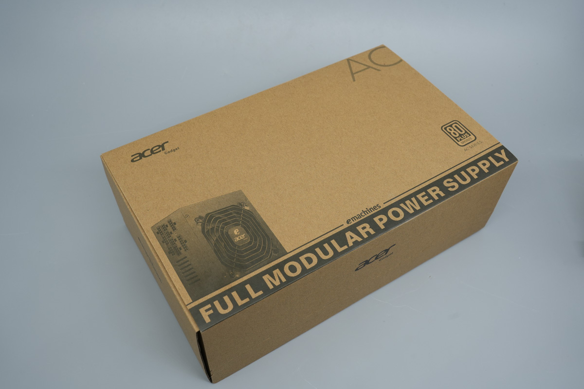

Removing the inner box reveals a cardboard box printed with an illustration of the power supply's exterior design.

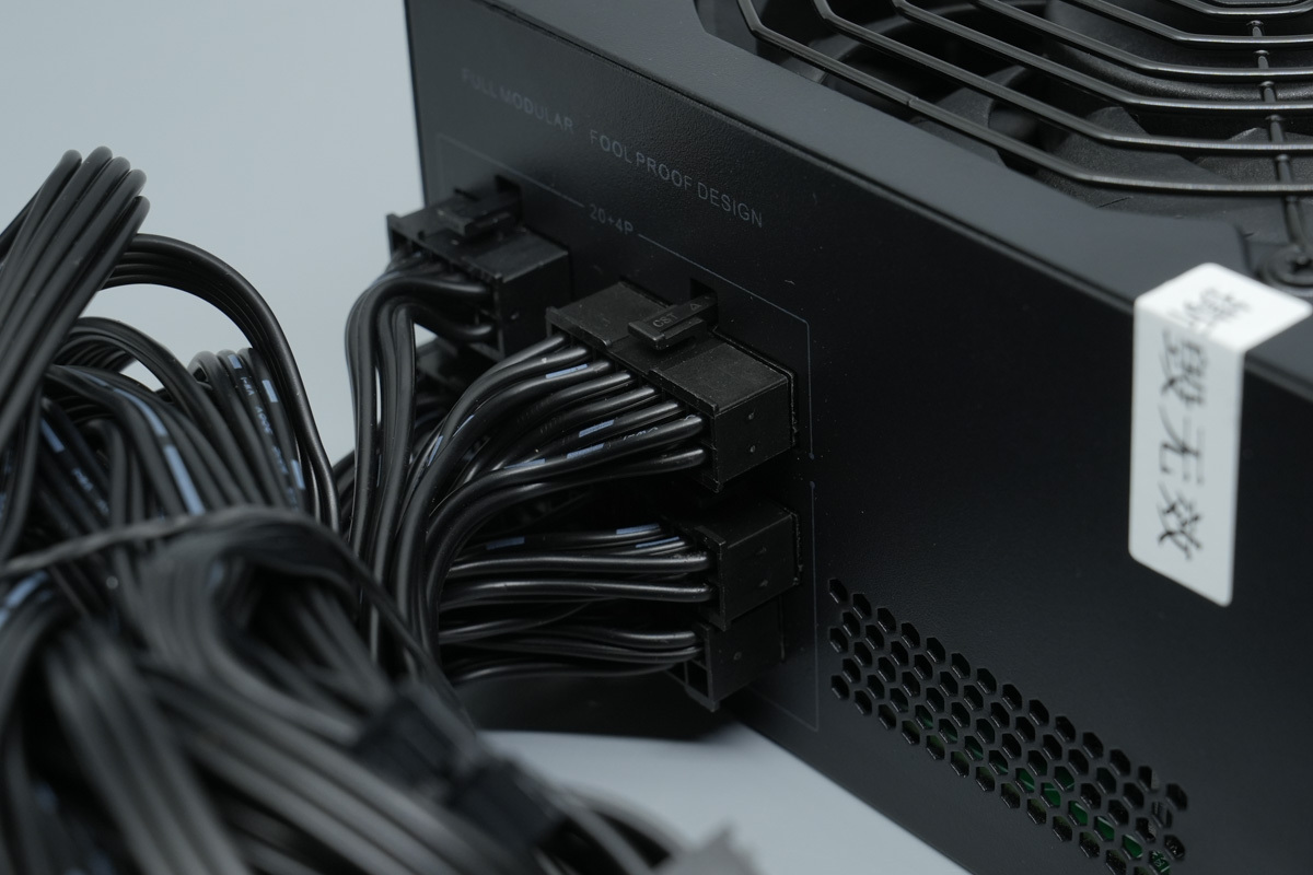

The output end is equipped with modular sockets for cable connections.

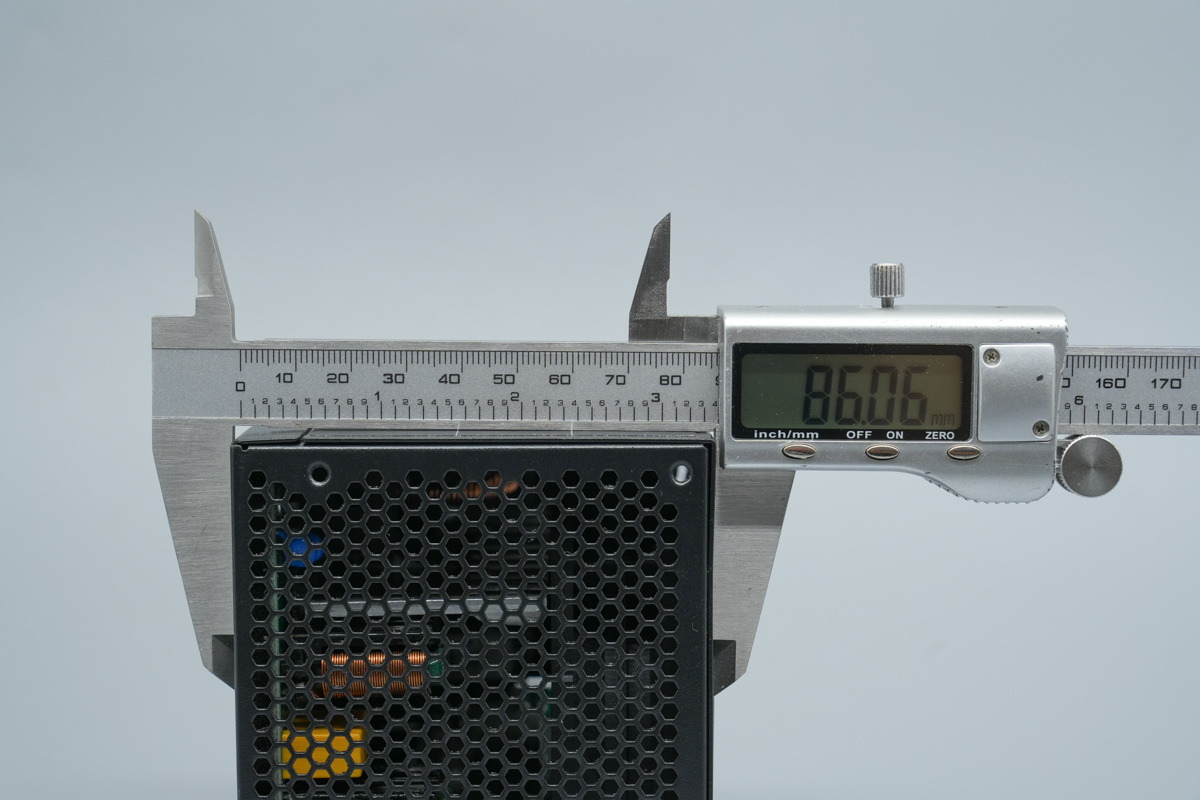

The thickness of the PSU is about 86.1mm (3.390 inches).

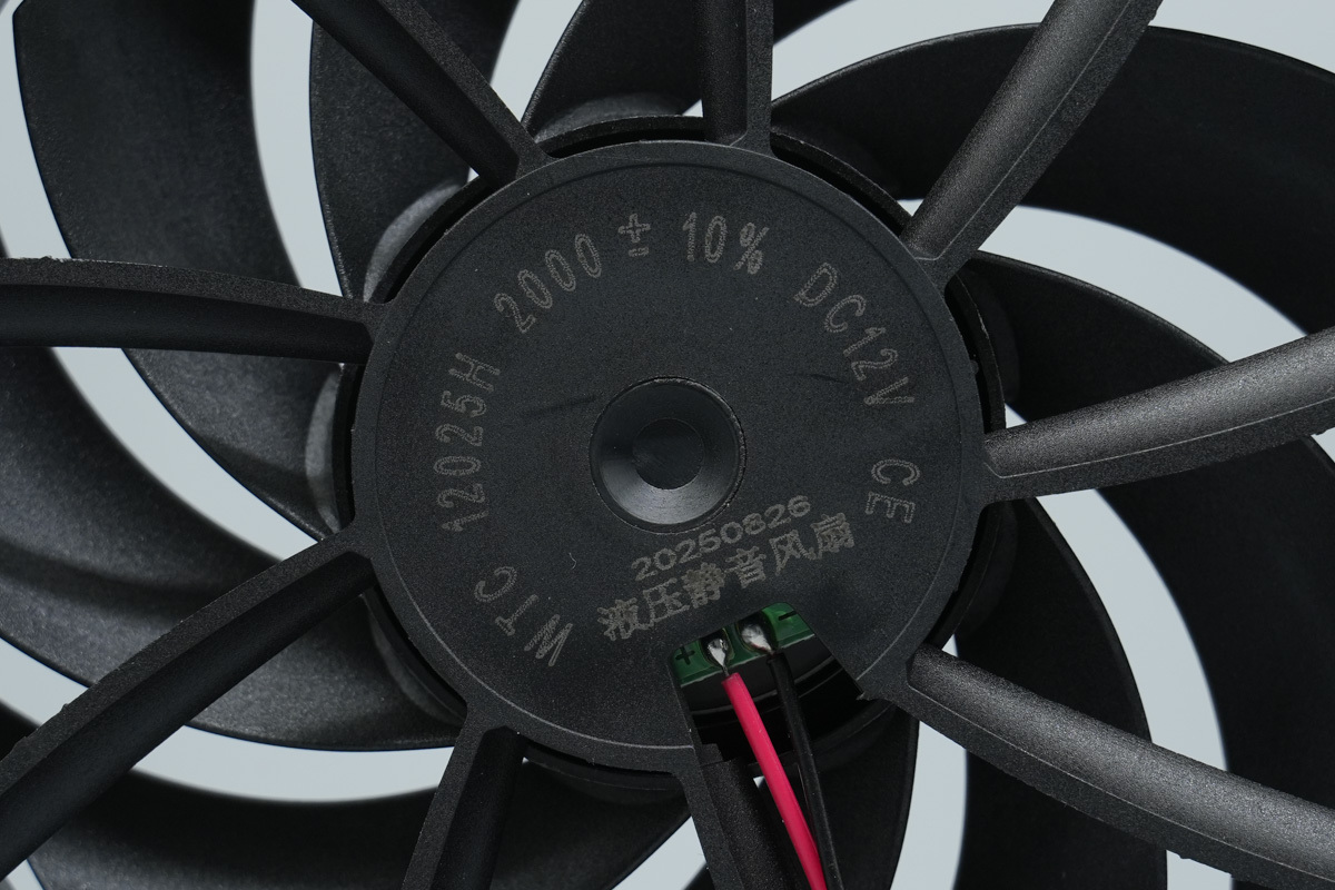

The PSU is equipped with a 12025-sized cooling fan.
Teardown of Acer AC650 650W Fully Modular PC PSU-Chargerlab
The cooling fan is rated for an operating voltage of 12V.

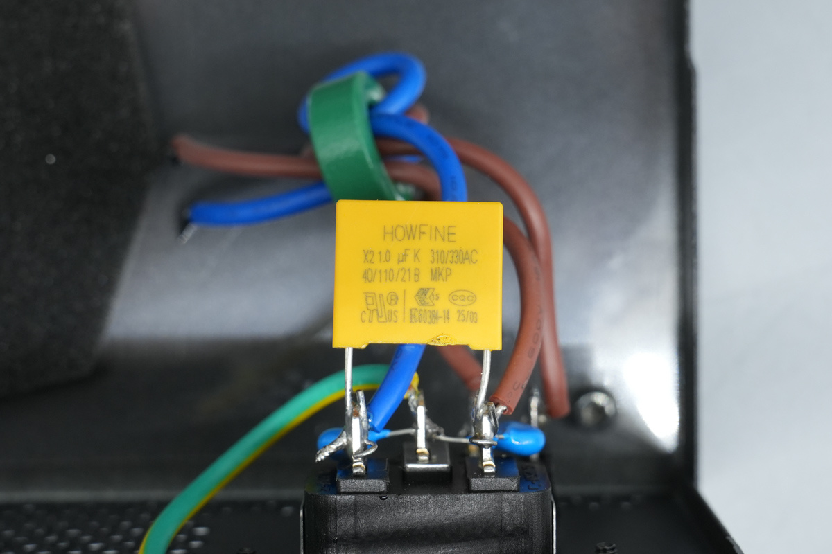

The X2 safety cap is from the HOWFINE, 1μF.

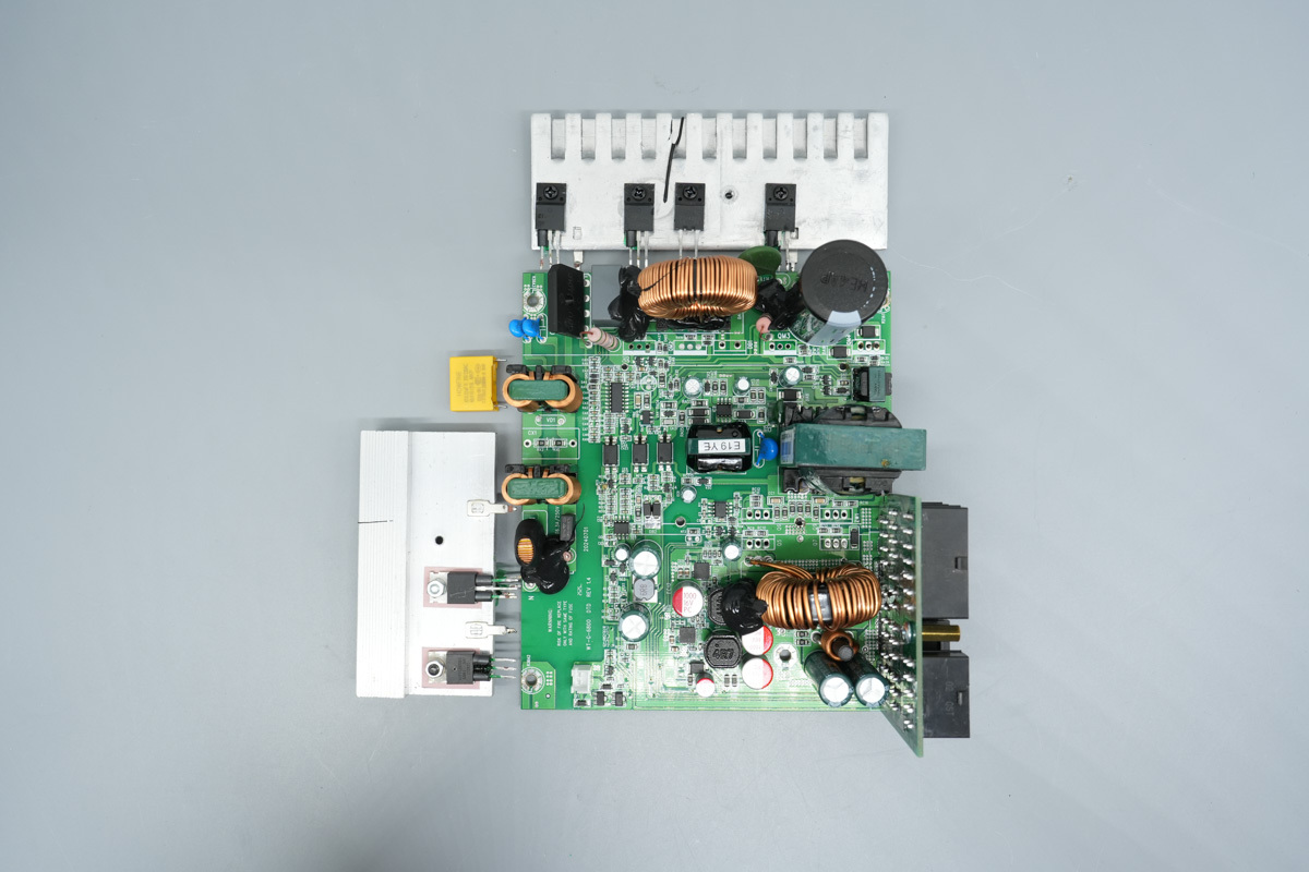

This is the PCBA module. The top-left corner features the AC input end, which includes the soldered fuse, differential-mode choke, and common-mode choke. Moving to the right, we find the blue Y-caps, rectifier bridge, film filtering cap, PFC boost choke, NTC thermistor, and the high-voltage filter cap. An internal heatsink is provided for the PFC MOSFET, PFC rectifier MOSFET, and the power MOSFET.
The central area houses the standby power transformer, with the main forward transformer located below it. The heatsink on the left side is dedicated to the synchronous rectifier MOSFET, with a filtering choke positioned to its left. Finally, the left side of the PCBA module incorporates the 5V and 3.3V step-down circuits, featuring step-down chips, output chokes, and filtering caps.

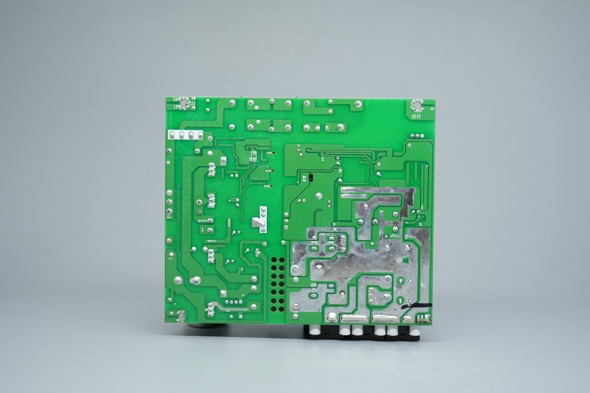

The back of the PCBA is clean of components, with low-voltage high-current traces left as exposed copper and reinforced with solder for better power delivery.

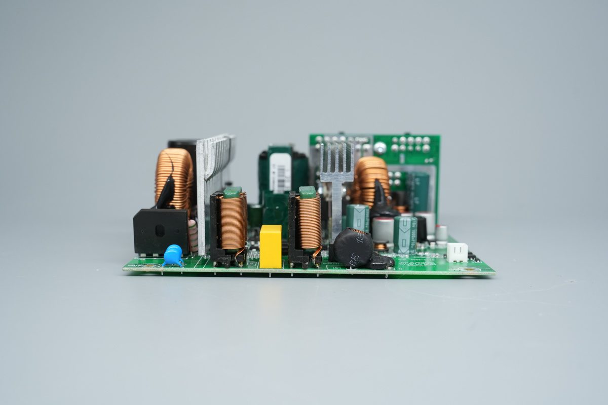

The side view of the PCBA highlights the primary input end, including the fuse, differential and common-mode chokes, and the X2 safety cap. Additionally, the rectifier bridge and Y-cap are mounted on the left side of the PCB.

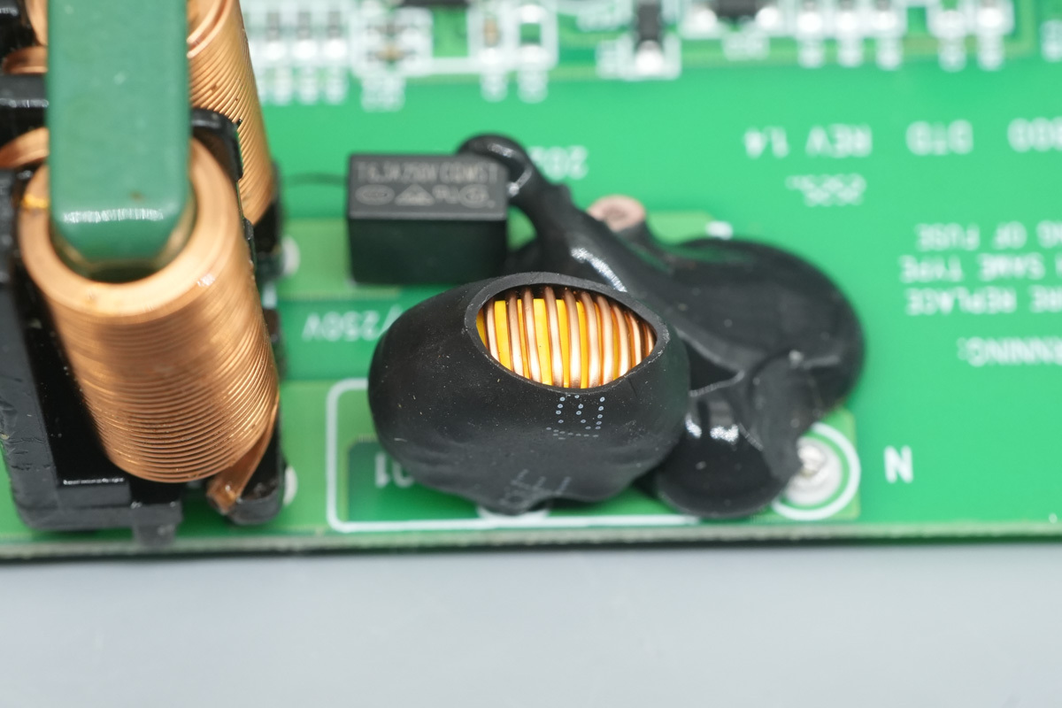

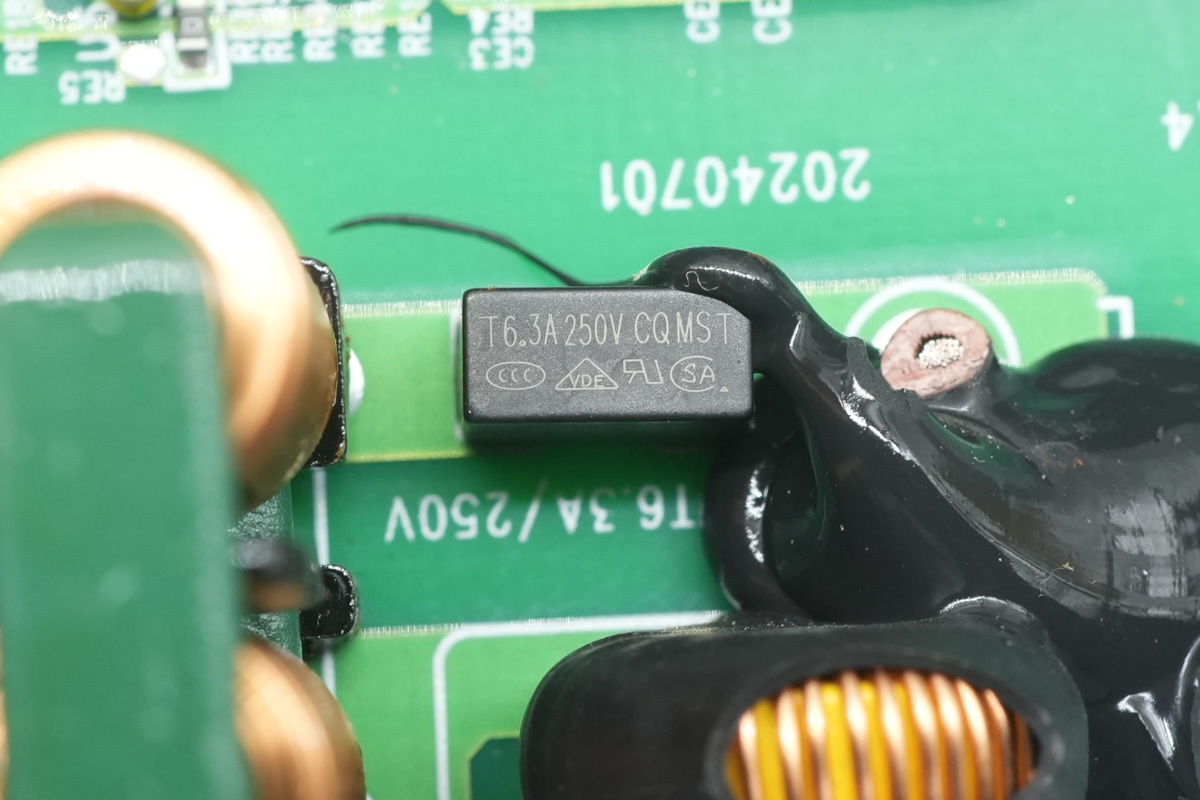

The input fuse is from CONQUER, specifically an MST-series time-delay fuse, 6.3A, 250V.

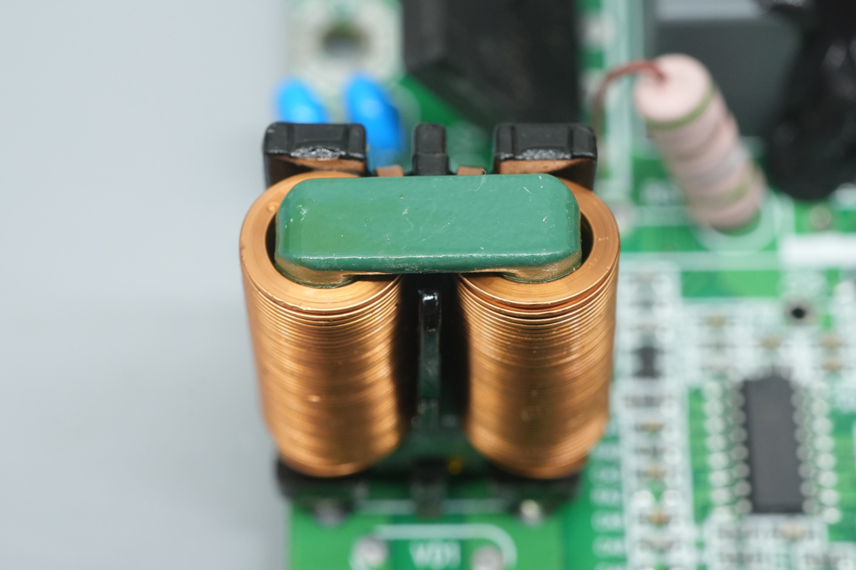

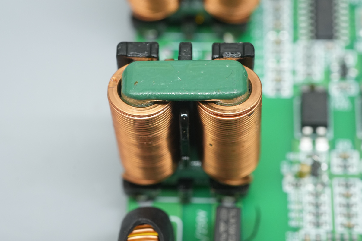

The common-mode choke is wound using flat copper wire.

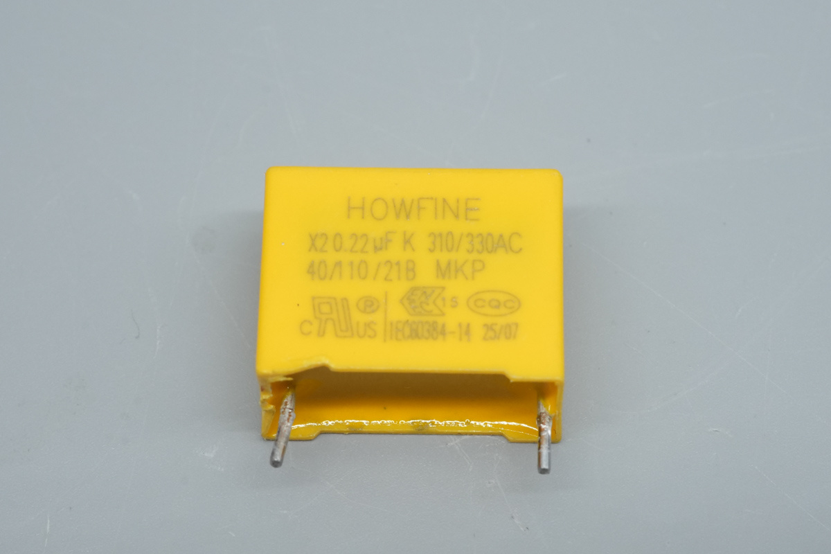

The X2 safety cap, 0.22μF.

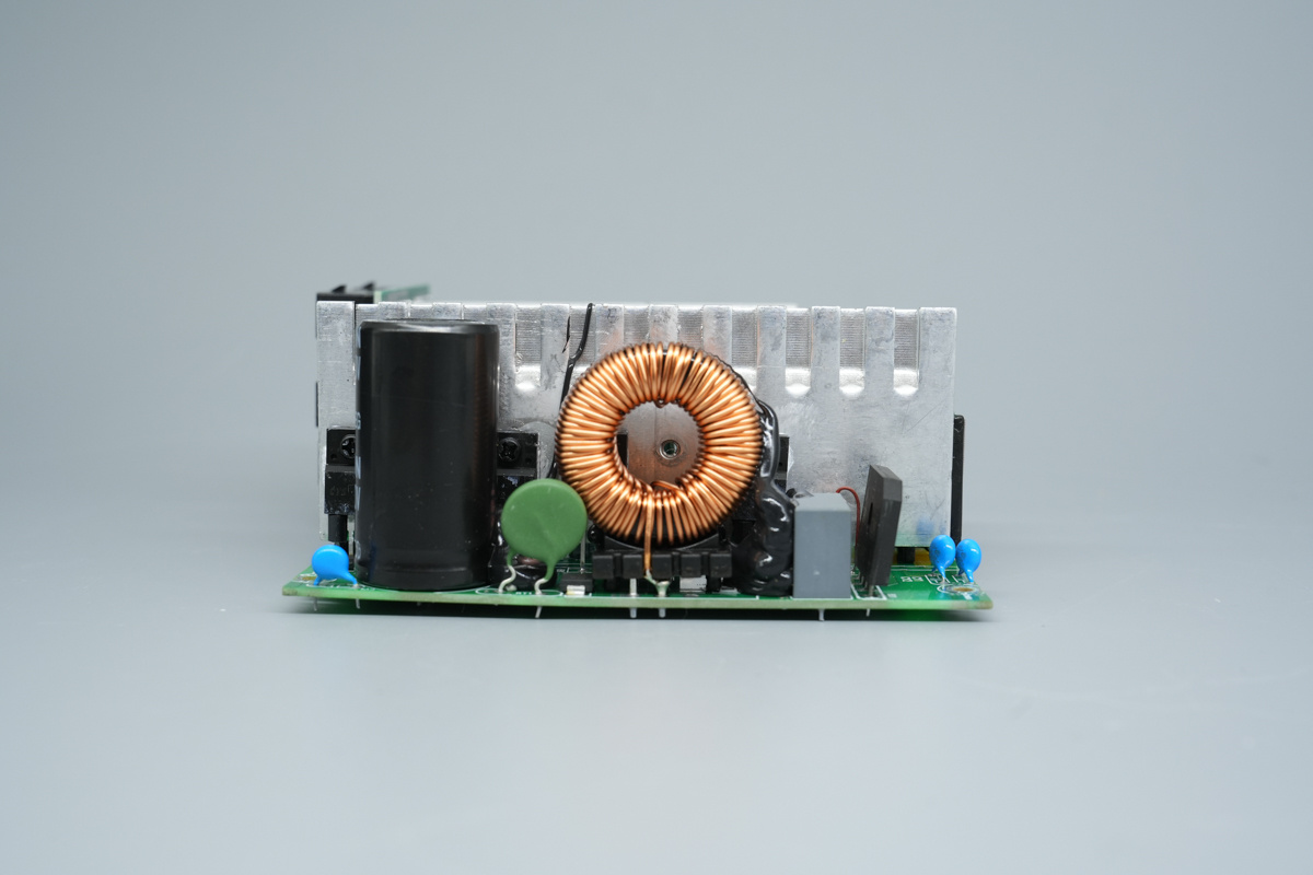

The side of the PCBA accommodates the high-voltage filter cap, NTC thermistor, PFC boost choke, film filtering cap, and the rectifier bridge.

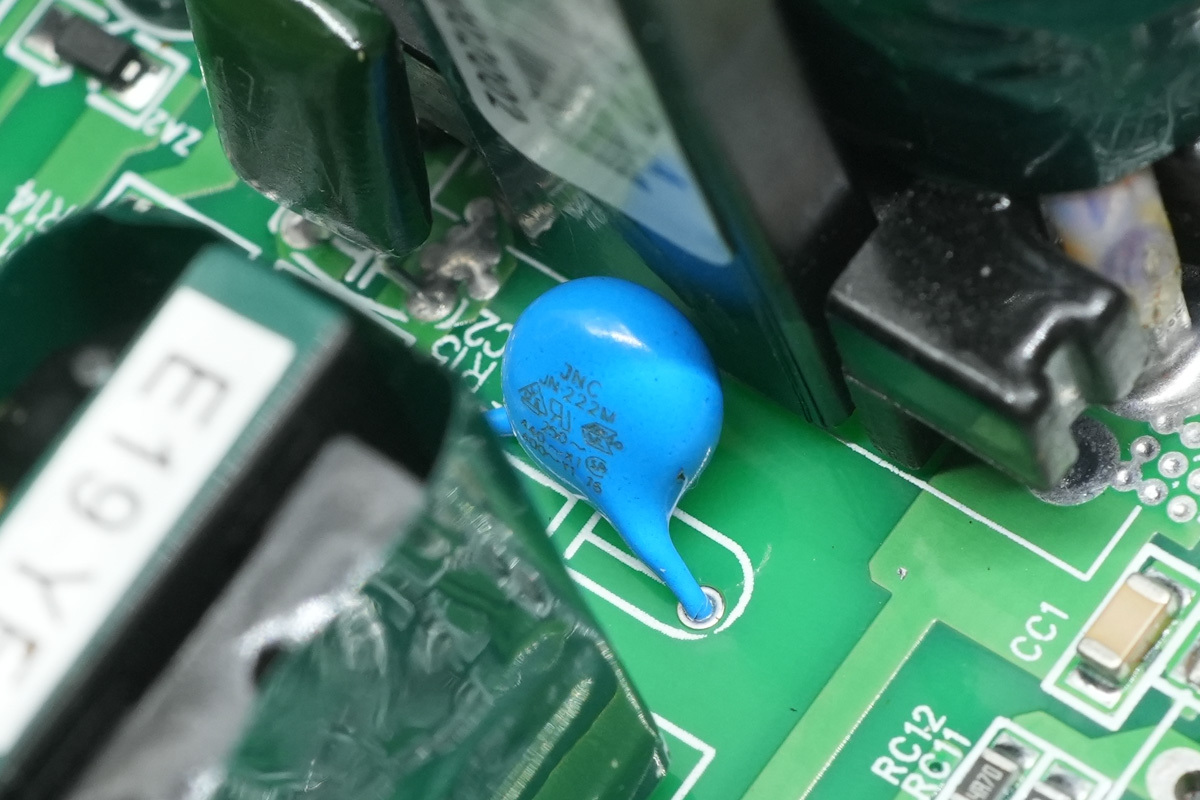

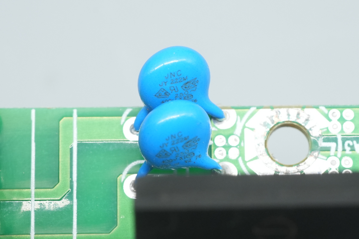

The blue Y-cap is from JNC, spec JY222M.

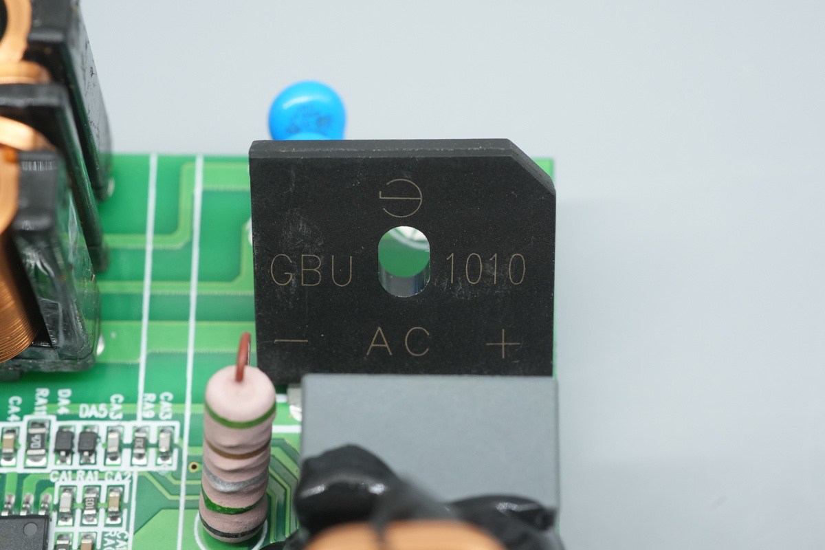

The rectifier bridge, model GBU1010, spec 10A 1000V, in a GBU package.

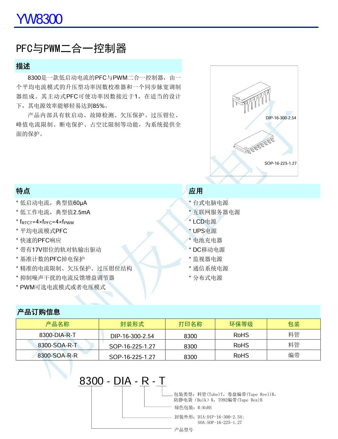

The two-in-one controller is from YW, model YW8300. This is an integrated PFC and forward PWM controller that combines an average current PFC controller with a synchronous PWM controller. It features low startup and operating current, fast PFC response, and comprehensive protection mechanisms including soft-start, fault detection, UVLO, over-voltage clamping, peak current limiting, and duty cycle limiting. It is housed in an SOP-16 package.
Here is the info about YW YW8300.

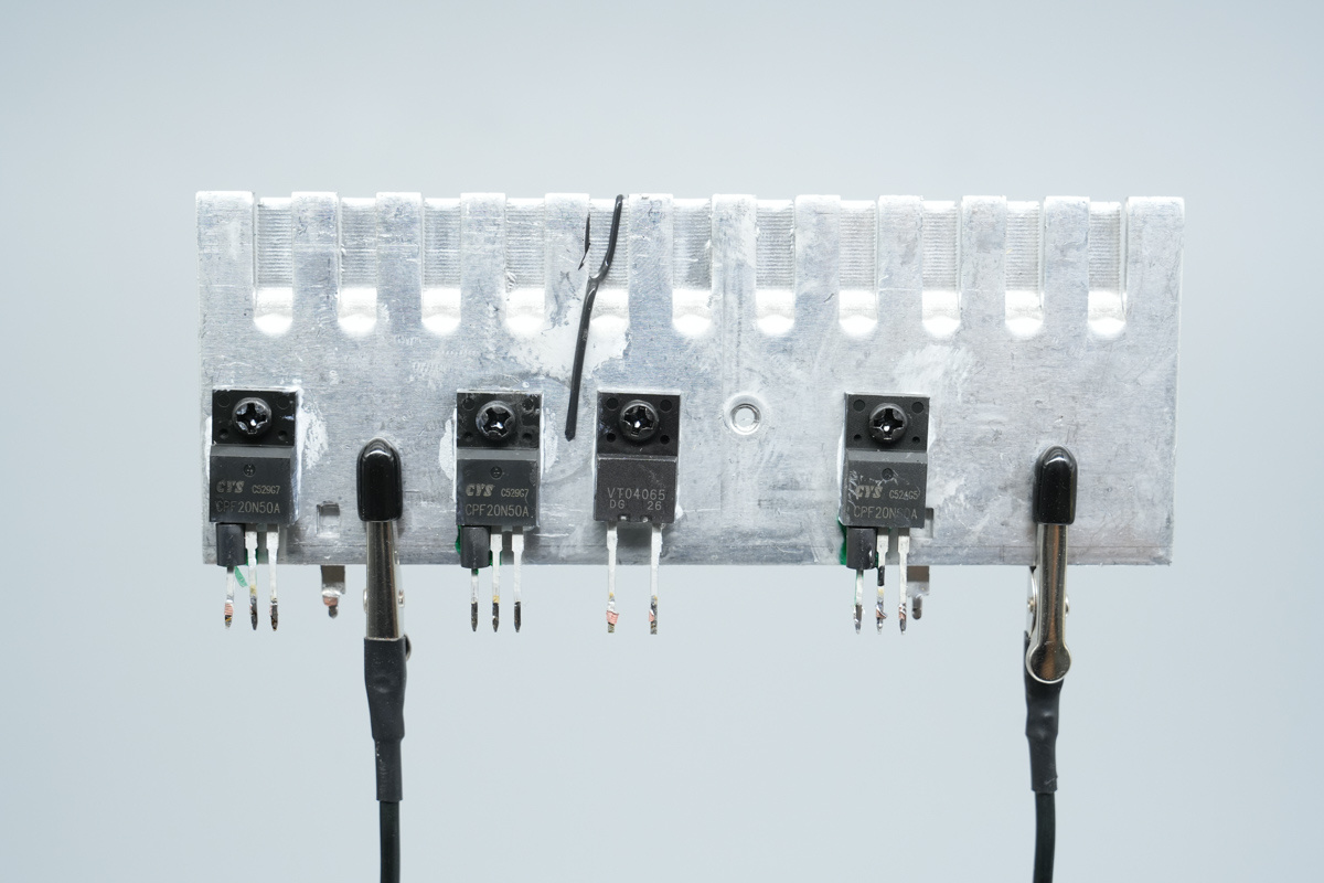

A long-form heatsink is employed to dissipate heat from the power MOSFET, the PFC rectifier MOSFET, and the PFC MOSFET.
The PFC MOSFET is from CYS, model CPF20N60A, NMOS, 650V, in a TO-220F package.

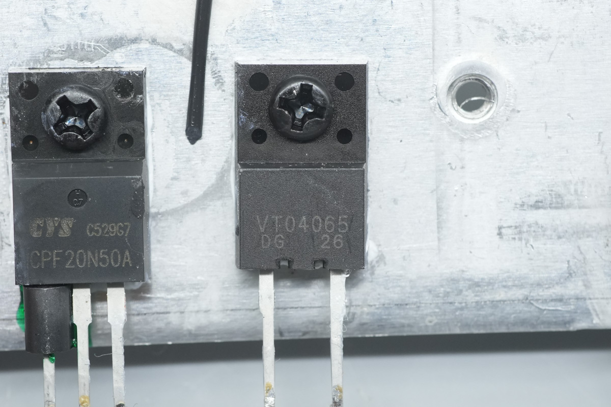

The PFC rectifier MOSFET, marked VT04065, in a TO-220-2 package.

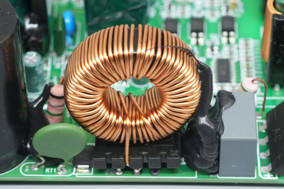

The PFC boost choke is wound using enameled copper wire.

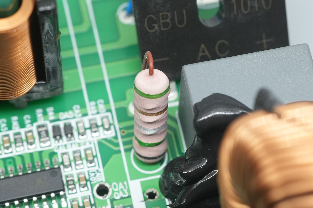

This is the wire-wound resistor utilized for sensing the current of the PFC MOSFET.

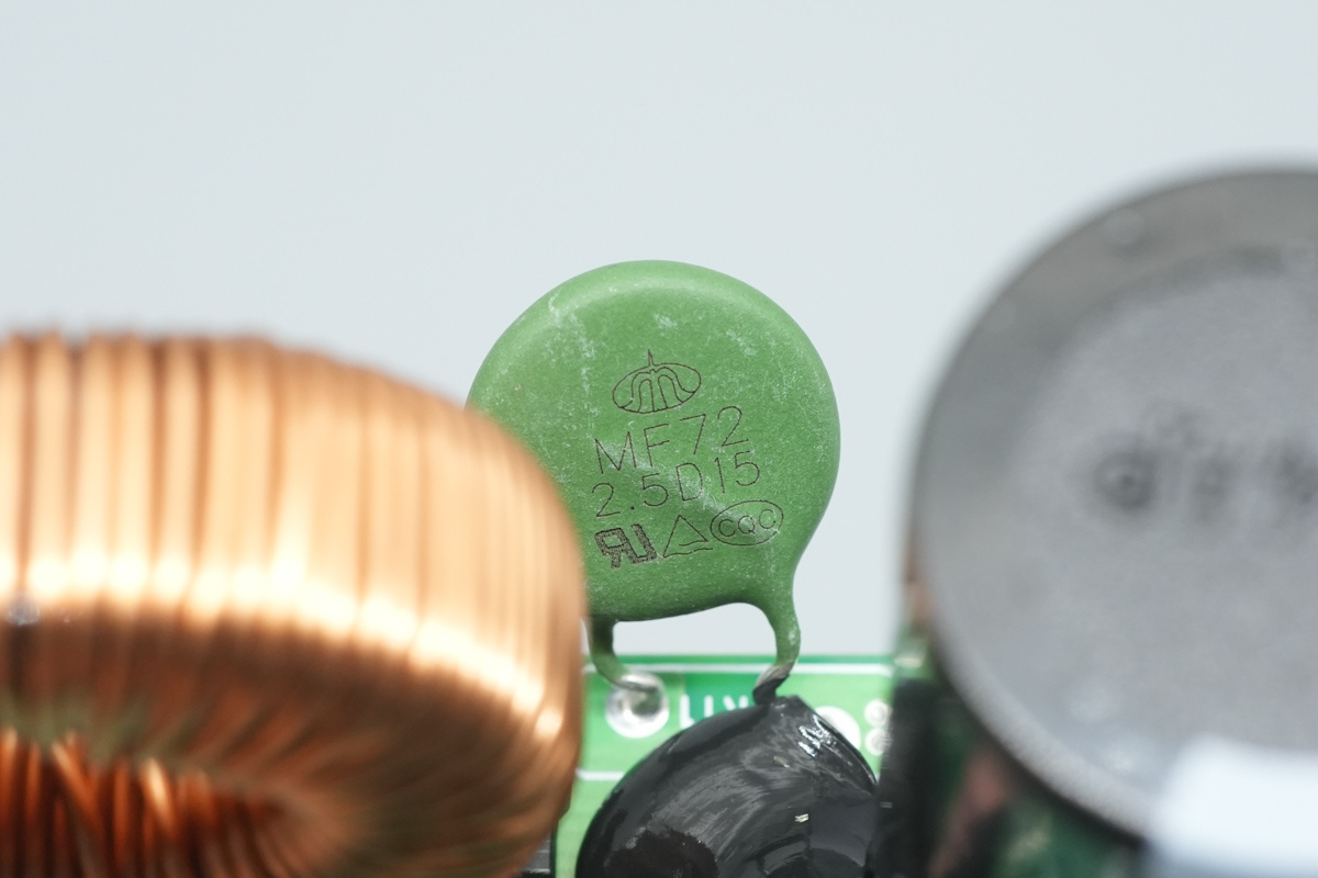

The NTC thermistor is from Shiheng Electronics, belonging to the MF72 series with the part number 2.5D15.

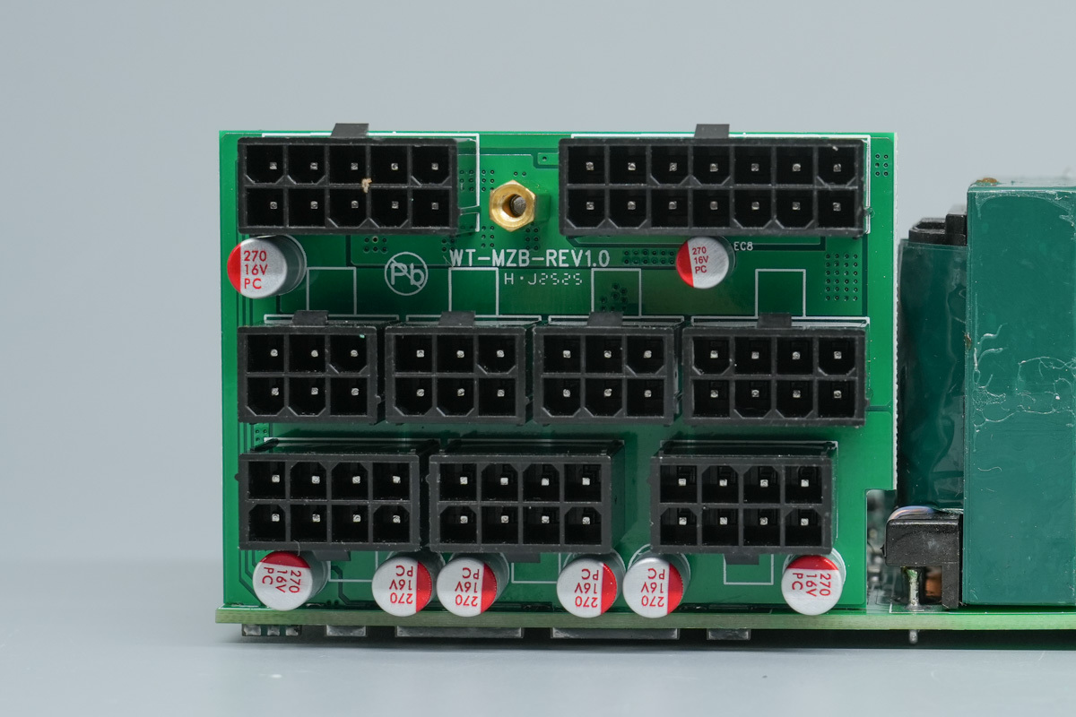

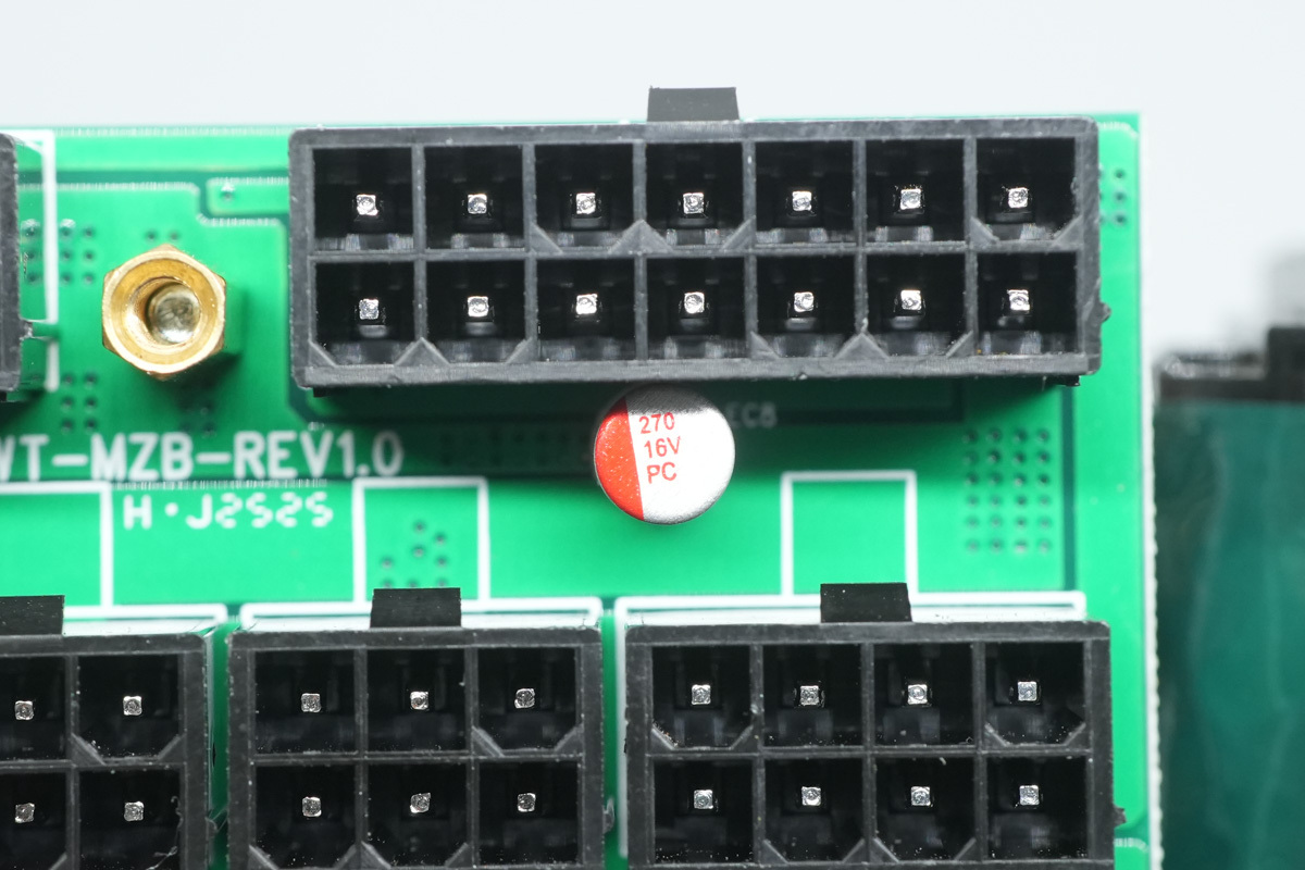

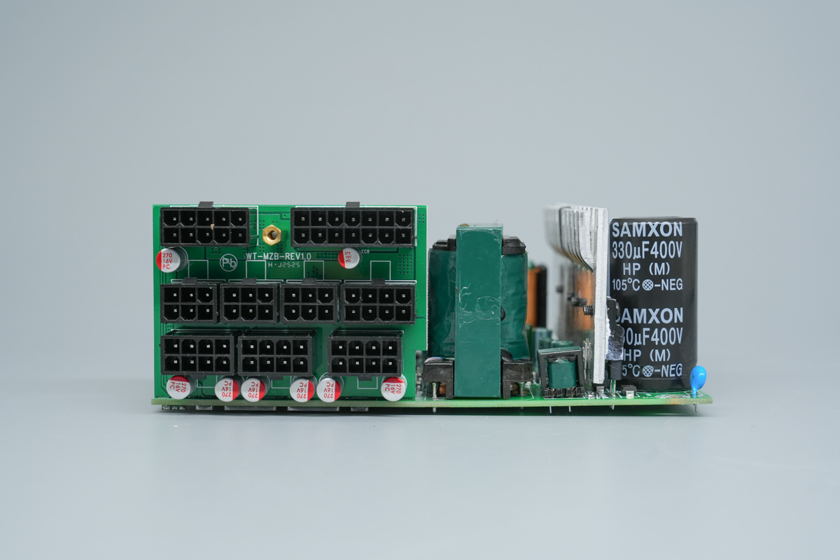

The side of the PCBA accommodates a modular PCB, the transformer, and the high-voltage filter cap.

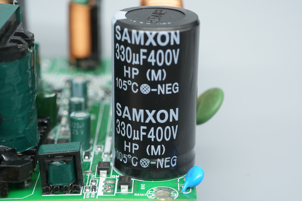

The high-voltage filter cap is from SAMXON, 330μF400V.

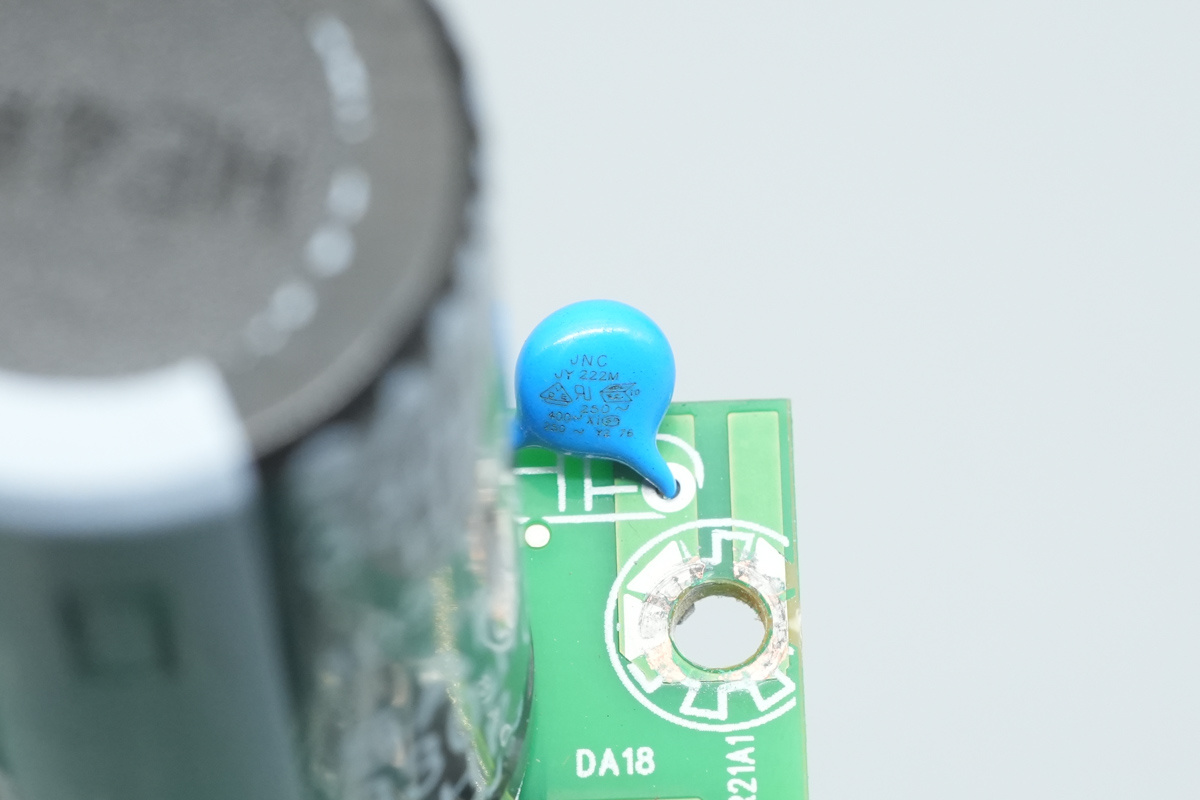

The blue Y-cap is from JNC, JY222M.

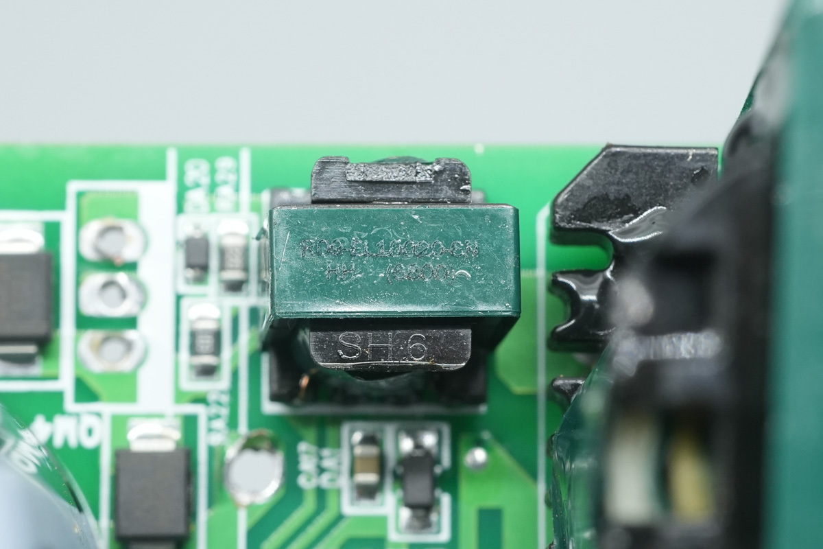

This is the drive transformer used to drive the power MOSFET.

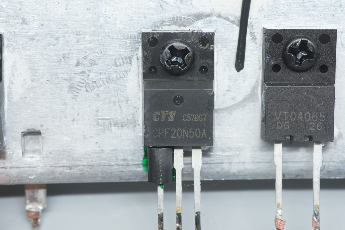

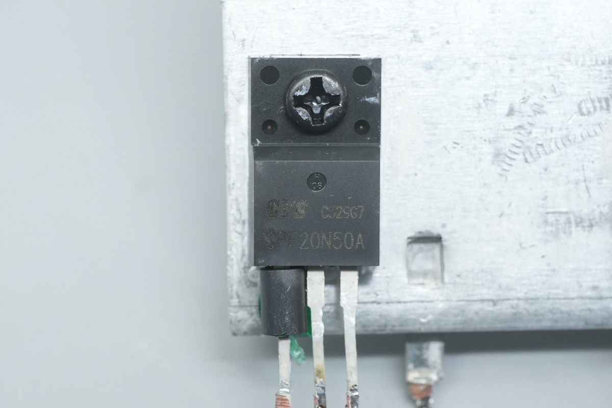

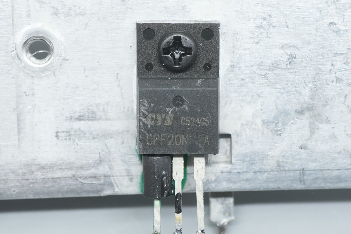

The power MOSFET is from CYS, model CPF20N50A, NMOS, 500V and 210mΩ, in a TO-220F package.
Another one is the same model.

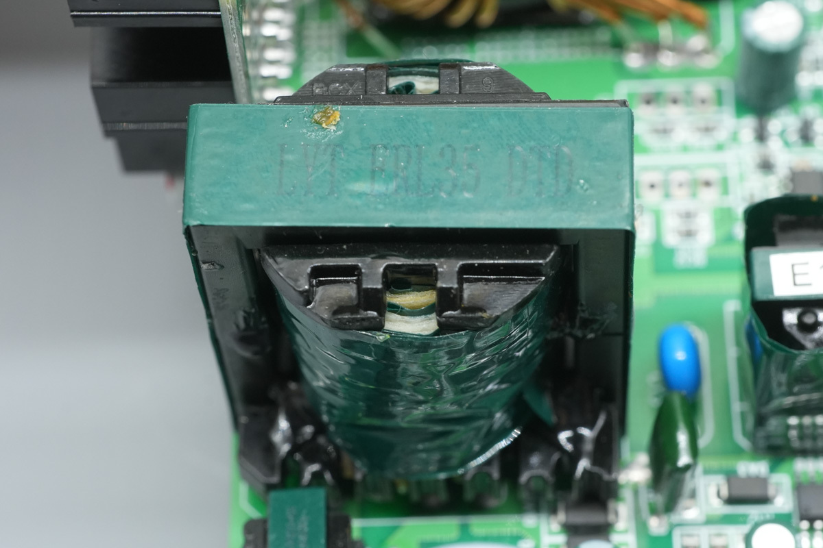

The transformer features an ERL35 core, with the magnetic core itself secured and insulated using high-temperature wrapping tape.

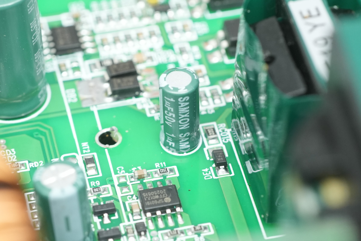

The synchronous rectifier chip is from SYNC, model SP6019. It is a specialized synchronous rectifier controller designed for forward topologies and is housed in an SOP-8 package.

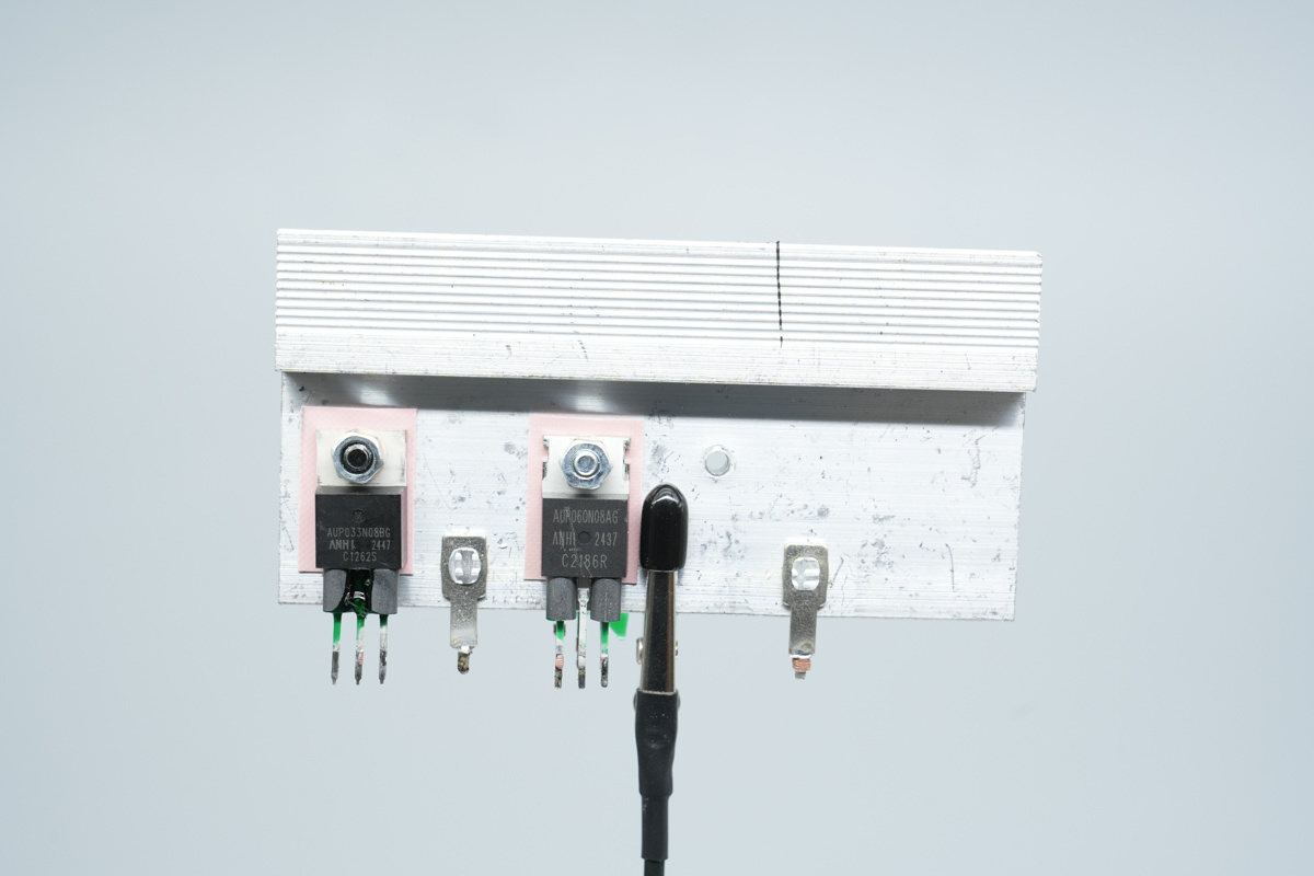

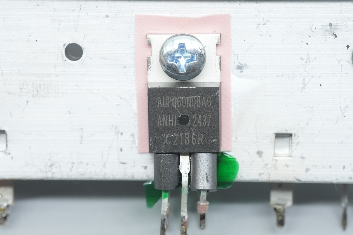

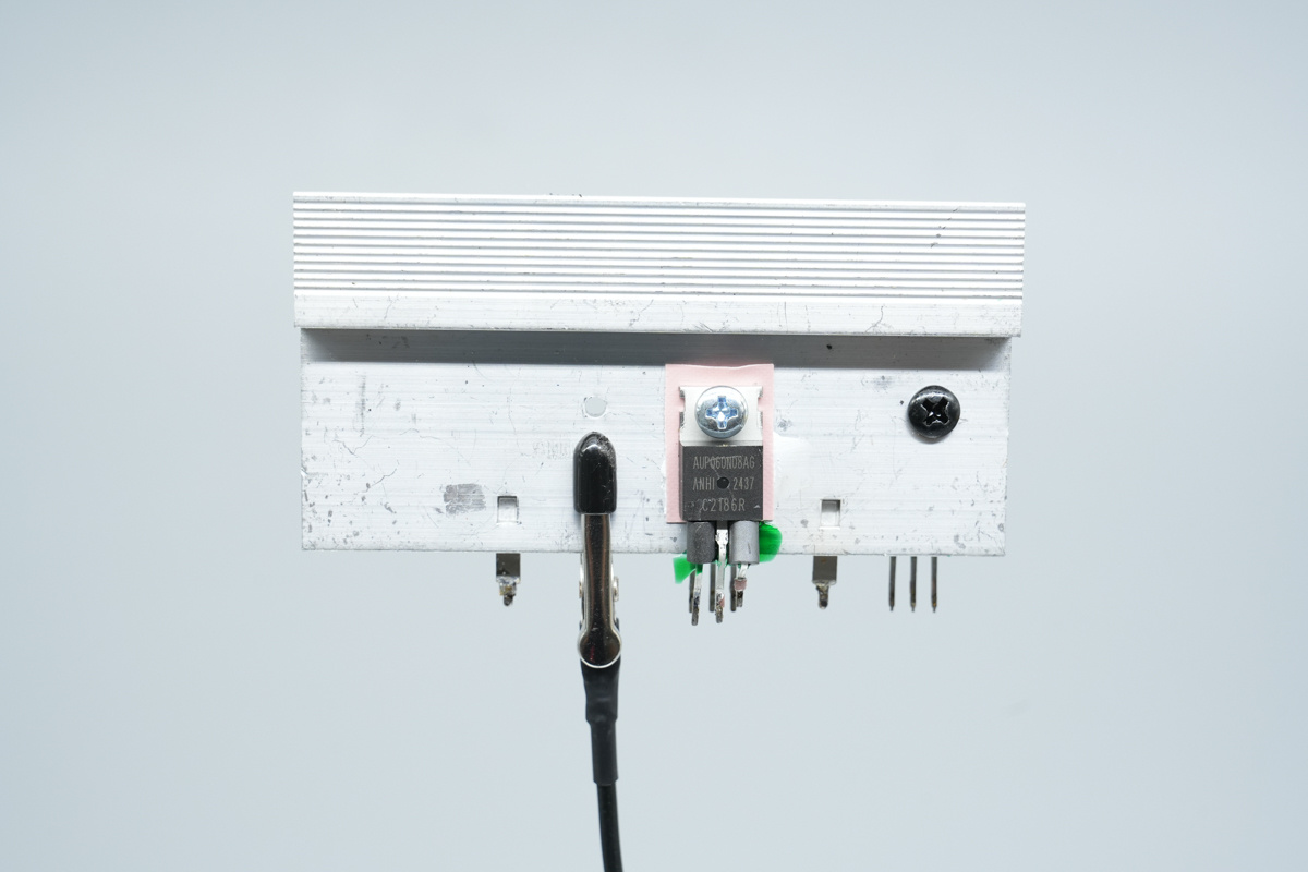

The synchronous rectifier MOSFET is mounted directly onto the heatsink.
There is another one on the back of the heatstink.
The synchronous rectifier MOSFET is from ANHI, model AUP060N08AG, NMOS, 80V and 6mΩ, housed in a TO-220 package.

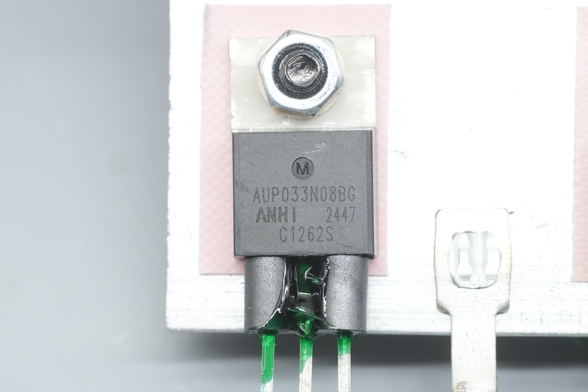

Another synchronous rectifier MOSFET is from ANHI, model AUP033N08BG, NMOS, 85V and 3.3mΩ, housed in a TO-220 package.

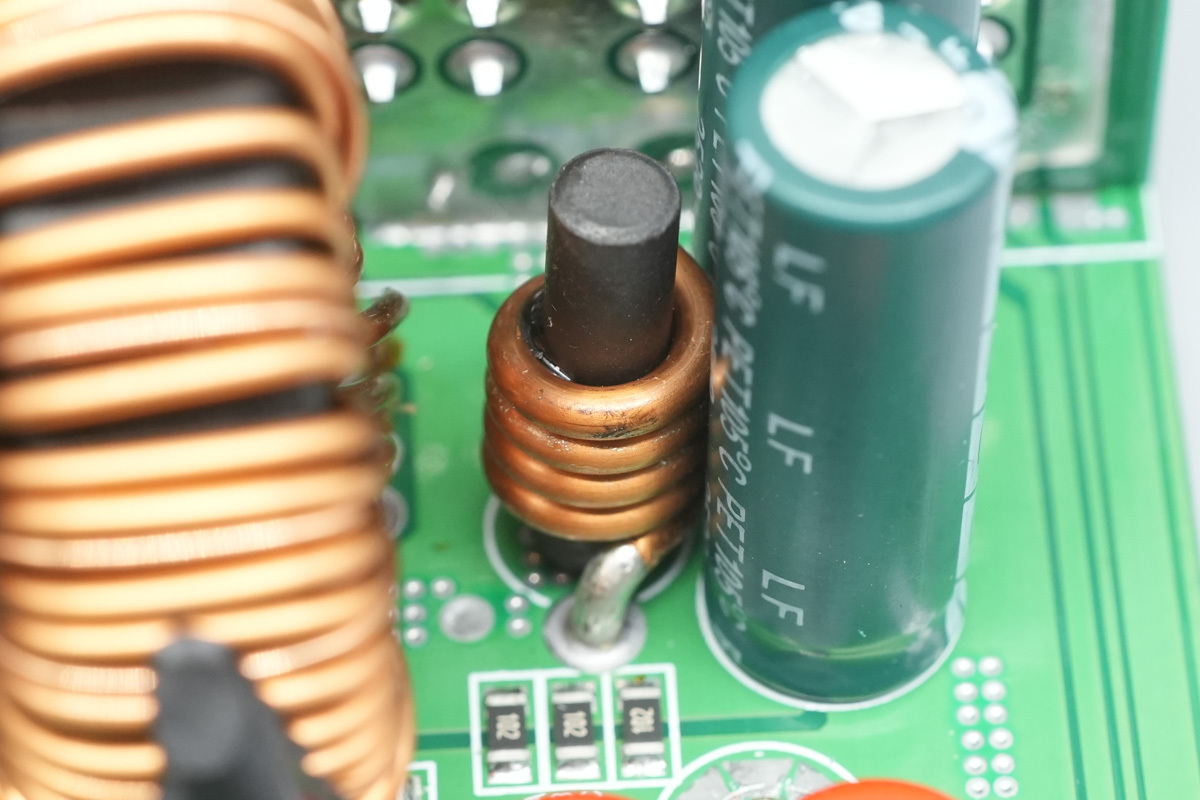

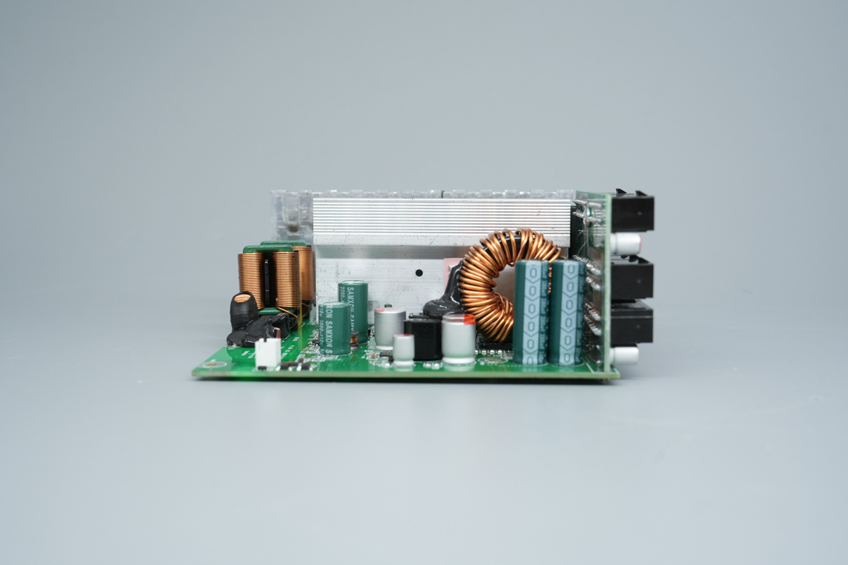

There is a filtering choke and a a filtering cap on the output end.

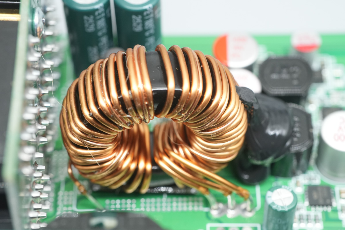

The filtering choke is constructed using multi-strand enameled wire wound in parallel.
The filtering choke is constructed using enameled wire windings.

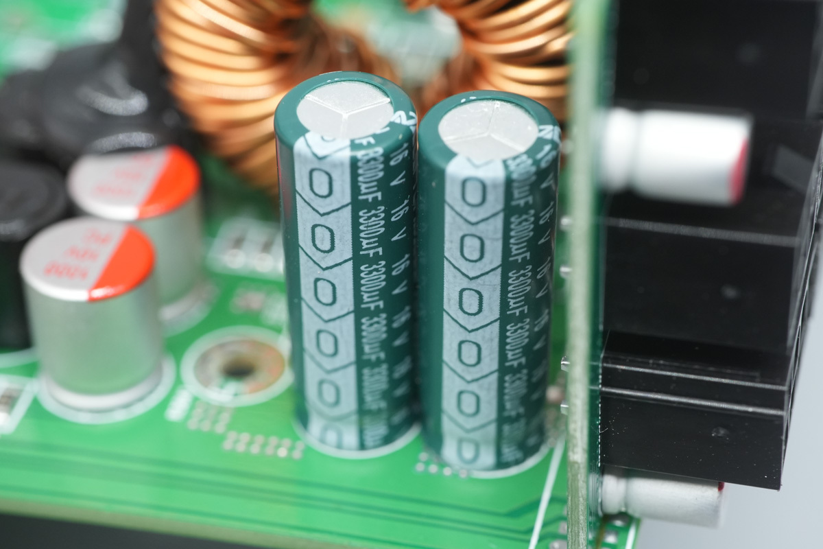

The filtering cap is from TOPAZCON, specifically the LF series of low-impedance electrolytic caps, rated at 16V and 3300μF.

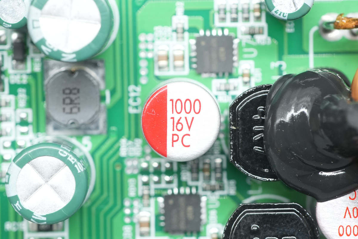

The filtering cap, 1000μF16V.

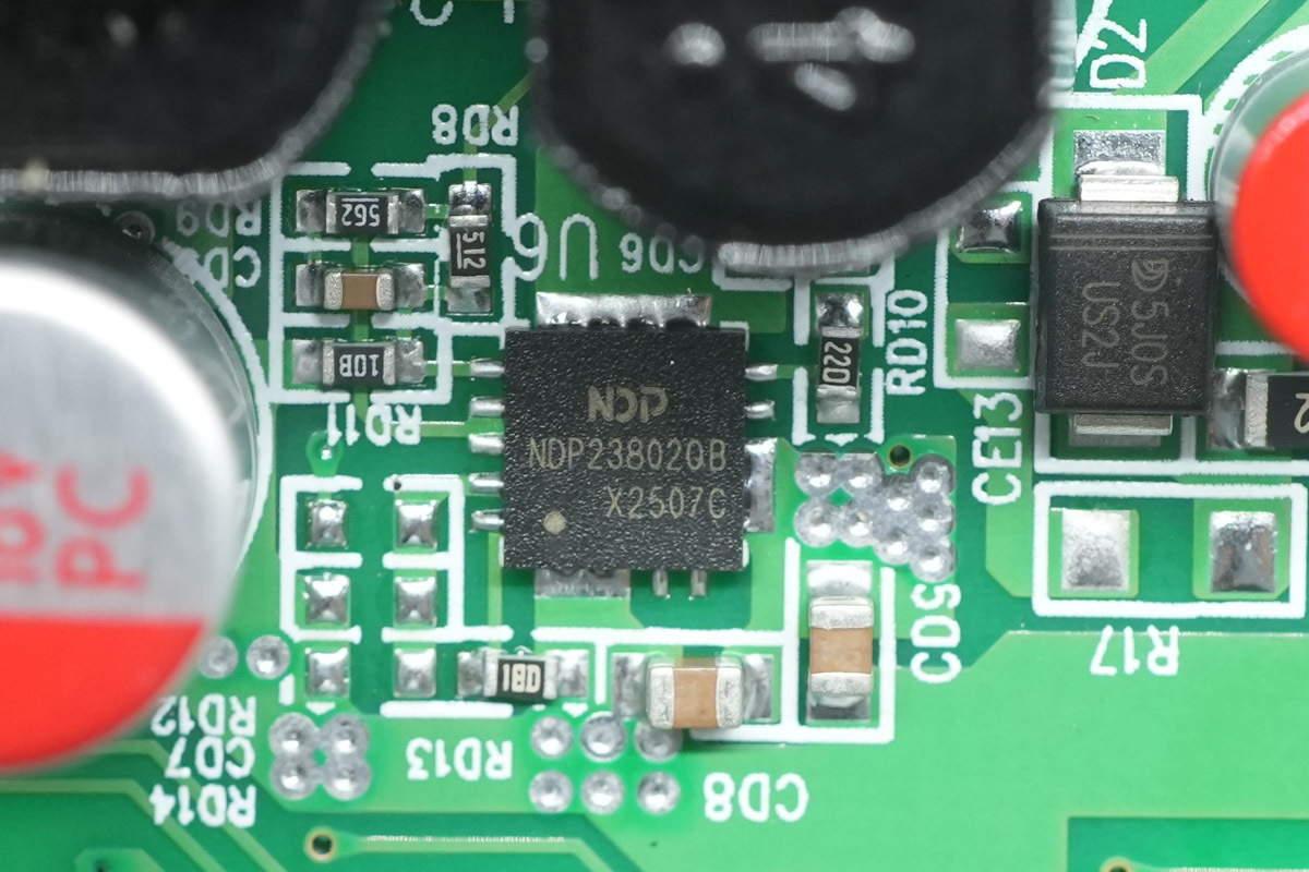

The synchronous step-down chip is from NDP, model NDP23802QB. It features an integrated power MOSFET and is housed in a QFN-20 package.

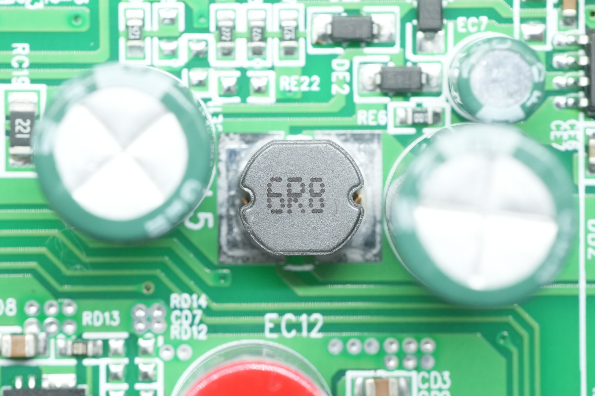

There are two step-down chokes, both 4.7μH.

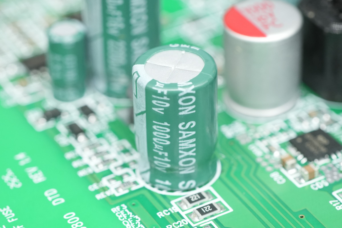

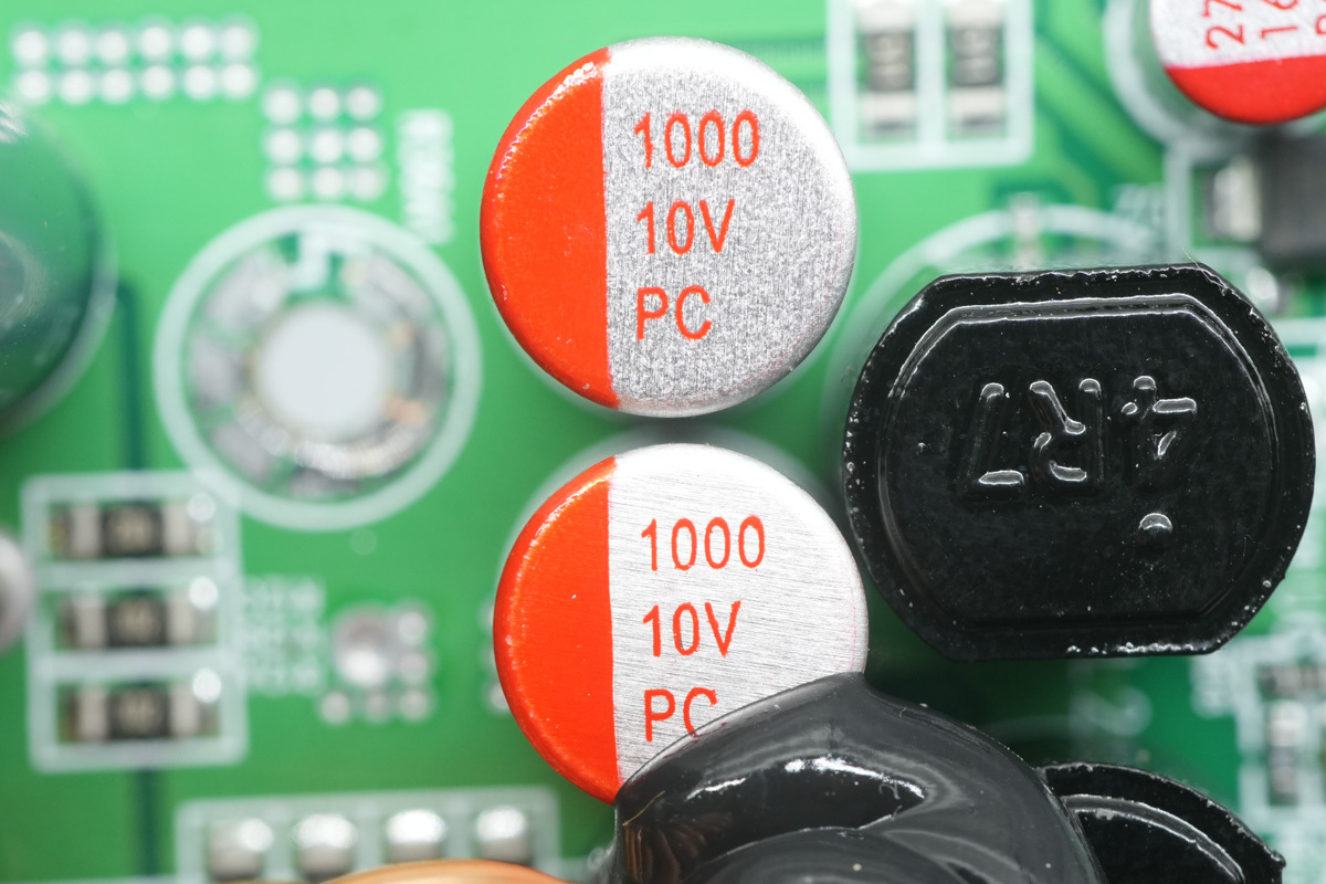

The filtering cap, 1000μF10V.

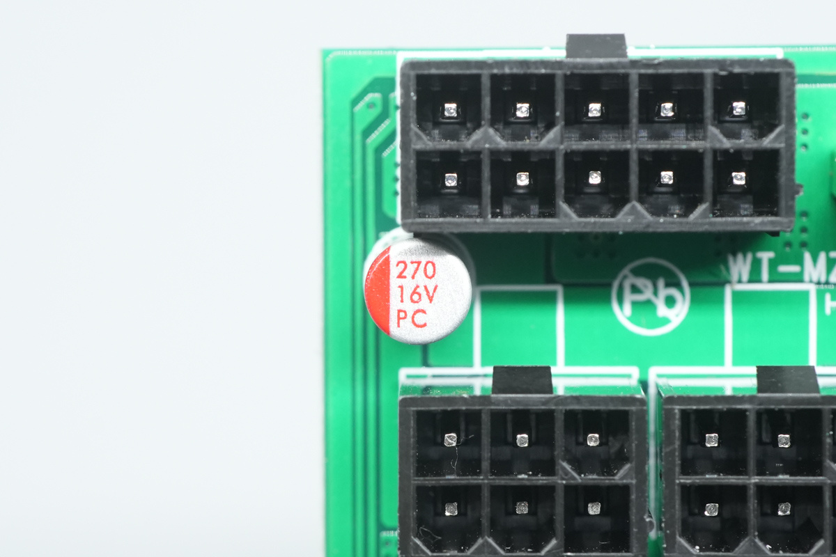

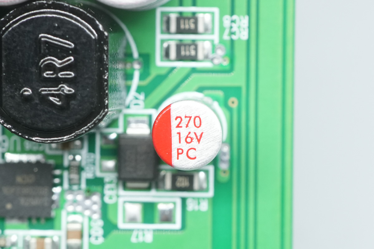

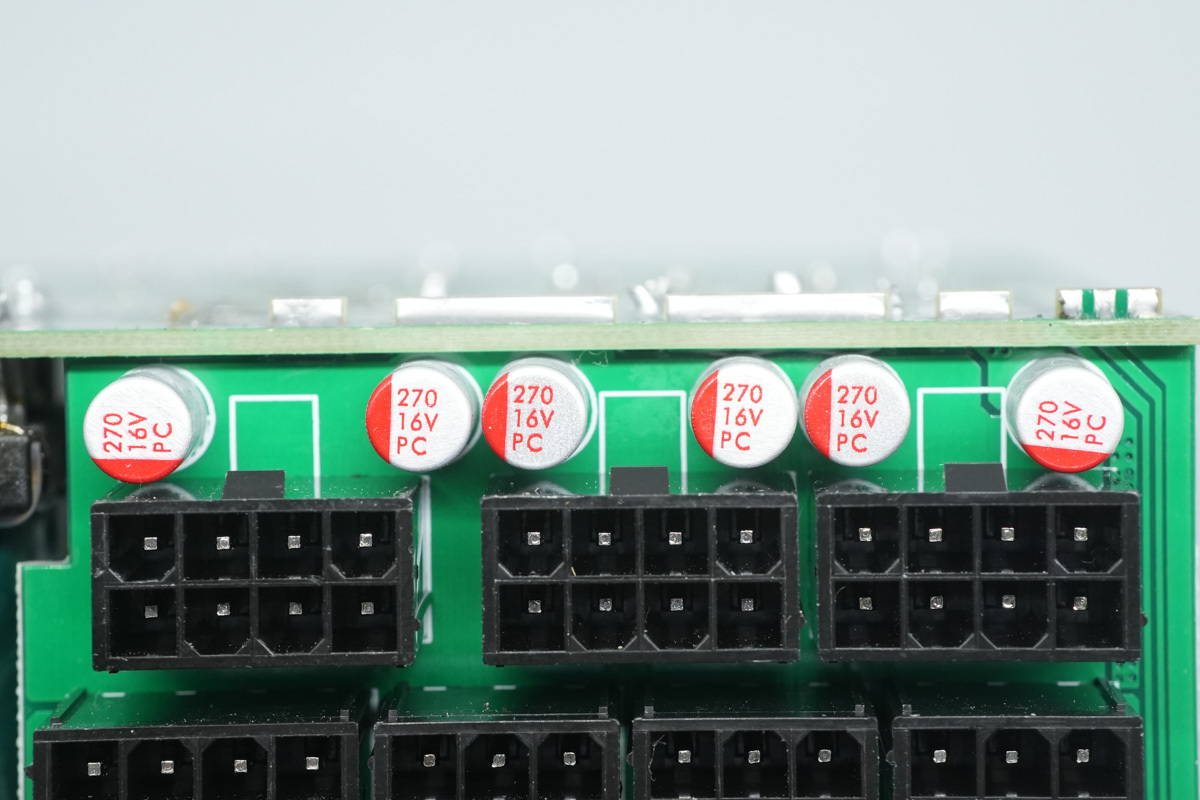

The filtering cap, 270μF16V.

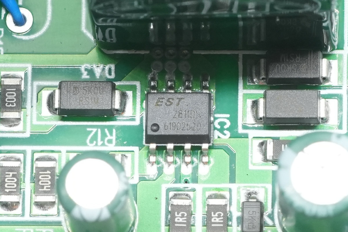

The standby power chip is from EST, model EST.2811DS. It features an integrated 650V power MOSFET and is housed in an SOP-8 package.

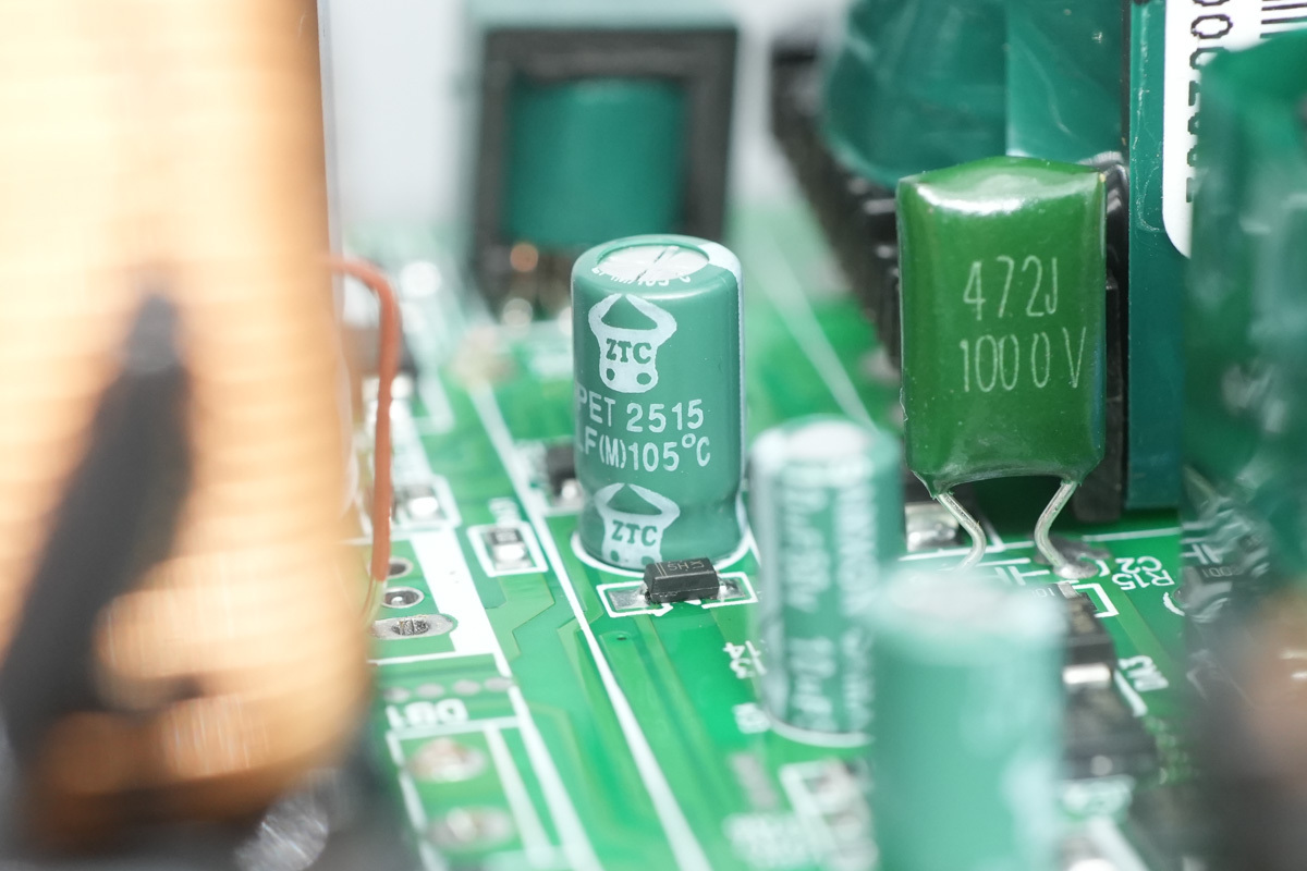

The filtering cap dedicated to supplying power to the main control chip is from ZTC.

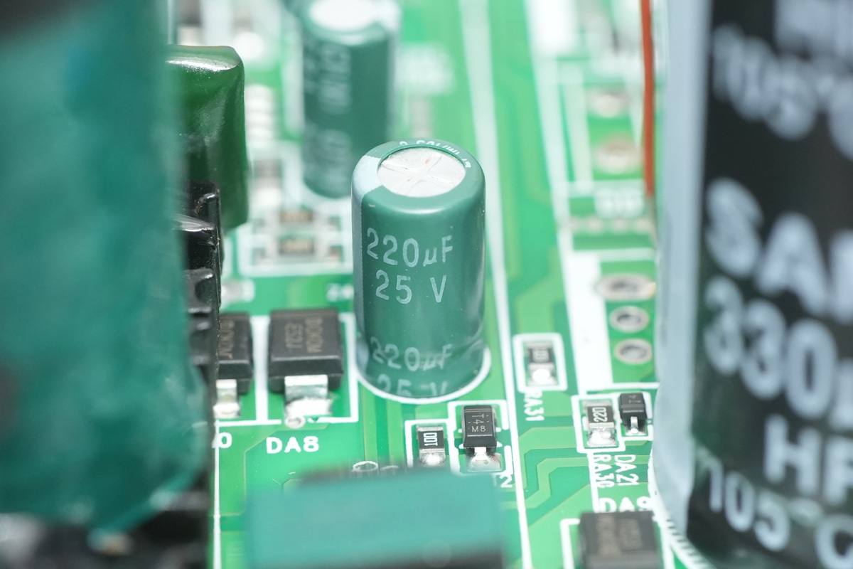

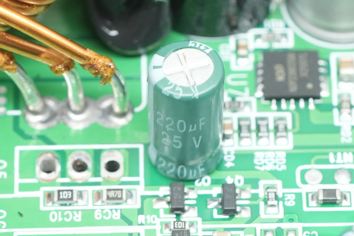

The filtering cap, 220μF25V.

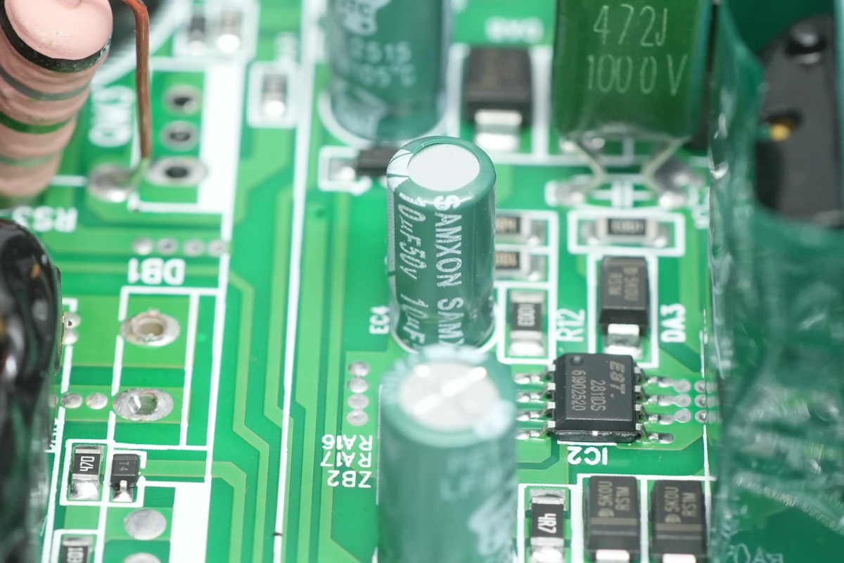

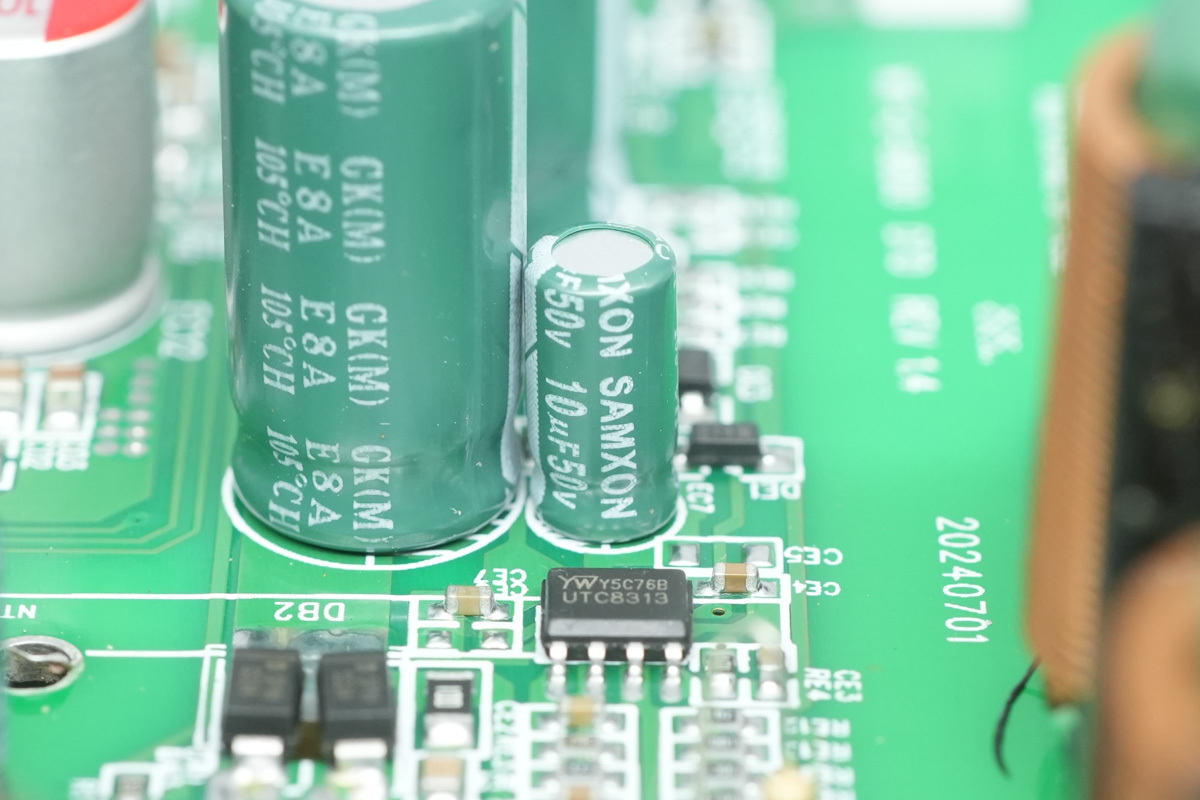

The filtering cap is from SAMXON, 10μF50V.

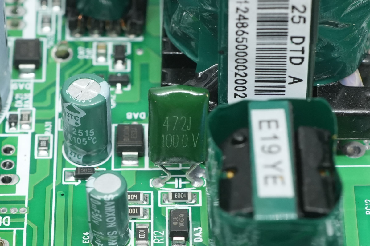

The film cap, 472J1000V.

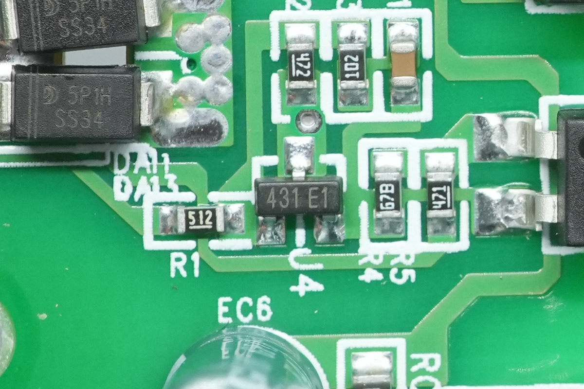

Rectification for the standby power rail is handled by two SS34 Schottky diodes from JINGDAO. With a 3A/40V rating and in a SMA packaging.

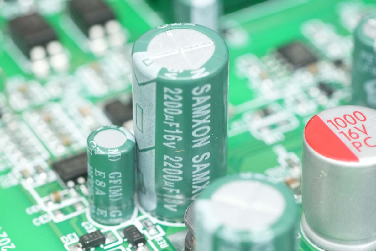

The filtering cap is from SAMXON, 2200μF16V.

This is the filtering cap, 6.8μH.

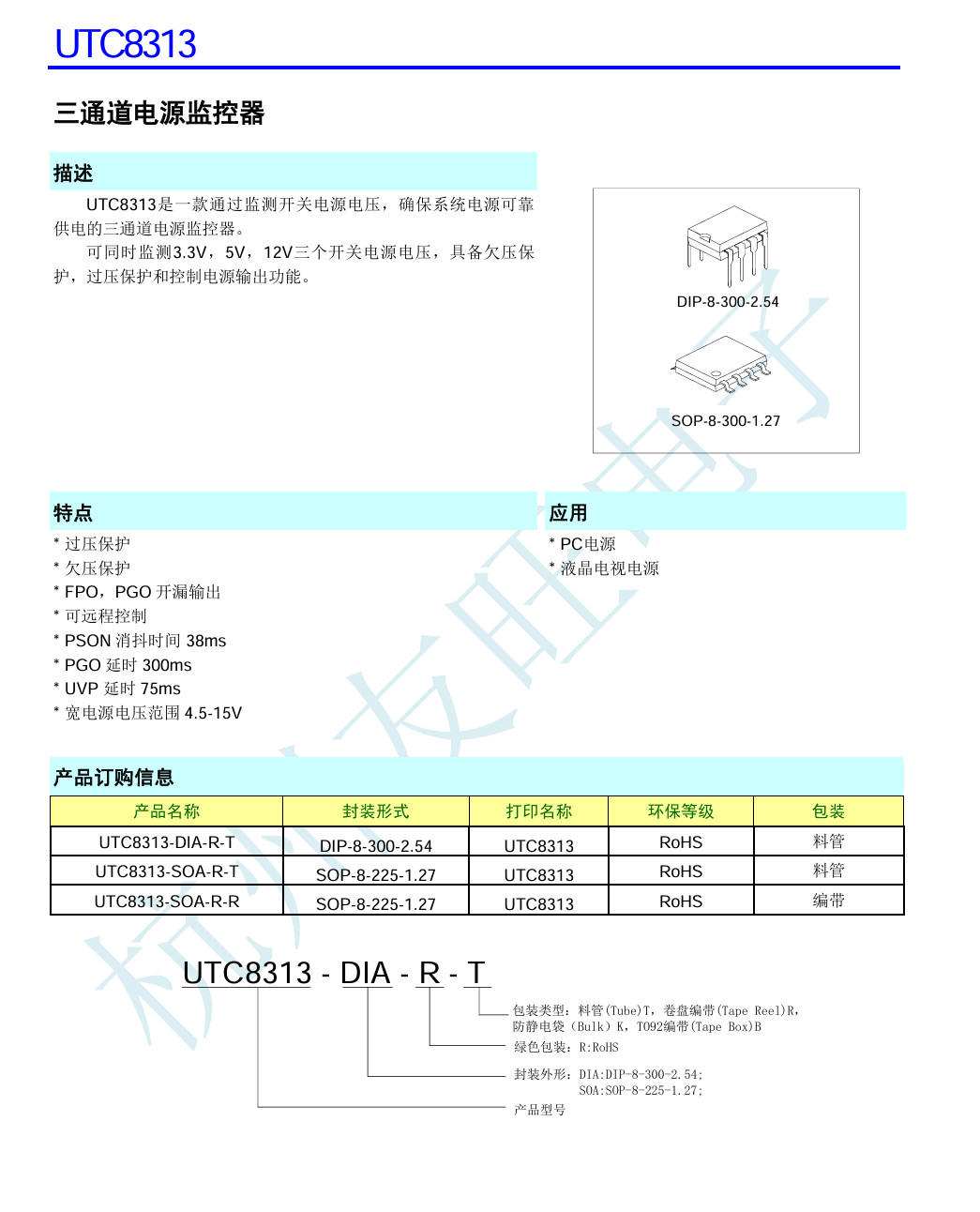

The power supervisor chip is from YW, model UTC8313. This 3-channel power supervisor monitors the 3.3V, 5V, and 12V output rails. It provides comprehensive protection, including UVP and OVP, while facilitating switch control and fault status signaling, all within an SOP-8 package.
Here is the info about YW UTC8313.

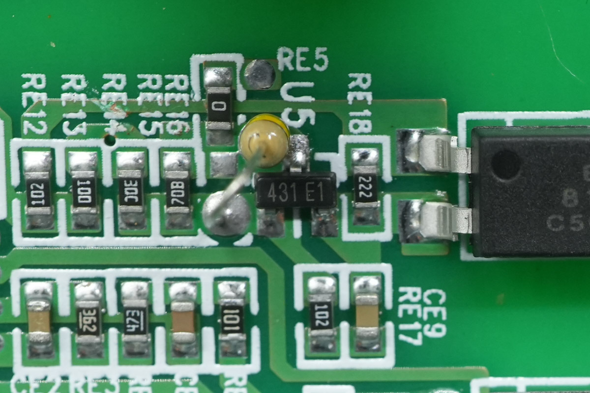

The voltage reference chip is from YW, model UTC431. This is a three-terminal adjustable precision shunt regulator capable of outputting a voltage between 2.5V and 36V. It is characterized by low dynamic output impedance, low noise, and fast turn-on response, all housed in a SOT-23 package.

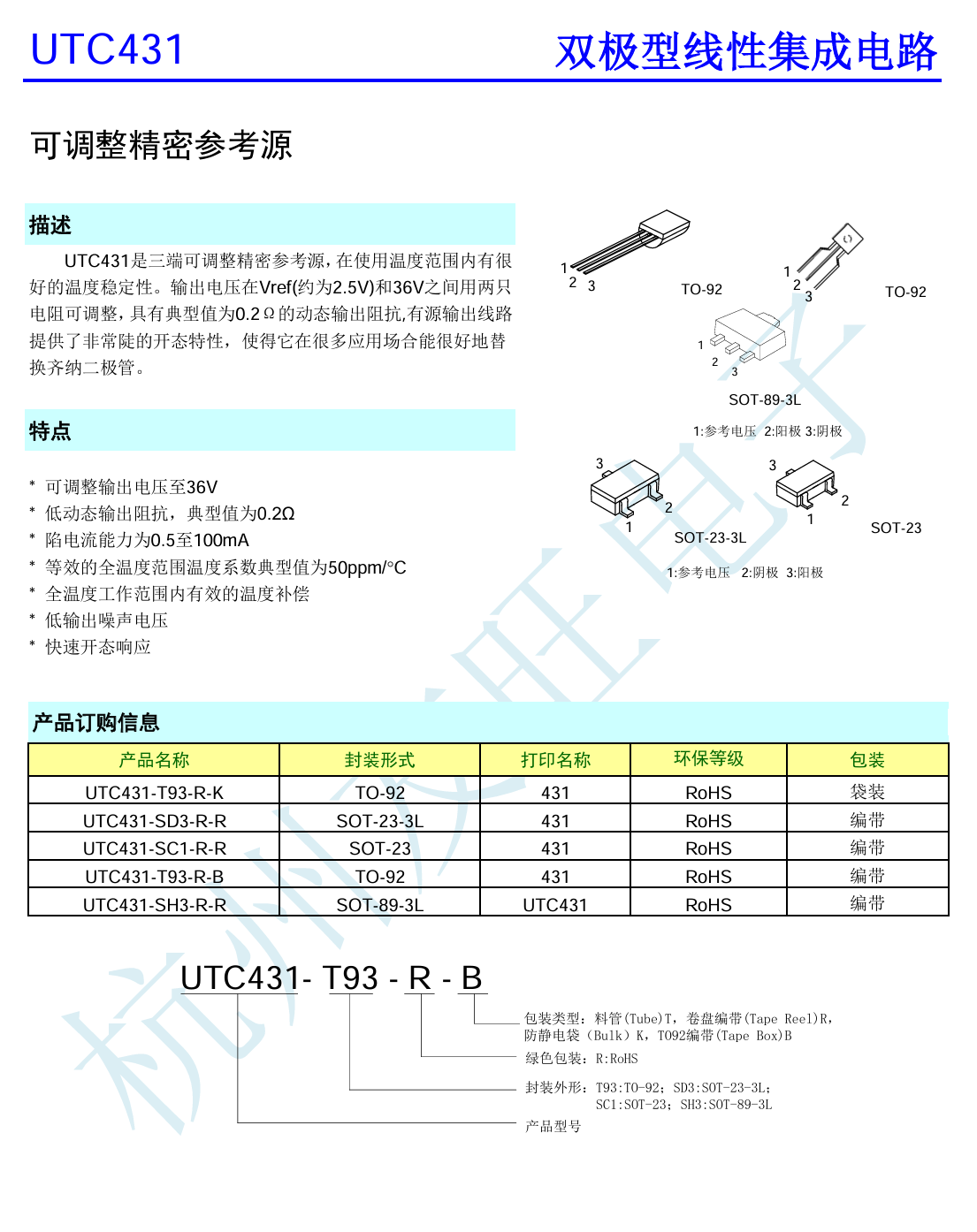

Here is the info about YW UTC431.

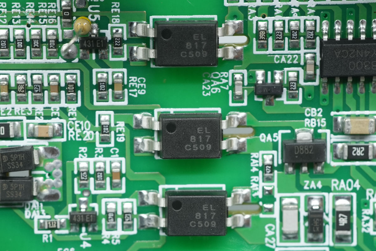

The optocoupler is from EVERLIGHT, model EL817, utilized to facilitate feedback and protection control.

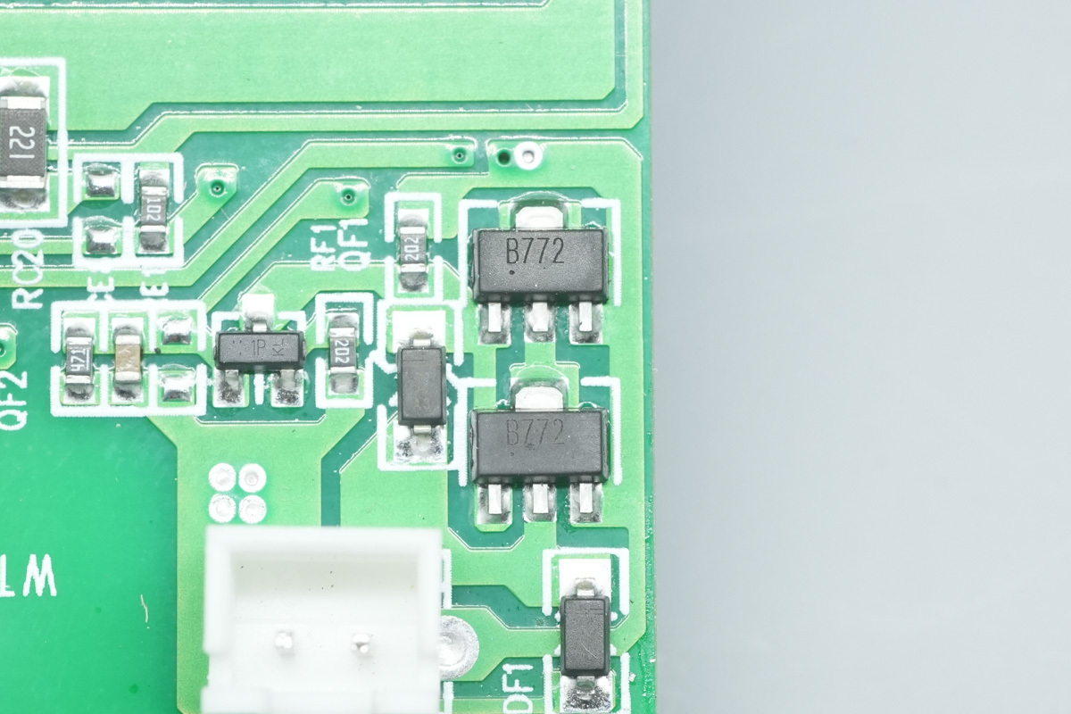

The cooling fan control circuit utilizes two B772 transistors connected in parallel.

To ensure a robust and reliable connection, the output PCB is both soldered and screwed into place. The PCB serves as the mounting base for the module interface and essential solid filtering caps.

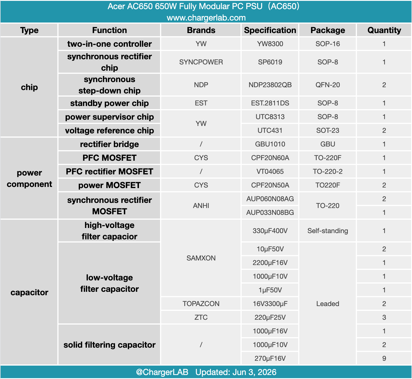

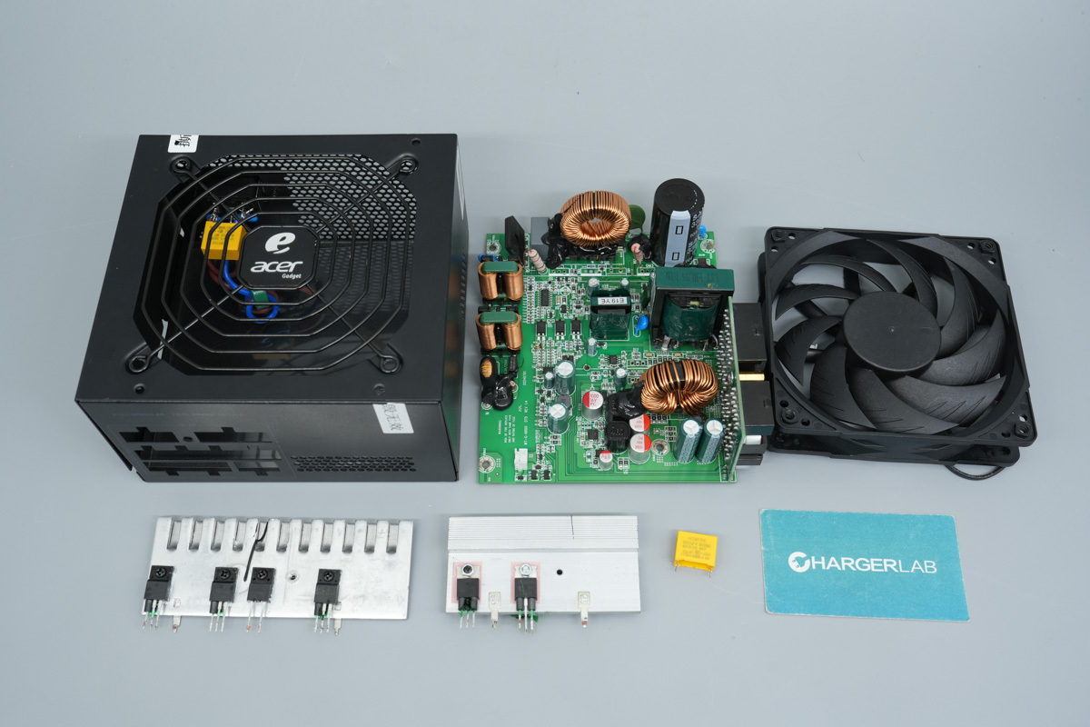

Well, those are all components of the Acer AC650 650W Fully Modular PC PSU.
The Acer AC650 PSU features a sleek black finish and a fully modular design, delivering a rated output of 650W to meet the needs of cost-effective PC builds. It utilizes an Active PFC circuit and high-specification primary electrolytic capacitors combined with solid filtering cap. The unit is 80 PLUS Bronze certified and comes with a 3-year warranty.
According to ChargerLAB’s teardown, it utilizes a highly efficient architecture consisting of an Active PFC, two-switch forward topology, synchronous rectification, and DC-DC conversion. It employs the YW YW8300—a 2-in-1 controller integrating CCM PFC and a forward converter—paired with power MOSFETs from CYS.
The secondary synchronous rectifier MOSFETs are sourced from ANHI. System monitoring is handled by the YW UTC8313, which provides OVP and UVP for the 3.3V, 5V, and 12V rails, as well as power switch control. The primary high-voltage cap is provided by SAMXON, complemented by solid filtering cap. The unit includes a temperature-controlled fan and features large-area heatsinks on the power transistors to ensure stable and reliable operation.
