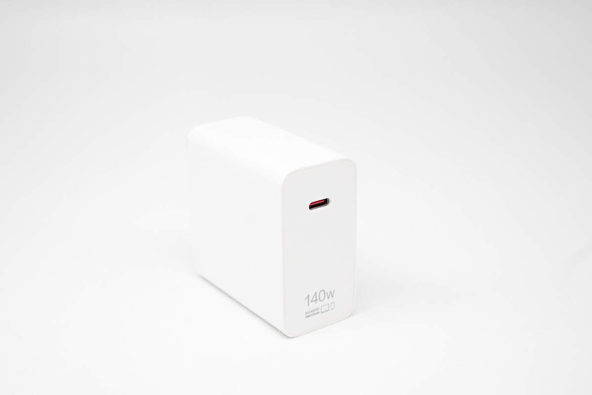

ChargerLAB recently conducted a series of tests on the Huawei MateBook X Pro. This laptop supports 140W fast charging and is equipped with a 140W charger, which is currently the Huawei charger with the highest charging power.
Today we will conduct charging tests on the original 140W charger to see how Huawei’s first 140W charger performs.
Review of the Original 140W Charger of Huawei MateBook X Pro-Chargerlab
The 140W charger comes in pure white. The case is made of PC fire-retardant material with a smooth surface.
It only has one orange USB-C port. The words “HUAWEI Super Charge” and “140W” are printed below the port.
