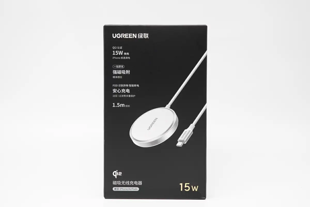

The front of the box is printed with UGREEN, product appearance, Qi2, 15W, and other selling points.
Review of UGREEN Qi2 Magnetic Wireless Charger-Chargerlab
Some specs info are printed on the back. Model is W703. It can support input of 5V3A or 9V2.22A. The maximum output power is 15W.
