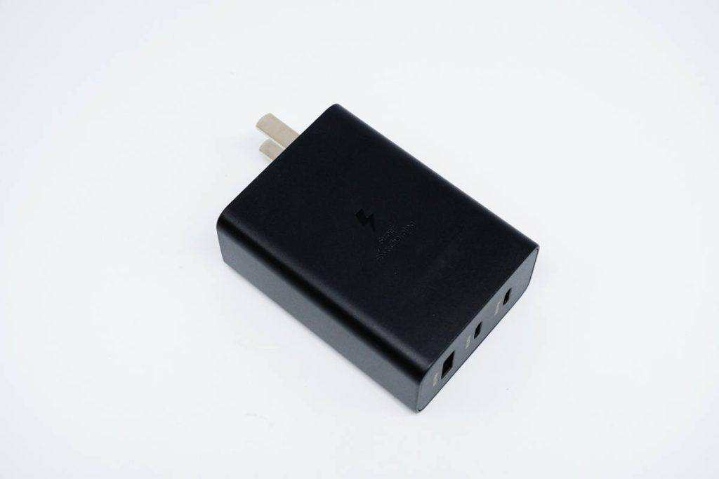

The charger has a black flame-retardant shell.
Power Distribution Review of Samsung 65W 2C1A Charger EP-T6530-Chargerlab

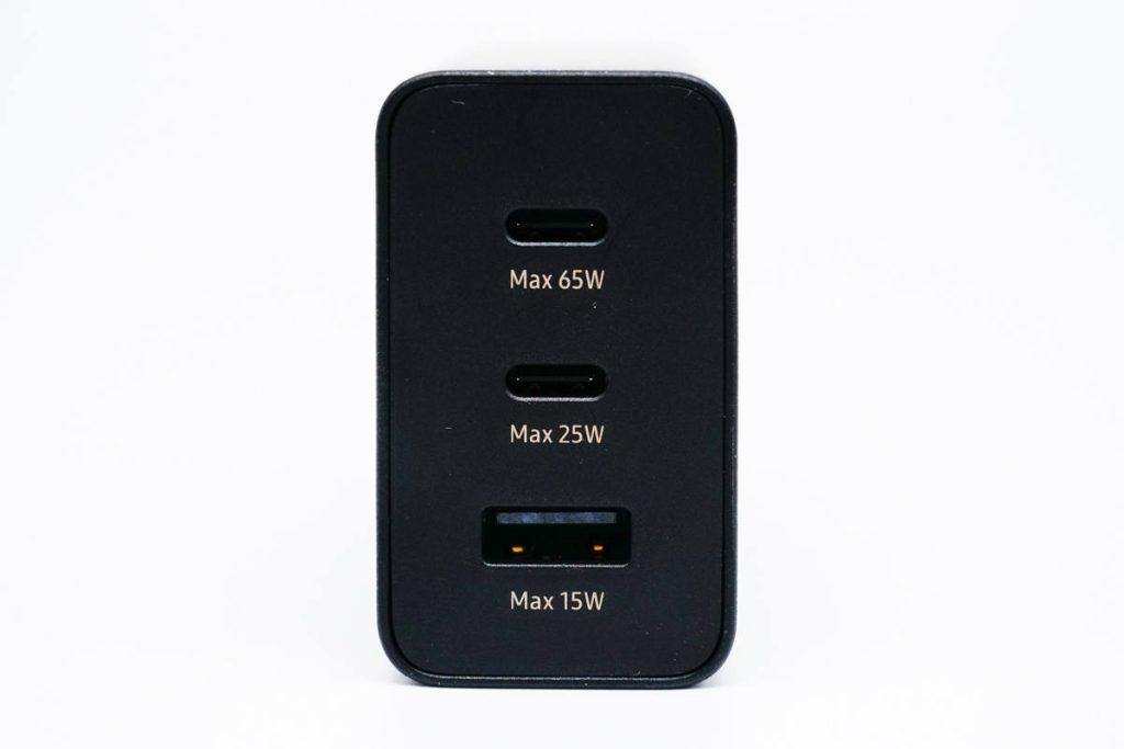

There are two USB-C ports and one USB-A port on the side, where the bottom is printed with the maximum output power, from which we can see that the two USB-C ports have different powers.

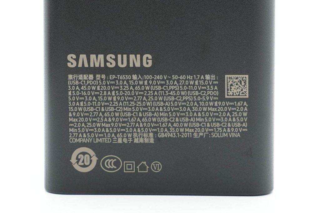

The specifications are printed on the bottom of the charger.
USB-C1 output: 5V3A, 9V3A, 15V3A, 20V3.25A
USB-C2 output: 5V3A, 9V2.77A
USB-A output: 5V2A, 9V1.67A
USB-C1+USB-C2: 65W (MAX)
USB-C1+USB-A: 65W (MAX)
USB-C2+USB-A: 40W (MAX)
USB-C1+USB-C2+USB-A: 65W (MAX)

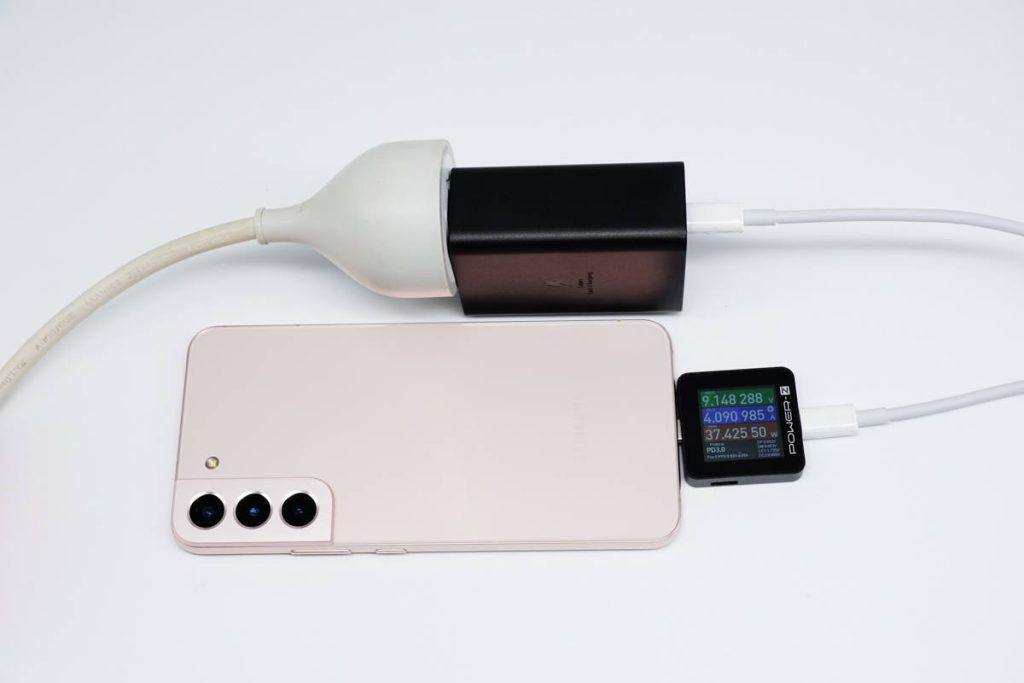

Using USB-C1 to charge the Samsung S22+, it supports 65W PD fast charging and 45W PPS fast charging, and the Samsung S22+ supports 45W PPS fast charging. The charging power is 9.14V 4.09A 37.42W, which is in PPS fast charging.

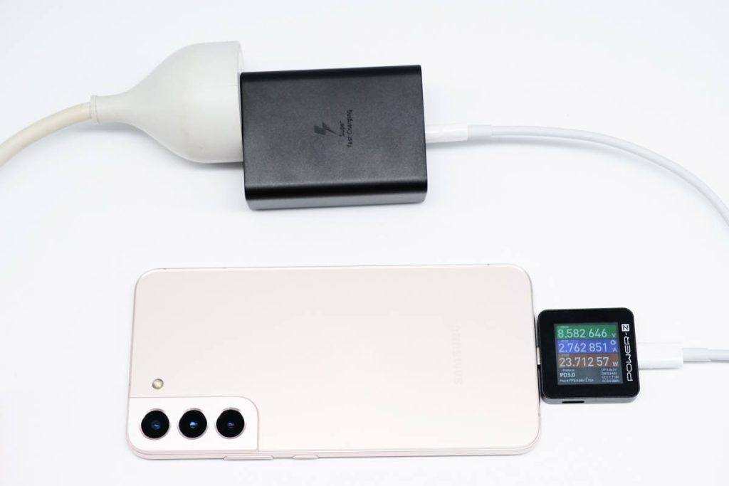

Using USB-C2 to charge the Samsung S22+, it supports 25W PD fast charging and 30W PPS fast charging, and the Samsung S22+ supports 45W PPS fast charging. The charging power is 8.58V 2.76A 23.71W, which is in PPS fast charging.
Both USB-C ports successfully activated PPS fast charging for charging the Samsung S22+.

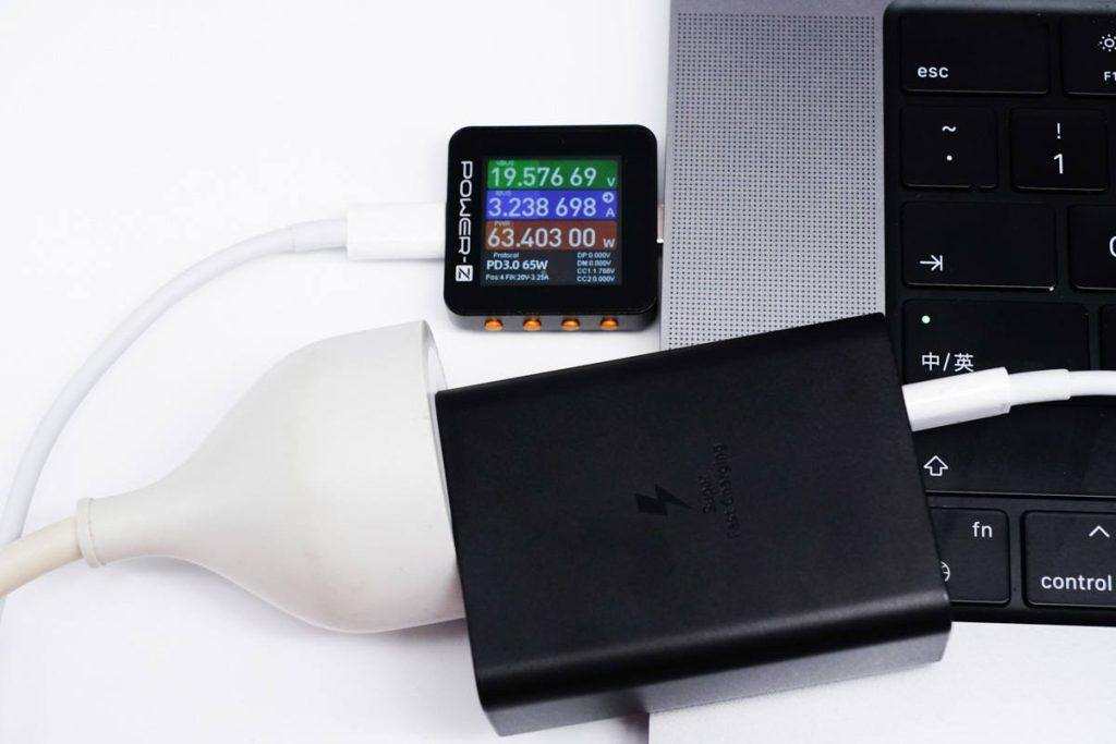

It is 18.57V 3.23A 63.4W when the USB-C1 is charging the MacBook Pro 16, activating the PD fast charging.

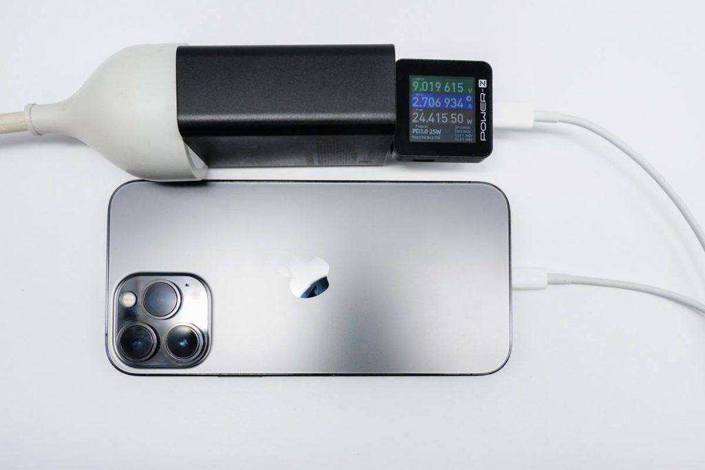

When charging the iPhone 13 Pro Max, the USB-C2 is at around 25W, which has reached its maximum output power.

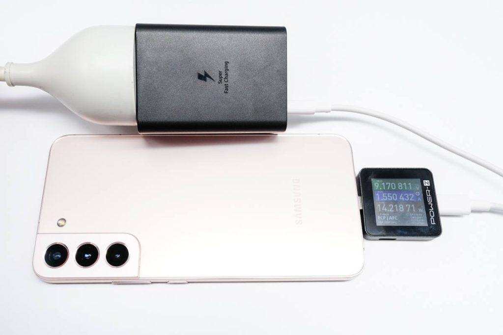

It is around 14W when the USB-A port is charging the Samsung S22+.

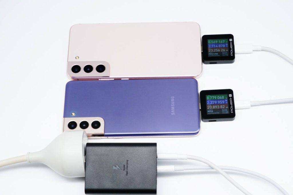

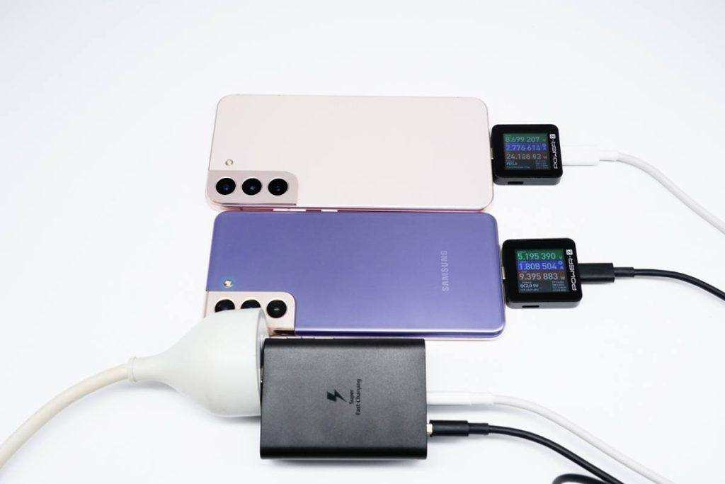

Using USB-C1 to charge the Samsung S22+ and USB-C2 to charge the Samsung S21 simultaneously, the powers are 23.25W and 20.89W, respectively.

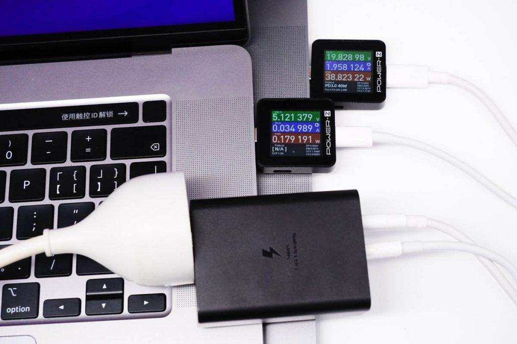

Using USB-C1 and C2 to charge two laptops simultaneously, the power of USB-C1 is 38.82W, and USB-C2 has no output power. It seems that the two USB-C ports cannot charge two laptops at the same time.

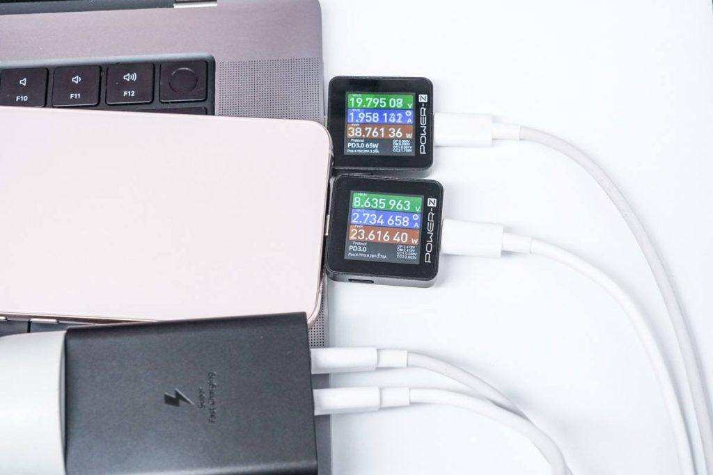

Using USB-C1 to charge the laptop and USB-C2 to charge the Samsung S22+ simultaneously, the powers are 38.76W and 23.61W, respectively. Then, the USB-C1 is in PD fast charging, while USB-C2 is in PPS fast charging.

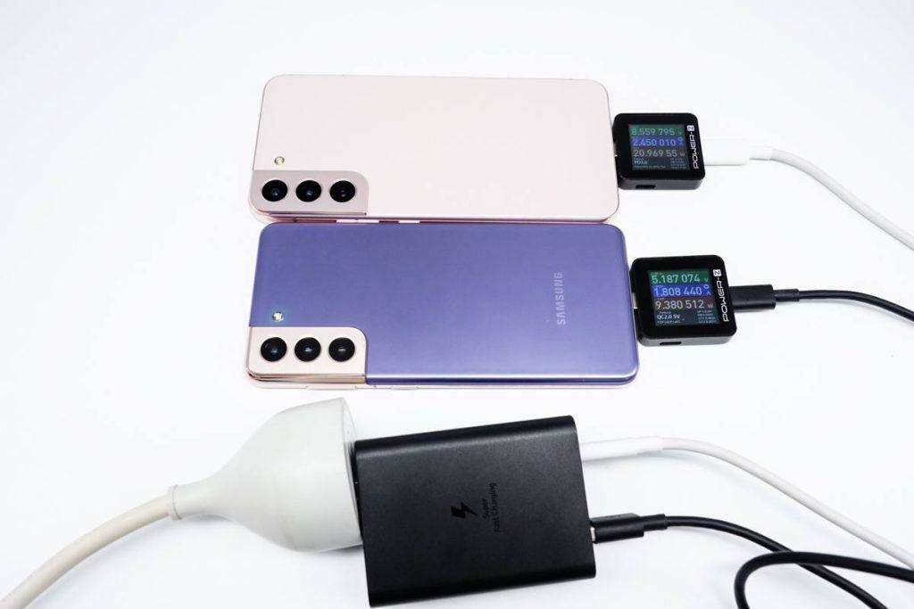

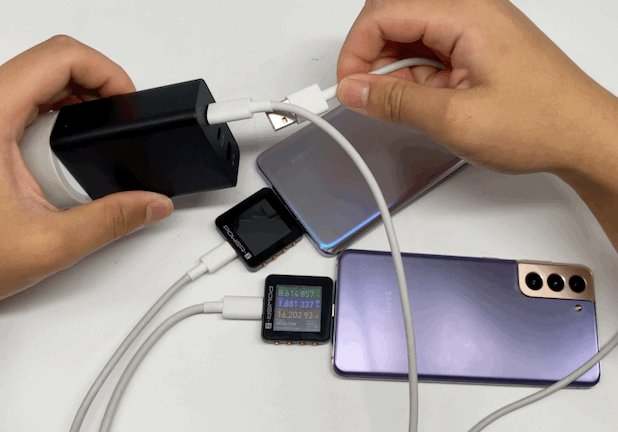

Using USB-C1 to charge the Samsung S22+ and USB-A to charge the Samsung S21 simultaneously, the powers are 20.98W and 9.38W, respectively. Then, the USB-C1 is in PPS fast charging, while USB-A is in AFC fast charging.

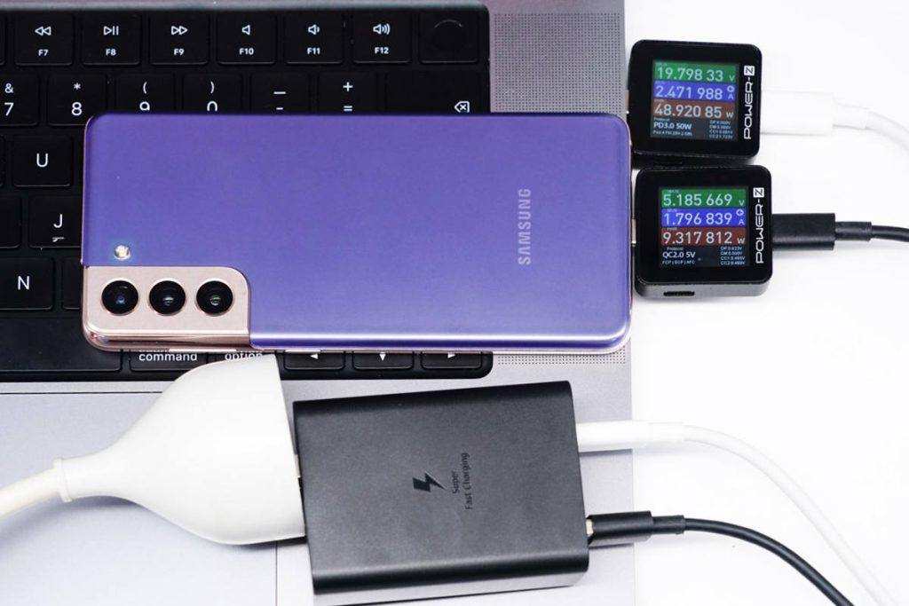

Using USB-C1 to charge the laptop and USB-A to charge the Samsung S21 simultaneously, the powers are 48.92W and 9.31W, respectively. Then, the USB-C1 is in PD fast charging, while USB-A is in AFC fast charging.

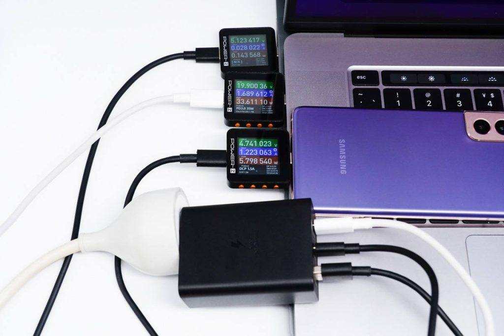

Using USB-C1 and C2 to charge two laptops while using the USB-A to charge the phone simultaneously, the powers of C1 and A are 33.61W and 5.79W, respectively. And the USB-C2 has no output power.

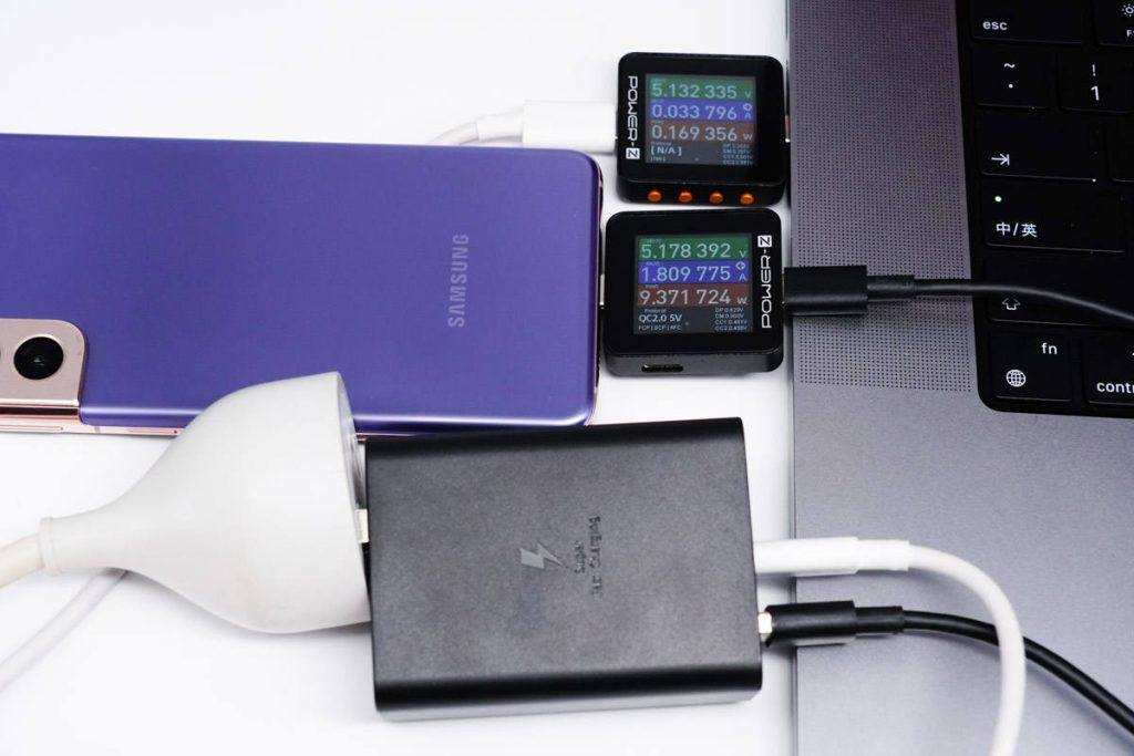

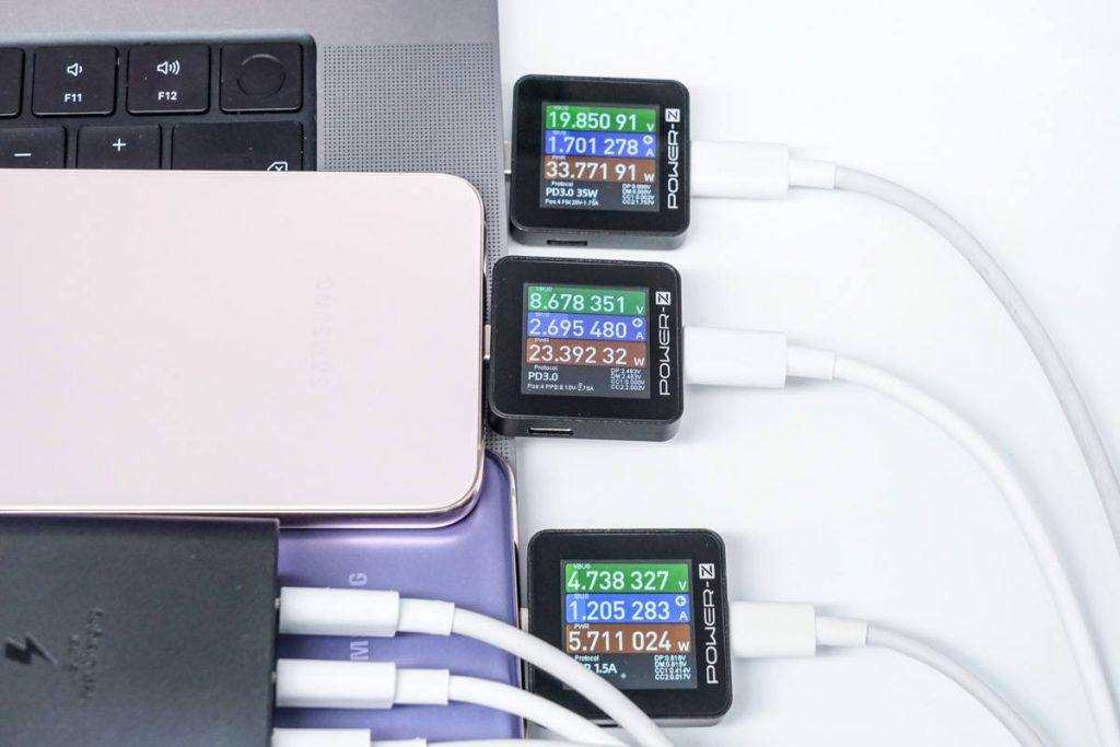

Using USB-C1, C2 and A to charge the laptop, Samsung S22+ and Samsung S21 simultaneously, the powers are 33.77W, 23.39W and 5.71W, respectively. Then, the USB-C1 is in PD fast charging, USB-C2 is in PPS fast charging, and the USB-A port is in AFC fast charging.

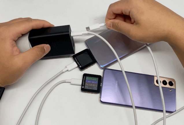

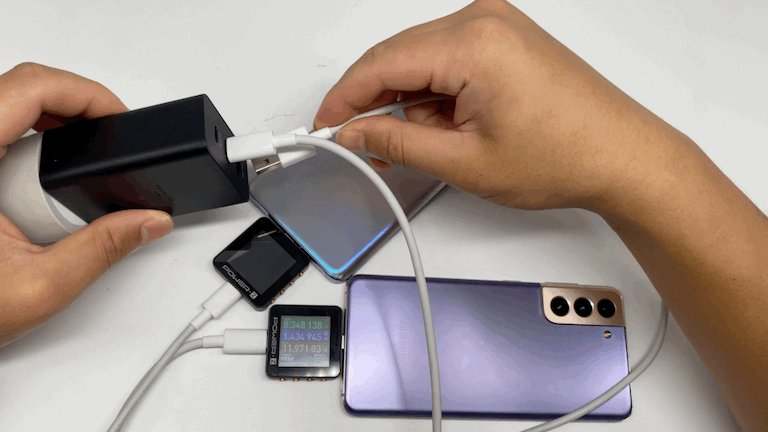

When a multi-port charger is charging multiple devices, the first cable will stop working when inserting the second cable, as seen in most multi-port chargers. Let's see if the Samsung 65W charger has the problem.
When the USB-C1 is charging the phone, the other cable is inserted into the USB-C2 port. At this time, the USB-C1 stops charging, and its power drops back to zero and then returns to normal.
Let's test the other port. At this time, when USB-C1 is charging the phone, the cable is inserted into the USB-A port. The power of USB-C1 decreases at the moment, but it does not return to zero.
Inserting the cable into the USB-A when the USB-C2 is charging the phone, we can see the power of the C2 doesn't reduce or return to zero.
