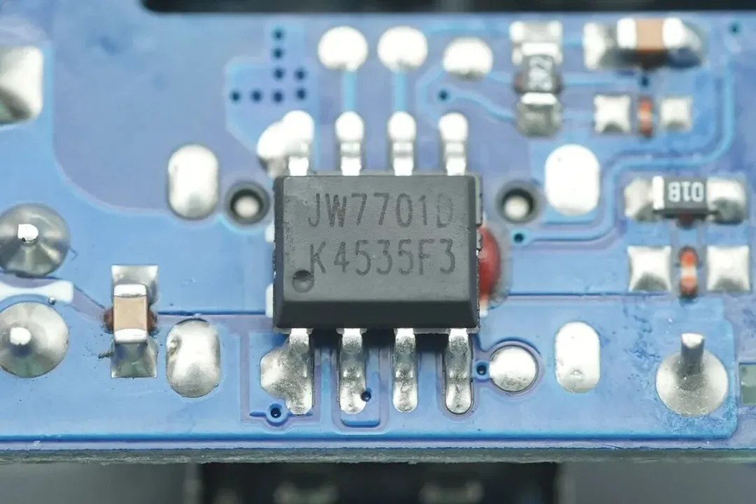

As consumer electronics evolve rapidly, the fast-charging adapter market demands uncompromising protocol compatibility and top-tier power density. Meet the JoulWatt JW7701D: a highly integrated, single-port, multi-protocol controller designed specifically for low-to-medium power adapters and USB charging devices. Shipped in a space-saving ESOP-8 footprint, it is fully certified by the USB-IF association for USB PD3.1 PPS (TID: 10615). Supporting Type-C DFP (Source) configurations, the JW7701D seamlessly speaks PD3.1, PPS, and China’s UFCS fusion protocol. It also covers major proprietary standards like Qualcomm QC, Huawei FCP/HVSCP, MediaTek PE, Samsung AFC, and Xiaomi Charge Turbo—ensuring universal fast charging across diverse mobile devices.
JoulWatt Unveils the JW7701D USB-C Single-Port Multi-Protocol Controller | Driving High-Integration Fast Charging-Chargerlab
Architecturally, the JW7701D delivers unparalleled integration, slashing the need for external components. It packs a low-impedance VBUS switch MOSFET, a precision 10mΩ current sense resistor, a feedback network, and CV/CC control loop drivers right into the silicon. The result? A radically smaller PCB footprint and a significantly leaner BOM cost. To elevate user experience, it supports intelligent cable compensation, counteracting voltage drops to maintain rock-solid stability under heavy loads. Safety is equally paramount: the IC is armored with input OVP/UVP, output OCP/SCP, OTP, CC-pin over-voltage protection, and a robust 4kV ESD rating, ensuring bulletproof reliability during intense multi-device usage and daily wear-and-tear.
By condensing complex protocol decoding, high-current paths, precision sensing, and feedback loops into a single chip, JoulWatt offers manufacturers a fast track to market with low development overhead and unbeatable ROI. The JW7701D perfectly aligns with the industry's relentless push for miniaturization and high-density power. As universal charging standards and protocol convergence take center stage, ultra-integrated controllers like the JW7701D will continue to empower developers to beat complex charging challenges with minimalist circuit designs—paving the way for an efficient, safe, and highly affordable fast-charging future.
