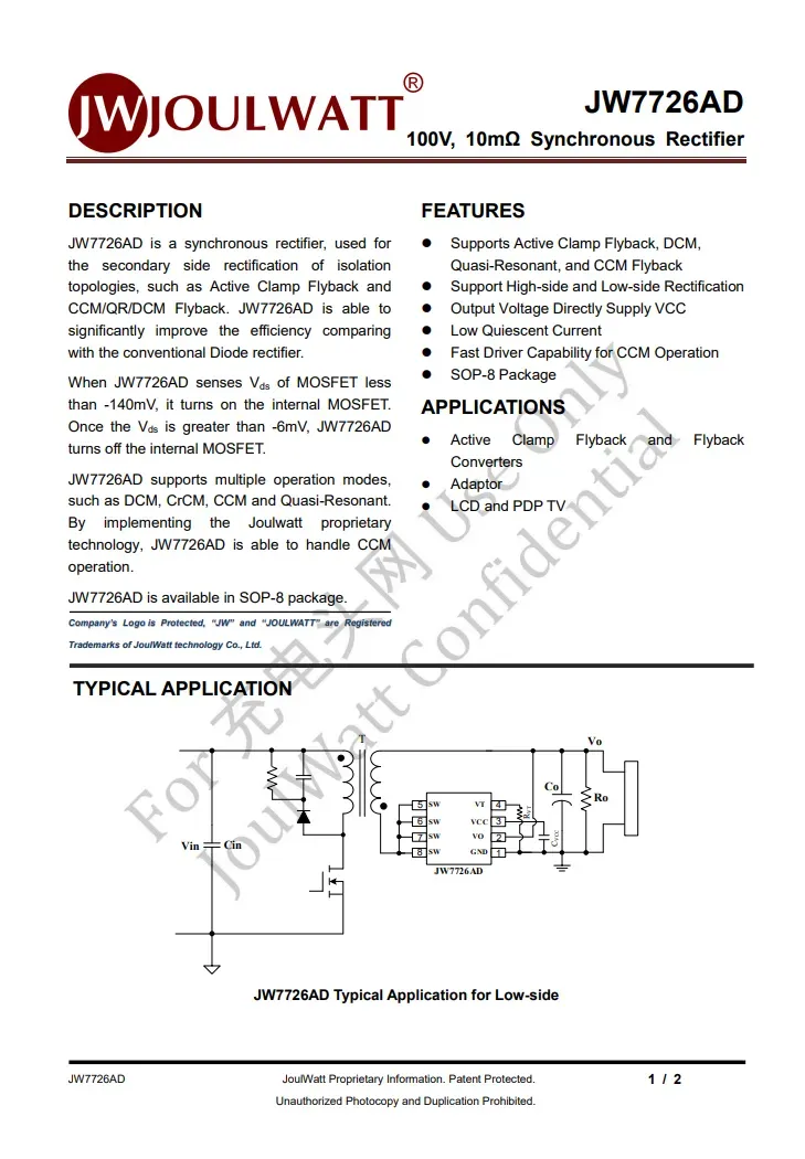

With efficiency and power density taking center stage in adapter design, secondary-side rectification losses from legacy Schottky diodes are now a critical bottleneck. Enter the JoulWatt JW7726AD—a highly integrated, 100V-rated synchronous rectifier designed to change the game for isolated topologies. Packed into a space-saving SOP-8 footprint, the JW7726AD integrates a premium 10mΩ power MOSFET right onto the silicon. By swapping high-loss diode drops for an ultra-low impedance active path, it slashes thermal buildup, giving developers the hardware edge needed to hit new milestones in efficiency and thermal management for flyback and fast-charging adapters.
JoulWatt Unveils the 100V Synchronous Rectifier IC JW7726AD | Driving High-Efficiency Isolated Power Designs-Chargerlab
The JW7726AD shines in system versatility and dynamic response. It is a drop-in fit for cutting-edge Active Clamp Flyback (ACF) topologies while maintaining flawless backward compatibility with DCM, CrCM, CCM, and Quasi-Resonant (QR) architectures. Supporting both high-side and low-side configurations, it adapts effortlessly to any power level or control scheme. Efficiency is designed into every layer: the IC draws VCC directly from the output and boasts exceptionally low quiescent current, ensuring stellar efficiency during light loads and high-frequency standby. Furthermore, its ultra-precise Vds sensing network reacts instantly: turning on the sync MOS the moment Vds drops below -140mV, and executing a lightning-fast shutoff when Vds climbs back above -6mV. This aggressive optimization squeezes out every drop of conduction loss while completely eliminating reverse current spikes, ensuring bulletproof stability under brutal dynamic loads.

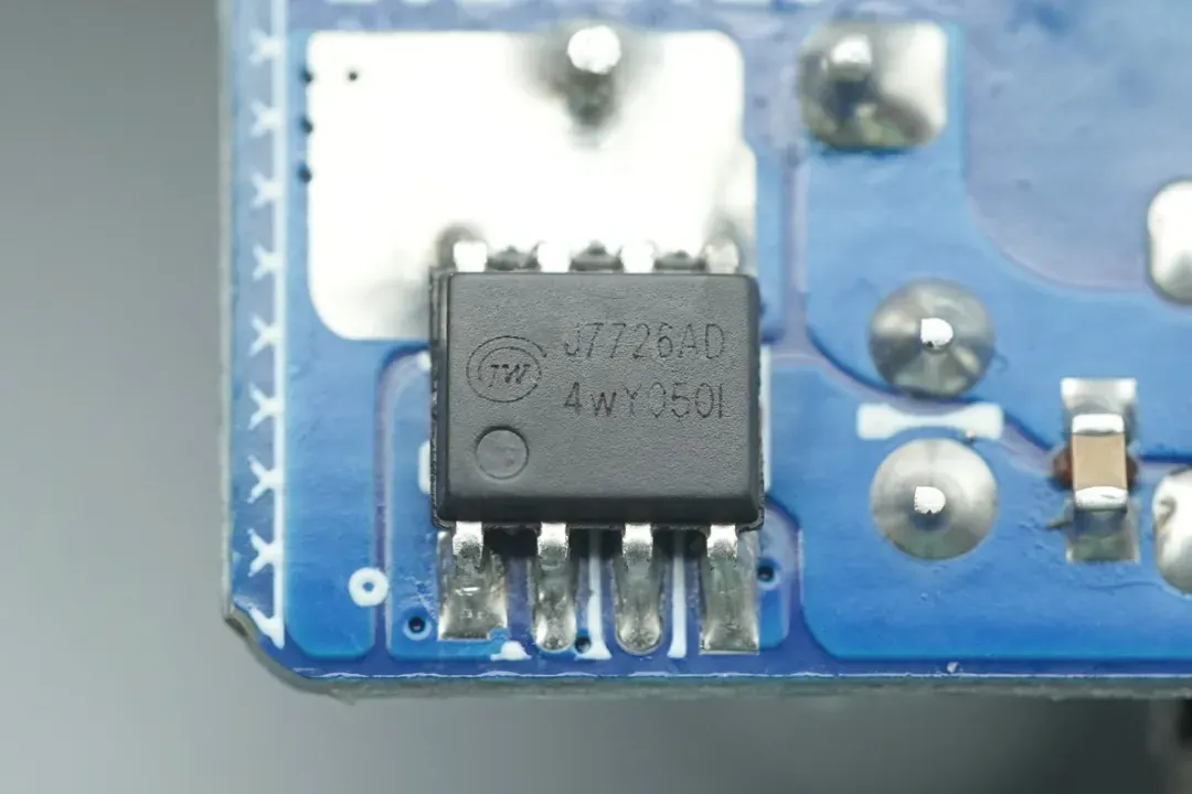

By packing a heavy-duty 100V MOSFET and an intelligent control loop into a minimalist SOP-8 package, JoulWatt lets engineers fast-track their way to cooler, high-efficiency power without complicating their BOM. Proven in volume teardowns—like the 35W GaN charger by Xihui Da—this IC represents a highly mature, field-tested solution for thermal optimization. As wide-bandgap (GaN/SiC) tech and advanced protocols push boundaries, highly integrated synchronous rectifiers like the JW7726AD are set to lead the charge, driving isolated switch-mode power supplies toward unprecedented power density and miniaturization.
