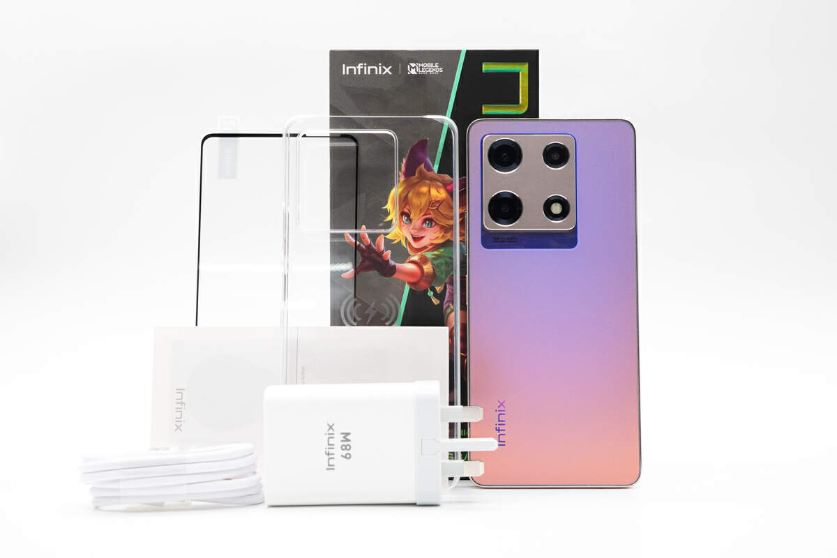

A few months back, we got our hands on the Infinix Note 30 Pro from Malaysia. It adopts MediaTek Helio G99 and has a large battery capacity of 5000mAh. It also supports 68W wired fast charging and 15W wireless charging.
Following that, we produced a ChargerLAB Compatibility 100 video specifically for this device. Through the video, we aimed to offer viewers a full understanding of its capabilities. Now, we're presenting this information in written form to provide a more detailed insight into its charging compatibility.

Since this phone is the only Infinix product we have, so we just gonna test its original charger.
Infinix Note30 Pro Charging Test - ChargerLAB Compatibility 100-Chargerlab
According to ChargerLAB POWER-Z KM003C, the original Infinix 68W charger can charge the phone at 9.28V 6.06A 56.23W, which is lower than the rated power.
