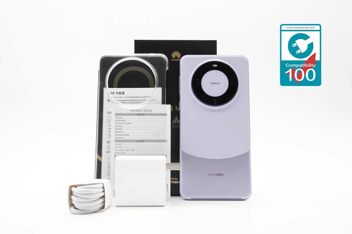

In the past few years, due to various restrictions, Huawei smartphones couldn't utilize the Kirin chipset. However, Huawei persisted in chip development. After nearly four years of research and development, they achieved a breakthrough, showcased in the latest Huawei Mate 60 Pro. This phone, equipped with a new chipset and robust communication capabilities, marks a powerful return.
Huawei Mate 60 Pro Charging Test - ChargerLAB Compatibility 100-Chargerlab
The Huawei Mate 60 Pro features the Ark Engine, Xuanwu architecture, and the all-new Kirin 9000s chipset, coupled with a 5000mAh battery. Additionally, it supports 88W Super Fast Charging, 50W Wireless Super Fast Charging, 20W Wireless Reverse Charging, and boasts IP68 dust and water resistance. Now, let's explore the charging compatibility of this device.
