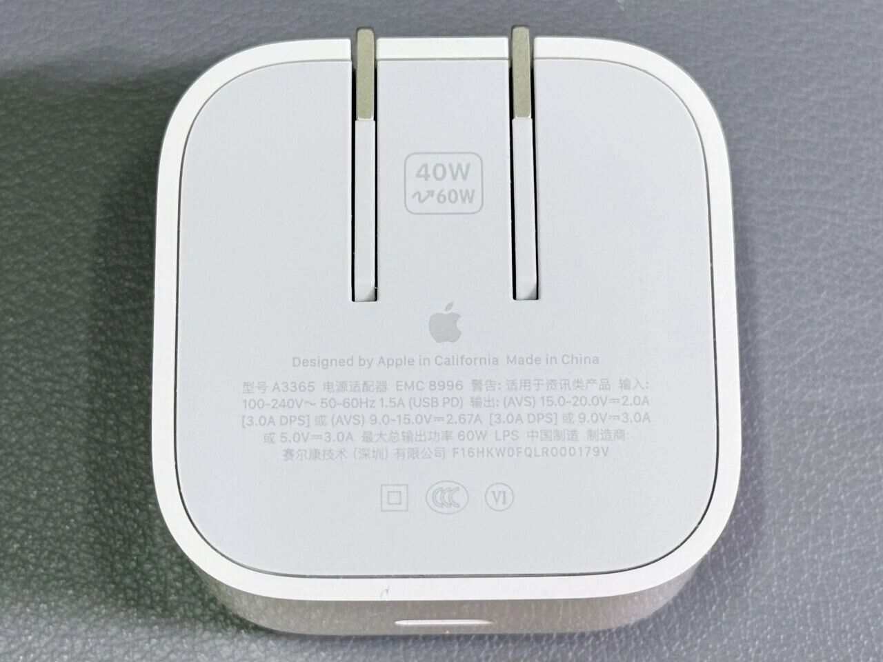

After connecting the KM003C to a computer via HID, simply launch the PC software to start recording. We performed aging tests on Apple’s recommended 40W Dynamic Power Adapter for the iPhone 17 series at different power levels—40W (20V 2A), 48W (20V 2.4A), and 60W (20V 3A)—all without active cooling. Let’s take a look.

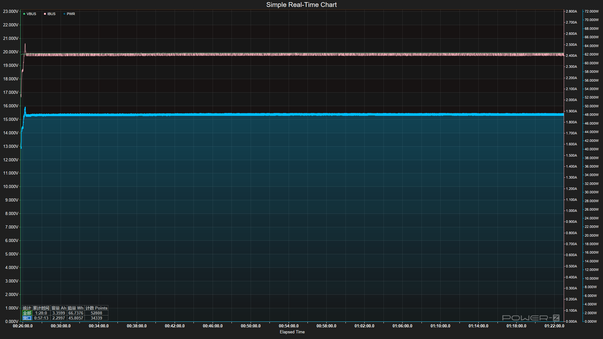

A one-hour stress test at 40W (20V 2A). The KM003C recorded full and stable output throughout, with no thermal protection triggered.

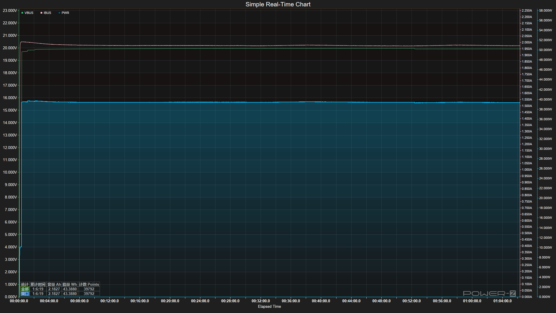

Next, a one-hour stress test at 48W (20V 2.4A). The KM003C measured continuous full-power output without thermal protection. However, this already reached the charger’s thermal dissipation limit—any further increase in output power or ambient temperature would cause power reduction.
