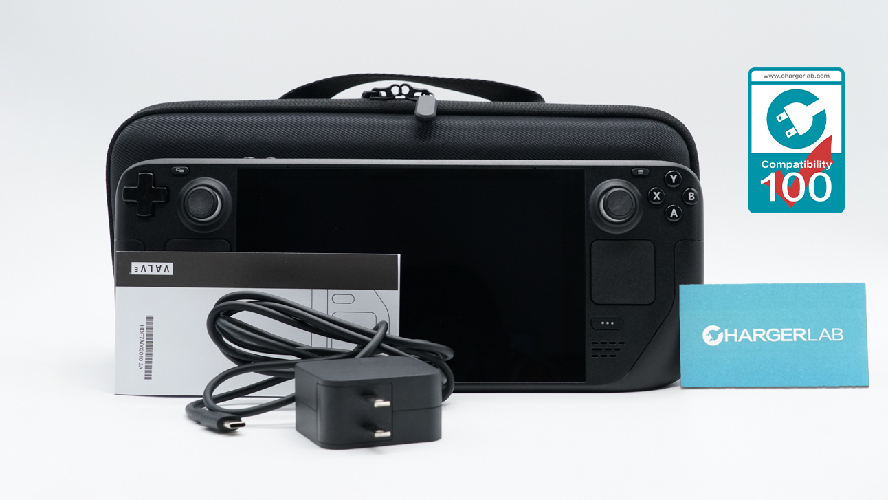

A few months ago, ChargerLAB purchased the hottest and most powerful handheld gaming console Steam Deck at the time and tested its charging compatibility, with excellent results, just like its compatibility with the vast game library on Steam. Recently, Valve officially announced that it just passed 10,000 verified and playable titles. Meanwhile, we have also acquired several new charging products, including the highly anticipated Apple 70W GaN Charger.
And that's why we have recently conducted a more detailed ChargerLAB Compatibility 100 Test for the Steam Deck, which includes multiple categories. Next, ChargerLAB will presents the results in the form of images and text, allowing everyone to have a clearer and straightforward understanding of the charging compatibility of this gaming device.

First, let's review the results when Steam Deck is paired with the original 45W power adapter. ChargerLAB POWER-Z KM002C shows that it can trigger the 15V PDO, and the input power is about 39W, which is lower than the advertised 45W.
