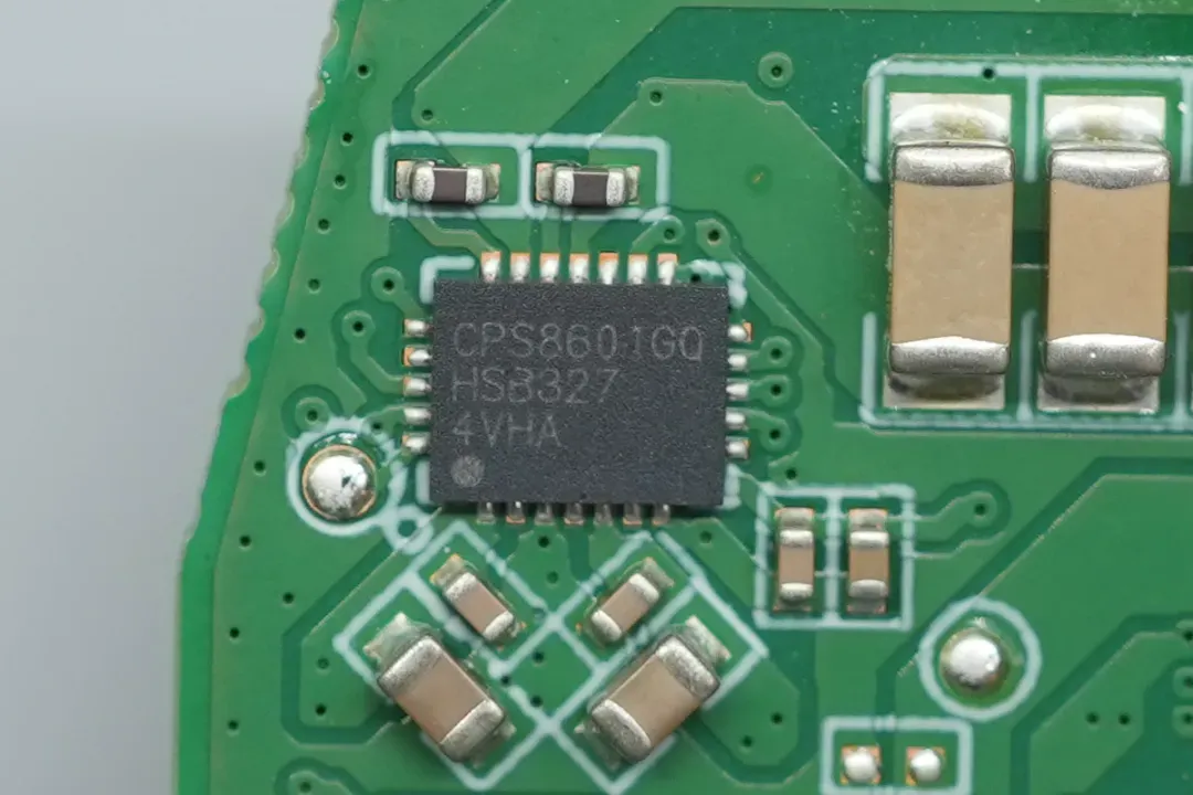

Recent ChargerLAB teardowns confirm that CPS has unleashed the CPS8601—a cutting-edge 15W wireless charging transmitter IC. By packing a high-performance 8051 MCU, full-bridge drivers, low-on-resistance power MOSFETs, ASK demodulation, Foreign Object Detection (FOD), and precision ADCs into a single monolithic chip, the CPS8601 redefines integration. Fully compliant with WPC 1.3 EPP 15W as well as Apple and Samsung wireless fast-charging protocols, this IC flattens the control and power delivery architecture. By drastically slashing peripheral component counts, it serves as the ultimate go-to master controller for ultra-compact magnetic chargers, desktop pads, and multi-device wireless docks.
CPS Semiconductor Unveils the CPS8601 15W Highly-Integrated Wireless Power Transmitter IC to Supercharge Miniaturized Accessories-Chargerlab

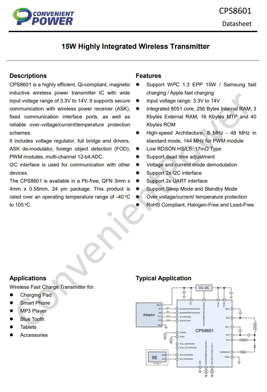

The CPS8601 shines in both processing power and high-frequency power conversion. Supporting a wide 3.3V to 14.3V input range, it embeds an 8051 core clocked dynamically from 8MHz to 48MHz (with 16KB MTP and 40KB ROM), backed by a 144MHz PWM engine to handle complex protocol handshakes and real-time power adjustments. In the power stage, integrated full-bridge drivers and low-on-resistance power MOSFETs (both high and low sides sit in the 17mΩ class) support fine-tuned dead-time control to systematically minimize switching losses. On the data side, it deftly handles both voltage and current-mode ASK demodulation for reliable receiver status tracking and power negotiation. Additionally, the chip features an internal 12-bit multi-channel ADC and an all-around protection matrix (OVP, OCP, OTP, and FOD), plus low-power sleep/standby modes. It has already proven its metattle in premium retail hardware, driving the low-power charging channel in devices like the Belkin 20W Qi2 2-in-1 Magnetic Wireless Charger (WIZ021).
