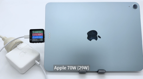

Interestingly, when switching to a 70W Apple charger, the power only increased to 14.64V 2.01A, or 29.50W, which is far below the 45W indicated on the packaging.

iPad Air M3 comes with a 20W charger, and the packaging states that it supports up to 45W input. However, actual testing shows that the maximum charging power is only around 31W.
In terms of charging compatibility, Apple’s original chargers continue to perform excellently, with most of them reaching either their own maximum power output or the iPad’s supported limit of around 30W. As for third-party chargers and power banks, the iPad also demonstrates excellent compatibility, achieving the highest PD fast-charging power supported by either the charger, power bank, or the iPad itself.
