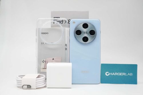

The box contains the OPPO Find X8 Pro, an 80W charging set, and some documents.
80W + 5910mAh | Charging Review of OPPO Find X8 Pro-Chargerlab

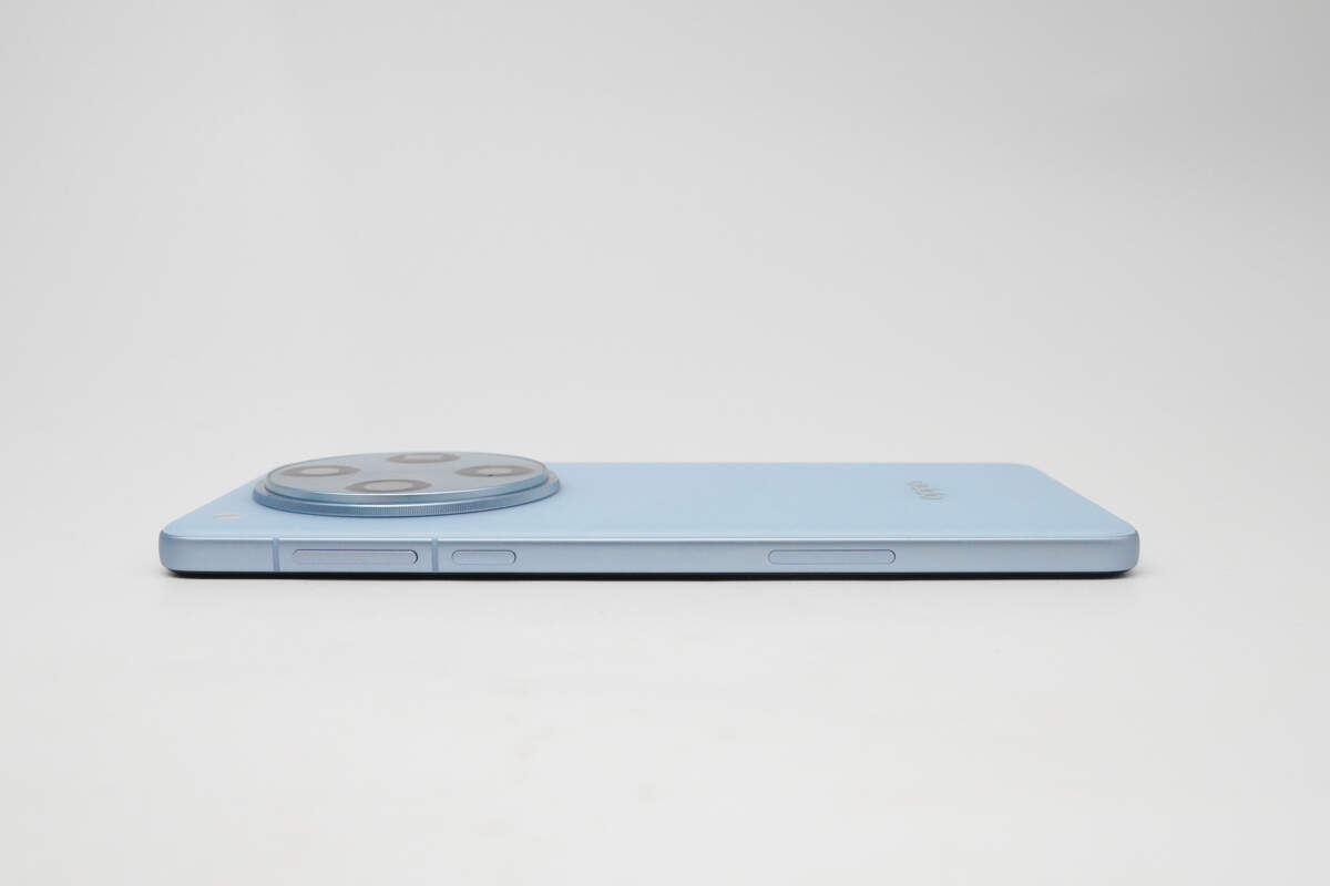

There is a volume button, a power button, and a camera shortcut button on the right side.
There is a three-stage button on the other side, which can switch between silent, vibrate, and ringing with one click.

It is equipped with an 80W USB-A charger and a USB-A to USB-C cable.
