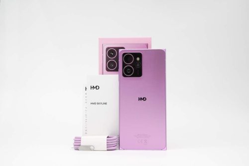

The box contains the HMD Skyline, a dual USB-C cable, and some documents.

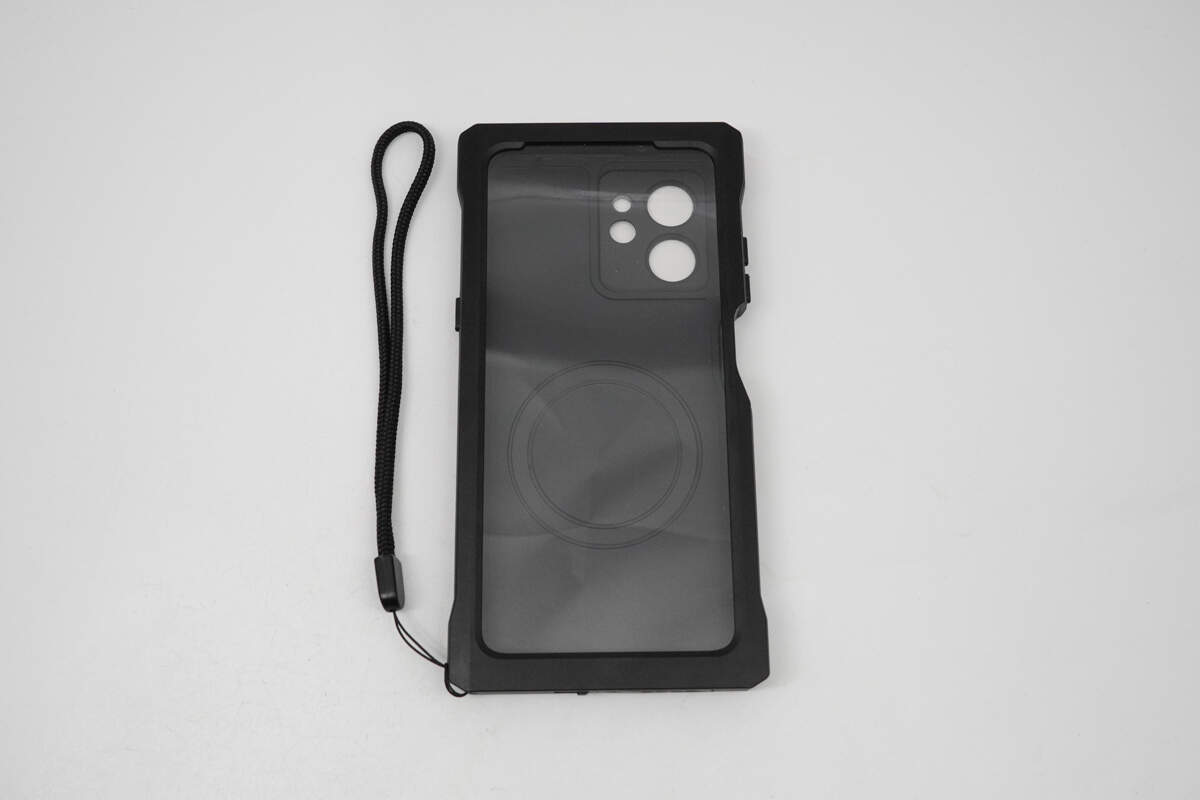

HMD also launched the HMD SKYLINE Rugged Case. The box is white, with a rendering of the phone case in the middle and the HMD logo printed on it.
33W+4600mAh | Charging Review of HMD Skyline-Chargerlab
The phone case is black, has IP68 dust and water resistance, has reinforced corners, and comes with a lanyard.

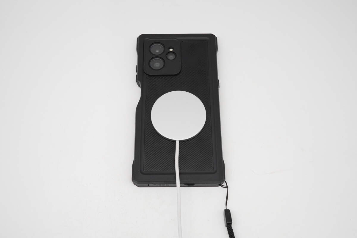

The built-in magnet on the back allows for wireless charging.
This is how the HMD Skyline looks like wearing this case.

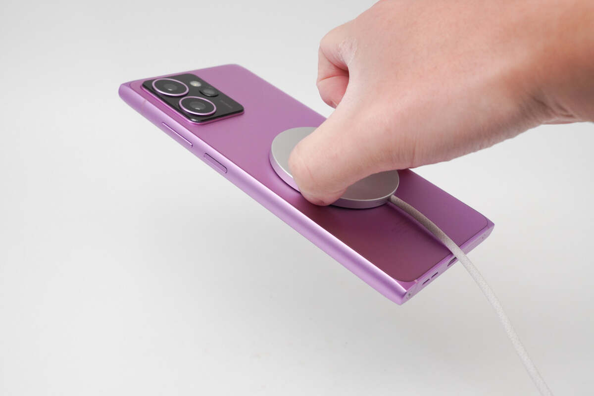

Charge with the Apple 35W charger and the MagSafe (A2140), the input power is about 8.97V 1.99A 17.85W.
The MagSafe magnetic charger can firmly attach to the HMD Skyline.
