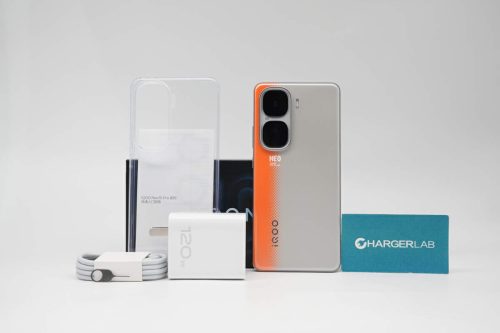

ChargerLAB got the new iQOO Neo10 Pro. It is equipped with Dimensity 9400 and iQOO's self-developed gaming chip Q2, with a built-in third-generation silicon battery and an astonishing equivalent capacity of 6100mAh. It also has super compatibility. Now, let's take a look at the performance of this phone.

The box contains the phone, a 120W charger set, a phone case, and some documents.
