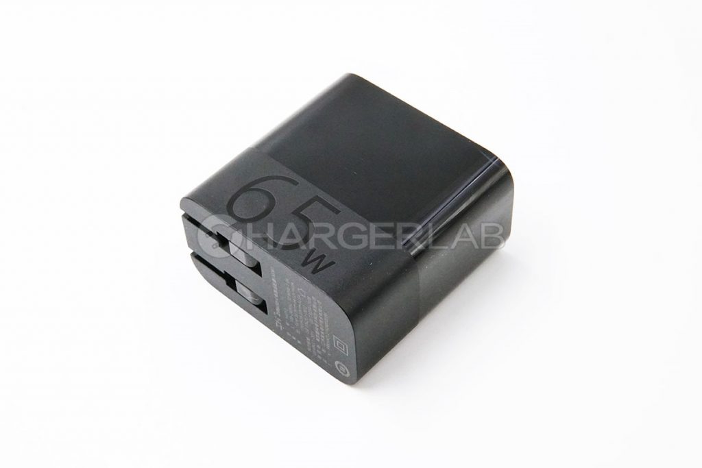

The ZMI 65W charger features a two-tone design with a glossy and matte finish which is a nice match for your Google Pixel phones. Dimensions: 50*50*28mm (2.0*2.0*1.1in).
ChargerLAB Exclusive: The World's Smallest 65W Charger by ZMI-Chargerlab

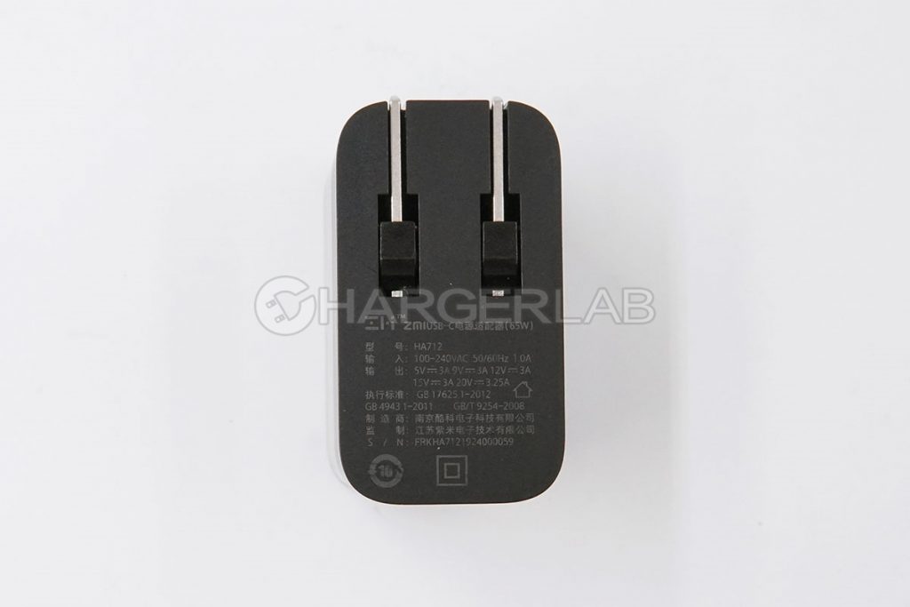

Specifications. Model: HA712. Input: 100-240VAC, 50/60Hz, 1.0A. Output: 5V/3A, 9V/3A, 12V/3A, 15V/3A, 20V/3.25A, maximum 65W.

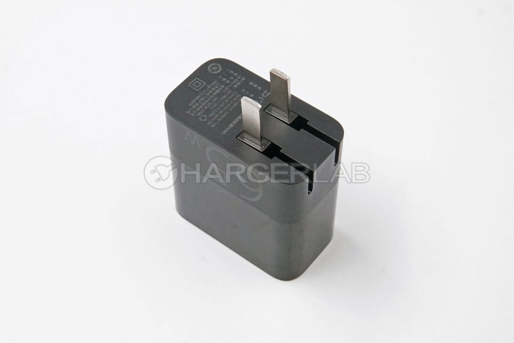

Foldable prongs, Mainland China standard (US compatible).

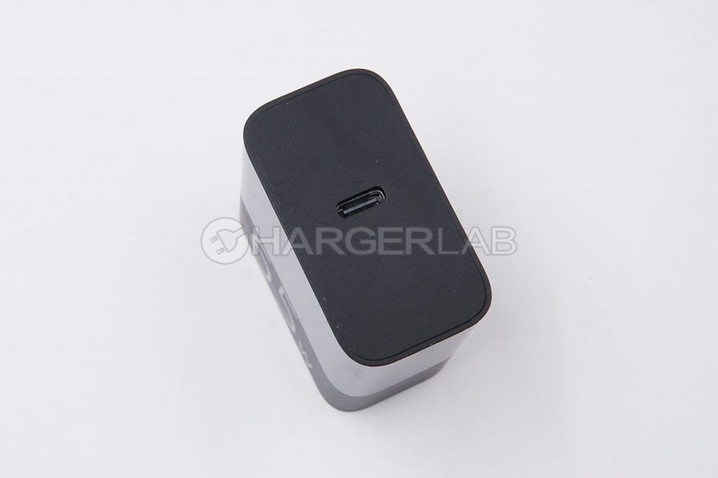

Single USB-C port.

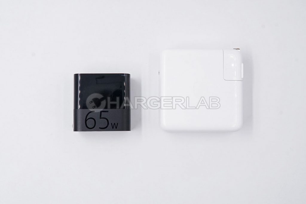

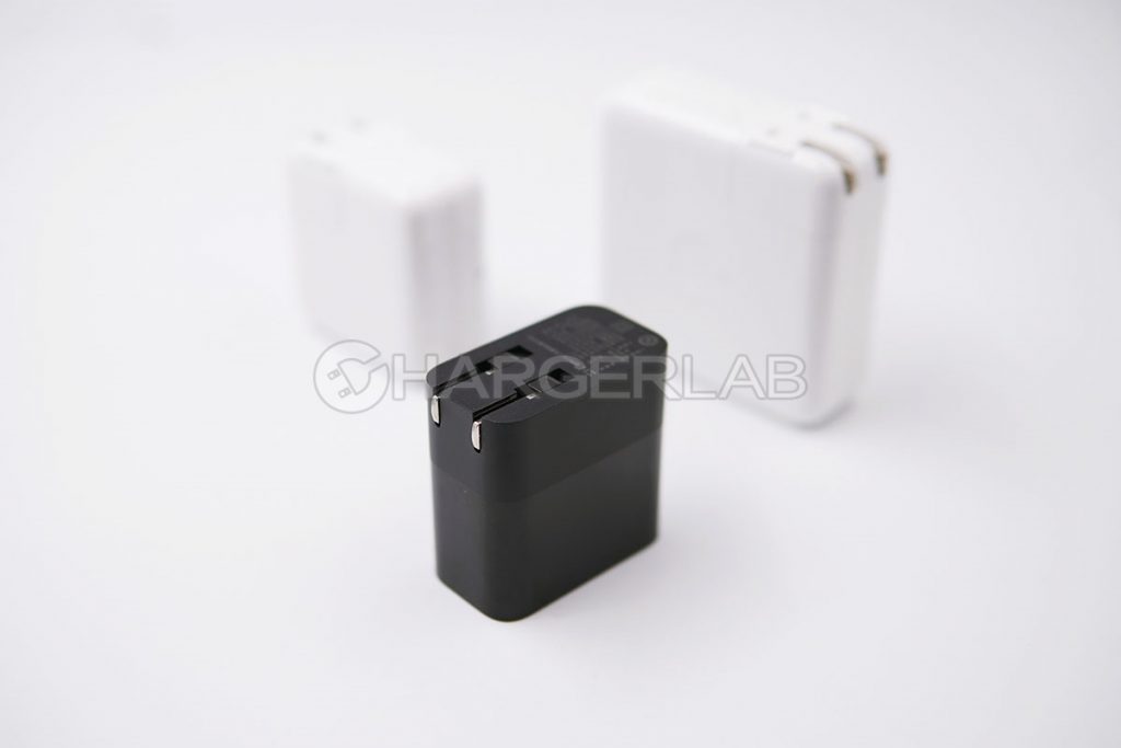

The ZMI 65W charger on the left, and the Apple 61W PD charger on the right. Huge size difference.

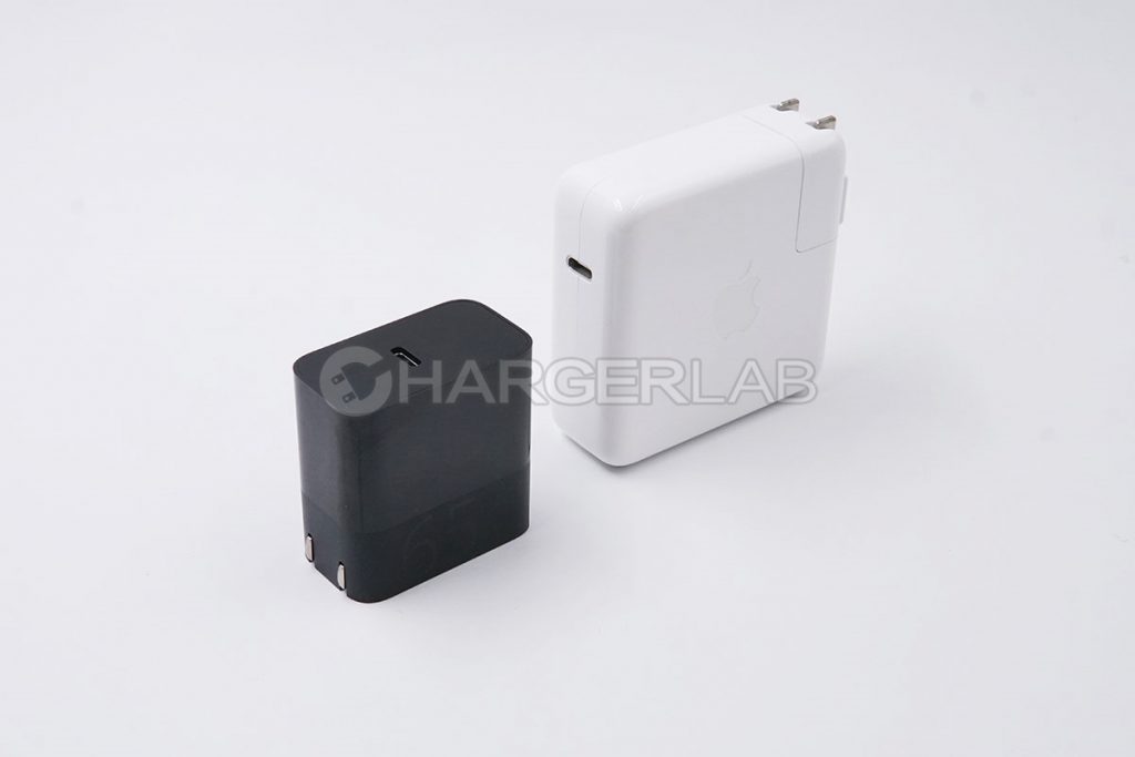

Taking a look at a different angle.

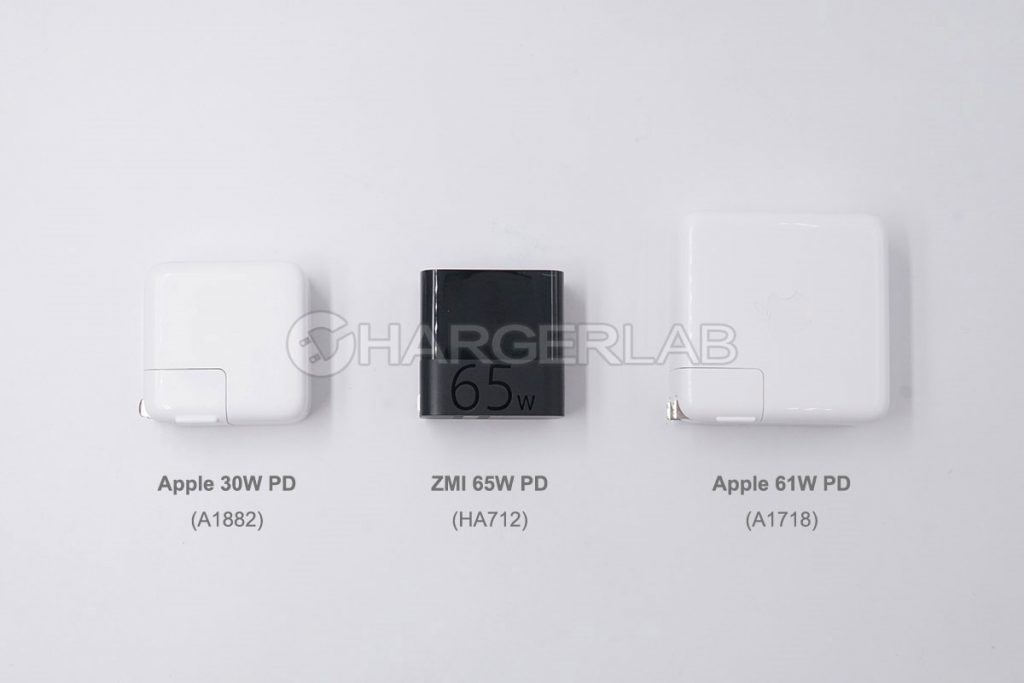

The Apple 30W PD charger on the left, ZMI 65W charger in the middle, and the Apple 61W PD charger on the right. The ZMI 65W charger is even smaller than the Apple 30W PD charger. Wow.
