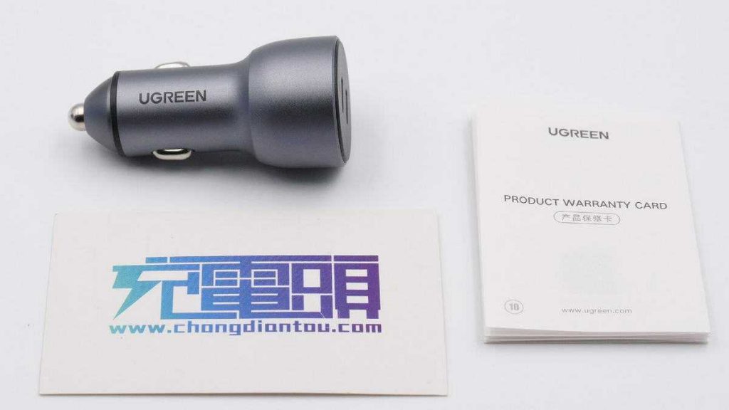

The package contains a car charger and instructions for use. The car charger is made of aluminum alloy shell, the surface is sandblasted, which makes the touch feels good.

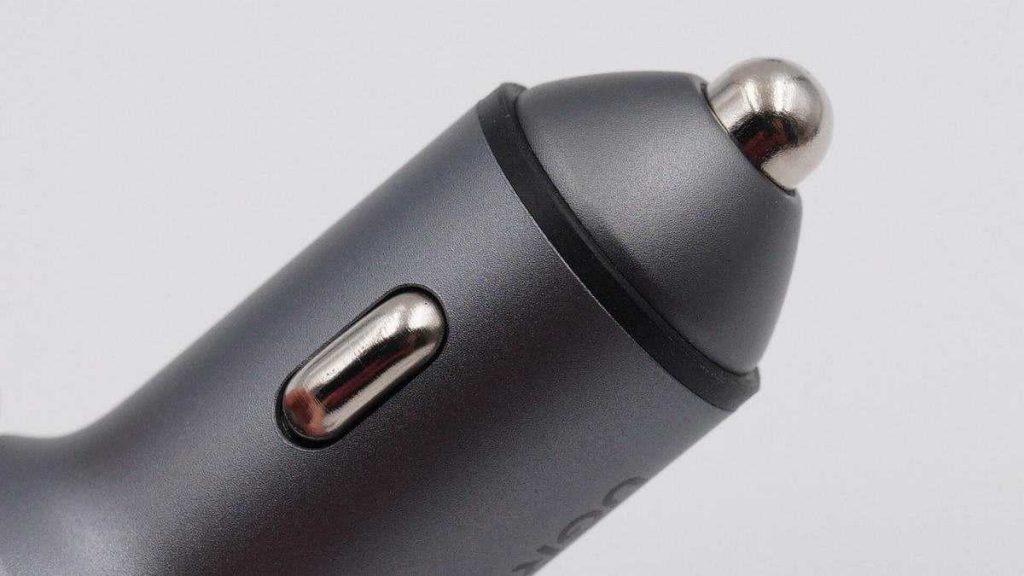

A rubber ring is arranged between the positive and negative poles of the product to isolate them.
Teardown Report - UGREEN 40W Dual Type-c Port Fast Car Charger-Chargerlab
The positive and negative contact points are magnetic and can attract small magnets.

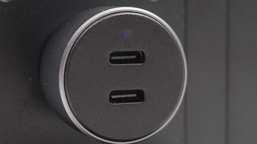

The output end is equipped with LED indicators and dual USB-C ports, the port’s black plastic insert does not expose copper, and the power indicator lights blue.

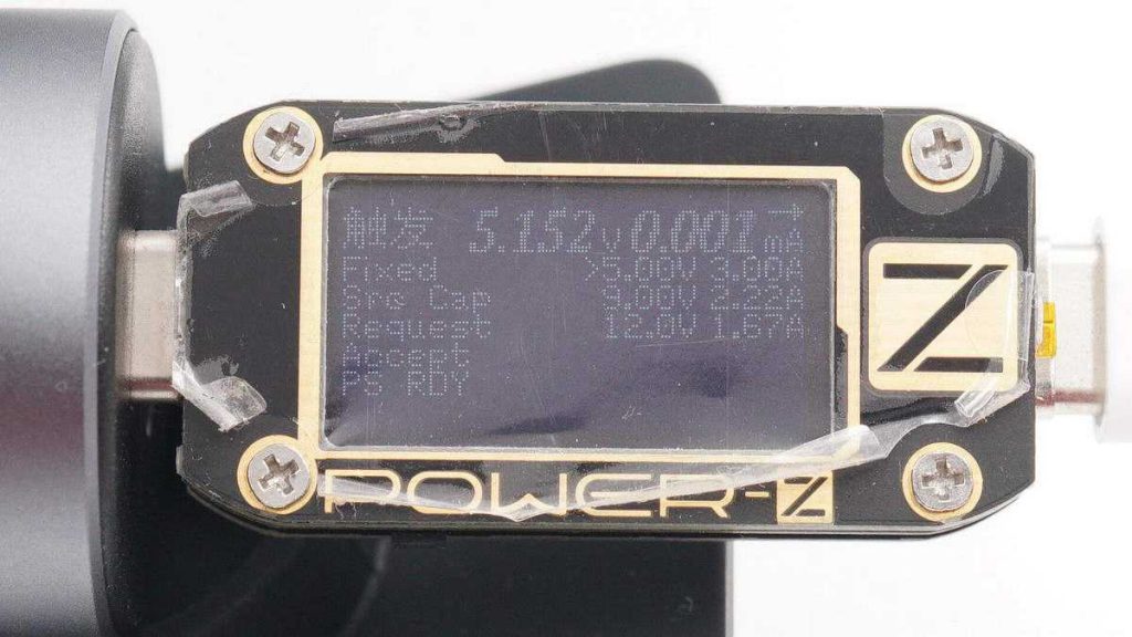

Use ChargerLAB POWER-Z KT002 to detect the output protocol of the USB-C 1 port, and show that it supports Apple 2.4A, Samsung 5V2A, DCP protocol, and QC2.0/3.0, AFC, FCP, PD3.0 fast charging protocol.
In addition, the PDO message shows that the C1 port also has three sets of fixed voltage gears: 5V3A, 9 V2.22A, and 12V1.67A.

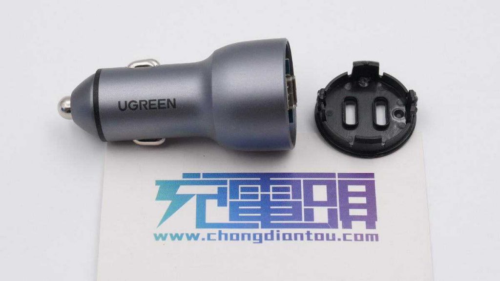

2. Teardown of UGREEN 40W Dual Type-c Port Fast Car Charger
Disassemble the top plastic shell, which is using buckles for packaging.

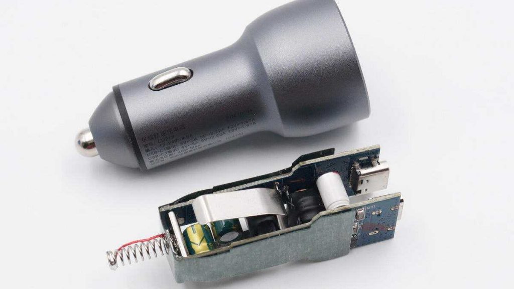

Take out the car charger module.

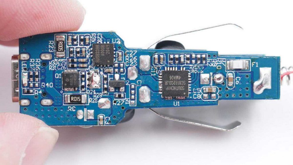

Tear off the Barley insulation paper; the back of the board is equipped with a buck converter, protocol chip and output VBUS switch tube.

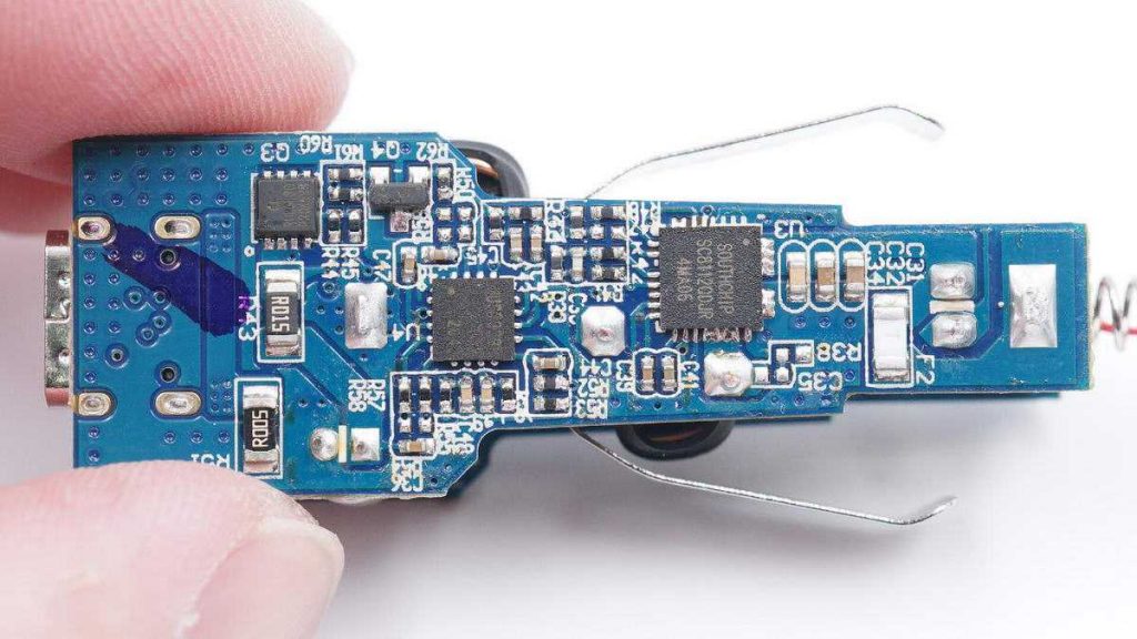

The other small board has the same circuit design.

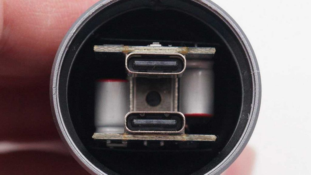

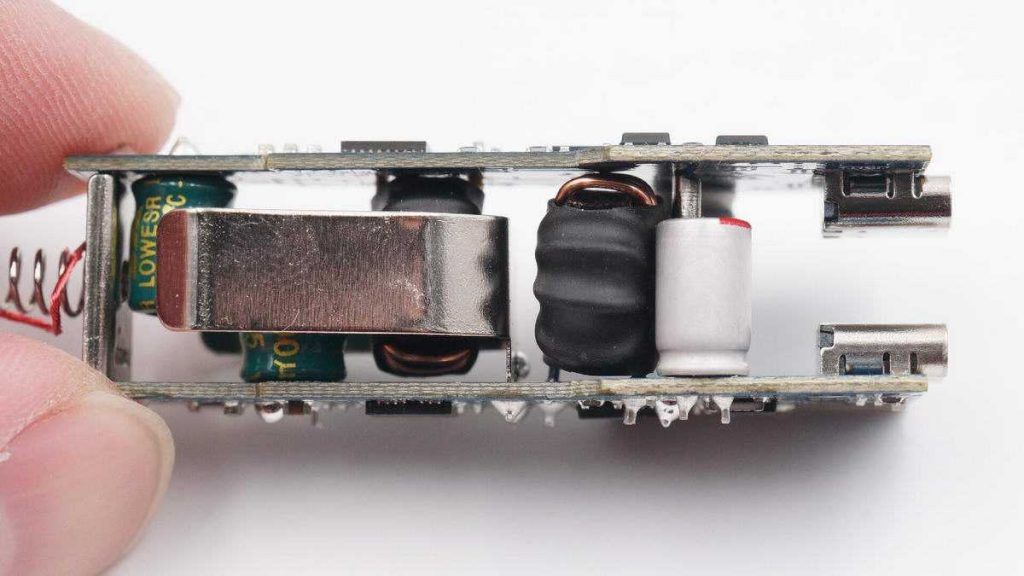

It can be seen from the side that the two input and output filter capacitors and step-down inductors are also fixed in each board, and a Heat-shrink tubing protects the inductor.
Through observation, the car charger adopts two independent buck circuit, the protocol chip controls and identify the output voltage architecture. And two circuits are exactly the same. Next, we start from the input end to understand the specification of each component.

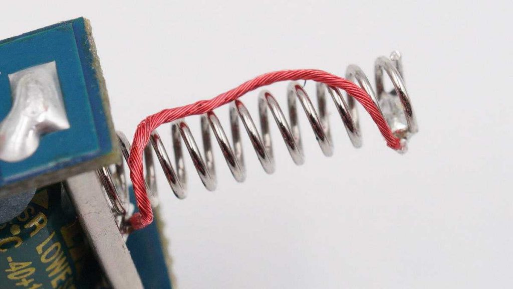

There is a red wire on the input spring to reduce resistance.

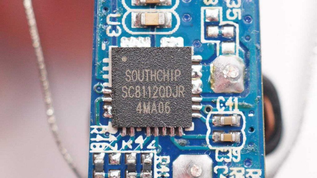

Southchip SC8112 is a dual-output 6A synchronous rectification step-down converter with a built-in switch tube and pass-through mode. Its output voltage can be set by voltage divider resistance and support high-precision output current limit. The total output power can be set by resistance, make it convenient for constant power output. It also supports line loss compensation, and complete protection functions, including over-voltage, over-current protection, short-circuit protection, and over-heat protection, suitable for car chargers, multi-port wall chargers, hubs, and industrial applications.
Information of Southchip SC8112.

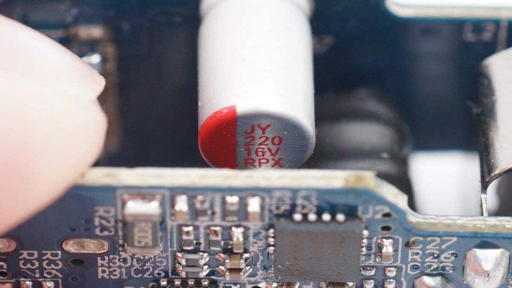

Close-up of the buck output filter solid capacitor, the specification is 16V 220μF.

The protocol chip uses Hynetek HUSB339, which has passed the USB PD3.0 certification, TID 62. HUSB339 is a high-performance and high integration of USB Type-C Power Delivery controller, integrated charge Protocol, like PD2.0, PD3.0, PPS, QC2.0 / 3.0, BC1.2,5V2.4A; suitable for power adapters, car chargers, power bank, etc. It has two packaging modes: SOP-14L and QFN-16L.
Information of Hynetek HUSB339.

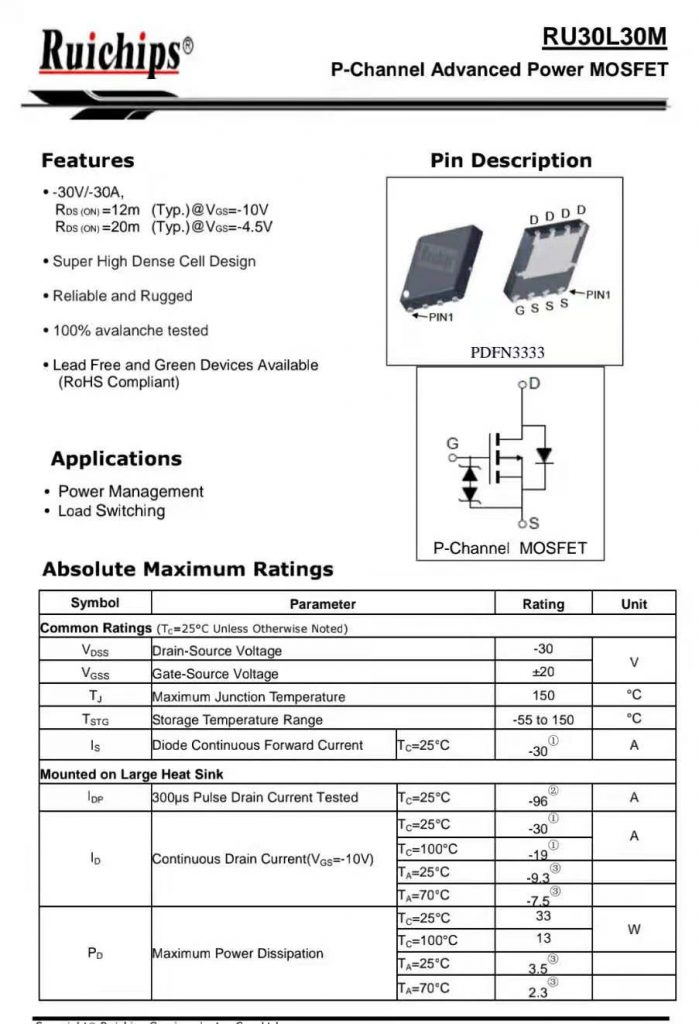

The output VBUS switch tube adopts Ruichips RU30L30M, PMOS, withstand voltage 30V, packaged by PDFN3333.
Data of Ruichips RU30L30M.
