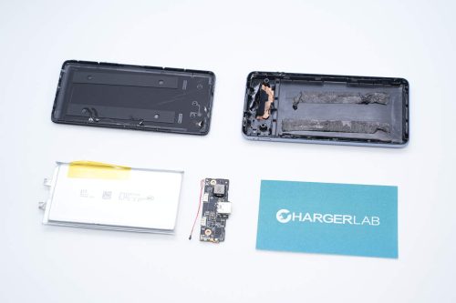

First, pry along the gap to open the cover.
Teardown of Xiaomi 5000mAh Ultra-thin Power Bank (PB0520MI)-Chargerlab
There are foams for cushioning at the place where the cover contacts the battery cell.
The PCBA module is fixed with screws.
A thermistor is attached to the battery to measure temperature.
Remove the remaining case.
The battery cell is fixed with double-sided tapes.
There is a graphite sticker inside the shell for heat dissipation.
Tear off the sticker, the bottom layer is a composite material of graphite foam and copper foil.
The battery and PCBA module are connected by welding.

Well, those are all components of the Xiaomi 5000mAh Ultra-thin Power Bank.
Here is the component list of the Xiaomi 5000mAh Ultra-thin Power Bank for your convenience.
It has an ultra-thin design, is equipped with a USB-C port, supports an input power of 18W, and supports a maximum output power of 20W.
After taking it apart, we found it adopts a 5000mAh soft pack battery from LS, with a nominal voltage of 3.88V. It uses SouthChip SC8934 for fast charge output. The workmanship is solid.
