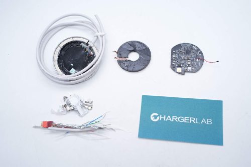

In the middle is the wireless charging coil.
Teardown of Xiaomi 30W Magnetic Wireless Charger (MDY-17-EY)-Chargerlab
Below the wireless charging coil is the PCBA module, and a black plastic shell separates the PCBA module and the aluminum alloy shell.
The USB-C cable core is connected to the PCBA module by welding and protected by glue.
The solder joints between the wireless charging coil and the PCBA module are full.
The PCBA module is equipped with a thermistor for temperature monitoring.
Remove the PCBA module and wireless charging coil.
The back of the PCBA module has components such as the wireless charging master control chip, thermistor, filter capacitor, NPO resonant capacitor, etc.
There are six filter capacitors in the center of the front.
The Schottky diode is marked with S56F.
These are the six filter capacitors on the front.
The wireless charging master control chip is from NuVolta. This is a highly integrated wireless charging transmitter chip with an internal MCU and wireless charging power stage. It integrates the traditional wireless charging master control chip and power full-bridge chip into one package, greatly saving space. It supports I2C and UART interfaces and has a built-in ADC for collecting charging parameter information. It supports QC and PD fast charging functions, has low quiescent current and a single chip can realize a complete wireless charging design with an output power of up to 30W. Model is NV1708A.

The wireless charging coil is wound with Litz wire.
Well, those are all components of the Xiaomi 30W Magnetic Wireless Charger.
The Xiaomi 30W Magnetic Wireless Charger comes with a USB-C cable and an aluminum alloy casing. It uses a magnetic design, and the experience of charging and using simultaneously is good.
After taking it apart, we found it adopts the NuVolta NV1708A wireless charging solution, which is a highly integrated wireless charging transmitter chip with an internal MCU and wireless charging power stage. It combines the traditional wireless charging master control chip and power full-bridge chip into one package, greatly saving space. The wireless charging coil, magnets, etc. are glued and reinforced, and they are also insulated.
