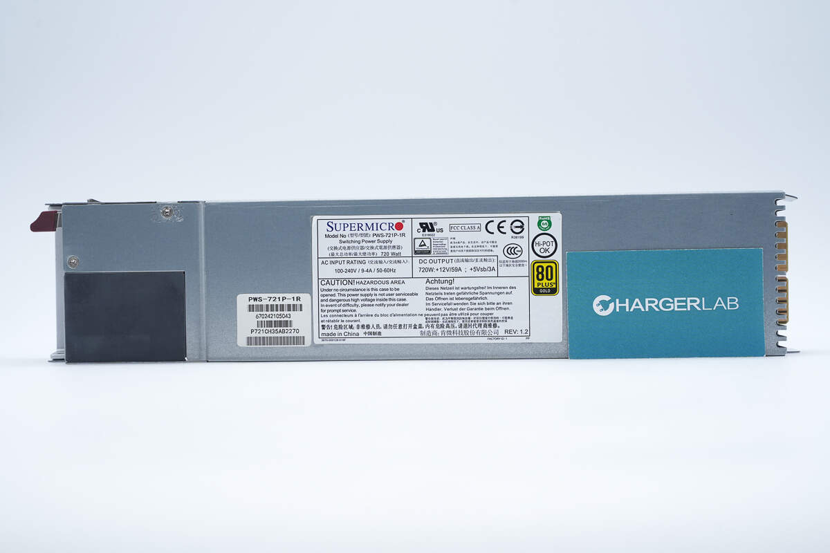

Model: PWS-721P-1R
Maximum Total Power: 720W
AC Input: 100–240V / 9–4A / 50–60Hz
DC Output: 720W: +12V / 59A; +5Vsb / 3A

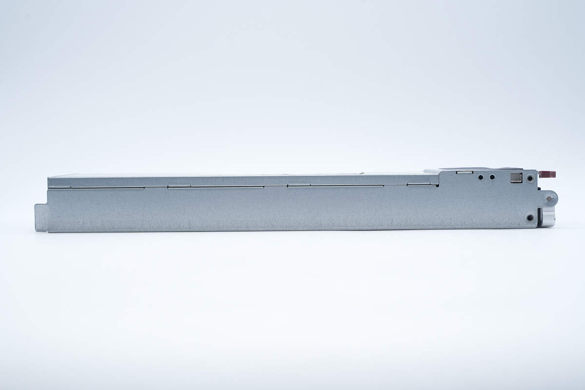

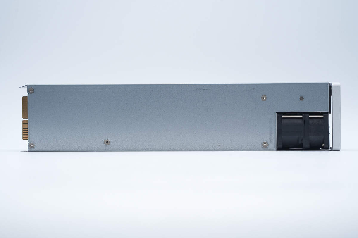

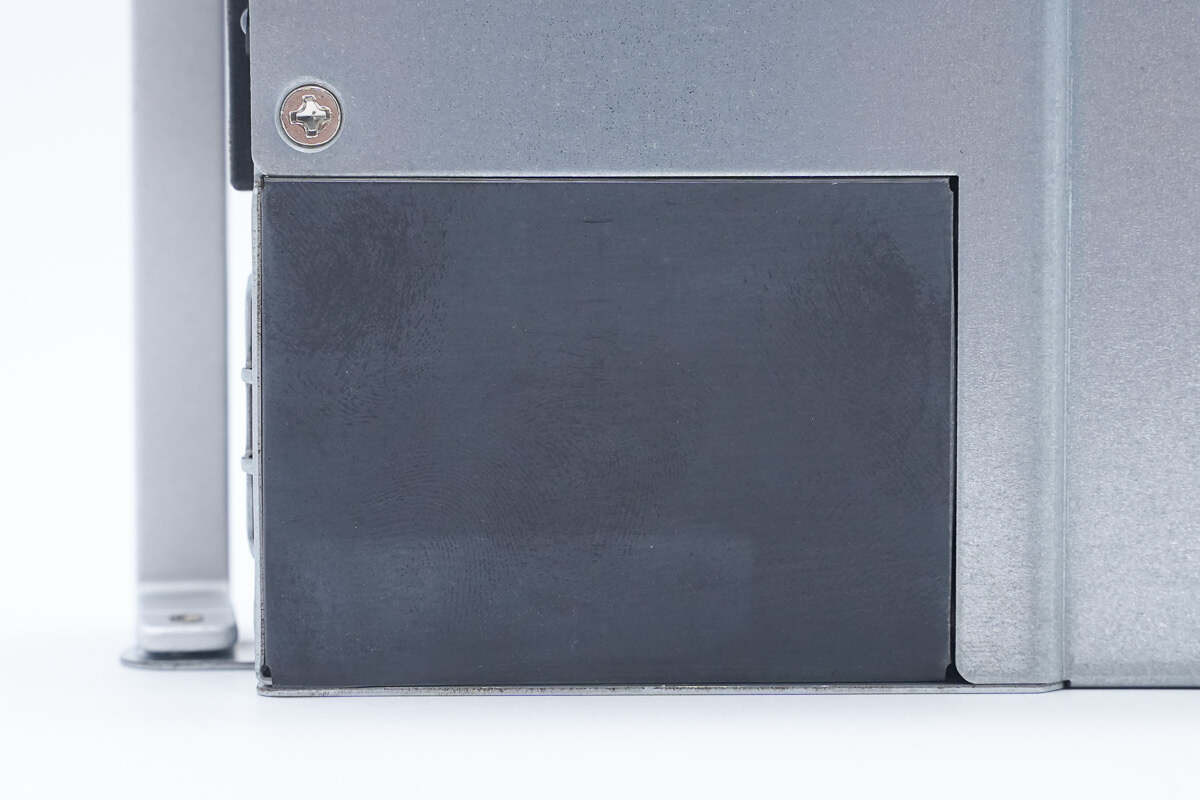

This side features mounting screw holes. The area corresponding to the fan is cut out to reduce overall thickness.
Teardown of Supermicro 720W 1U Redundant Power Supply (PWS-721P-1R)-Chargerlab
The side of the enclosure is secured with locking clips.

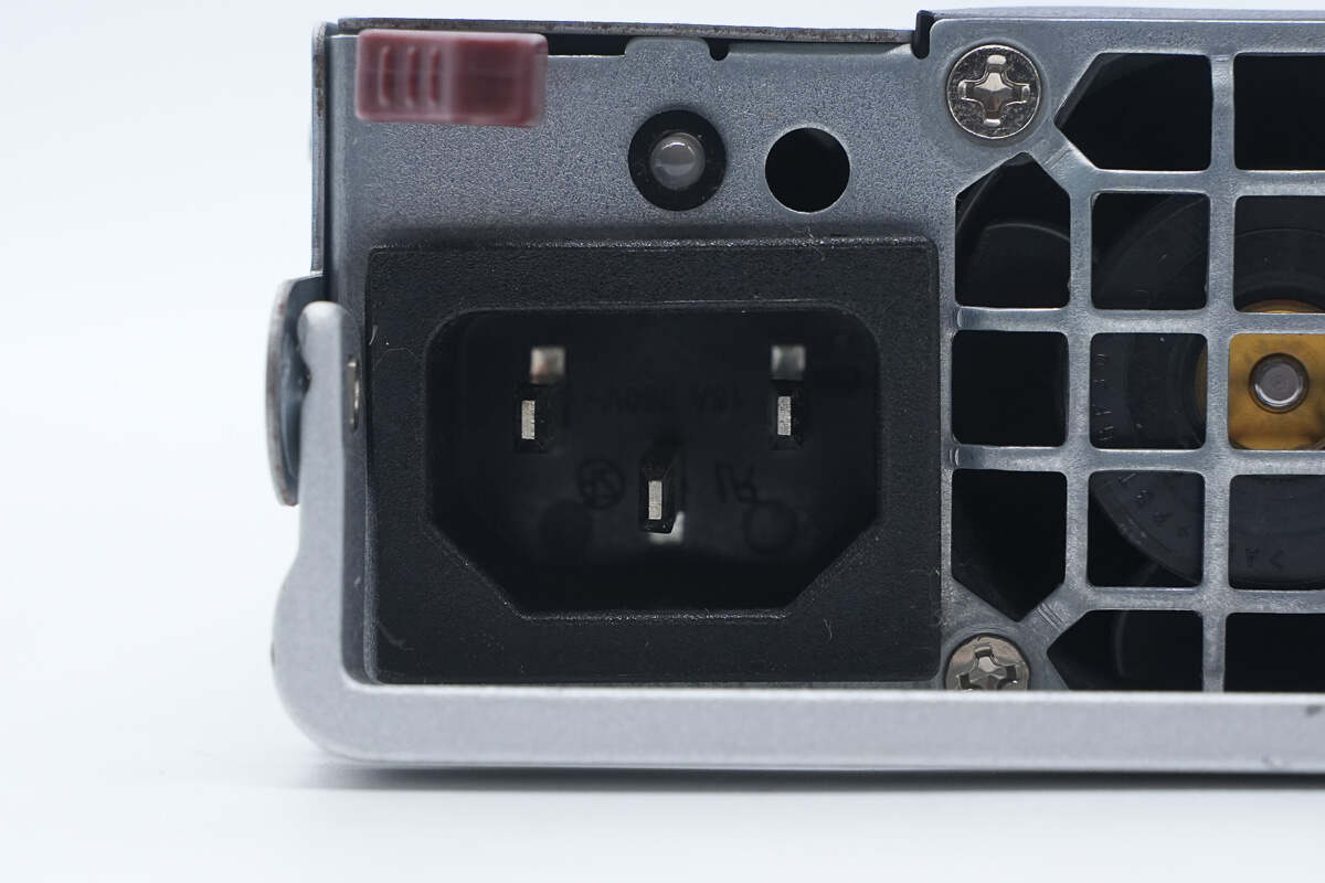

The input side features a C14 power inlet, a cooling fan, an LED indicator, and a handle.
Above the C14 power inlet is the LED indicator.

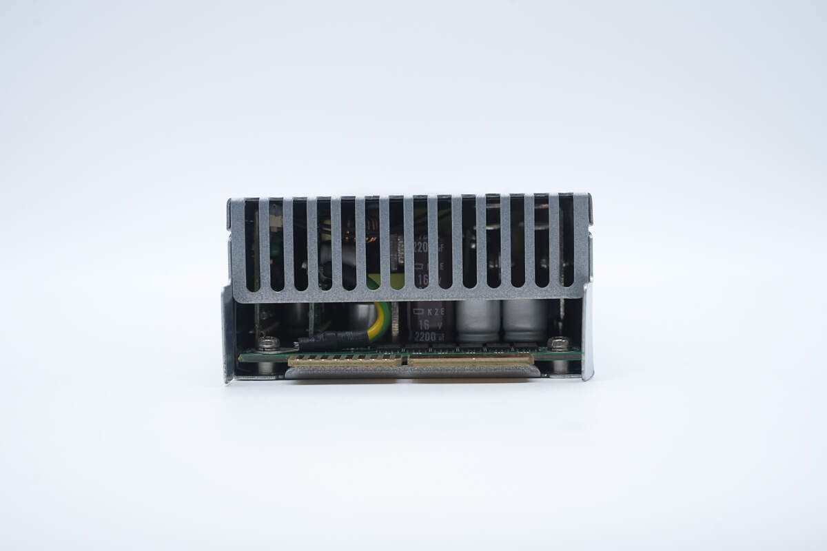

The output side features a protective grille and a gold finger connector.

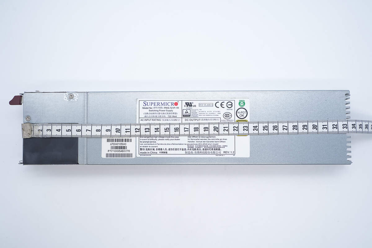

The length of the power supply is about 334 mm (13.15 inches).

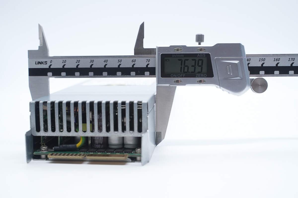

The width is about 76.4 mm (3.0079 inches).

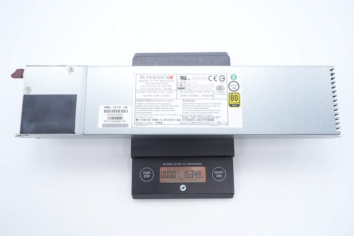

The weight is about 1535 g (54.15 oz).

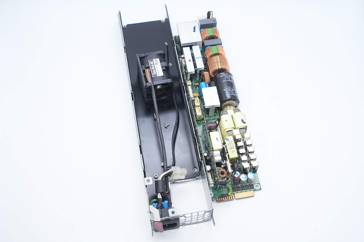

First, unscrew the mounting screws and remove the top cover. Inside, there is a black Mylar insulating sheet.
The PCBA module is fastened inside the enclosure using screws.

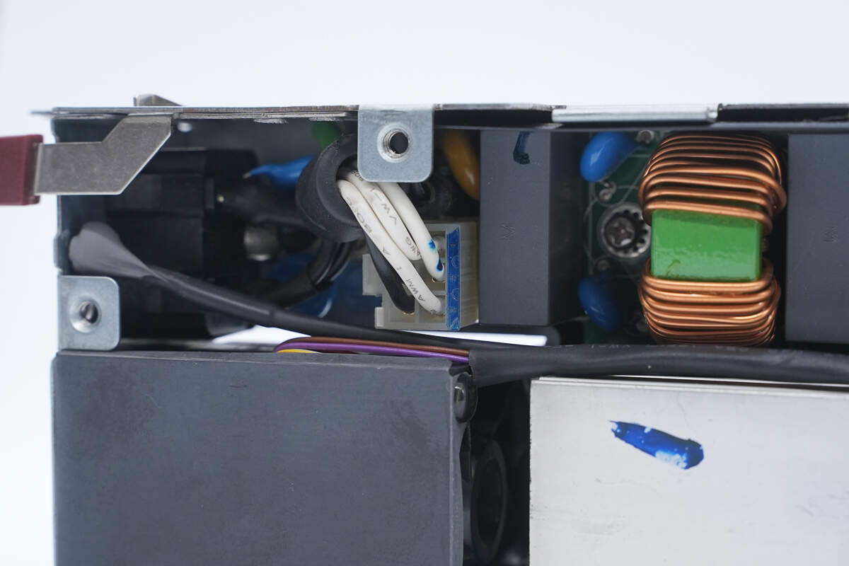

The AC input wires are connected via a plug-in connector.

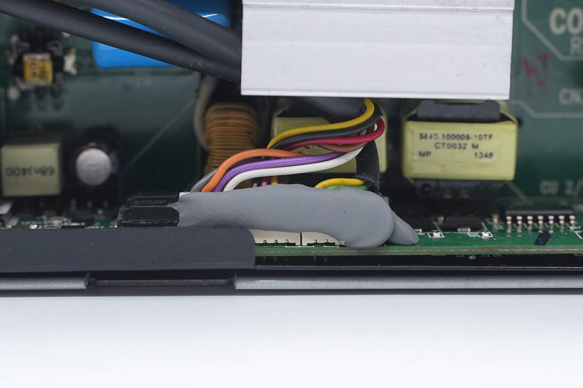

The fan and LED indicator are connected via plug-in connectors and sealed with adhesive for added stability.

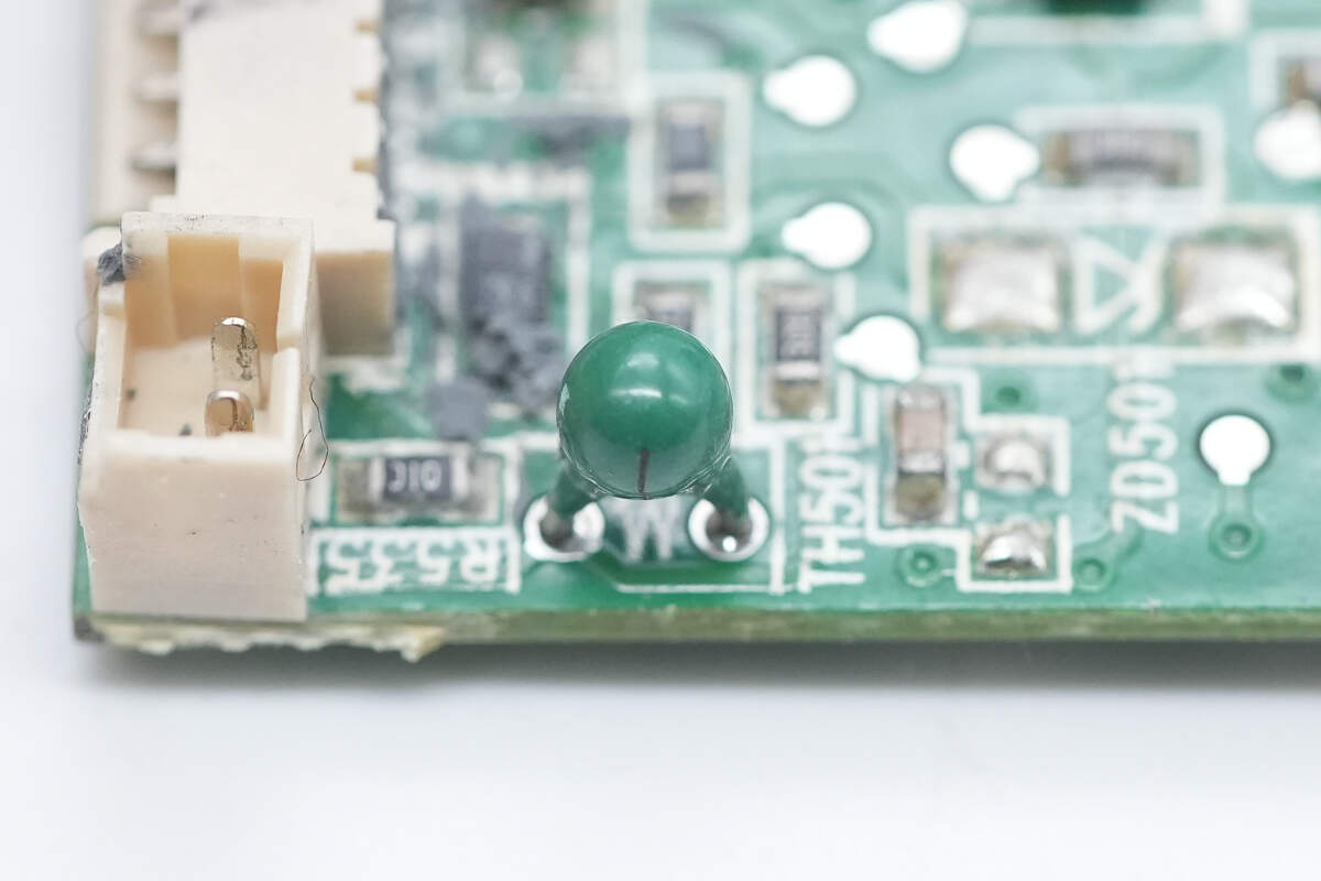

The thermistor is also connected via a plug-in connector.

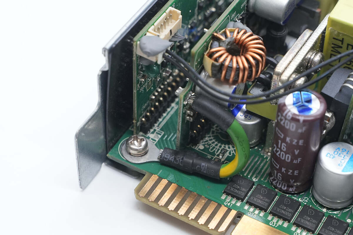

The grounding wire is secured with a screw.

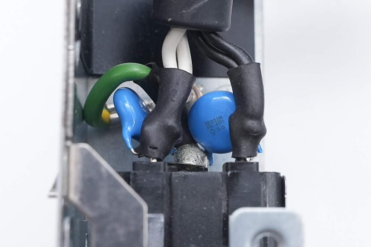

The power inlet is connected with soldered wires.

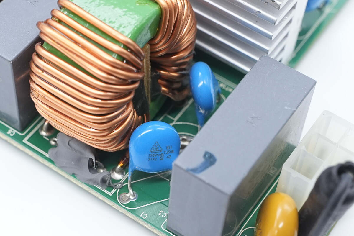

The power inlet is also soldered to a blue Y-capacitor. The solder joints on the wires are insulated with heat shrink tubing.

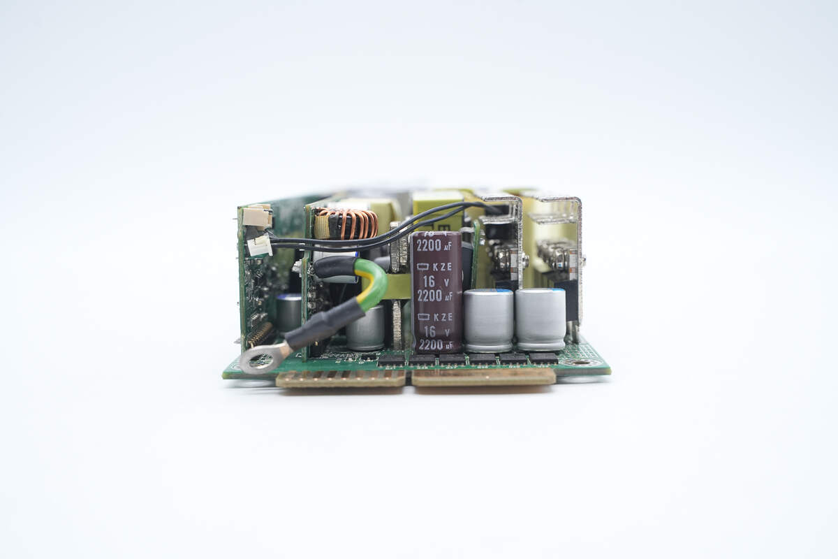

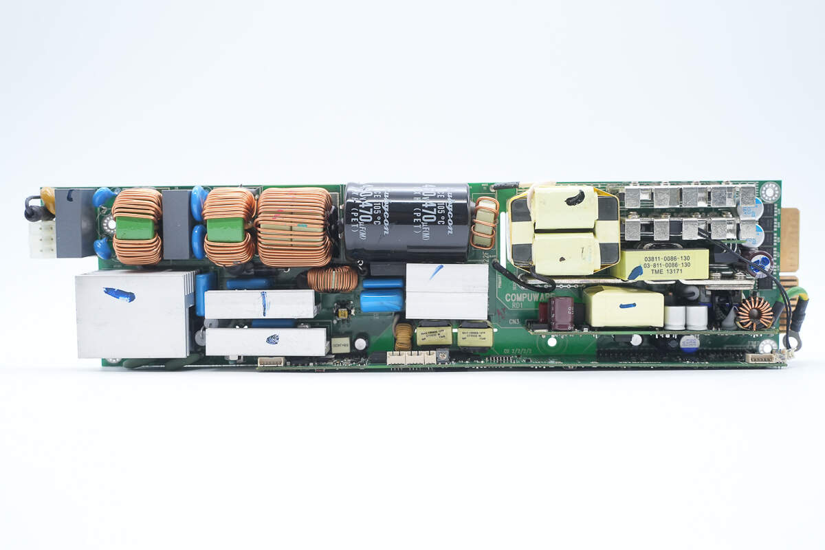

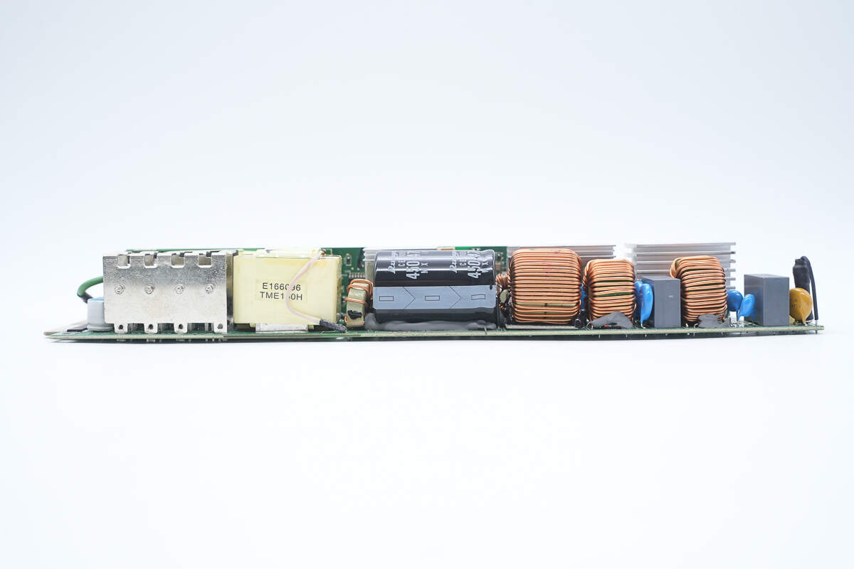

Overview of the PCBA module front side:
In the upper left corner are the connector socket, fuse, varistor, safety X2 capacitor, common-mode choke, and PFC inductor. Below them, the heatsink cools the bridge rectifier, PFC MOSFET, and PFC rectifier. Also present are a relay and a thermistor.
In the central upper area, there is the PFC boost inductor and high-voltage filter capacitors. Below that are the phase-shift full-bridge MOSFETs and the driver transformer. On the right side are the main transformer, synchronous rectifiers, and the standby power supply PCB. At the bottom is a long control PCB.

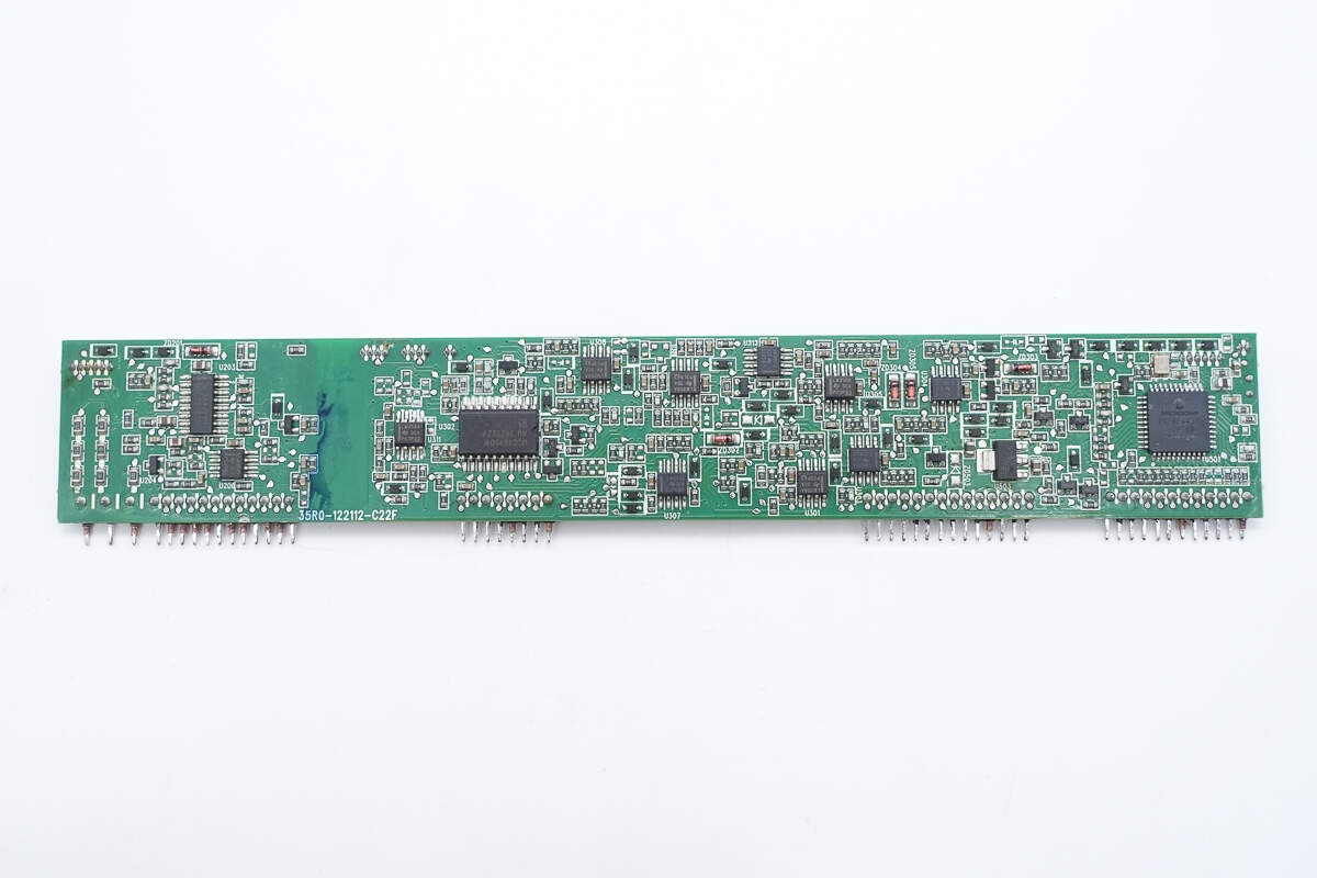

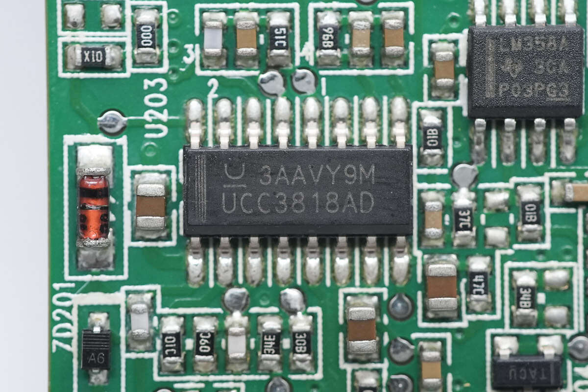

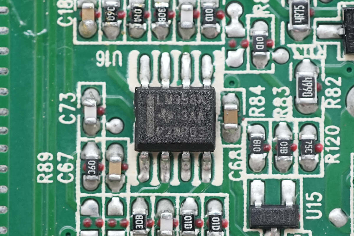

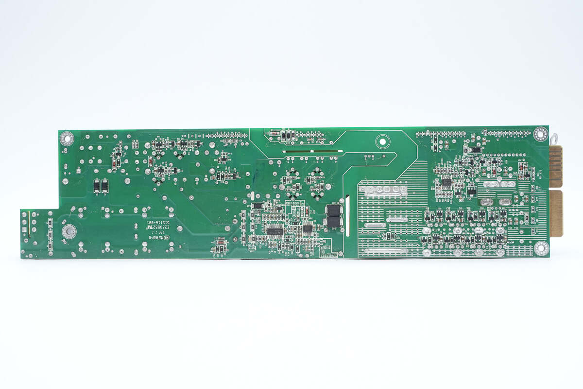

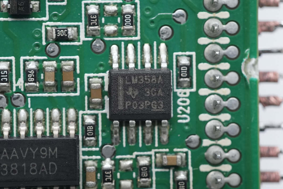

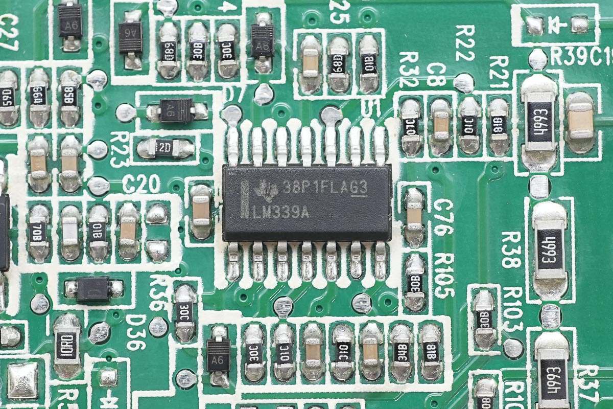

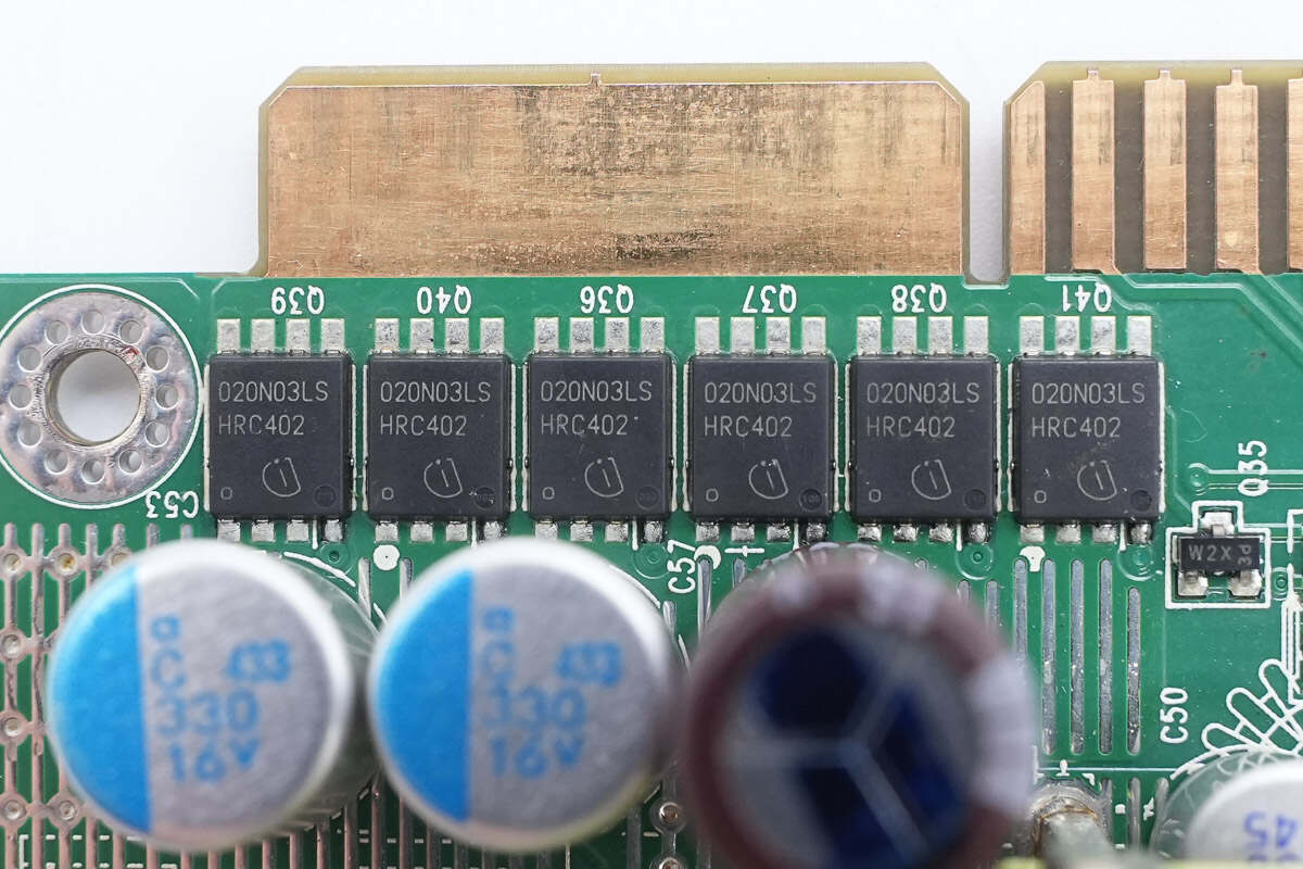

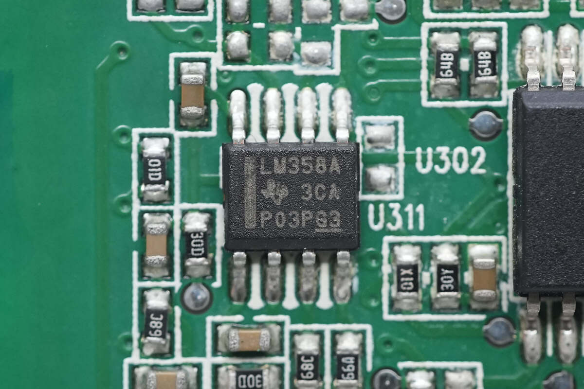

The back side of the PCBA module is soldered with voltage comparators, Op-Amps, fast recovery diodes, drivers, and a PWM controller.

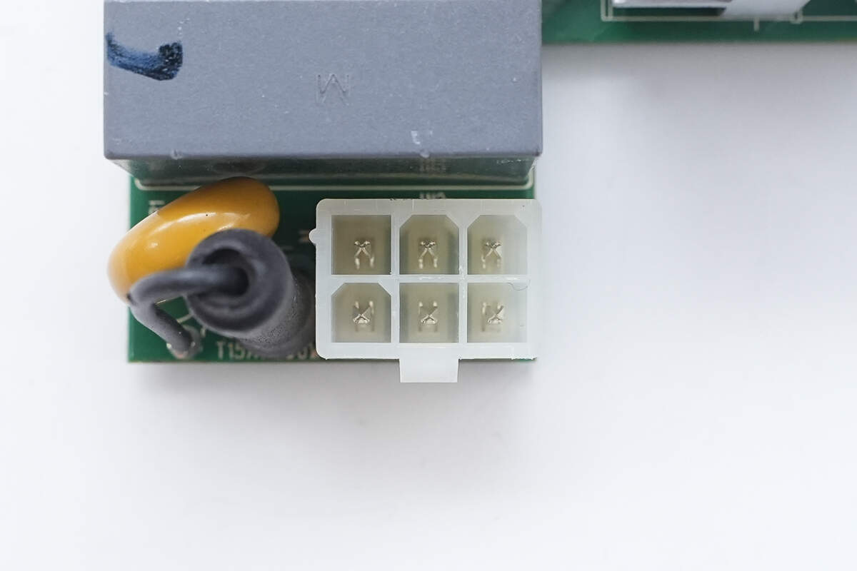

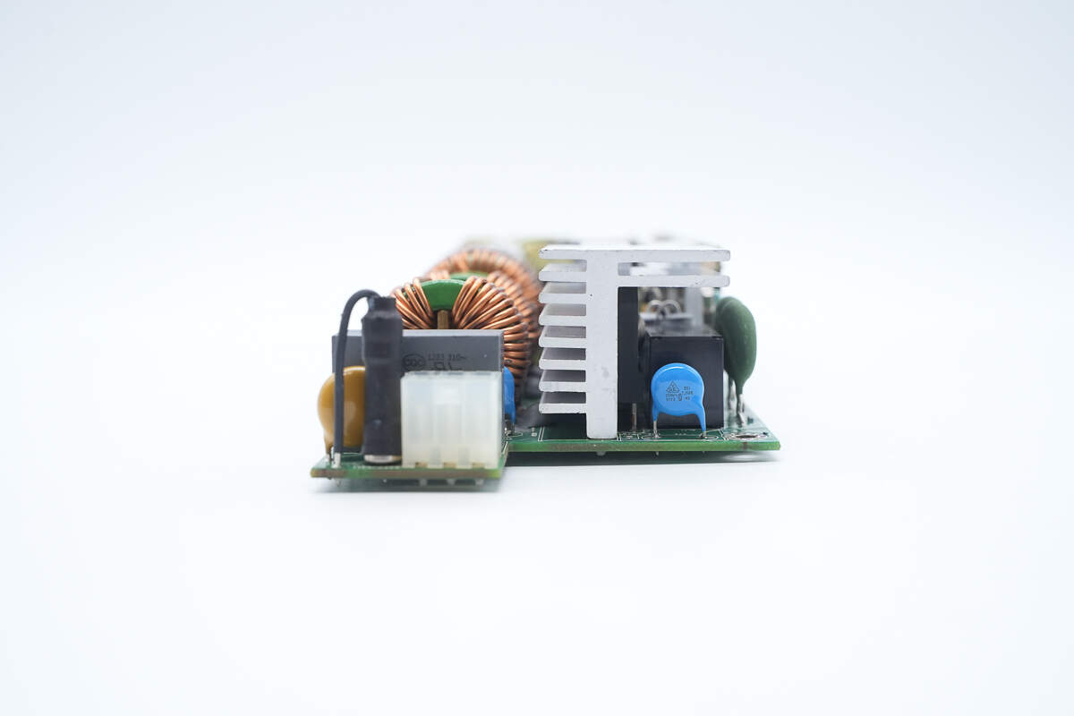

The input side includes a connector socket, fuse, varistor, safety-certified X2 capacitor, relay, Y-capacitor, and thermistor.
Close-up of the 6-pin AC input connector.

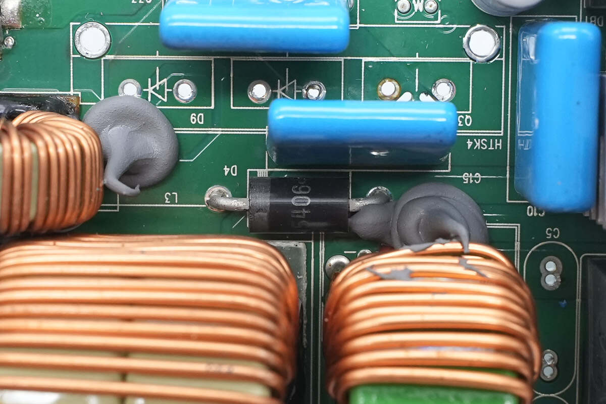

On the side of the PCBA module, there is a varistor, safety X2 capacitors, common-mode chokes, a PFC boost inductor, a high-voltage filter capacitor, a resonant inductor, and heatsinks for synchronous rectifiers and the transformer.
The fuse is insulated with heat-shrink tubing.

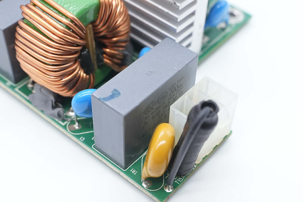

The varistor, marked TVR10471V, is used to absorb overvoltage surges.
The safety X2 capacitor has a capacitance of 1 μF.
Close-up of the blue Y capacitor.

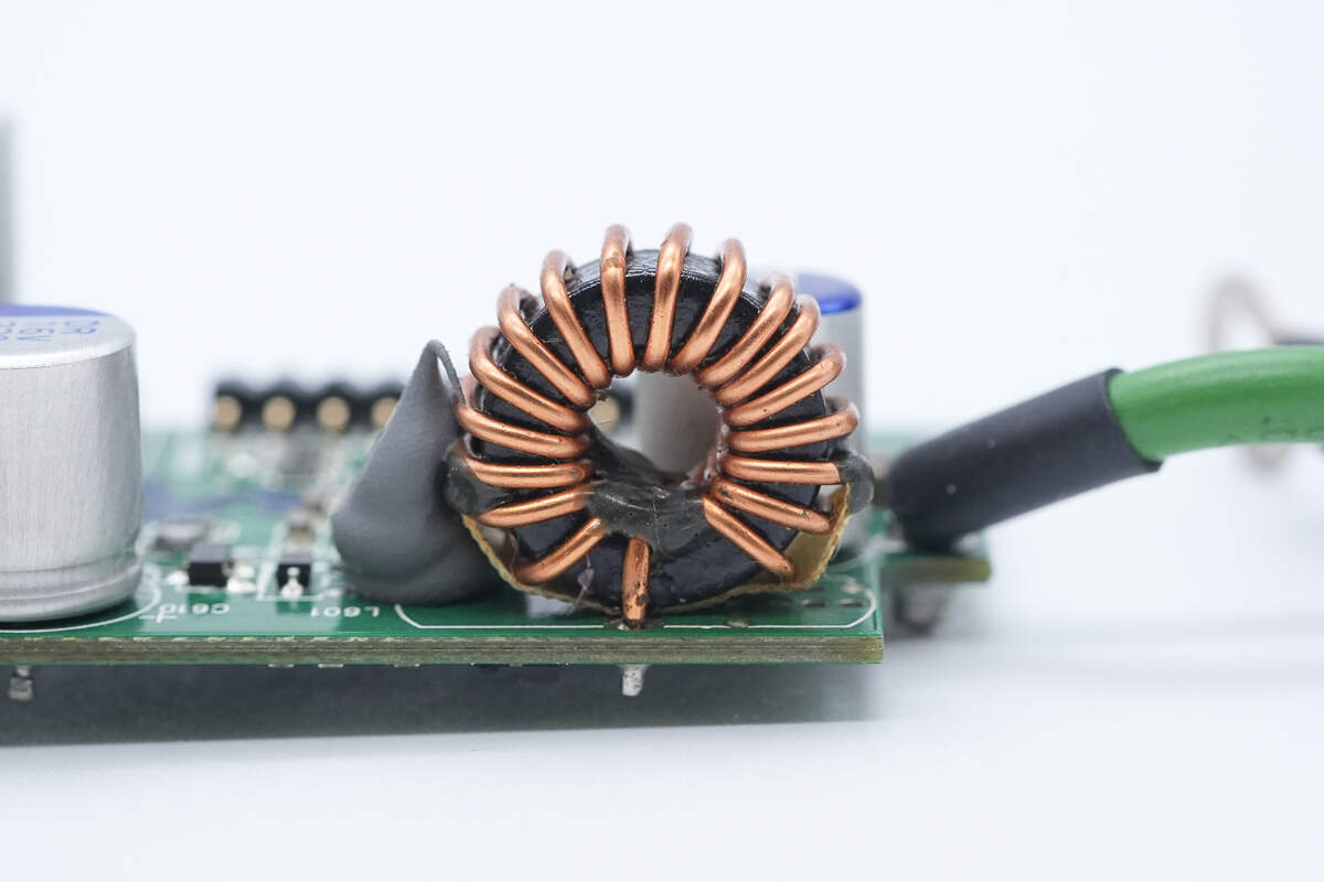

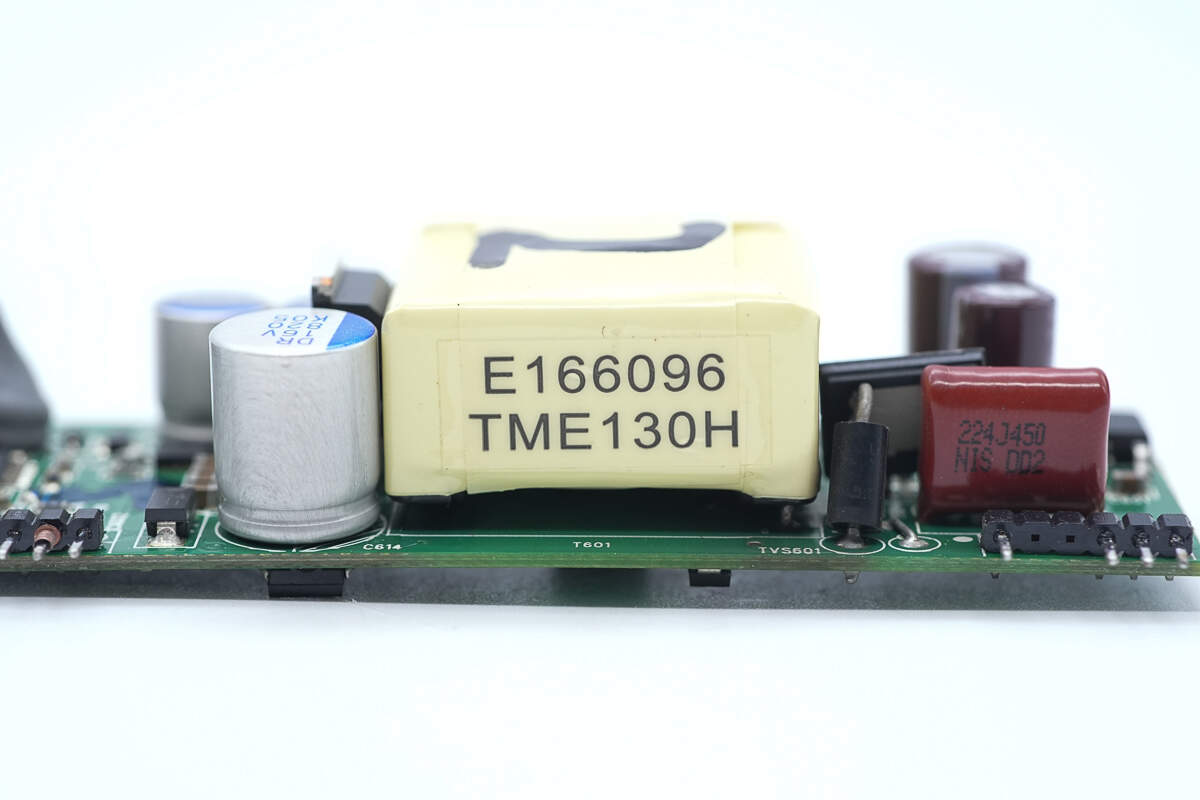

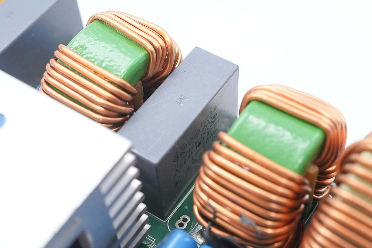

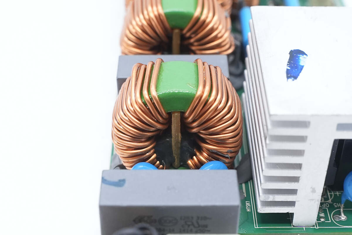

The common-mode choke is wound with enameled wire and features a Bakelite insulating board inside.
The other safety X2 capacitor has the same specifications.
The common-mode choke is wound with enameled wire and internally insulated with a Bakelite board.

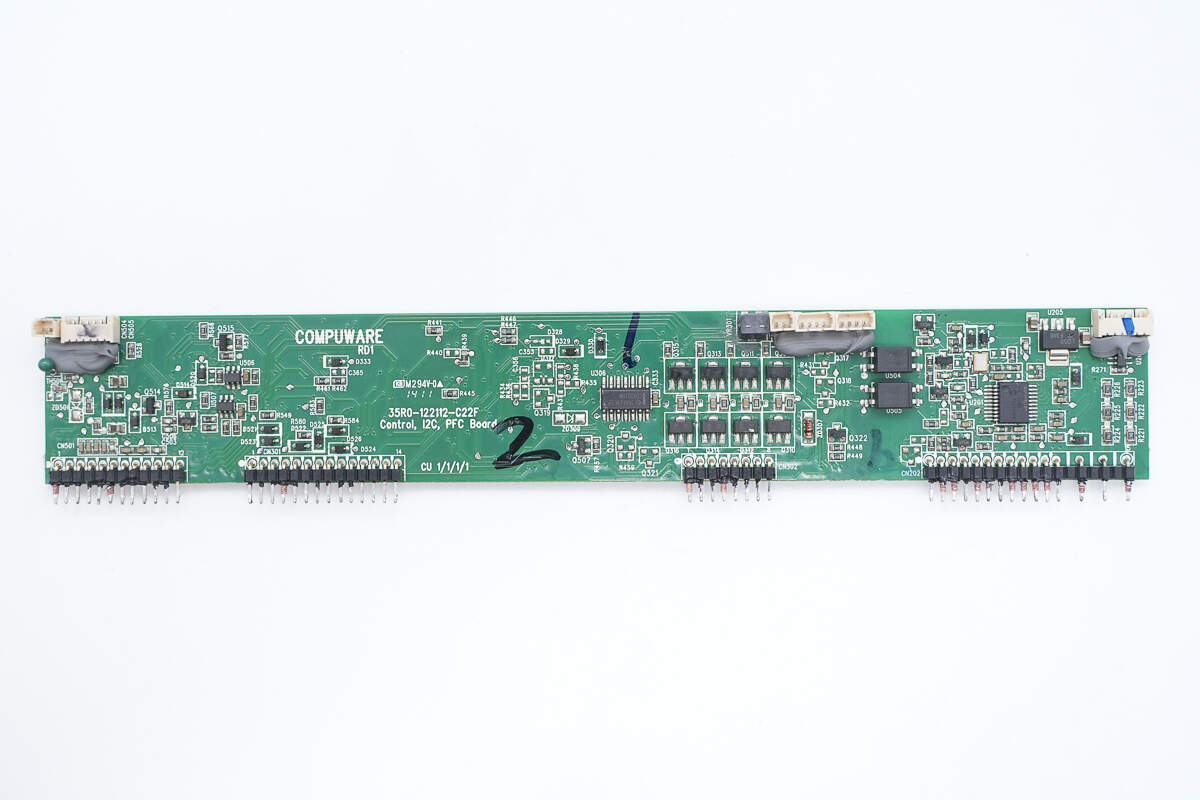

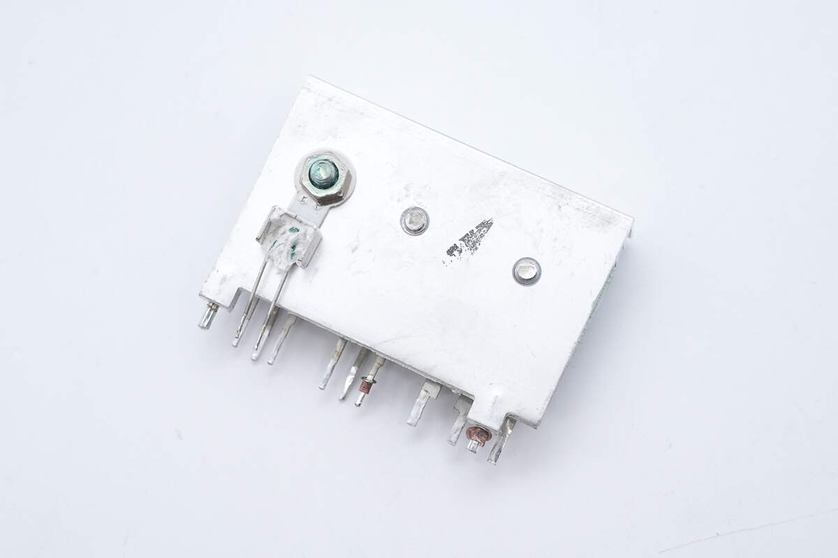

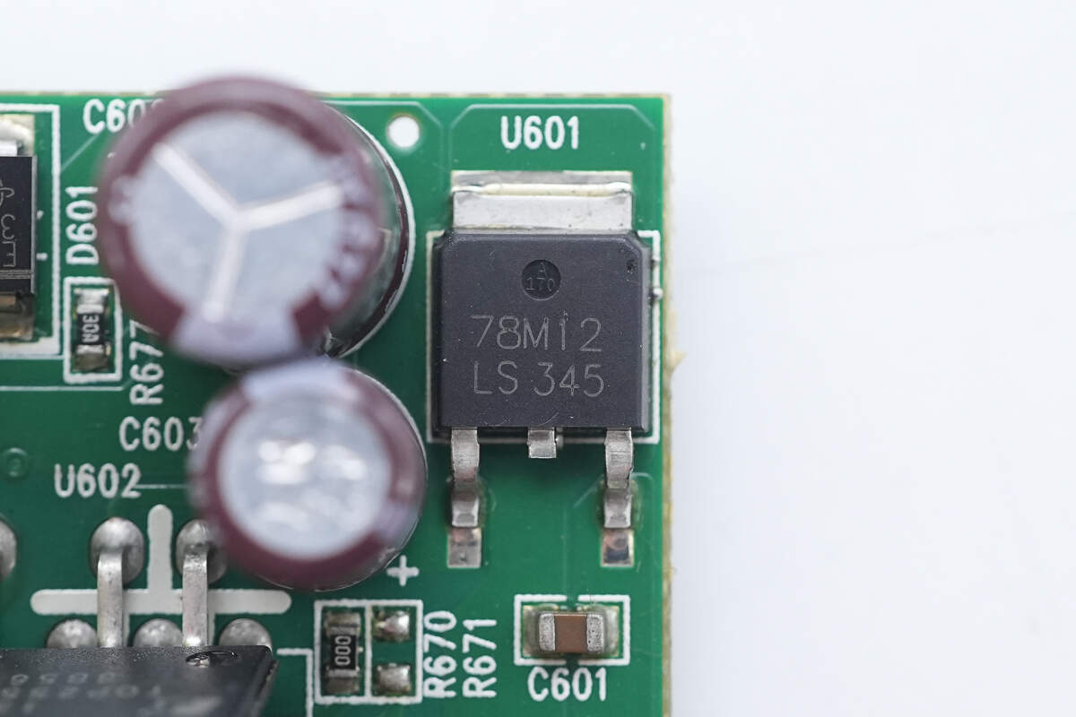

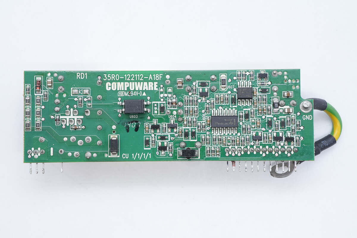

This side features a thermistor and a long, rectangular control PCB.

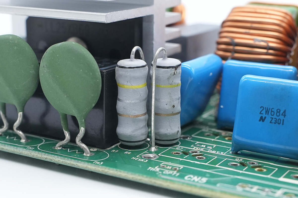

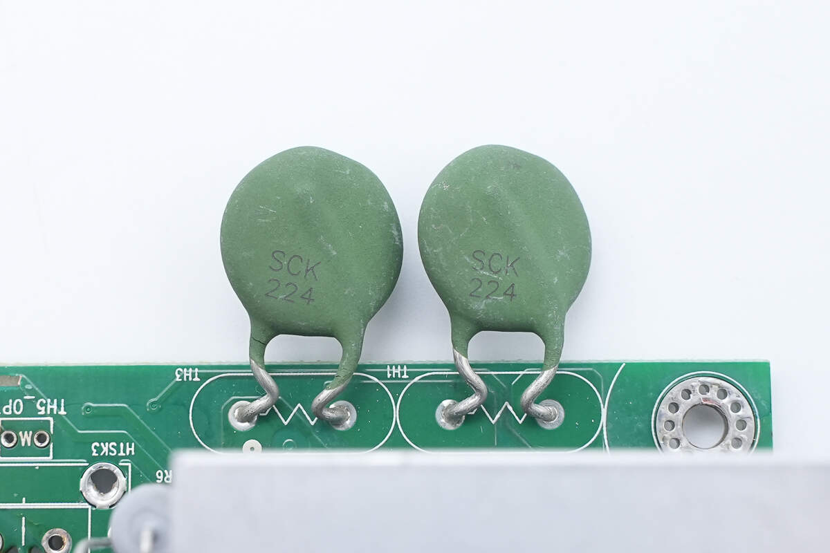

The thermistors, marked SCK224, are connected in series.

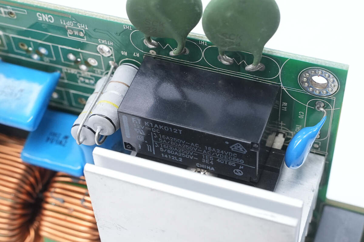

The relay is from Fujitsu, model FTR-K1AK012T. It features a single normally open contact with a contact rating of 16A at 250V, and a coil voltage of 12V.

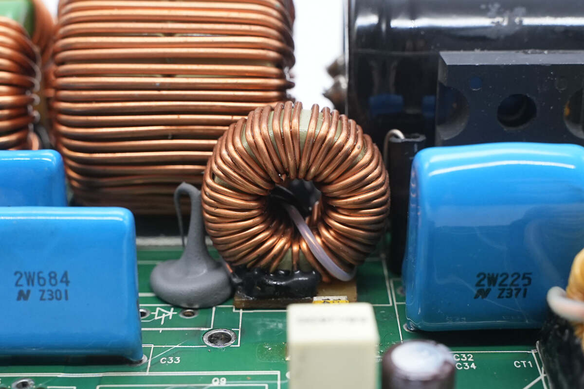

The PFC boost inductor is wound on a ferrite core.

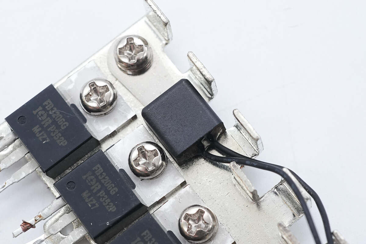

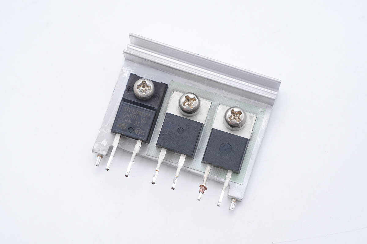

There are three MOSFETs mounted on the heatsink.
On the back, the thermistor is secured with a screw to monitor temperature.

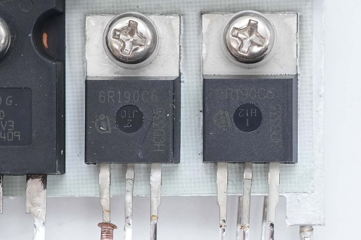

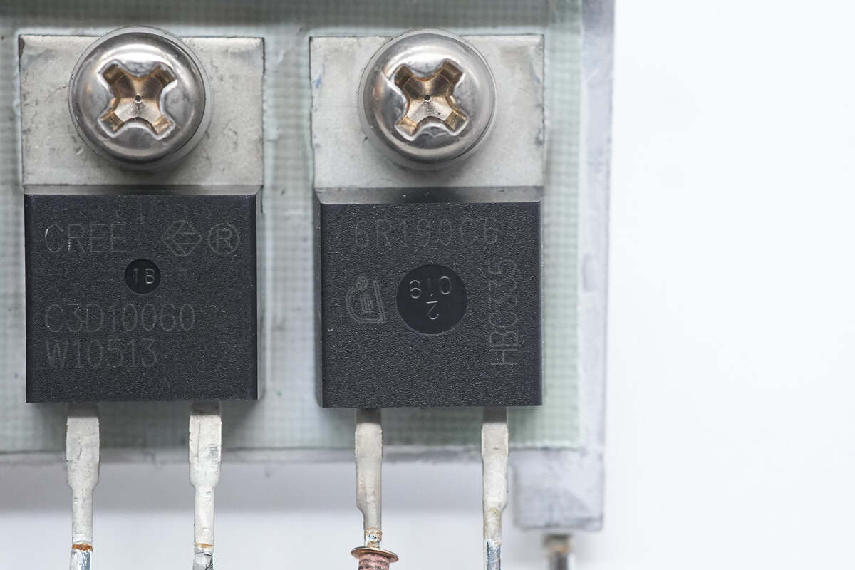

The PFC MOSFETs are from Infineon, model IPP60R190C6. They are N-channel MOSFETs with a voltage rating of 650V, an on-resistance of 190mΩ, and come in a TO-220 package.

The other heatsink houses the rectifiers and PFC MOSFET.
The PFC MOSFET is from Infineon, model IPP60R190C6, with a total of three units used.

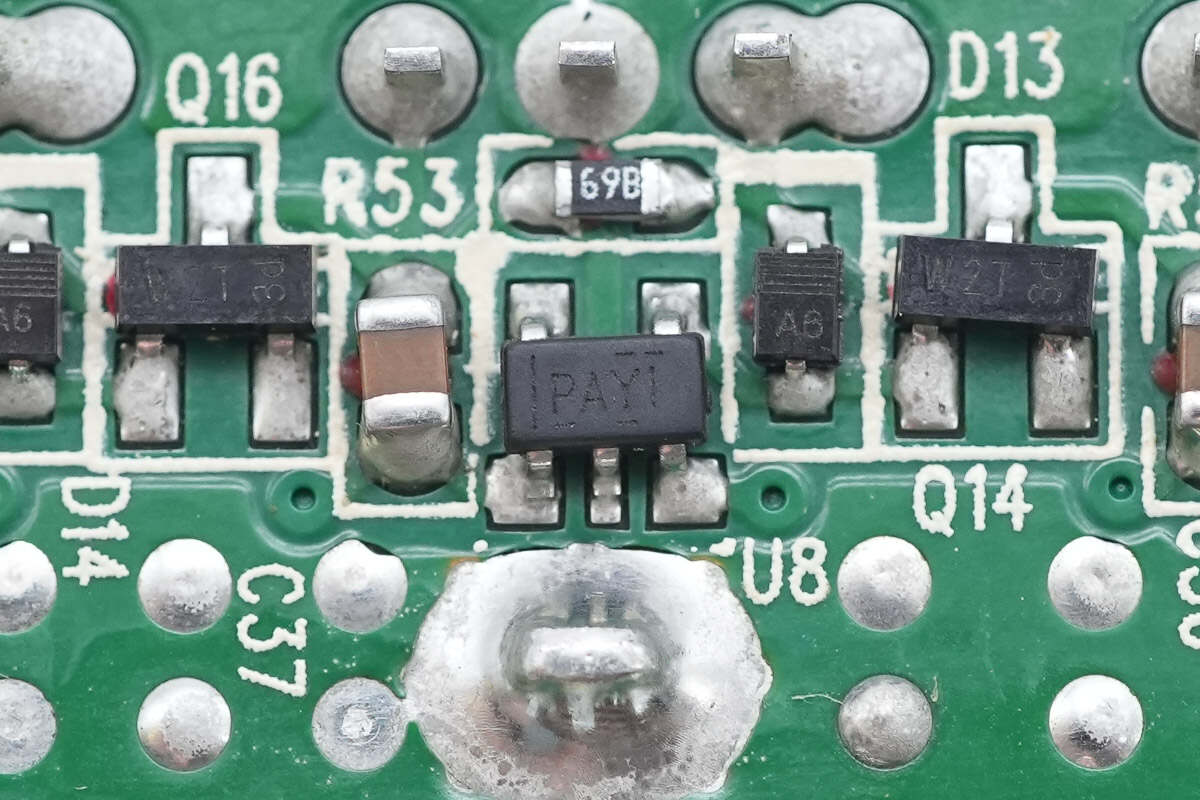

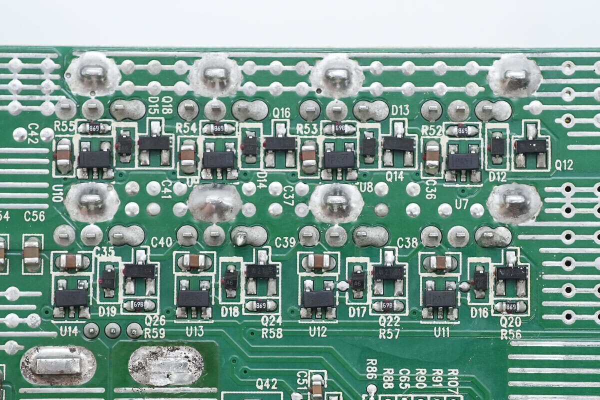

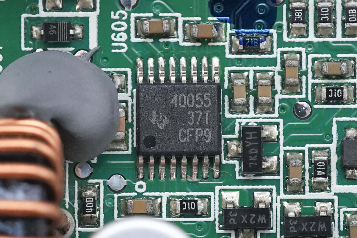

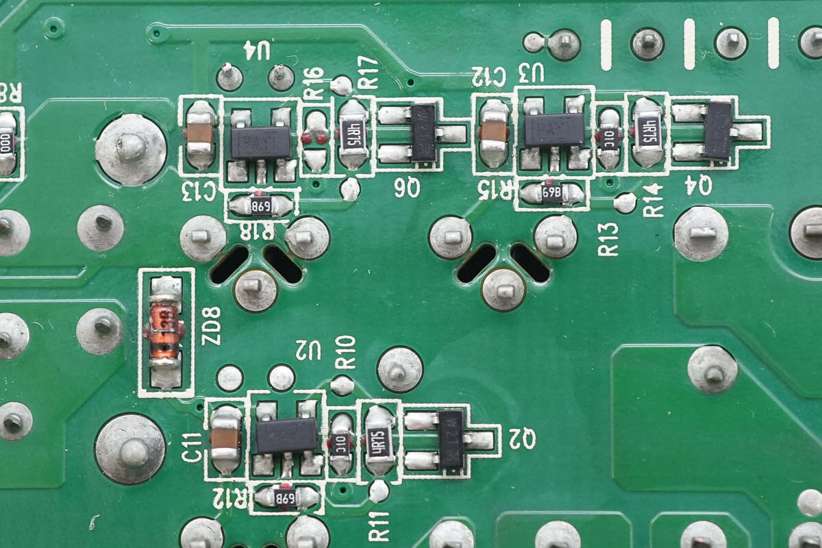

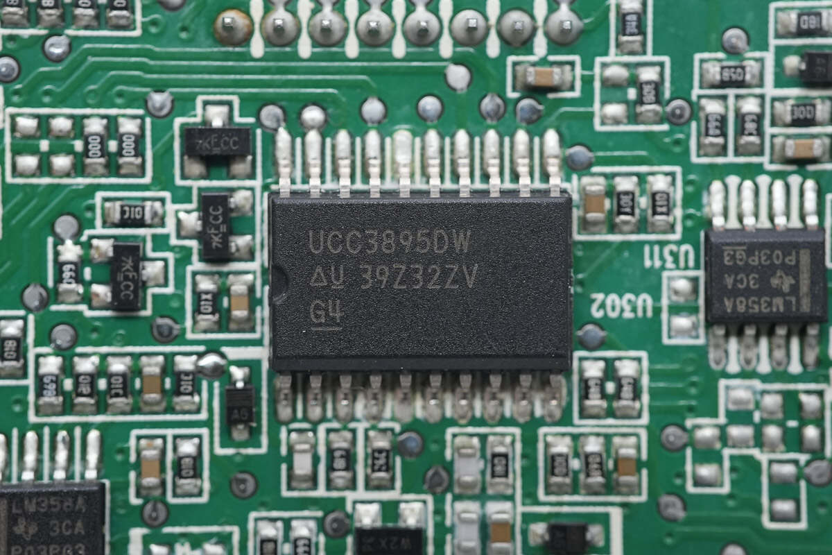

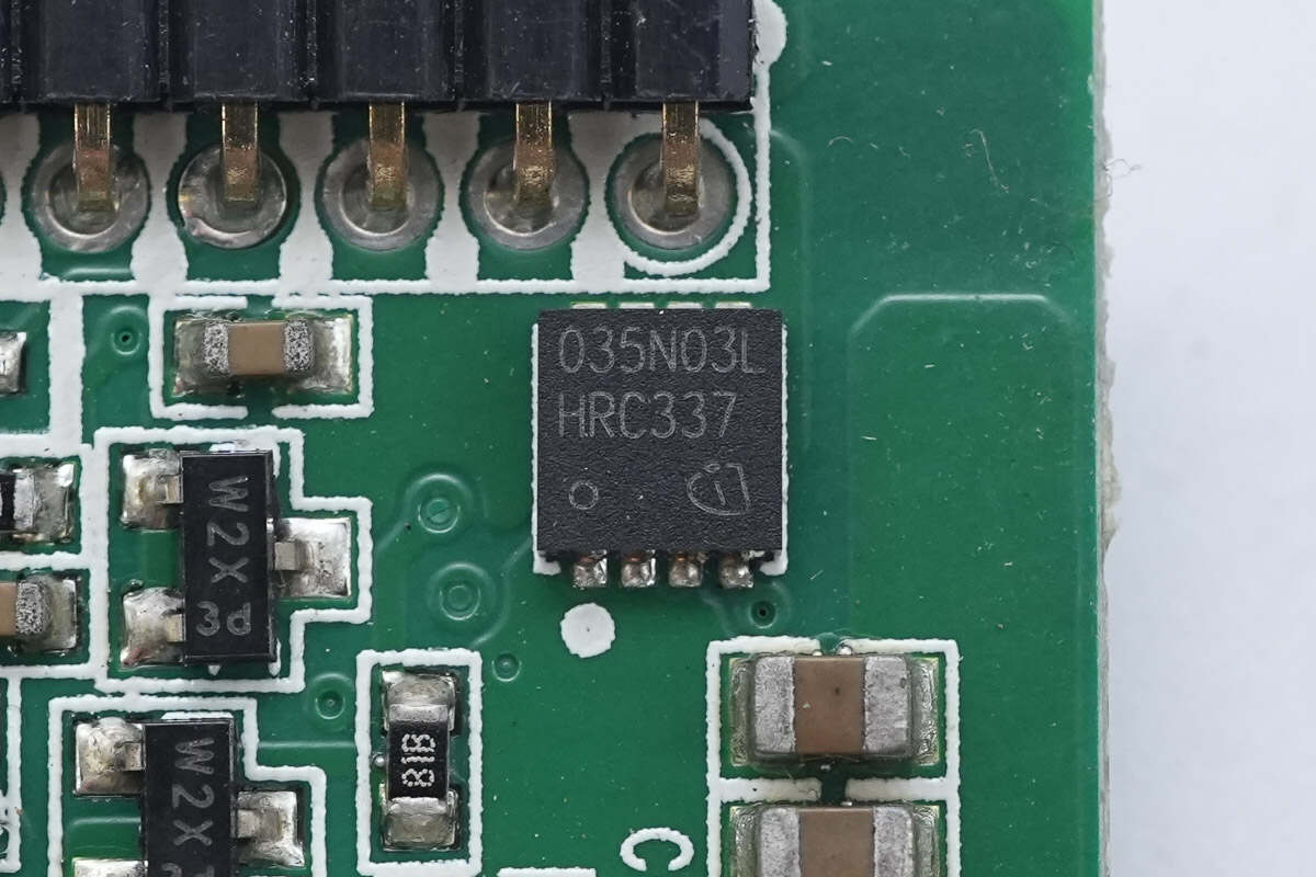

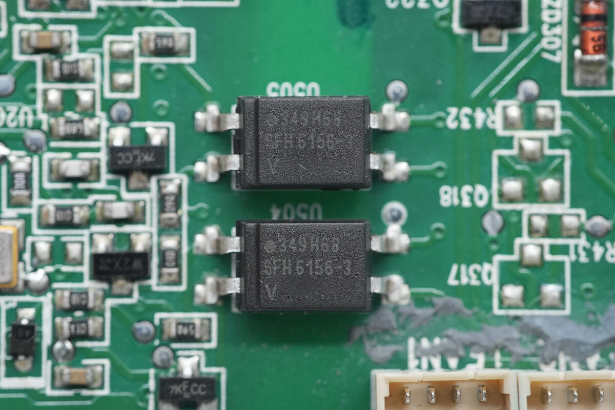

On the back side of the PCBA module, there are three driver ICs responsible for driving the PFC MOSFETs.
The drivers are from Texas Instruments, marked PAYI, model TPS2819. Each is a single-channel high-speed driver with a 2A output current, housed in a SOT-23 package.

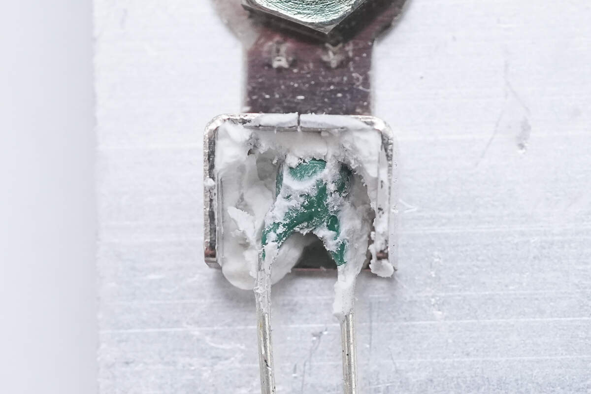

The PFC rectifier is from Wolfspeed, model C3D10060A. It is a third-generation SiC Schottky diode, rated at 600V and 10A, housed in a TO-220-2 package.

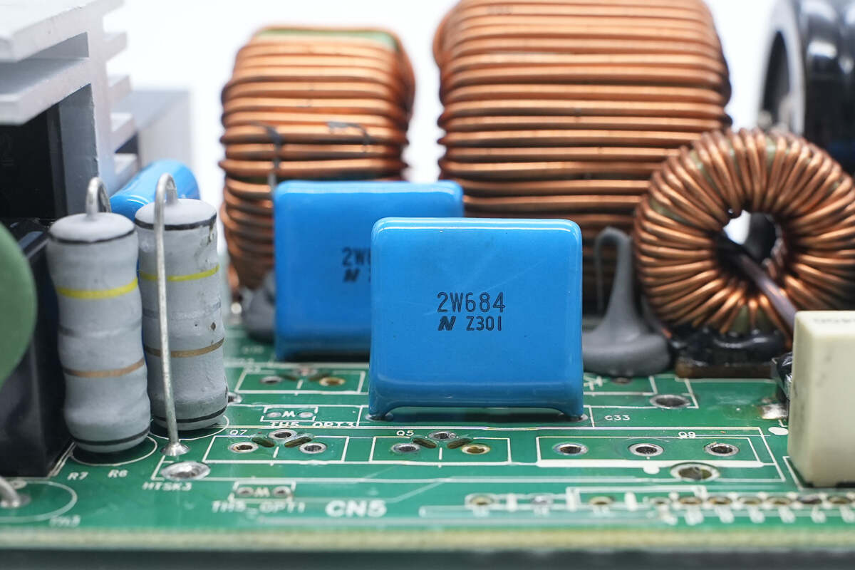

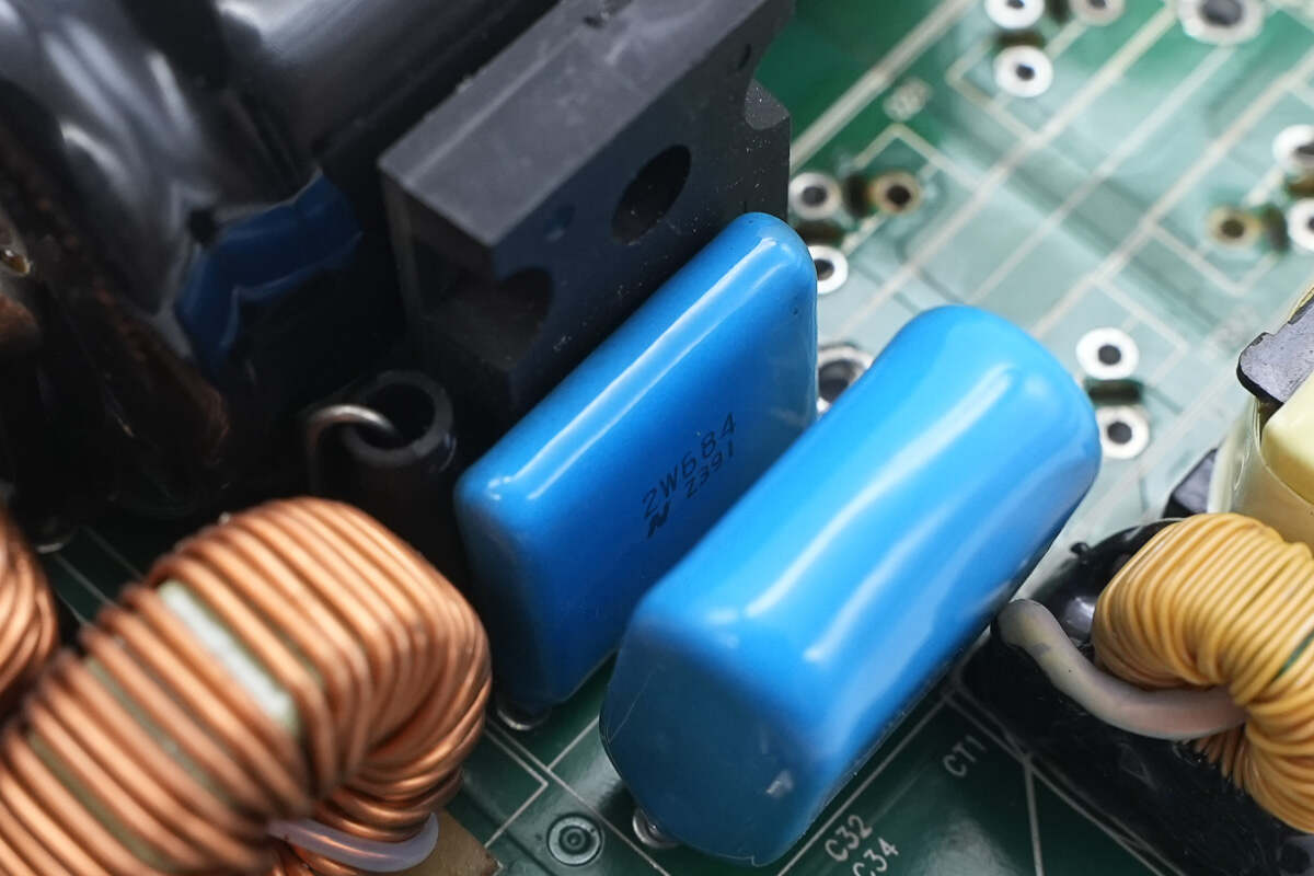

The film filter capacitor is from Nitsuko. 450V 0.68μF.
The other film filter capacitor is rated at 450V, 1μF.

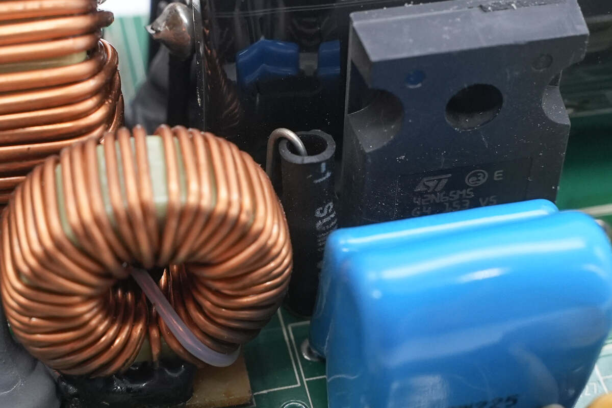

The boost MOSFET is from STMicroelectronics, model STW25NM60ND. It is an N-channel MOSFET with a voltage rating of 600V, an on-resistance of 130mΩ, and comes in a TO-247 package.
The bottom of the boost inductor is insulated with a Bakelite board.
The rectifier is from STMicroelectronics, model STTH15R06FP. It is a Turbo 2 ultra-fast diode, rated at 600V and 15A, housed in a TO-220FPAC package.

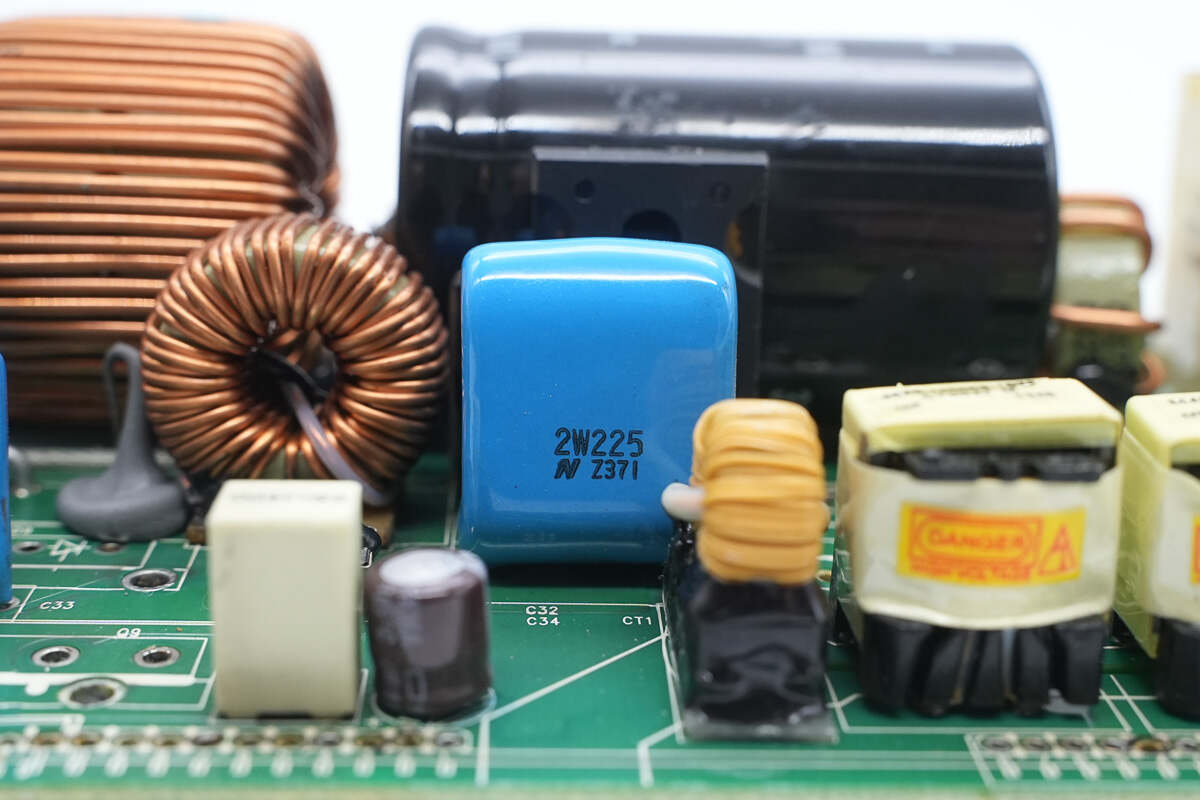

The film filter capacitor is rated at 450V, 2μF.
This film filter capacitor is rated at 450V, 0.68μF.

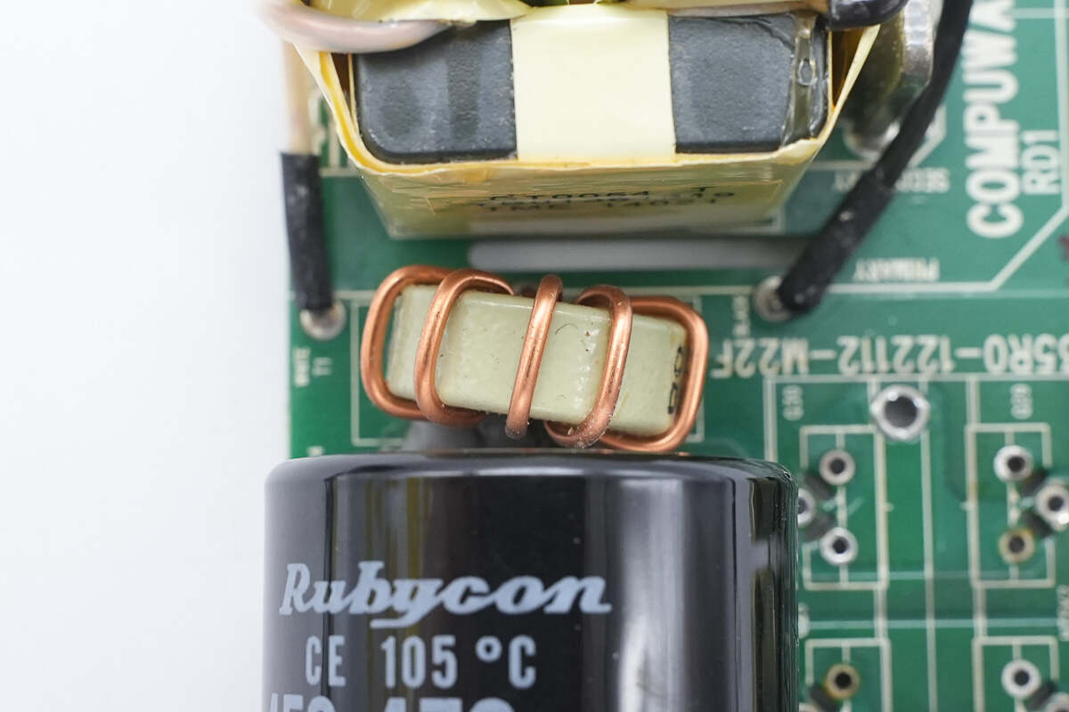

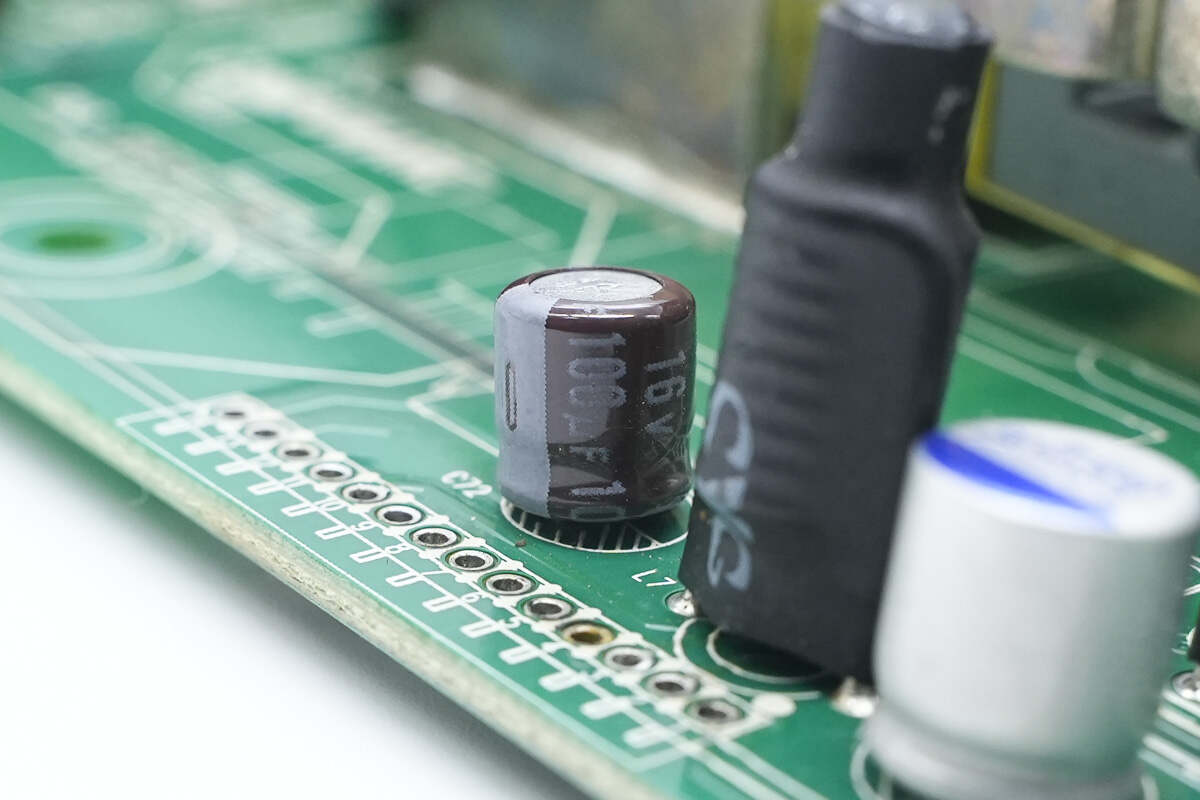

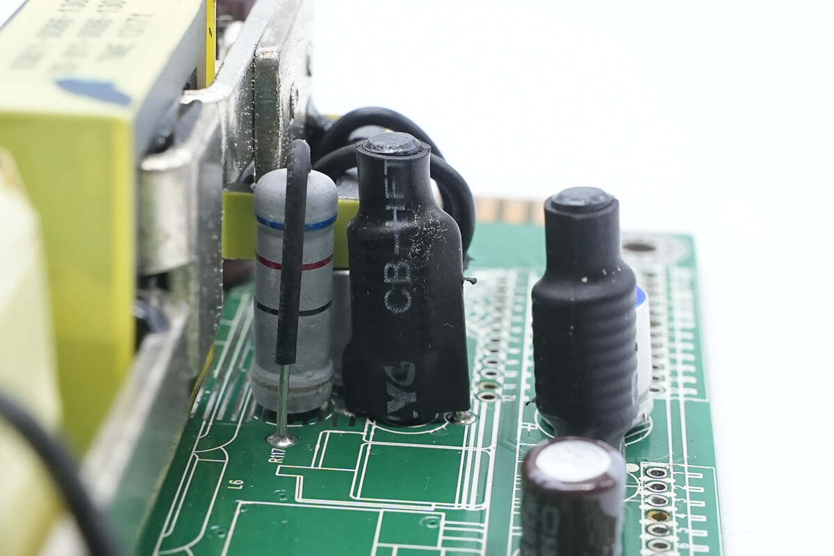

The high-voltage filter capacitor is from Rubycon, part of the MXH series. It is an electrolytic capacitor rated at 450V, 470μF.

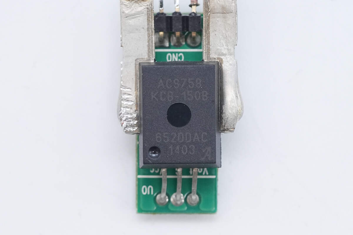

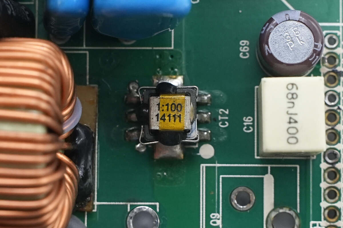

Close-up of the current transformer.

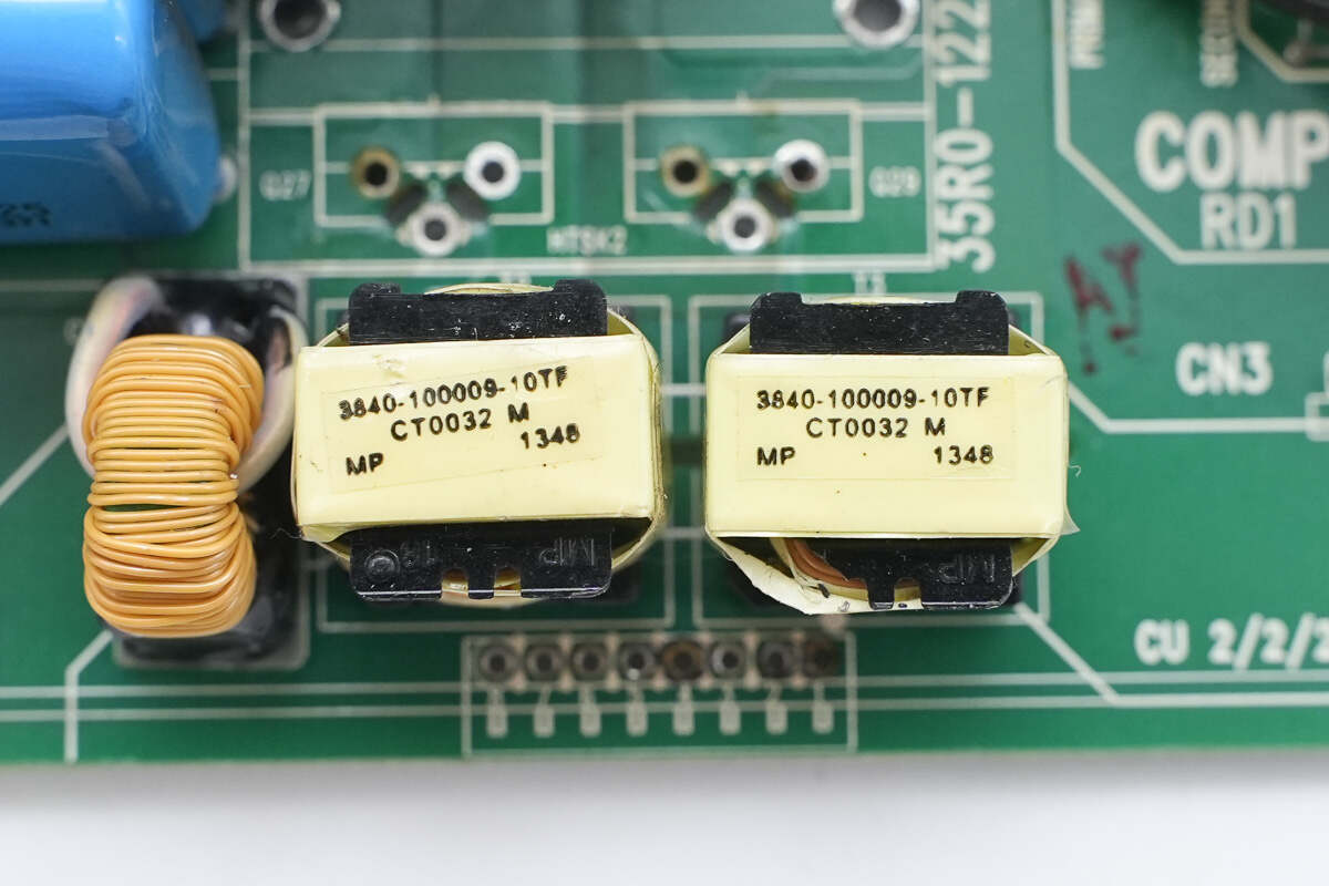

Two isolation transformers are used to drive the phase-shift full-bridge MOSFETs.

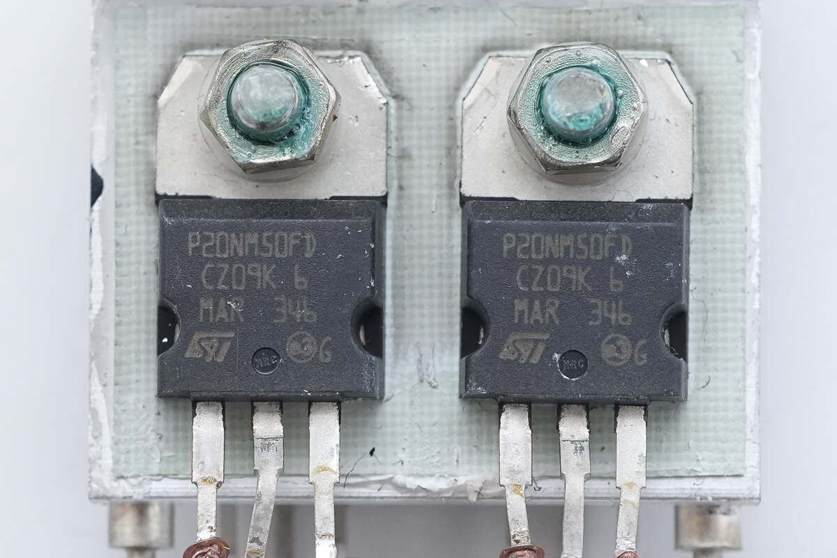

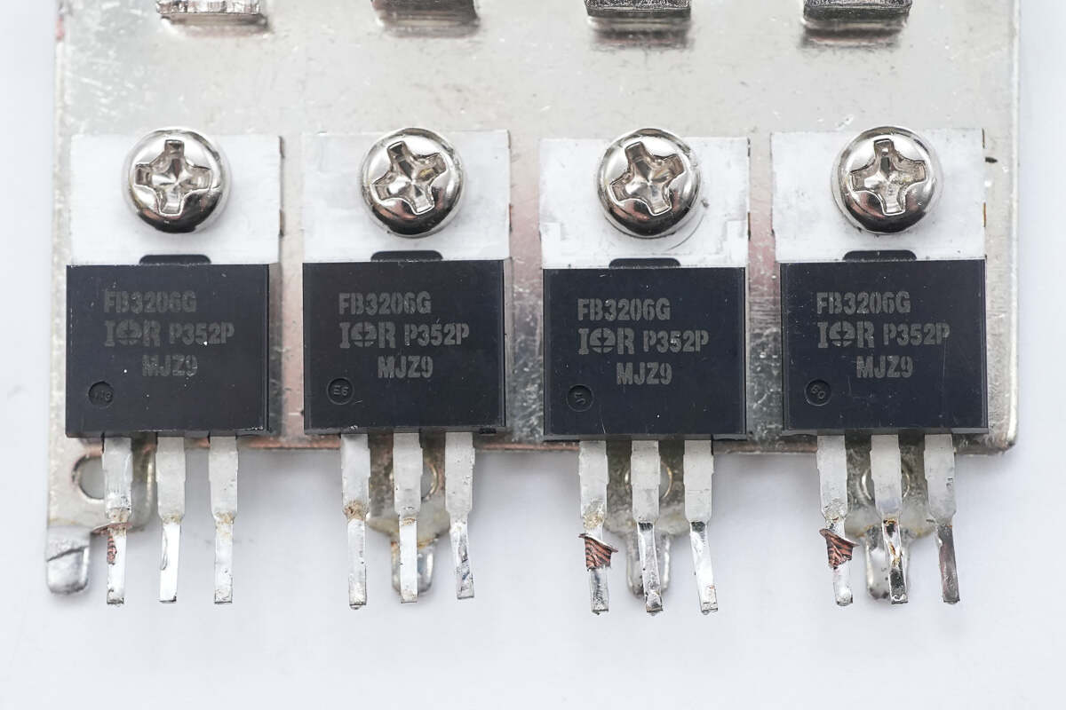

Four phase-shift full-bridge MOSFETs are mounted on the heatsink.
The MOSFETs are from STMicroelectronics, model STP20NM50FD. They are N-channel MOSFETs rated at 500V with an on-resistance of 220mΩ, housed in a TO-220 package.

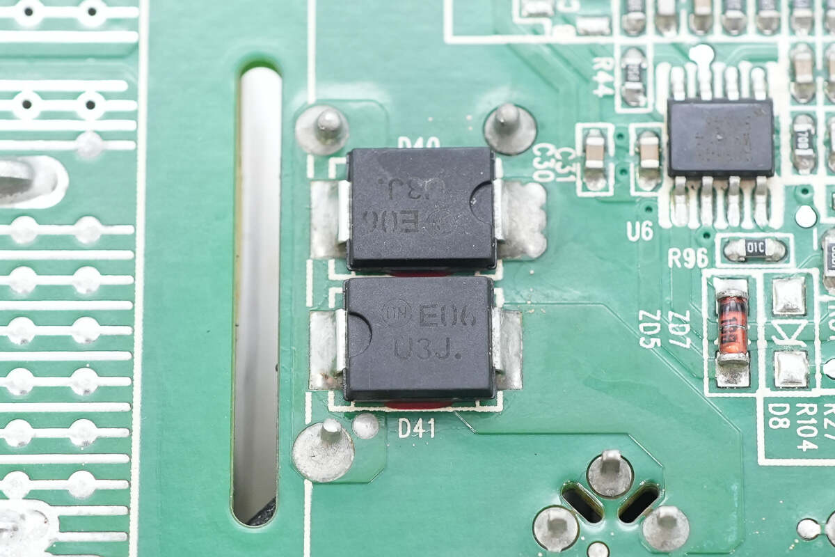

Two fast recovery diodes from Onsemi, marked U3J, model MURS360, rated at 600V 3A, are housed in SMC packages.
Here is the filter inductor.

The synchronous rectifiers are mounted on heatsinks.
A thermistor is mounted on the heatsink to monitor temperature.
The synchronous rectifiers are from Infineon, model IRFB3206G. They are N-channel MOSFETs rated at 60V with an on-resistance of 2.4mΩ, housed in TO-220AB packages.
The other four synchronous rectifiers have the same model.

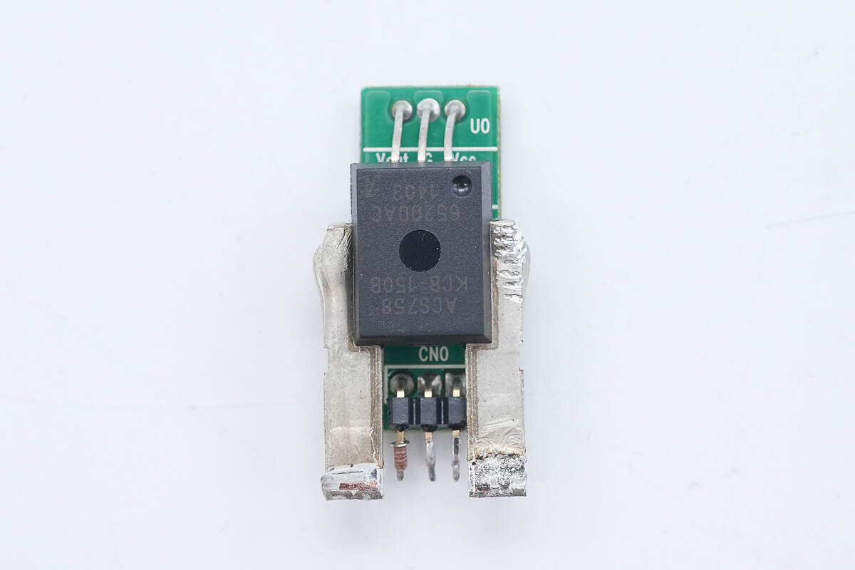

The Hall-effect current sensor is from Allegro, model ACS758KCB-150-PSF-T. It features a built-in 100μΩ sense resistor and an integrated low-offset, precision linear Hall sensor circuit. It supports bidirectional current sensing up to 150A, operates at 3.3V or 5V, and comes in a 5-pin package.
The output side features a filter ferrite core.

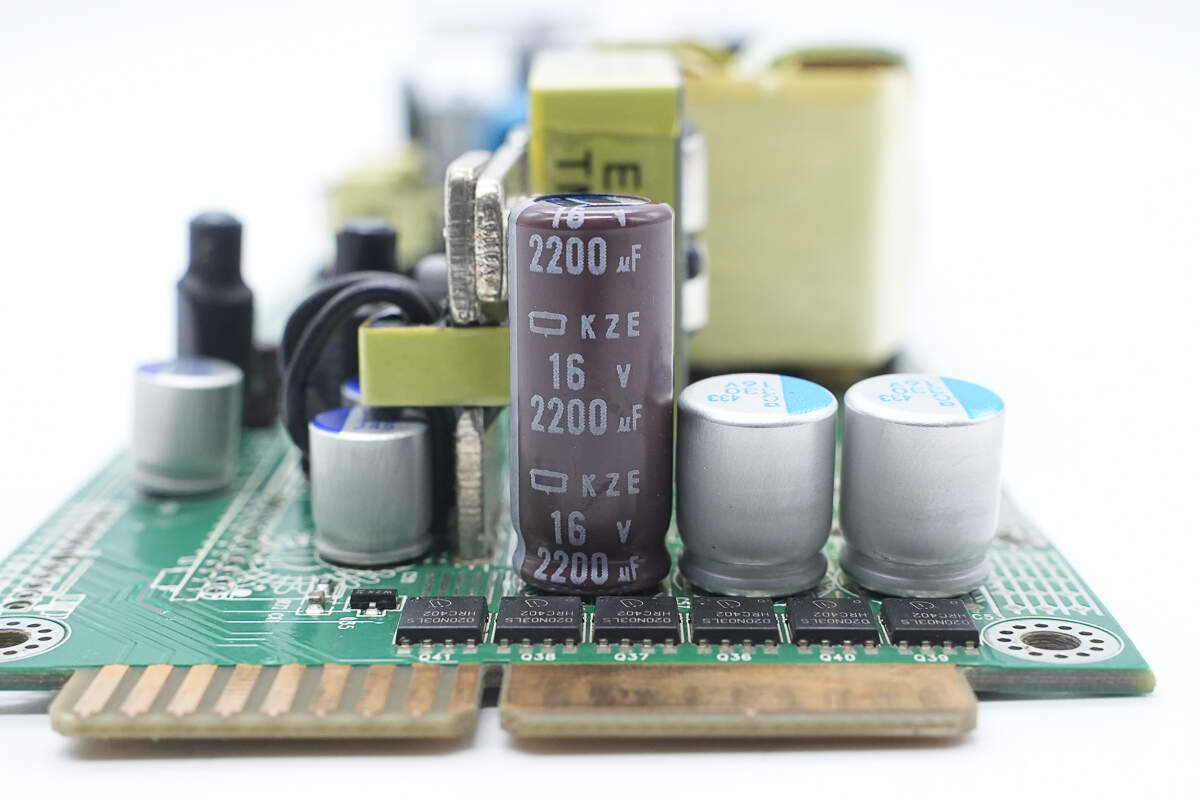

The filter capacitor is from NCC, part of the KZE series of long-life electrolytic capacitors, rated at 16V, 2200μF.
The solid capacitors are also from NCC, each rated at 330μF, 16V.

On the left side of the control PCB are a PFC controller and an Op-Amp. In the center are a phase-shift full-bridge controller, a voltage comparator, and an Op-Amp. The right side houses the MCU.
The back side features a NAND gate, transistors, optocouplers, and an MCU.
The PFC controller is from TI, model UCC3818AD. It is a CCM-mode PFC controller featuring overvoltage protection and precise power limiting, housed in a 16-pin SOIC package.

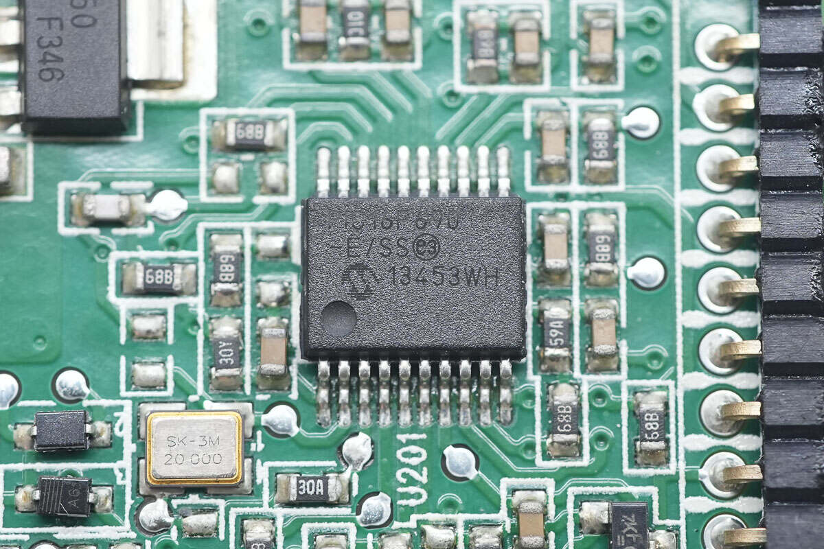

The MCU is from Microchip, model PIC16F690. It features a high-performance RISC core CPU, 7KB of internal FLASH, 256 bytes of SRAM, 256 bytes of EEPROM, an integrated 10-bit ADC, and comes in a 20-pin SSOP package.

The phase-shift full-bridge controller is from TI, model UCC3895. It supports fixed-frequency PWM and resonant zero-voltage switching, with both voltage-mode and current-mode control. The chip features enhanced control logic, adaptive delay settings, and shutdown functionality, housed in a 20-pin SOIC package.

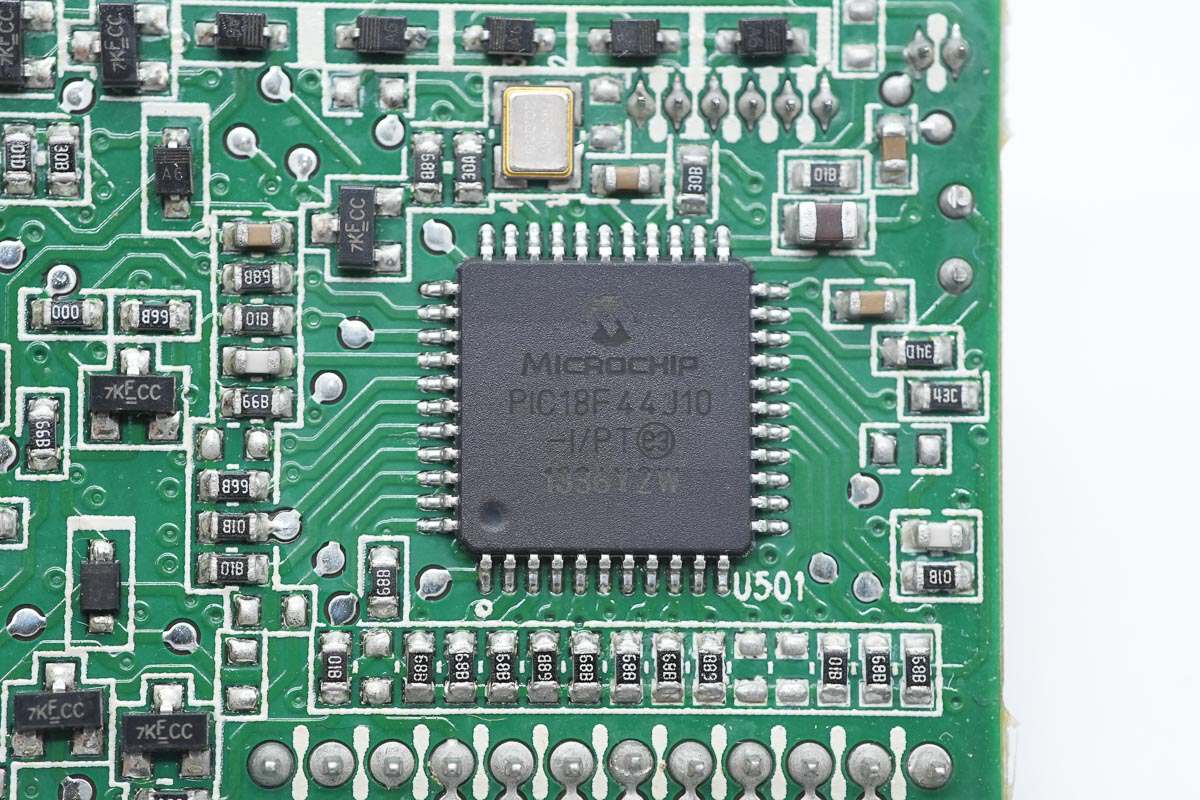

The main MCU is from Microchip, model PIC18F44J10. It features 16KB of internal FLASH and 1KB of RAM, housed in a 44-pin TQFP package.
Close-up of the 20.000 MHz clock crystal oscillator.

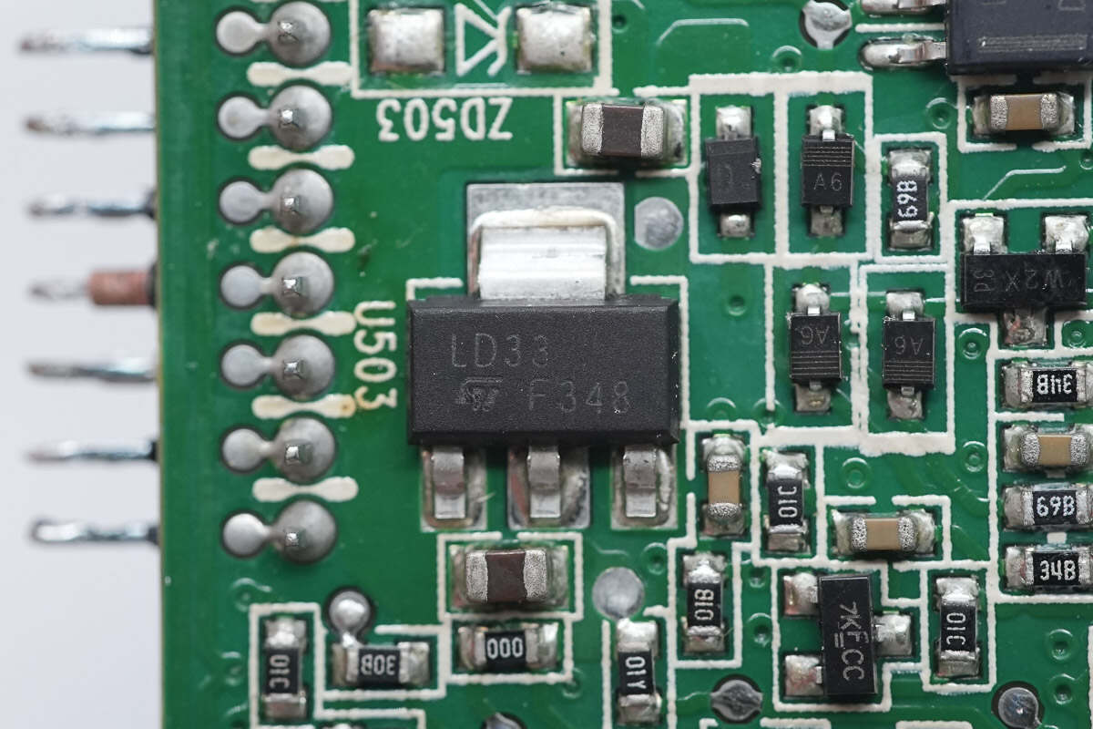

The voltage regulator supplying power to the MCU is from STMicroelectronics, marked LD33, model LD1117S33TR. It supports up to 15V input voltage, outputs 3.3V at 800mA, and comes in a SOT-223 package.

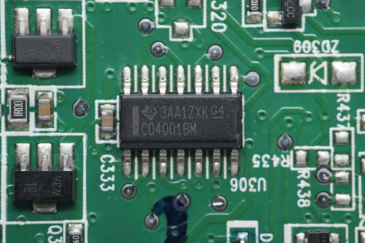

The NAND gate is from TI, model CD4001BM. It is a quad 2-input device housed in a 14-pin SOIC package.

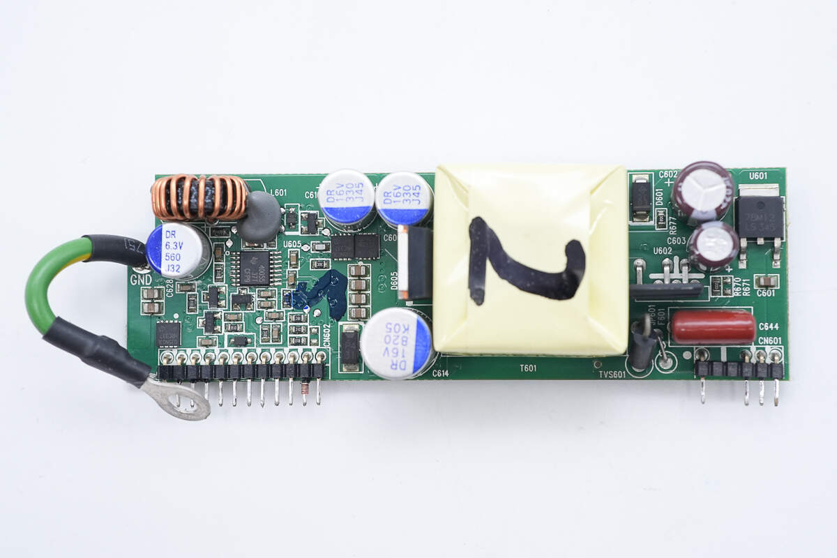

On the right side of the standby power PCB are the switching power IC, the voltage regulator, and filter capacitors. In the middle are the transformer, rectifier, and solid capacitors. The left side features the synchronous buck controller, buck MOSFETs, and a filter capacitor.
On the back side are an optocoupler, voltage comparators, and operational amplifiers.

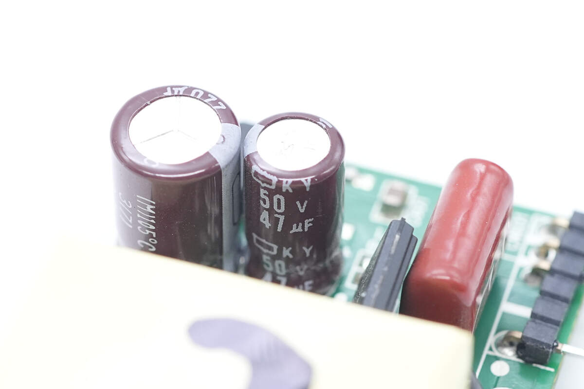

The film filter capacitor is rated at 0.22μF, 450V.
The filter capacitor is from NCC, rated at 47μF, 50V.
Another capacitor is rated at 220μF, 25V.

The rectifier is from STMicroelectronics, model STPS20H100CR. It is a Schottky diode rated at 100V, 20A, housed in a TO-220AB package.

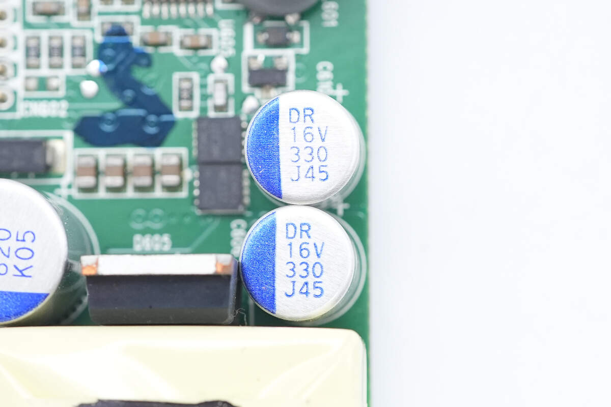

Both of these filter solid-state capacitors are rated at 330μF, 16V.

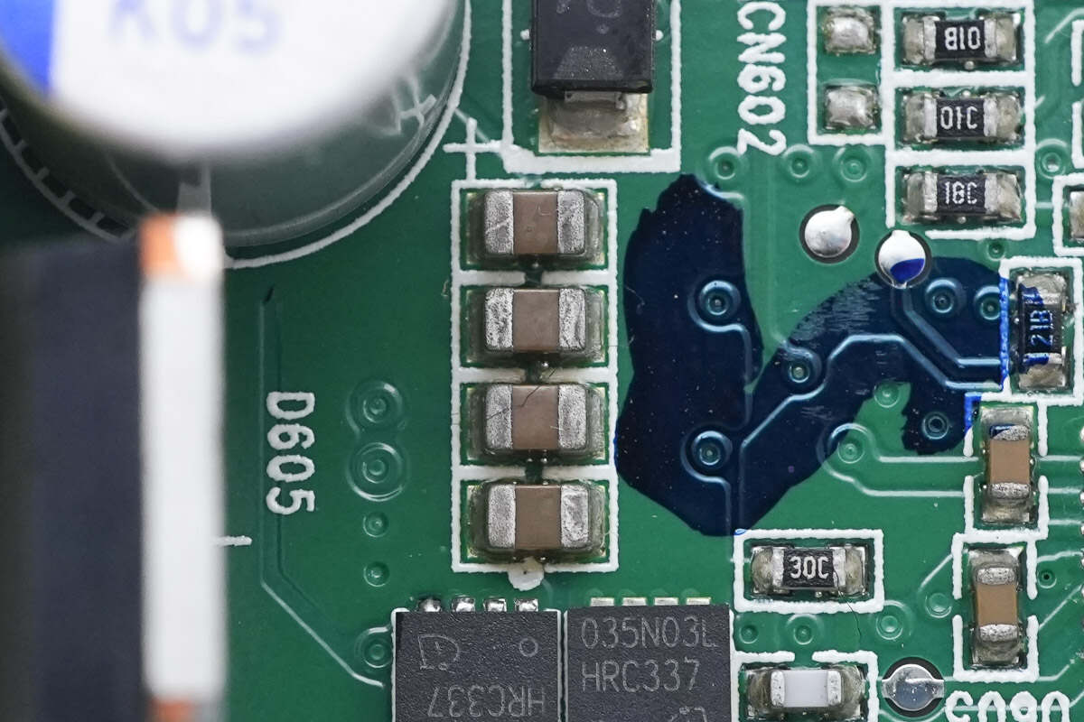

The MLCC capacitors are connected in parallel for input filtering.

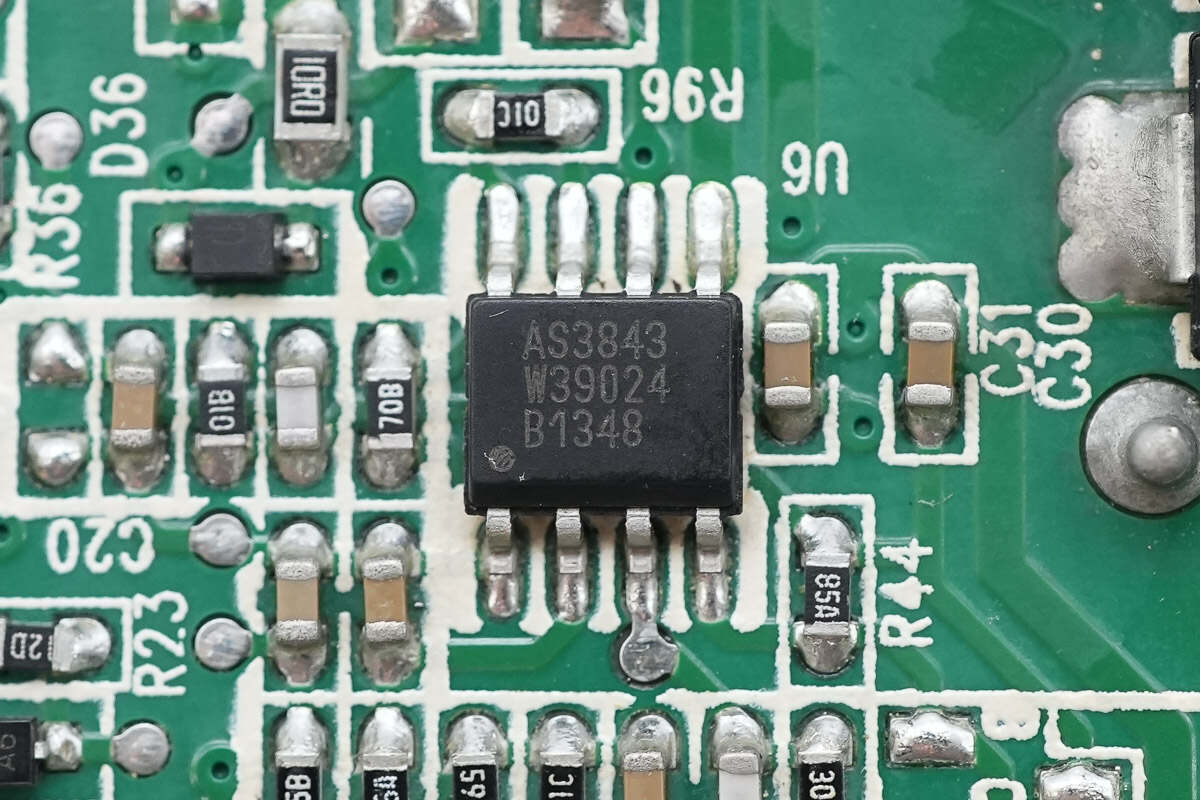

Close-up of the AS3843 PWM controller.
Close-up of the LM358A dual op-amp.

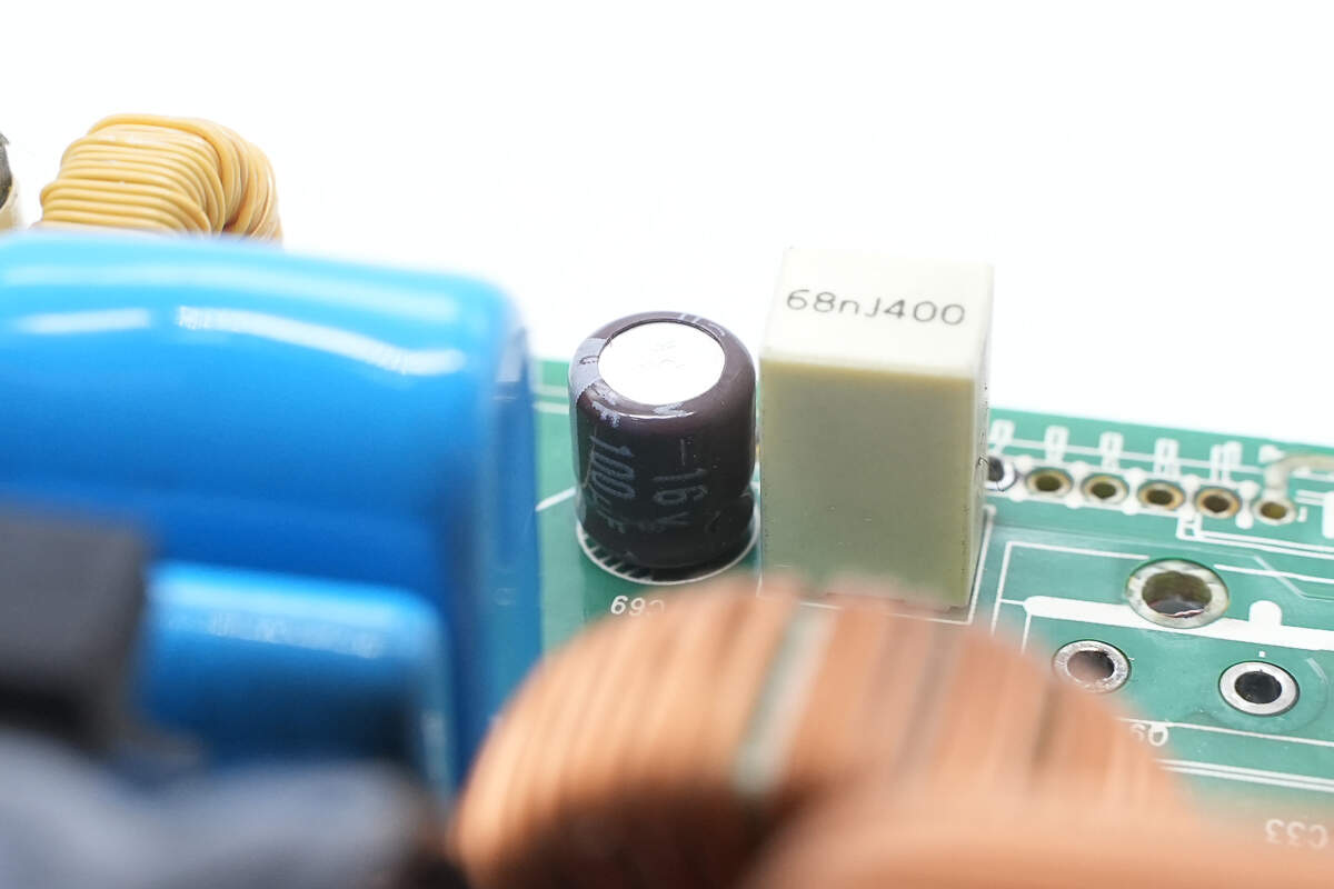

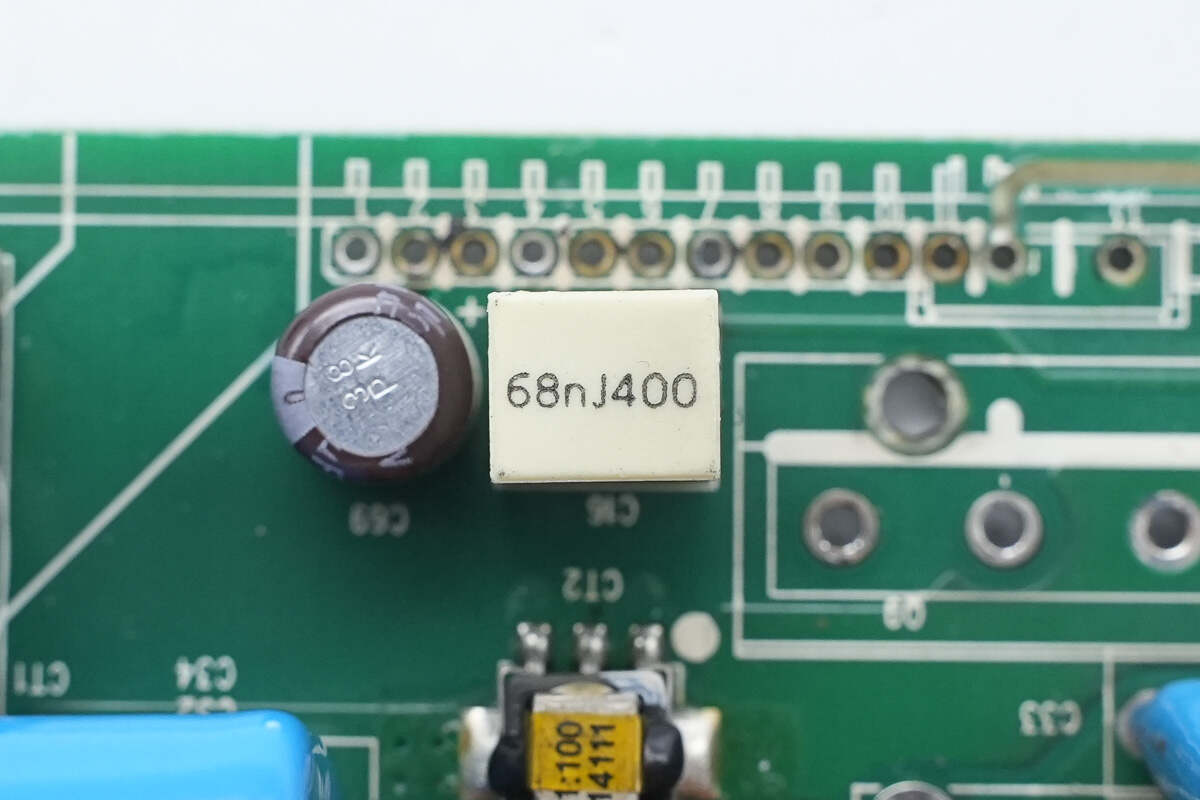

The electrolytic capacitor is from NCC, rated at 100μF, 16V.

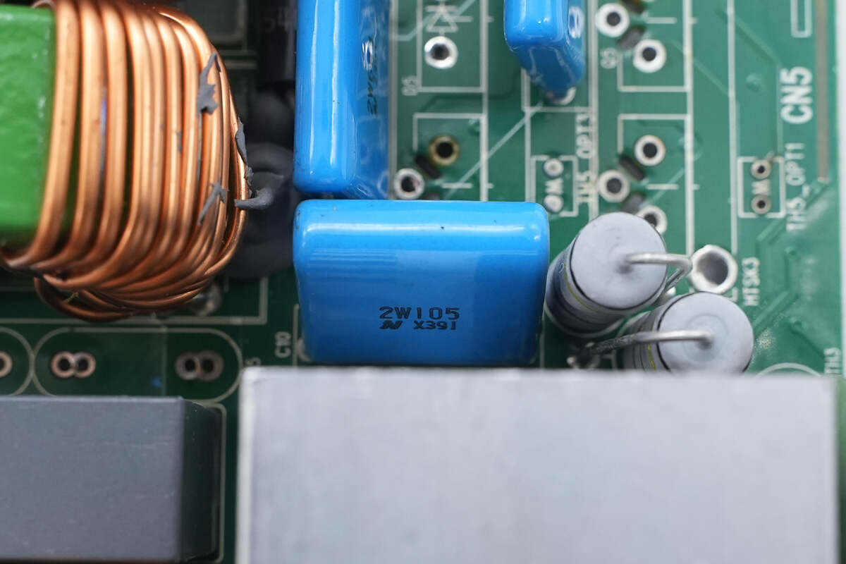

The film capacitor is rated at 68nF, 400V.
Another filter electrolytic capacitor with the same specifications.

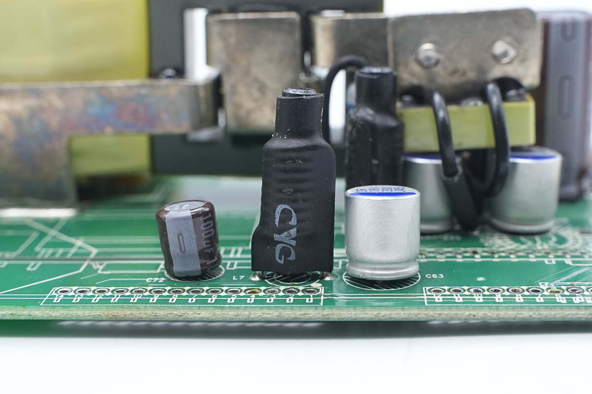

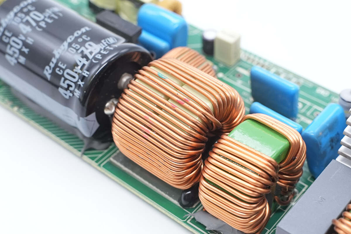

The filter inductor is insulated with heat shrink tubing.
The other filter inductor is also insulated with heat shrink tubing.
All three solid-state capacitors are rated at 330μF, 16V.

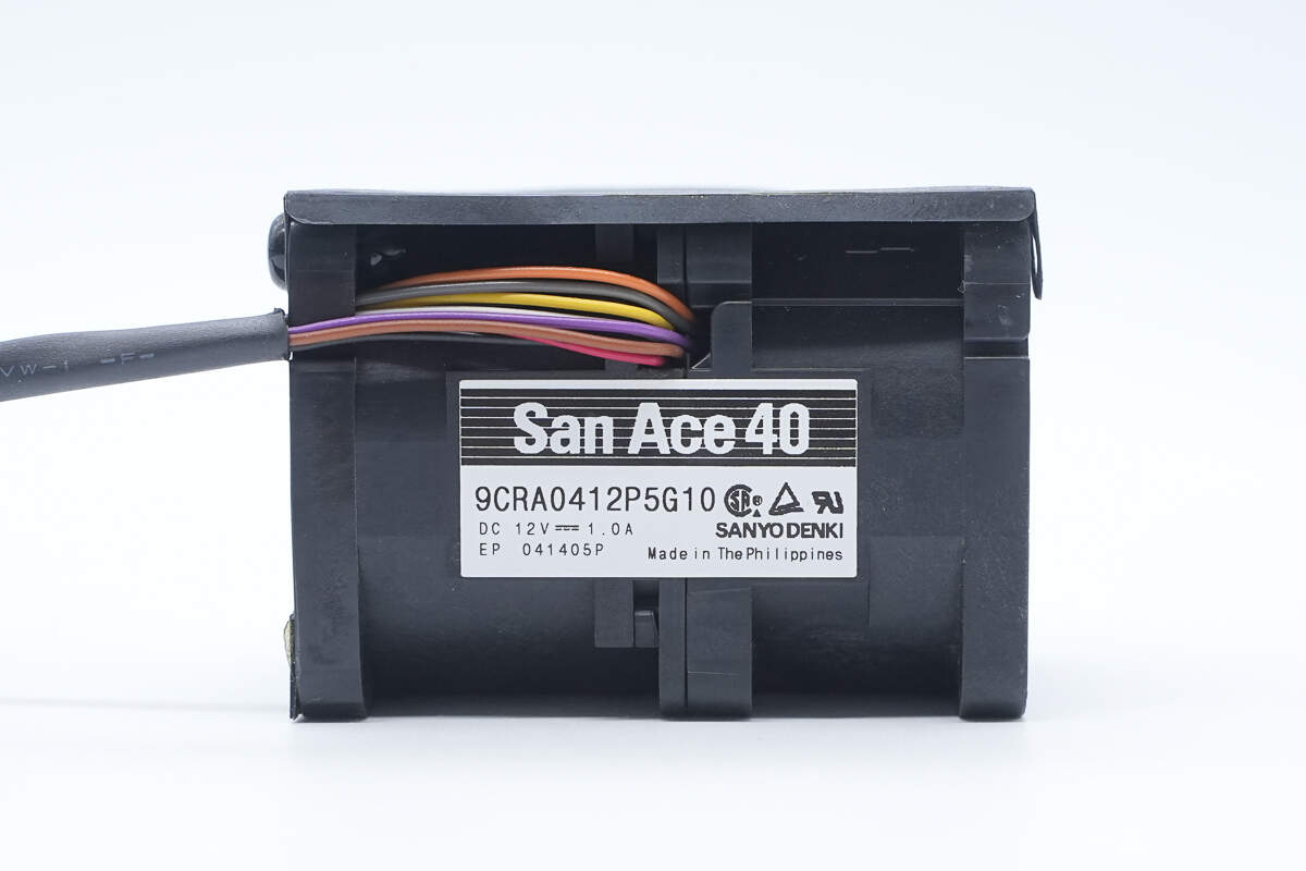

The cooling fan is from SANYO DENKI, model 9CRA0412P5G10, rated at 12V 1A, manufactured in the Philippines.

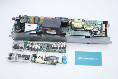

Well, those are all components of the Supermicro 720W 1U Redundant Power Supply.
Here is the component list of the Supermicro 720W 1U Redundant Power Supply for your convenience.
It supports a wide input voltage range of 100-240V, with a rated output power of 720W and a 12V output voltage, along with a 5V standby output. The input side features a C14 power socket, a cooling fan, an LED indicator, and a handle. The output side has a gold finger connector for hot-swapping.
After taking it apart, we found it uses a PFC plus phase-shift full-bridge architecture. The PFC controller is the TI UCC3818AD, paired with Infineon IPP60R190C6 MOSFETs and Wolfspeed C3D10060A silicon carbide diode. The phase-shift full-bridge controller is the TI UCC3895, utilizing STMicro STP20NM50FD MOSFETs.
Inside, there is a control PCB and a standby power PCB. The control PCB features a Microchip MCU for parameter monitoring and communication functions. The standby power PCB uses a PI TOP255EN power chip, and the output current is monitored via a Hall current sensor. The internal layout is compact, with solid and reliable build quality and component selection.
