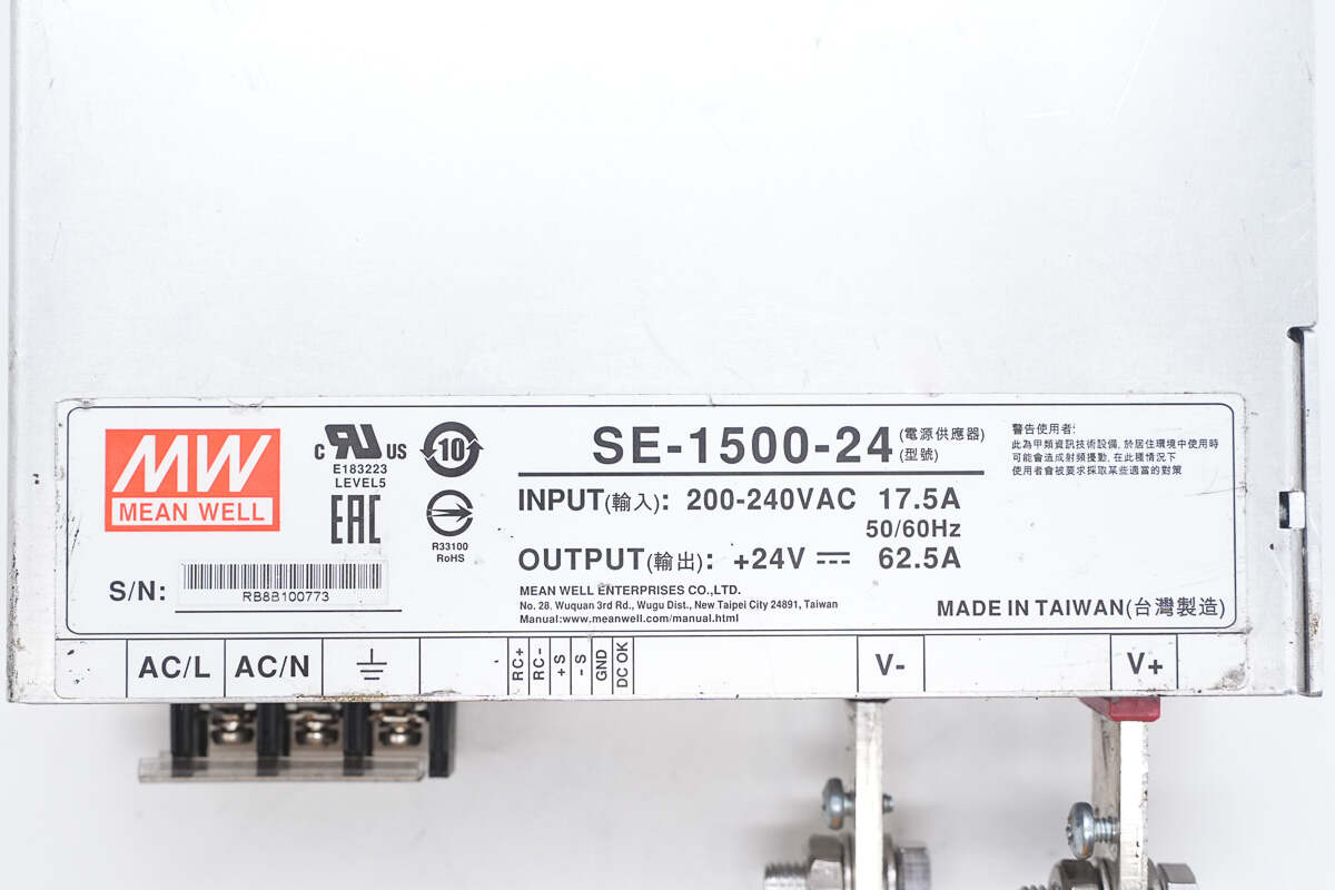

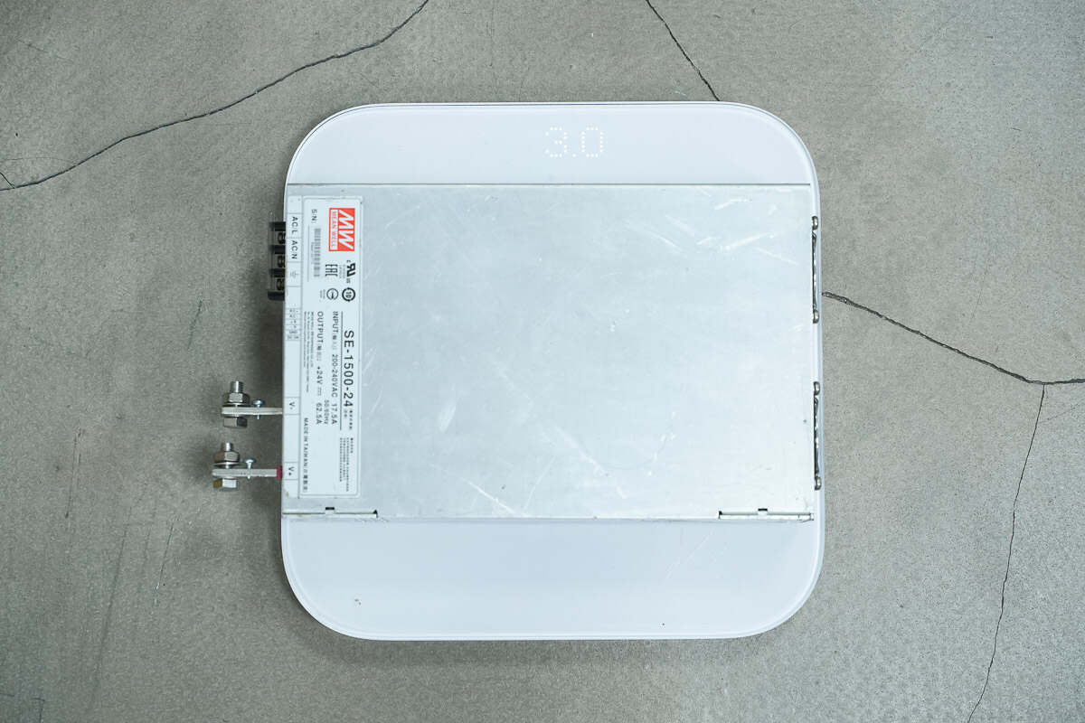

Model: SE-1500-24
Input: 200-240VAC 17.5A 50/60Hz
Output: 24V 62.5A

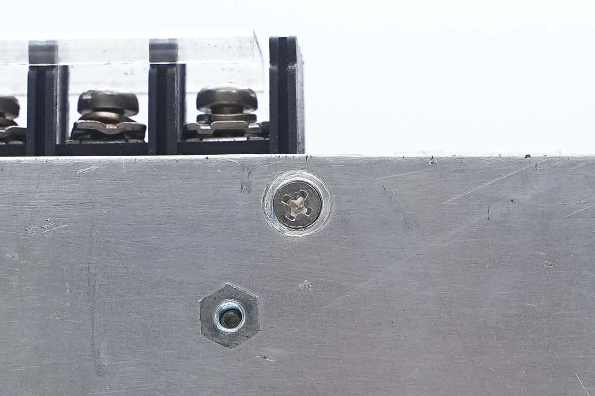

The rear cover is secured with screws.
Teardown of MEAN WELL 1500W Switching Power Supply (SE-1500-24)-Chargerlab

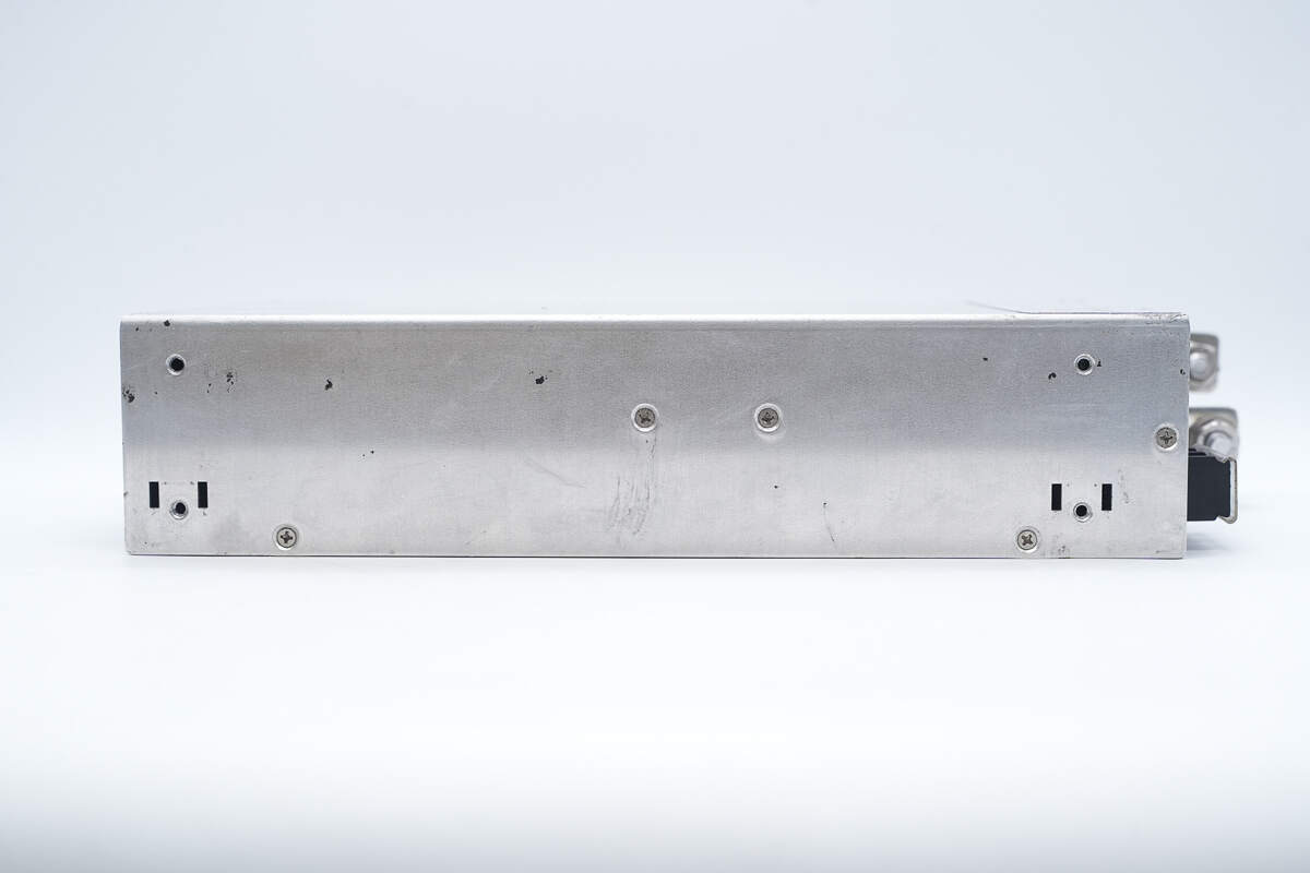

The sides also have screws for mounting.

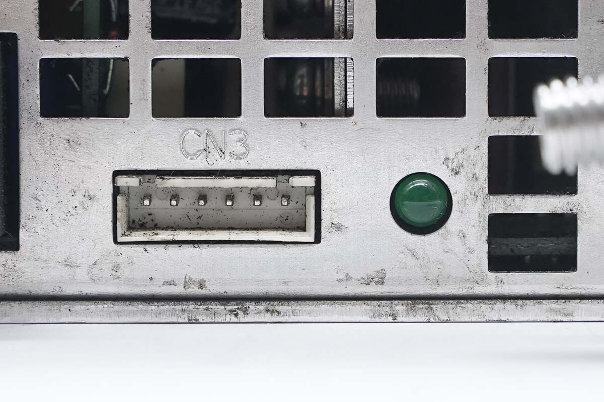

The bottom of the module has AC input terminals, DC output terminal posts, and a control terminal. It also features several rectangular openings for airflow.

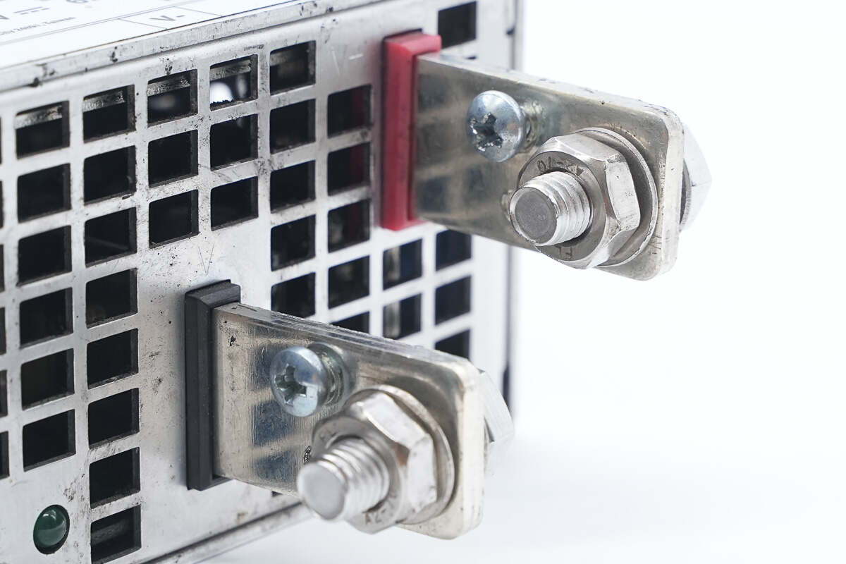

The DC output terminal posts are marked with red and black to indicate the positive and negative poles.

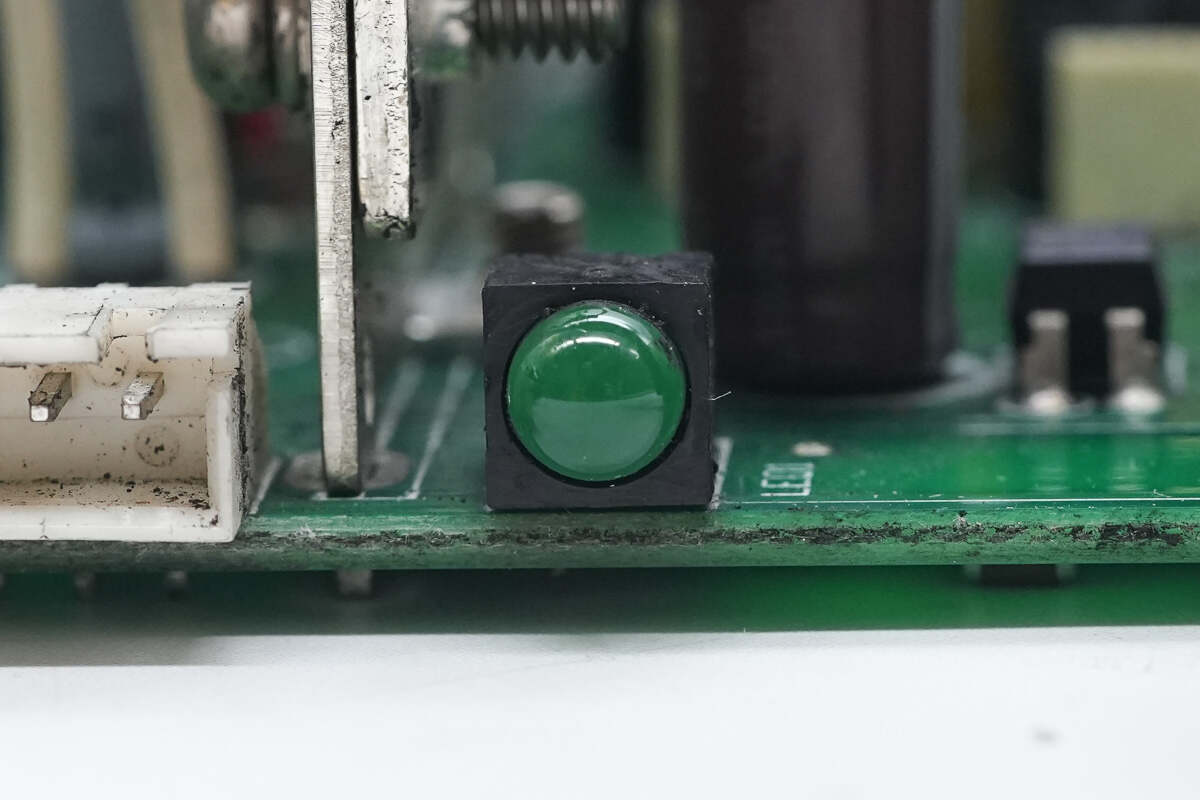

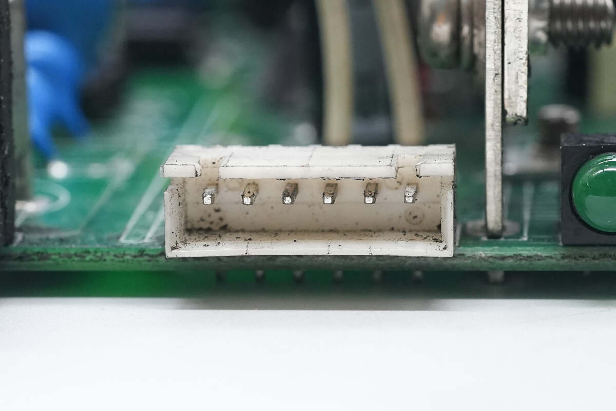

Close-up of the control terminal and indicator light.

The length is about 280 mm (11.024 inches).
The width is about 177.9 mm (7.0039 inches).

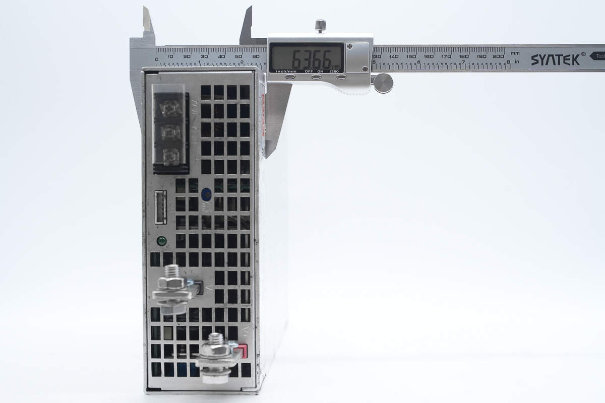

The thickness is about 63.7 mm (2.51 inches).
The weight is about 3 kg.

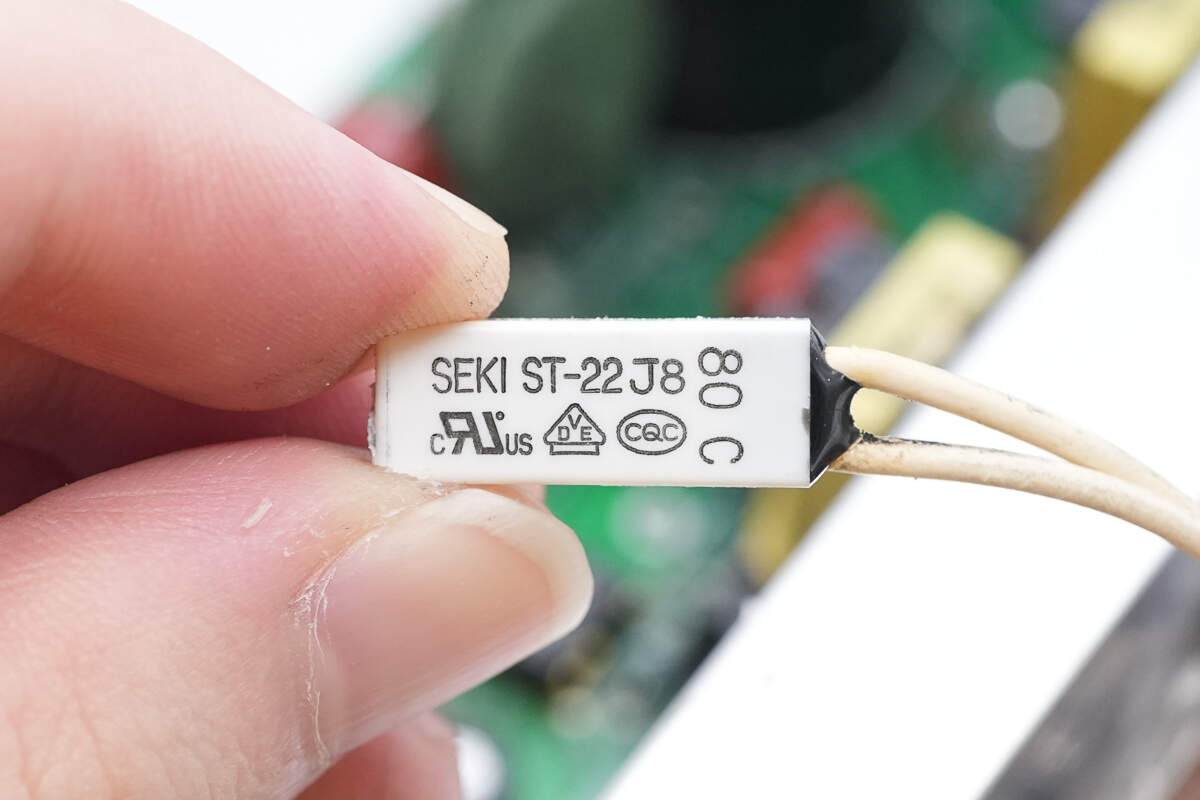

The temperature switch is secured to the rectifier's heatsink with a screw and a metal plate.

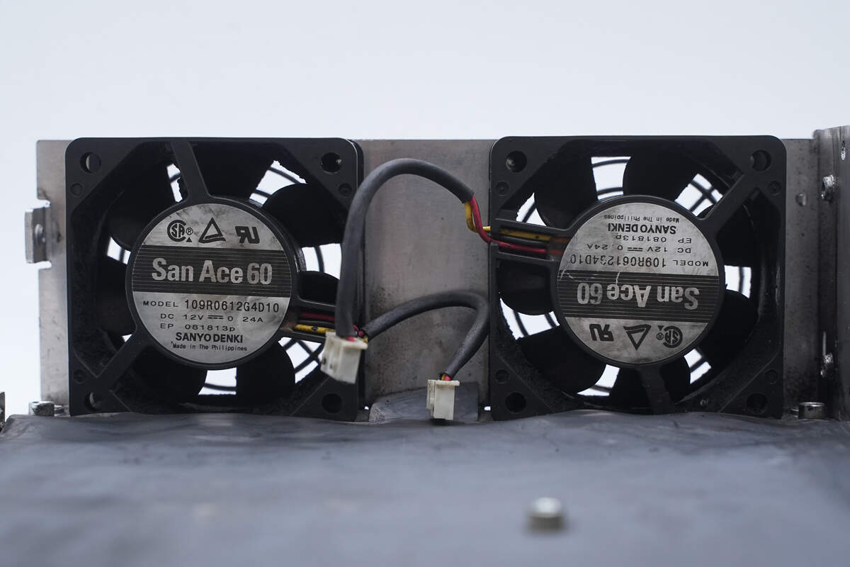

The two cooling fans are connected via connectors.

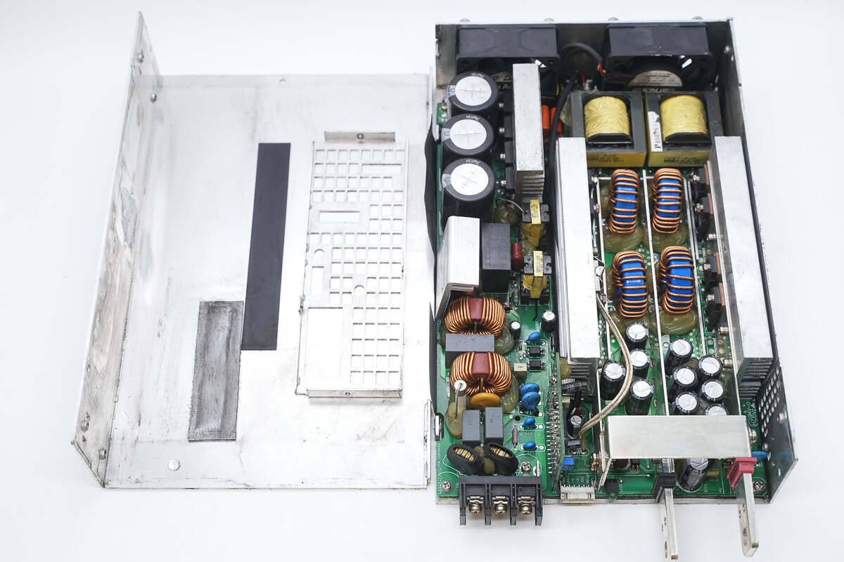

Remove the PCBA module. The interior of the casing is insulated with Mylar sheets.
The two cooling fans are from SANYO DENKI, part of the San Ace 60 series, with a specification of 12V 0.24A.
The upper left corner of the PCBA module's front face houses the AC input, along with wiring terminals, filter inductors, safety X2 capacitors, fuses, varistors, and common mode chokes. The center section contains the bridge rectifier, relay, and thermistor. The right side is equipped with high-voltage filter capacitors and primary MOSFETs.
Below the MOSFETs are the transformers. On the left side are the rectifier diodes and heatsinks. The center contains filter inductors, filter capacitors, and on the left side, the DC output terminal posts. A control PCB is located between the AC input terminal and the DC output terminal posts.

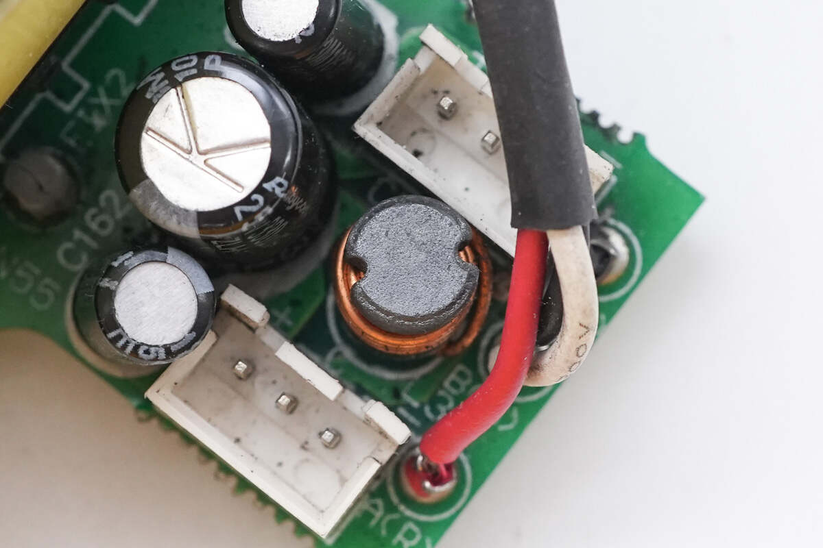

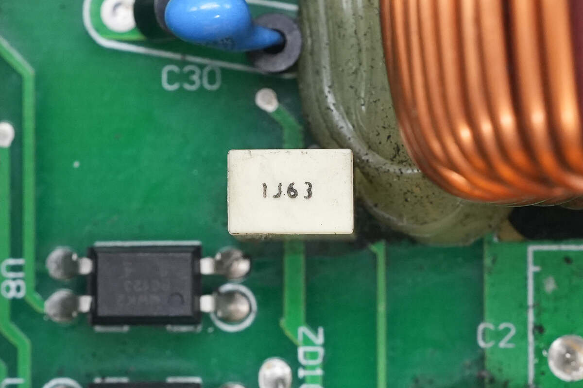

The filter inductors are wound with magnetic cores and insulated with heat-shrink tubing.

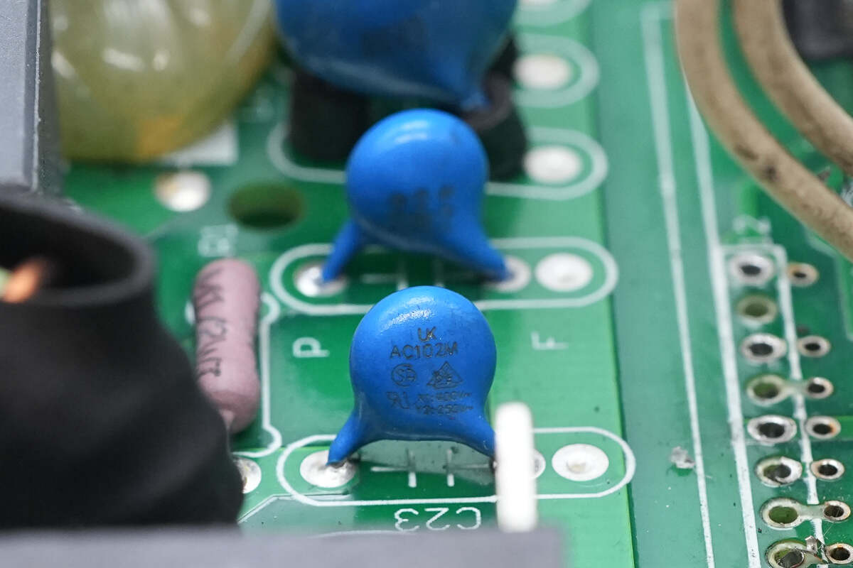

Close-up of the blue Y capacitors.

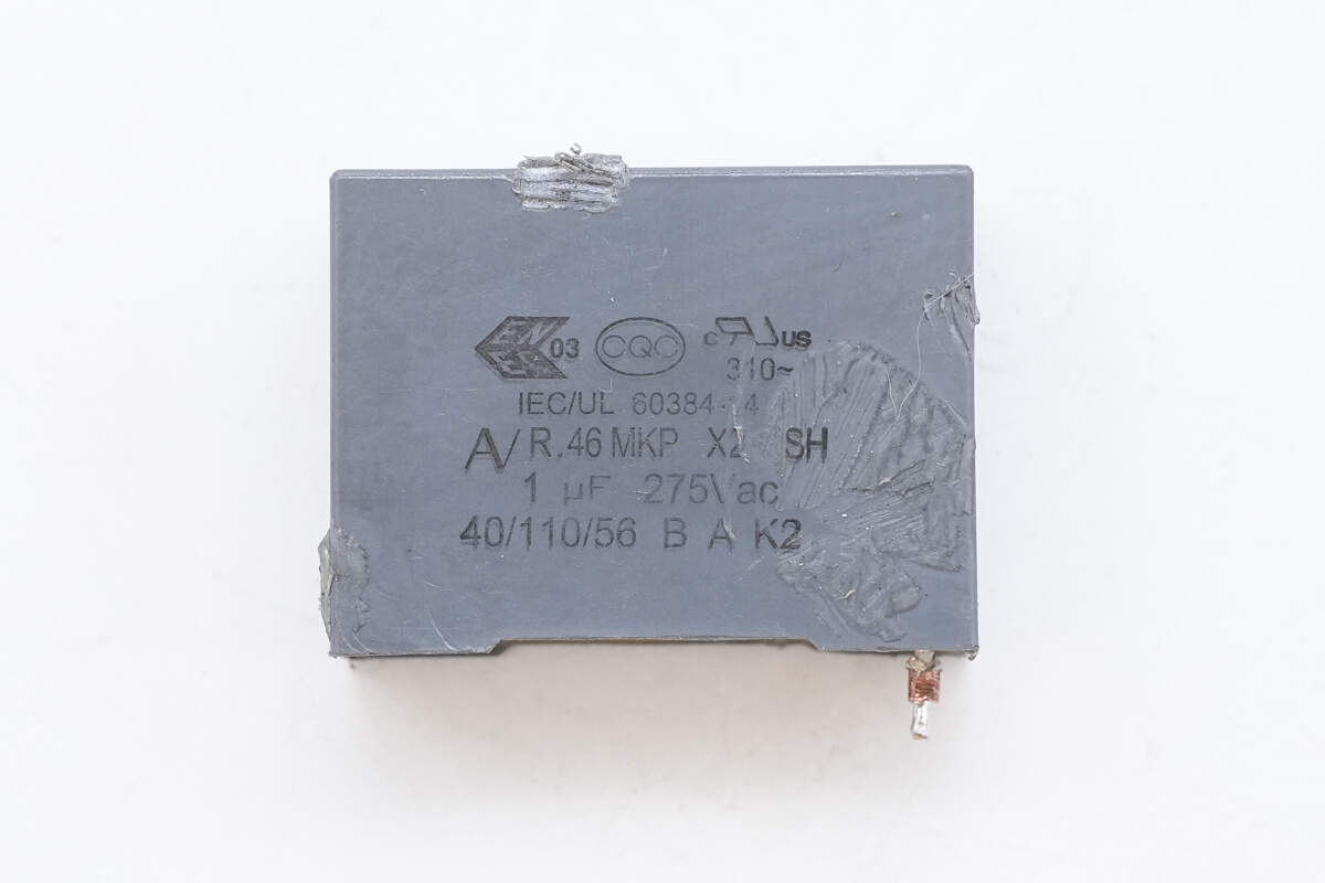

The safety X2 capacitors are rated at 1μF.

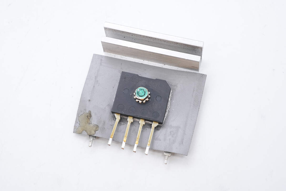

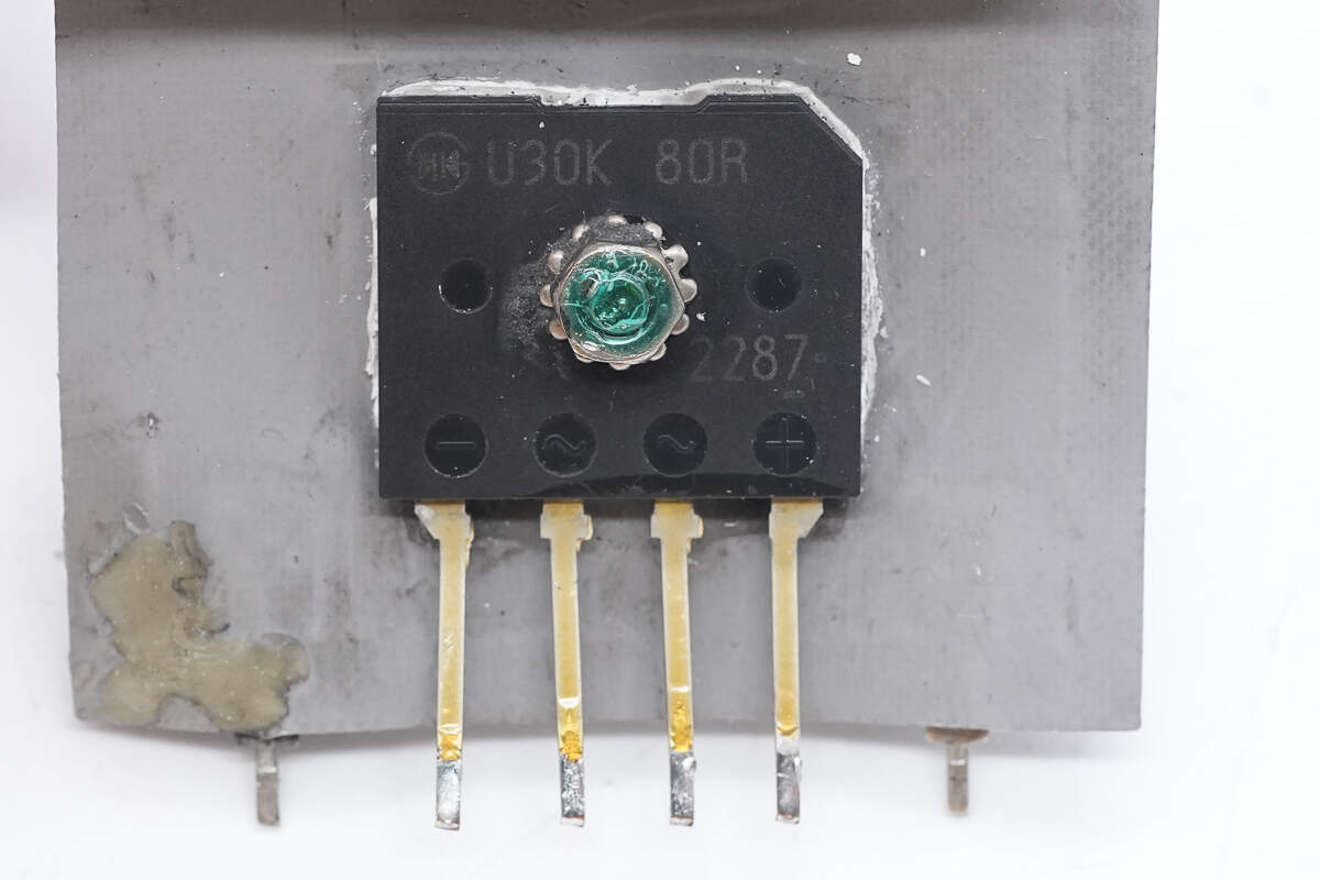

The bridge rectifier is secured to the heatsink with a screw.
The bridge rectifier is from Shindengen, model U30K80R, with a rating of 30A 800V, and is packaged in a D6K form factor.

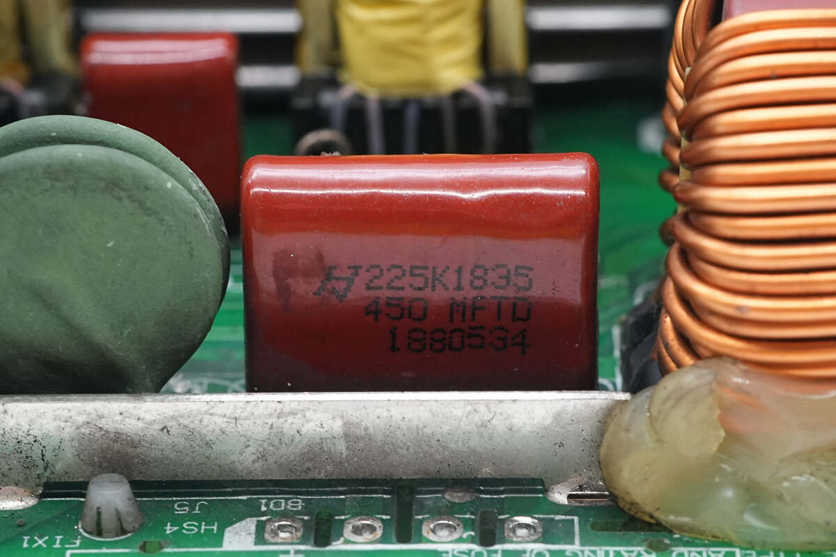

The film capacitor is from HJC, with a specification of 2.2μF 450V.

The Thinking SCK20160 thermistor is used to suppress inrush current during power-up.

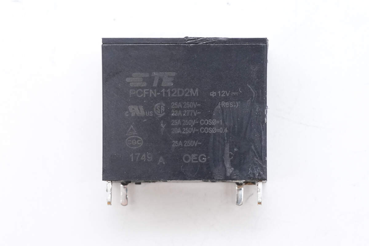

The relay is from TE, model PCFN-112D2M, with a contact rating of 25A 250V and a coil voltage of 12V.

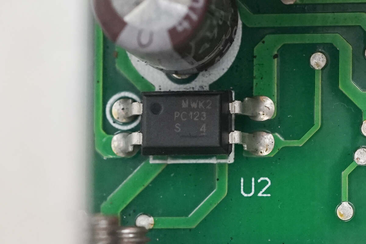

The front of the control PCB features a potentiometer, a PWM controller, and an isolation optocoupler.

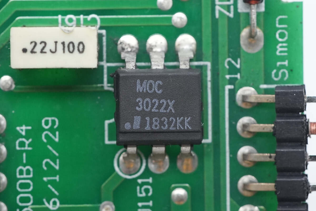

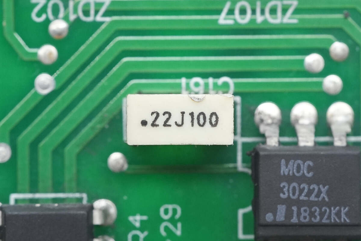

The isolation optocoupler is marked with MOC3022X.

The film capacitor is rated at 0.22μF 100V.

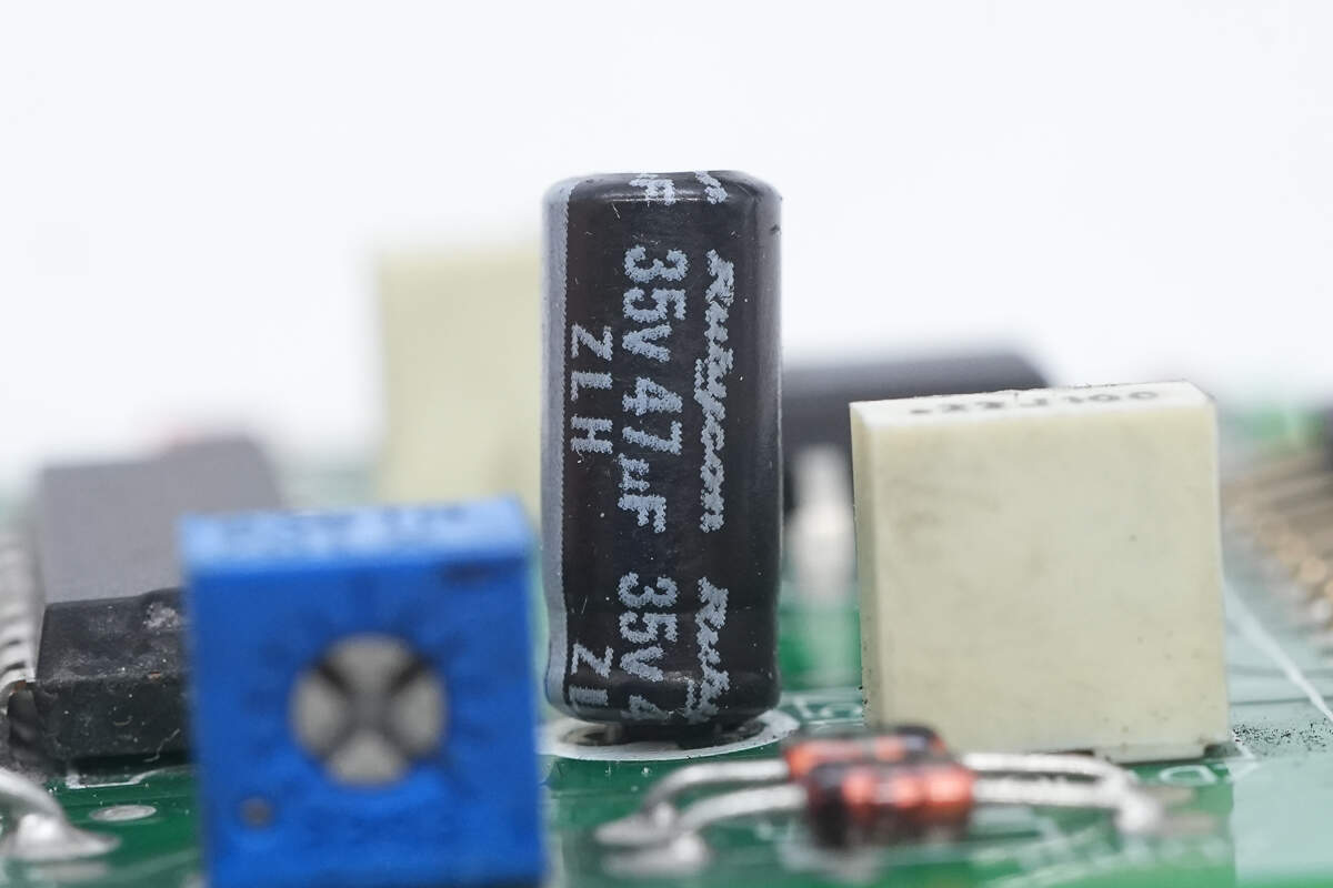

Close-up of the potentiometer for adjusting the output voltage.

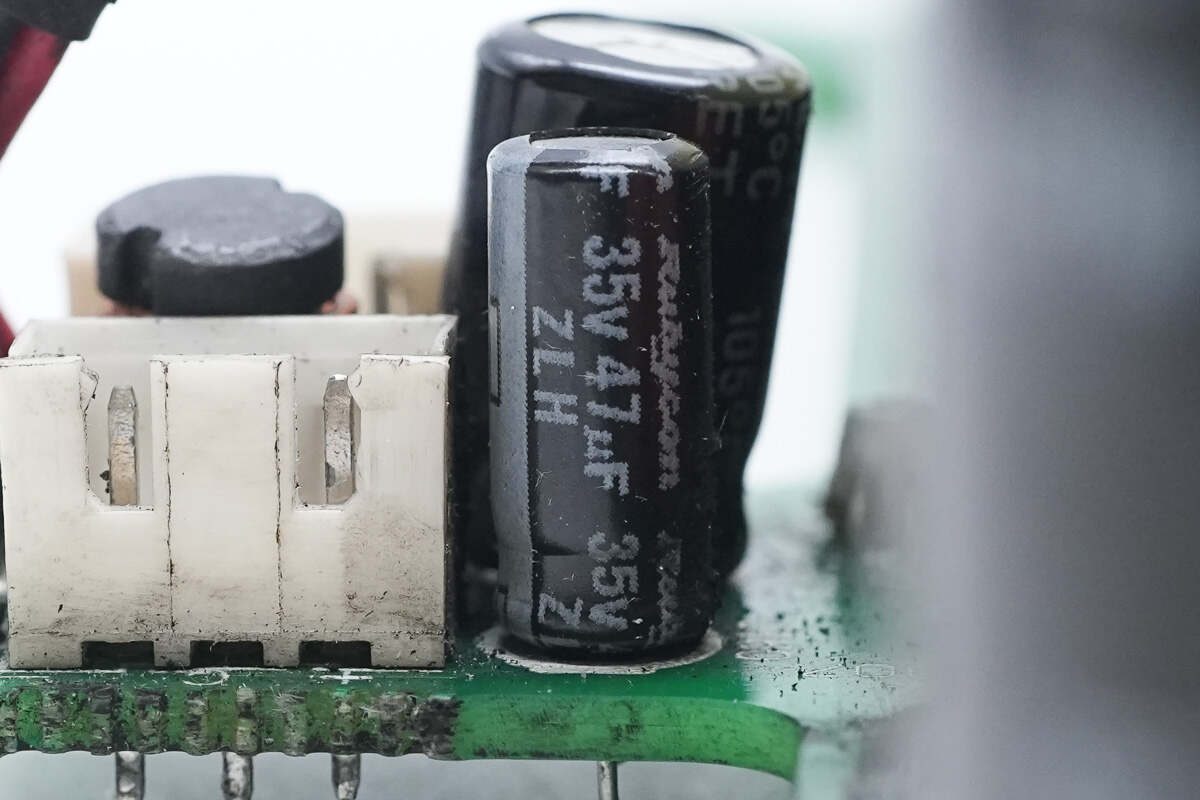

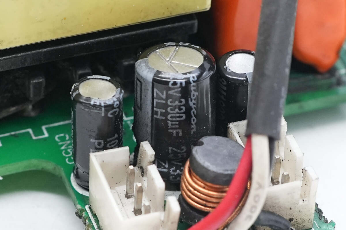

The power supply filter capacitor is from Rubycon, with a specification of 35V 47μF.
The other filter capacitor has the same specification.

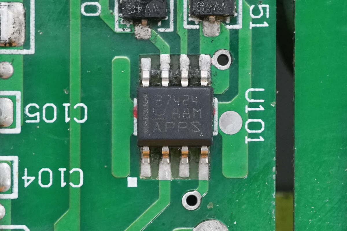

The driver chip is from Texas Instruments, model UCC27424. It is a dual-channel gate driver with a 4A output current, used to drive the isolation transformer, and is packaged in an SOIC8 form factor.

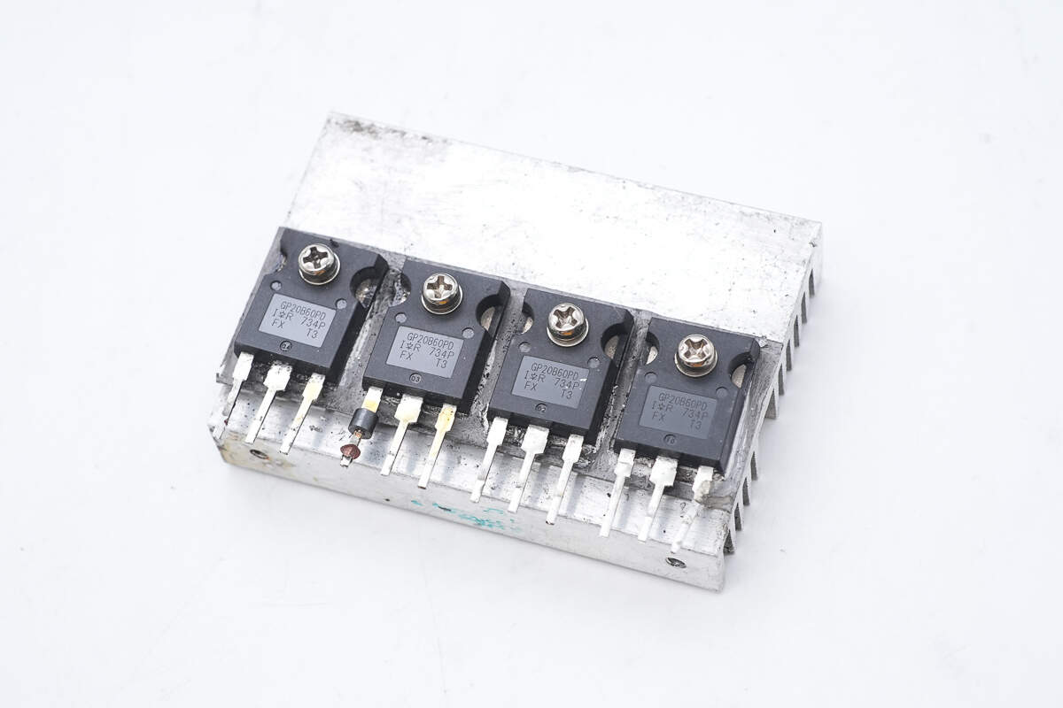

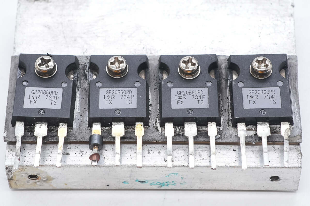

The primary MOSFETs are secured to the heatsink with screws.
The MOSFETs are from Infineon, model IRGP20B60PD. They are IGBTs with a rating of 600V 20A, packaged in TO-247AC form, supporting a switching frequency of 150kHz. These are suitable for PFC and ZVS switch-mode power supply applications.

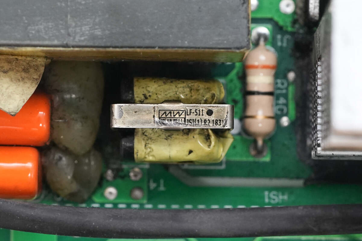

The current transformer is used to detect the primary current.

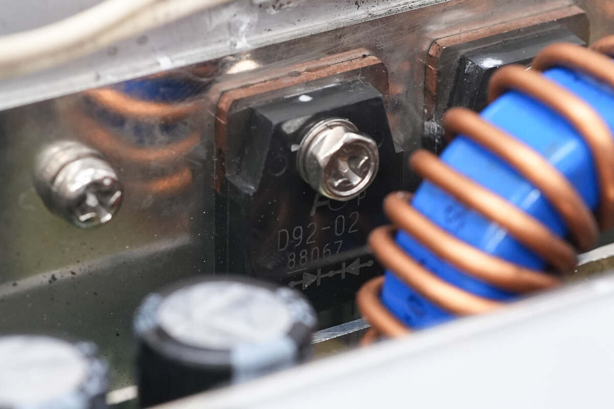

The rectifiers are from Fuji Electric, model ESAD92-02R. They are rated at 200V 20A and are packaged in a TO-3P form factor.

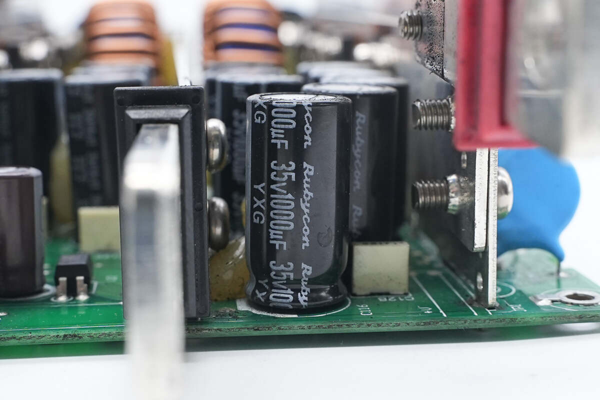

The output side is equipped with 12 electrolytic capacitors.

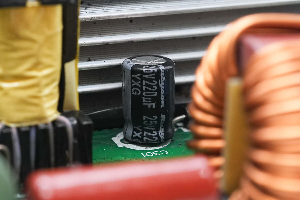

The capacitors are from Rubycon, part of the YXG low-ESR electrolytic capacitor series, with a specification of 35V 1000μF.

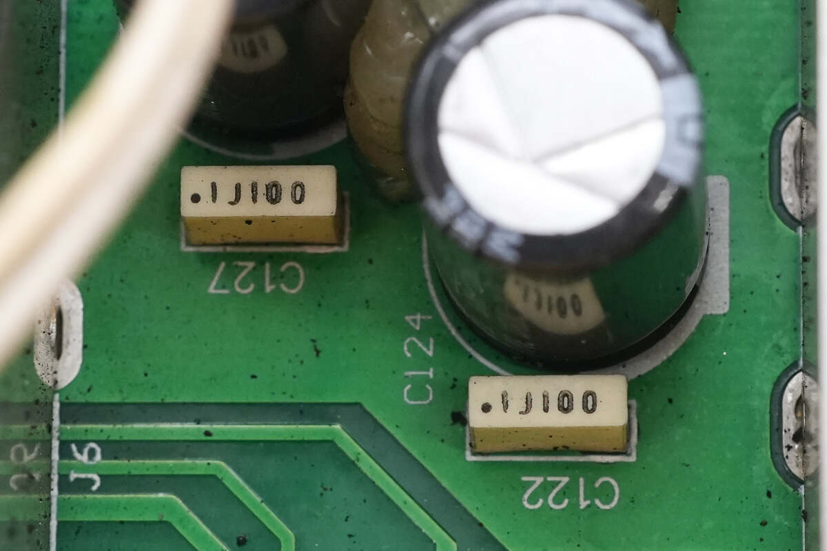

The electrolytic capacitors are parallel to 0.1μF 100V film capacitors for filtering.

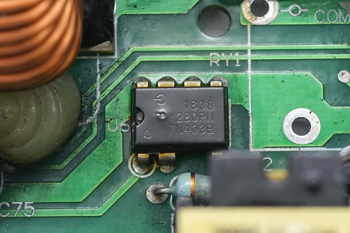

The auxiliary power chip is from PI, model TNY280PN. It is part of the TinySwitch-3 series, with an integrated MOSFET, and is packaged in a DIP-8C form factor.
The film capacitor is rated at 0.47μF 450V.

The thermal protector is from SEKI, model ST22, with a triggering temperature of 80°C. It is used for temperature protection of the rectifiers.

Close-up of the PC123 feedback optocoupler.

The filter capacitor is rated at 25V 330μF.

The filter capacitor is rated at 35V 47μF.
