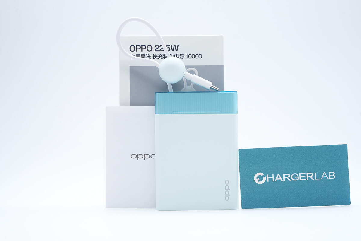

The package includes the power bank and some documents.

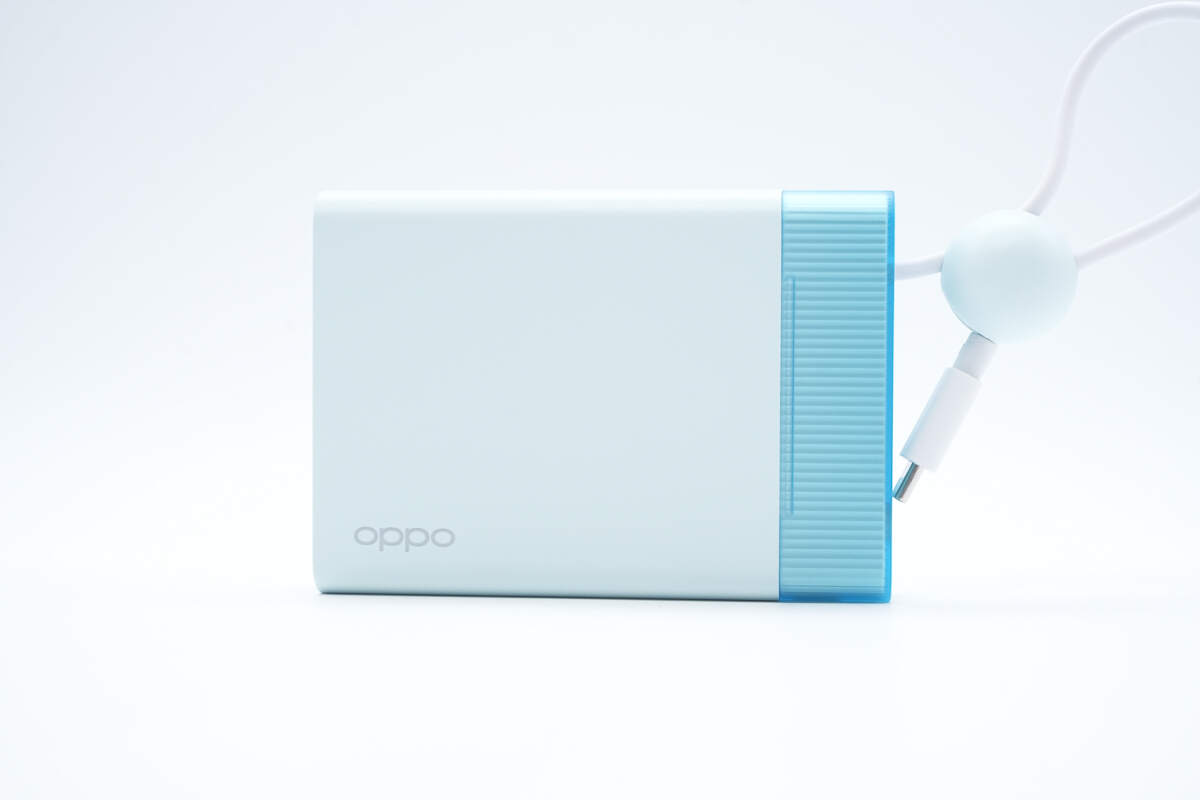

Teardown of OPPO 10000mAh 22.5W Energy Jelly Power Bank (PBSV00)-Chargerlab

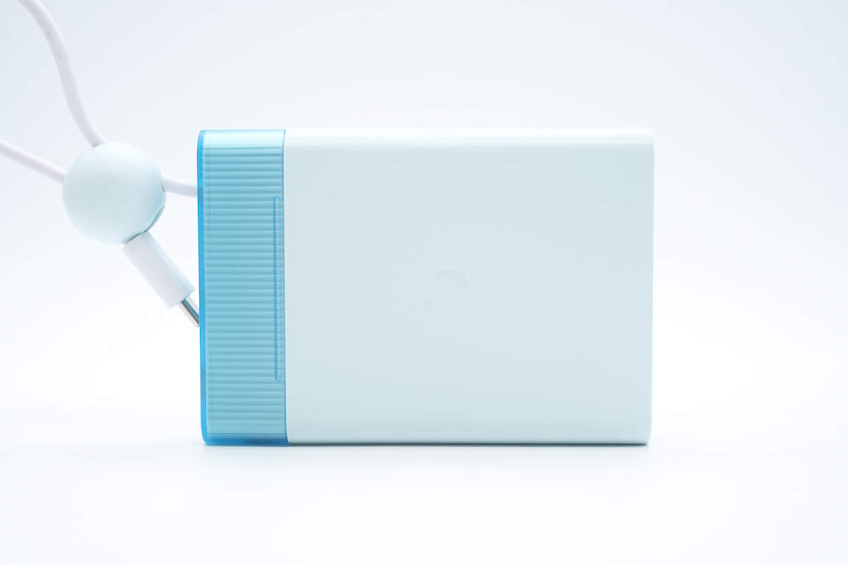

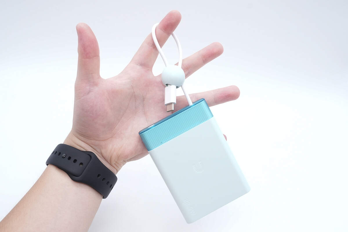

The power bank comes in blue and features a compact, slim design.
It includes a built-in USB-C cable with a storage ball for easy winding, eliminating the need to carry an extra cable during daily outings.
The built-in cable can also be used as a carrying strap.

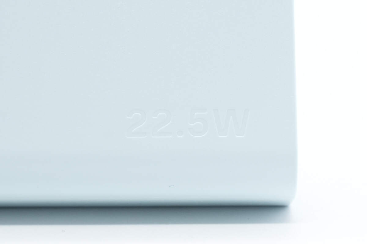

The corner of the device is marked with "22.5W."

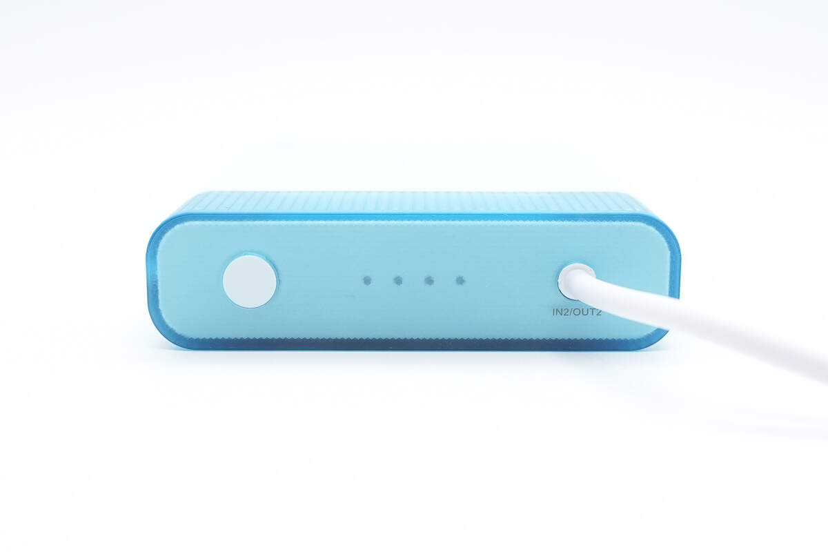

The top is equipped with a power button and battery indicator lights.
There are four indicator lights in total, with each light representing 25% of the battery capacity.

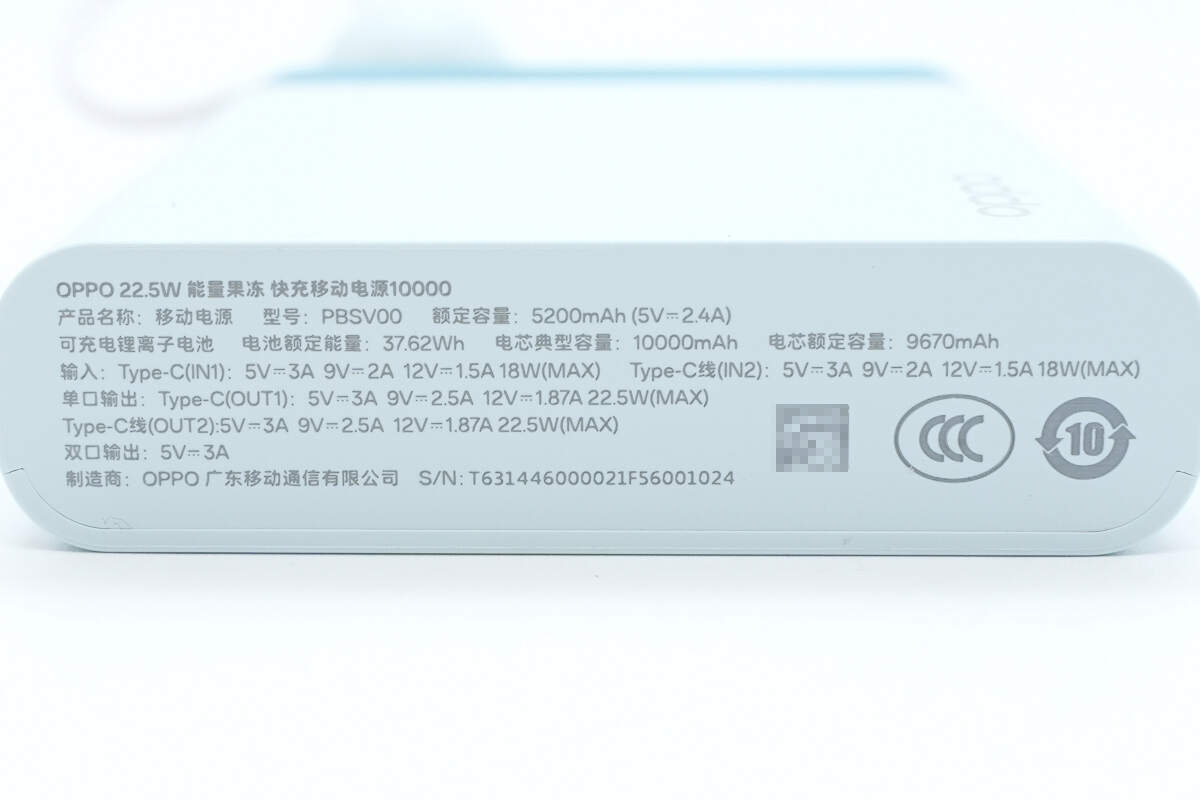

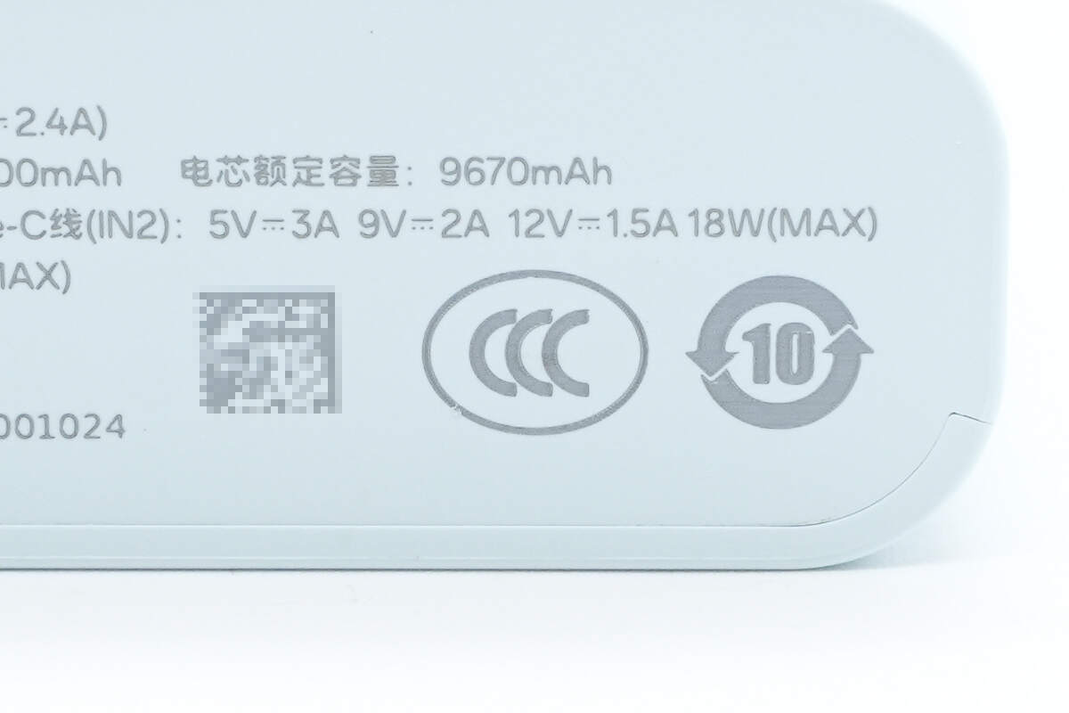

The bottom of the casing is printed with the product specifications.
Model: PBSV00
Rated Capacity: 5200mAh (5V 2.4A)
Battery Type: Rechargeable Lithium-ion Battery
Rated Energy: 37.62Wh
Typical Cell Capacity: 10000mAh
Rated Cell Capacity: 9670mAh
Input:
Type-C (IN1): 5V 3A, 9V 2A, 12V 1.5A, 18W MAX
Type-C (IN2): 5V 3A, 9V 2A, 12V 1.5A, 18W MAX
Single Port Output:
Type-C (OUT1): 5V 3A, 9V 2.5A, 12V 1.87A, 22.5W MAX
Type-C Cable (OUT2): 5V 3A, 9V 2.5A, 12V 1.87A, 22.5W MAX
Dual Port Output: 5V 3A

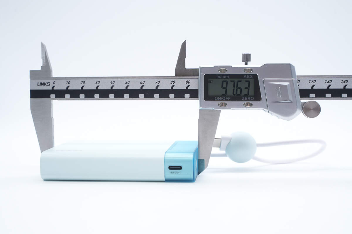

The length of the power bank is about 97.63 mm (3.84 inches).

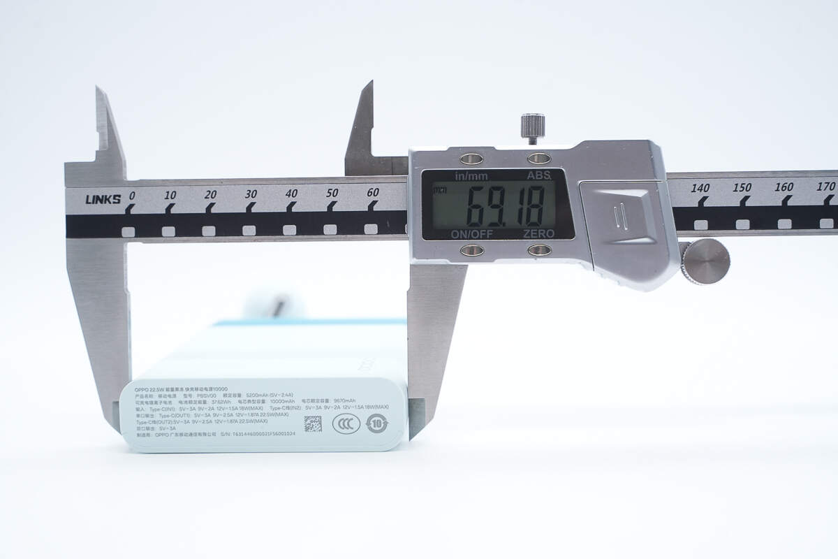

The width is about 69.18 mm (2.72 inches).

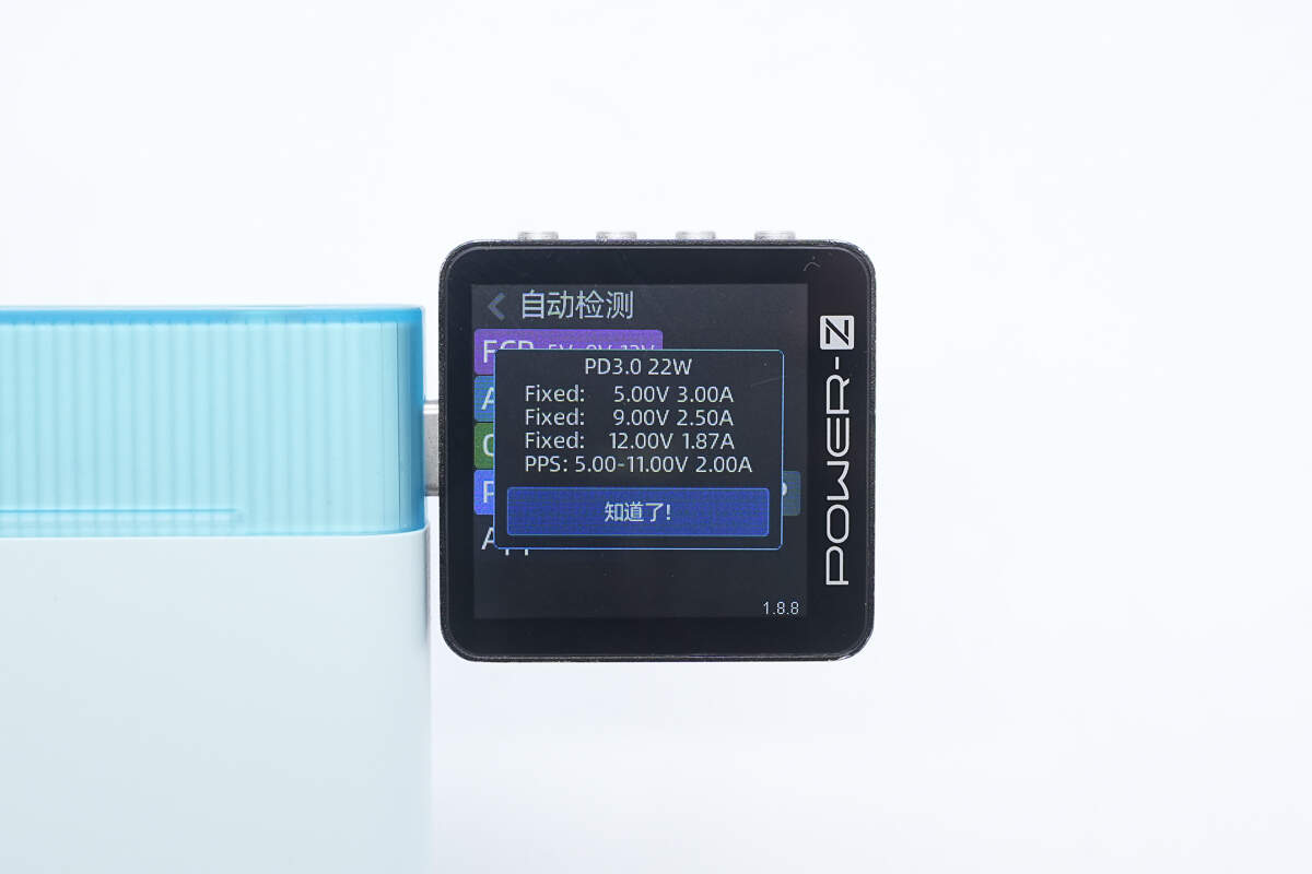

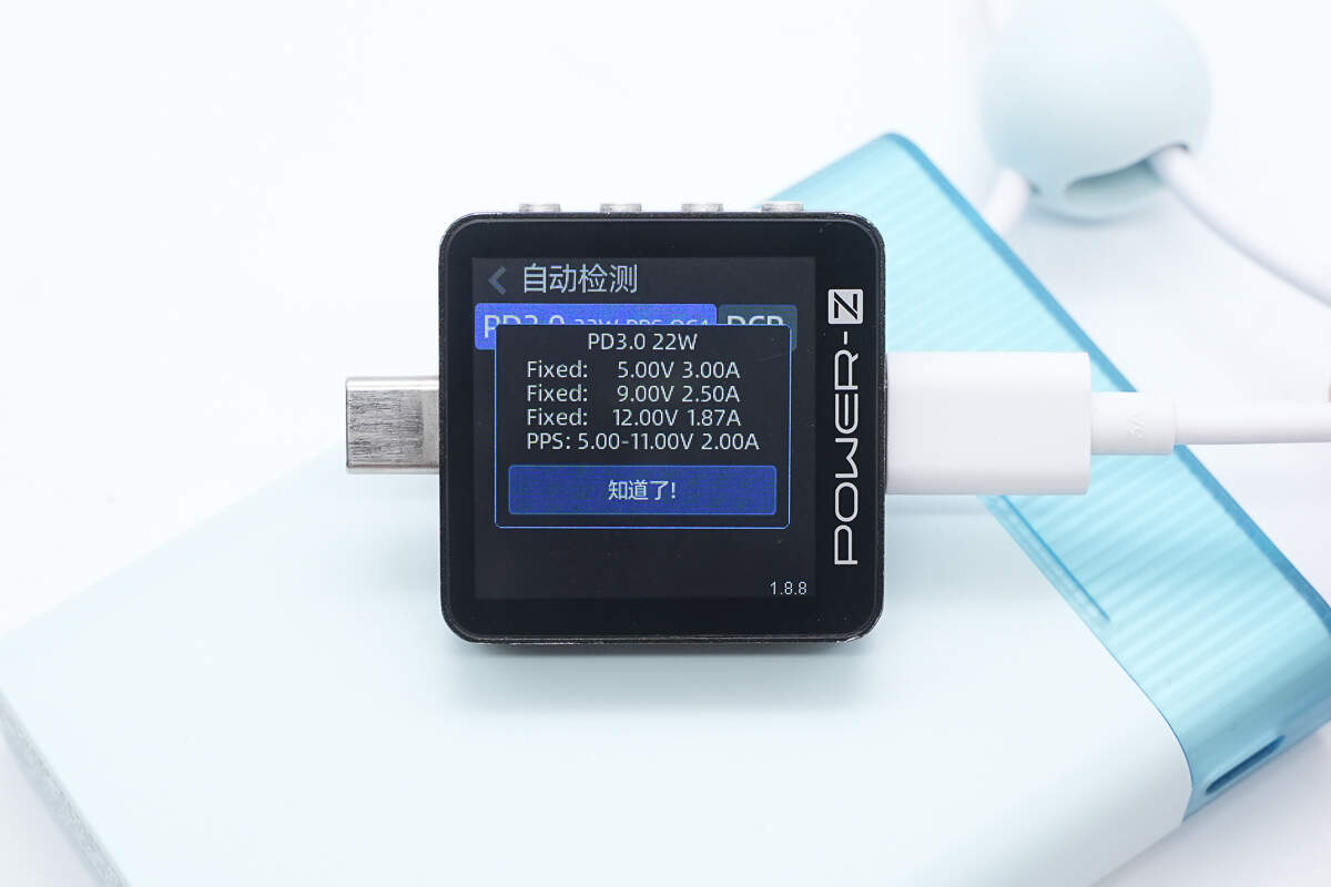

ChargerLAB POWER-Z KM003C shows that the USB-C port supports FCP, AFC, QC3.0/4+, PD3.0, PPS, DCP, and Apple 2.4charging protocols.
And it has three fixed PDOs of 5V3A, 9V2.5A, and 12V1.87A. It has one set of PPS, which is 5-11V2A.
The USB-C cable supports PD3.0, PPS, QC4+, and DCP charging protocols.
The PDO message display matches that of the USB-C port.

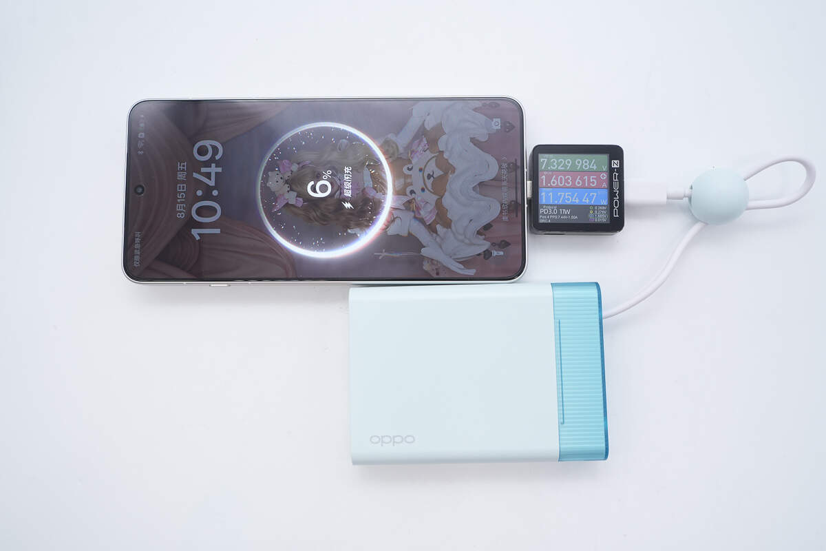

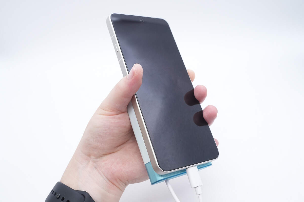

Using the built-in USB-C cable to charge the OPPO Find X8 Ultra successfully activates OPPO SuperVOOC fast charging.

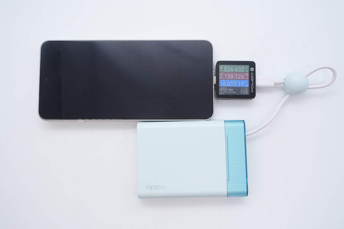

When the charging power stabilizes, it reaches about 16W.

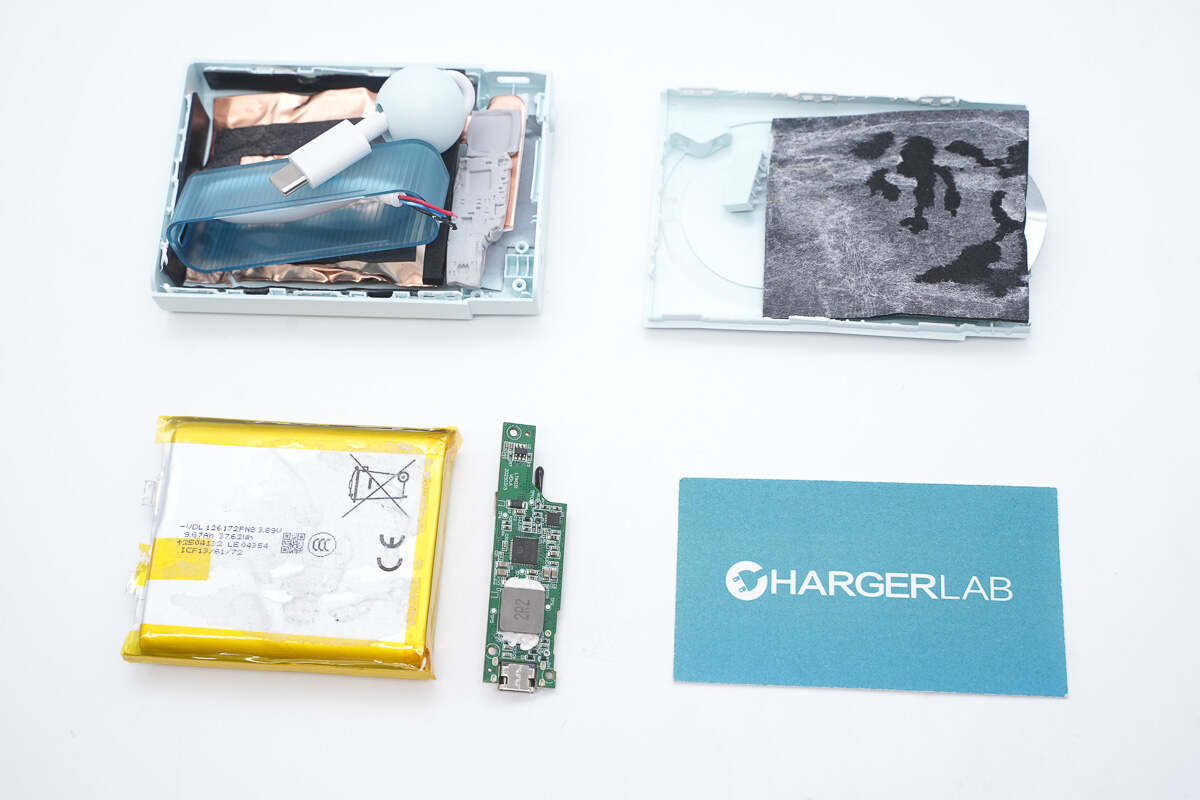

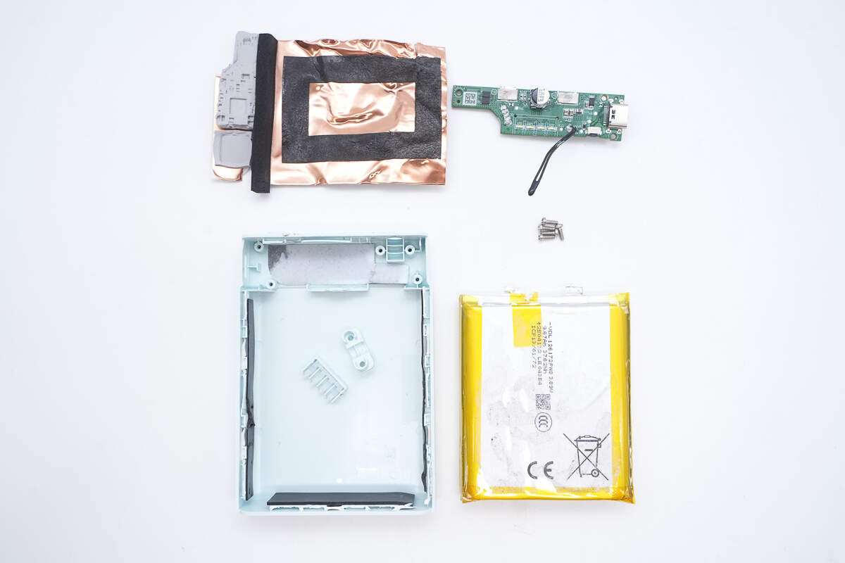

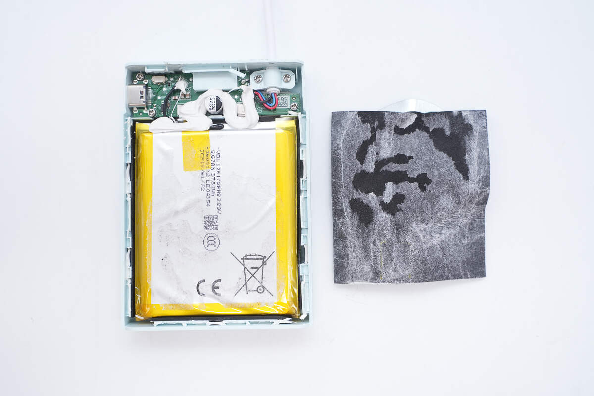

Upon disassembly, the outer shell is found to be secured with snap-fit clips.

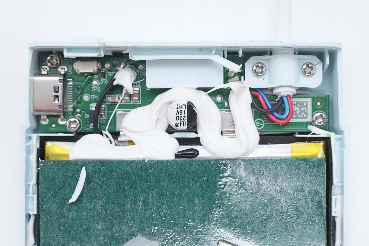

The PCBA and built-in USB-C cable are secured with screws. Components such as the thermistor and capacitors are reinforced with adhesive. The battery cells are connected to the PCBA via spot-welded nickel strips.

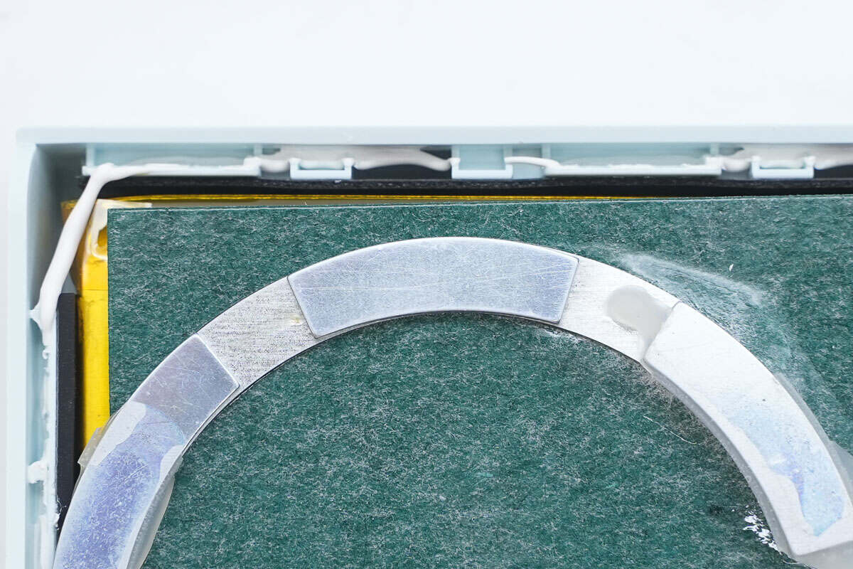

The magnet is placed on top of the battery cell, with insulating fish paper positioned in between for safety.
Cushioning foam is placed between the battery cell and the outer casing for shock absorption. The magnetic ring is secured in place with adhesive.
The fish paper is attached to the battery cell using double-sided adhesive.

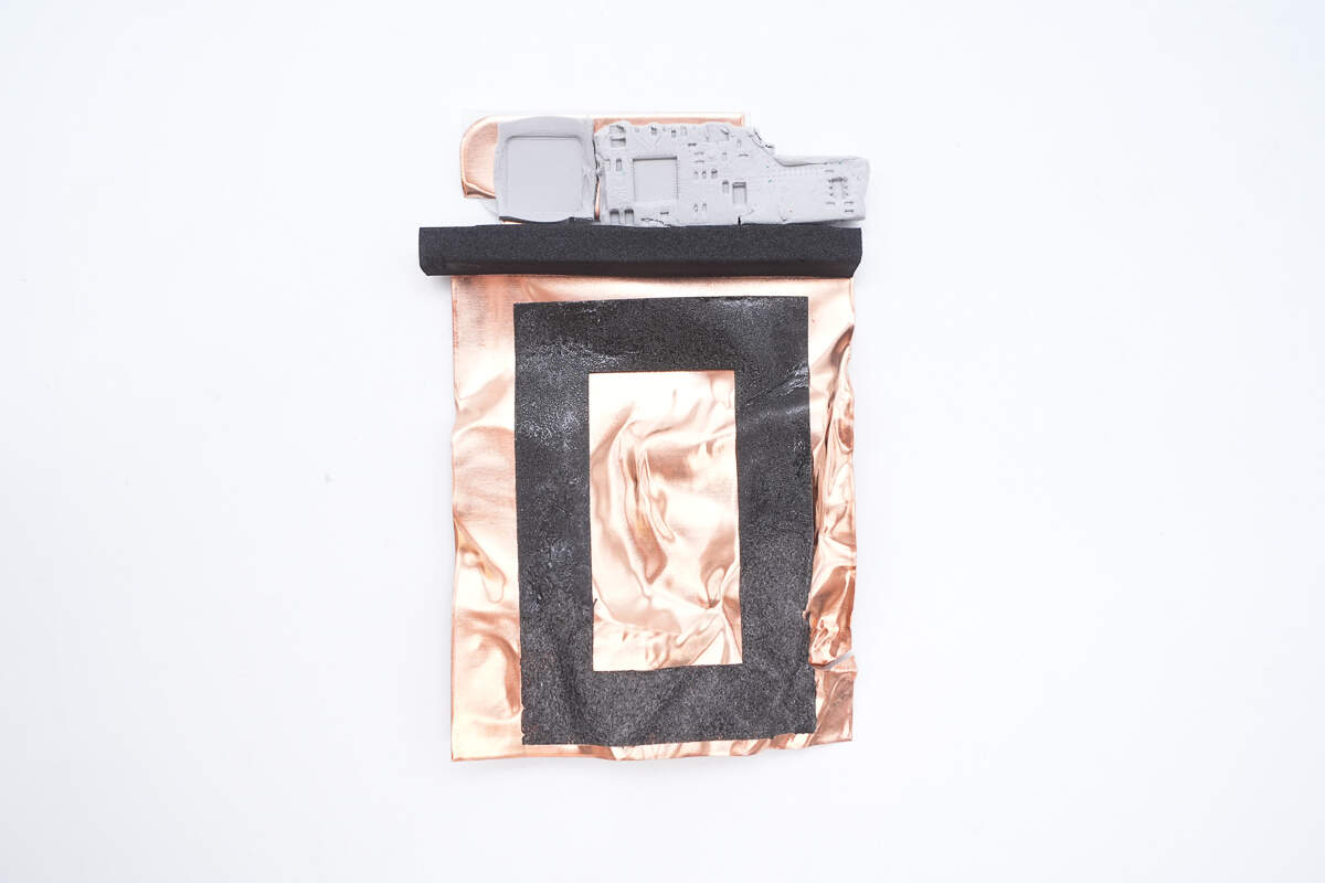

After removing the battery cell and PCBA, there is a layer of heat-dissipating copper foil and a thermal pad underneath.
The heat-dissipating copper foil is attached with double-sided tape and foam padding.
Insulating tape is applied around the perimeter of the battery cell.

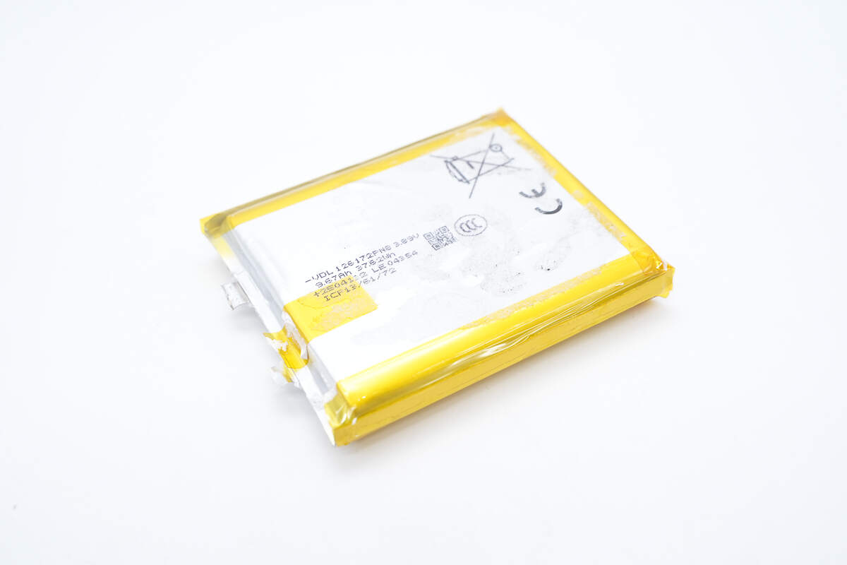

The battery cell is from VDL, model 126172PN8, with a nominal voltage of 3.89V, rated capacity of 9.67Ah, and energy of 37.62Wh. It has passed the CCC certification.

After removing the white adhesive from the front of the PCB, the following components are visible: battery protection MOSFETs, an electrolytic capacitor, a thermistor, LED indicator lights, a power button, and a USB-C socket.
The back side features a master control chip and a battery protection chip.

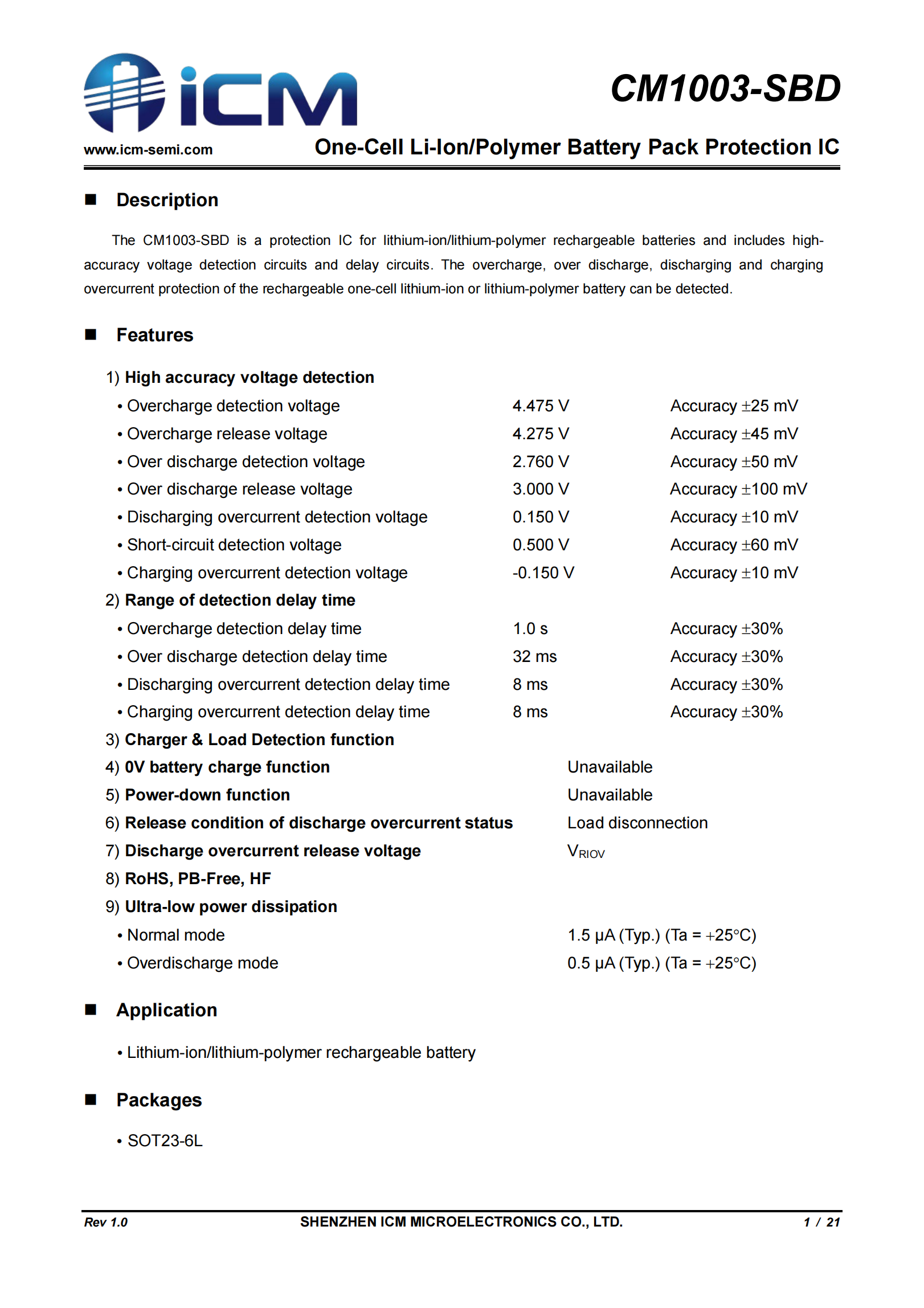

The battery protection chip is from iCM, marked with 1003SBD. The model is CM1003-SBD. It is a single-cell lithium battery protection chip that supports high-voltage lithium battery applications. The overcharge protection voltage is 4.475V with a precision of 20mV. The overdischarge protection voltage is 2.76V with a precision of 50mV. It uses an SOT23-6 package.
Here is the information about iCM CM1003-SBD.

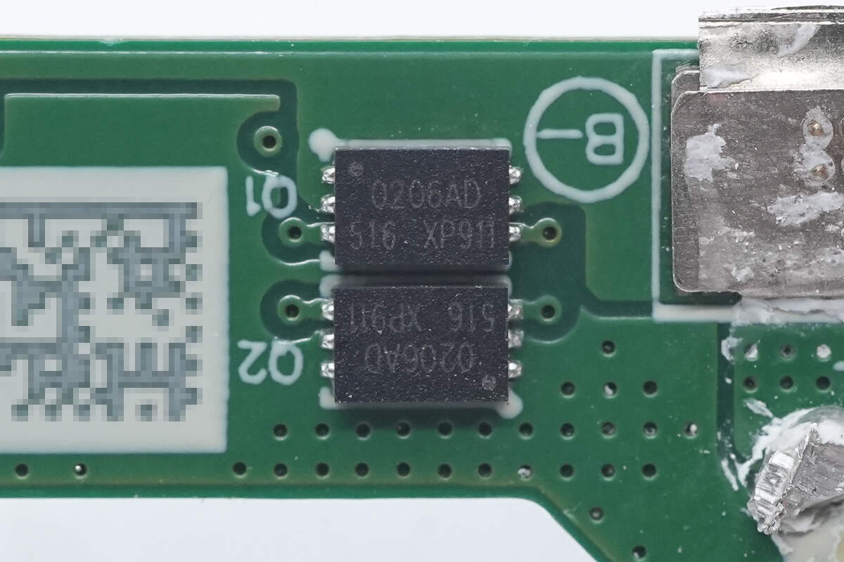

Two battery protection MOSFETs are from CRM, marked with 0206AD. The model is CRMVATU0206AD. These are dual N-channel MOSFETs with a voltage rating of 20V and an on-resistance of 6.7mΩ. They use a DFN2x3-6L-D package.

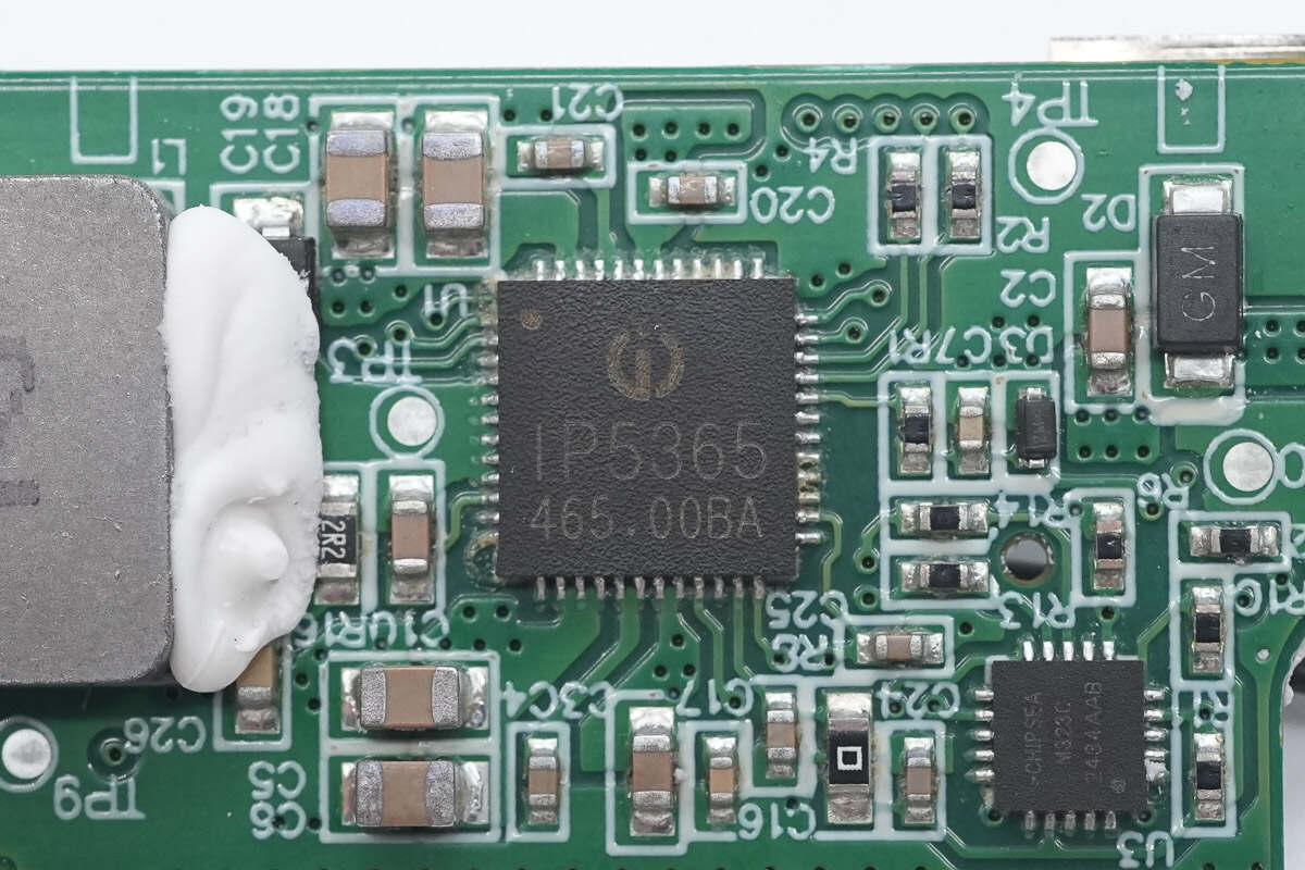

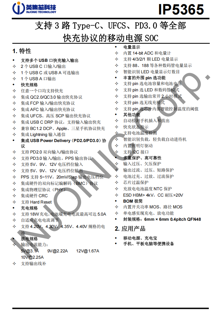

The SoC is from Injoinic, model IP5365. It features two USB-C ports that support both input and output, one USB-C or USB-A output port, and one additional USB-A output port, supporting a total of three USB output ports. Each port supports fast charging. It supports PD 3.0, PPS charging, and UFCS protocols, as well as AFC, FCP, SCP, and QC 2.0/3.0 protocols. Additionally, it integrates Lightning input communication.
IP5365 supports 18W fast charging. The battery charging current can reach up to 5A and supports battery voltages of 4.2V, 4.3V, 4.35V, and 4.4V. It has built-in switching power MOSFETs and path MOSFETs, and integrates a 14-bit ADC. It supports 1 to 4 LED lights for battery level indication, as well as 88 or 188 digital tube displays. It supports automatic power on and off. It integrates input overvoltage and undervoltage protection, output overcurrent, overvoltage, and short-circuit protection, battery overcharge, overdischarge, and overcurrent protection. The chip has built-in overheat protection and supports an external NTC for battery temperature protection.

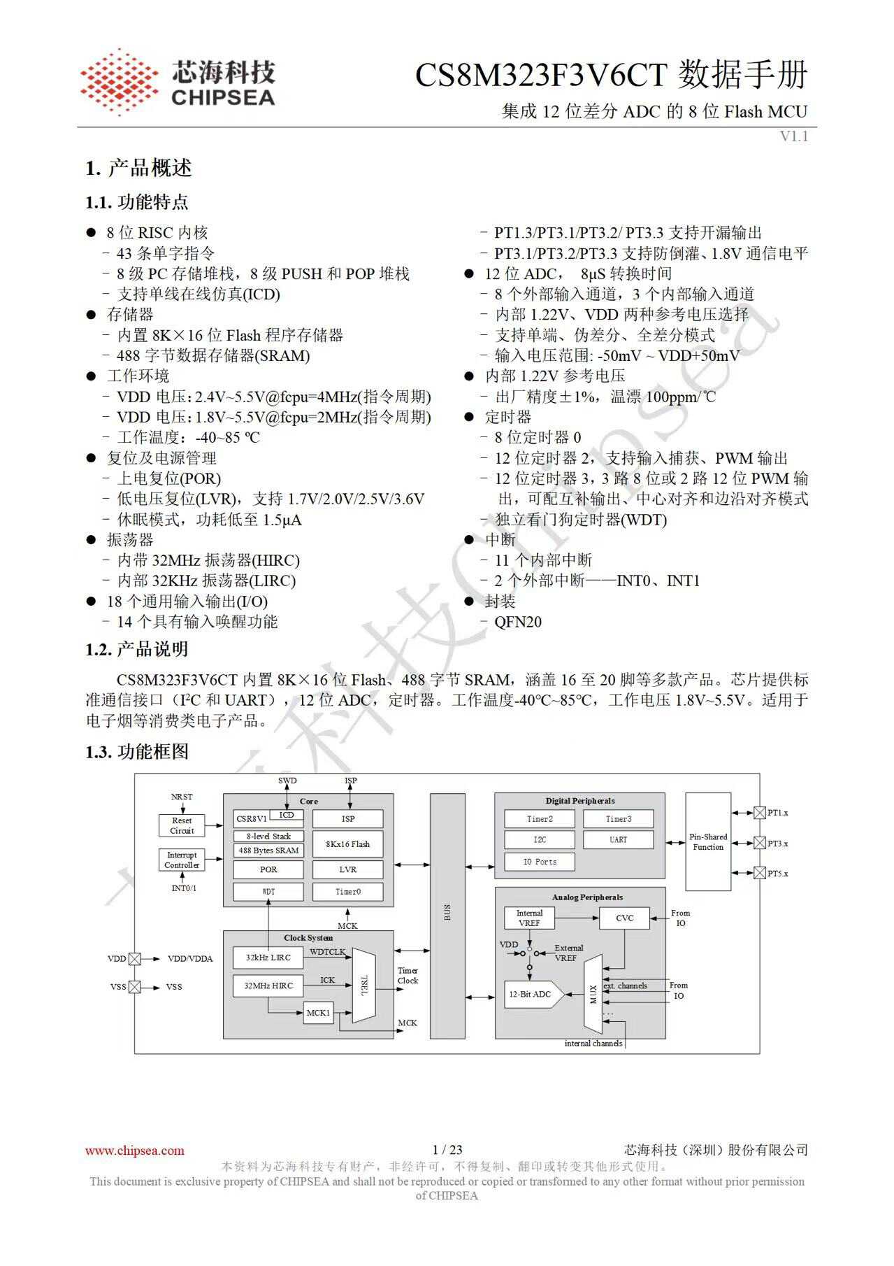

The MCU used for overall device management is from Chipsea, part of the CS8M32X series. It features 8K × 16-bit Flash memory and 488 bytes of SRAM, with multiple variants offering 16 to 20 pins. The MCU provides standard communication interfaces, including I²C and UART, as well as a 12-bit ADC and timers. It operates within a temperature range of -40°C to 85°C and a voltage range of 1.8V to 5.5V, making it suitable for consumer electronics such as e-cigarettes.
Here is the information about the CS8M32X series.

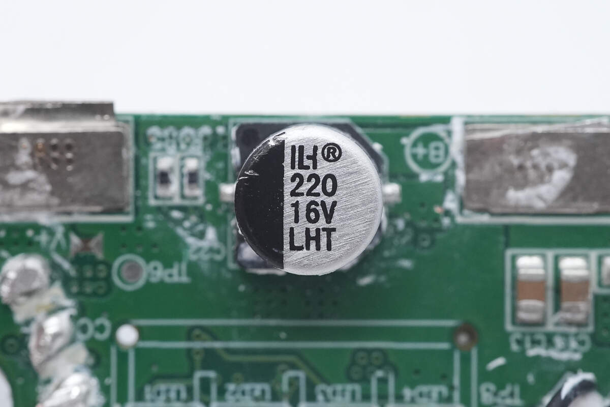

The electrolytic capacitor is from CHAOH. 16V 220μF.
