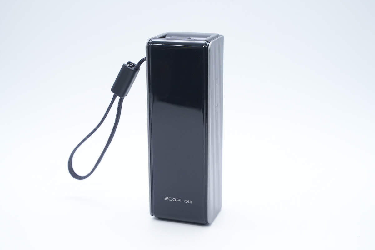

The design has a strong sense of style and modern aesthetics.
Teardown of EcoFlow RAPID 170W 25,000mAh Power Bank with Built-in Cable (EF-HB-001)-Chargerlab

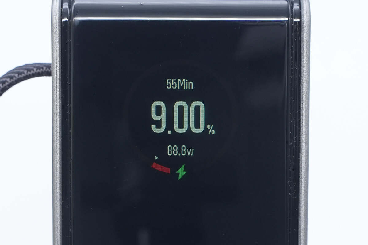

The display offers a rich interface with various functions, as shown in the image, and also supports fun animated icons.
The display shows the remaining battery level, input charging power, and estimated time to full charge. The input charging is indicated by a green lightning bolt icon.

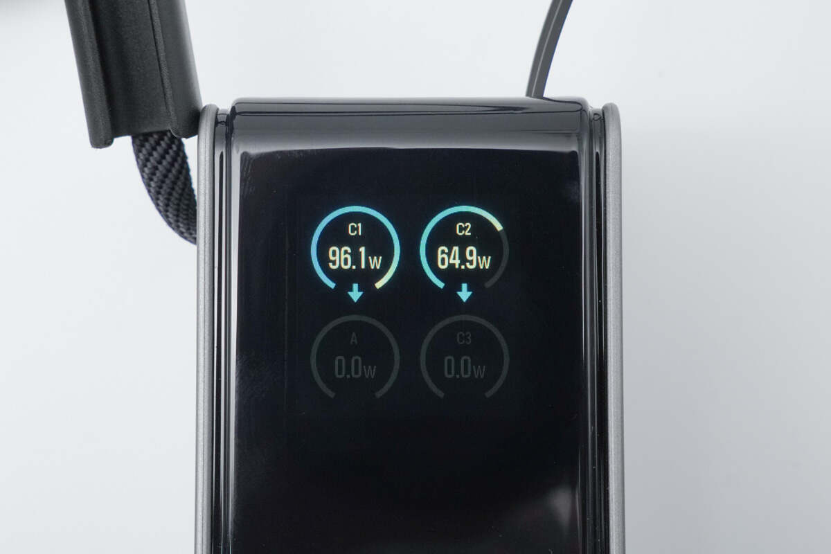

When outputting power, a blue downward arrow is shown, along with the total output power.
The status of each port, along with real-time input and output power, is also clearly displayed at a glance.

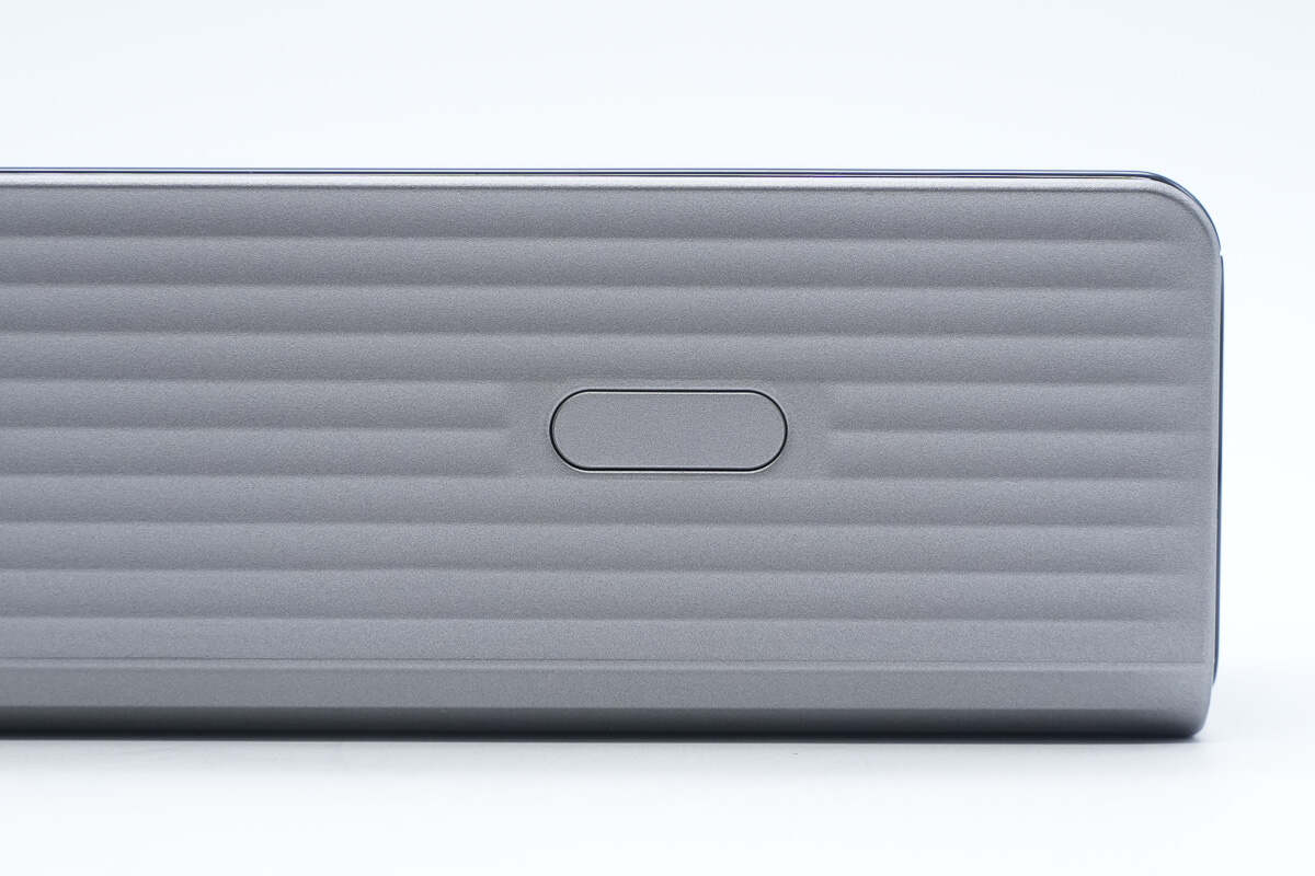

The power button is located on the side of the device.

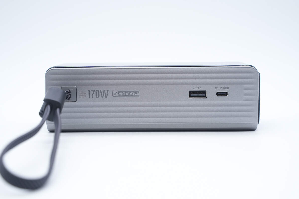

On the other side, there is one USB-A port, one USB-C port, and the USB-C2 lanyard cable. The casing is marked with “170W,” “25,000mAh / 90Wh,” and an airplane-approved symbol.

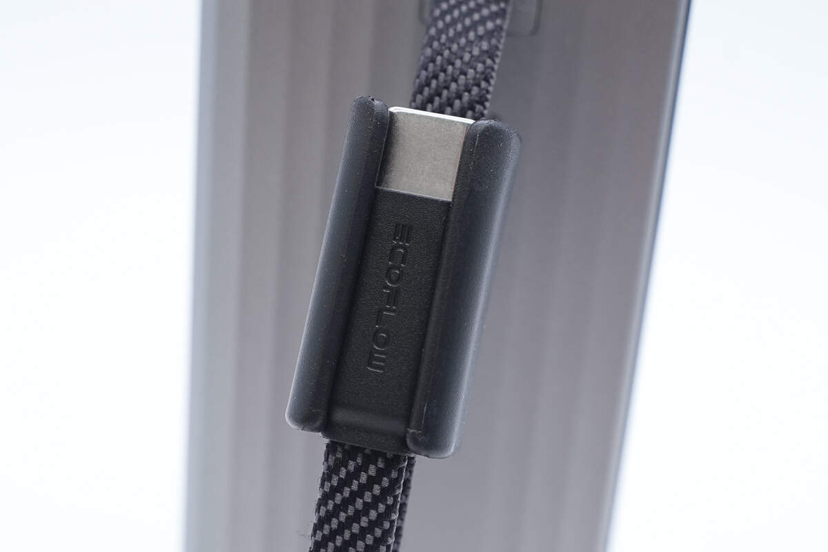

The USB-C2 lanyard cable features an integrated terminal storage and securing design, allowing it to be carried, hung, or used for charging conveniently.

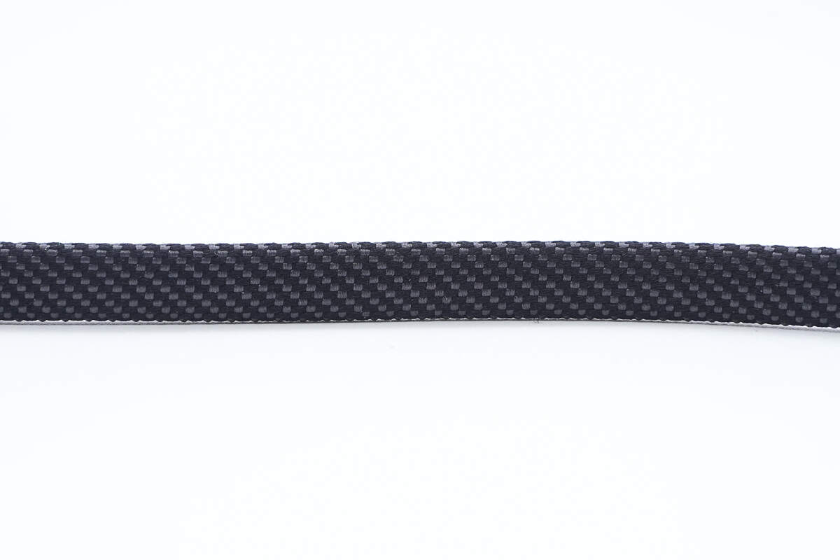

The cable is made of braided material.
The connector housing has a matte finish with the EcoFlow logo engraved on the front.

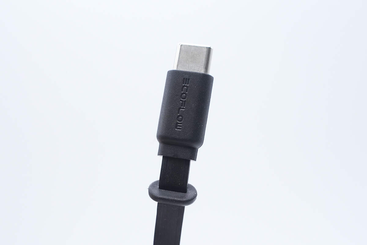

The top of the device features a retractable USB-C1 cable.
The retractable cable’s connector also has a matte finish with the EcoFlow logo engraved on it.

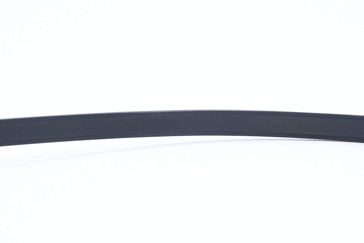

The retractable cable is flat and made of silicone material.

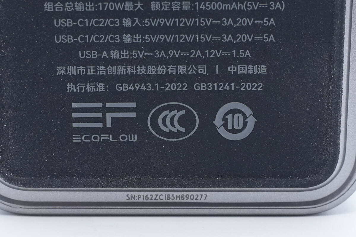

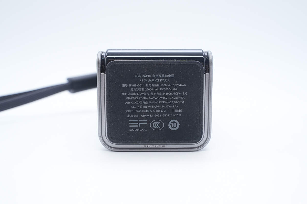

The bottom is equipped with an anti-slip pad and printed with specification information.
Model: EF-HB-001
Lithium Battery Energy: 5000mAh 18V / 90Wh
Total Cell Capacity: 25,000mAh (5 × 5000mAh)
Maximum Combined Output: 170W Max
Rated Capacity: 14,500mAh (5V 3A)
USB-C1/C2/C3 Input: 5V / 9V / 12V / 15V 3A, 20V 5A
USB-C1/C2/C3 Output: 5V / 9V / 12V / 15V 3A, 20V 5A
USB-A Output: 5V 3A, 9V 2A, 12V 1.5A

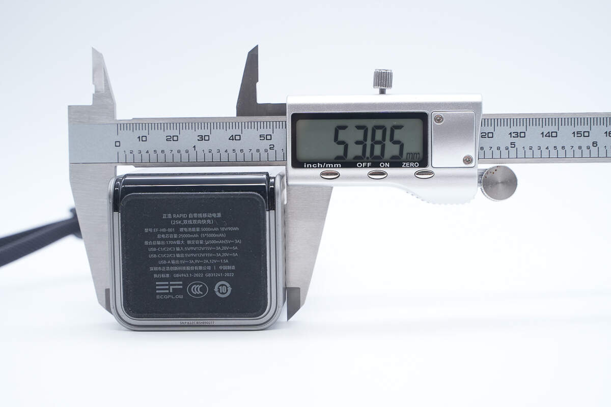

The width is about 53.85 mm (2.12 inches).

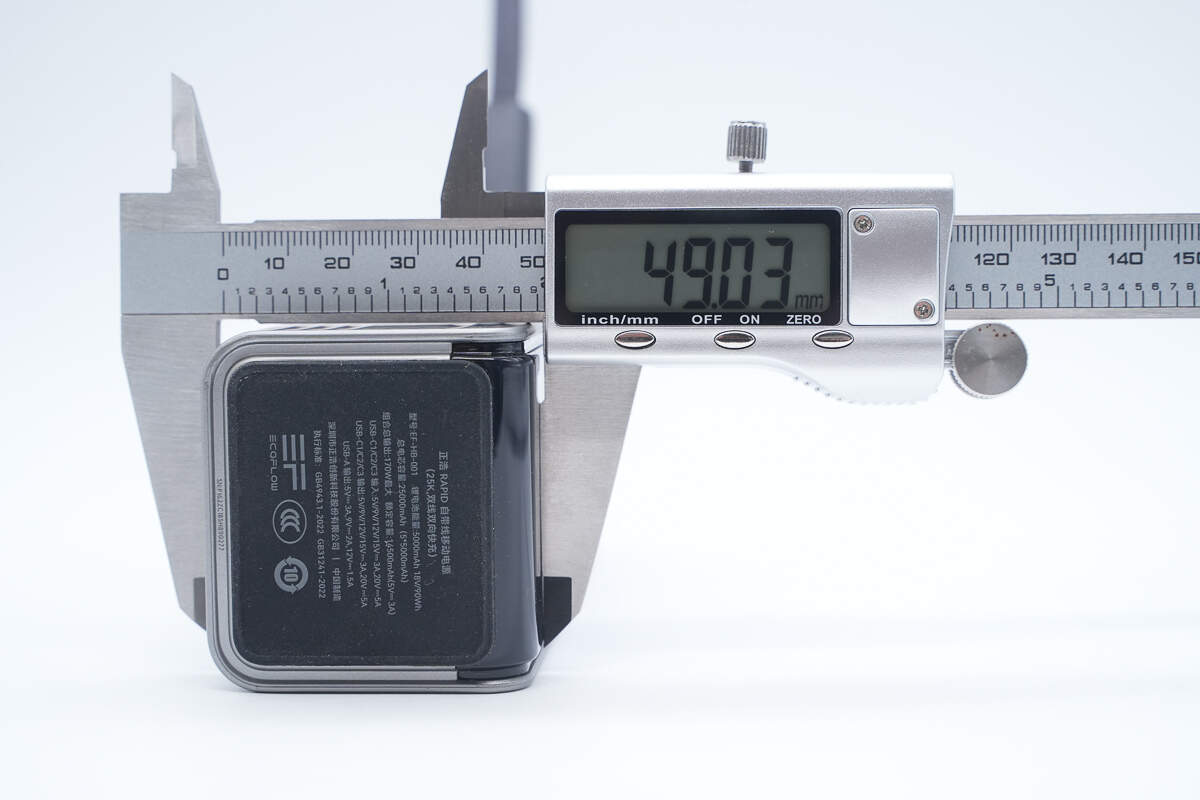

The thickness is about 49.03 mm (1.93 inches).

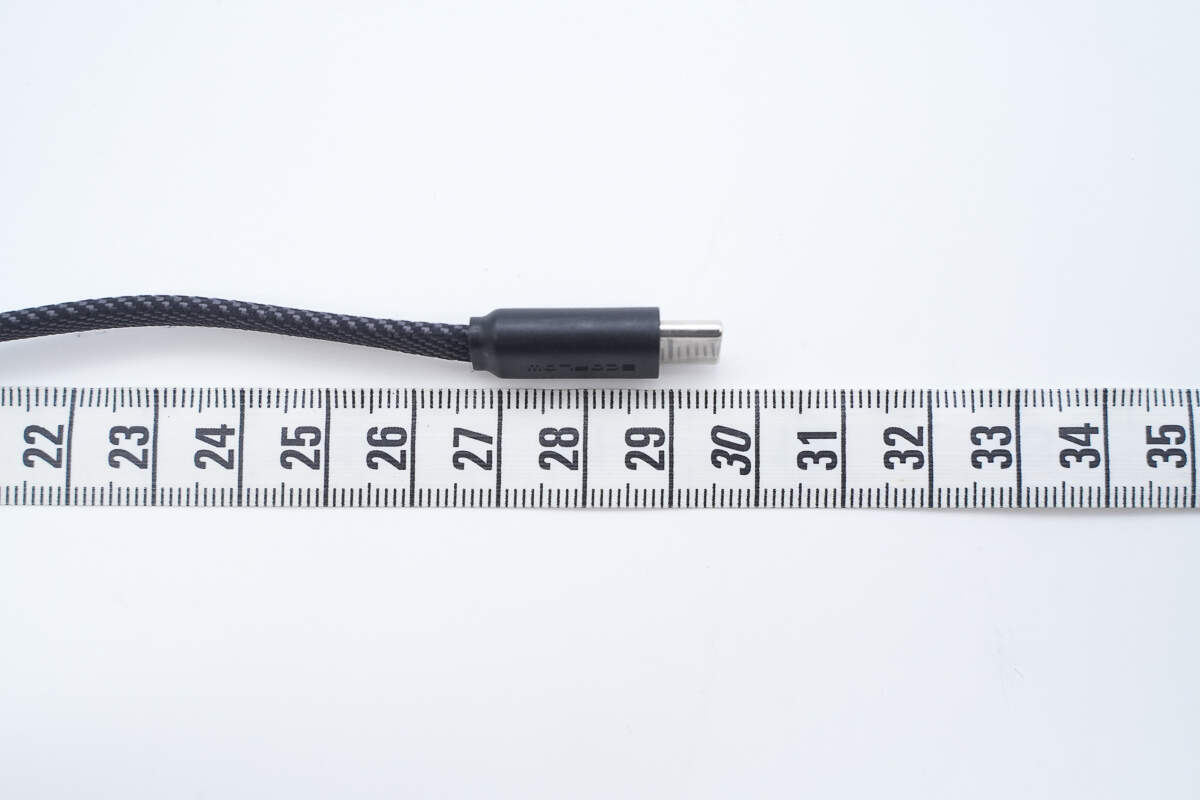

The length of the USB-C2 lanyard cable is about 29.5 cm (11.61 inches).

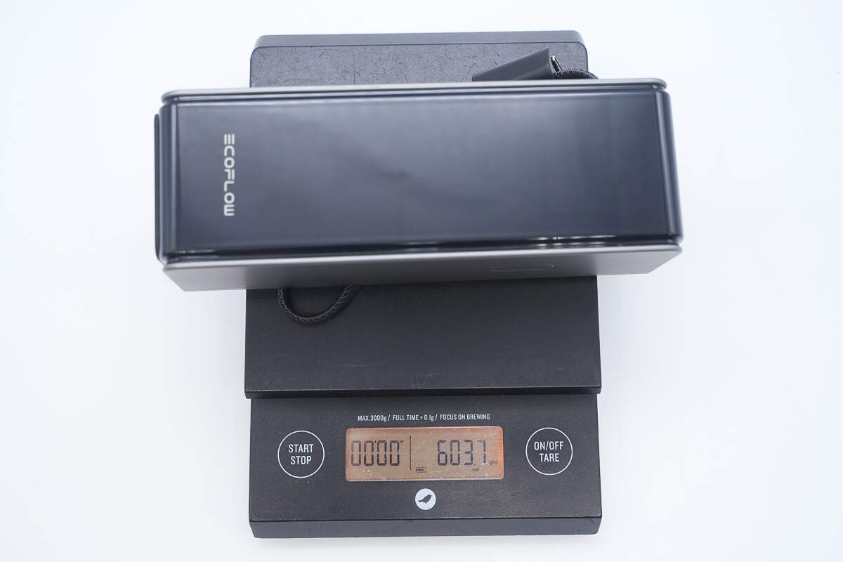

The weight is about 604 g (21.31 oz).

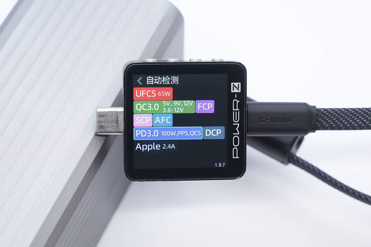

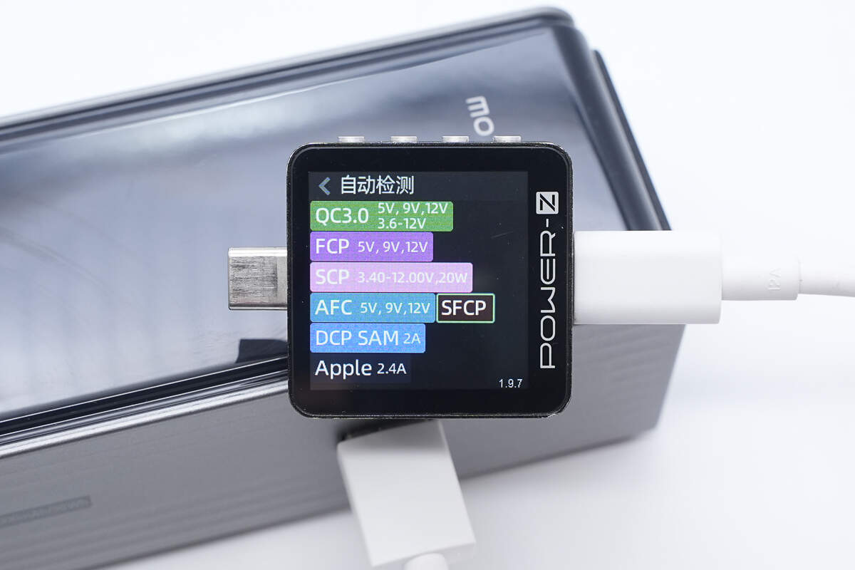

ChargerLAB POWER-Z KM003C shows that the retractable USB-C1 cable supports UFCS, QC3.0/5, FCP, SCP, AFC, PD3.0, PPS, DCP, and Apple 2.4 charging protocols.
And it has five fixed PDOs of 5V3A, 9V3A, 12V3A, 15V3A, and 20V5A. It has one set of PPS, which is 5-21V5A.
Testing shows that the USB-C2 lanyard cable supports the same protocols as the USB-C1 retractable cable.
Testing confirms that the USB-C3 port supports the same protocols as the two cables.
The PDO messages are also the same, meaning all three USB-C ports deliver identical output performance.
The USB-C cable supports QC3.0, FCP, SCP, AFC, SFCP, DCP, SAM 2A, and Apple 2.4 charging protocols.

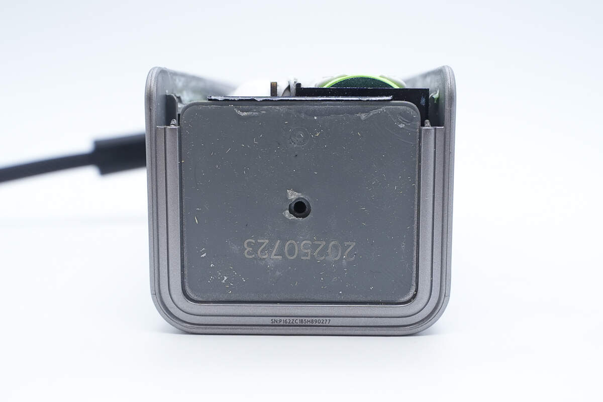

The front panel is secured with snap-fit clips along the edges and can be removed by carefully prying it off.
Peel off the anti-slip pad at the bottom to reveal a hidden screw in the center (which has already been removed).

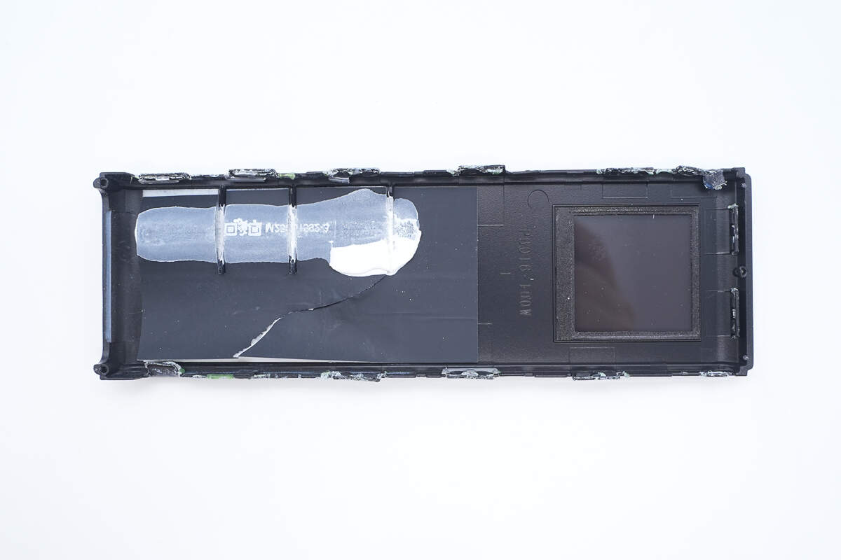

The inside of the front panel is lined with protective foam for insulation, and the edges of the display are cushioned with foam padding.

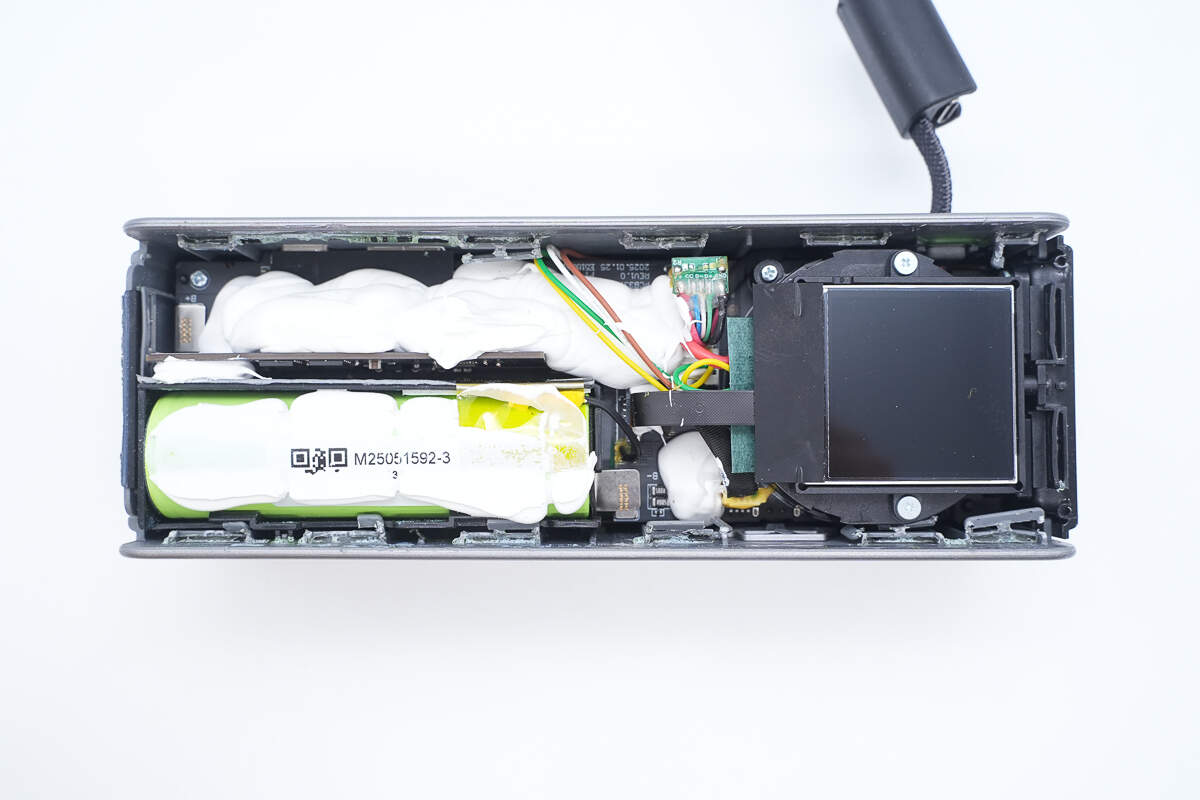

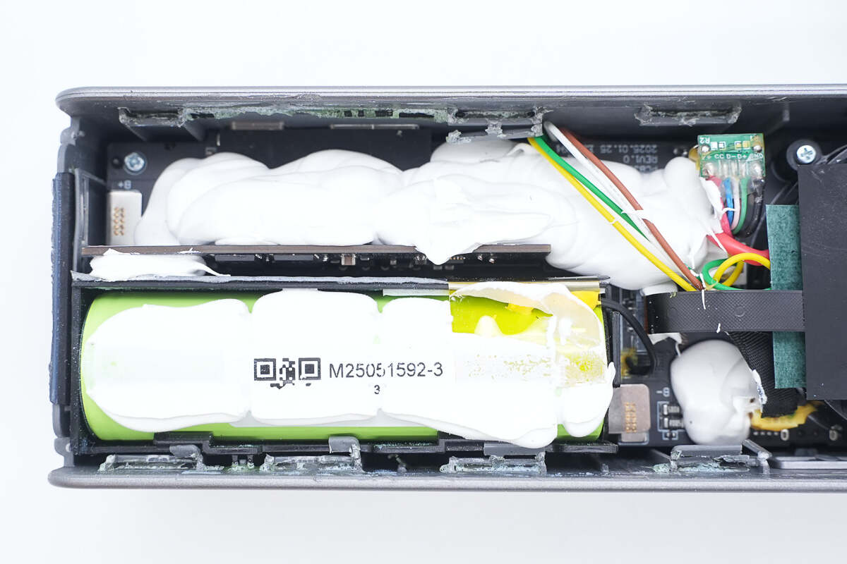

Inside, the upper layer contains a single battery cell, next to which a small vertical PCB is soldered. The display is located on the right side.
The area around the battery cell and PCB is heavily reinforced and secured with white adhesive. A thermistor is attached to the right end of the battery cell for temperature monitoring.
The single battery cell is spot-welded to the main PCB using a nickel strip.

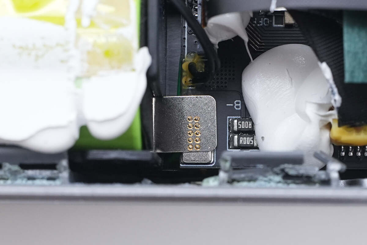

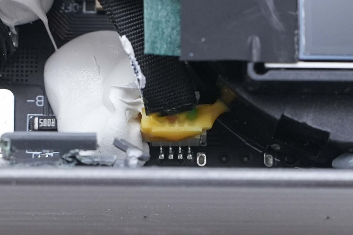

The bottom battery cell connects to the main PCB via plug-in wires, with the connector socket reinforced using adhesive.

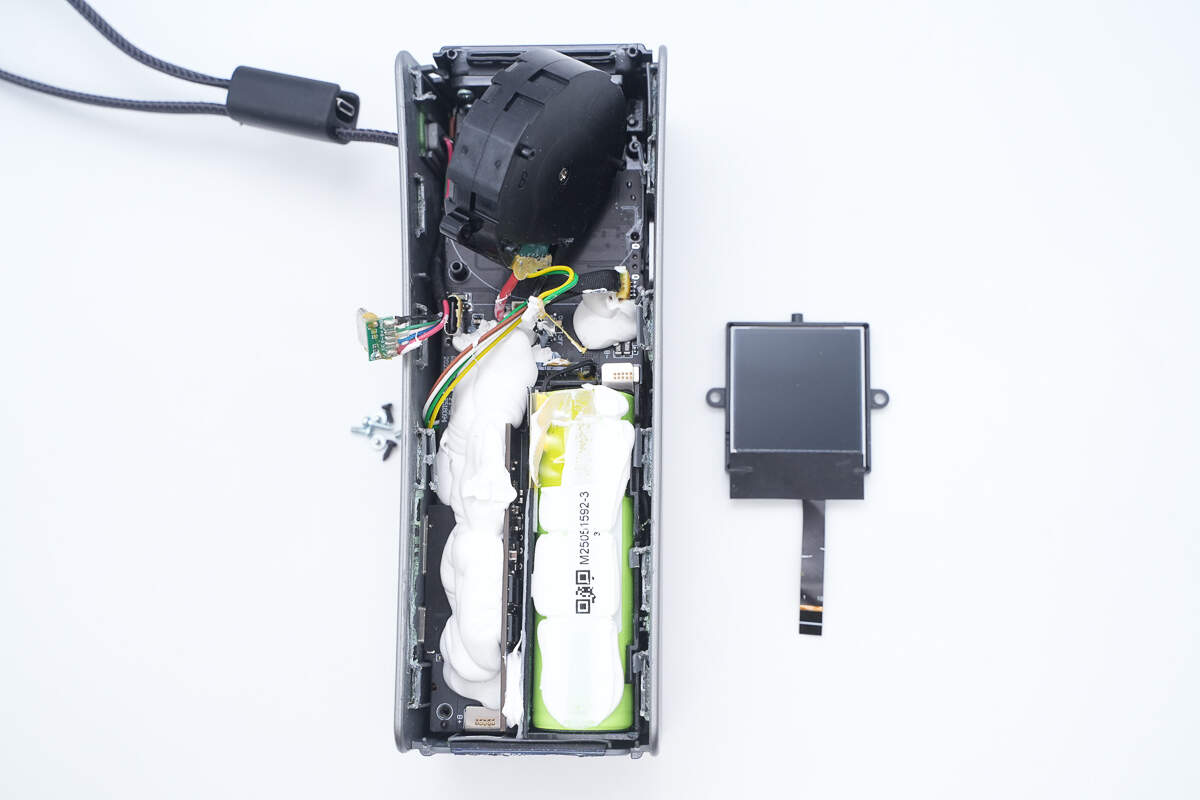

The display is housed in a plastic casing for support and protection, secured by screws on both sides above the retractable cable module.

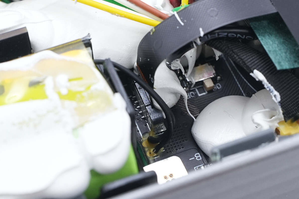

The display connects to the main PCB via a detachable flex cable, with the connector reinforced using adhesive for added durability.

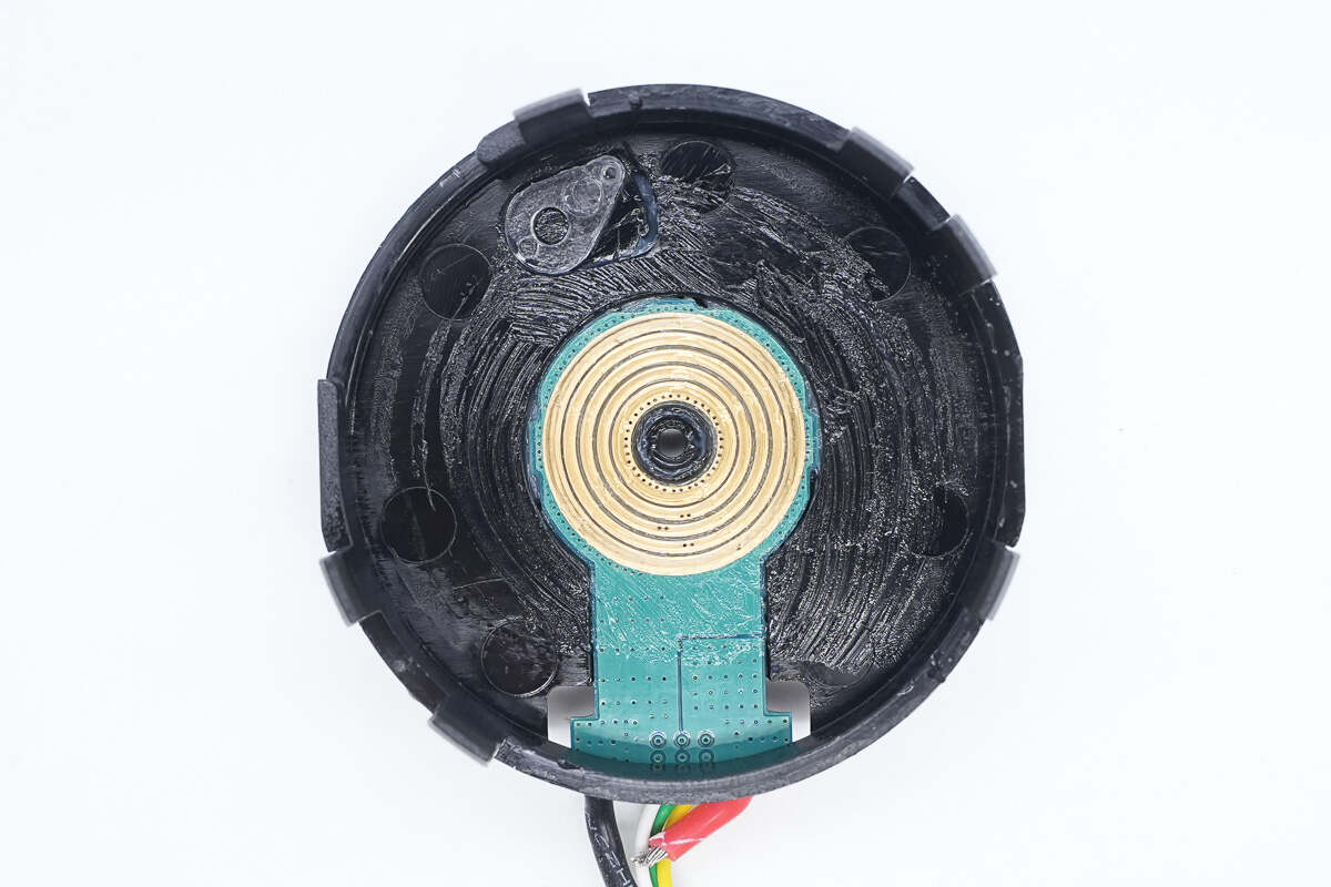

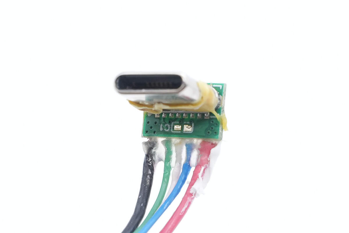

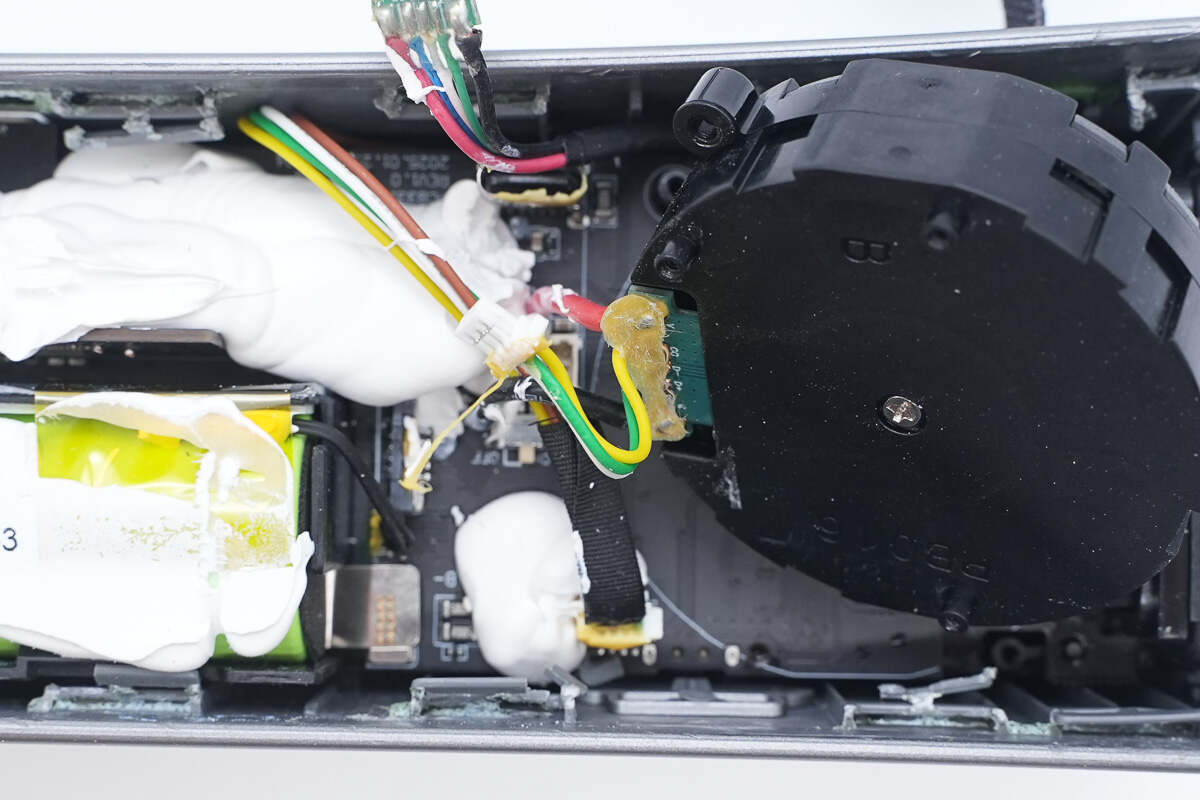

The retractable cable module is also secured with screws. The USB-C2 lanyard cable wires are soldered to the back of a small green PCB, with the wiring protected by adhesive.
The other side of the small PCB is soldered to a USB-C male connector. The USB-C2 lanyard cable connects to the main PCB's USB-C female port through this module via a plug-in connection, which is also reinforced with adhesive.
Remove the screws to take out the display.

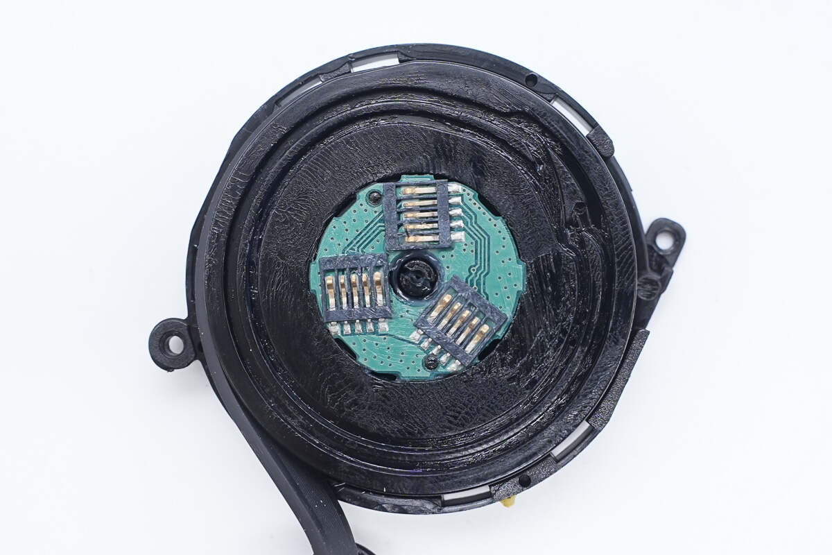

The retractable cable module connects to the main PCB via plug-in connections using thin yellow, white, and green wires, while the thicker red and black wires are soldered directly.
Disconnect the wire connectors from each group and remove the module.

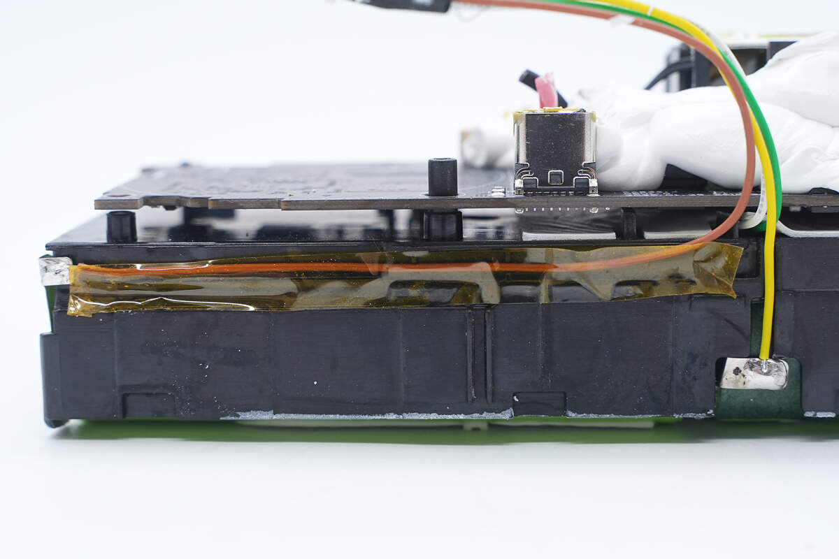

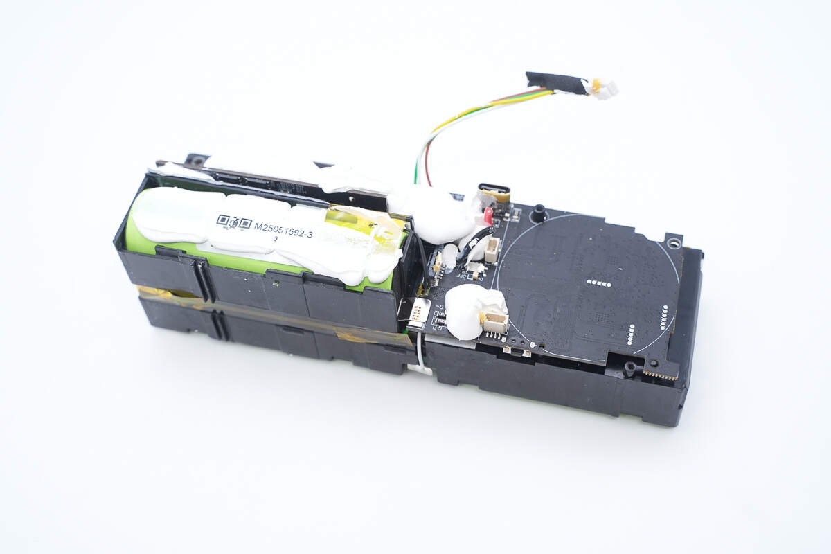

The module uses an integrated plastic frame to isolate and secure the PCB and battery cell. The PCB is fixed by a mounting post at the top, while the single battery cell is placed within a dedicated compartment.

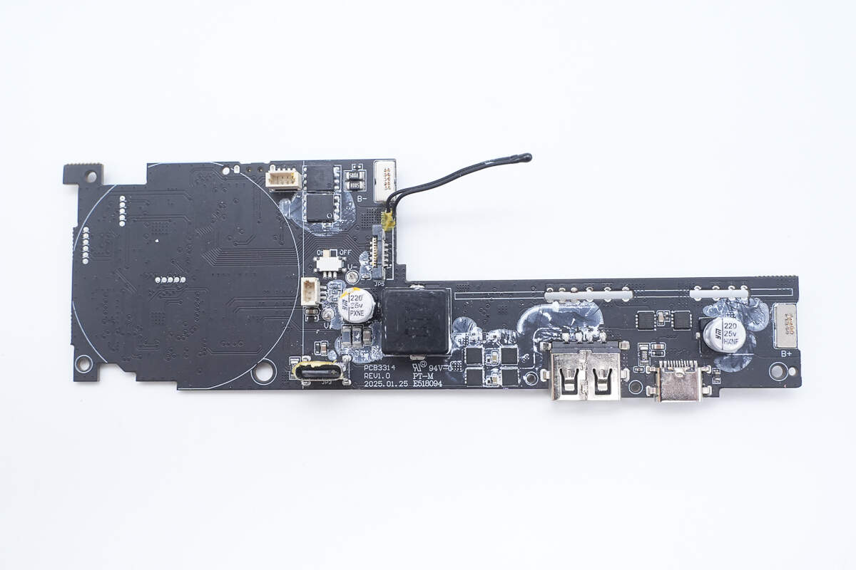

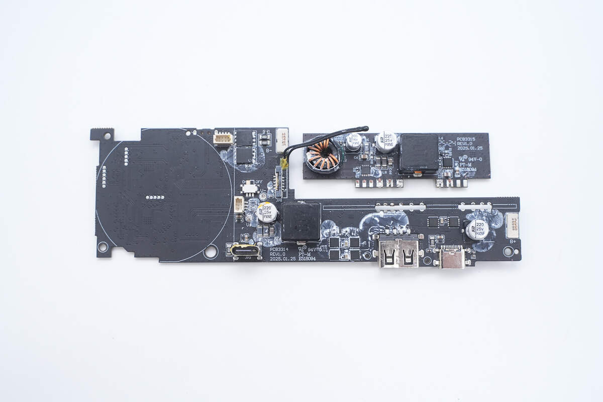

The main PCB is supported by mounting posts that create the gap, effectively preventing heat buildup.

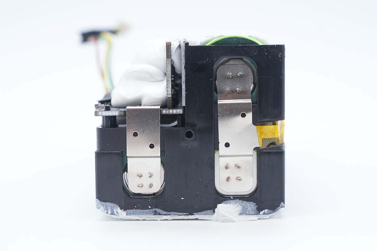

At the bottom, there are four battery cells protected with insulating paper and reinforced with adhesive.
The battery cells are connected by spot-welded nickel strips.

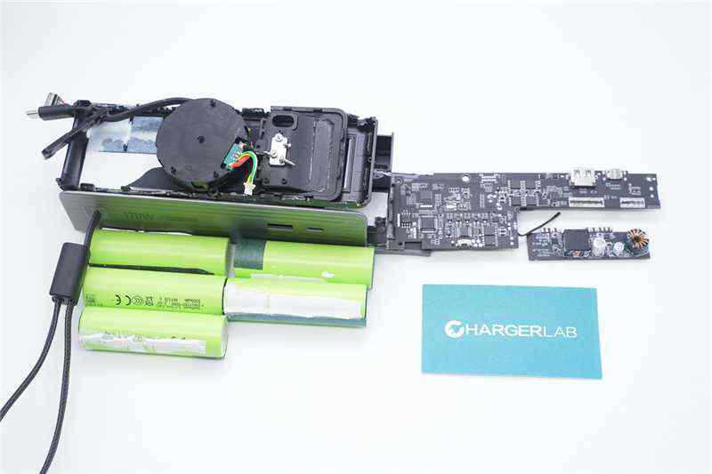

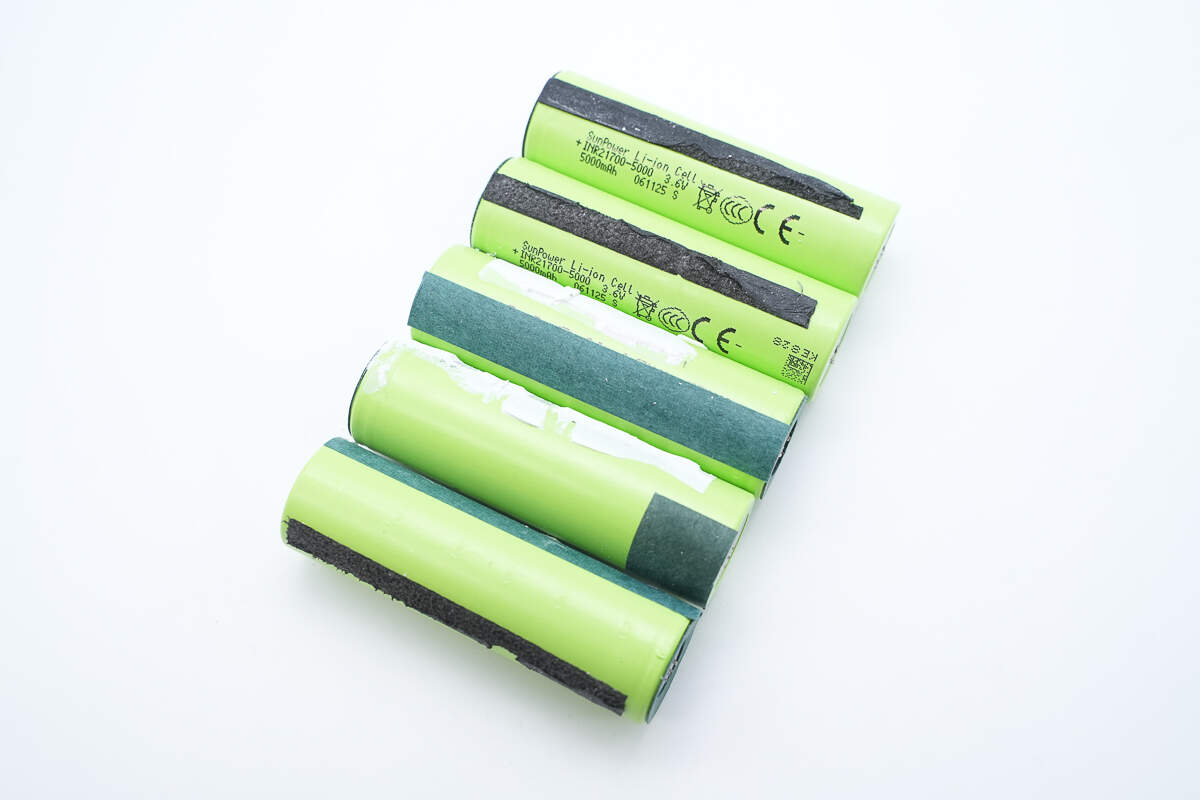

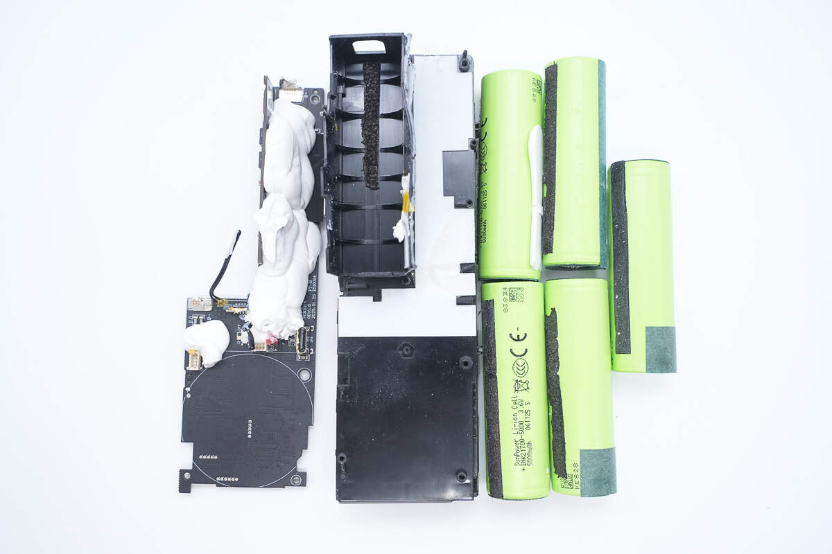

Separate the PCBA module from the battery pack. Protective foam is attached inside the L-shaped area at the top of the plastic frame.

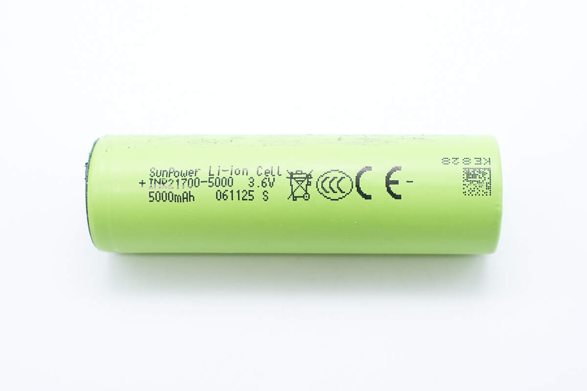

The battery pack consists of five identical 21700 lithium-ion cells.

The five battery cells are from SunPower, model INR21700-5000, with a nominal voltage of 3.6V and a rated capacity of 5000mAh. They have a charging cutoff voltage of 4.2V and have passed CCC and CE certifications.
Clean off the white adhesive on the PCBA module. On the main PCB, there is a small vertical PCB attached.
Separate the small PCB from the main PCB.

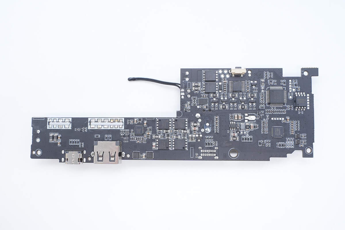

The front side of the main PCB is equipped with a battery protection chip, battery protection MOSFETs, a battery fuel gauge chip, an MCU, a memory, a PD controller, switching switches, synchronous buck-boost controllers, synchronous buck-boost MOSFETs, VBUS MOSFETs, and a synchronous buck converter, among other components.
The back side features two battery protection MOSFETs, a buck-boost inductor, solid capacitors, and VBUS MOSFETs.

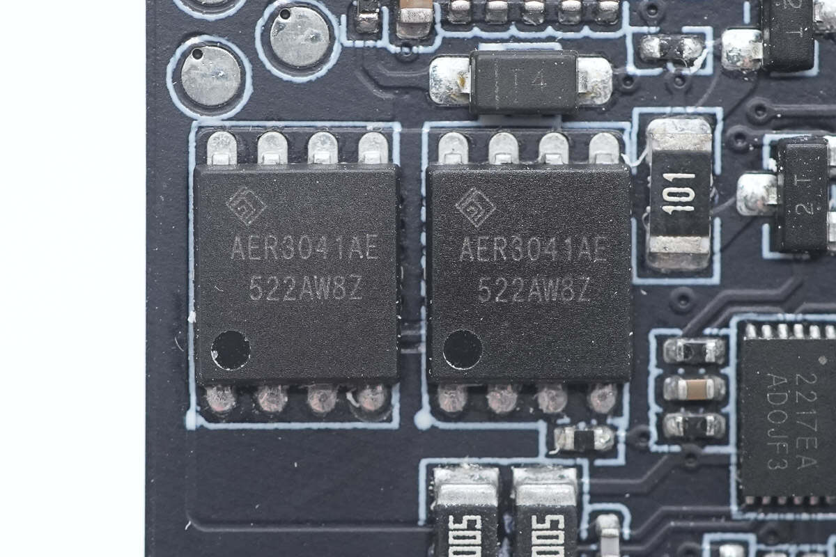

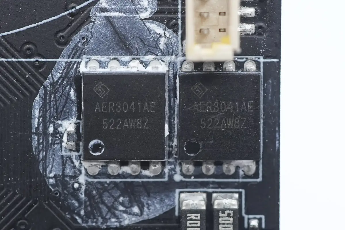

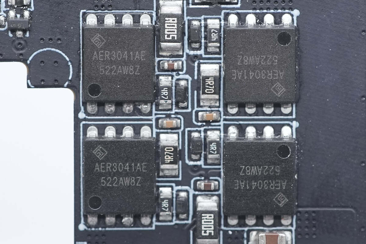

The four battery protection MOSFETs are from ALLEPIC, model AER3041AE. These are N-channel MOSFETs with a voltage rating of 30V and an on-resistance of 3.2mΩ. They come in a PDFN5060 package.
The other two AER3041AE MOSFETs are located on the reverse side of the main PCB.

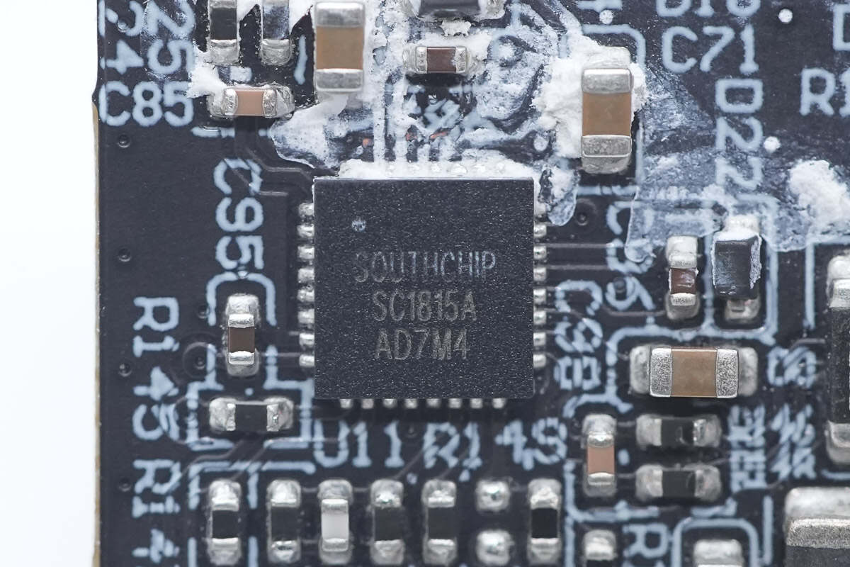

The synchronous buck-boost controller is from SouthChip, model SC1815A, and it comes in a QFN32 package.

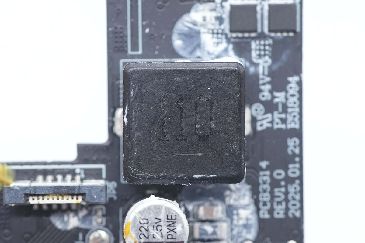

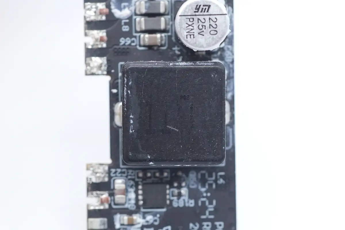

Close-up of the 11μH buck-boost inductor.

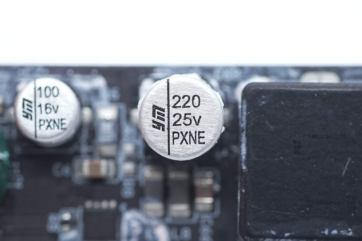

The solid capacitor is from YMIN, rated at 25V and 220μF.
The solid capacitor is from YMIN, and the specification is also 25V 220μF.

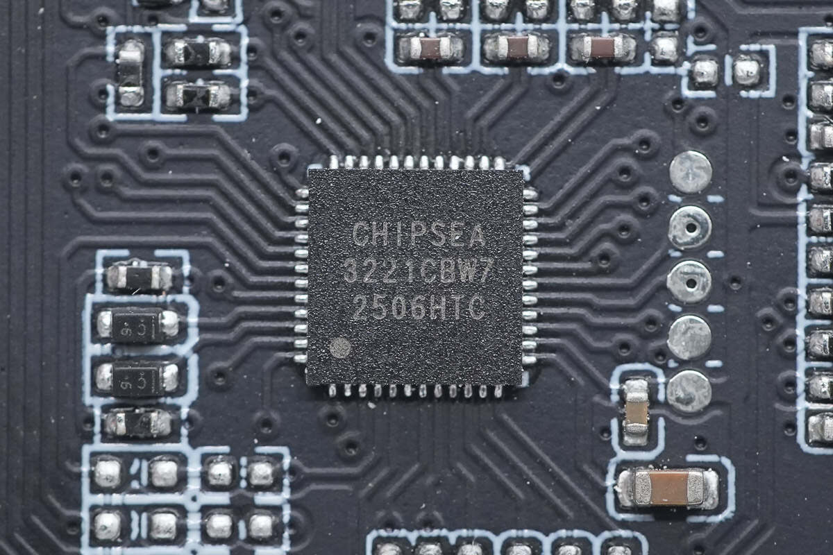

The bidirectional fast-charging controller for the two built-in cables and the USB-C3 port uses the Chipsea CPW3221. This USB Type-C and USB PD controller is designed for power banks, BMS, wireless charging, and display applications. It integrates all Type-C CC and USB PD functions, as well as USB BC1.2 support. Additionally, it includes multiple fast-charging protocols to enhance compatibility with various mobile devices.
The CPW3221 features a 32-bit microprocessor running at 48MHz, suitable for a wide range of industrial control and high-performance CPU applications. It includes 128KB of program Flash memory, 24KB of SRAM, and various peripherals such as I/O ports, timers, USART, I2C, ADC, watchdog timers, making it versatile for broader uses. The chip is available in QFN32 and QFN48 packages.

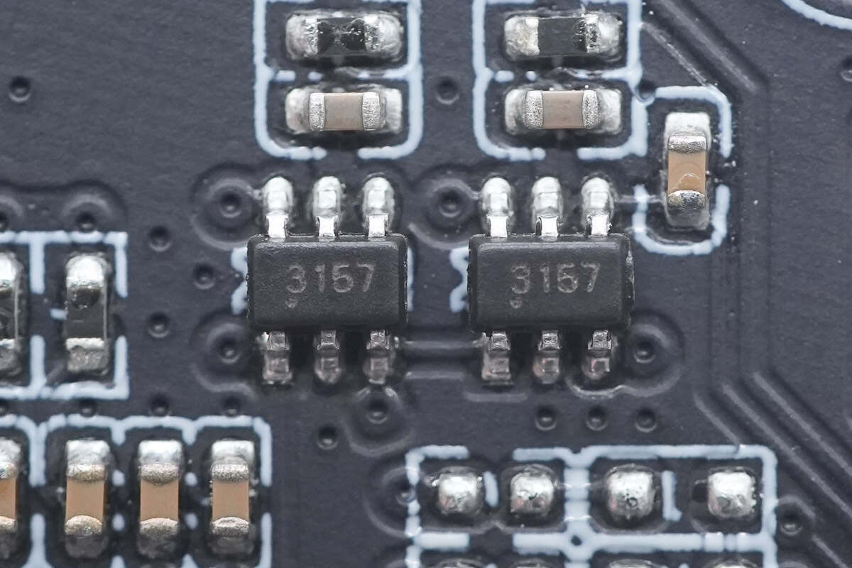

There are two switches marked with "3157."

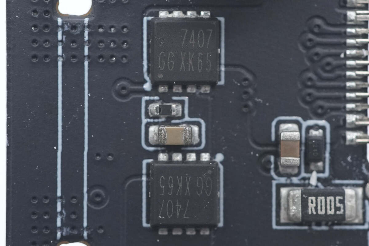

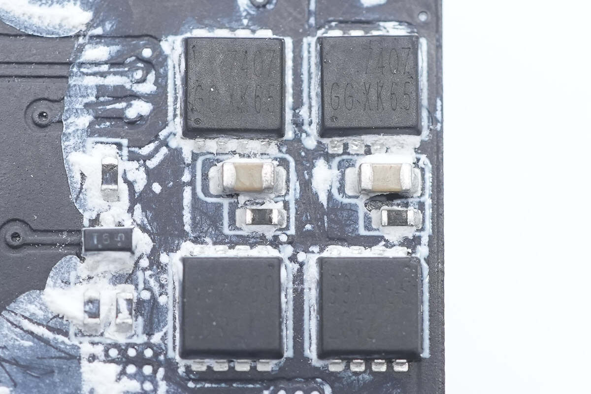

The four VBUS MOSFETs are marked with "7407."

This solid capacitor is from YMIN, rated at 25V and 220μF.

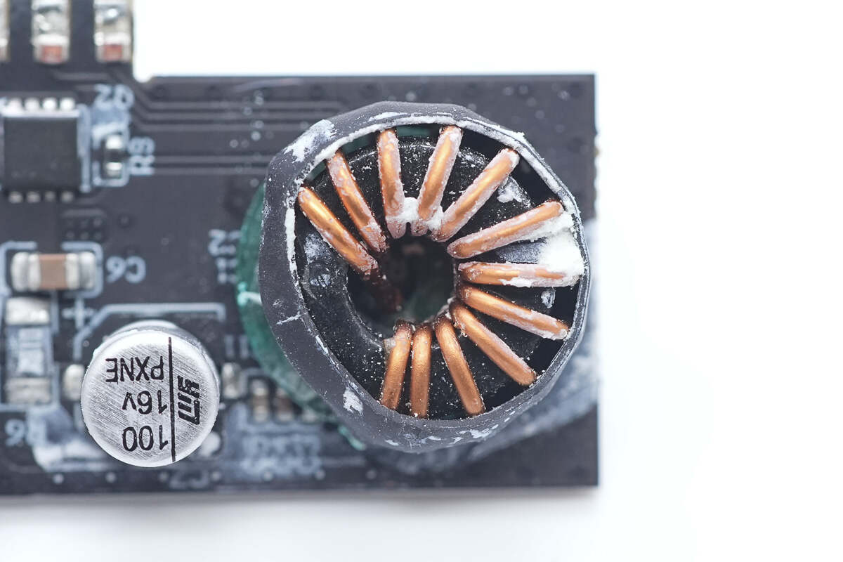

The buck-boost inductor is insulated with a heat-shrink tube on the outside, and the bottom is lined with insulating paper.

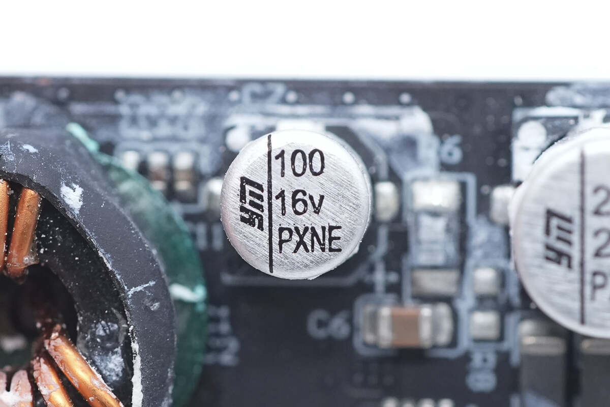

The solid capacitor is from YMIN, rated at 16V and 100μF.

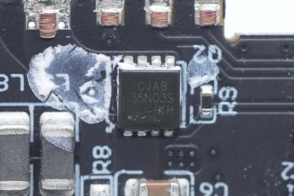

The USB-A port VBUS MOSFET is from JSCJ, model CJAB35N03S. It is an N-channel MOSFET with a voltage rating of 30V and an on-resistance of 5.2mΩ, packaged in a PDFNWB 3.3×3.3-8L package.

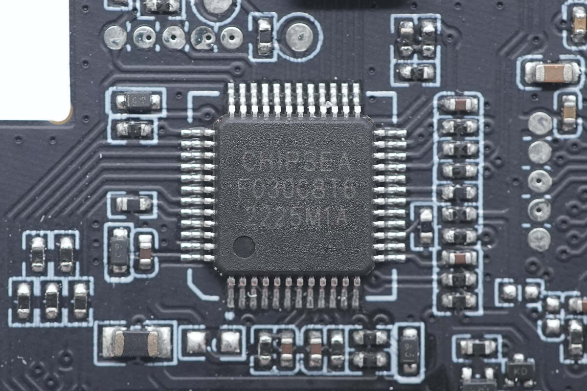

The MCU is from Chipsea, model CS32F030C8T6. It features a 48MHz ARM Cortex-M0 CPU, with 64KB of FLASH memory and 8KB of SRAM. It includes two UART interfaces, two SPI interfaces, and two I2C interfaces, all housed in an LQFP48 package.

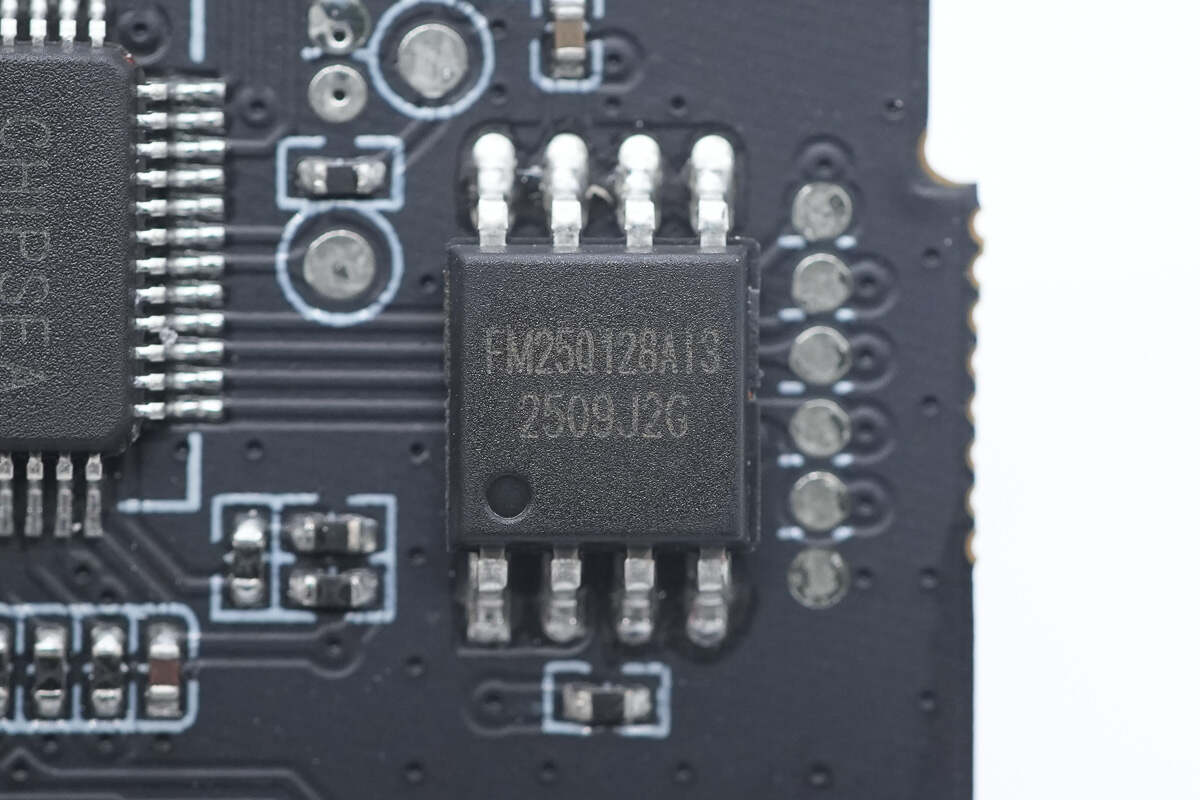

The memory chip is from FUDAN, model FM25Q128AI3. It is a 16MB serial flash memory with a wide operating voltage range. It supports standard Serial Peripheral Interface (SPI), dual/quad I/O, and quad peripheral interface (QPI) with dual-clock instruction cycles. The chip comes in an SOP8 package.

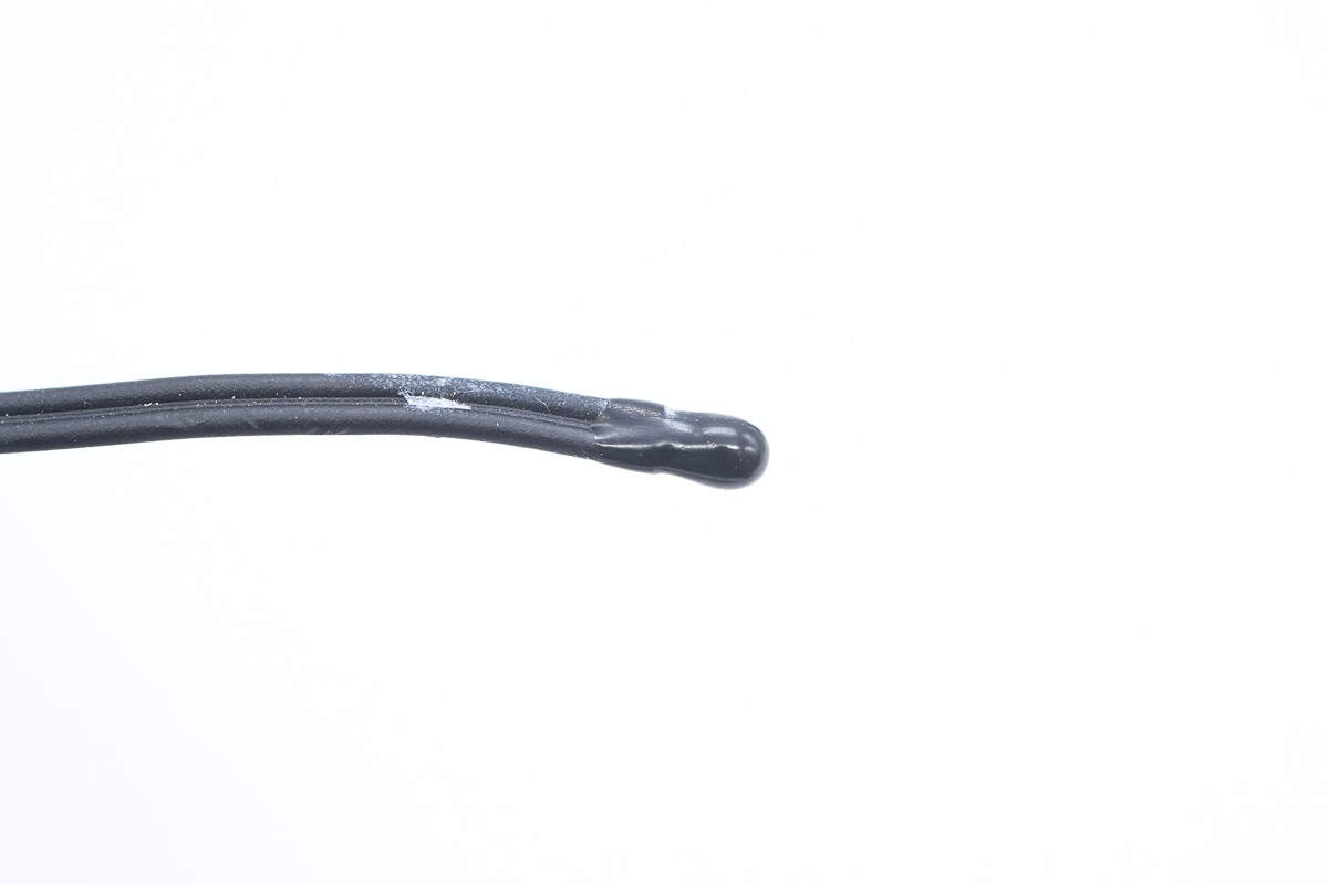

Close-up of the thermistor.

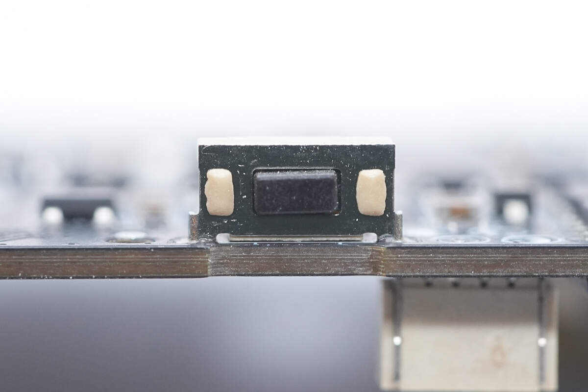

Close-up of the power button.

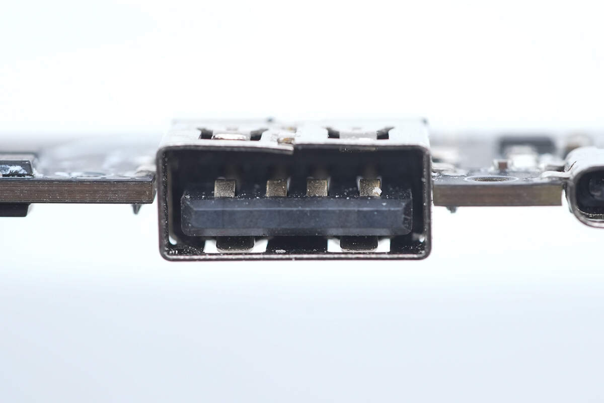

The USB-A socket is mounted using plated through-hole soldering.

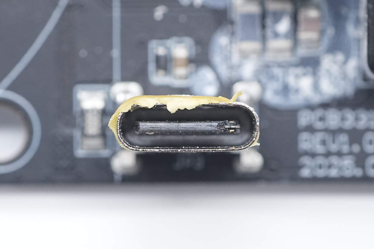

The USB-C3 socket is also mounted using plated through-hole soldering.

Disassemble the retractable cable module.
Inside the top housing, there is a magnet designed to hold the USB-C1 retractable cable connector securely in place.
Close-up of the slip ring.
The spool is equipped with three brushes to enhance current-carrying capacity.
