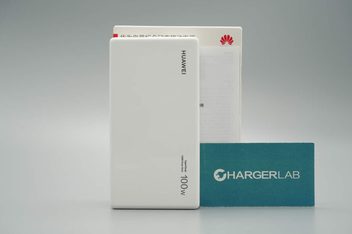

Inside the box, you'll find the power bank and a user guide.
Teardown of Huawei SuperPower 100W 12000mAh Power Bank (P0020)-Chargerlab

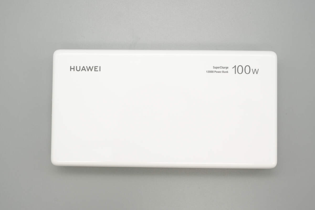

It comes in two color options: black and white. The smooth, rounded edges and slim profile make it comfortable to hold.
The front is printed with the HUAWEI logo and “100W” markings.

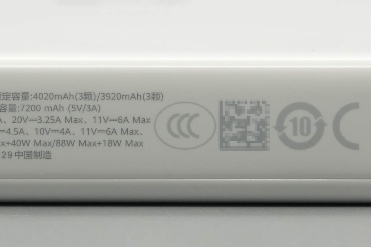

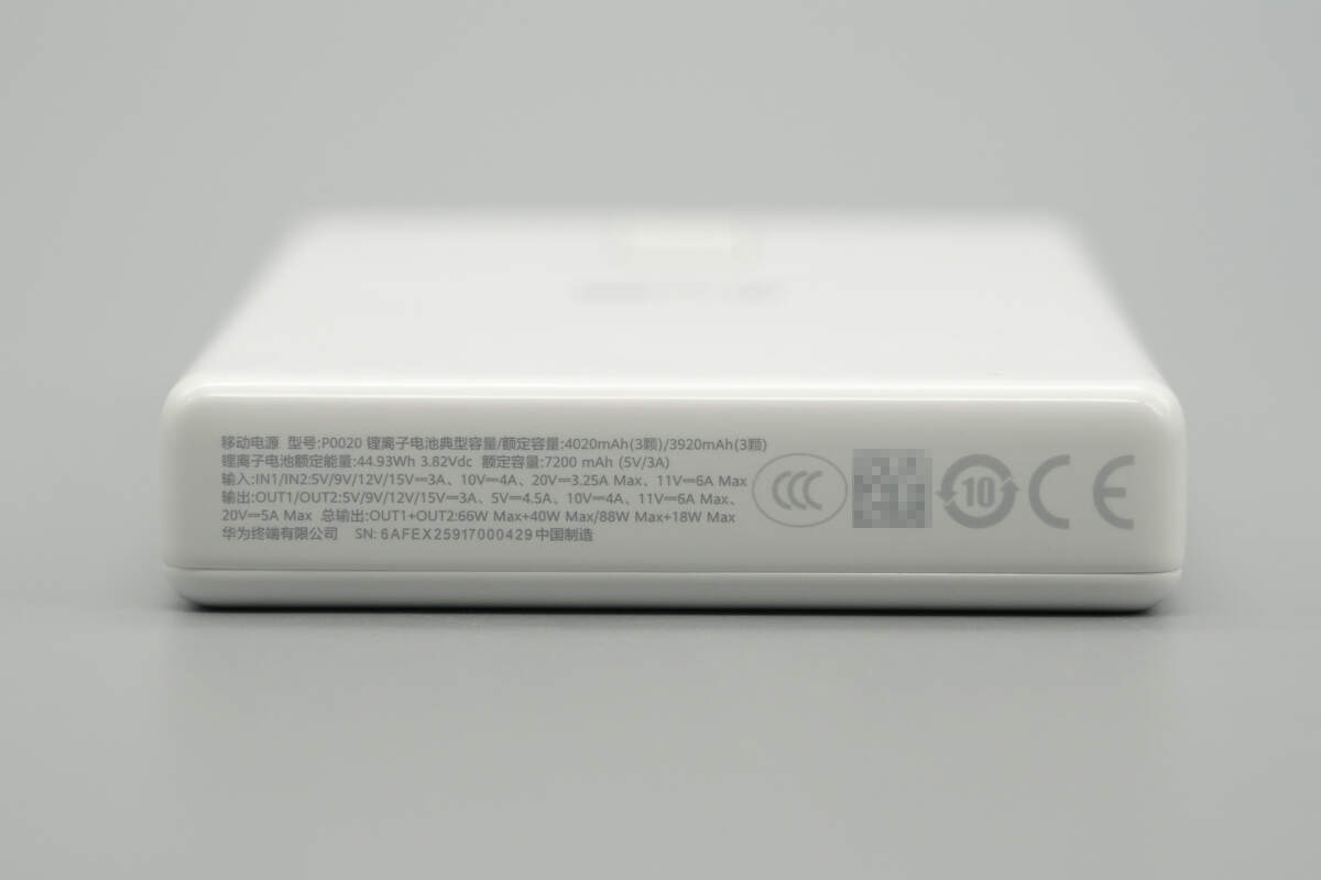

The specifications are printed on the end of the power bank.
Model: P0020
Typical/Rated Li-ion Battery Capacity: 4020 mAh (3 cells) / 3920 mAh (3 cells)
Rated Li-ion Battery Energy: 44.93 Wh, 3.82 V DC
Rated Capacity: 7200 mAh (5 V 3 A)
Input:
IN1/IN2: 5/9/12/15 V ⎓ 3 A, 10 V ⎓ 4 A, 20 V ⎓ 3.25 A Max, 11 V ⎓ 6 A Max
Output:
OUT1/OUT2: 5/9/12/15 V ⎓ 3 A, 5 V ⎓ 4.5 A, 10 V ⎓ 4 A, 11 V ⎓ 6 A Max, 20 V ⎓ 5 A Max
Total Output (OUT1 + OUT2): 66 W Max + 40 W Max / 88 W Max + 18 W Max
It has passed CCC and CE certifications.

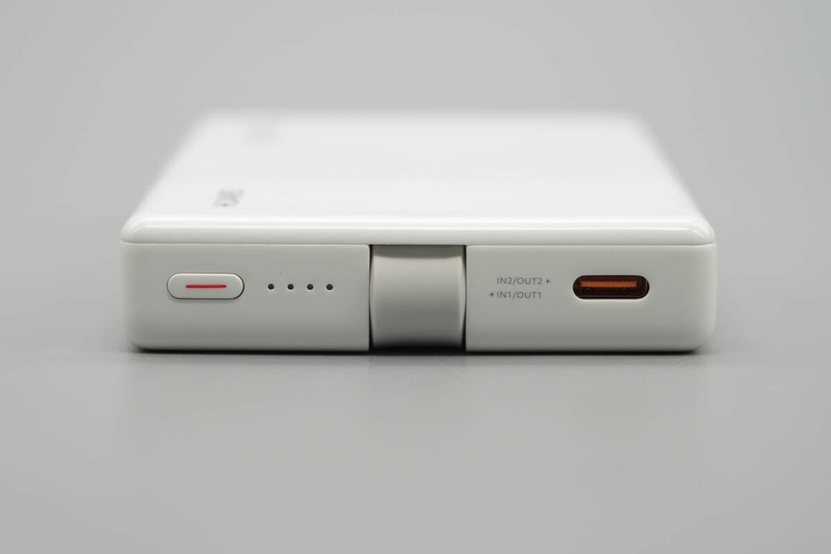

The other end features a power button, battery indicator lights, a built-in USB-C cable, and a USB-C2 port.
The battery indicator lights glow white, with each light representing 25% of the charge.

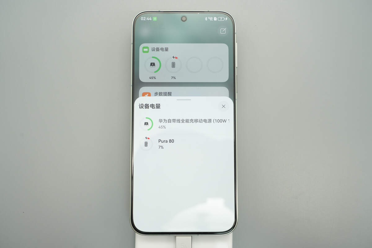

It supports HarmonyOS Smart Display, allowing users to check the remaining power of the power bank on their smartphones while charging.

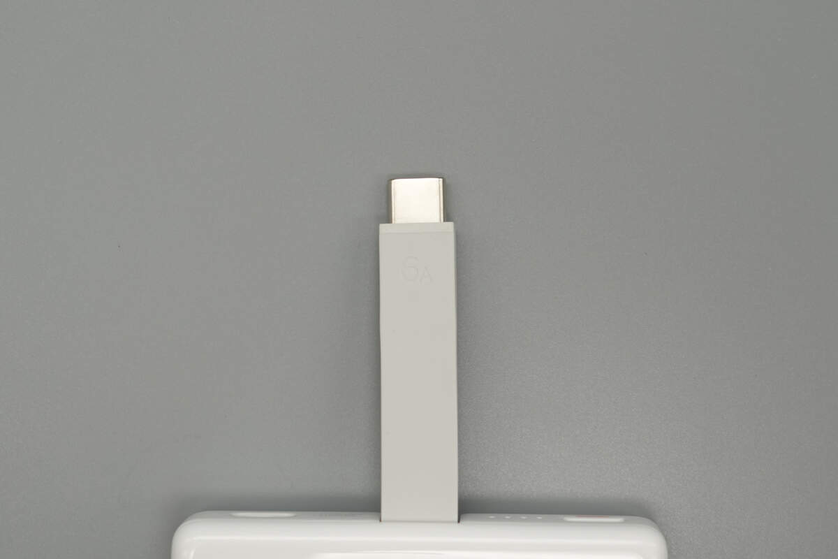

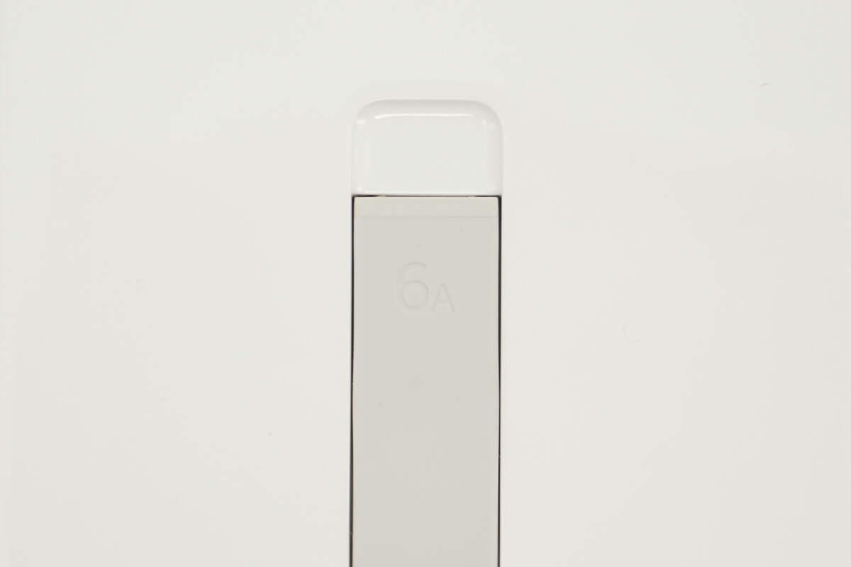

The built-in cable is marked with 6A.

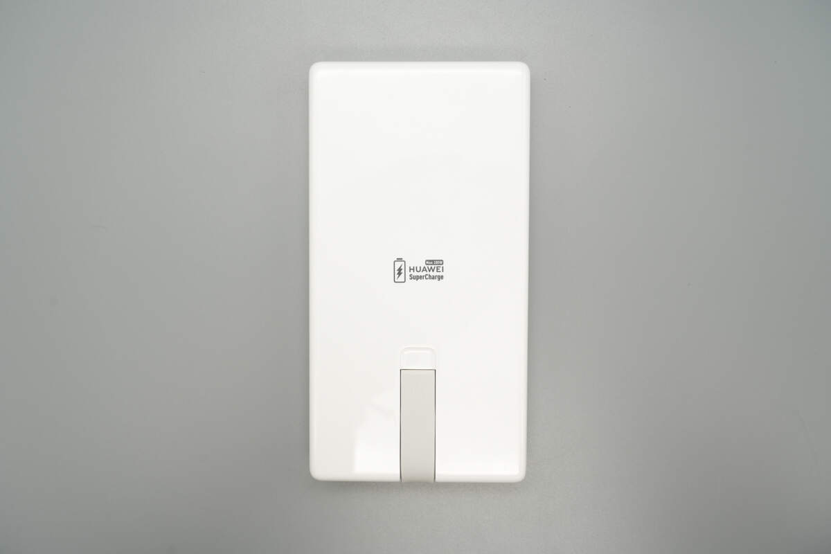

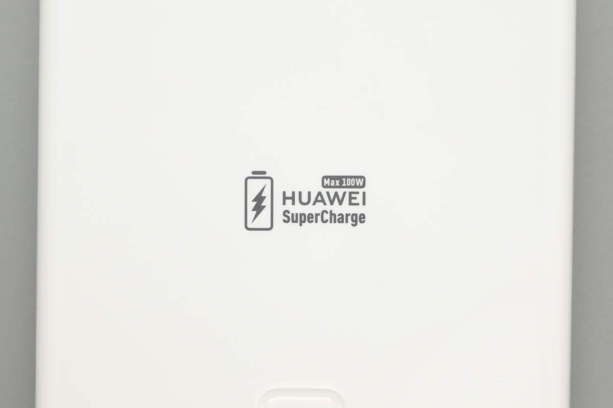

The center is printed with Max 100W and HUAWEI SuperCharge.

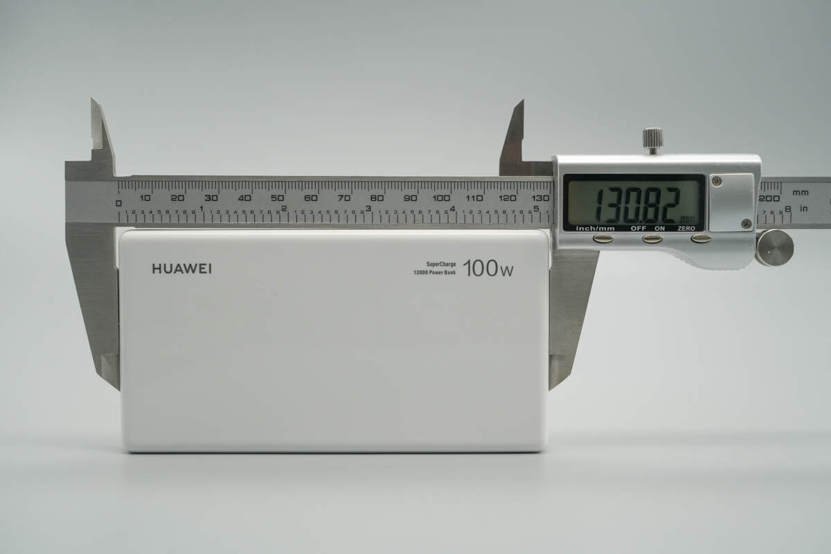

The length of the power bank is about 130.82 mm (5.15 inches).

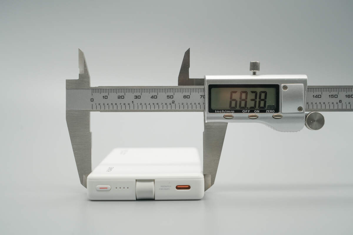

The width is about 68.38 mm (2.69 inches).

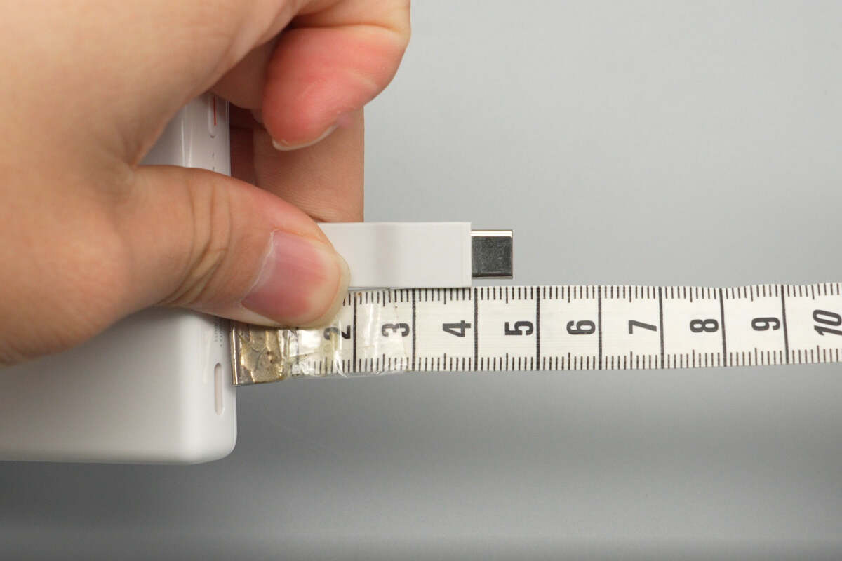

The length of the built-in USB-C cable is about 4.5 cm (1.77 inches).

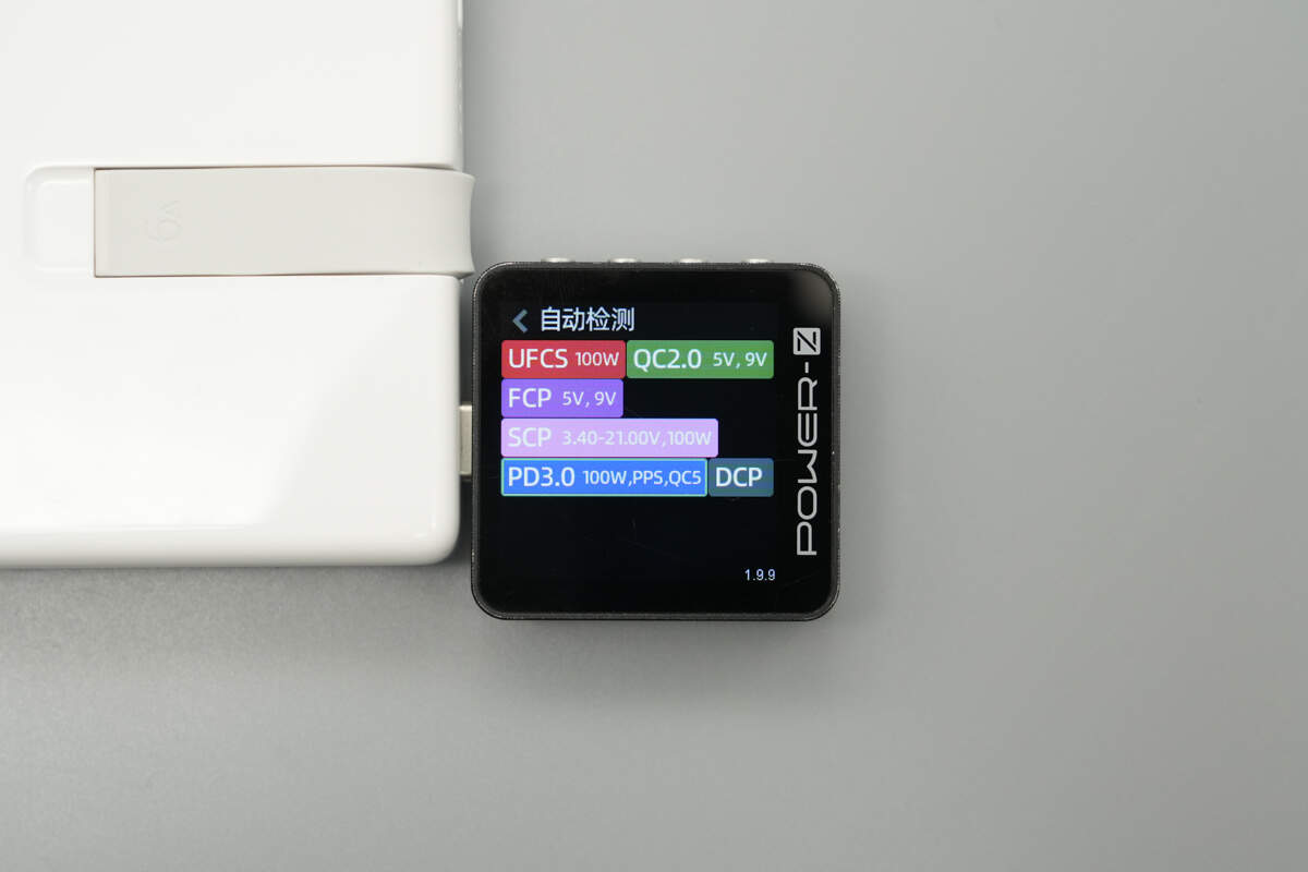

ChargerLAB POWER-Z KM003C shows that the build-in USB-C cable supports UFCS, QC2.0/5, FCP, SCP, PD3.0, PPS, and DCP charging protocols.

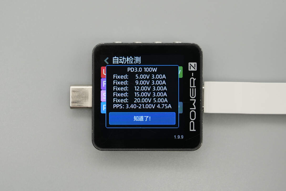

And it has five fixed PDOs of 5V3A, 9V3A, 12V3A, 15V3A, and 20V5A. It has one set of PPS, which is 3.4-21V4.75A.

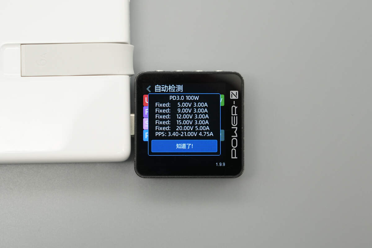

The USB-C2 port supports the same charging protocols as the built-in USB-C cable.
The PDO reports are also identical.

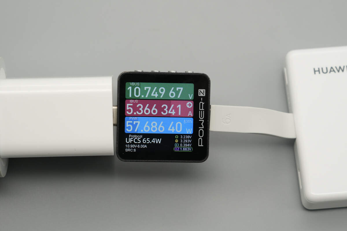

When charging the power bank using a Huawei 100W charger via the built-in USB-C cable, the measured output power of the charger is about 57.69W.

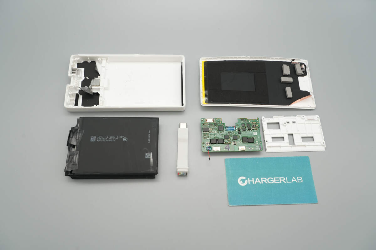

Remove the front casing. The PCB is covered with a white plastic plate for insulation. Areas corresponding to the main heat-generating components are cut out and fitted with thermal pads to facilitate heat dissipation.

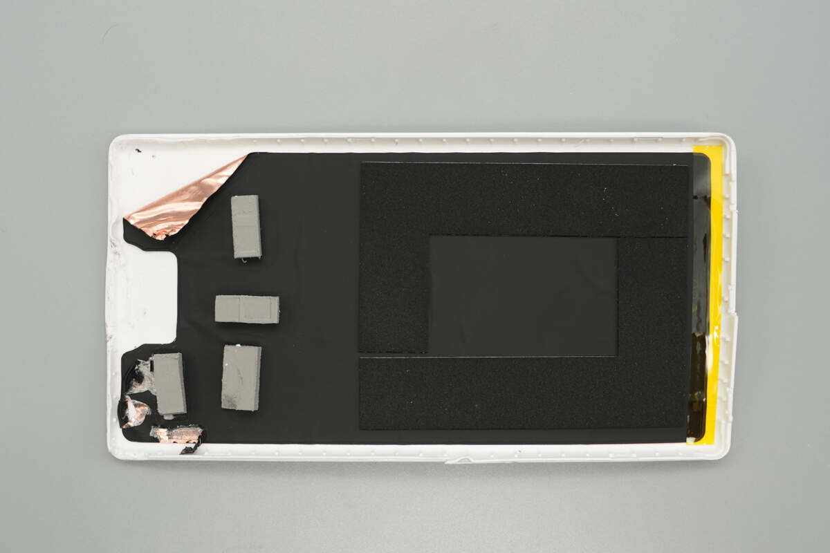

The inner side of the casing is lined with copper foil, thermal pads, and foam.
Remove the white plastic plate. The battery cells are connected to the PCB via nickel strips spot welding.

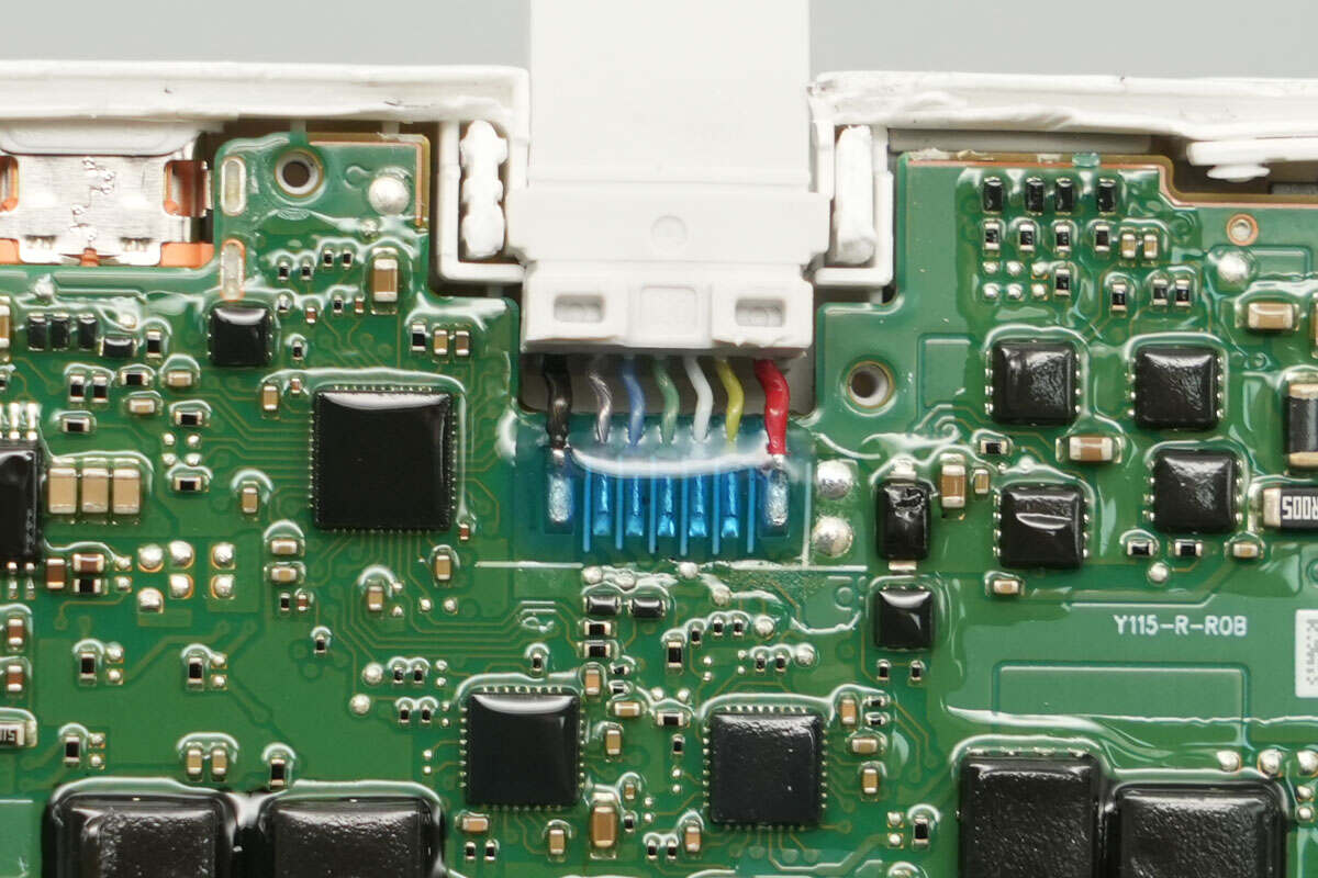

The connection between the built-in USB-C cable and the PCB is secured with adhesive for protection.

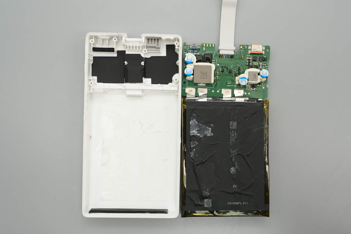

Remove the PCB and battery cells.

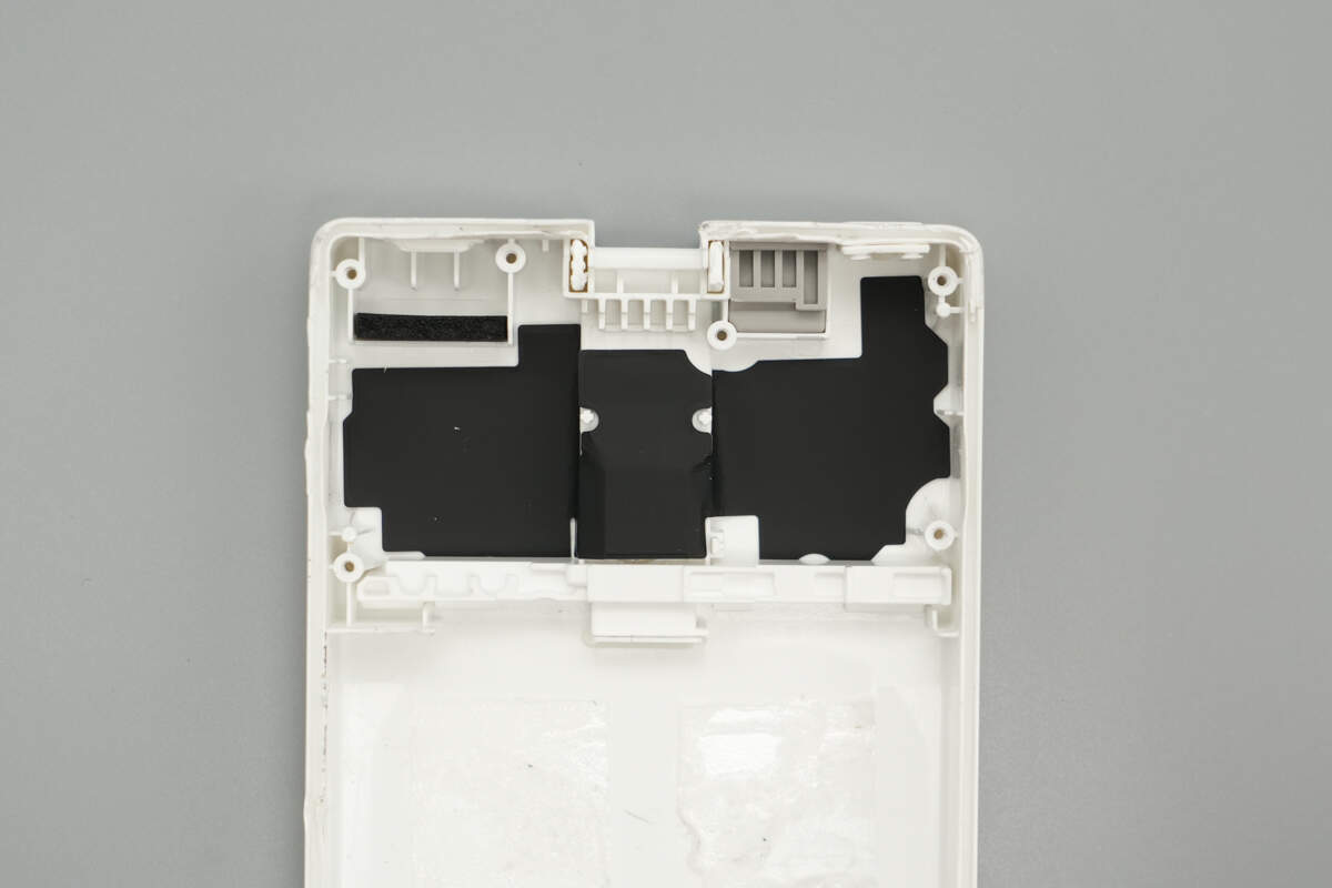

The other half of the casing, corresponding to the PCB area, is lined with graphite thermal tape.

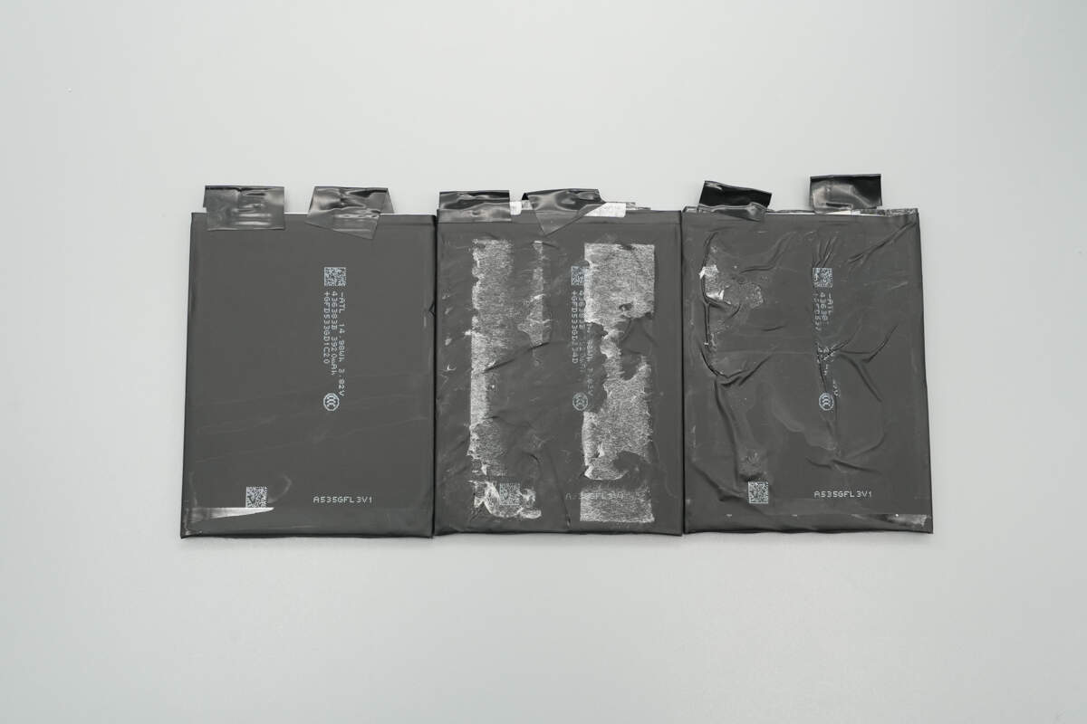

The battery pack consists of three cells.
All three battery cells share the same part number and are from ATL, model 436383B, with a nominal voltage of 3.82 V and a nominal capacity of 3920 mAh. They have passed CCC and CE certifications and comply with UL1642 and IEC62133 safety standards.

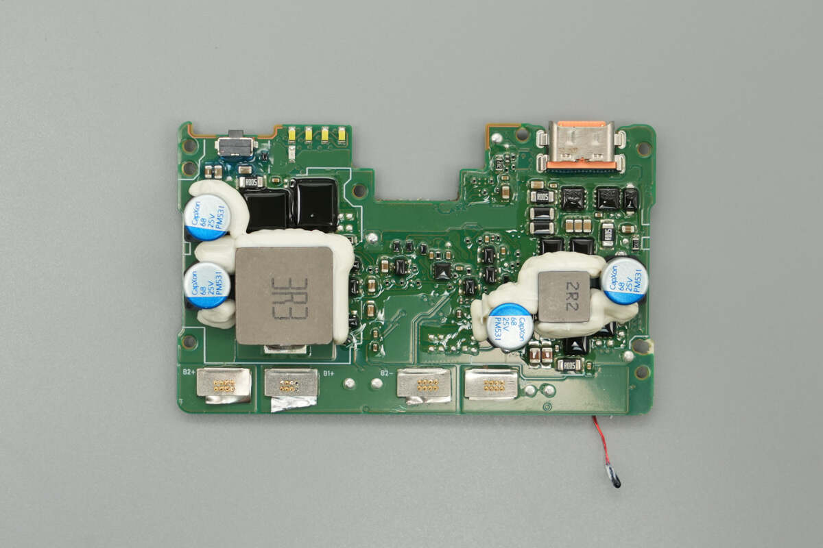

The front side of the PCB features synchronous buck-boost MOSFETs, VBUS MOSFETs, an E-Marker chip, inductors, and solid capacitors.
The back side of the PCB is equipped with a battery protection chip, battery protection MOSFETs, a synchronous buck-boost controller, synchronous buck-boost MOSFETs, a protocol chip, VBUS MOSFETs, and a thermistor.

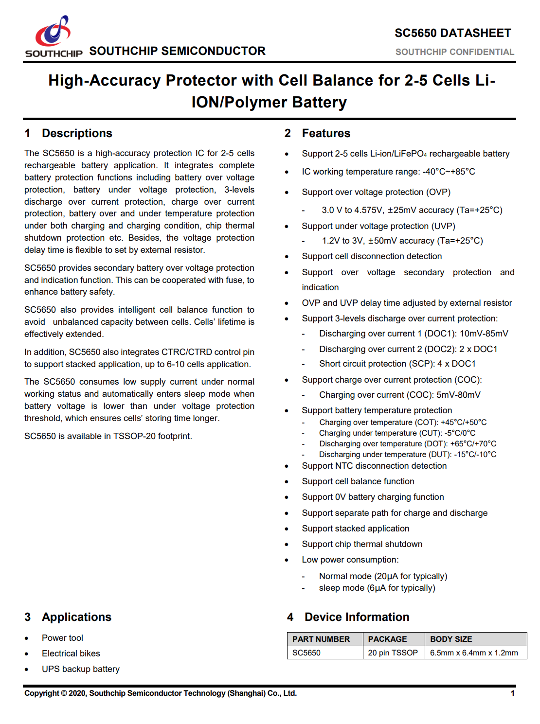

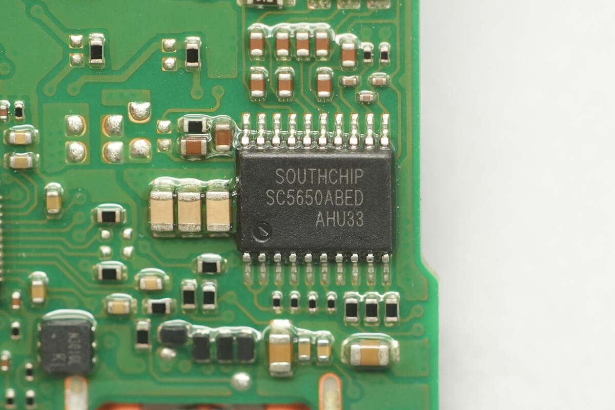

The battery protection chip is from SouthChip, model SC5650. It is designed for 2–5 series battery packs and provides protections including overvoltage, undervoltage, three-level overcurrent during discharge, and overcurrent during charging. It also supports an external NTC thermistor for high/low temperature battery protection and chip overheat shutdown.
The SC5650 supports cascaded applications, allowing two chips to be used for 6–10 series battery packs. It features extremely low quiescent current and high protection accuracy, with multiple variants available to accommodate different voltages and battery types.
Here is the information about SouthChip SC5650.

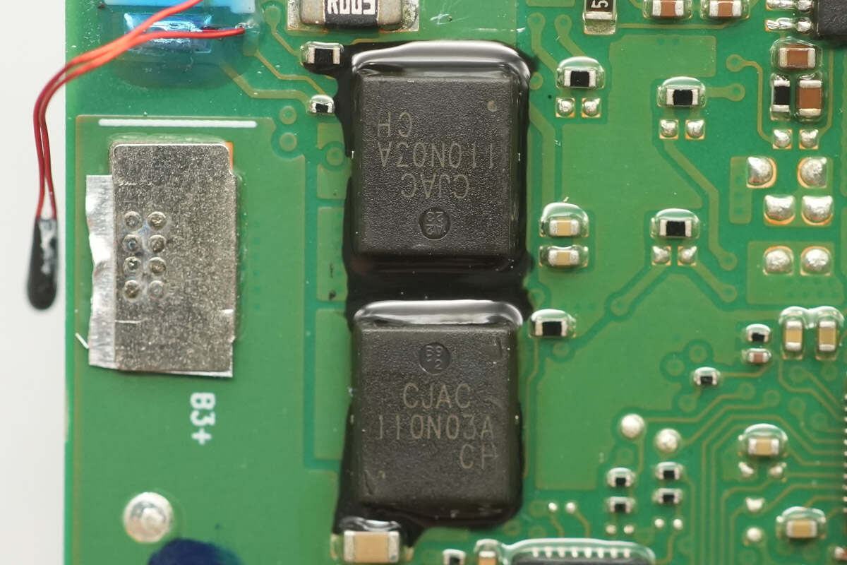

The battery protection MOSFETs are from JSCJ, model CJAC110N03A. They are N-channel MOSFETs with a voltage rating of 30 V and an on-resistance of 1.8 mΩ, packaged in a PDFNK 6 5×6-8L package.

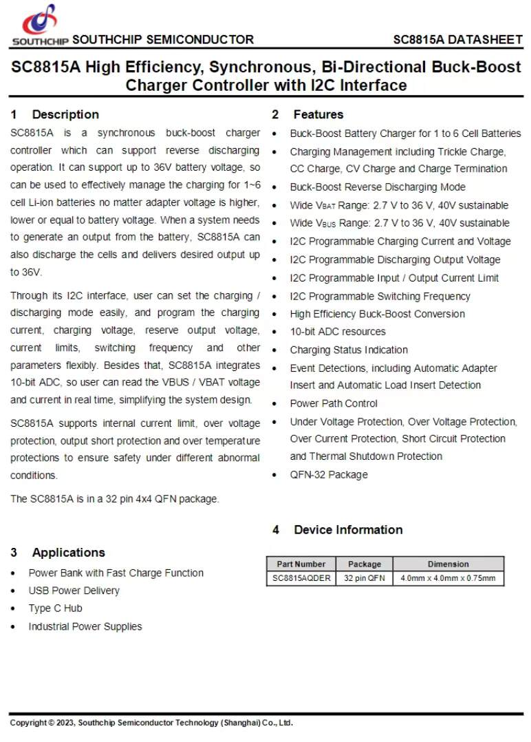

The synchronous buck-boost controllers for both the built-in USB-C cable and the USB-C2 port are SouthChip SC8815A. This is a high-efficiency, bidirectional synchronous buck-boost controller that supports charging 1–6 series battery cells and features an I²C interface. It provides full lithium battery charging management, allowing battery charging current and voltage, reverse discharge output voltage, and input/output current limits to be controlled via the I²C bus.
The SC8815A integrates a 10-bit ADC and provides charging status indication. It supports automatic adapter and load insertion detection, undervoltage protection, overvoltage protection, overcurrent protection, short-circuit protection, and overheat shutdown. The chip comes in a QFN32 package and is suitable for PD fast-charging power banks, USB-C hubs, and industrial power applications.
Here is the information about SouthChip SC8815A.

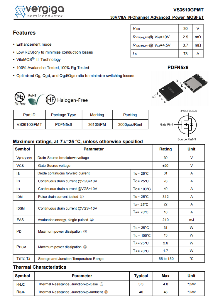

The synchronous buck-boost MOSFETs for the built-in USB-C cable’s buck-boost circuit are from Vergiga, model VS3610GPMT. They are N-channel MOSFETs with a voltage rating of 30 V and an on-resistance of 2.5 mΩ, packaged in a PDFN 5×6 package.
Here is the information about Vergiga VS3610GPMT.

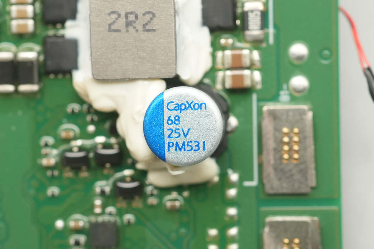

Close-up of the 3.3 μH buck-boost inductor.
The two solid capacitors are from CapXon, each rated at 25 V and 68 μF.

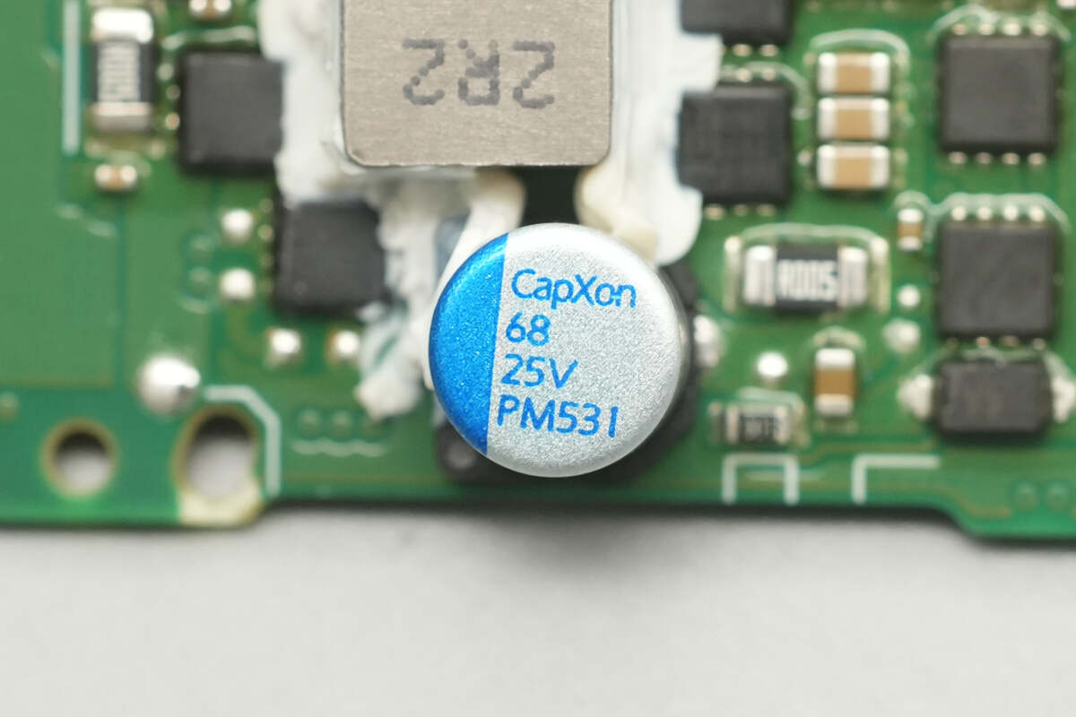

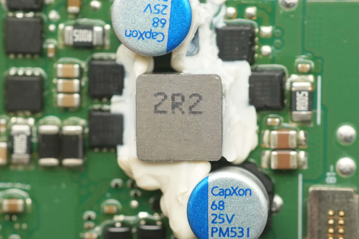

Close-up of the 2.2 μH buck-boost inductor.
The solid capacitor is also from CapXon, rated at 25 V and 68 μF.
The other solid capacitor has the same part number.

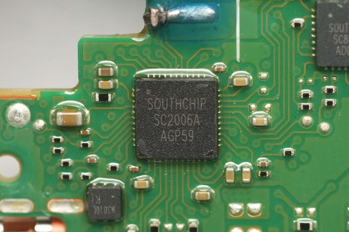

The protocol chip for both the built-in USB-C cable and the USB-C2 port is SouthChip SC2006A, a fast-charging controller that supports three Type-C DRP ports. It is compatible with all major fast-charging protocols and features CC and DPDM interfaces. Its target applications include power banks, car chargers, and power tools.
The SC2006A integrates Type-C/PD circuits, DPDM/UFCS fast-charging circuits, VBUS discharge paths, voltage and current detection, an 11-bit high-performance ADC, two 11-bit DACs, NMOS gate drivers, an I²C interface, and protection circuits, minimizing the need for external components.
The SC2006A features a built-in 32-bit high-performance microcontroller with 128 KB of flash memory and 8 KB of SRAM, offering a cost-effective solution for various applications. It also supports multiple protection mechanisms, including overvoltage, undervoltage, overcurrent, short-circuit, over-temperature, DPDM overvoltage, CC overvoltage, and VCONN overvoltage/overcurrent/short-circuit protections, ensuring stable and reliable system operation.

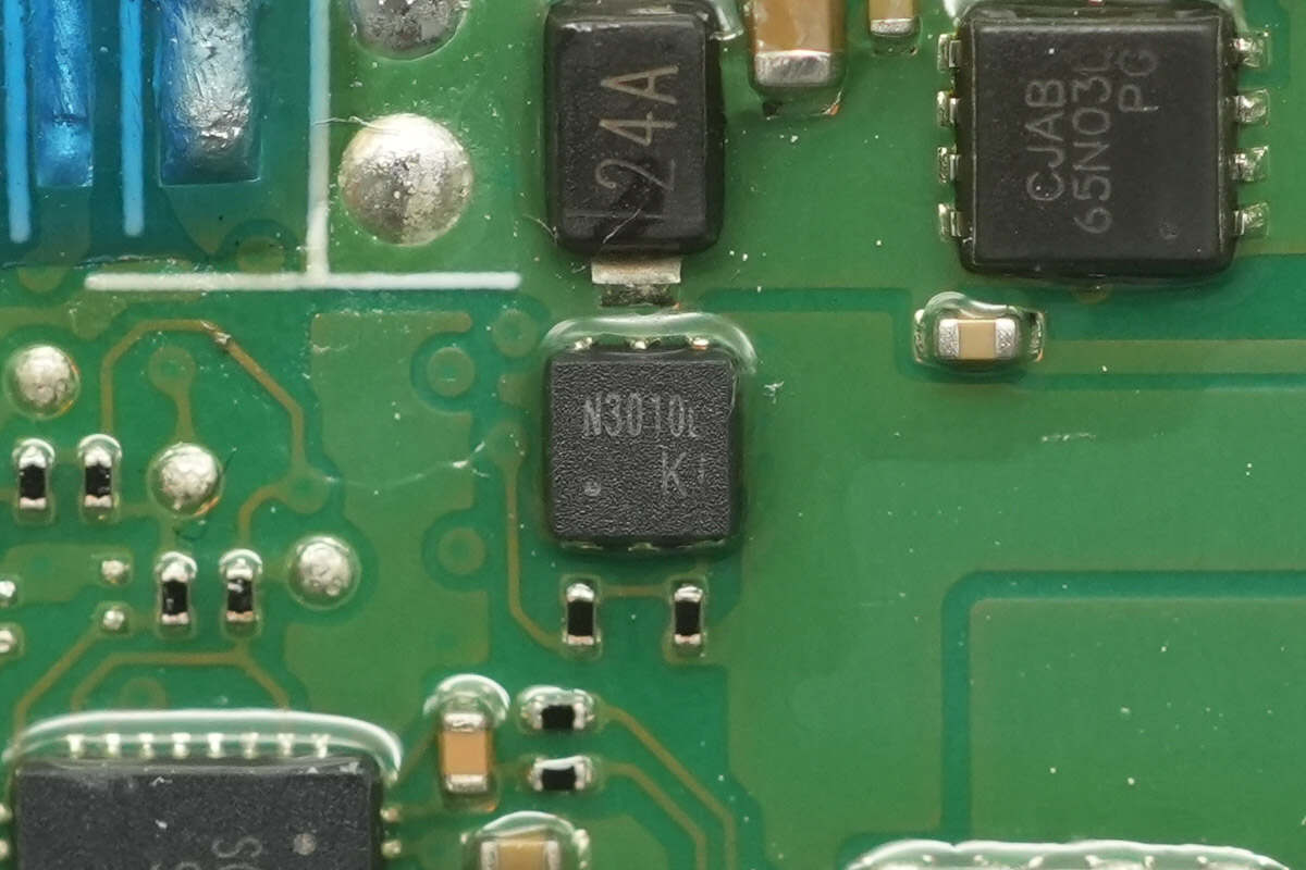

The MOSFET marked with N3010L is from JSCJ, model CJMN3010L. It is an N-channel MOSFET with a voltage rating of 30 V and an on-resistance of 8.3 mΩ, packaged in a DFNWB 2×2-6L package.

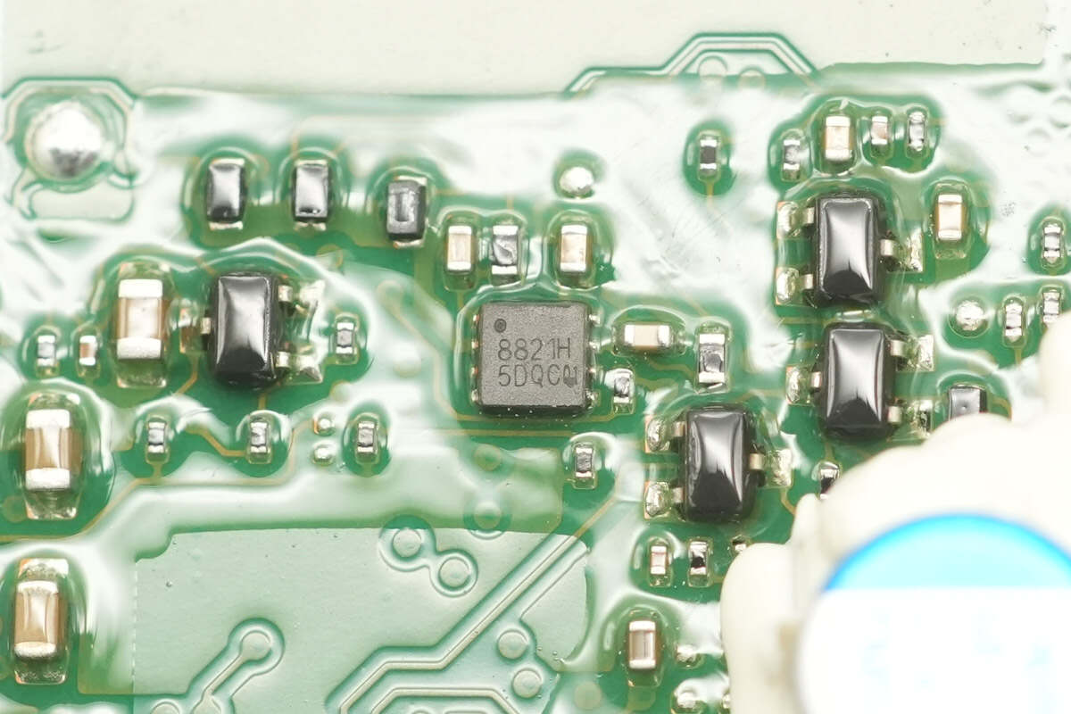

The E-Marker chip, marked with 8821H, is packaged in a DFN-8.

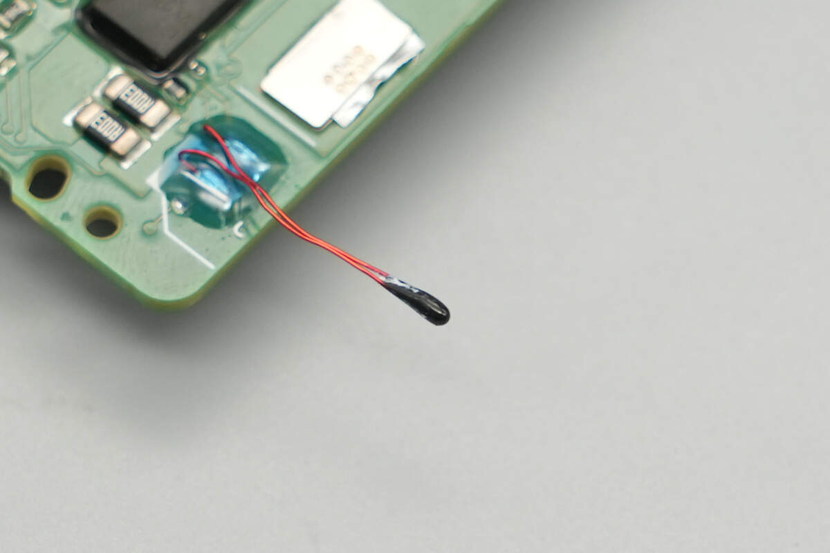

Close-up of the thermistor.

CapXon solid capacitors are used, and both the capacitors and inductors are reinforced with adhesive. The front and back of the PCB are coated with conformal coating to protect the chips. Graphite thermal tape and copper foil are applied to the casing to assist heat dissipation, indicating high-quality materials and workmanship.
