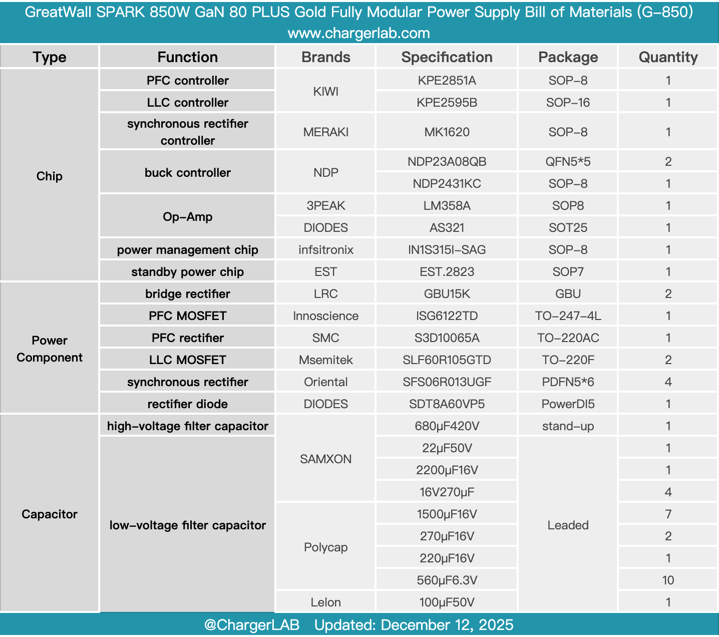

GreatWall has launched the SPARK GaN 850W fully modular power supply. It features a fully modular design, comes with a 7-year warranty, and is certified 80 PLUS Gold for energy efficiency. The unit complies with the Intel ATX 3.1 power supply specification and is equipped with a native PCIe 5.1 connector. It provides a single 12V rail with a high current output of up to 70.8A, meeting the power demands of high-performance PC configurations.
The power supply adopts a mainstream high-efficiency topology consisting of active PFC, half-bridge LLC resonance, synchronous rectification, and DC-to-DC conversion. It integrates Innoscience GaN power ICs, enabling a significant generational leap in both performance and energy efficiency. Next, let’s take a closer look at its internal components and design.

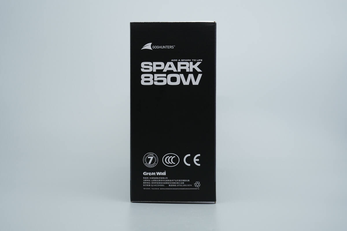

The top of the packaging is printed with “SPARK” and “GaN,” while the bottom displays “850W,” the 80 PLUS Gold certification logo, and the ATX 3.1 and PCIe 5.1 markings.
Teardown of GreatWall SPARK 850W GaN 80 PLUS Gold Fully Modular Power Supply (G-850)-Chargerlab
The top of the packaging box is printed with the “SPARK 850W” branding.

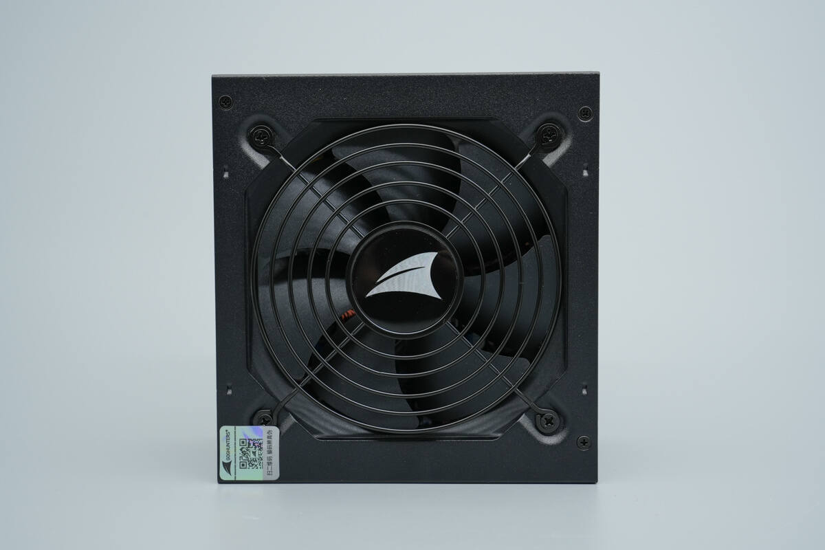

The cooling fan on the top is equipped with a protective grille.

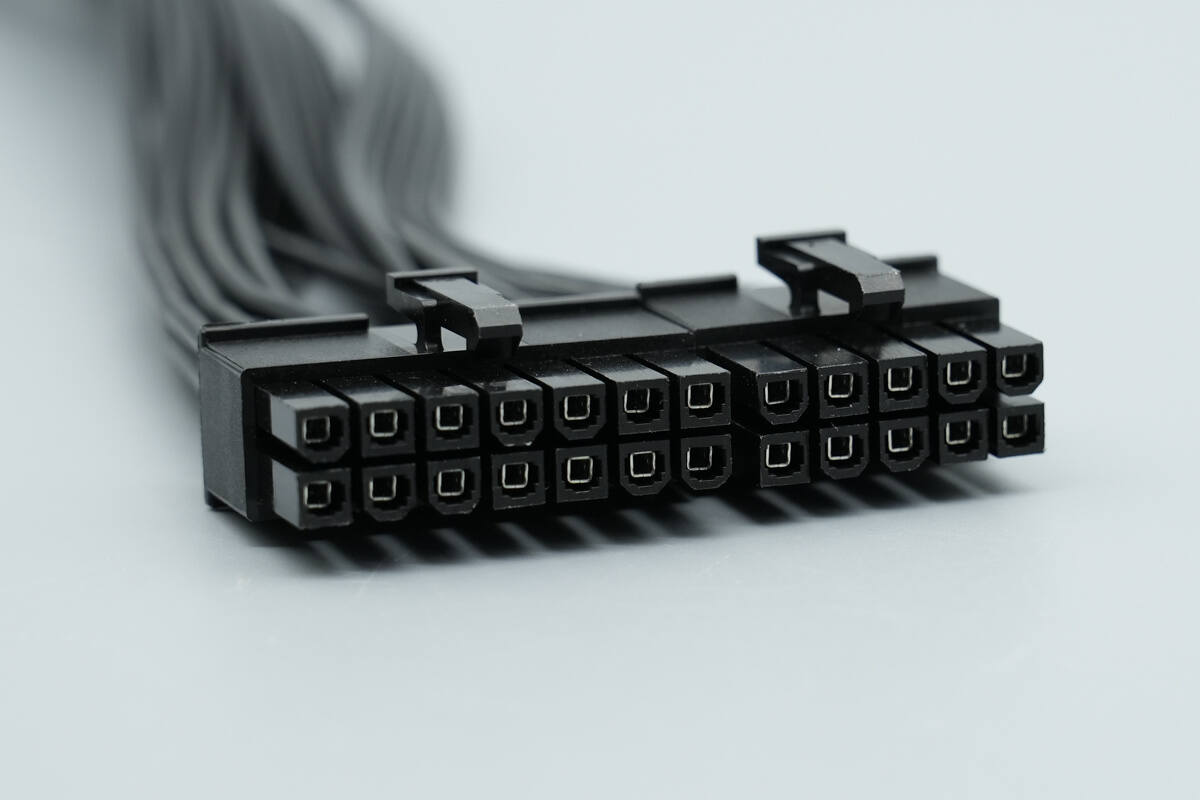

Overview of the 24-pin connector on the power supply.
Overview of the 24-pin connector on the motherboard end.

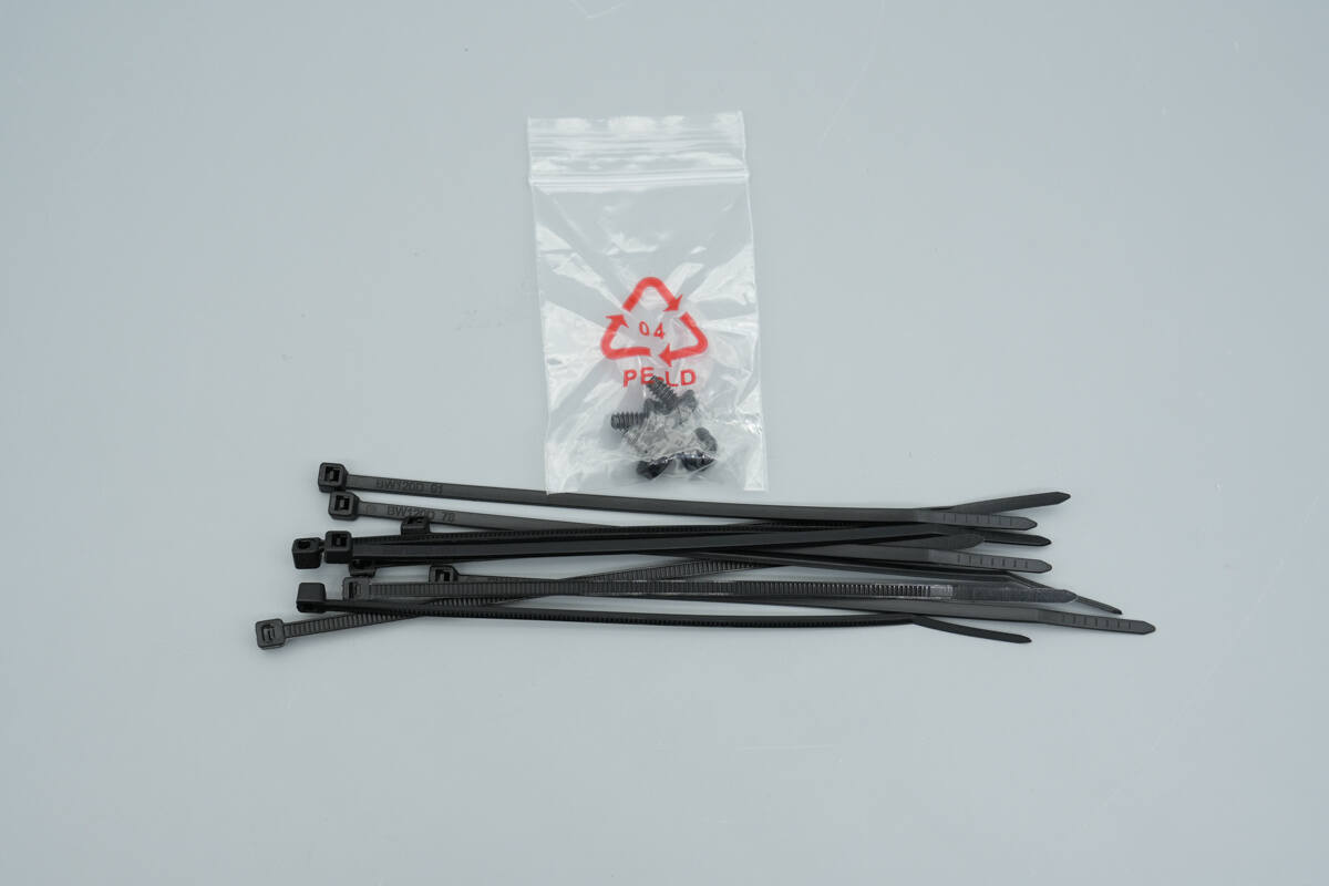

Close-up of the included mounting screws and cable ties.

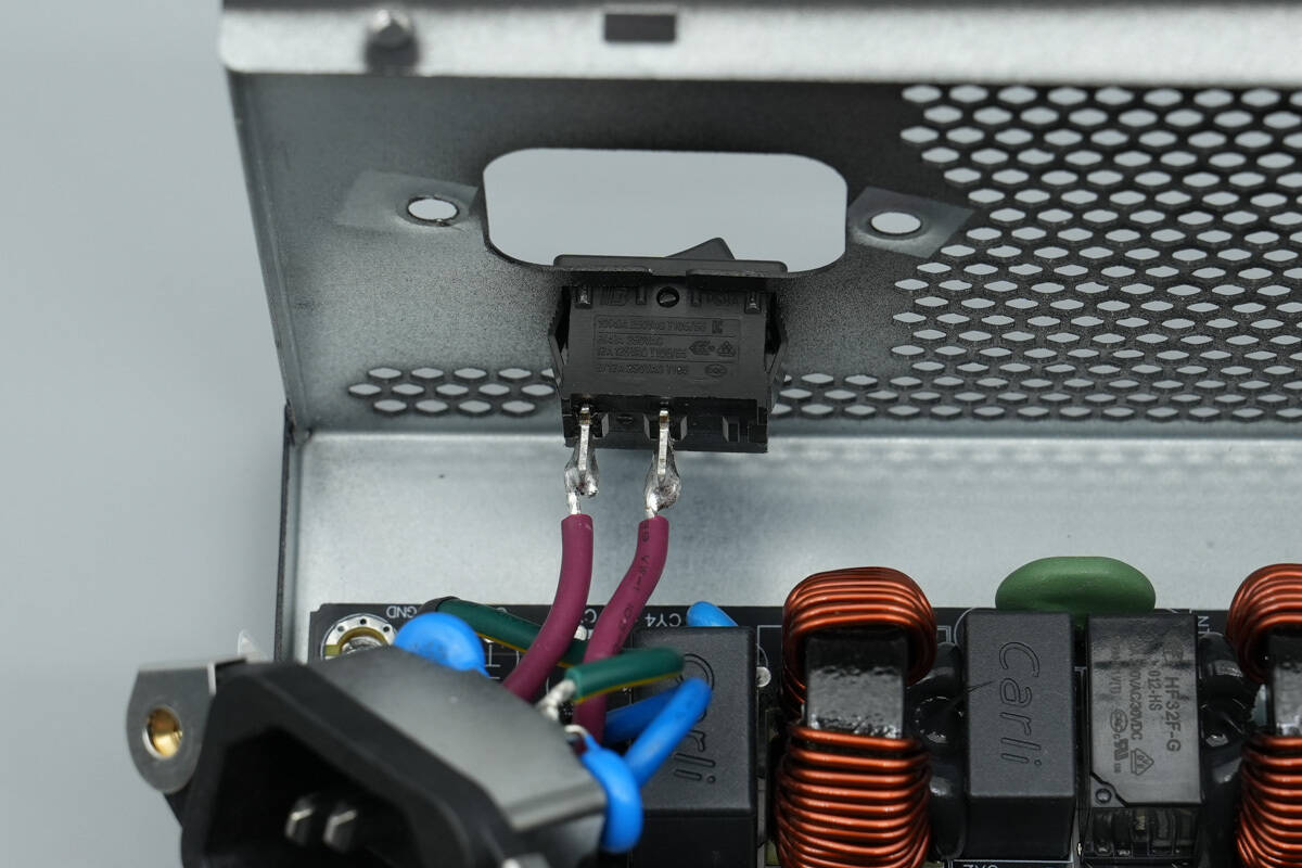

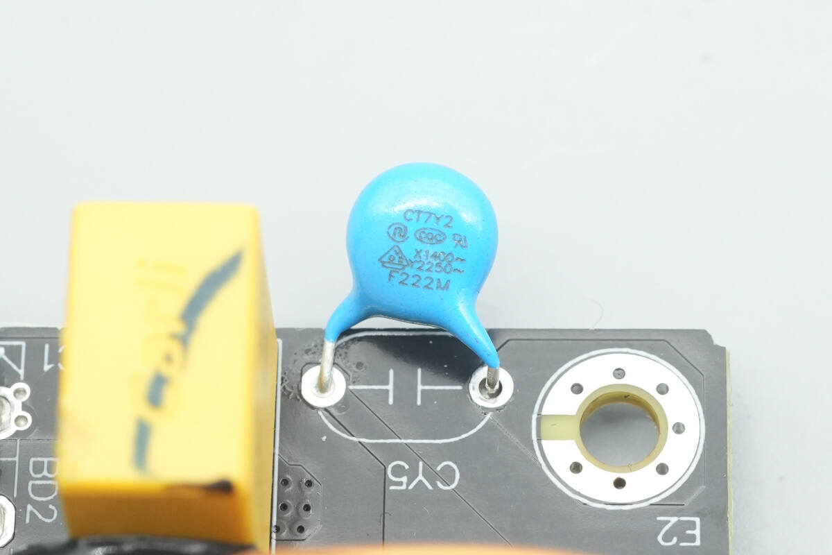

The power input socket is soldered in place, with blue Y capacitors also soldered.
The power switch is also soldered in place.

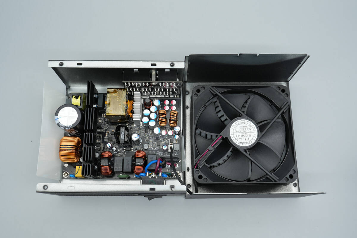

Remove the PCBA module. The interior of the casing is lined with Mylar insulation sheets.
The area corresponding to the synchronous rectifier is equipped with yellow thermal pads.

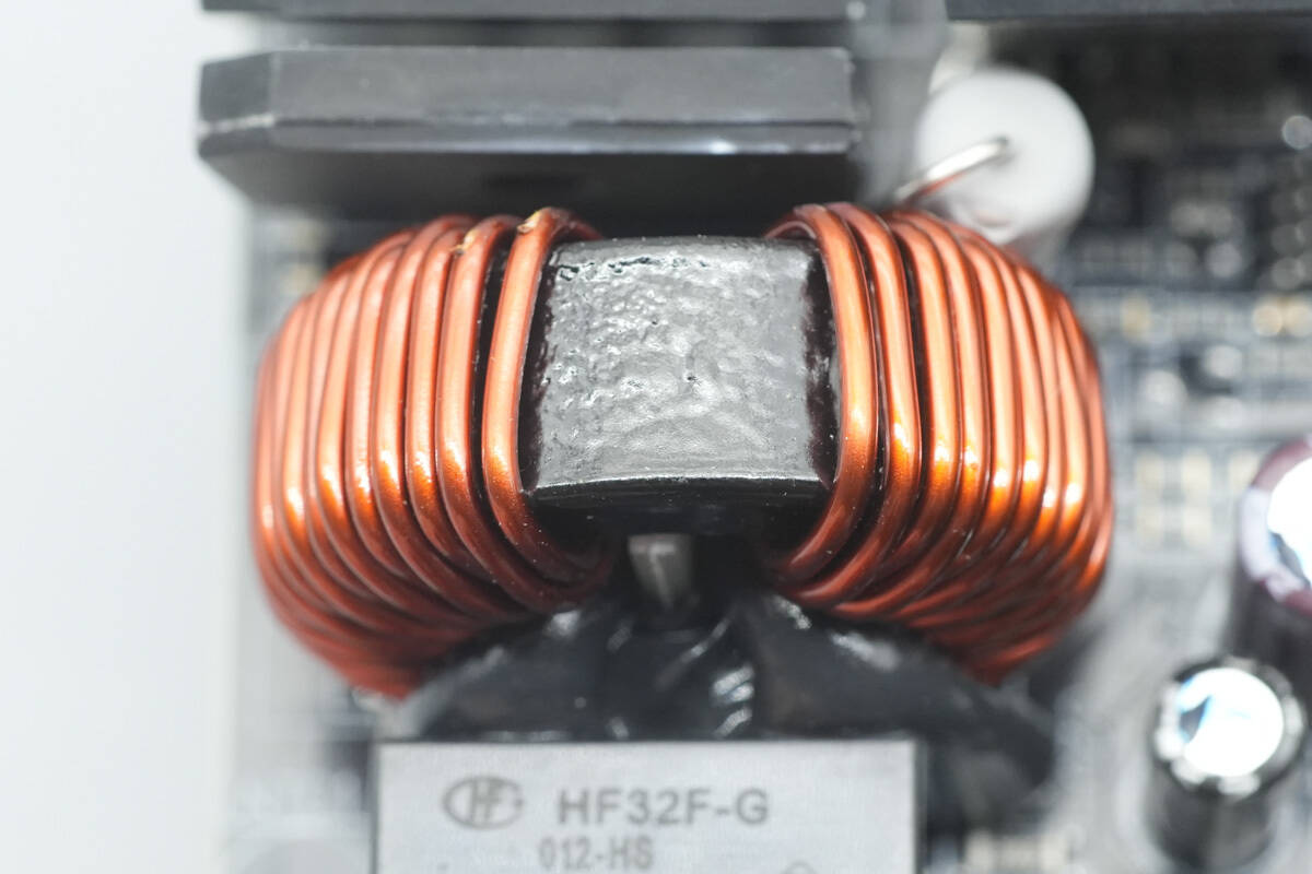

The common mode choke is wound with enameled wire, and an insulating phenolic board is installed at the bottom.

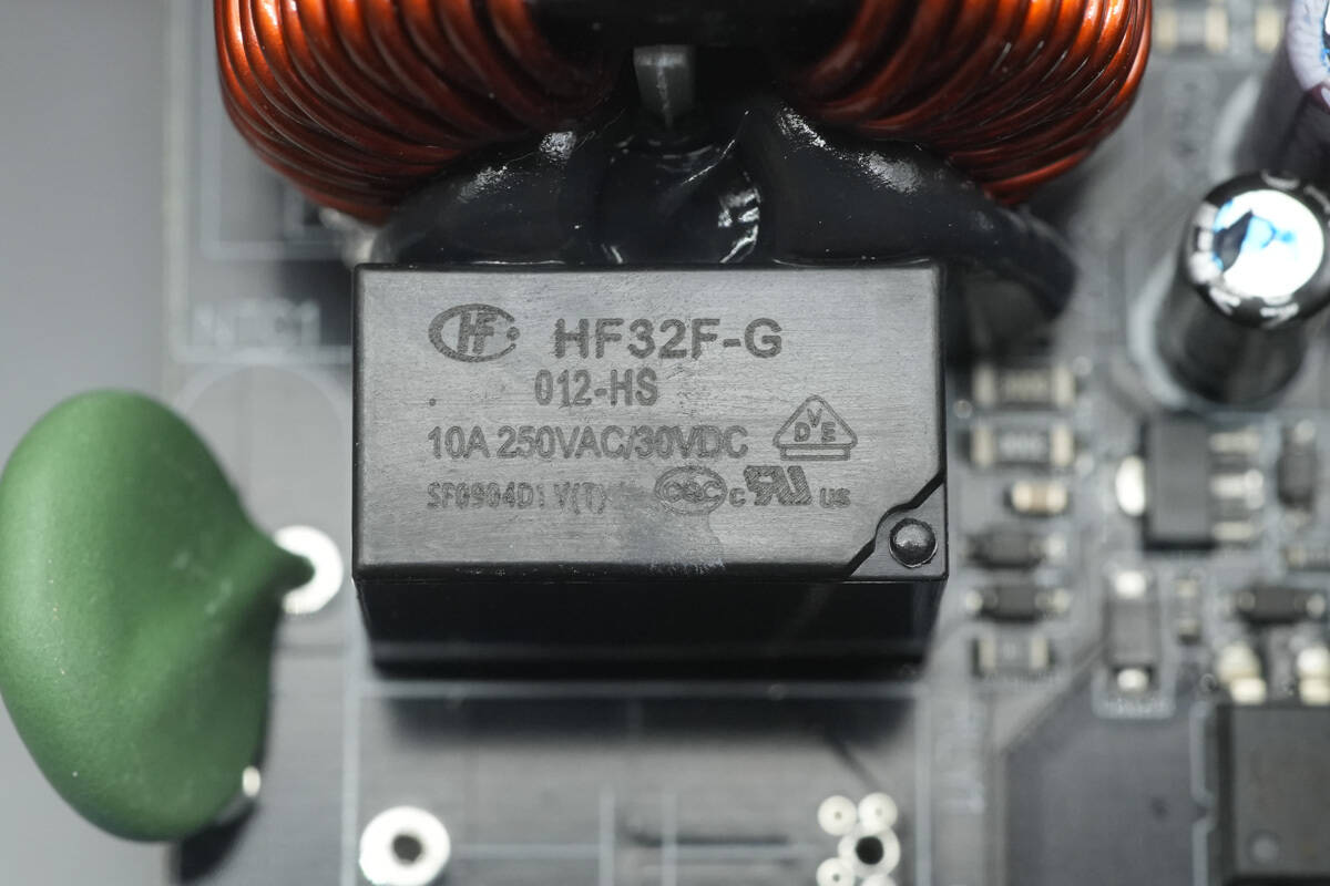

The relay is from HONGFA, model HF32F-G/012-HS. It is an ultra-compact, medium-power relay featuring a single normally open contact, with a contact switching capacity of 10A and a coil voltage of 12V.

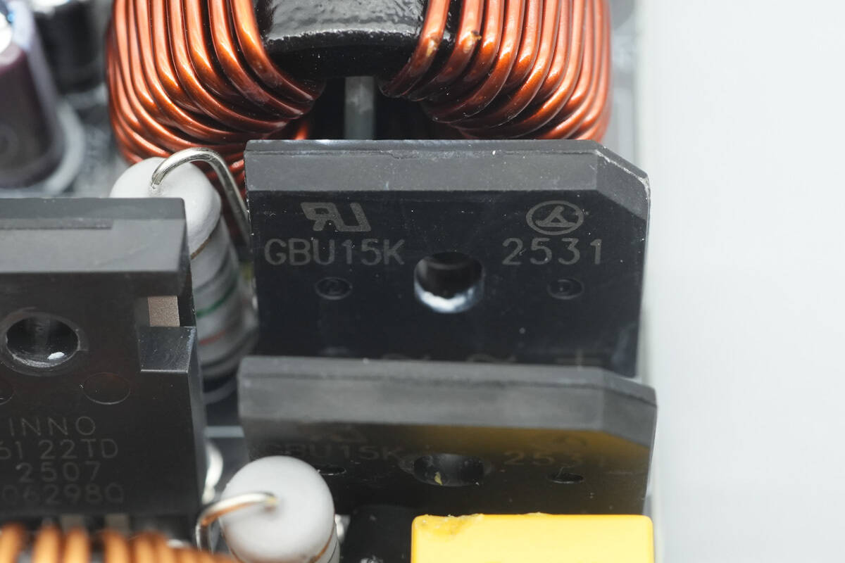

The bridge rectifier is from LRC, model GBU15K, rated at 800V 15A, and comes in a GBU package.
The other bridge rectifier has the same model, and the two bridge rectifiers are connected in parallel to share heat dissipation.

Close-up of the blue Y capacitor.

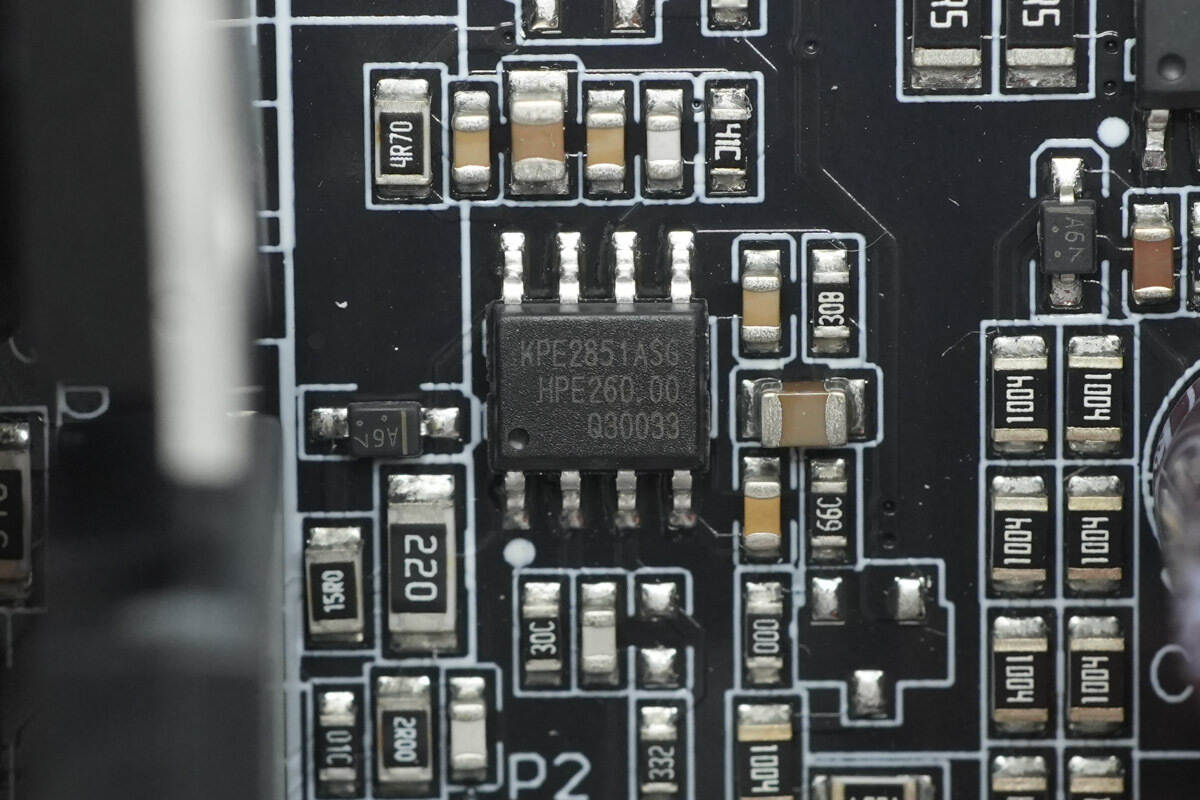

The PFC controller is from Kiwi Instruments, model KPE2851A. It is a high-performance boost PFC controller that operates in CCM mode, offering high power factor, low current distortion, and excellent voltage regulation. The chip features comprehensive protection functions, including VDD over-/under-voltage protection, input under-voltage protection, output over-/under-voltage protection, cycle-by-cycle overcurrent protection, cycle-by-cycle overload protection, current-sense resistor open-circuit protection, and over-temperature protection. It comes in an SOP-8 package.

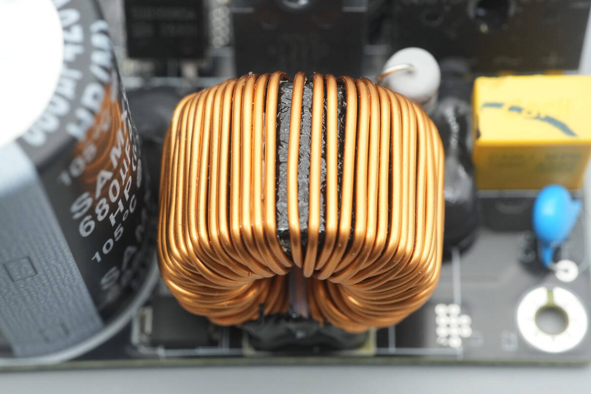

The PFC boost inductor is wound with enameled wire, with an insulating phenolic board installed at the bottom.

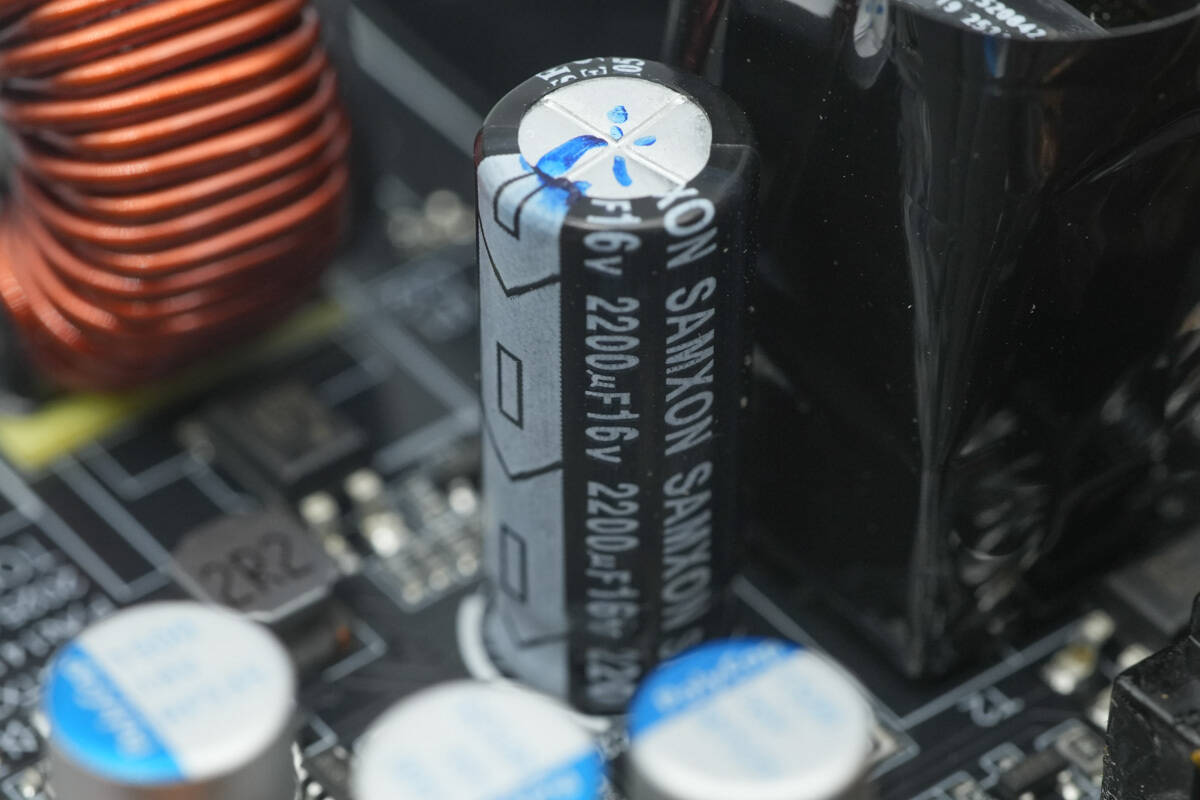

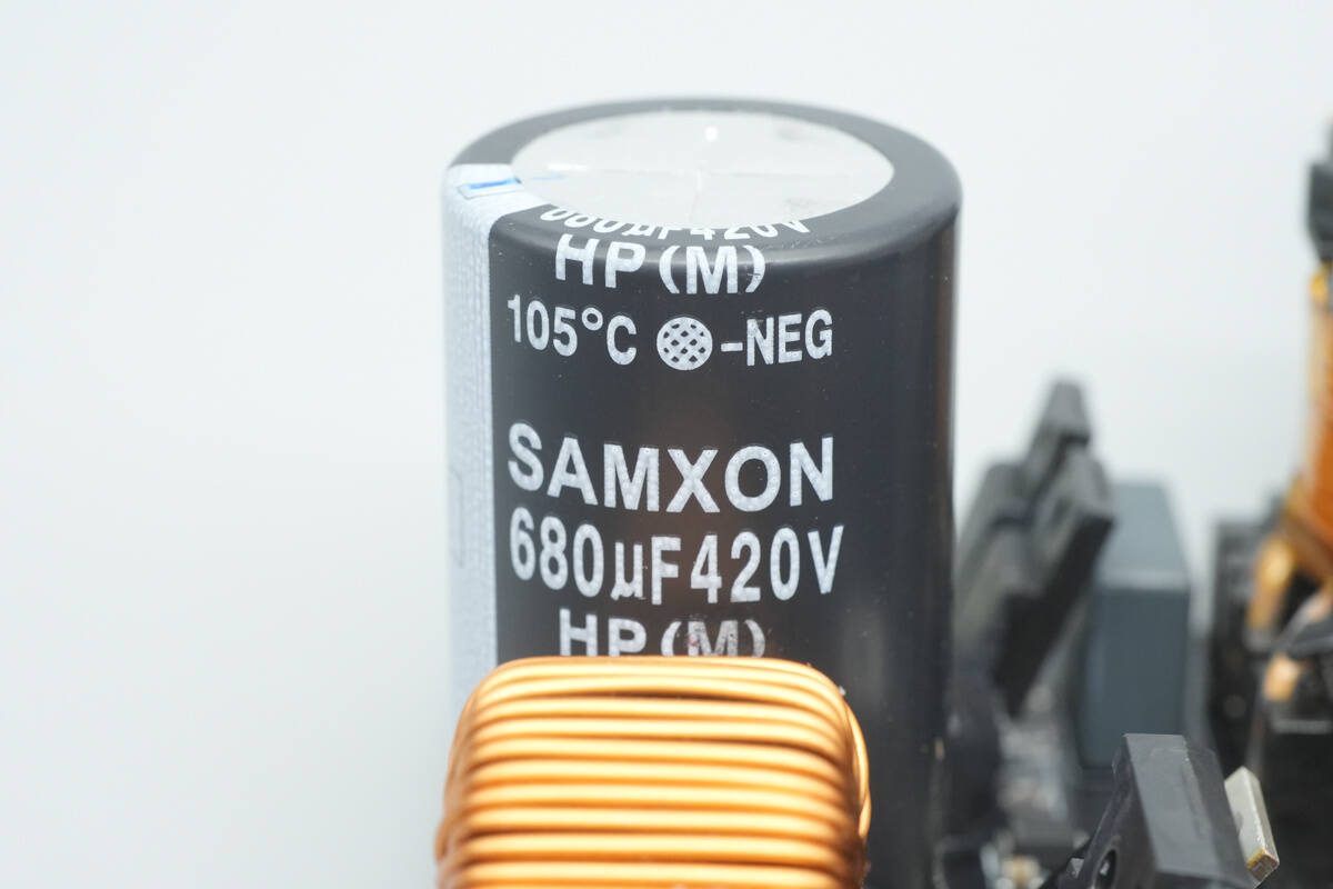

The high-voltage filter capacitor is from SAMXON, part of the HP series of wide-temperature electrolytic capacitors, rated for 105 °C operation, with a specification of 680 µF 420 V.

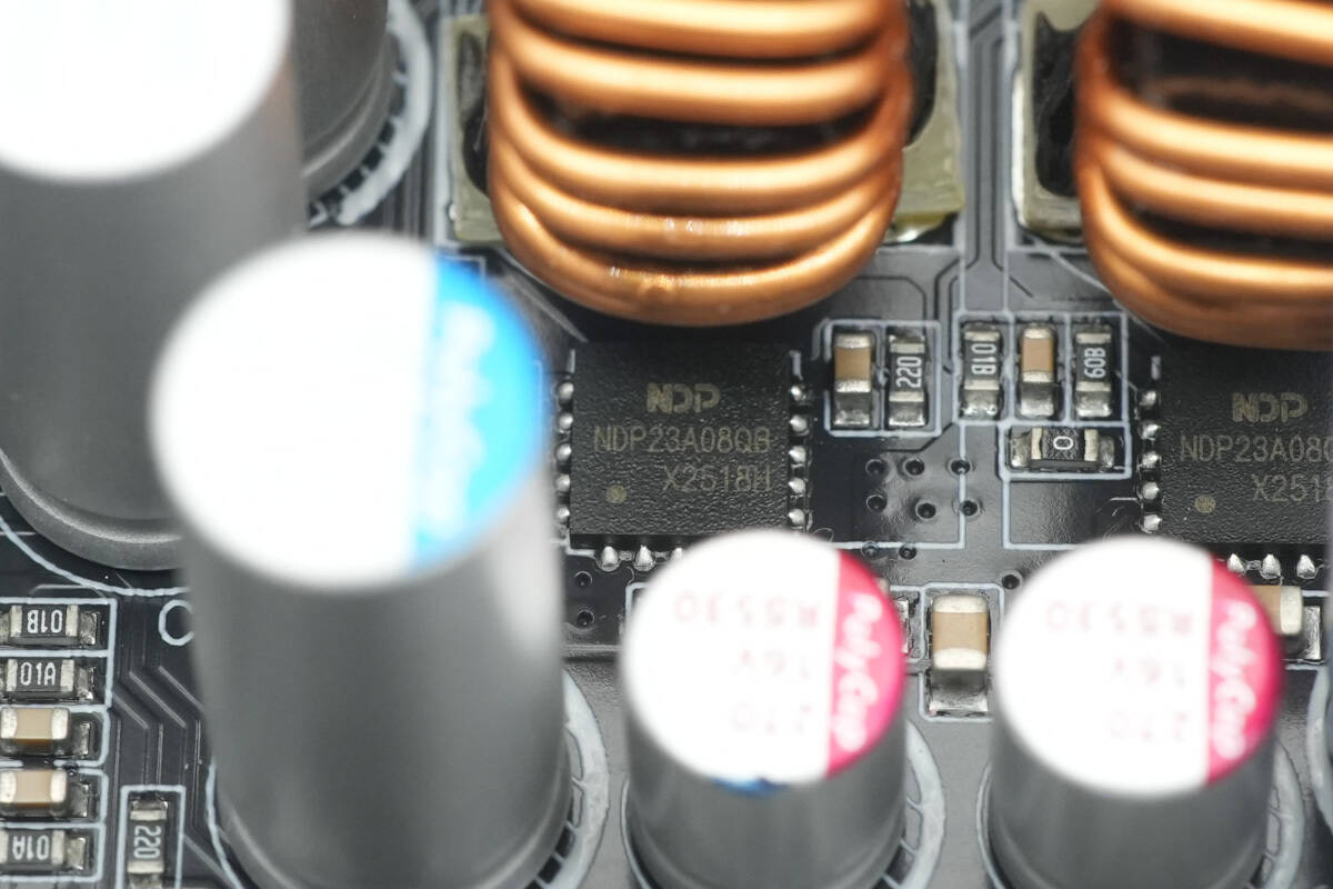

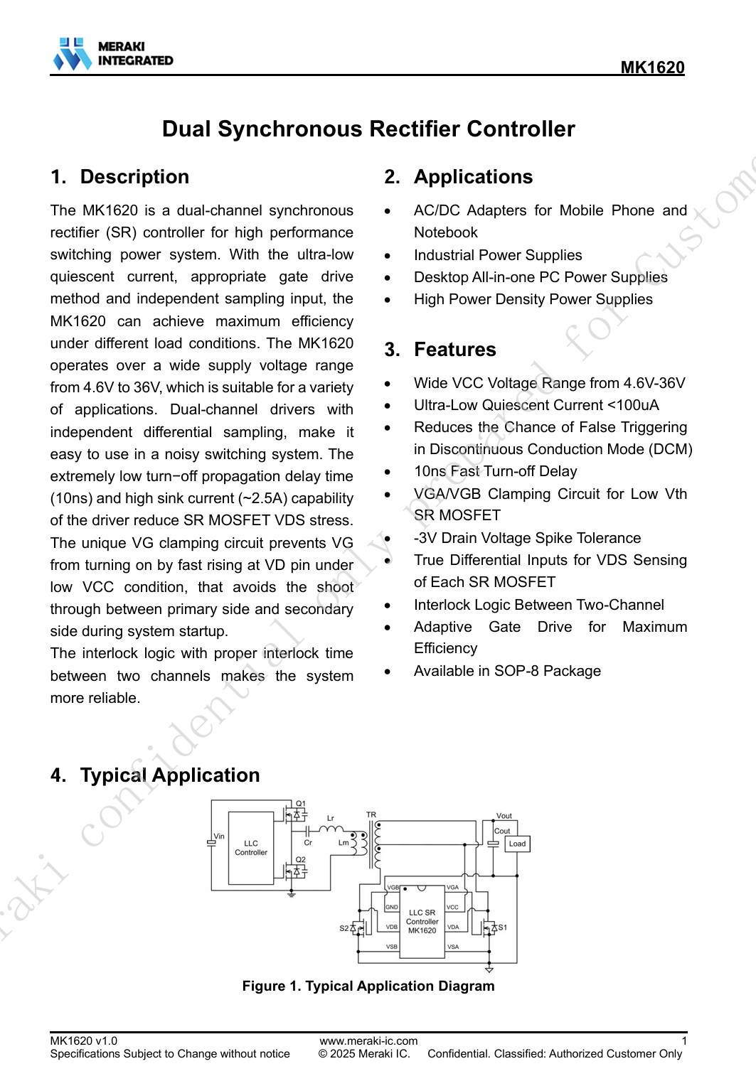

The LLC controller is from Kiwi Instruments, model KPE2595B. It is a half-bridge LLC controller with integrated high-voltage startup, operating in current-mode control and featuring a 650 V-rated half-bridge driver that supports switching frequencies up to 750 kHz. The chip includes adaptive dead-time control and provides a PowerGood signal output.
Internally, the KPE2595B integrates VDD over/under-voltage protection, VBT under-voltage protection, input under-voltage protection, cycle-by-cycle overcurrent protection, capacitor-mode regulation, overload protection, output over-voltage protection, output short-circuit protection, external over-temperature protection, and internal chip over-temperature protection. It comes in an SOP-16 package and is suitable for desktop, industrial, and server power supply applications.
Here is the information about Kiwi Instruments KPE2595B.

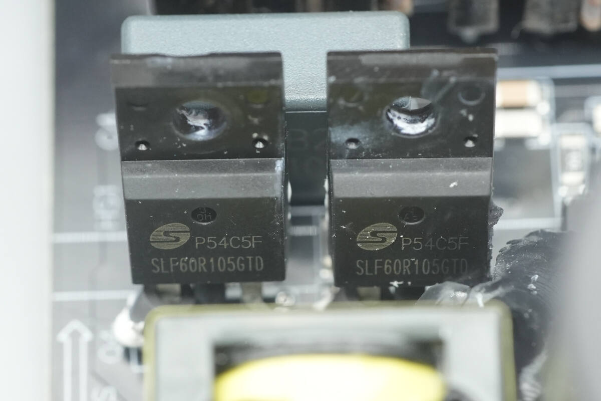

The LLC MOSFETs are from Msemitek, model SLF60R105GTD. They are NMOS devices rated for 600 V with an on-resistance of 93.5 mΩ, and come in a TO-220F package.

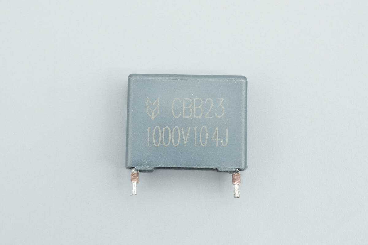

The resonant capacitor is rated at 0.1 µF 1000 V.

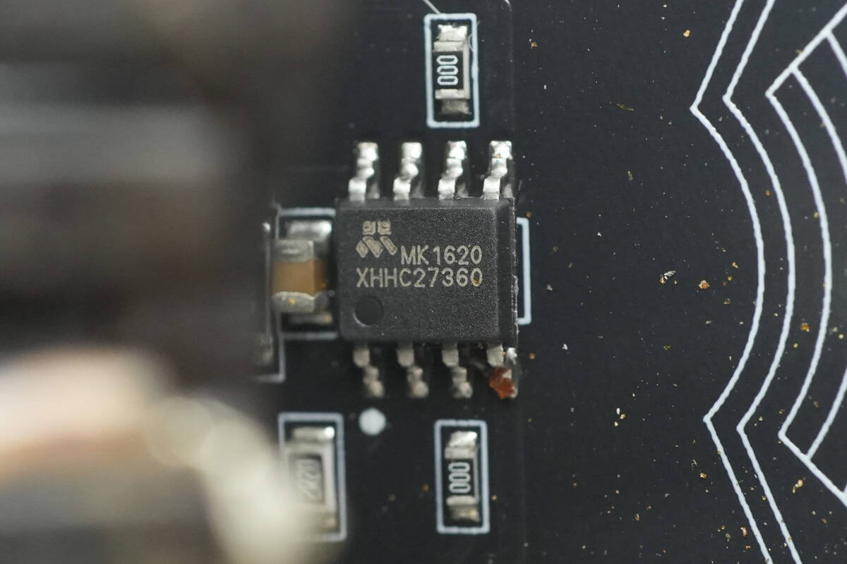

The synchronous rectifier controller is from Meraki, model MK1620. It is a dual-channel controller designed for LLC resonant topology. The chip supports a wide VCC supply range of 4.6–36 V and features ultra-low quiescent current. It provides a 10 ns fast turn-off propagation delay, includes a clamping circuit, supports dual-channel VDS differential input detection, dual-channel logic interlock, and adaptive drive control. The device comes in an SOP-8 package.

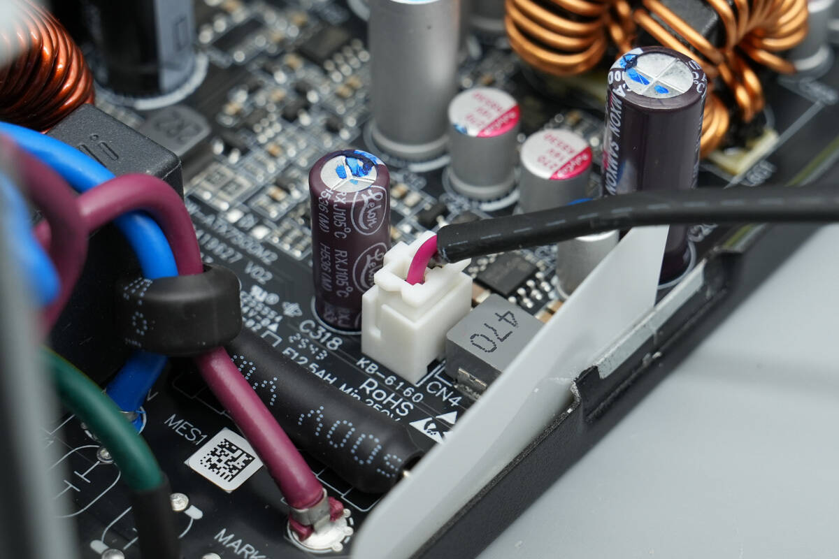

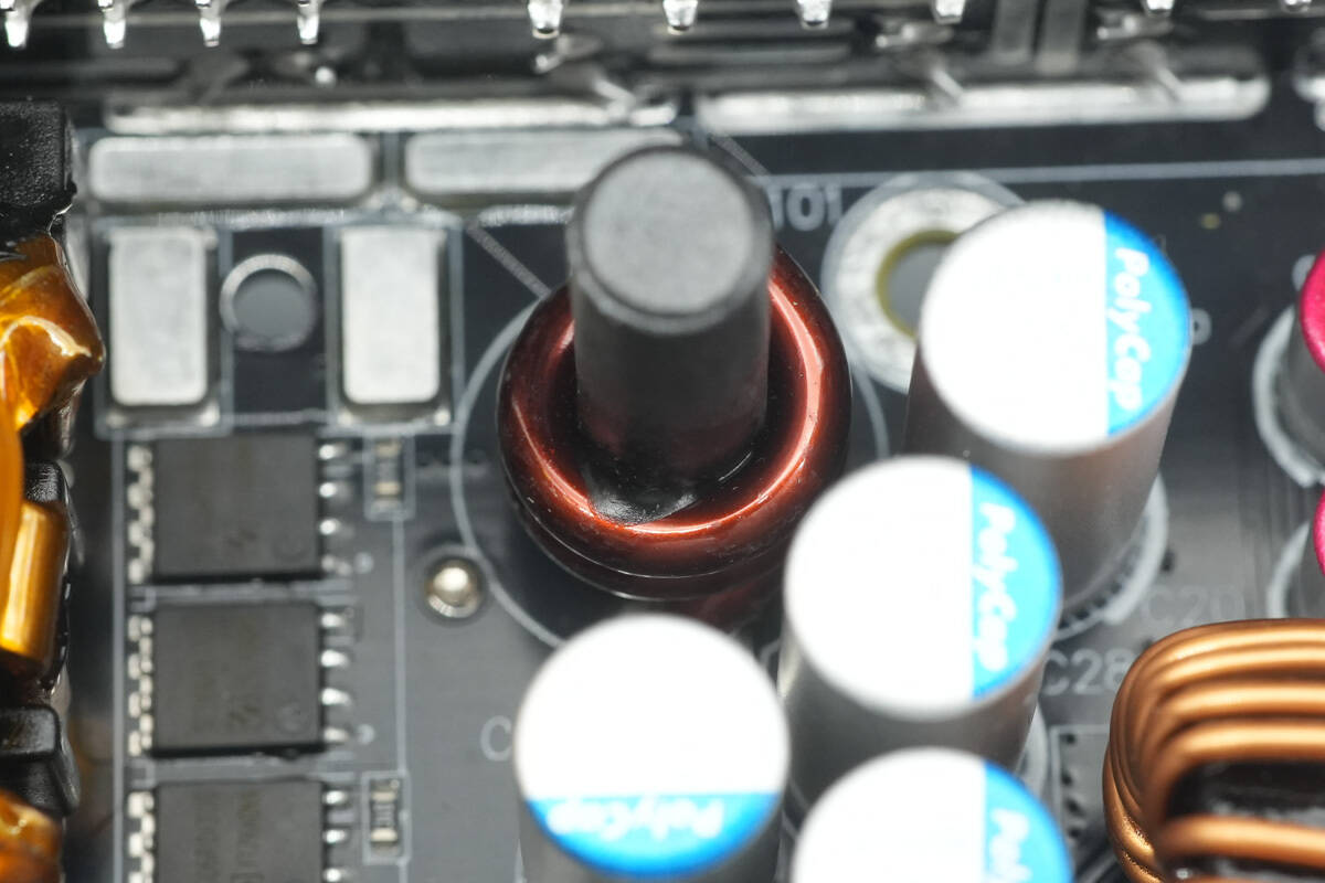

The filter capacitors are from PolyCap, part of the RF series of solid-state capacitors. They feature a long lifespan of 5000 hours and high-frequency, low-impedance characteristics. Each capacitor is rated at 1500 µF 16 V, and seven units are connected in parallel.

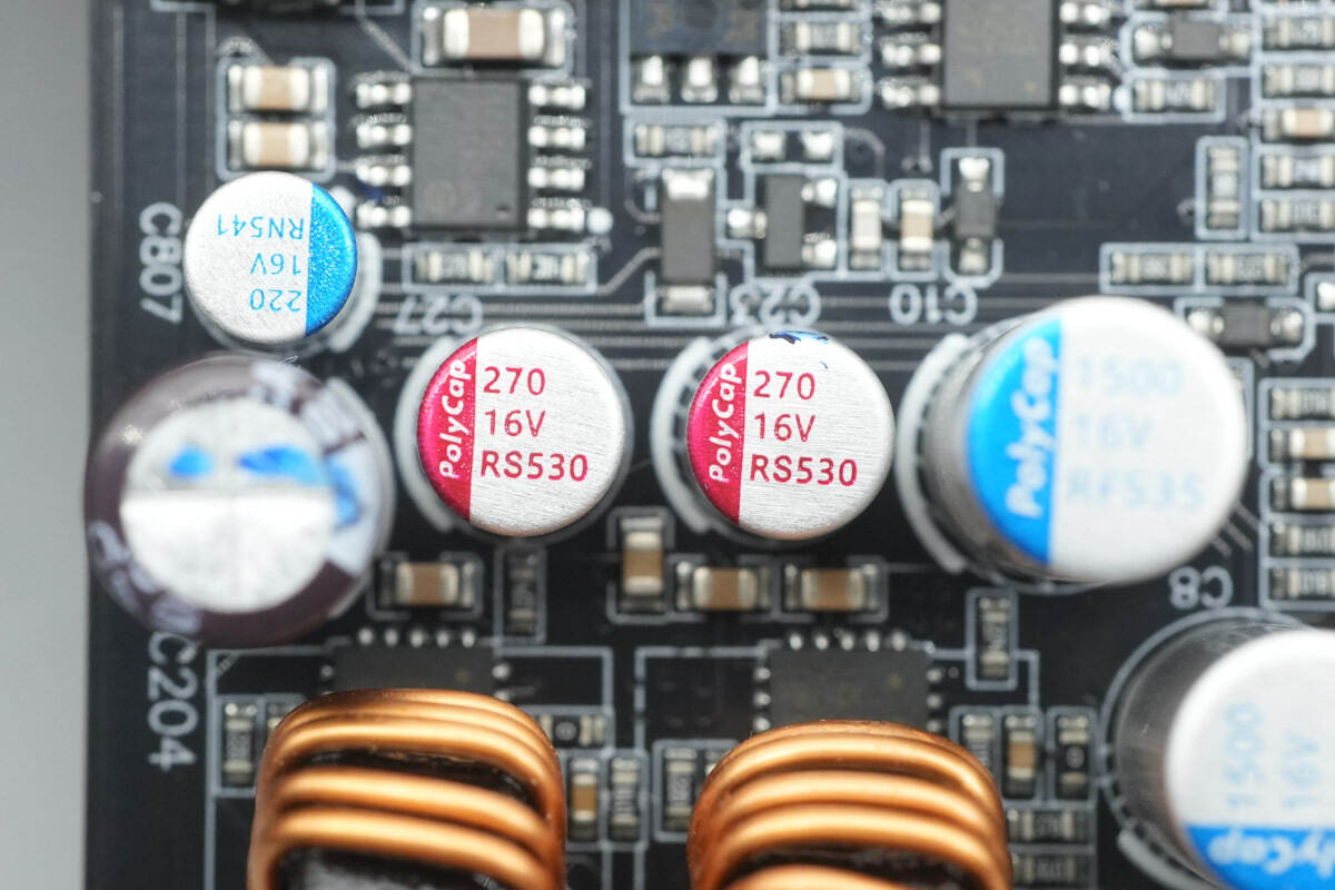

The two filter capacitors are from PolyCap, part of the RS series of solid-state capacitors, each rated at 270 µF 16 V.

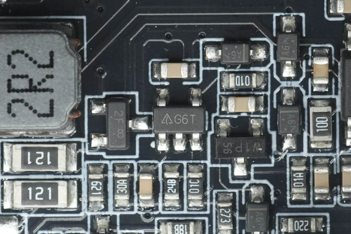

The operational amplifier is from DIODES, marked G6T, model AS321. It is a low-power single op-amp and comes in a SOT-25 package.

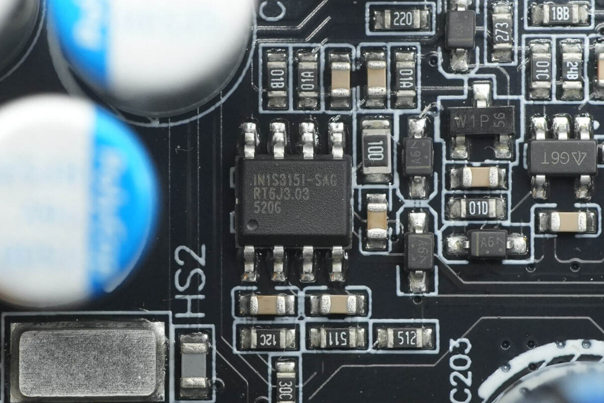

The power management chip is from Infsitronix, model IN1S315I-SAG. It provides over-voltage and under-voltage protection for 3.3 V, 5 V, and 12 V rails, and comes in an SOP-8 package.

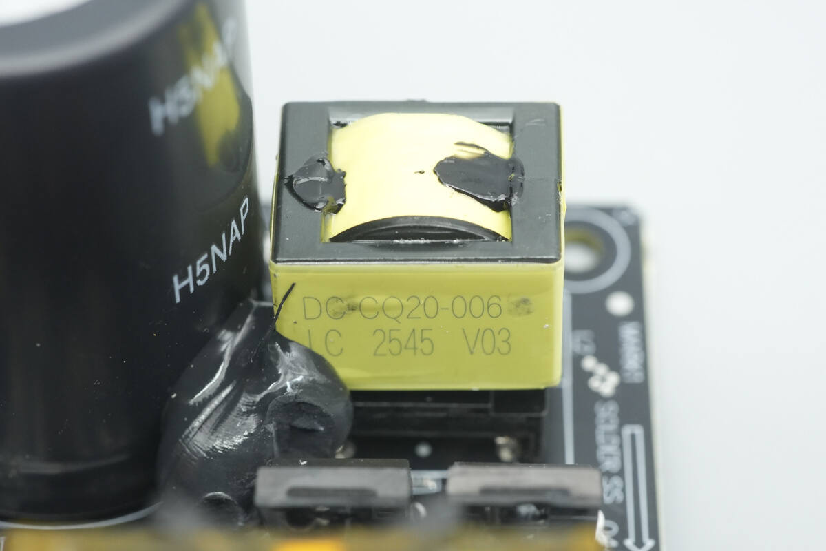

The standby power transformer is tightly wound and insulated with tape.

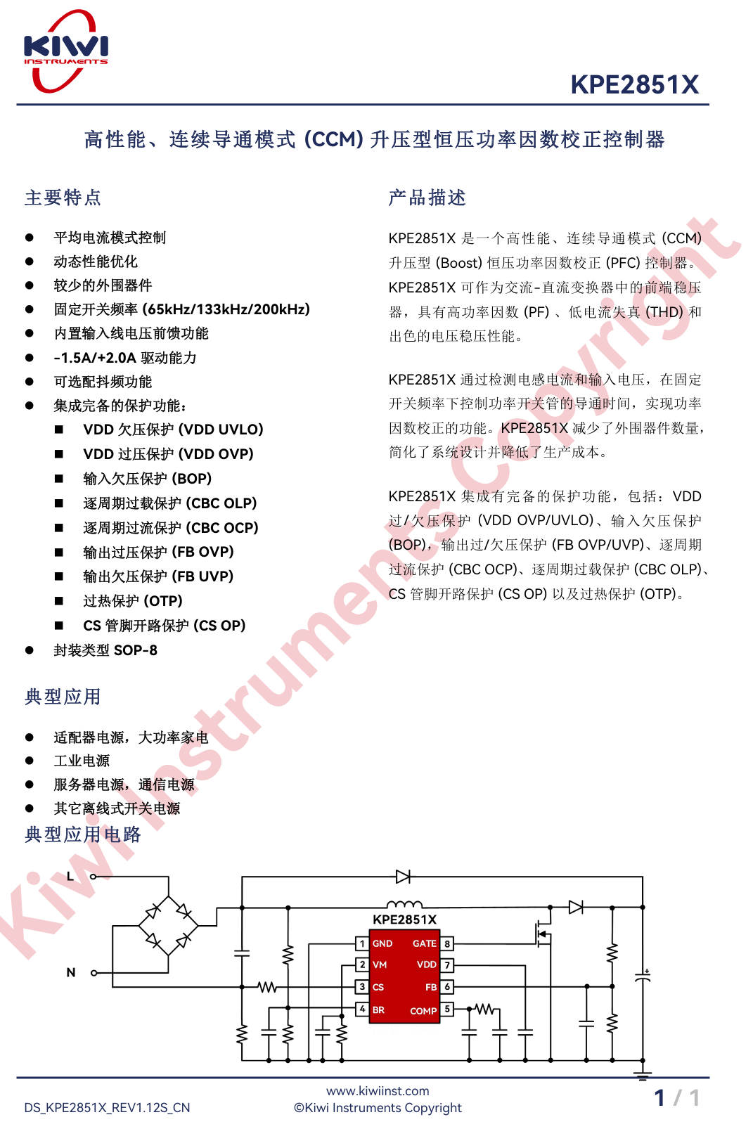

After taking it apart, we found that it uses a Kiwi Instruments KPE2851A PFC controller paired with a KPE2595B LLC controller. The PFC MOSFET employs Innoscience ISG6122TD GaN-on-Si chip, the PFC rectifier uses SMC S3D10065A SiC diodes, and the LLC MOSFETs are Msemitek SLF60R105GTD.
