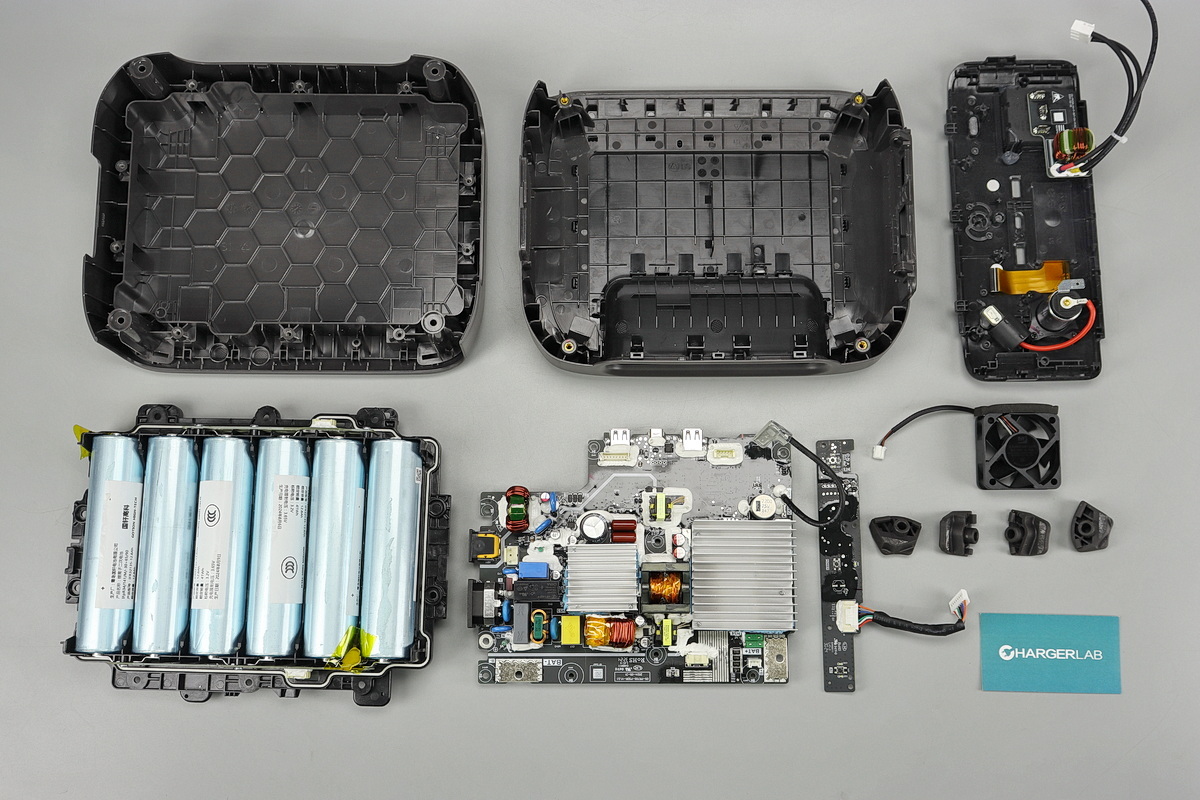

First remove the non-slip pads at the four corners and unscrew the internal fixing screws.
Teardown of ECOFLOW RIVER 3 300W 245Wh GaN Power Station (EFR705)-Chargerlab
Open the cover, there is a bidirectional inverter module inside and a cooling fan on the left.

Unscrew the fixing screws and remove the PCBA module. The bottom is the battery pack with an information label attached.
Model is: EFR705-NZ

Unscrew the fixing screws and remove the battery pack from the shell. The battery pack is fixed with double-sided foam tape, and there are hexagonal reinforcement ribs inside the shell.
The battery pack is composed of six lithium-iron phosphate batteries connected in series.
The batteries are insulated by plastic frames.
The battery pack sealing rubber rings are used to prevent dust and water.
The lithium iron phosphate batteries are from Gotion High-tech. The nominal voltage is 3.2V, the charging limit voltage is 3.65V, the rated capacity is 12.8Ah, and the rated energy is 41Wh. Model is IFR32135-12.8Ah.

The front of the bidirectional inverter module has the positive and negative terminals of the battery pack and the fuse. There is a large heat sink on the left side to dissipate heat for the MOSFET. There is a transformer on the right side of the heat sink. There are heat sinks, filter inductors, filter capacitors, and relays for switching input and output on the right side of the transformer. There is an AC input interface and a DC input interface on the right side.
On the back are components such as a current detection chip, digital isolator, master control chip, battery protection chip, GaN power chip, GaN FET, etc.
Unscrew the fixing screws of the heat sinks. The back of the heat sinks are coated with blue thermal gel.
The battery input end has components such as a fan interface, fuse, battery cell voltage sampling socket, and current detection resistor.
Two fuses are connected in parallel for overcurrent protection at the battery end. 30A.
These four resistors are connected in parallel. 470Ω.
The sampling resistor is used to detect the battery current. 0.5mΩ.
On the left side of the low-voltage circuit are the master control chip and battery protection chip. On the right side of the master control chip is the current sampling chip and protocol chip. In the middle are the synchronous buck-boost converter and synchronous buck converter, as well as the corresponding SMD inductor.

Well, those are all components of the ECOFLOW RIVER 3 300W 245Wh GaN Power Station.
Here is the component list of the ECOFLOW RIVER 3 300W 245Wh GaN Power Station for your convenience.
The ECOFLOW RIVER 3 power station has a built-in 245Wh lithium iron phosphate battery. Its built-in bidirectional inverter module supports 300W charging power and 300W output power. The upgraded drive supports 600W power. It also supports DC input and can be charged with solar panels or car chargers. The USB-C port supports 100W PD fast charging. There is an LCD screen on the side to facilitate information such as remaining usage time, remaining power, and input and output power.
After taking it apart, we found it uses a modular design, the battery pack is dustproof and waterproof, with IP54 protection. The battery pack uses six strings of lithium-iron phosphate batteries. The batteries are connected by nickel strip spot welding, and a thermistor is set to detect the temperature.
It has a bidirectional inverter circuit, battery protection circuit, and fast charging circuit, realizing all functions. The PCBA module is covered with conformal coating and thermal conductive adhesive to prevent moisture and dust from affecting it and ensure operational reliability.
