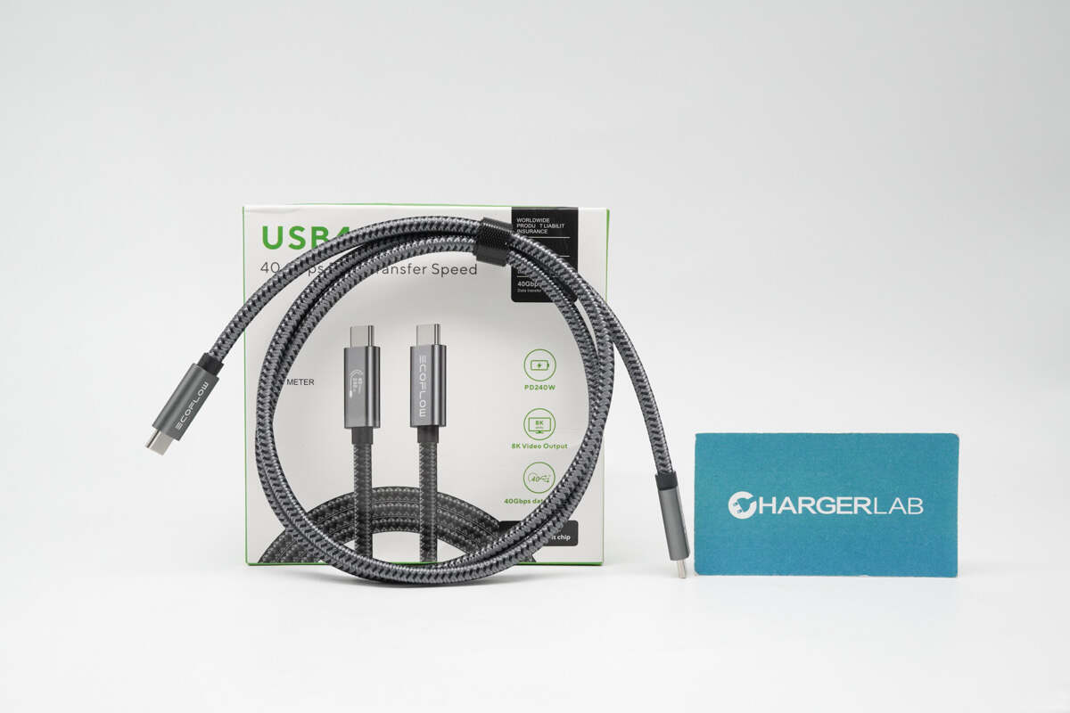

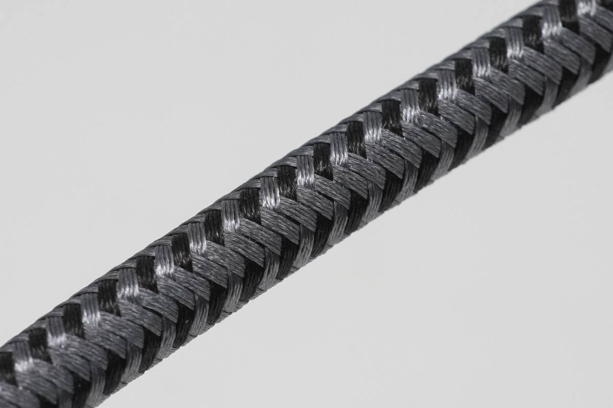

The cable is wrapped in a grey and black aramid fiber braided exterior, which is both wear-resistant and dirt-resistant, enhancing its texture and feel.
Teardown of EcoFlow 240W USB4 Fast Charging Braided Cable-Chargerlab

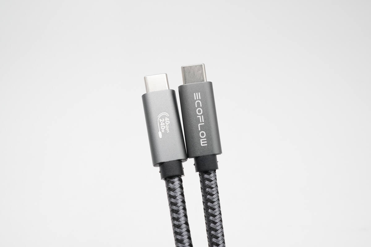

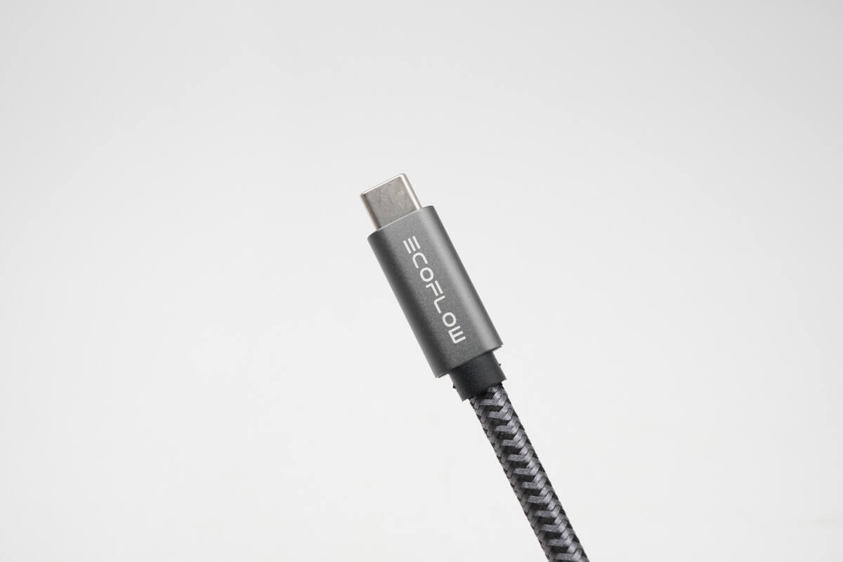

The connectors feature a metal casing with a painted surface.

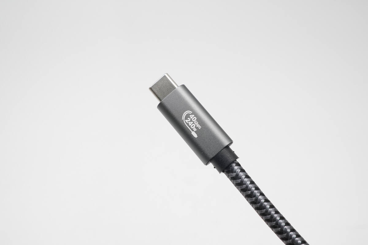

The casing is embossed with the EcoFlow logo.
The other side is marked with "40Gbps" and "240W".

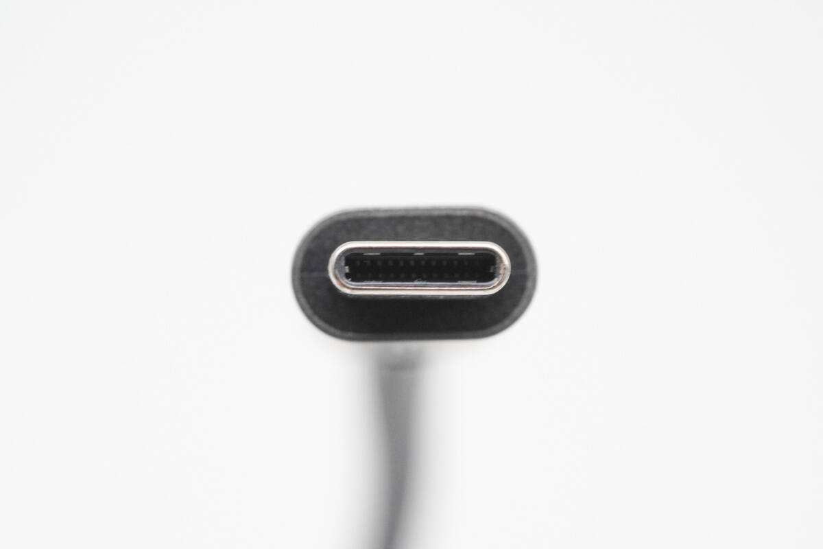

The USB-C male connector features a full PIN design internally.

The close-up of the cable’s braiding.
The length is about 100 cm (39.37 inches).

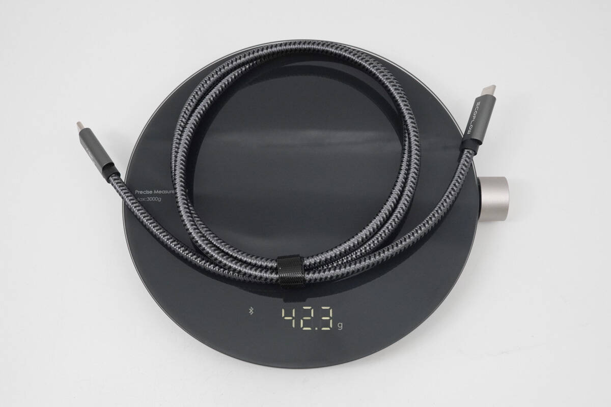

The weight is about 42 g (1.48 oz).

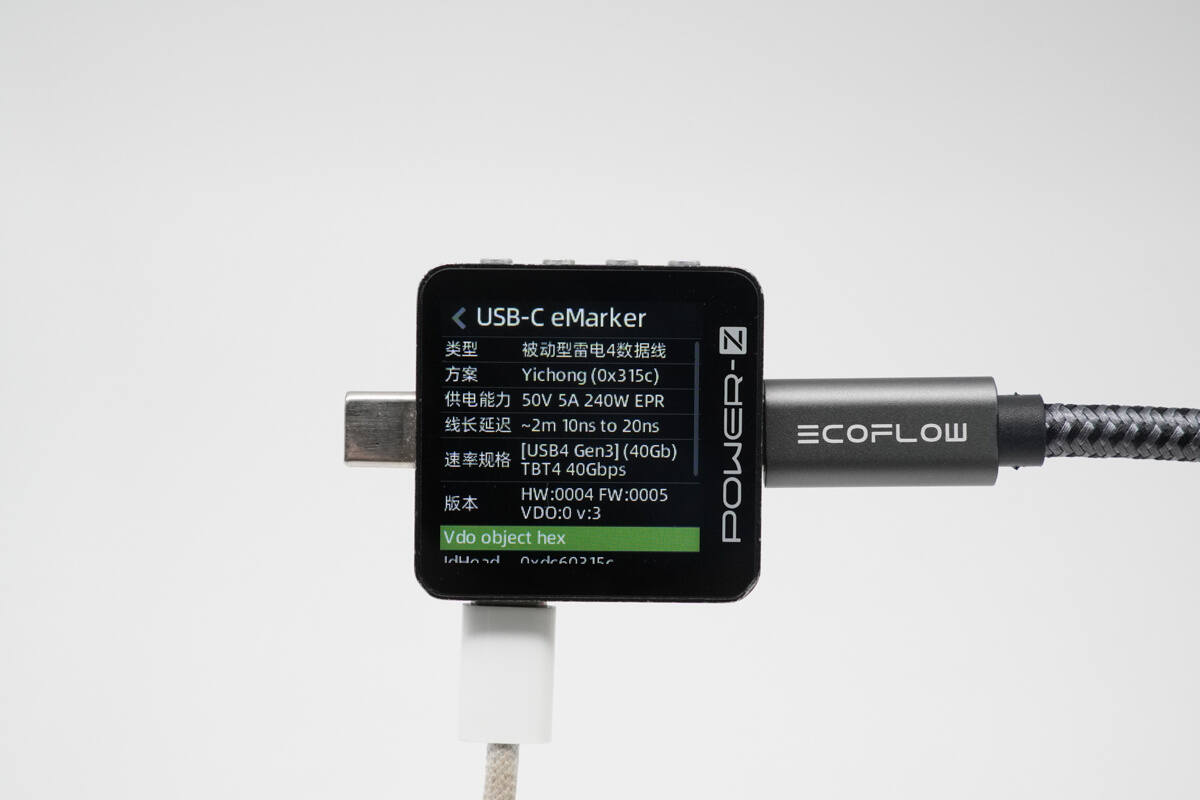

ChargerLAB POWER-Z KM003C shows that it is equipped with an E-Marker chip from CPS. The cable supports a power transmission capability of 50V 5A and a data transfer capability of USB4 Gen3 (40Gbps).

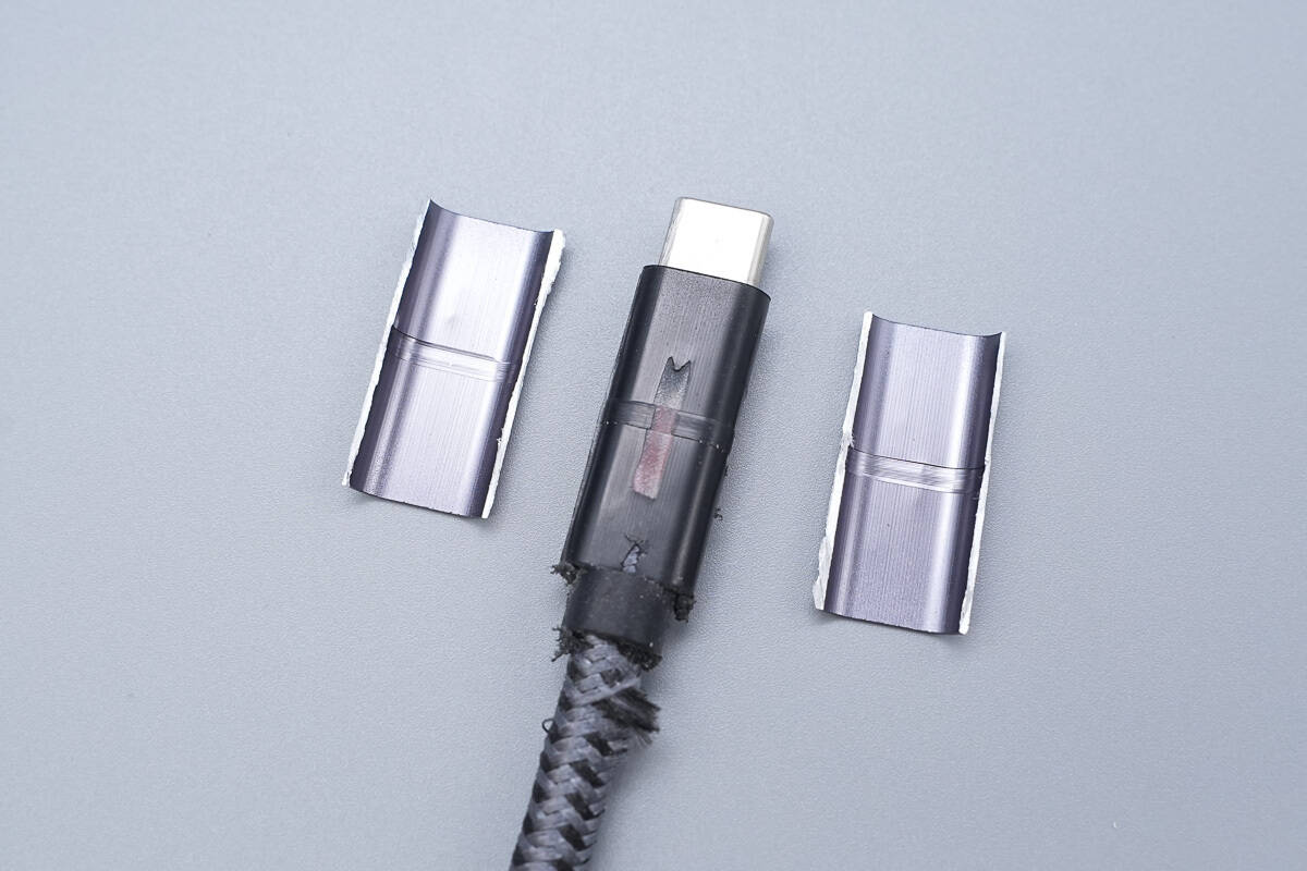

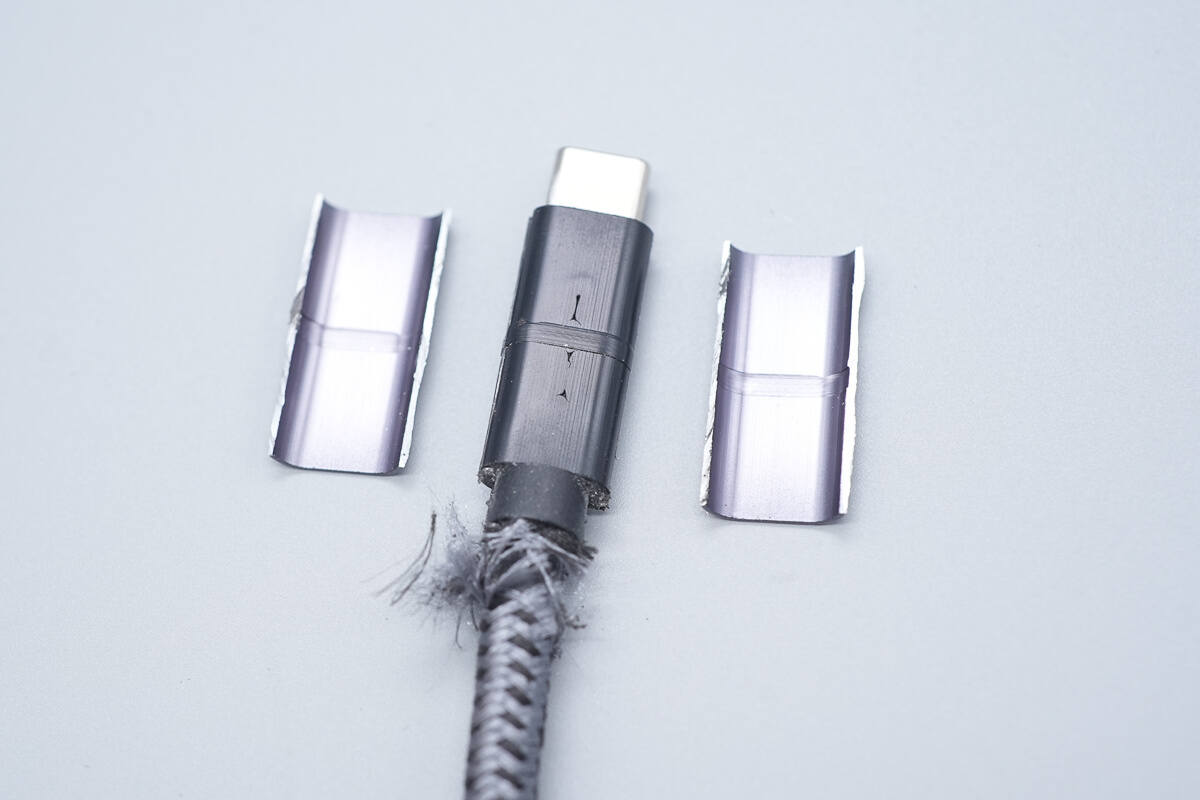

Cut open the metal casing of the connector, revealing an internally molded, single-piece injection structure.
The interior is filled with a hard-sealing adhesive to protect the PCB and cable cores.

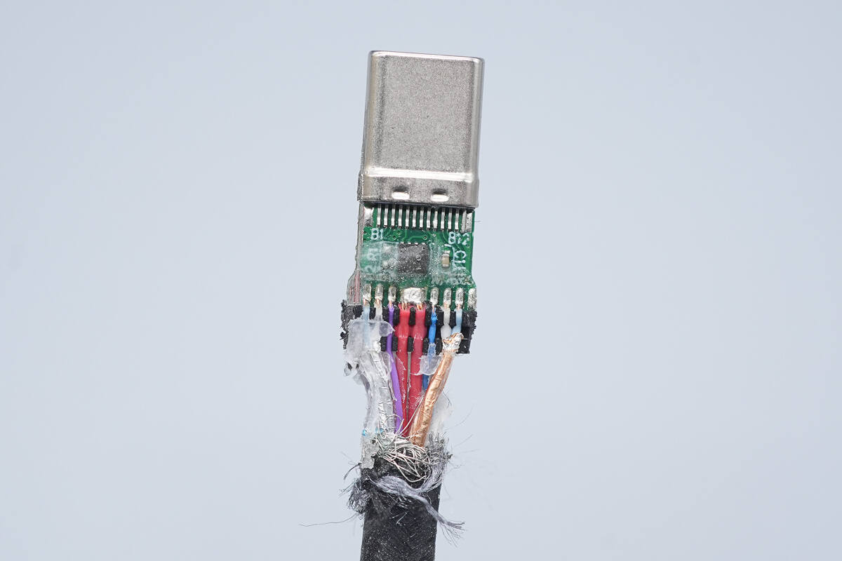

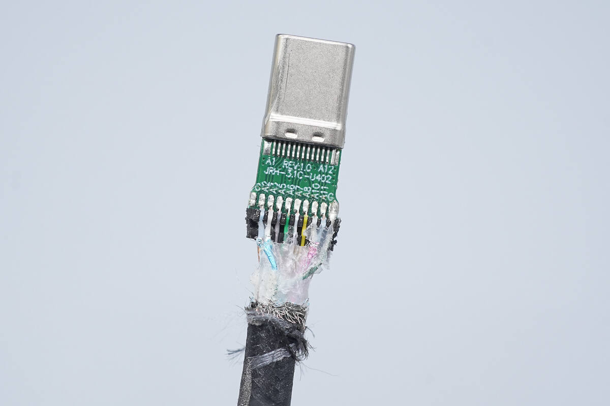

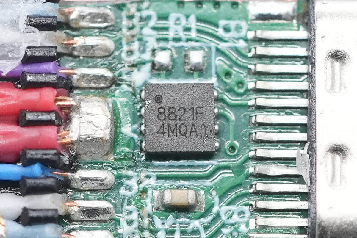

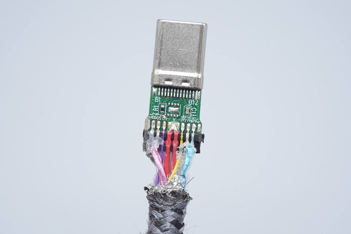

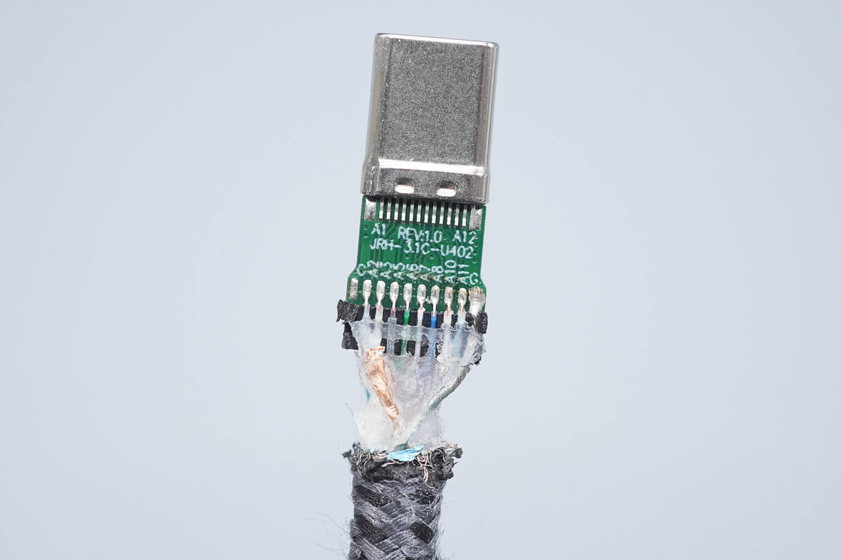

After removing the hard-sealing adhesive, a layer of hard sealant remains on the front of the PCB, protecting the E-Marker chip.
The other side of the PCB has no components, and both sides where the cable cores are soldered are clean and well-executed.
After removing the metal casing of the USB-C male connector, the central area of the pins and the connection points with the PCB are both reinforced with injection molding to enhance strength.

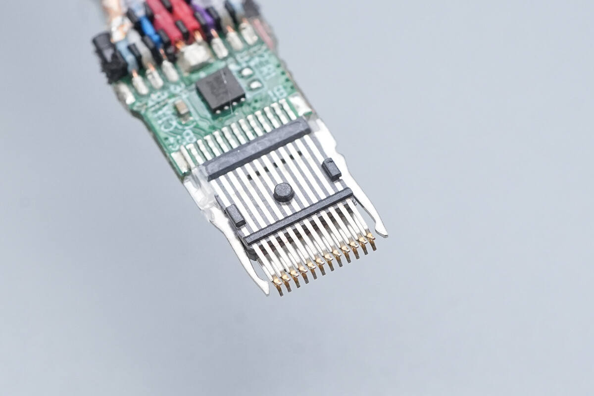

The front ends of the pins have been gold-plated for improved conductivity and durability.
The E-Marker chip is from CPS, model CPS8821F, which supports full USB4 functionality and is fully compatible with USB3.2 Gen1/Gen2, USB3.1, and USB2.0. It supports commands like Discover Identity, Discover SVID, Discover Modes, Enter Modes, and Exit Modes, and also supports Manufacturer Info packets, making it easier for manufacturers to store related information within the cable.
The CPS8821F also supports host authentication and, for PD3.1 high-output voltage applications, the series has enhanced ESD and high-voltage pin resistance. This allows the CC and Vconn to provide 33V high-voltage protection and integrates detection protection for VBUS and CC/Vconn short circuits.

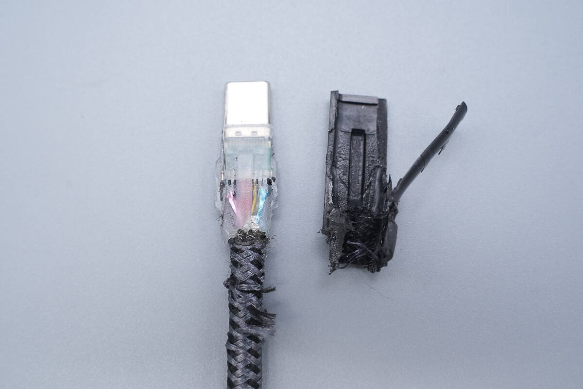

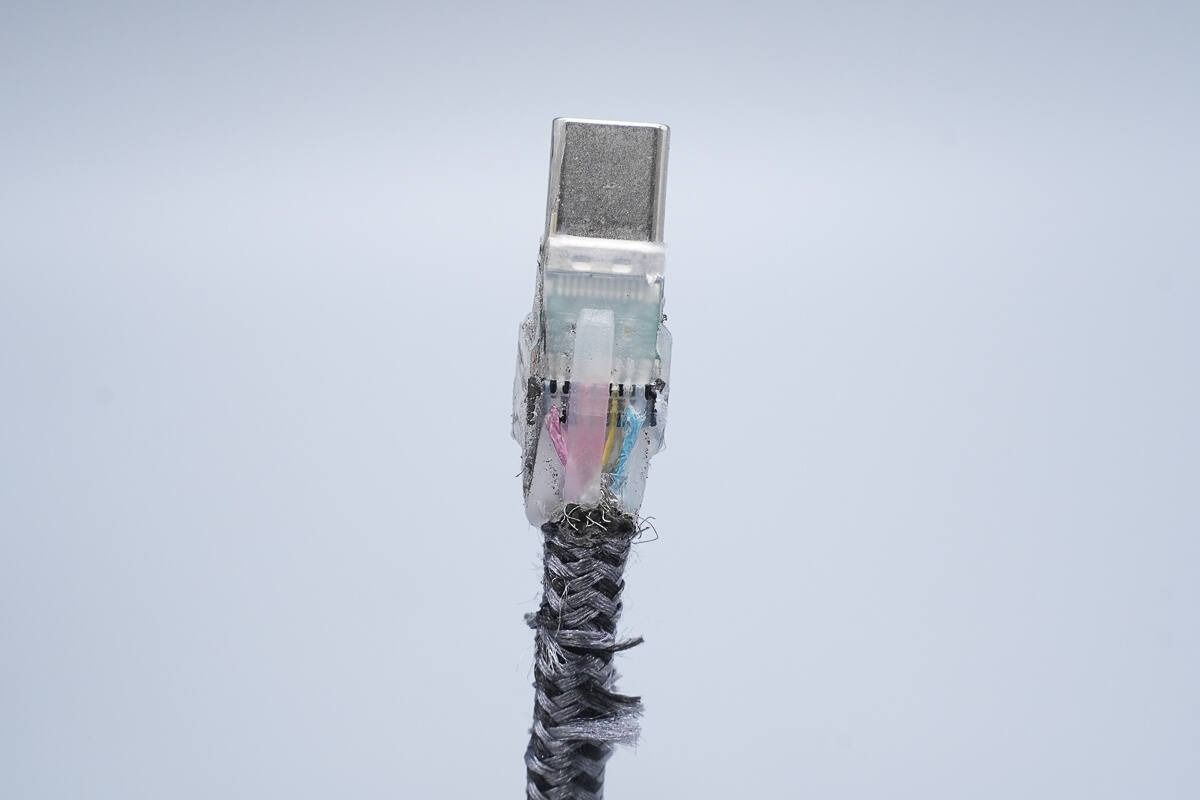

After removing the metal casing of the other connector, the internal design is identical.
After removing the black plastic, the interior is also filled with hard sealing adhesive.

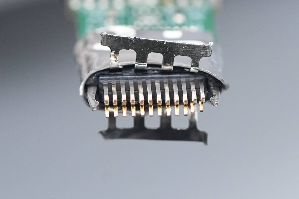

The internal pins of the male connector are also gold-plated for enhanced conductivity and durability.

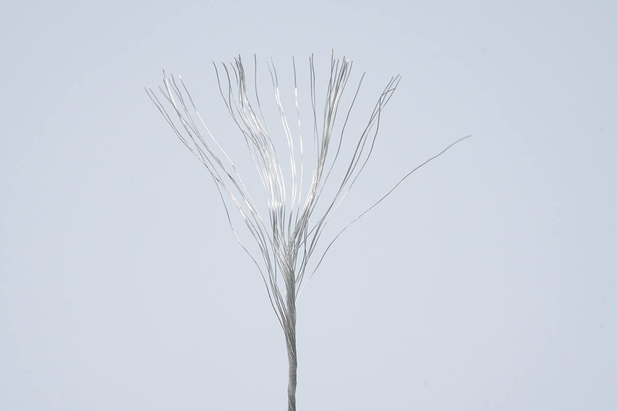

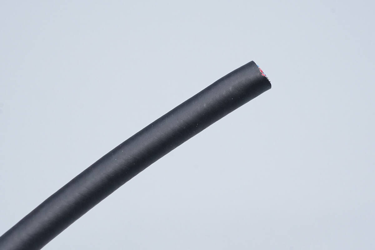

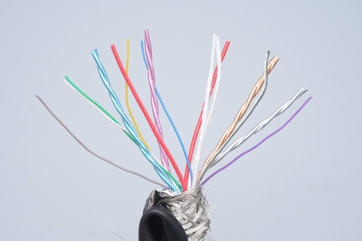

When the cable is cut open to observe the cross-section, it reveals an internal shielding mesh and multiple wire cores, with some of the wire cores designed in a twisted pair configuration.
The outer casing of the cable is made of TPE material.

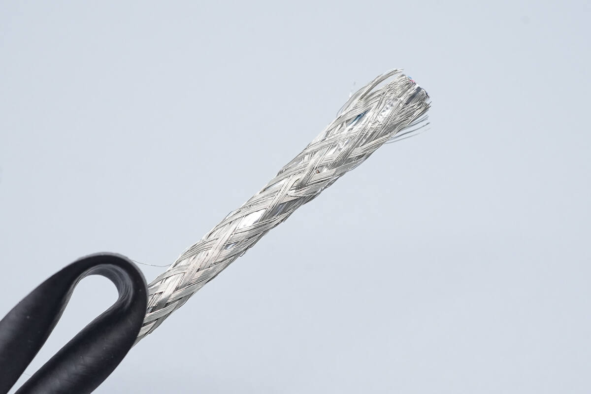

The shielding mesh is cross-braided for enhanced durability and protection against interference.

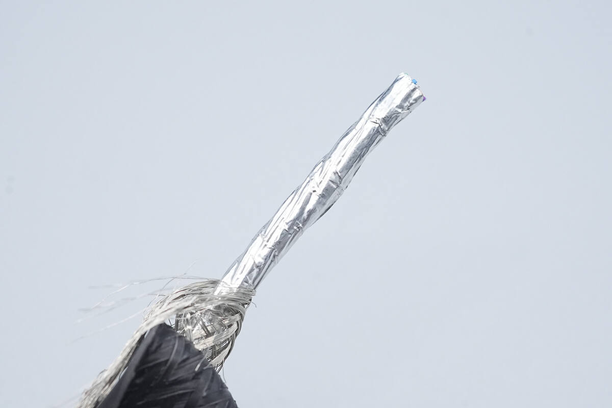

Beneath the shielding mesh, there is an additional layer of shielding aluminum foil.

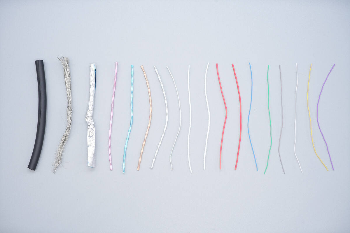

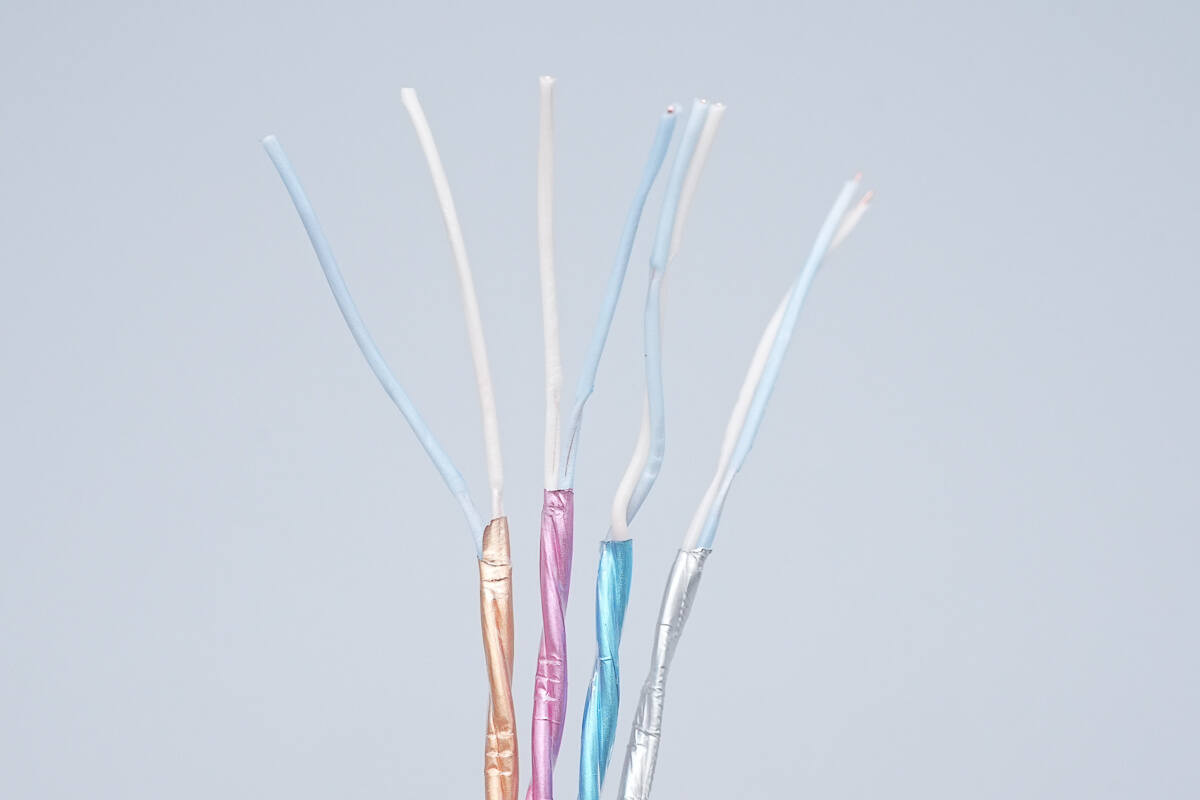

In addition to the wire cores, the cable also includes a tensile strength wire. The twisted pairs are wrapped in shielding aluminum foil of different colors for enhanced protection and organization.

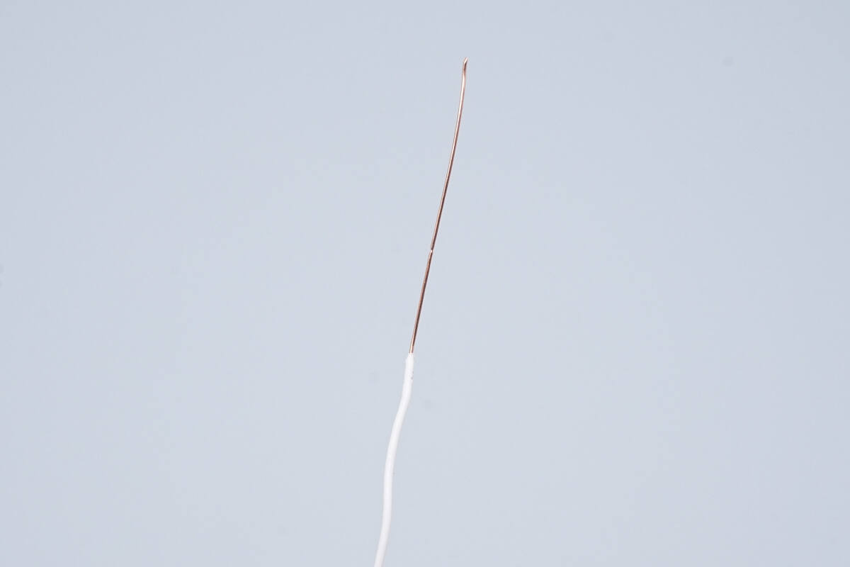

The blue, purple, gold, and silver twisted pair shielded wires are ultra-high-speed differential signal lines. The white and green twisted pairs are USB2.0 data lines. The two red wire cores are positive power lines, while the remaining wires include the CC, SBU, VBUS, and other signal cores.

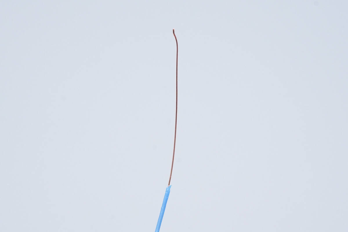

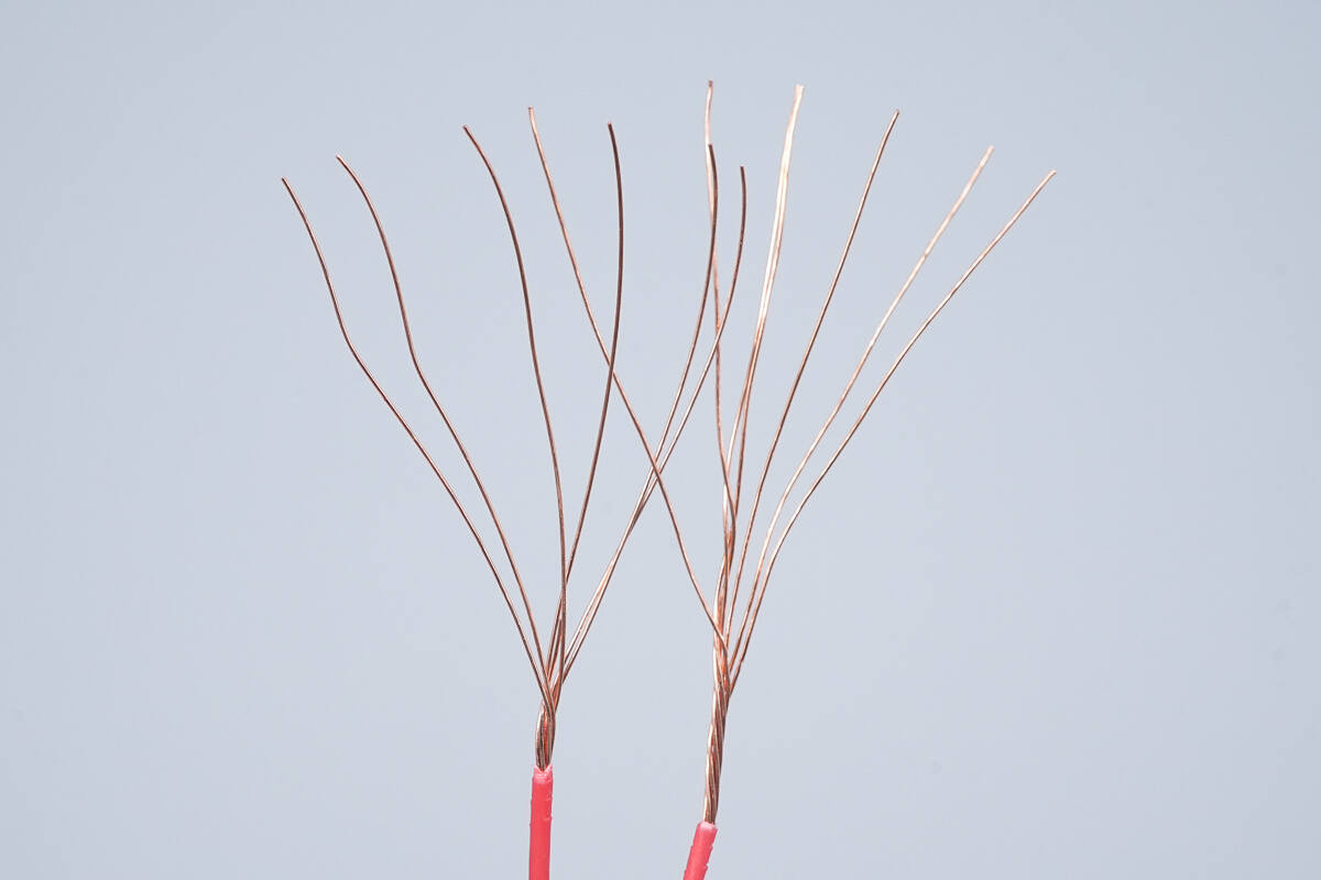

The two red positive power wire cores are made of pure copper wire for optimal conductivity.

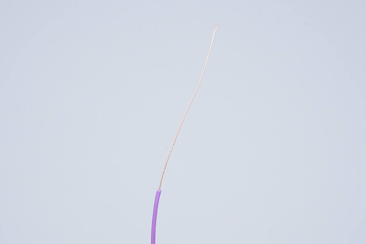

A close-up of the purple VBUS wire core.

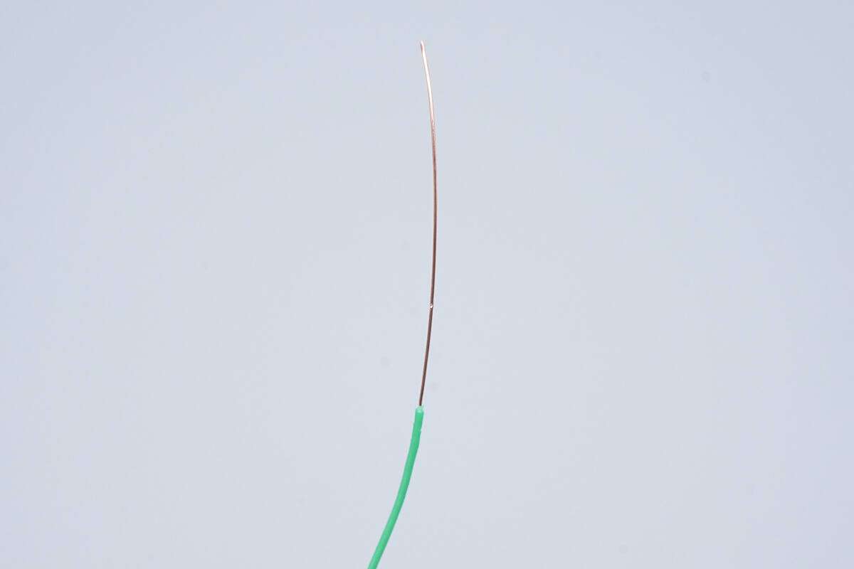

Green D+ wire core used for USB 2.0 data transmission.

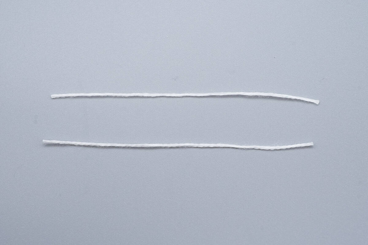

Close-up of the tensile cotton threads.

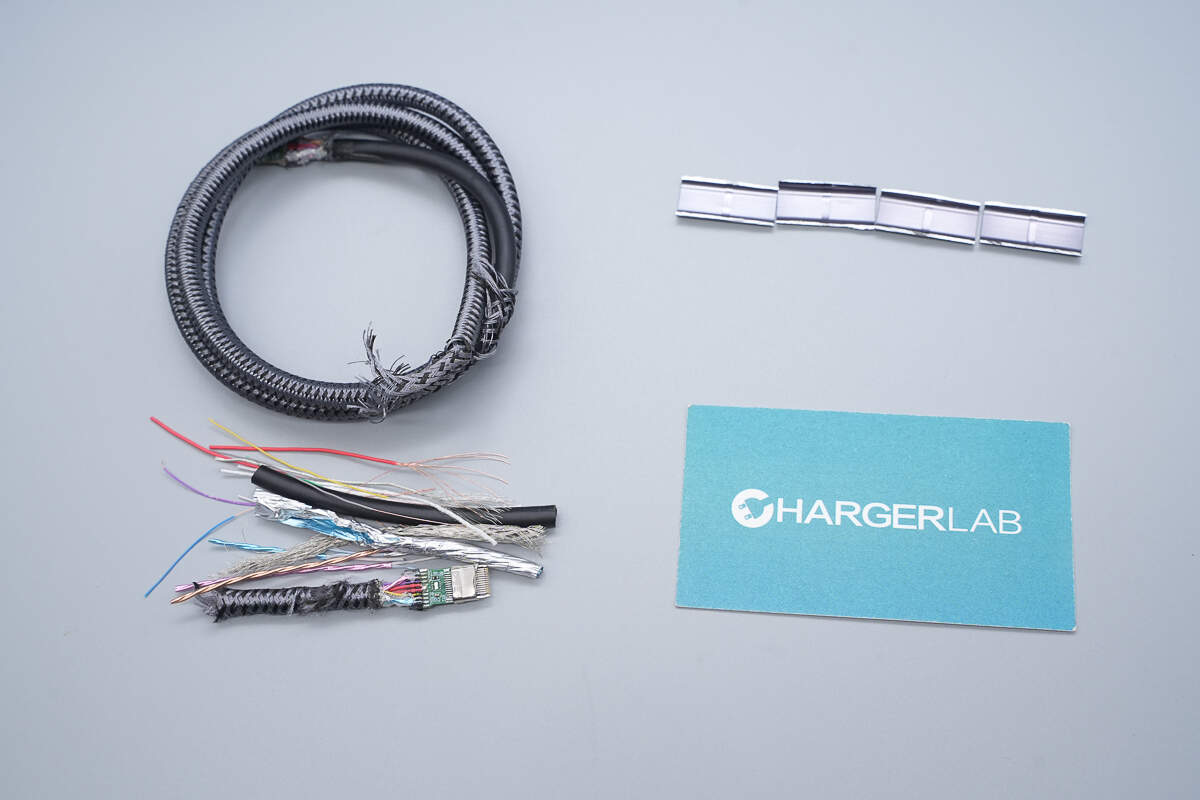

Well, those are all components of the EcoFlow 240W USB4 Fast Charging Braided Cable.
The braided cable is 1 meter in length, made of gray-black aramid fiber woven in a cross pattern. The terminals feature a metal shell with the brand logo, indicating 40Gbps data transfer speed and 240W power capability. The male connectors are full PIN. It supports the 40Gbps data transmission standard, 8K@60Hz video extension, and has a power transmission capacity of 50V 5A 240W.
After taking it apart, we found that it uses the CPS CPS8821F E-Marker chip, supporting all USB4 features, with high-voltage protection and VBUS short-circuit detection. It is equipped with a braided shield and an aluminum foil shielding layer, effectively enhancing its resistance to interference. The wire cores include four pairs of blue and white twisted shielded cables for ultra-high-speed data transmission, multiple positive power cores in red and purple, as well as CC, SBU, USB2.0, and other signal cores. With solid materials and high craftsmanship, it is a high-performance, reliable USB4 full-function data cable.
