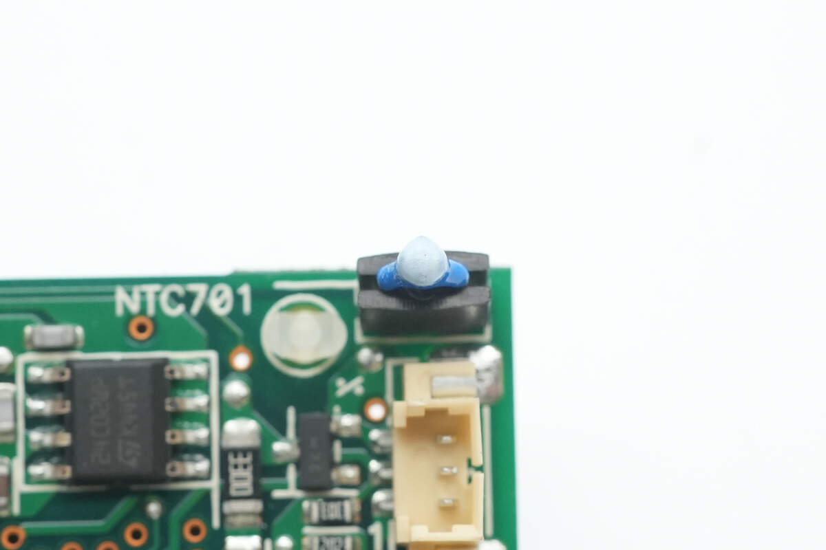

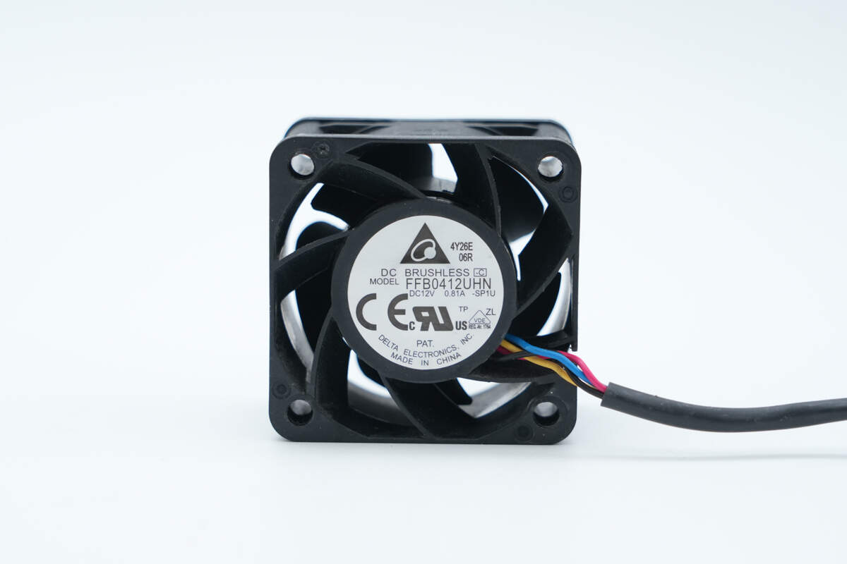

The LED indicator and cooling fan are connected via connectors.

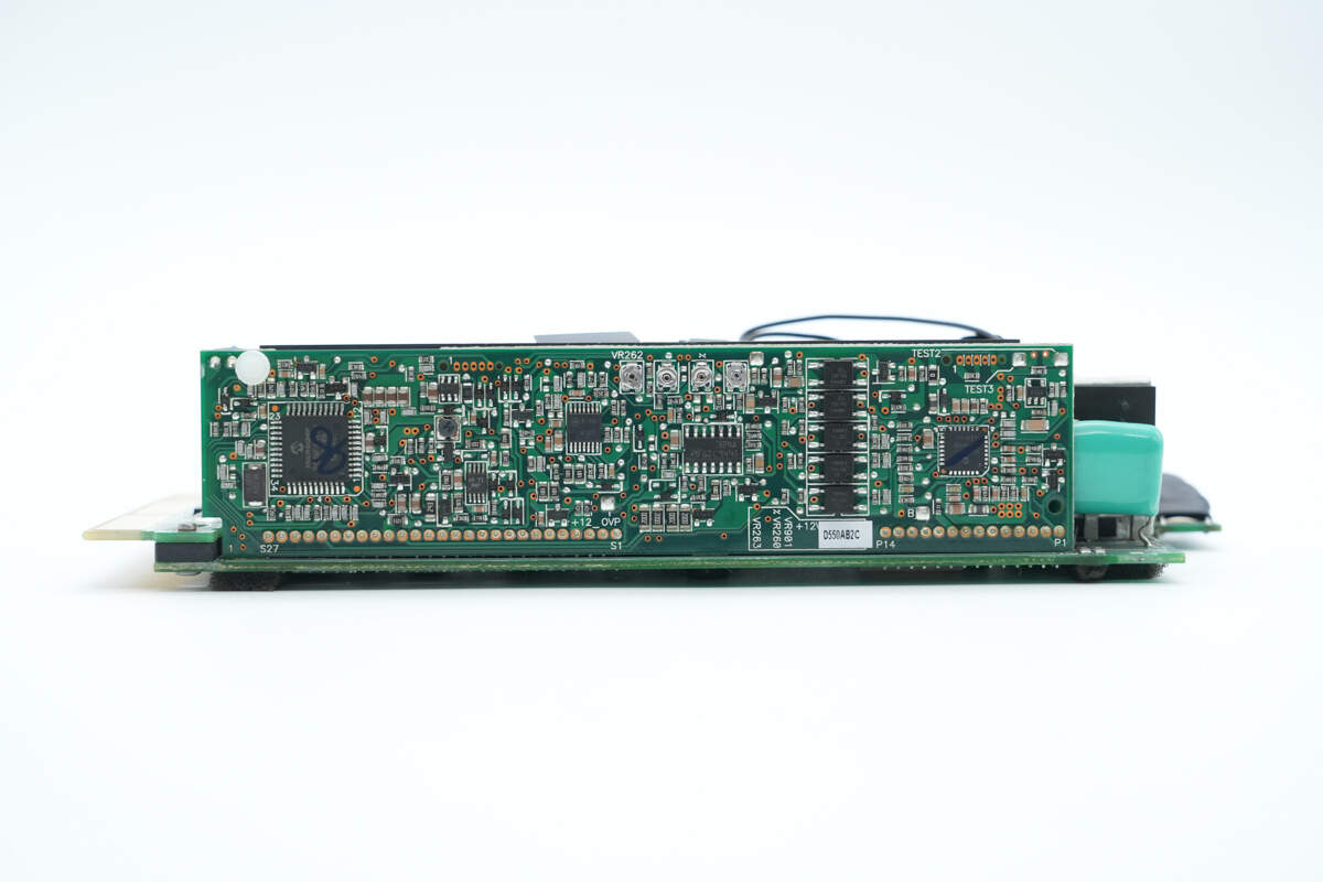

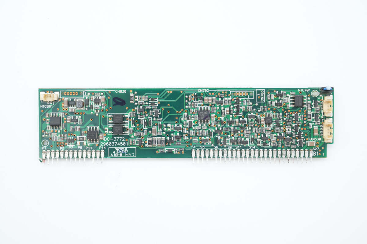

The synchronous rectifier PCB is equipped with a transformer, synchronous rectifier controller, and synchronous rectifiers.
Teardown of Delta 550W SiC Server Power Supply (DPS-550AB-2)-Chargerlab
Copper bars are soldered on the back side to enhance current-carrying capacity.

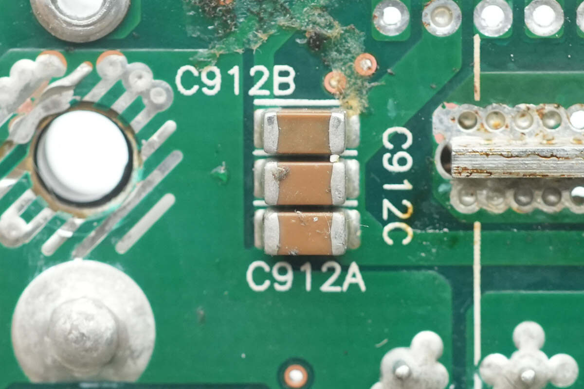

Close-up of the MLCC capacitors.
There are also MLCC capacitors on the back side.

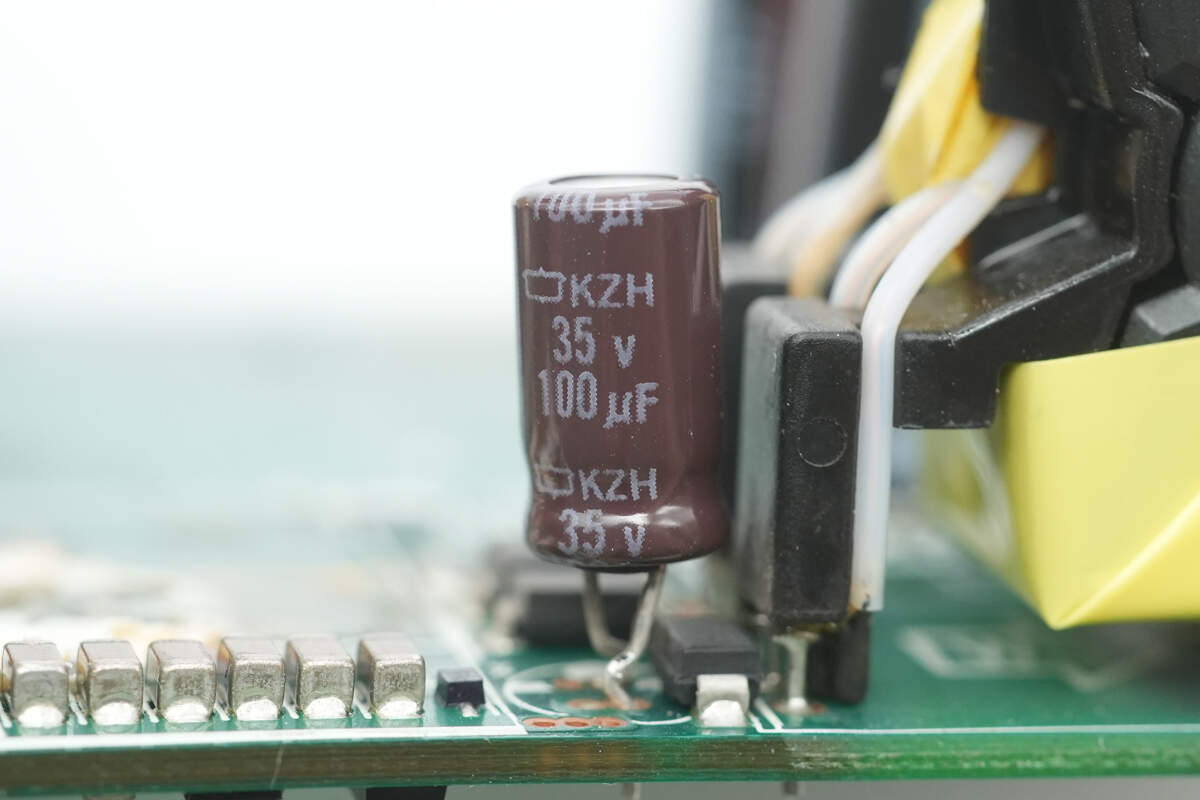

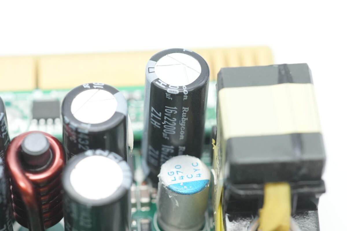

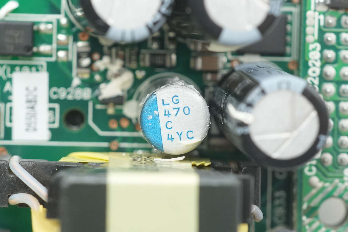

The output side is equipped with a standby power transformer, filter capacitors, and a filter inductor. The filter inductor is insulated with heat shrink tubing.
Four filter capacitors are arranged with a filter inductor in the middle.
The filter capacitors are from Rubycon, each rated at 16 V, 2200 μF.

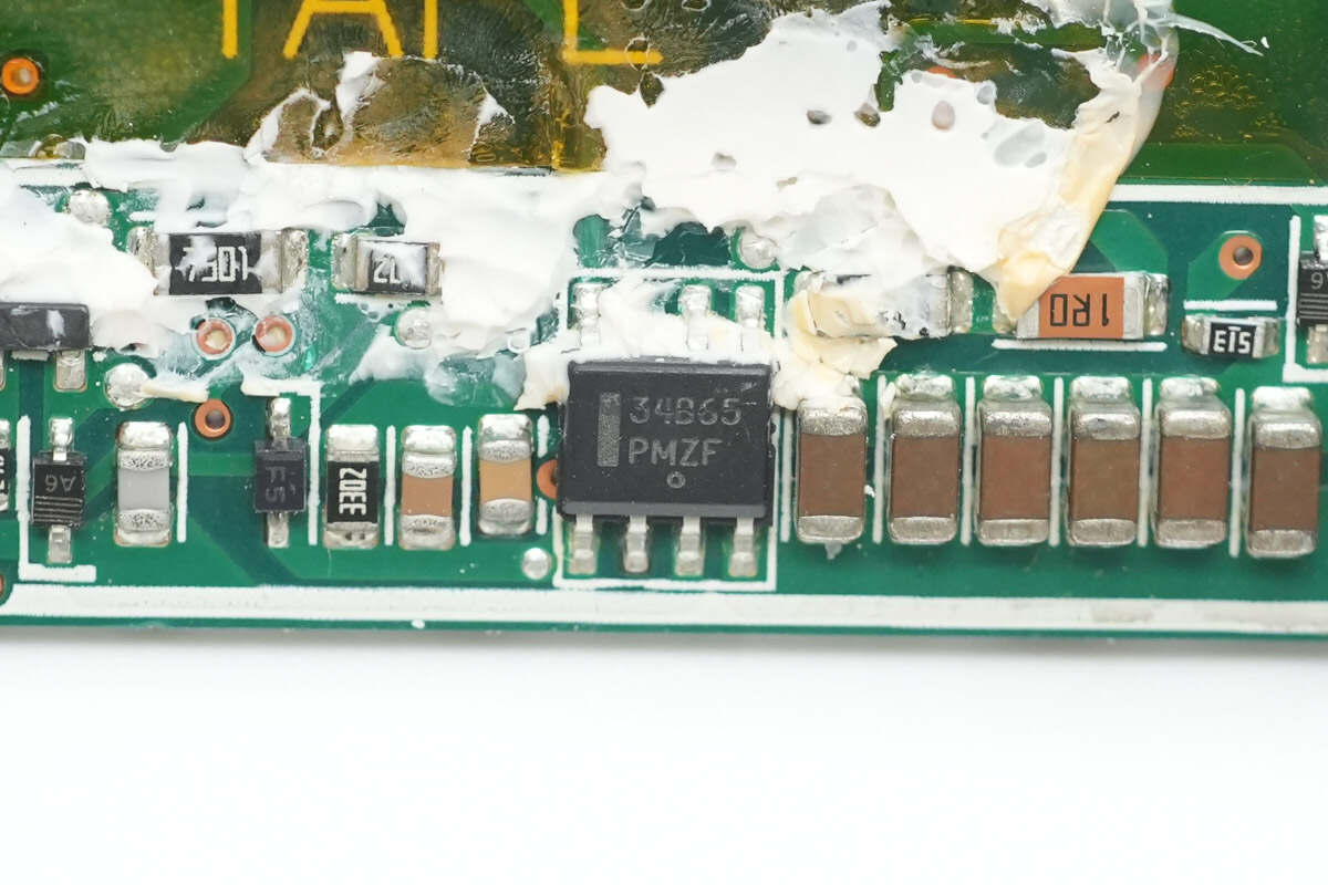

These MLCC capacitors are connected in parallel with electrolytic capacitors for output filtering.
Close-up of another set of MLCC capacitors.

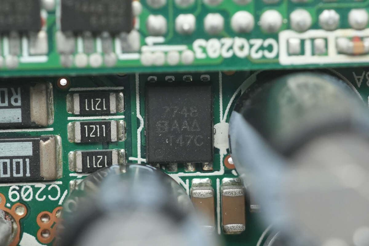

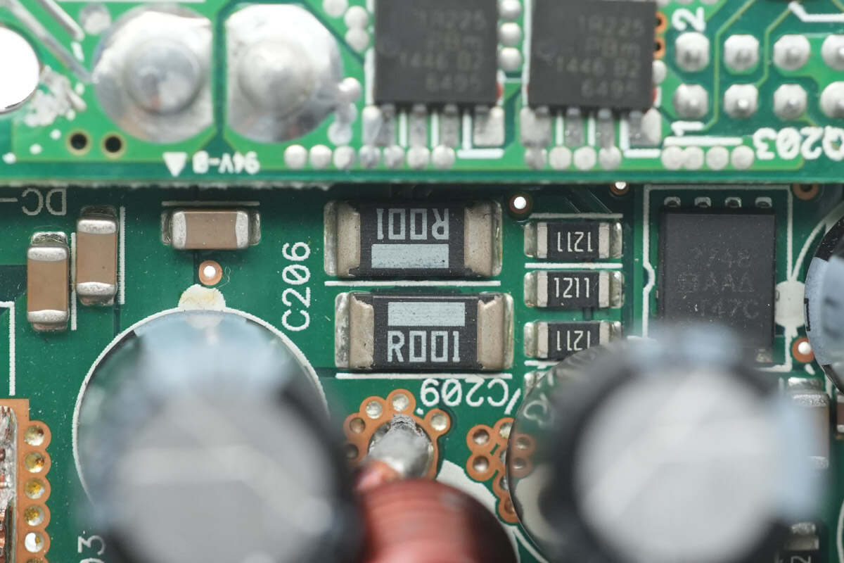

Two 1 mΩ resistors are connected in parallel to sense the output current.

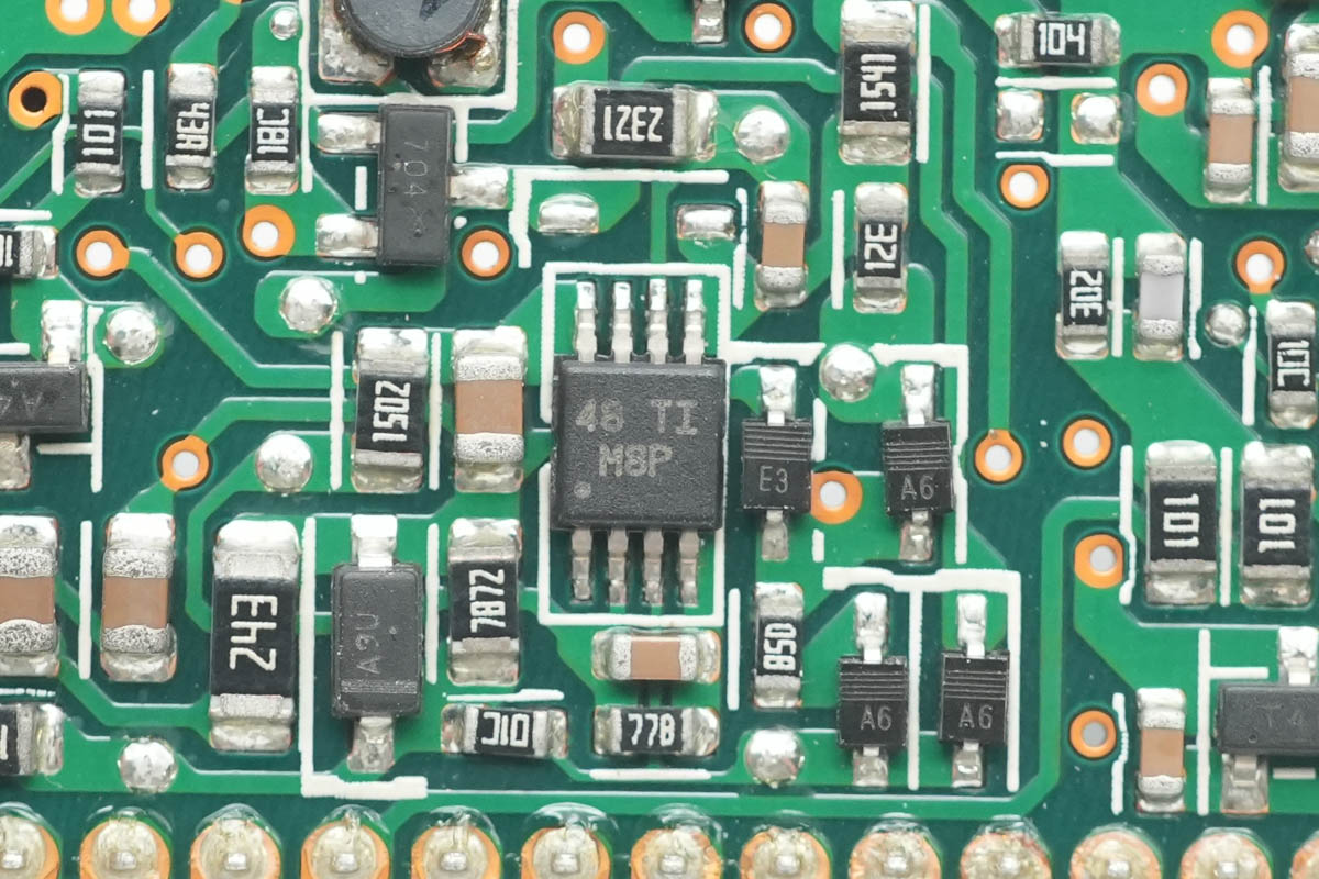

The current-sensing chip is from TI, marked CEU, model INA211. It is a bidirectional high-precision current-sense amplifier, supports up to 26V and comes in an SC70 package.
The voltage comparator is from TI, marked M8P, model LM393A. It is an industrial-grade, dual-channel precision differential comparator and comes in a VSSOP-8 package.
