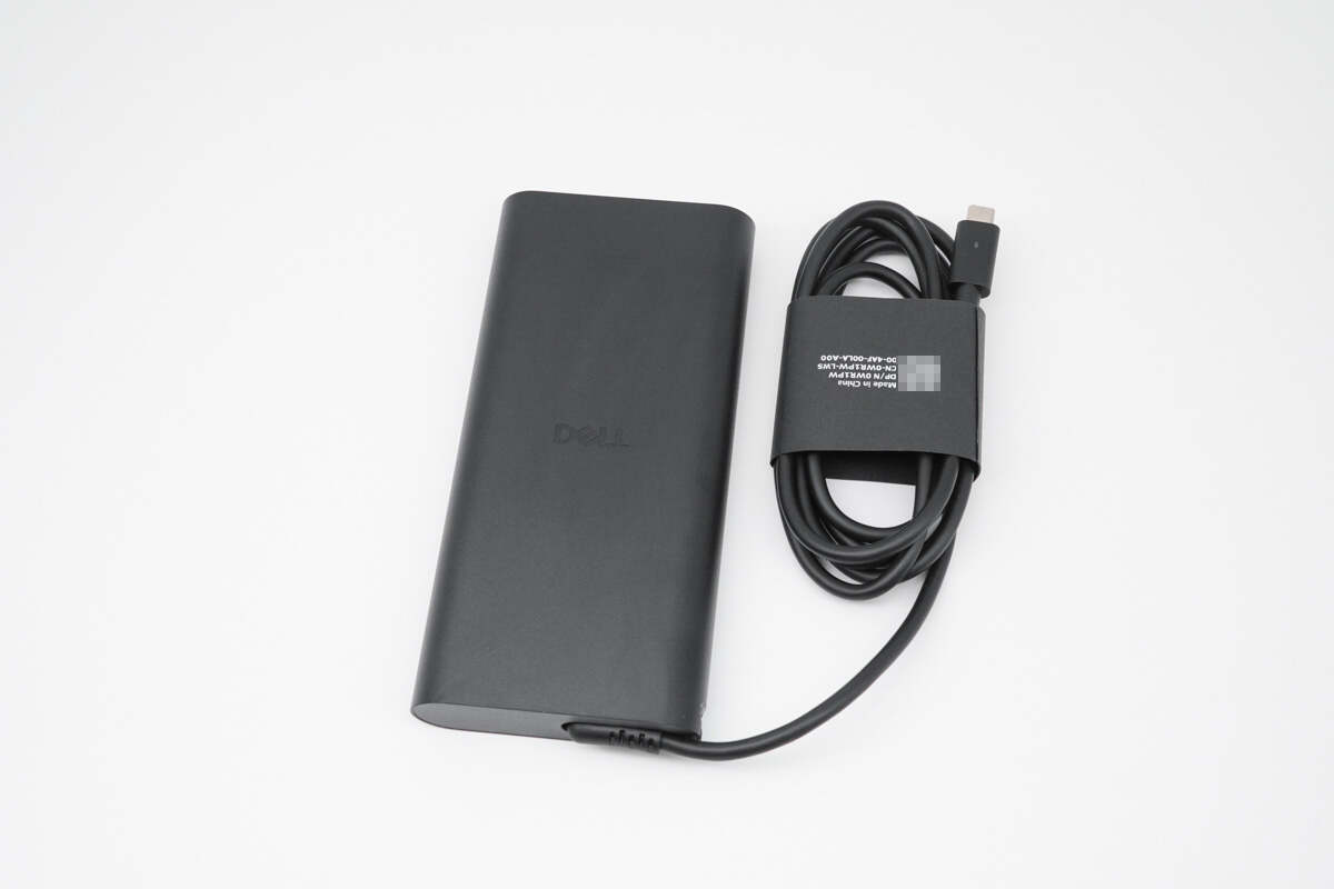

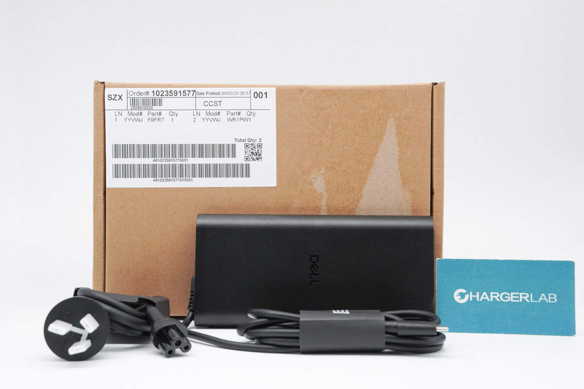

It is packaged in a kraft paper box with DELL printed on it.
Teardown of Dell 280W USB-C GaN AC Adapter (LA280PM240)-Chargerlab

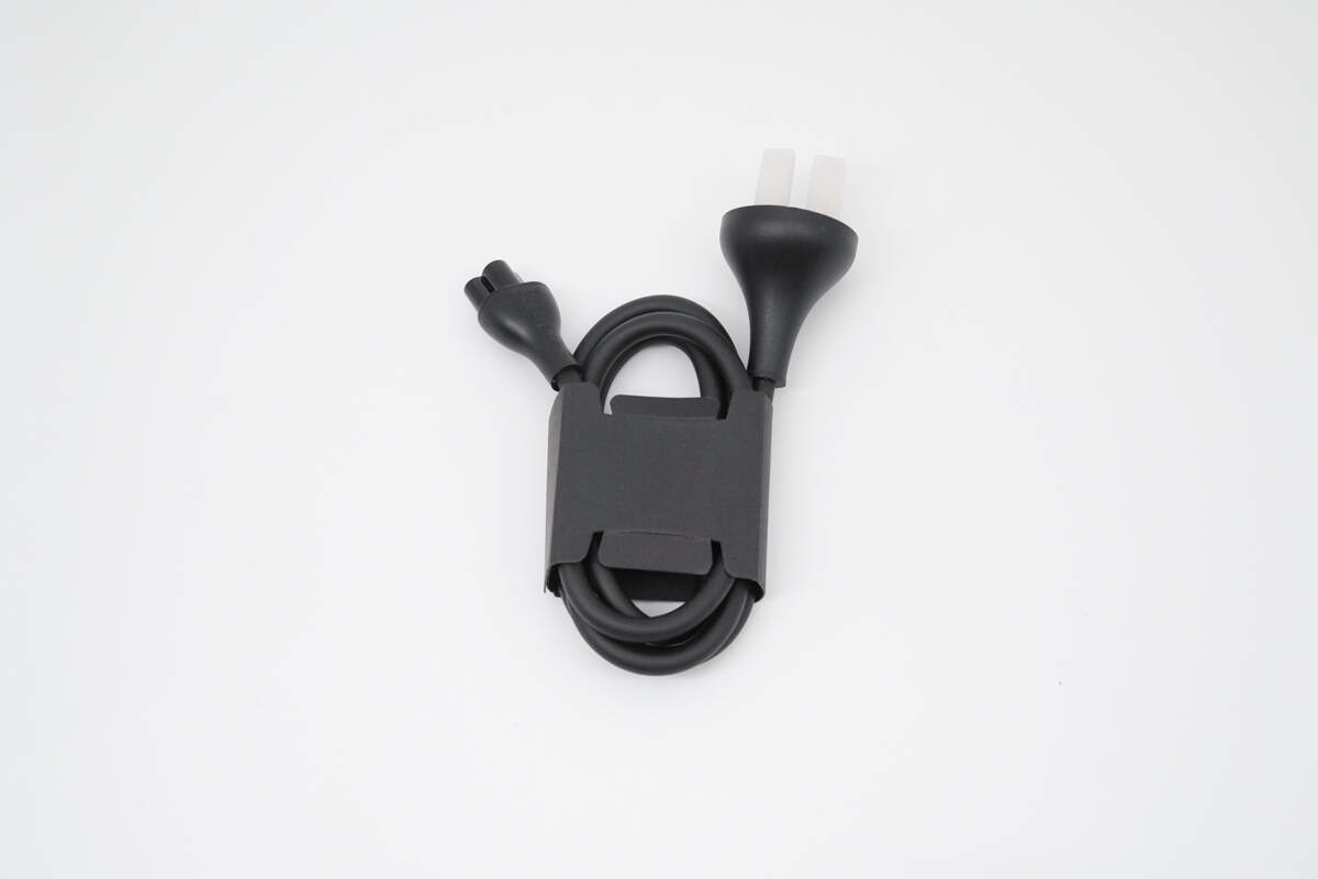

The power cable and adapter feature a split-type design.

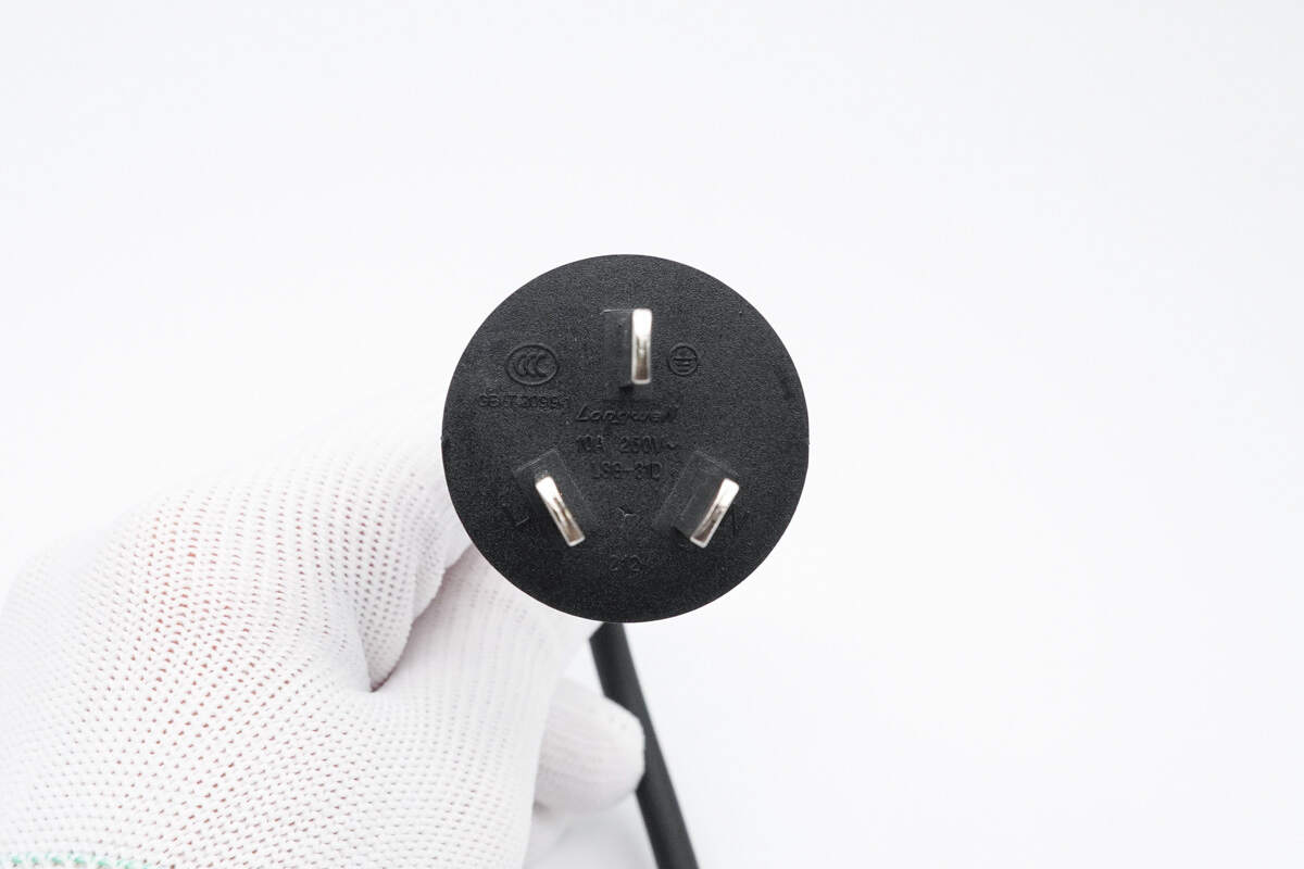

The power cable is secured with a paper loop. The plug is protected by a white plastic cover.

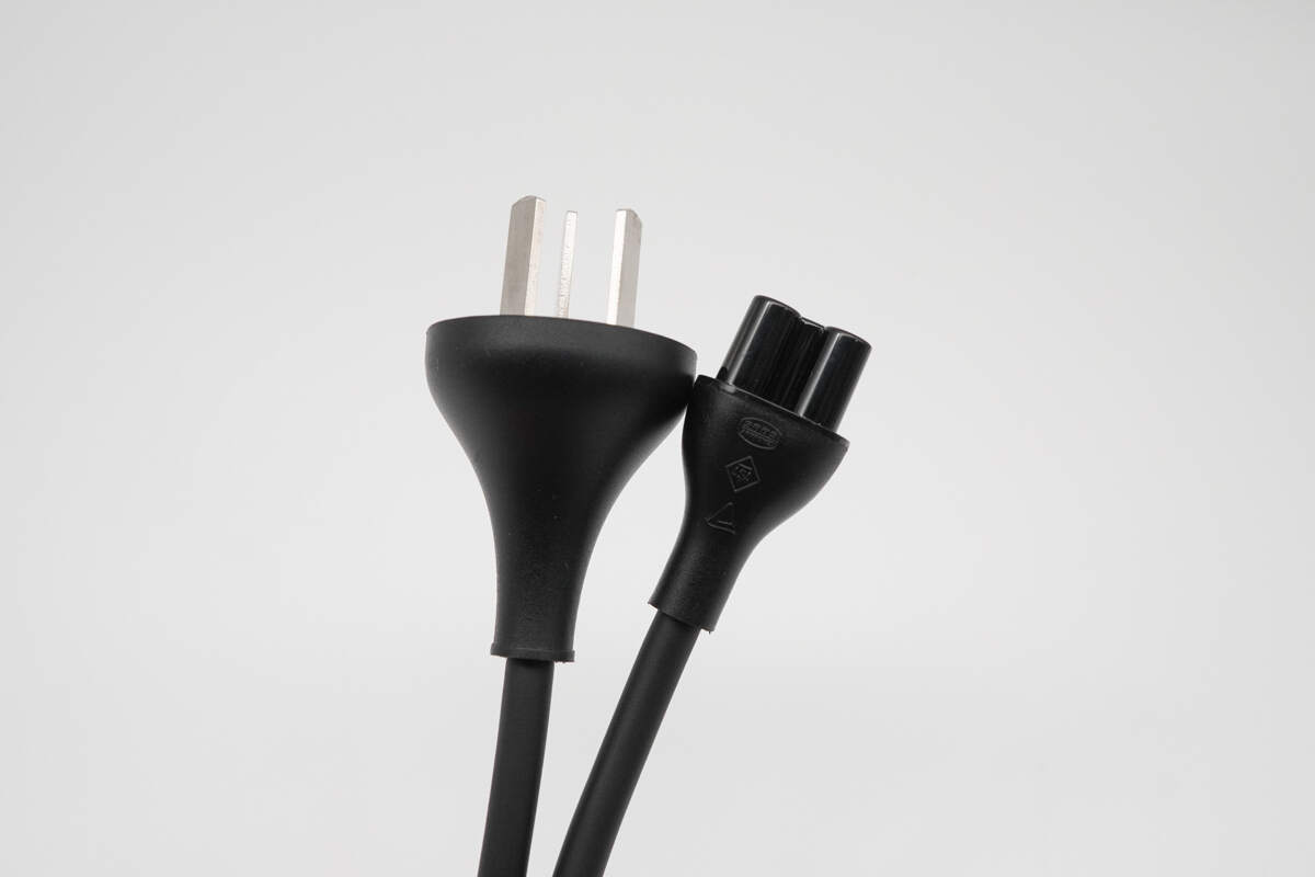

The power cable features a three-prong plug on one end and a cloverleaf connector on the other.
The cable is manufactured by Longwell, rated at 10A 250V~, and certified by CCC.

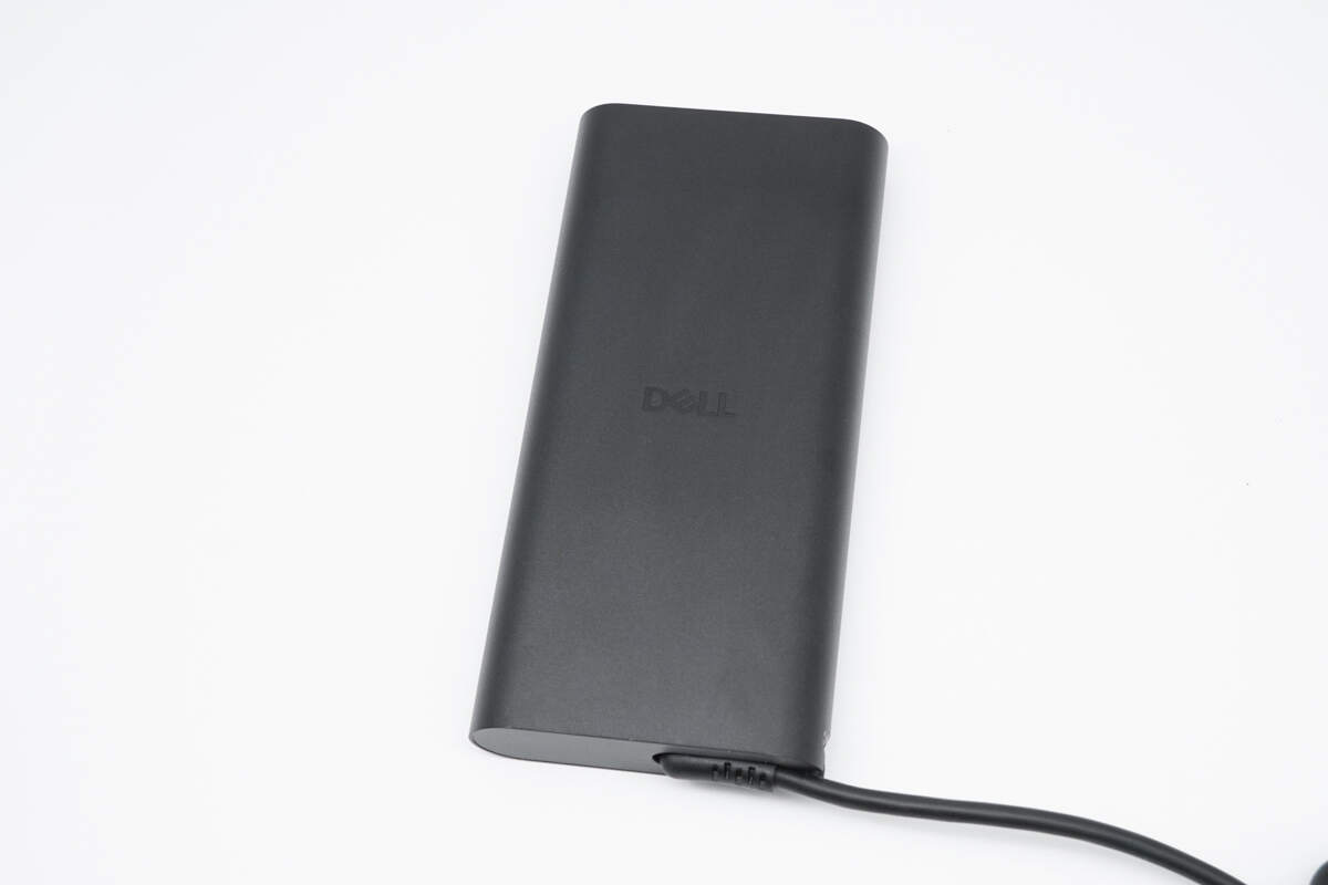

The adapter has a matte, fingerprint-resistant surface with curved sides.
The center features the DELL logo.

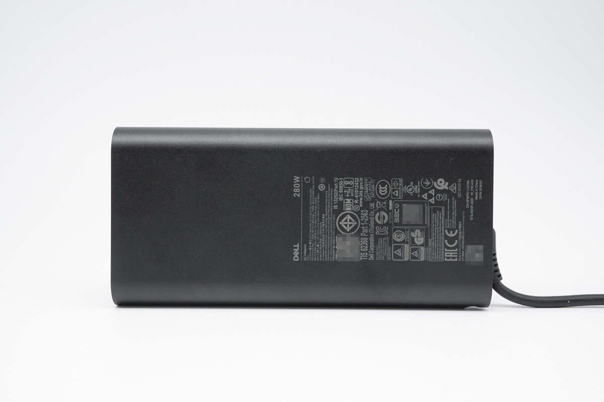

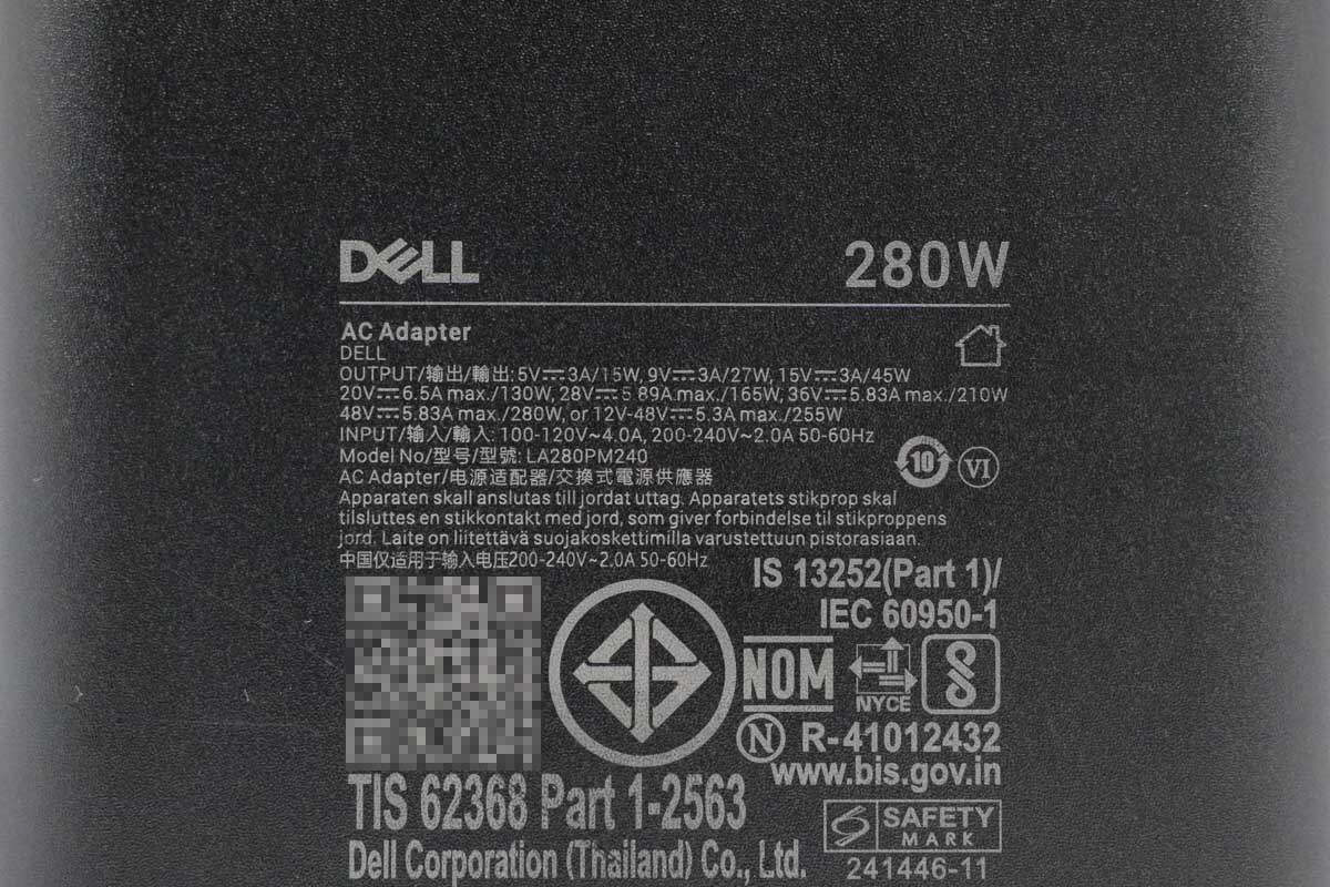

The back is printed with specification information.
It is certified by CCC, KC, CE, EAC, CP, PSE, GS, UL, NOM, NYCE, and several other standards, making it compatible for use in the vast majority of countries and regions worldwide.
Model: LA280PM240
Input: 100-120V~4A, 200-240V~2A 50/60Hz
Output: 5V 3A, 9V 3A, 15V 3A, 20V 6.5A, 28V 5.89A, 36V 5.83A, 48V 5.83A, 12-48V 5.3A
Certified with VI-level energy efficiency.

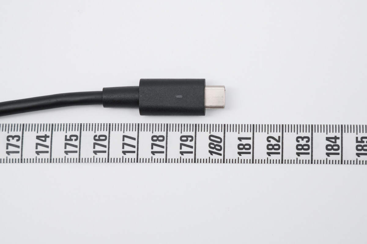

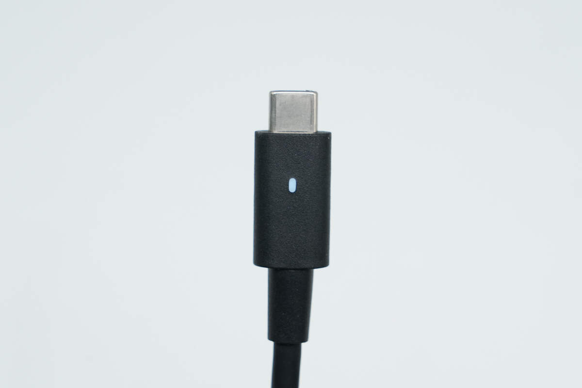

The USB-C connector has an LED indicator that emits a soft blue light when powered on.

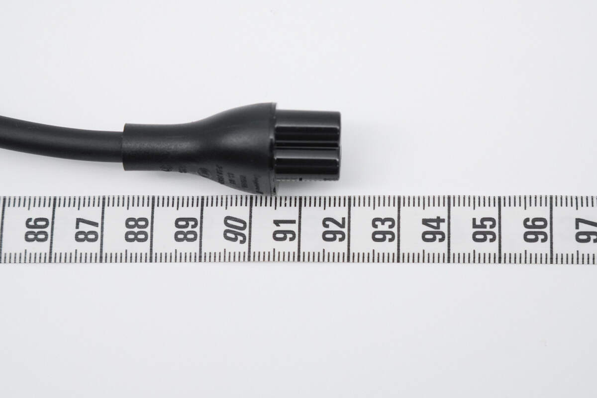

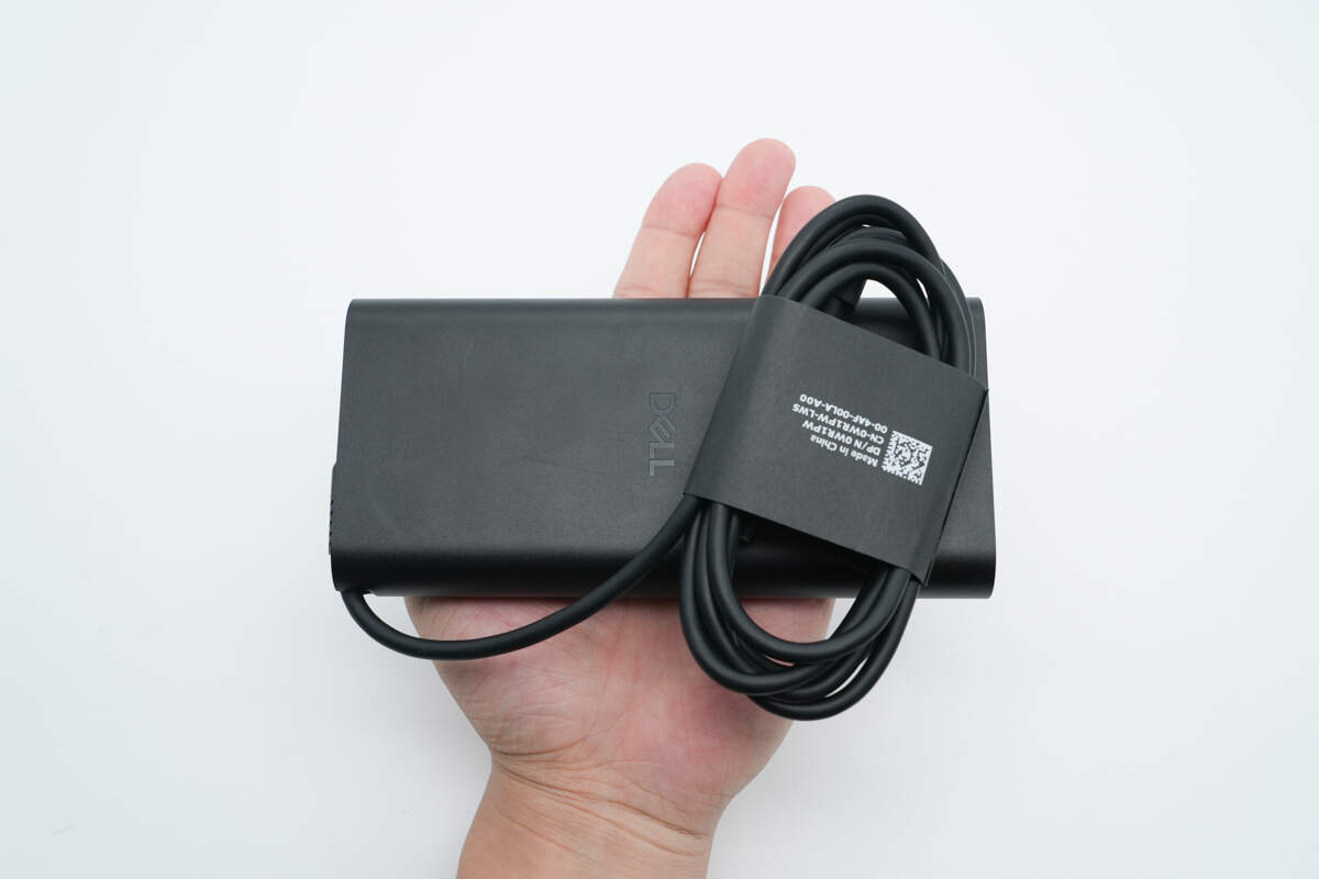

The length of the power cord is about 92 cm (36.22 inches).

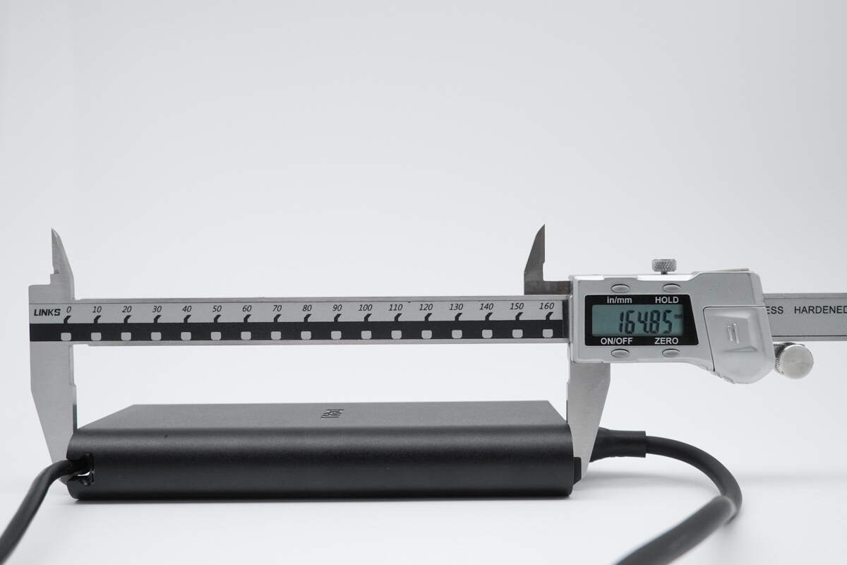

The length of the adapter is about 164.85 mm (6.49 inches).

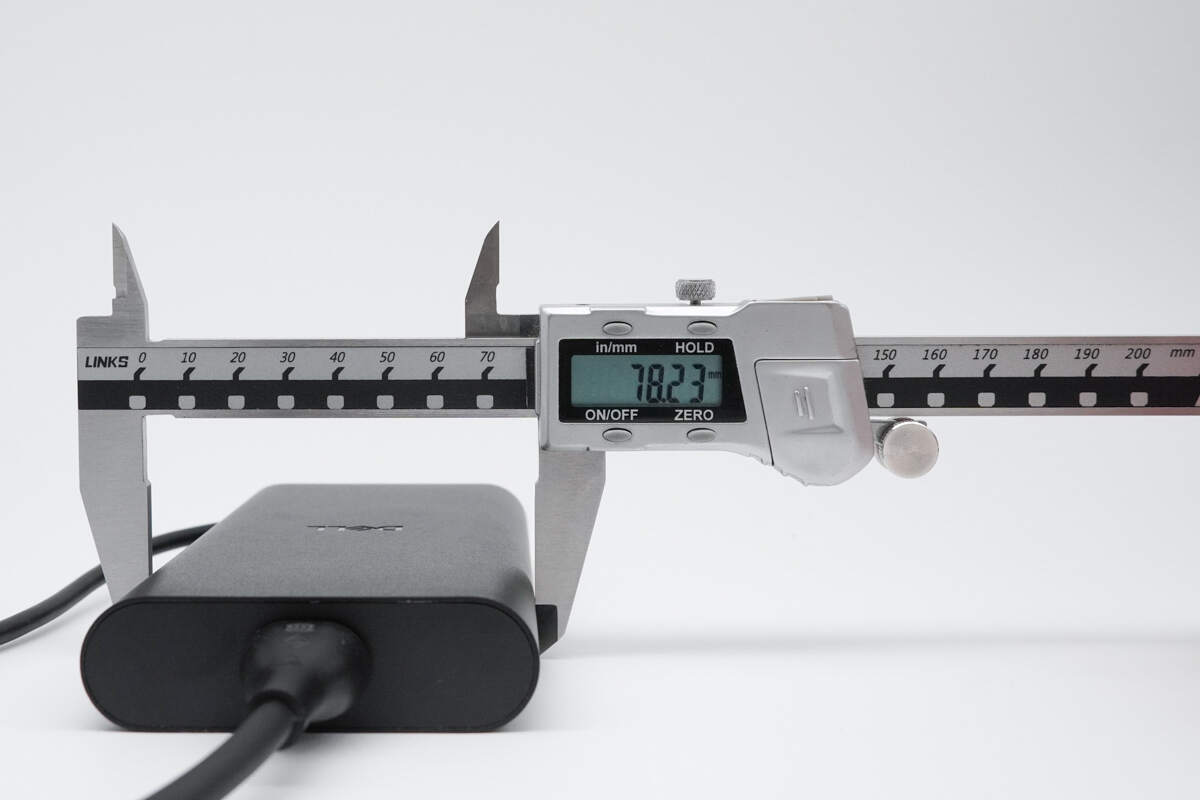

The width is about 78.23 mm (3.08 inches).

The length of the output cable is about 180 cm (70.87 inches).

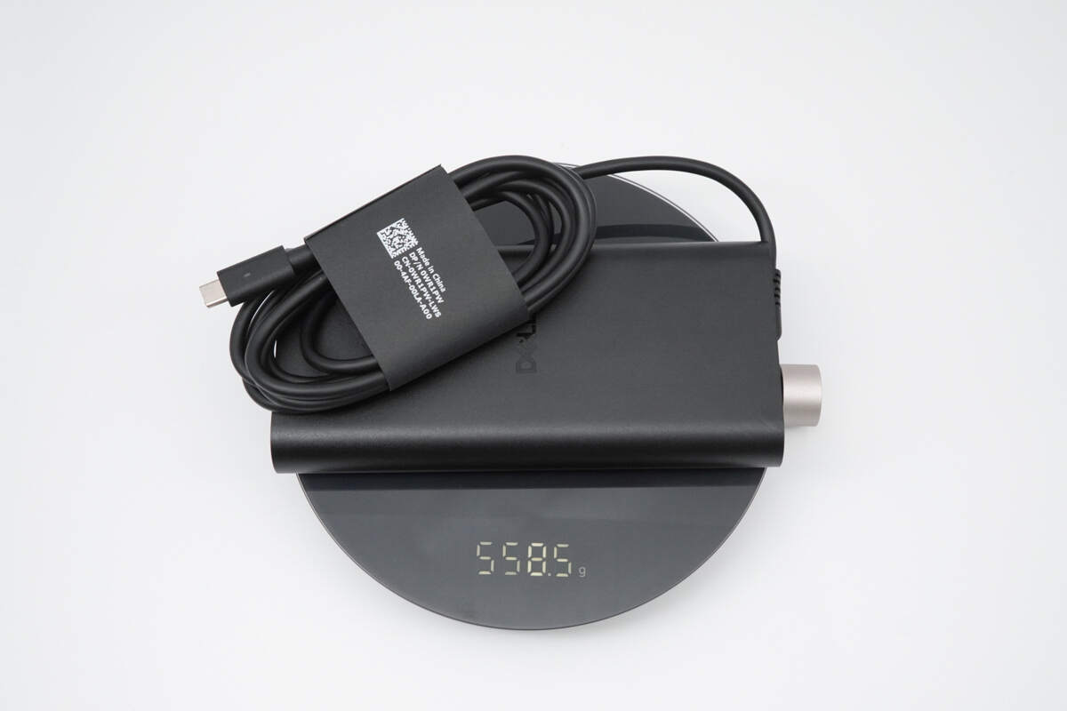

The weight is about 559 g (19.72 oz).

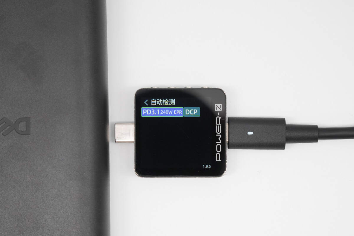

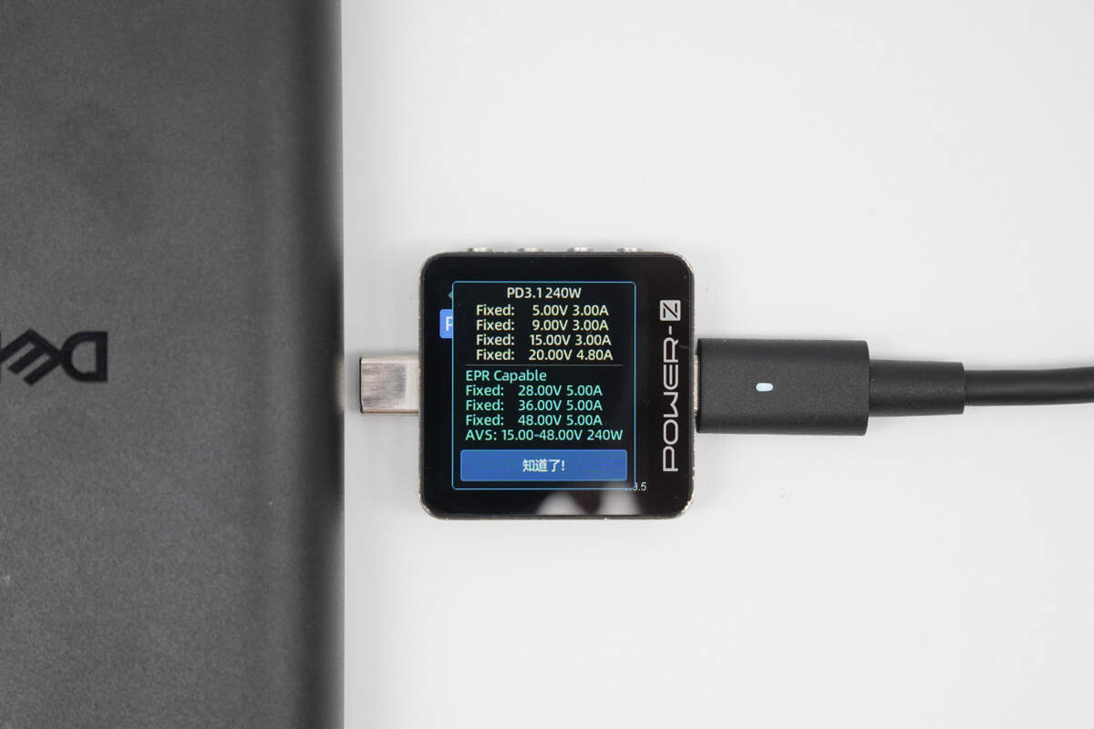

ChargerLAB POWER-Z KM003C shows it supports PD3.1 and DCP protocols.
It has seven fixed PDOs of 5V3A, 9V3A, 15V3A, 20V4.8A, 28V5A, 36V5A, and 48V5A. It also has one set of AVS, which is 15-48V 240W.
When used to charge the Aohi 240W PD3.1 power bank, the measured charging power was approximately 136W, successfully activating PD3.1 28V 5A 140W fast charging.

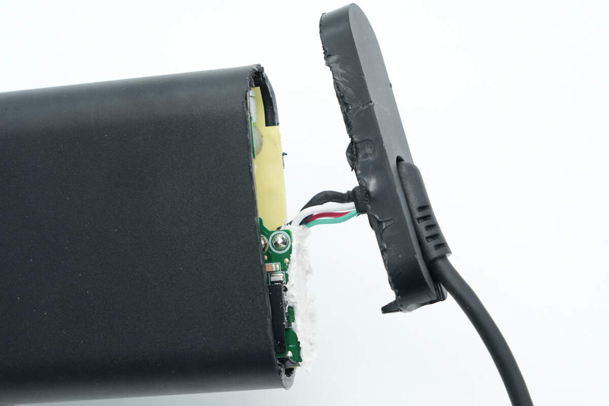

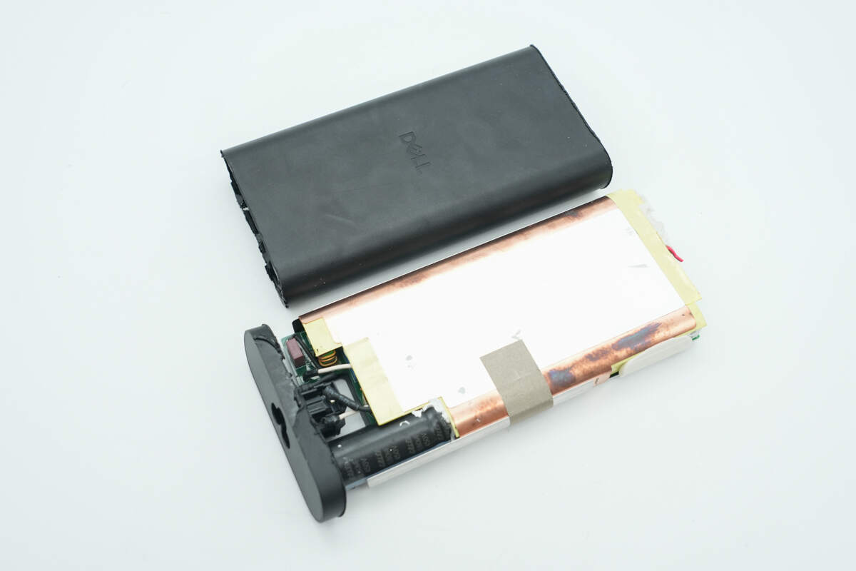

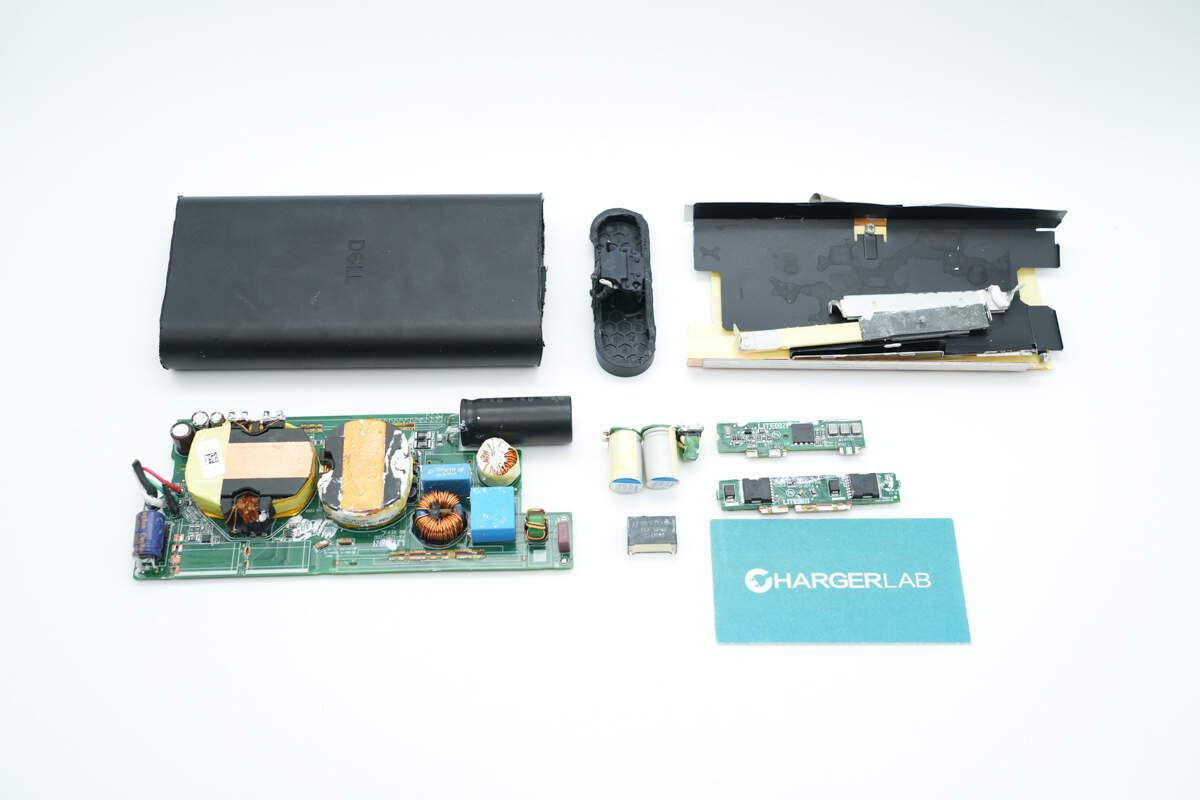

Remove the casing of the output end. The output wires are connected using crimp terminals with soldering.

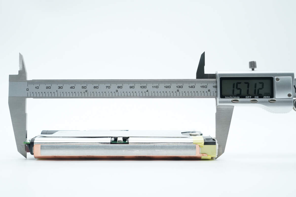

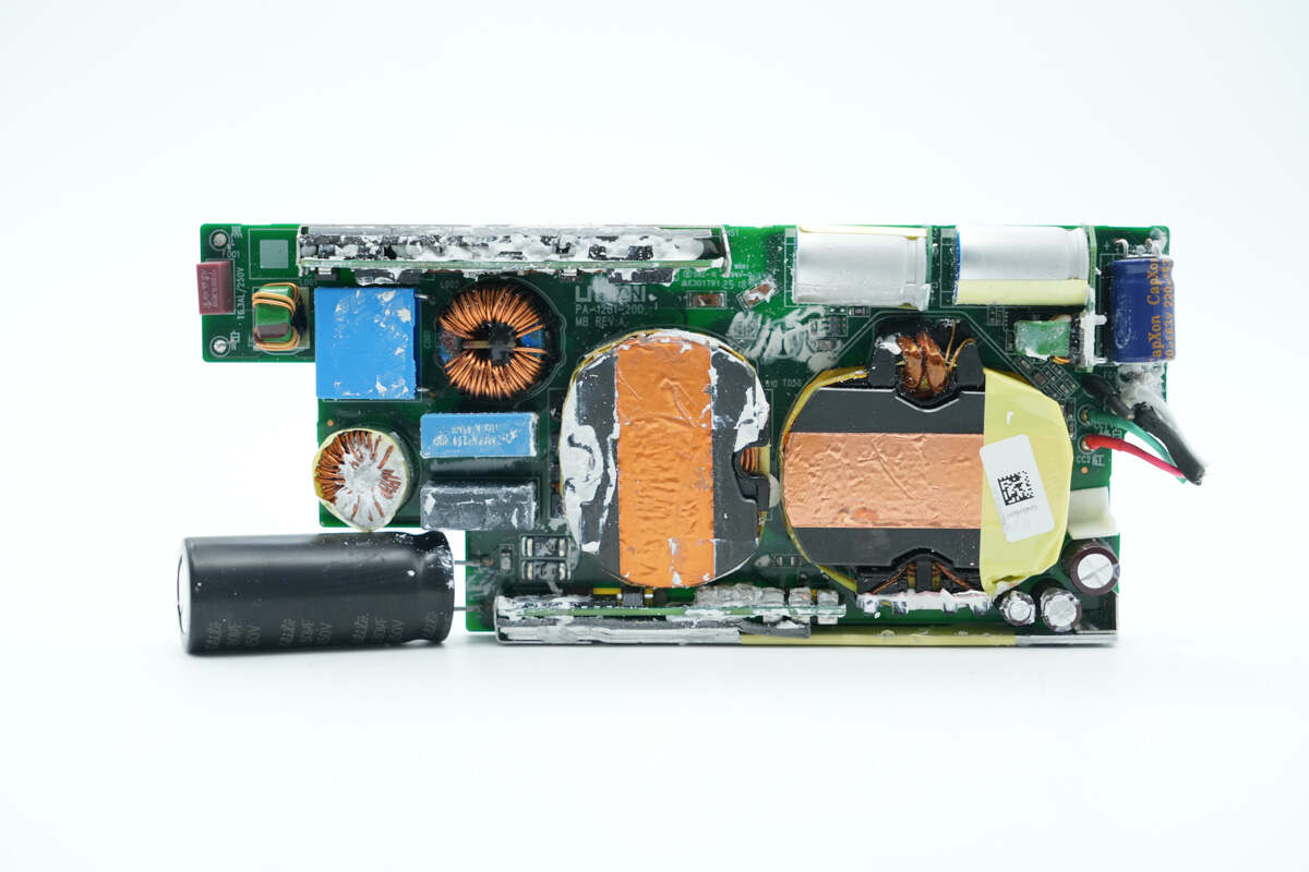

Disassemble the outer casing on the other end to remove the PCBA module.
The length of the PCBA module is about 157.12 mm (6.19 inches).

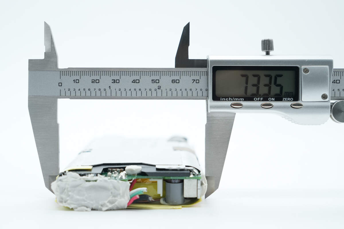

The width is about 73.35 mm (2.89 inches).
The thickness is about 18.57 mm (0.73 inches).

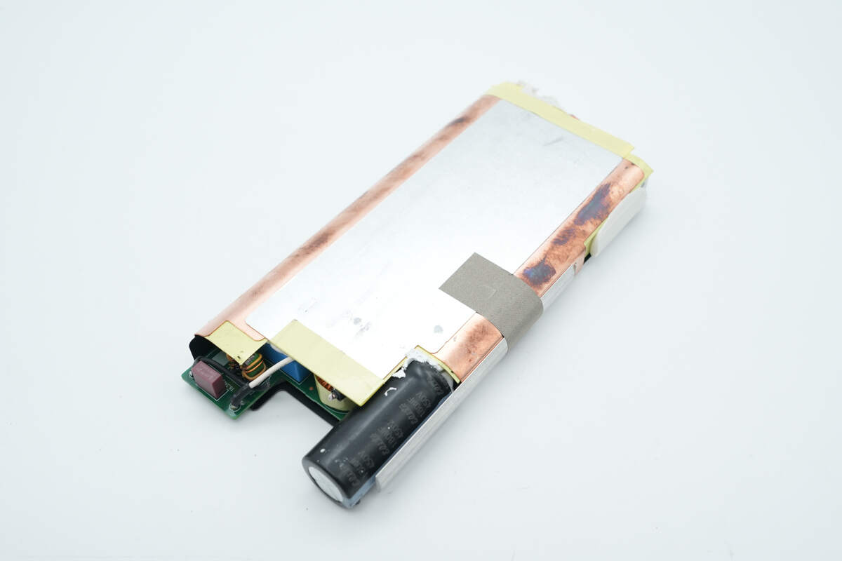

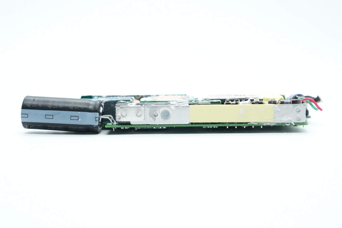

The PCBA module is covered with a copper heatsink and an aluminum plate.
The inner side of the heatsink is lined with insulating tape and a Mylar sheet.

Remove the white adhesive. The front side reveals components such as a time-delay fuse, common mode chokes, filter capacitors, a PFC boost inductor, and a transformer.
The back side contains components such as bridge rectifiers, a master control chip, HFB half-bridge MOSFETs, synchronous rectifiers, a synchronous buck converter, and a protocol chip.

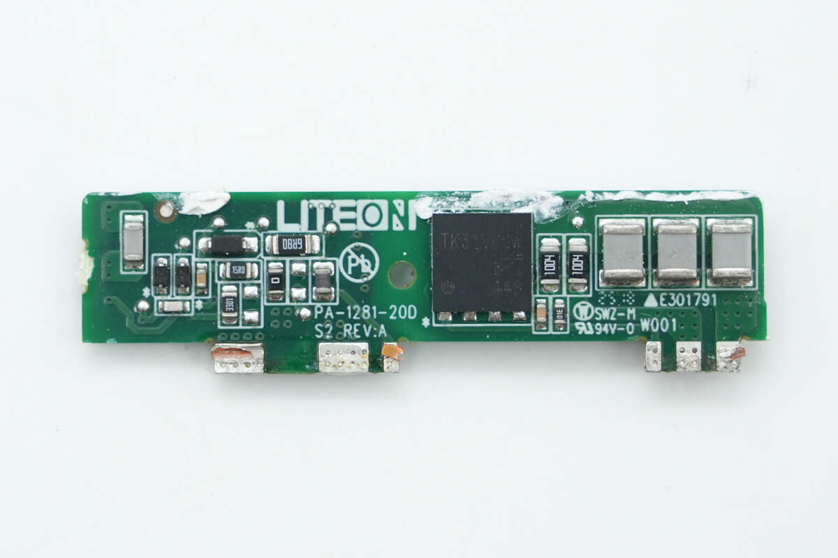

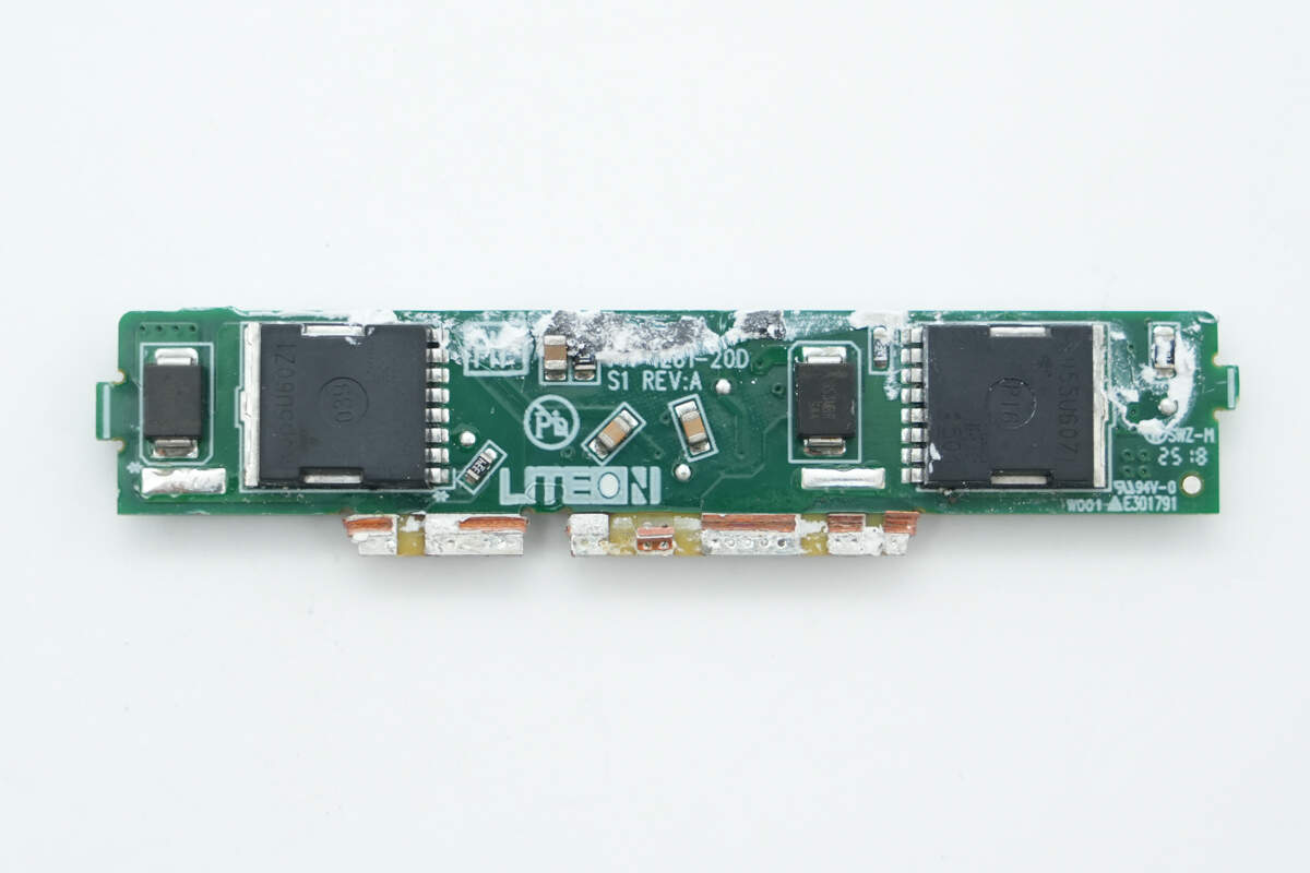

An active rectification PCB is soldered on the side.
Remove the active rectification PCB. The front side features an active rectification controller and two MOSFETs.
On the back side, there are two additional MOSFETs. This design uses four MOSFETs to replace the traditional bridge rectifier, driven by a controller that supports bridge rectification.
This solution effectively eliminates the majority of losses associated with conventional rectifier bridges, significantly improving the overall efficiency of the power supply. It offers advantages of high efficiency and low power loss, but requires a high-voltage driver and the use of four MOSFETs, which increases cost. This also reflects Dell’s commitment to quality in this power supply, demonstrating a willingness to invest in premium components to ensure product reliability.

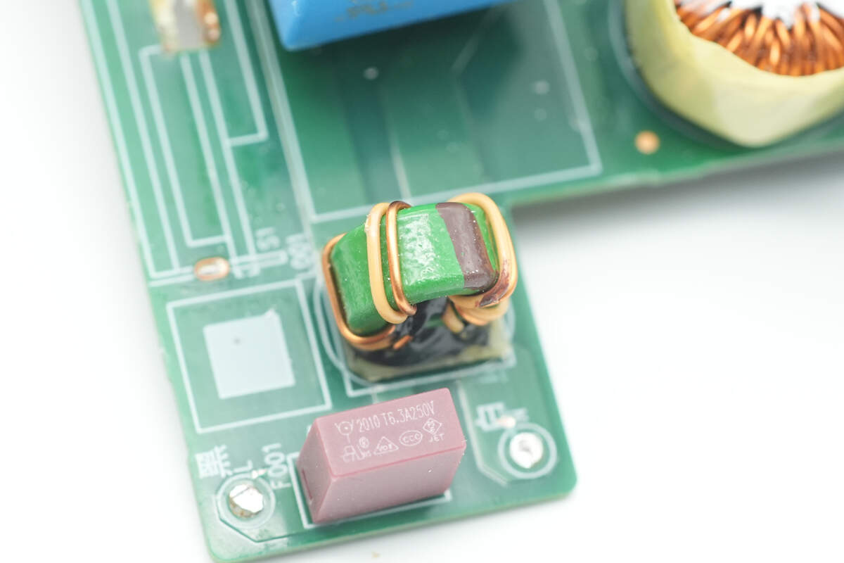

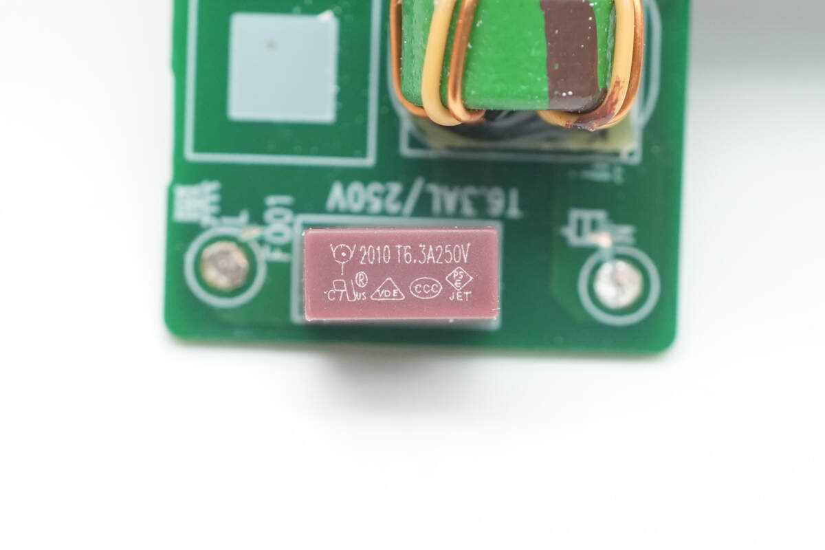

The time-delay fuse is from WalterFuse, with a rating of 6.3A 250V.
The common mode choke is dual-wound and used to filter out EMI interference.

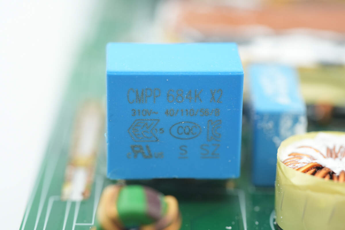

The safety X2 capacitor has a specification of 0.68μF.

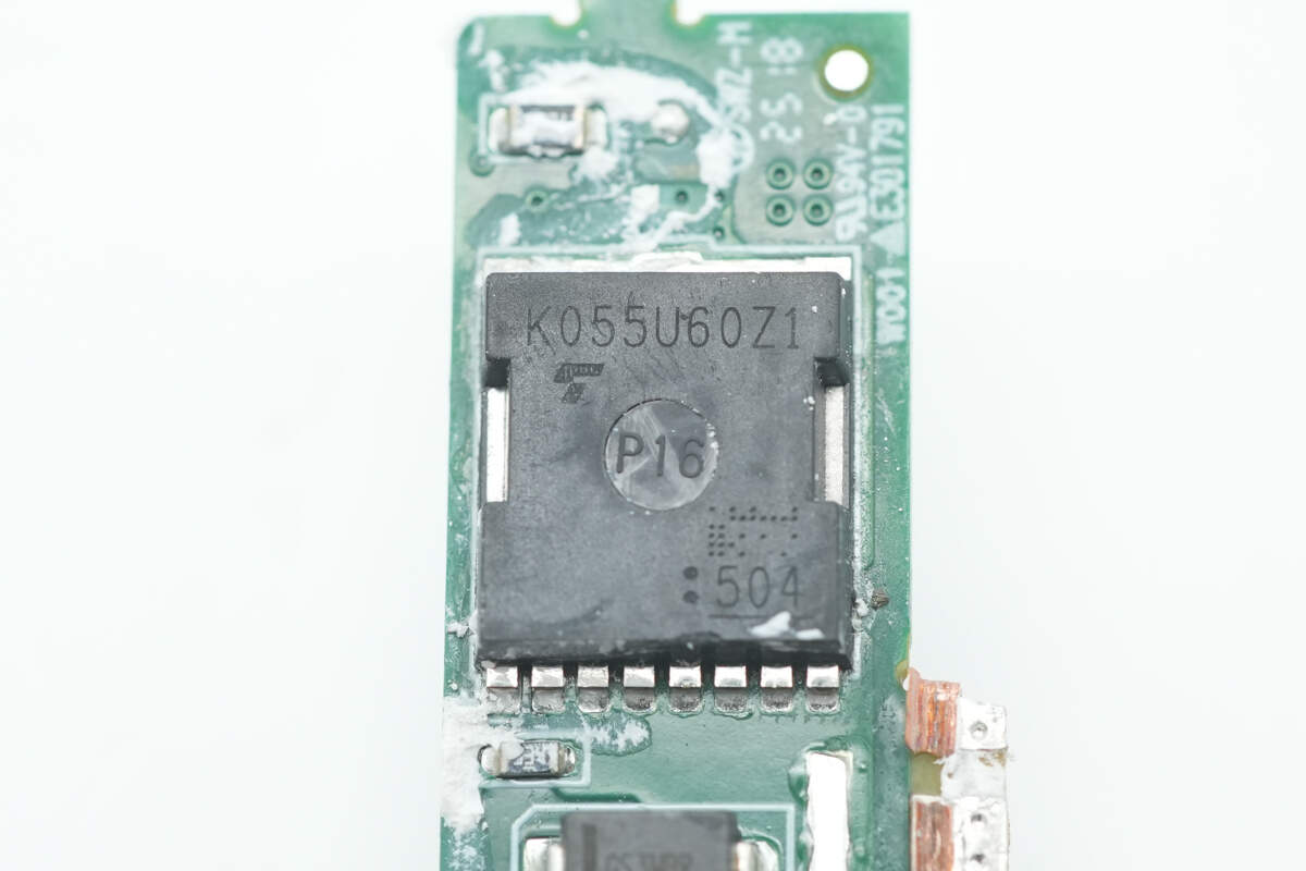

The four MOSFETs are from Toshiba, model TK055U60Z1. They are NMOS devices with a 600V voltage rating, an on-resistance of 0.046Ω, and come in a TOLL package.

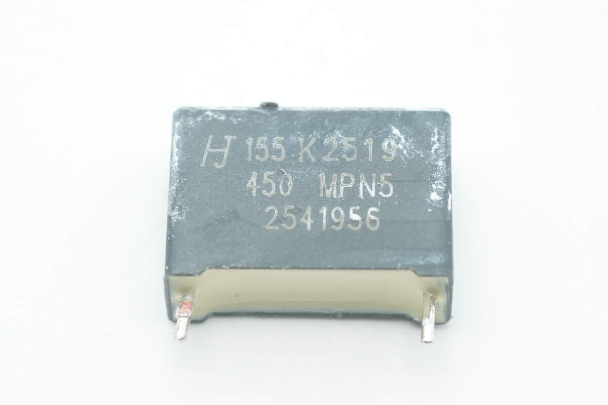

The film capacitor is specified as 1μF 450V.

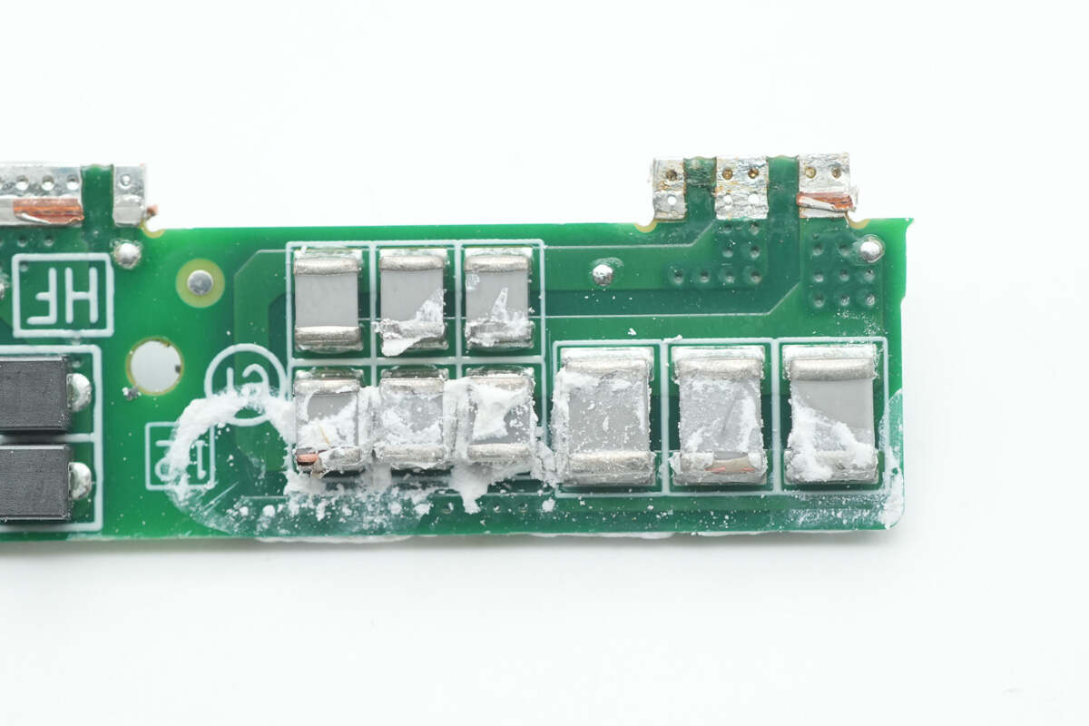

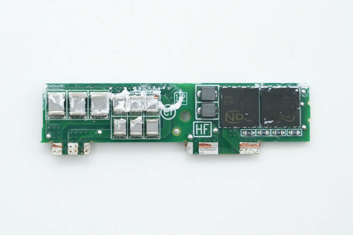

The other side of the PCBA module is soldered with the PFC boost PCB.

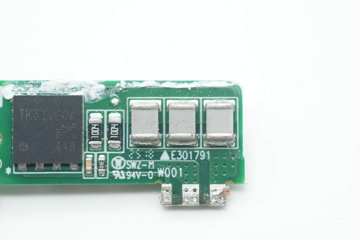

Remove the PFC boost PCB. The front side features NPO resonant capacitors and a MOSFET.
The reverse side is equipped with PFC MOSFETs and NPO resonant capacitors.

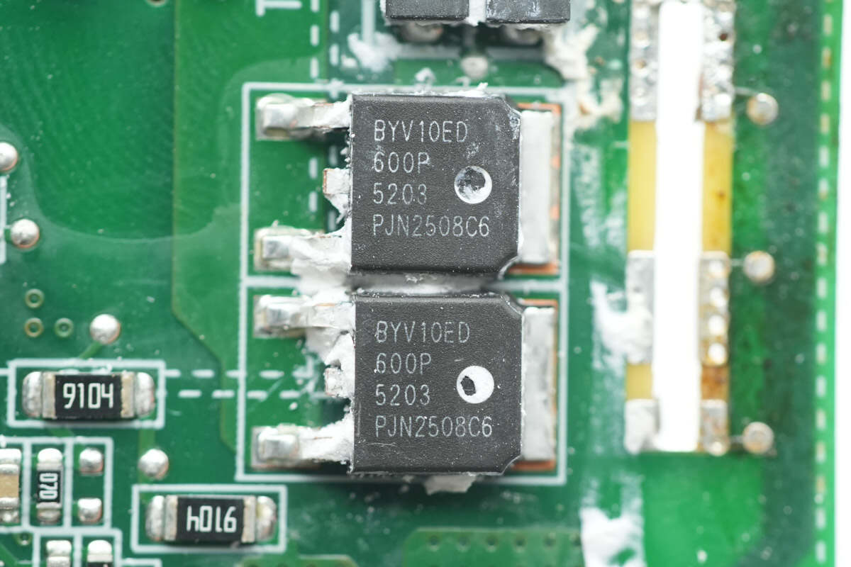

The PFC rectifiers are from RePower, model BYV10ED-600P. They are ultra-fast recovery diodes rated at 600V 10A, housed in a DPAK package.

The MOSFET used for resonant capacitors switching is from Toshiba, model TK31V60W. It is an NMOS device with a 600V voltage rating, 78mΩ on-resistance, and comes in an 8×8 mm DFN package.
Close-up of another set of NPO resonant capacitors.

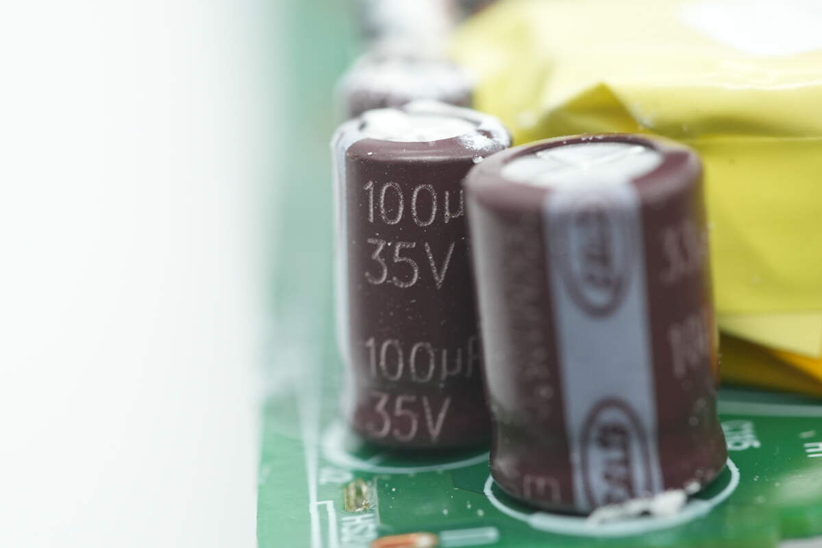

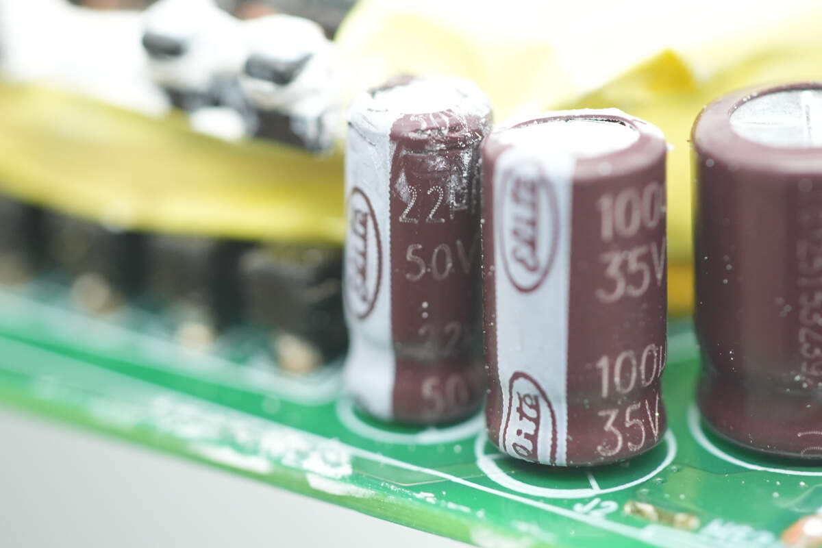

The capacitor supplying power to the master control chip is also from ELITE, with a specification of 22μF 50V.
The second capacitor is rated at 100μF 35V.

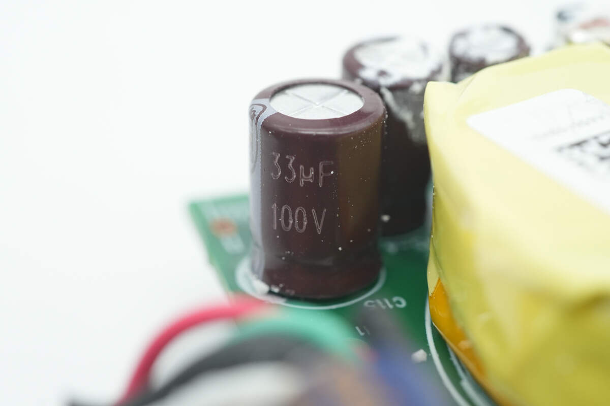

The third capacitor is specified as 33μF 100V.

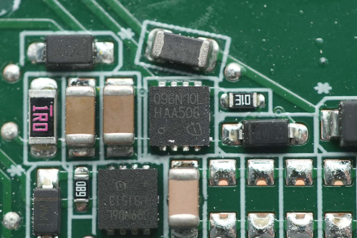

The power supply MOSFET is from Infineon, marked 096N10L, model BSZ096N10LS5. It is an NMOS device with a 100V voltage rating, 9.6mΩ on-resistance, and comes in a TSDSON-8 FL package.
The other power supply MOSFET is from Infineon, marked 099N06L, model BSZ099N06LS5. It is an NMOS device with a 60V voltage rating, 9.9mΩ on-resistance, and comes in a TSDSON-8 FL package.

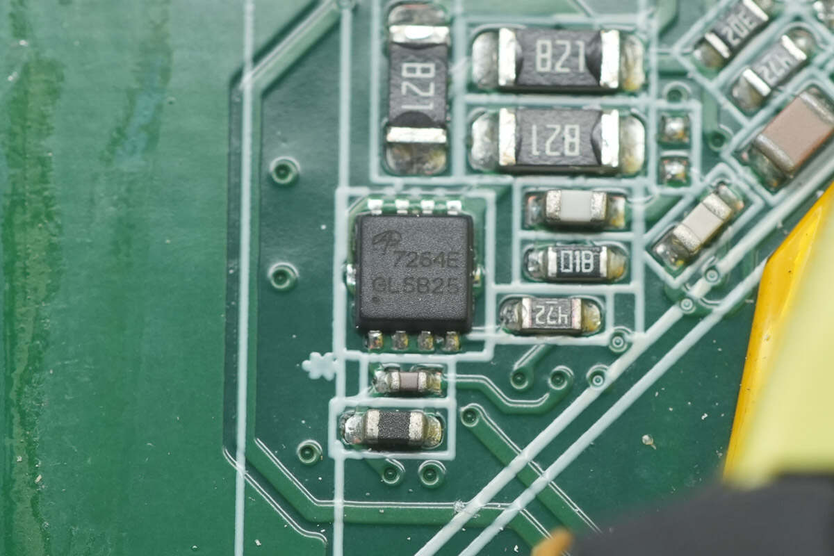

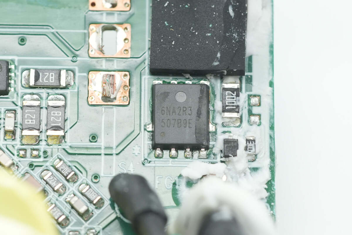

The output discharge MOSFET is from AOS, model AON7264E. It is an NMOS device with a 60V voltage rating, 7.7mΩ on-resistance, and comes in a DFN 3×3 EP package.

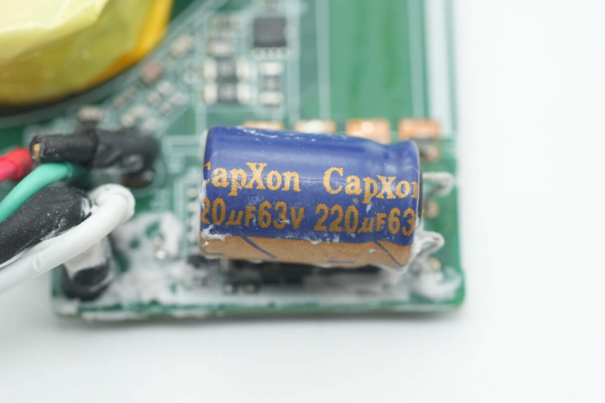

Two solid capacitors for output filtering are from CapXon, both rated at 470μF 63V.
There is an electrolytic capacitor for output filtering from CapXon, rated at 220μF 63V.

The output VBUS MOSFET is from XSEMI, model XP6NA2R3MT. It is an NMOS device with a 60V voltage rating, 2.3mΩ on-resistance, and comes in a PMP5×6 package.
