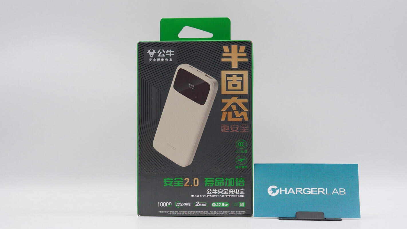

The front of the packaging features the Bull logo along with an image of the product's appearance.

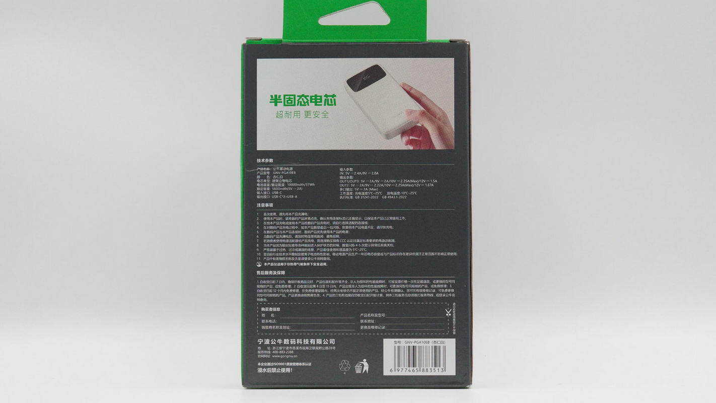

The back of the packaging contains information such as product specifications, retailer details, and important precautions.

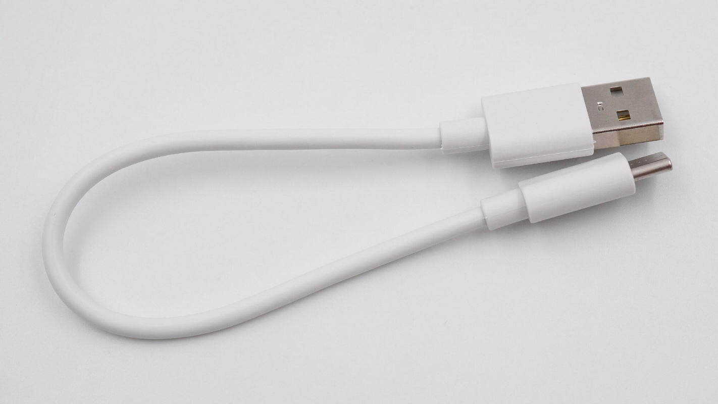

A USB-A to USB-C charging cable is included in the package.

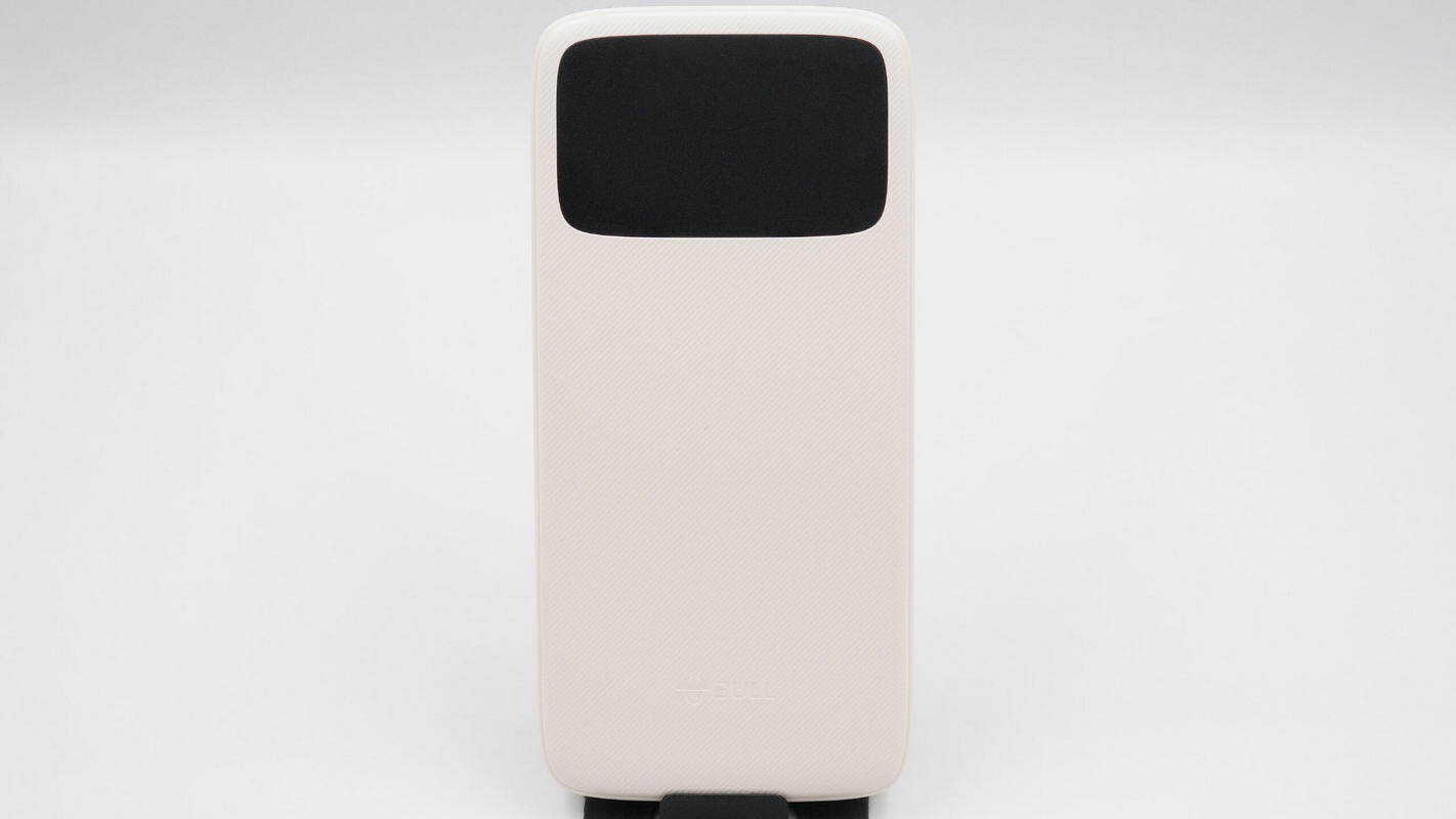

The power bank features a light beige color scheme. The top section of the front has a display screen, with the BULL logo printed below it.

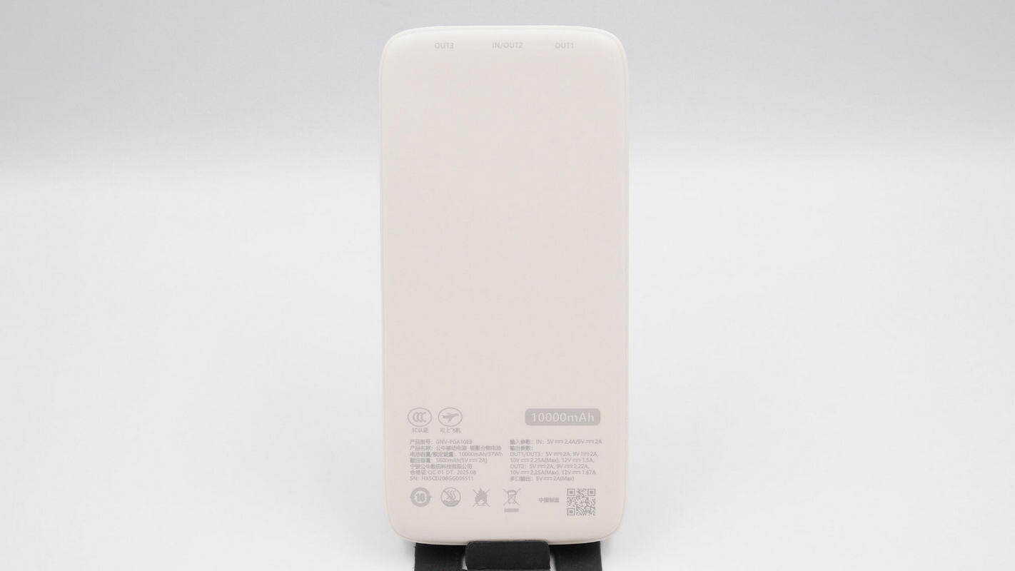

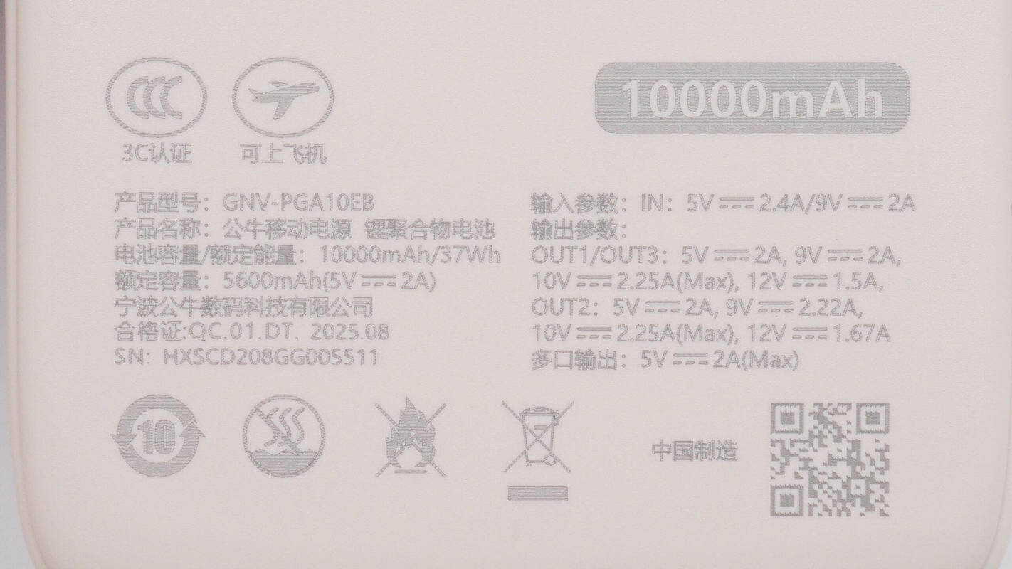

The back of the power bank displays the parameter information.
Teardown of Bull 22.5W 10000mAh Semi-Solid State Power Bank (GNV-PGA10EB)-Chargerlab
Model: GNV-PGA10EB
Battery Capacity / Rated Energy: 10000mAh / 37Wh
Rated Capacity: 5600mAh (5V2A)
Input Parameters (IN): 5V2.4A, 9V2A
Output Parameters:
OUT1 / OUT3: 5V2A, 9V2A, 10V2.25A (Max), 12V1.5A
OUT2: 5V2A, 9V2.22A, 10V2.25A (Max), 12V1.67A
Multi-port Output: 5V2A (Max)

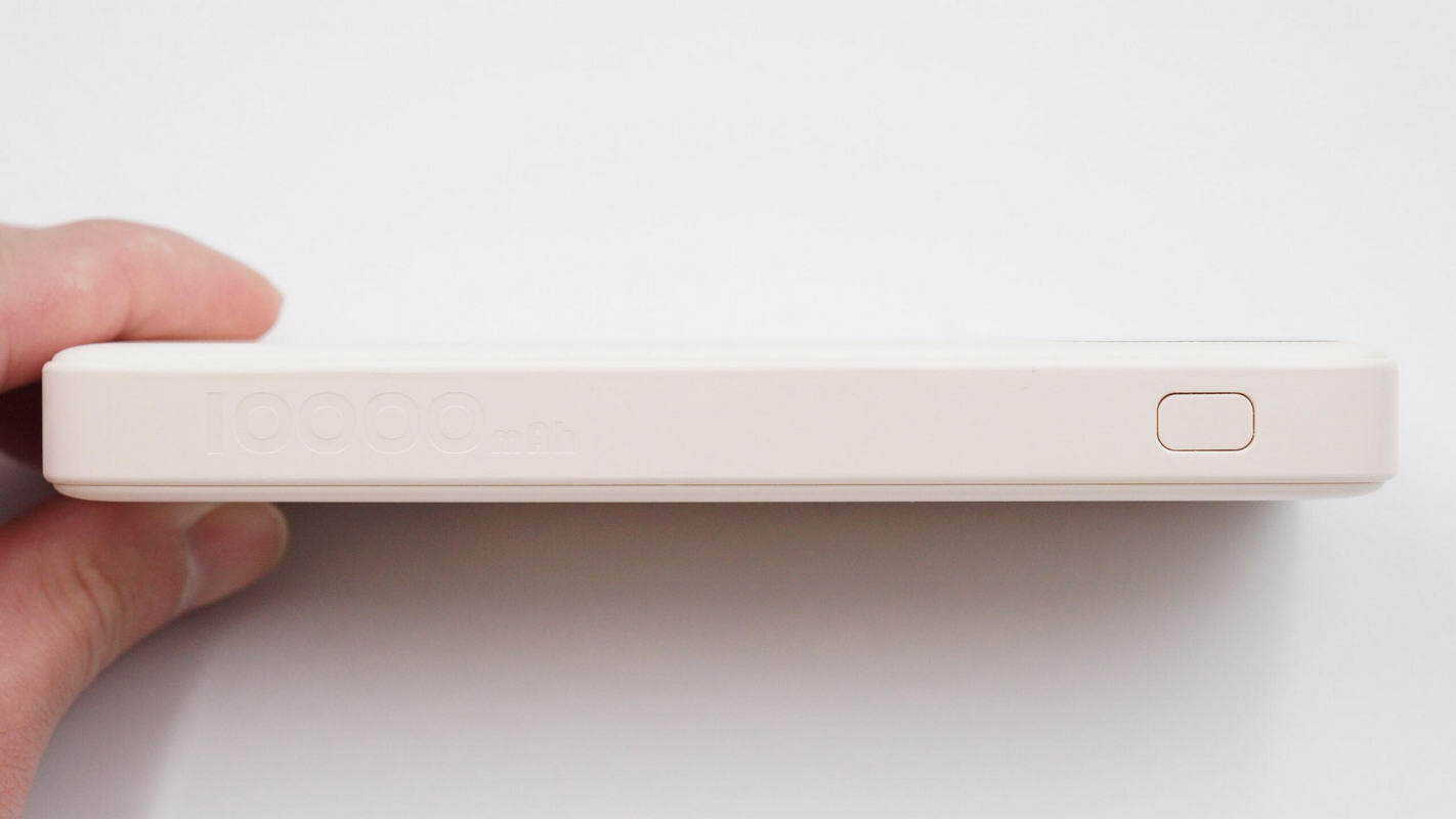

The side features a power button.

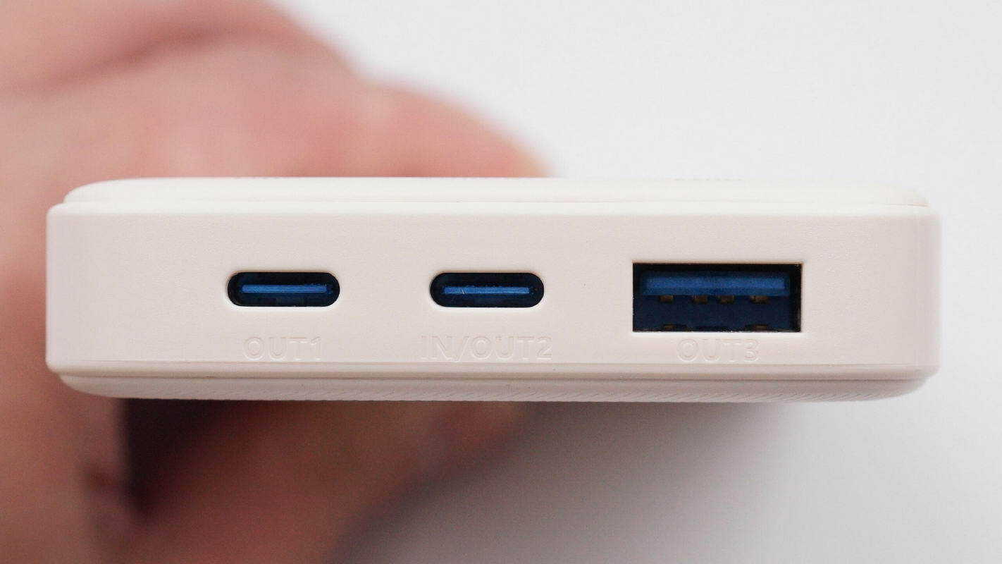

The top houses two USB-C ports and one USB-A port, with the middle USB-C2 supporting both input and output.

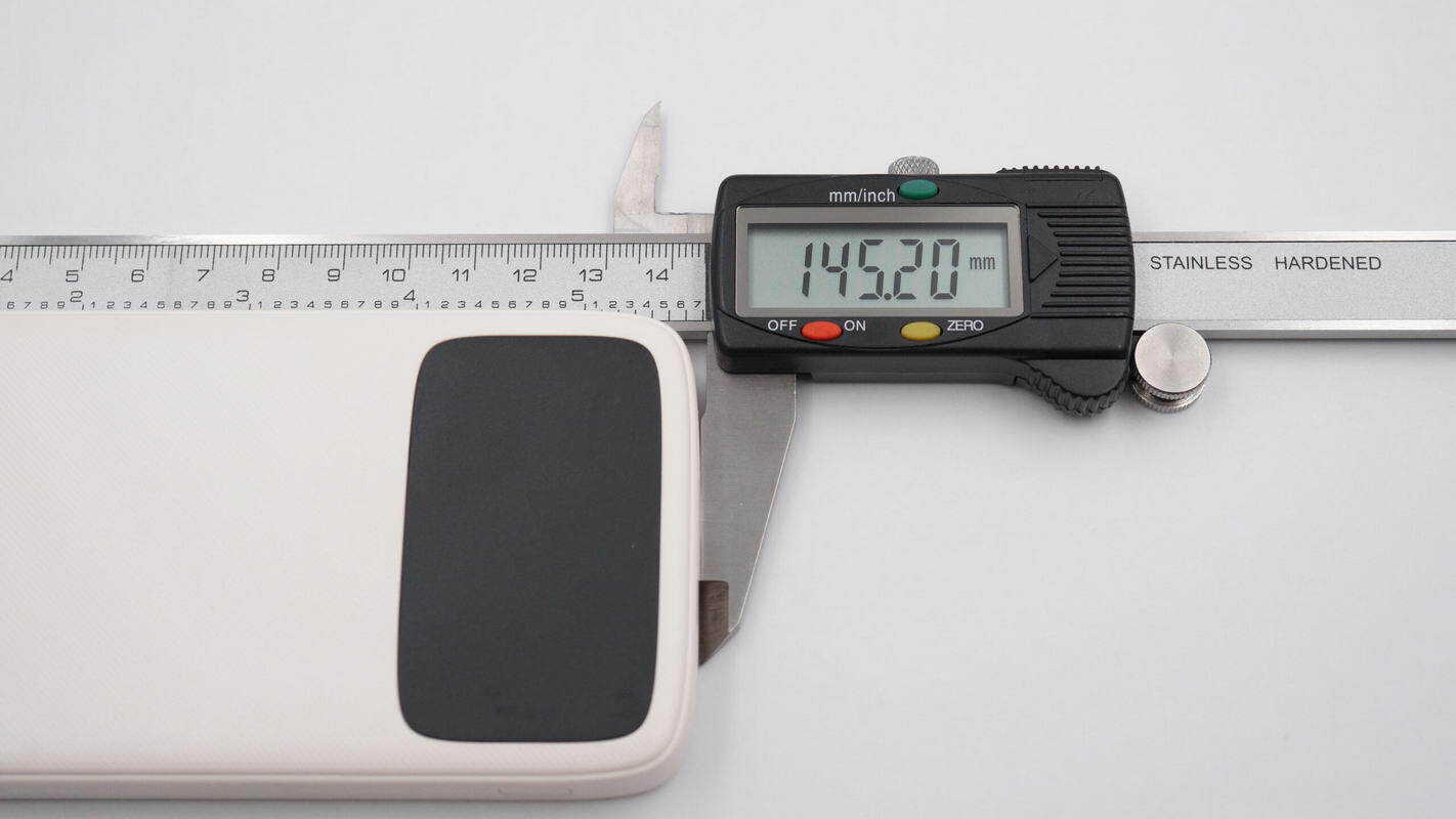

The length of the power bank is about 145.2 mm (5.72 inches).

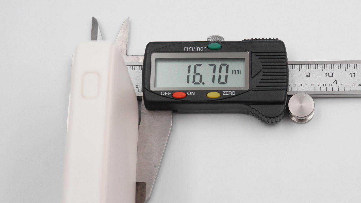

The thickness is about 16.7 mm (0.66 inches).

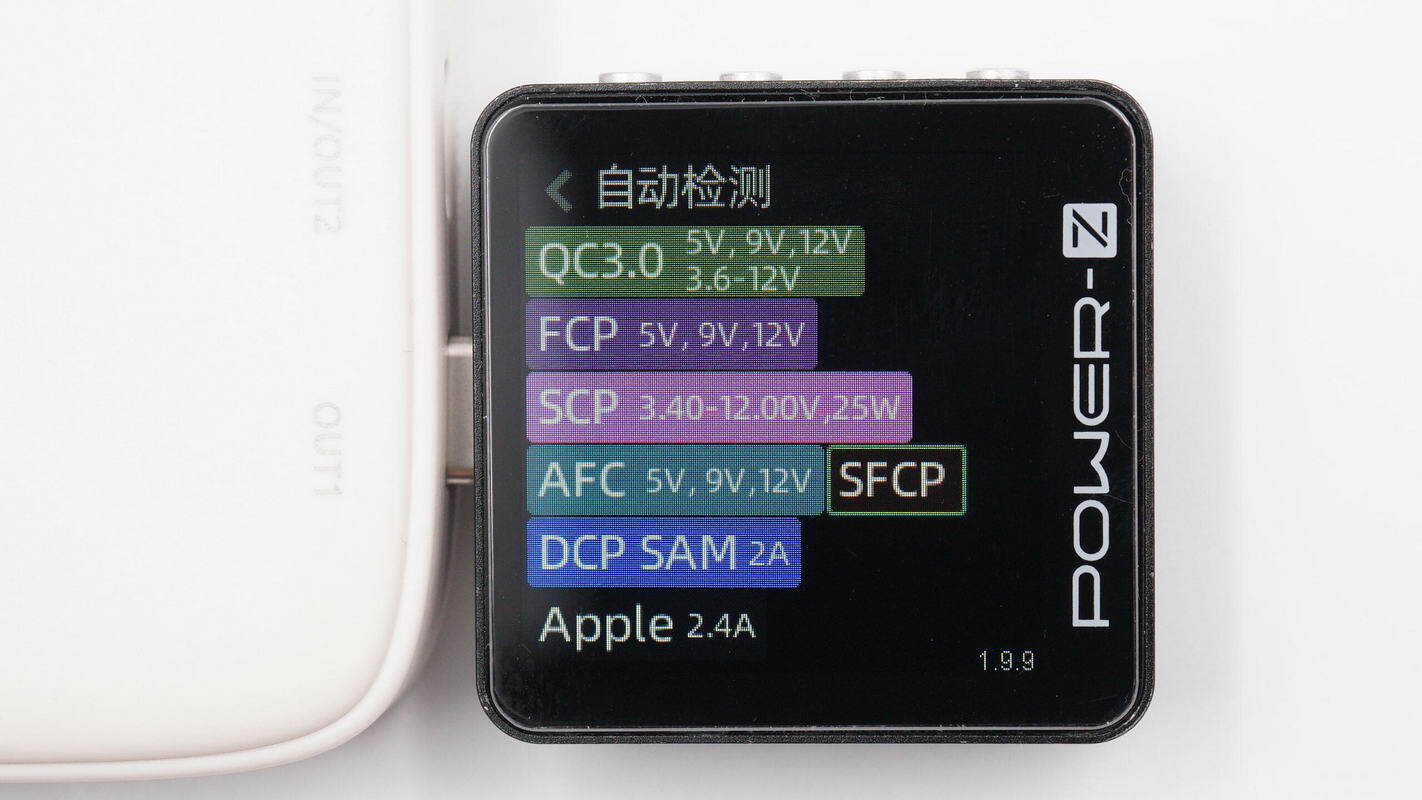

ChargerLAB POWER-Z KM003C shows that the USB-C1 supports QC3.0, FCP, SCP, AFC, DCP, SFCP, and Apple 2.4A charging protocols.

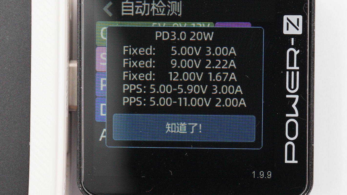

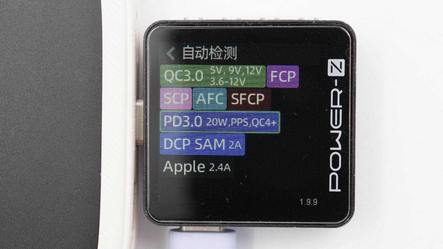

The USB-C2 supports PD3.0, PPS, QC4+/3.0, FCP, SCP, AFC, DCP, SFCP, and Apple 2.4A charging protocols.
And it has three fixed PDOs of 5V3A, 9V2.22A, and 12V1.67A. It also has two sets of PPS, which are 5-5.9V3A and 5-11V2A.

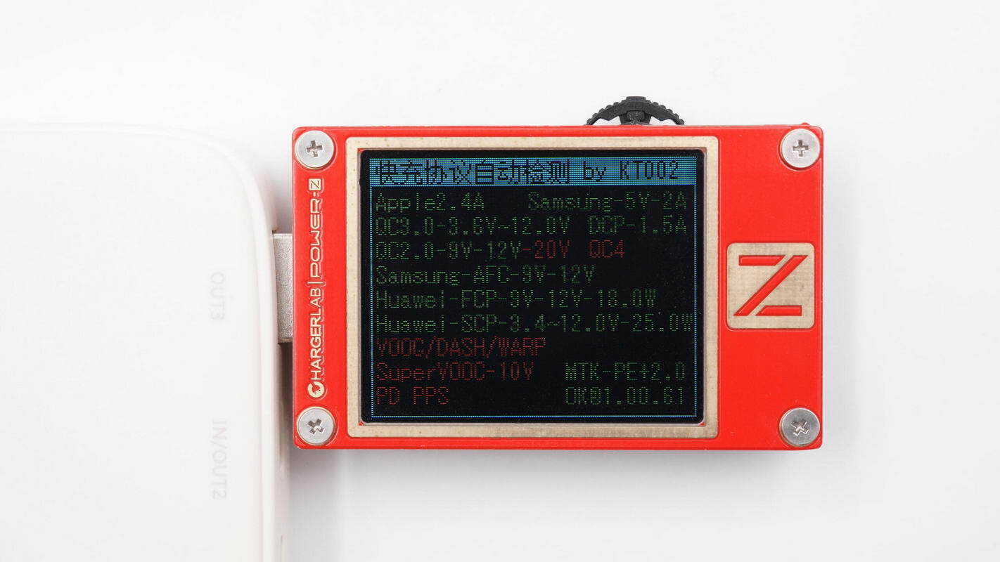

Using the KT002, it was measured that the USB-A port supports charging protocols such as Apple 2.4A, Samsung, QC3.0/2.0, AFC, SCP, and PE2.0.

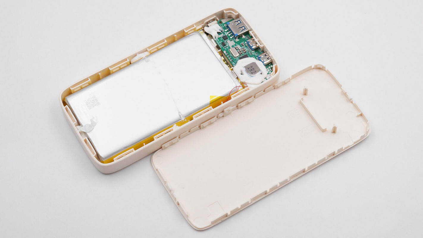

Pry open the bottom panel along the seam. The bottom panel is secured by clips.

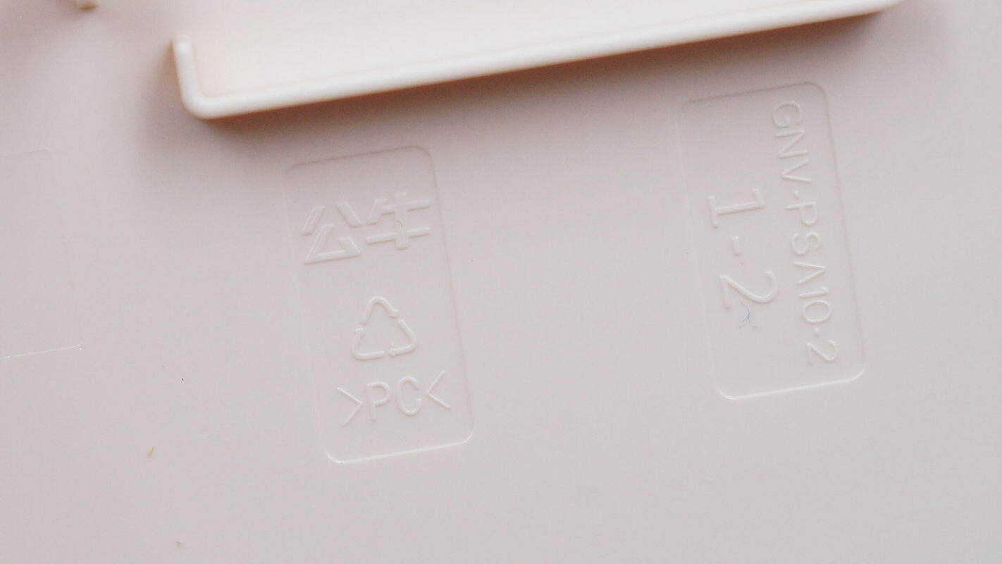

The injection-molded text indicates that the material is PC (polycarbonate), which is highly flame-retardant, has good toughness, impact resistance, and relatively good heat resistance.

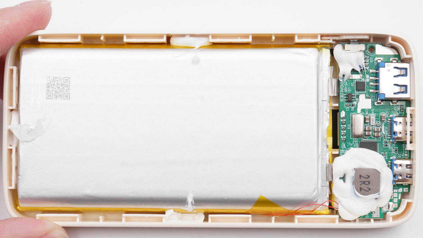

The battery cell is wrapped in a silver aluminum-plastic film, with yellow insulating tape applied along the edges for added protection. Around the corners, white glue can be seen, used to secure the cell in place within the casing. This helps prevent movement of the cell inside the housing while enhancing shock resistance and abrasion protection.

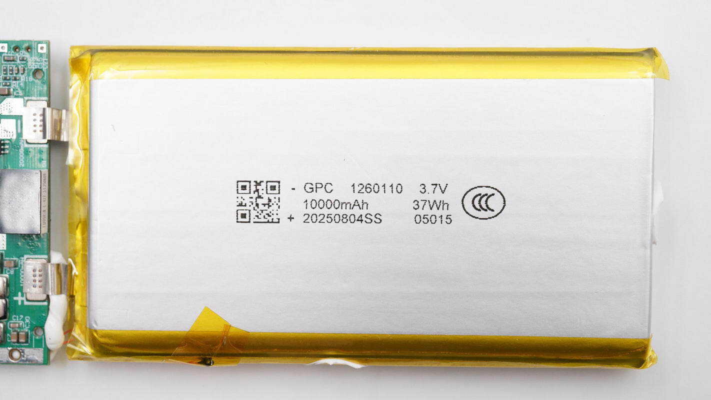

The semi-solid-state battery cell is supplied by GPC, with a specification of 1260110. It has a nominal voltage of 3.7V, a capacity of 10000mAh, and an energy rating of 37.0Wh. The cell has also passed CCC certification.

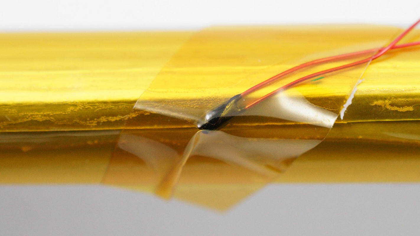

The thermistor is affixed to the side of the battery cell using yellow high-temperature insulating tape.

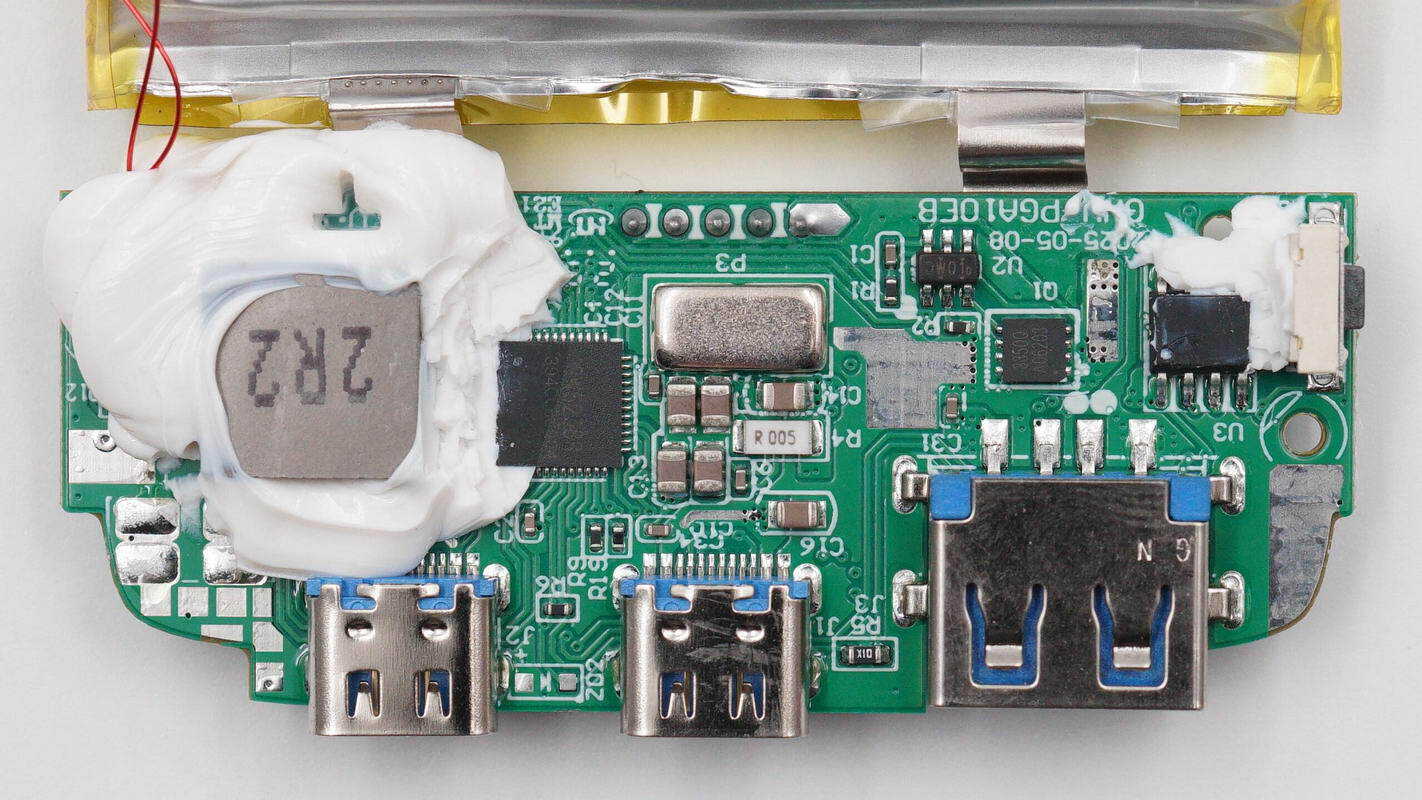

The front of the PCB features an alloy inductor, the master control chip, a battery protection chip, a battery protection MOSFET, and the MCU.

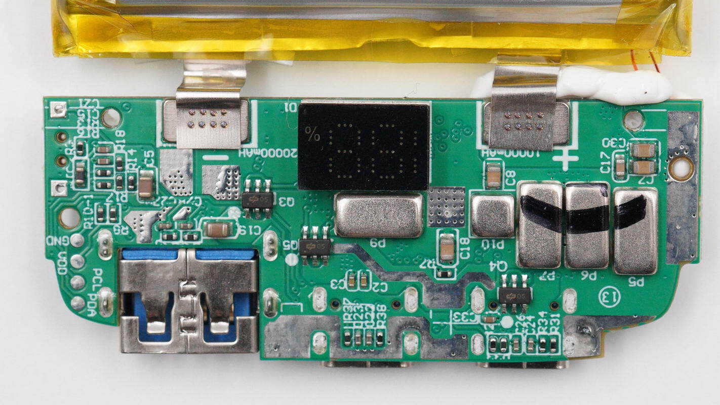

The back of the PCB contains VBUS MOSFETs and the digital display module. The battery cell is connected to the PCB via nickel sheets welded at the points.

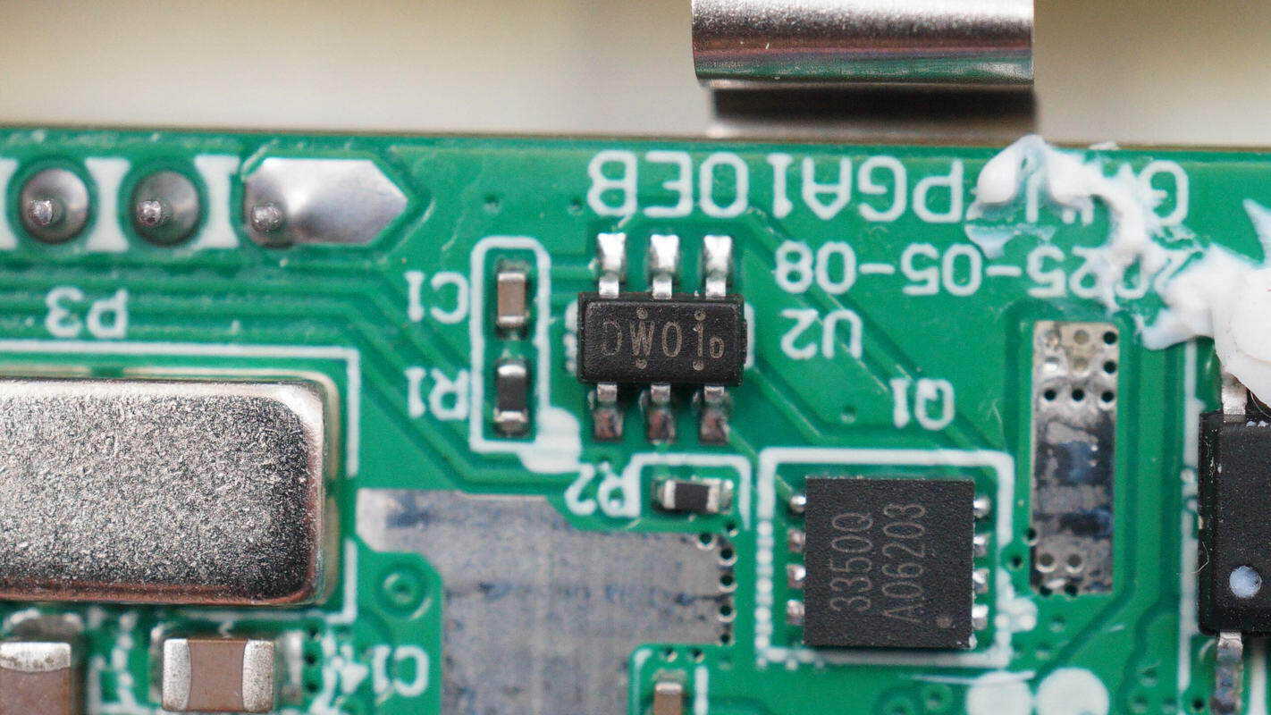

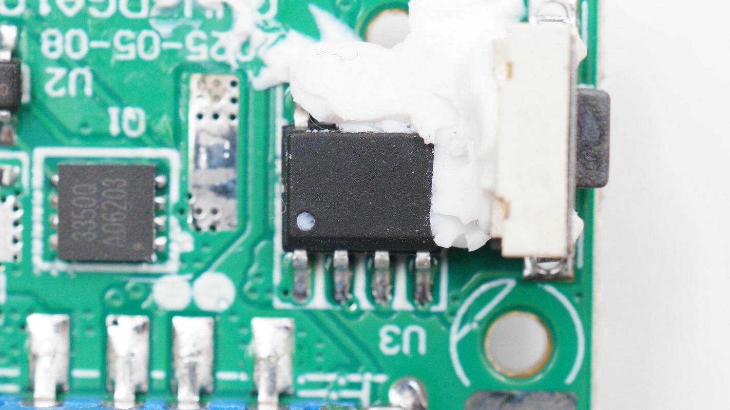

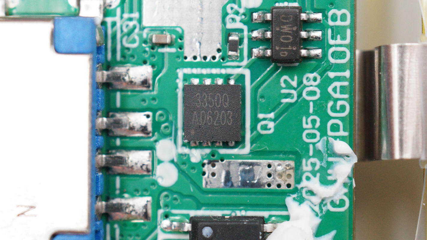

The battery protection chip is marked with DW01. This is a lithium battery protection IC that provides over-discharge, over-charge, over-current, and short-circuit protection functions.

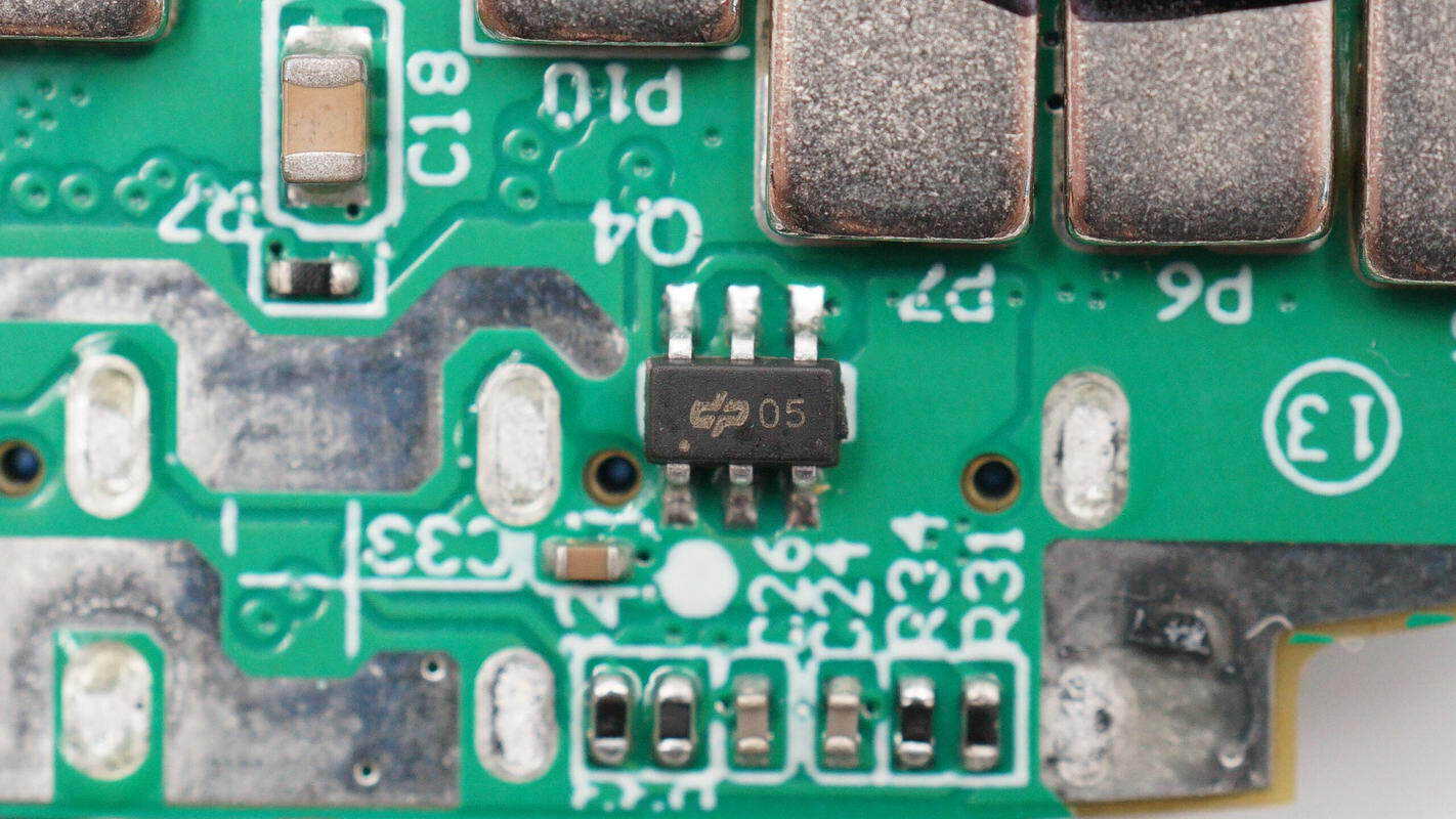

The battery protection MOSFET is marked with 33500.

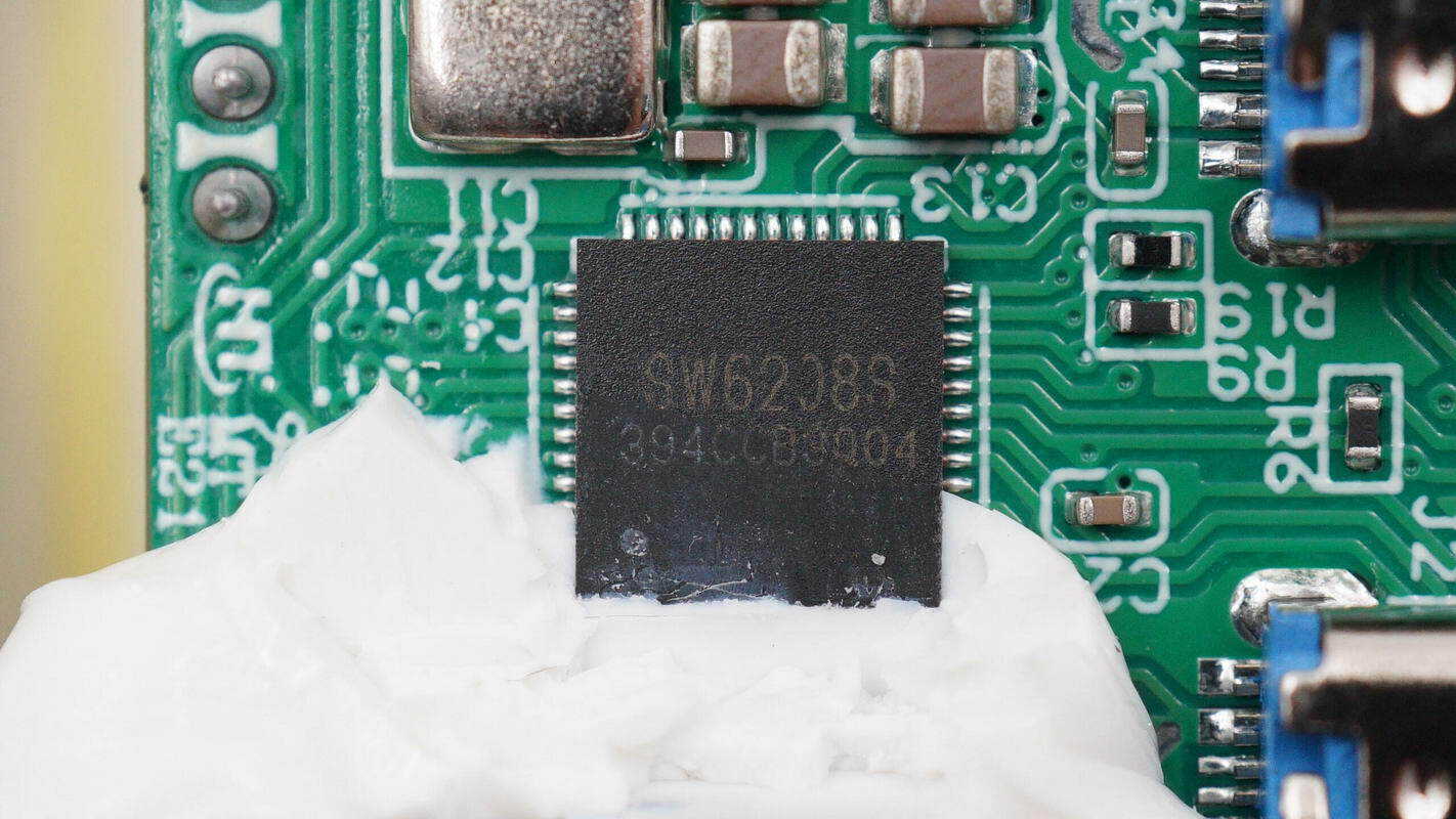

The master control chip is from iSmartWare, model SW6208S. This is a highly integrated, multi-protocol bidirectional fast charging IC designed specifically for power banks. It supports fast charging on any port (A+A+B+C+L5). The chip integrates 5A high-efficiency switch-mode charging and 24W efficient synchronous boost output.
The SW6208S supports switch-mode charging up to 5A with an efficiency of 96%, features synchronous boost capabilities, and provides an output power of up to 22.5W. It includes automatic load detection, supports wireless charging and low current modes, ensuring efficient charging. The chip is compatible with multiple protocols, including PPS, PD3.0, and QC3.0, making it suitable for a wide range of devices.
The SW6208S also integrates a Type-C interface, BC1.2 module, battery measurement and display functions, a 188-segment digital display, button support, and comprehensive protection mechanisms, providing users with convenience and safety. Its I2C interface and compact QFN-48 (6x6mm) package make it easy to integrate into various applications, making it an ideal choice for power bank designs. It offers powerful features and outstanding performance for the product.

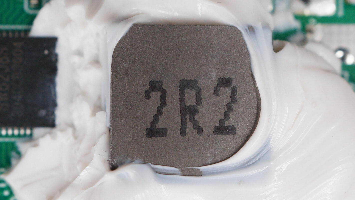

The boost inductor is made of alloy, with an inductance of 2.2μH. It is secured with white encapsulation around it for heat dissipation.

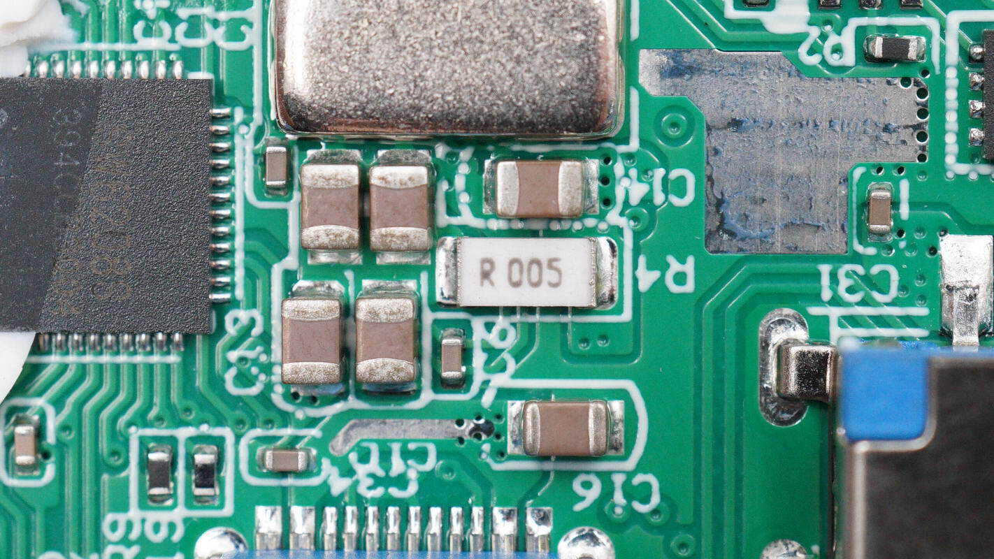

Close-up of the R005 current sampling resistor.

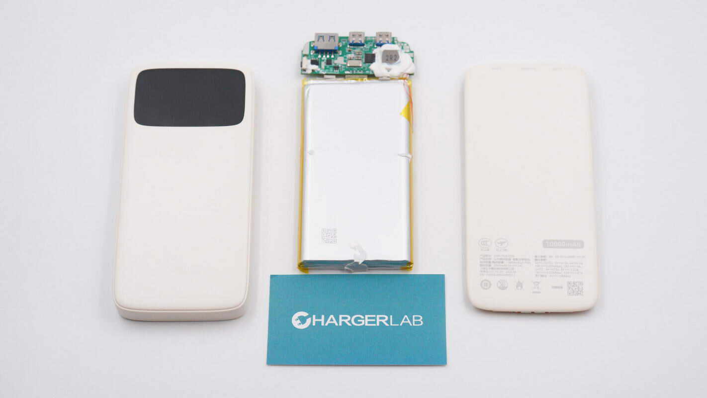

Well, those are all components of the Bull 22.5W 10000mAh Semi-Solid State Power Bank.

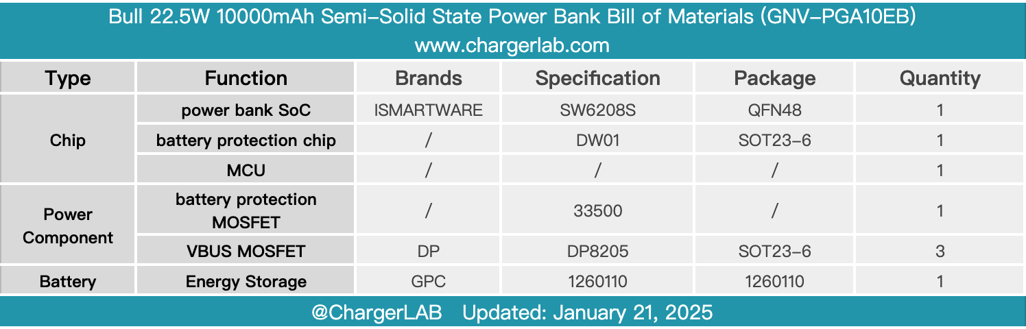

Here is the component list of the Bull 22.5W 10000mAh Semi-Solid State Power Bank for your convenience.
