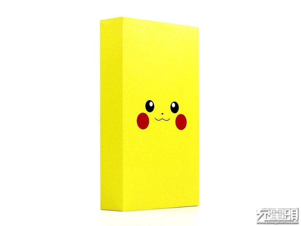

Lovely Picachu yellow box. Pika pika!

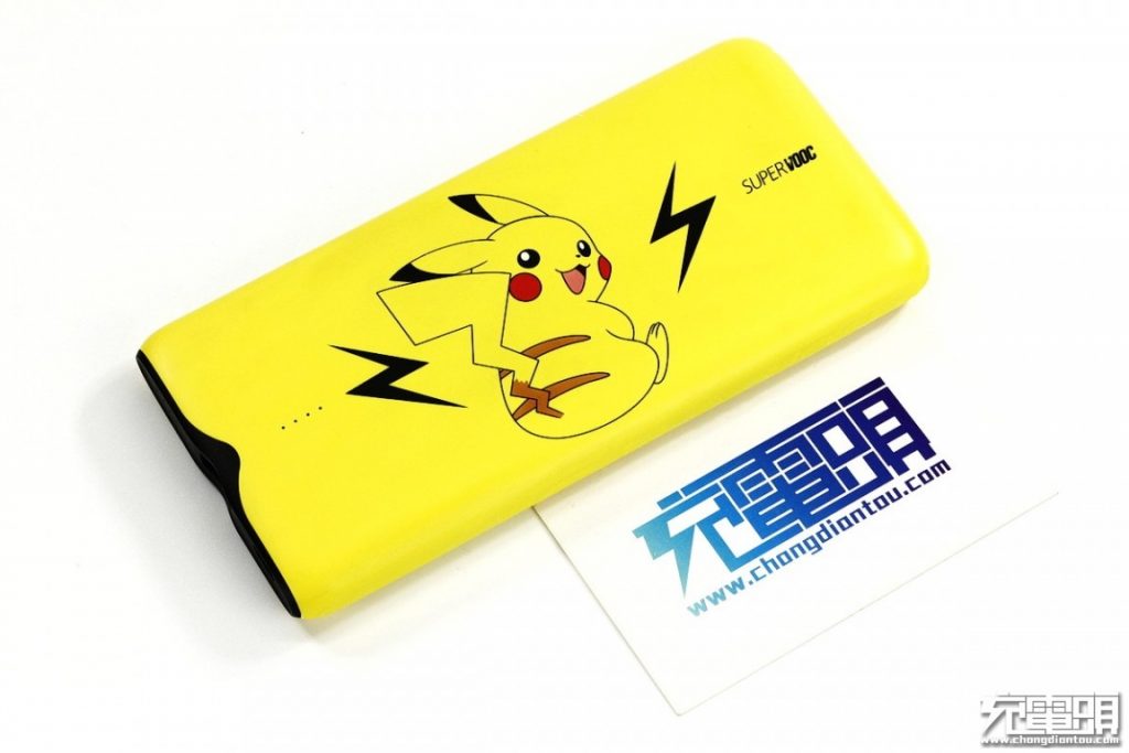

OPPO SuperVOOC 50W Power Bank Teardown Review: Pikachu Power!-Chargerlab

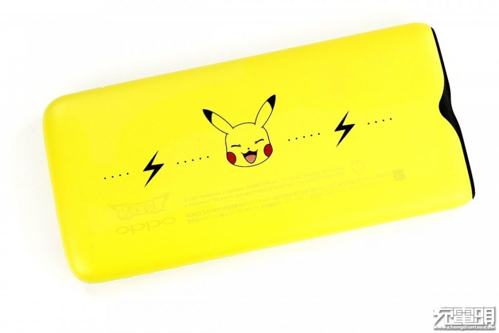

Cute Pikachu face on the back.

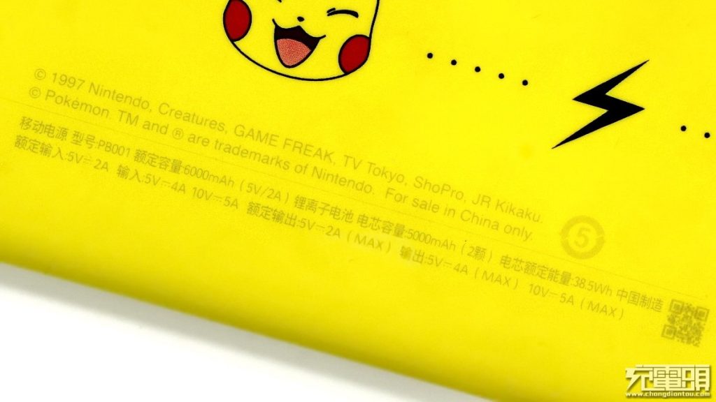

Specifications.

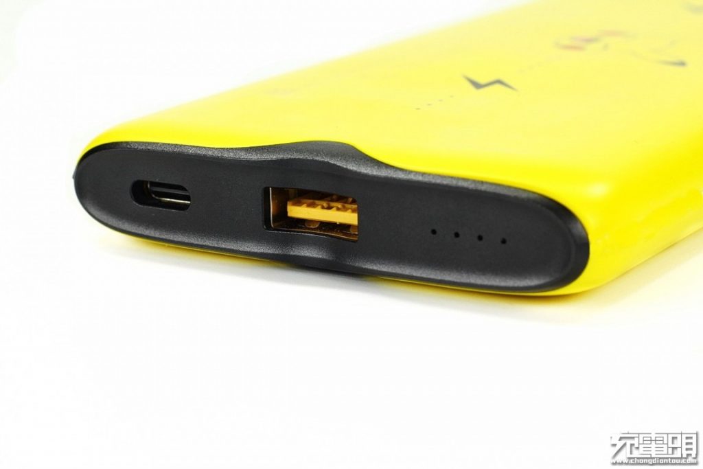

It has a USB-A output port and a USB-C input port for charging. The USB-C port does not support power output.

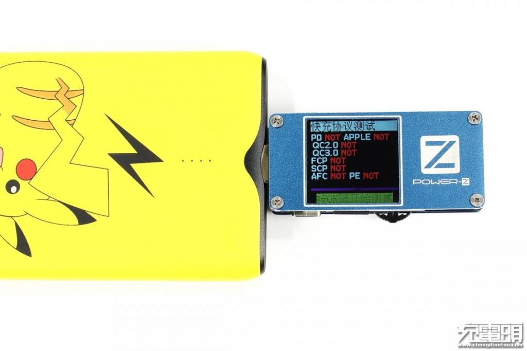

Using our ChargerLAB Power-Z FL001S USB tester, it shows that the power bank does not support common fast charging protocols.

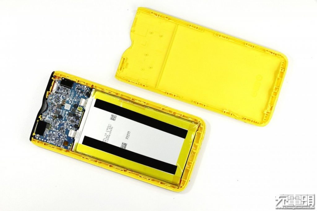

Removing the housing reveals the PCBA and battery cells inside. The size of the PCBA is much larger than the conventional 10000mAh power banks to be able to output power of 50W.

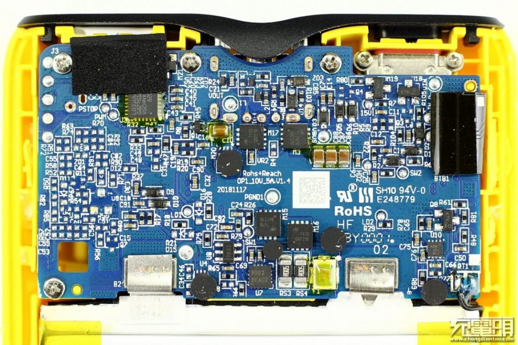

The PCBA is mounted on the housing using four screws. The blue board is covered with components, and the battery is connected to the PCBA with a nickel strap.

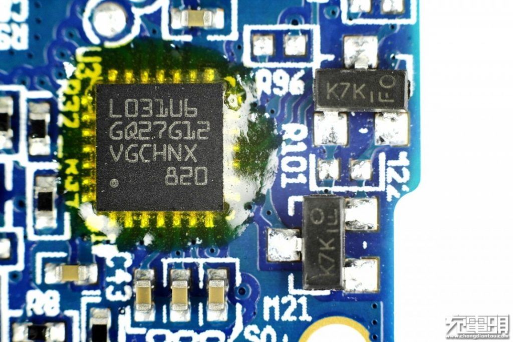

An MCU from STMicroelectronics, the pad is glued.

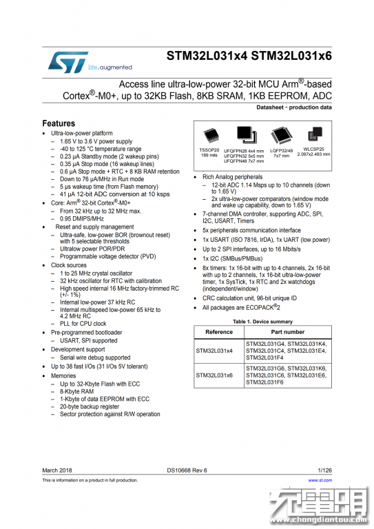

The STMicroelectronics STM32L031 is an ultra-low-power 32-bit microcontroller with a minimum operating voltage of 1.65V and an operating frequency from 32kHz to 32MHz.

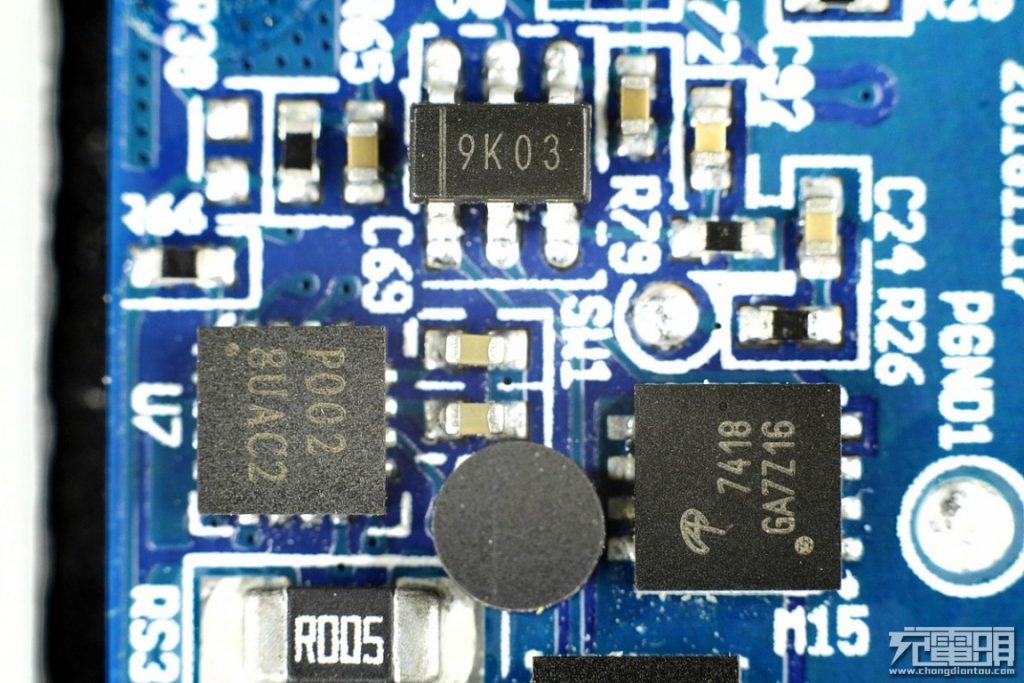

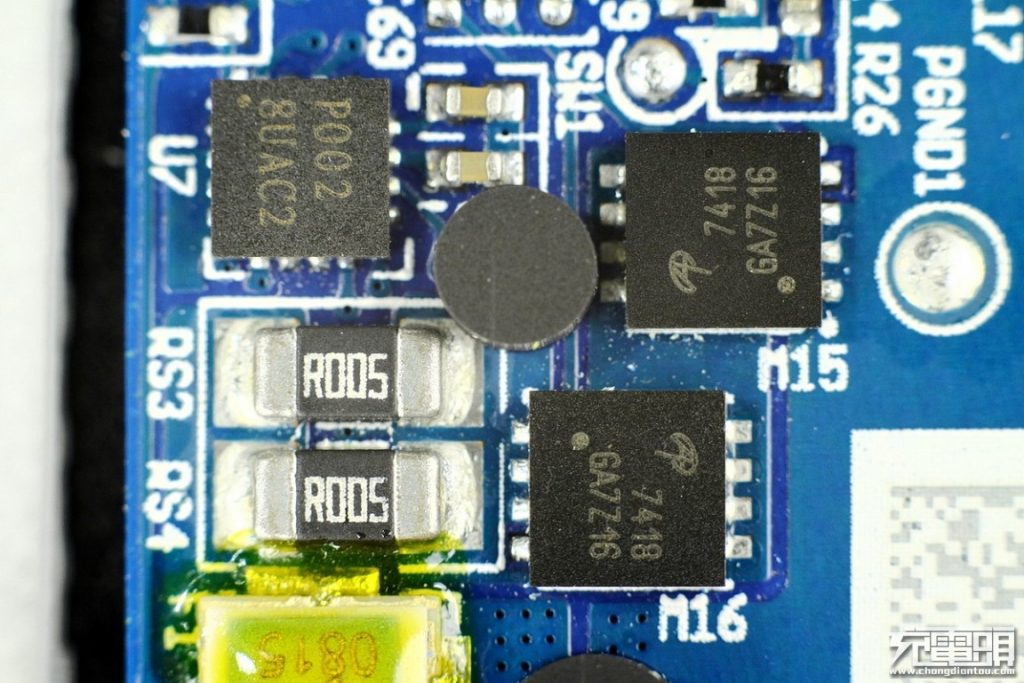

Battery protection chip 9K03 and protection tube AON7418.
Two 5mΩ current sense resistors in parallel.

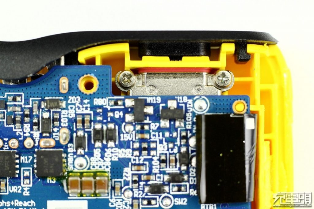

The USB-C is fixed by two screws.

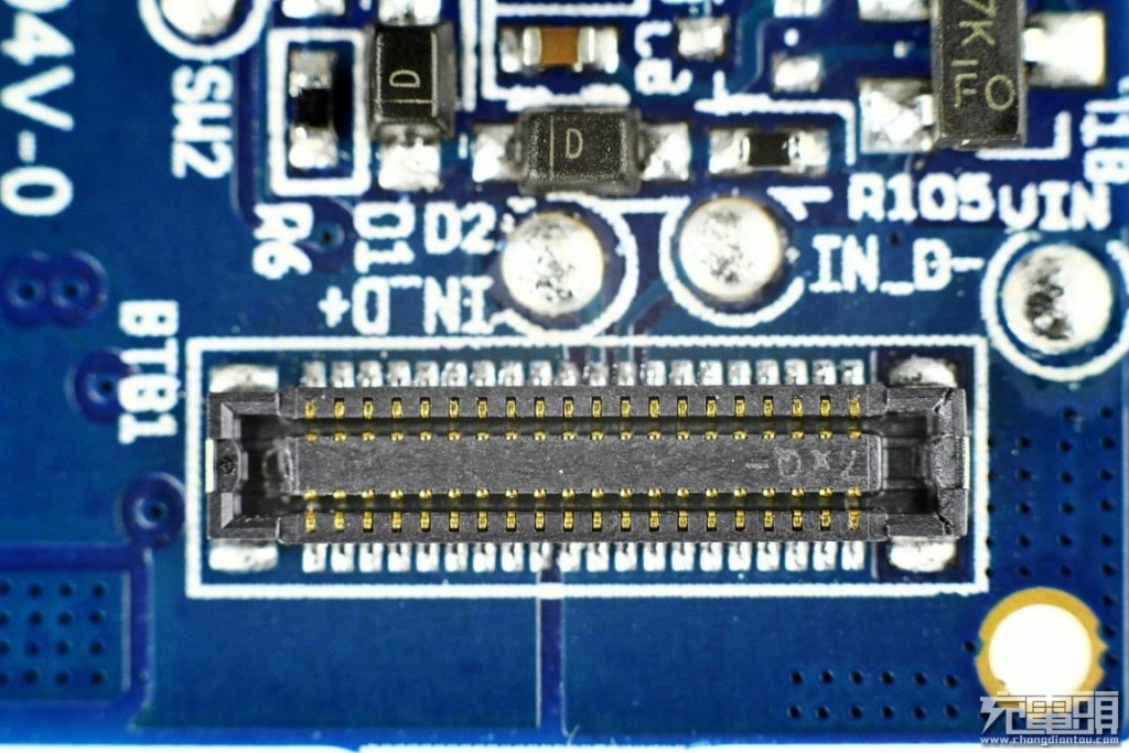

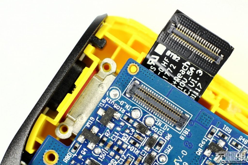

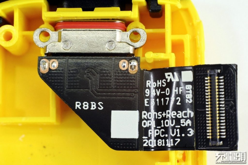

The USB-C port is connected to the PCBA by a ribbon cable, and the terminals are connected in parallel to reduce the resistance.

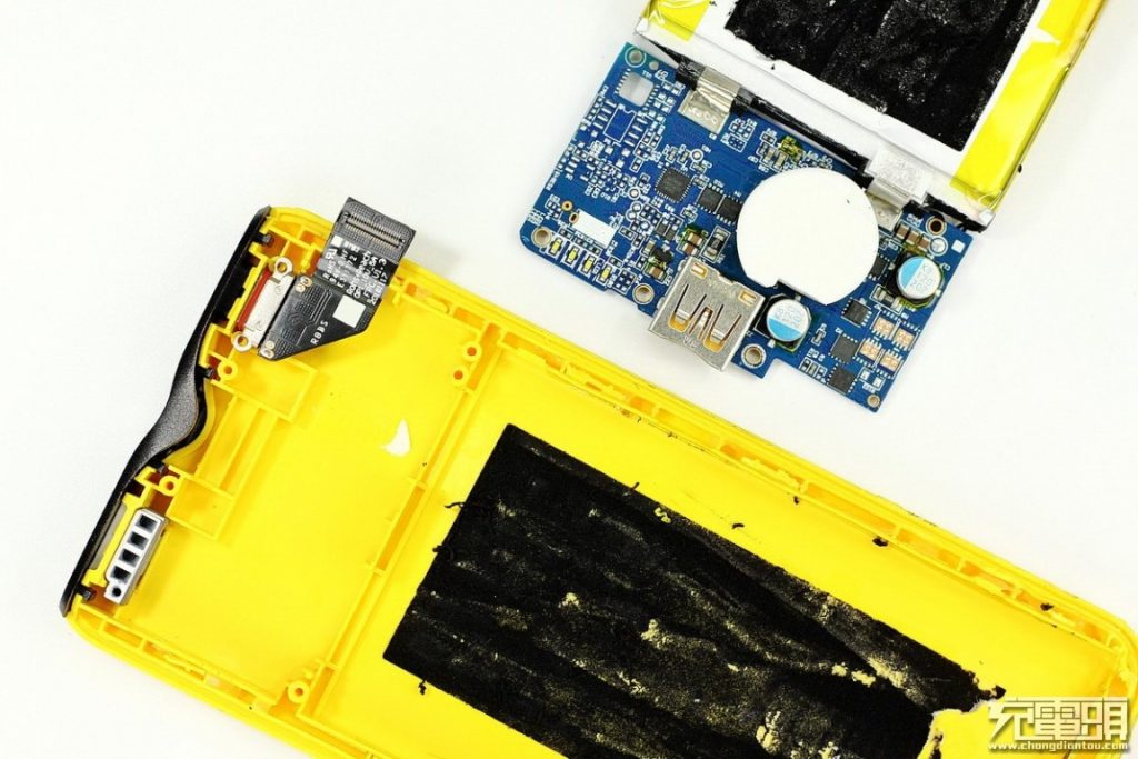

Remove the battery cell and the PCBA from the casing, we can see that a large double-sided adhesive tape is used to firmly fix the battery core to the casing to prevent the internal circuit from being dropped in daily use.

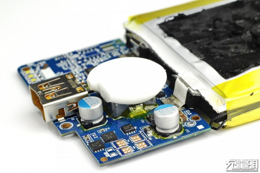

The inductor on the back of the PCBA is coated with a large, thick silicone heat sink, beside are two solid-state filter capacitors, which have a low profile.

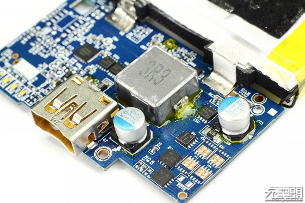

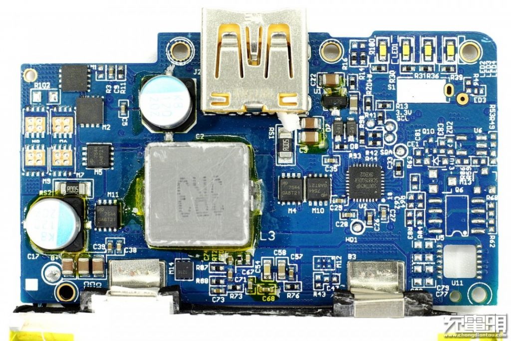

Remove the heat-dissipating glue on the inductor, we see lettering of 3R3. There are four MOSs next to the inductor, and the USB-A port has an orange core.

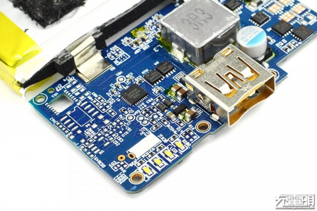

Four LED battery level indicators, plus a buck-boost control chip and two MOS tubes.

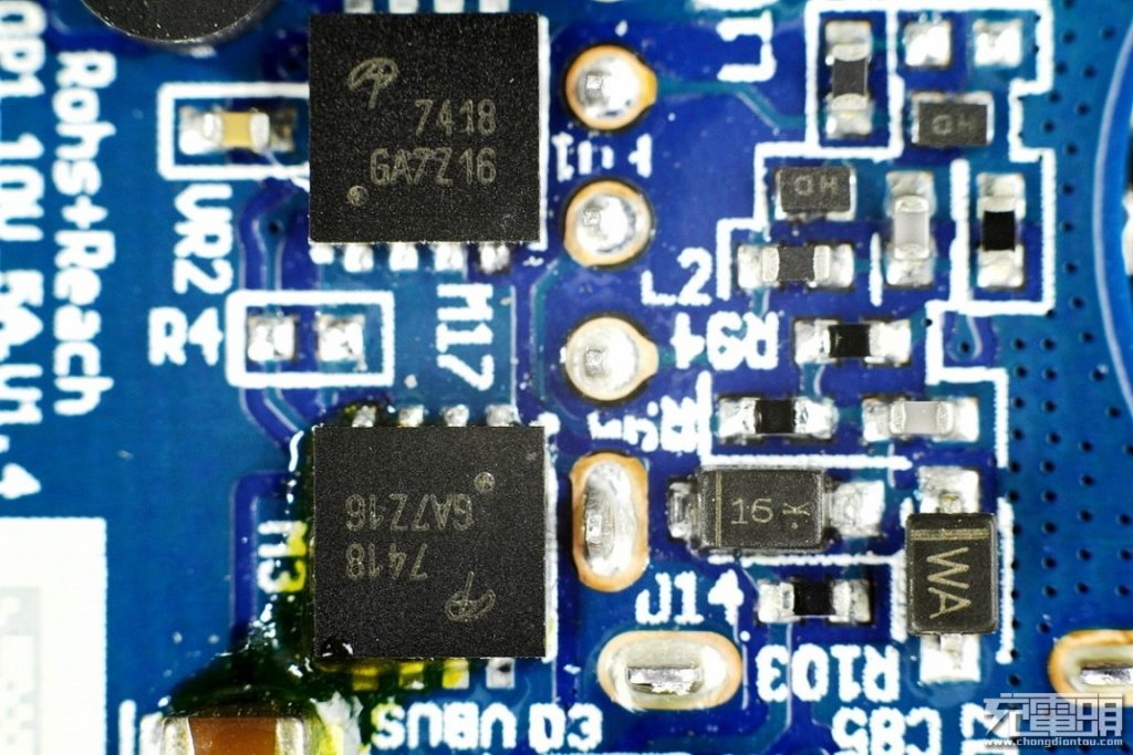

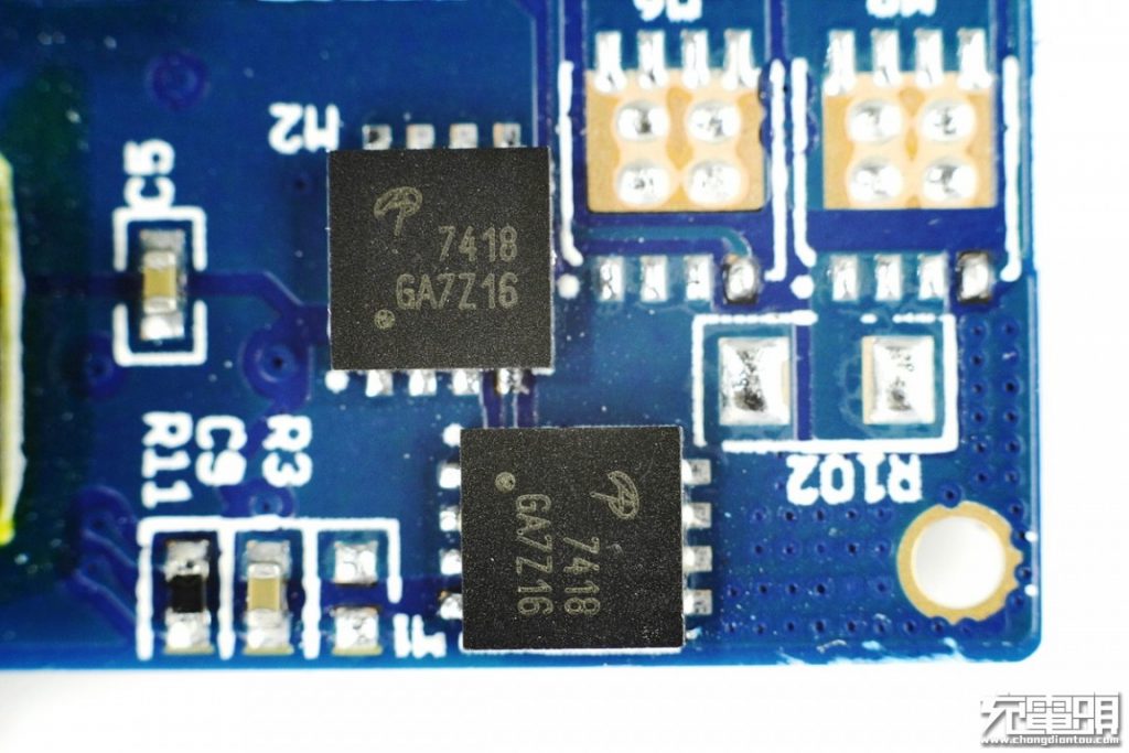

Two AON7418s for input and output switching and output port switching.

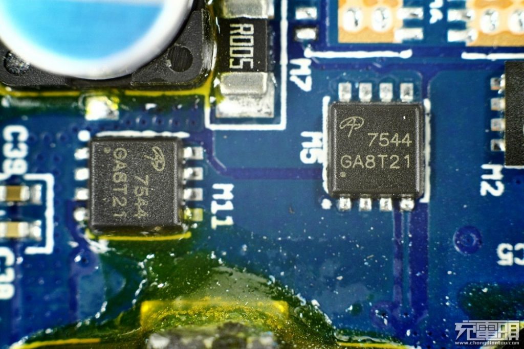

Two AON7544s.

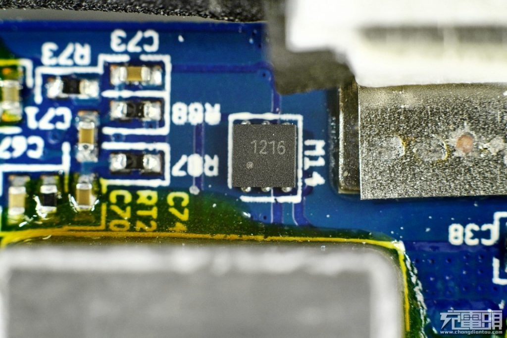

1216 lettering.

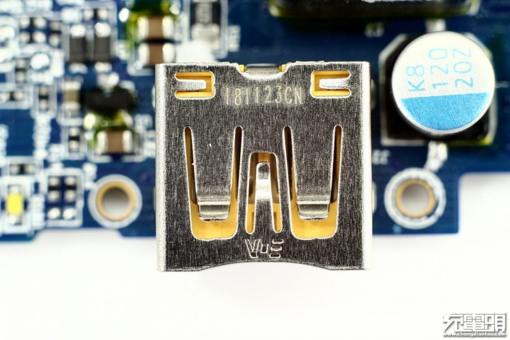

USB-A port with 181123CN code.

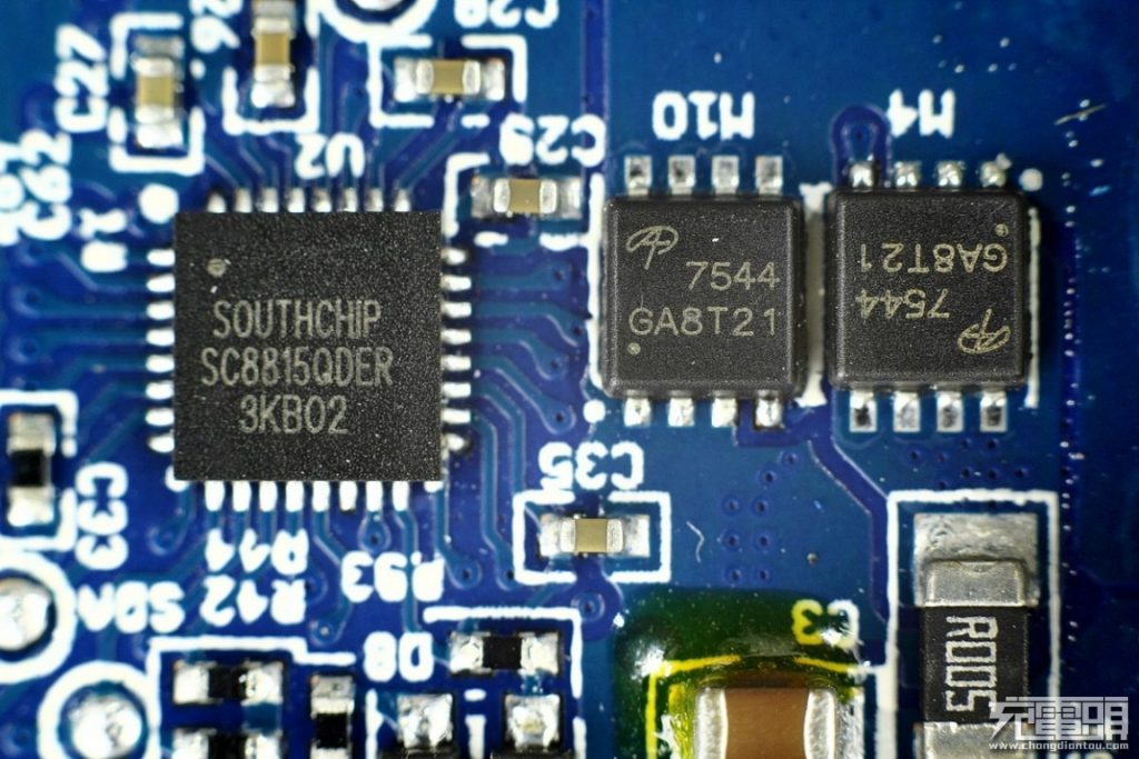

The main control chip of the power bank, SC8815 from Southchip. Besides are the MOS tube, a total of four AON7544 to a buck-boost circuit for input and output.

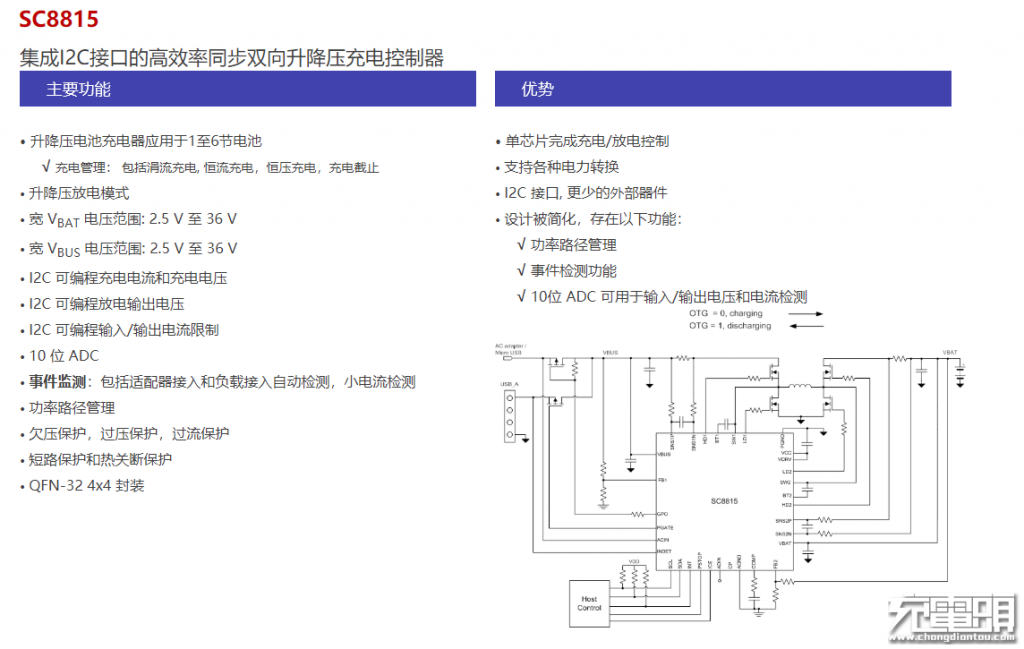

SC8815 is a synchronous buck-boost charger controller which can support reverse discharging operation. It can support up to 36V battery voltage, so can be used to effectively manage the charging for 1~6 cell Li-ion batteries; When a system needs to generate an output from the battery, SC8815 can also discharge the cells and delivers desired output up to 36V. The SC8815 features I²C interface, so the battery termination voltage, output voltage, charging/discharging mode and VBAT/VBAT current limits can be set freely through I²C. Meantime, it offers several functions like PMOS gate driver, adapter/load insert detection to simplify the system design and reduce the BOM. The SC8815 supports under voltage lockout, over voltage protection, over current protection, short circuit warning and over temperature protections to ensure safety under different abnormal conditions.

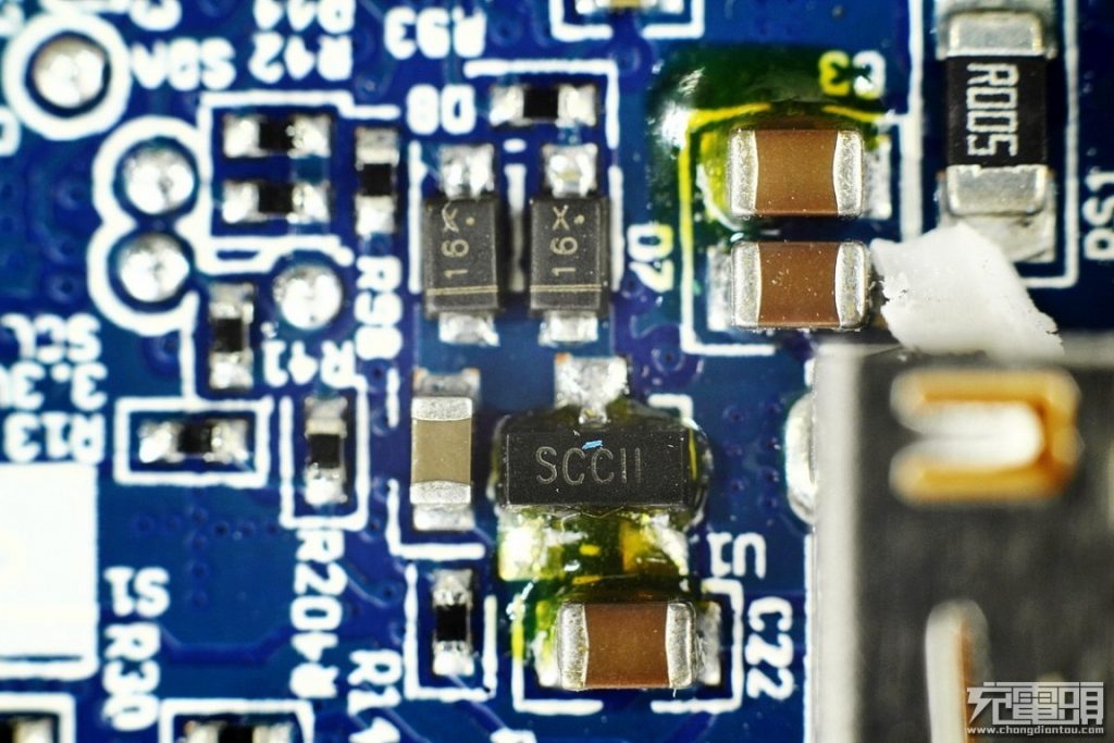

A triode with SCCII lettering.

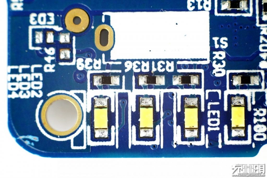

Close-up of the four LED indicators.

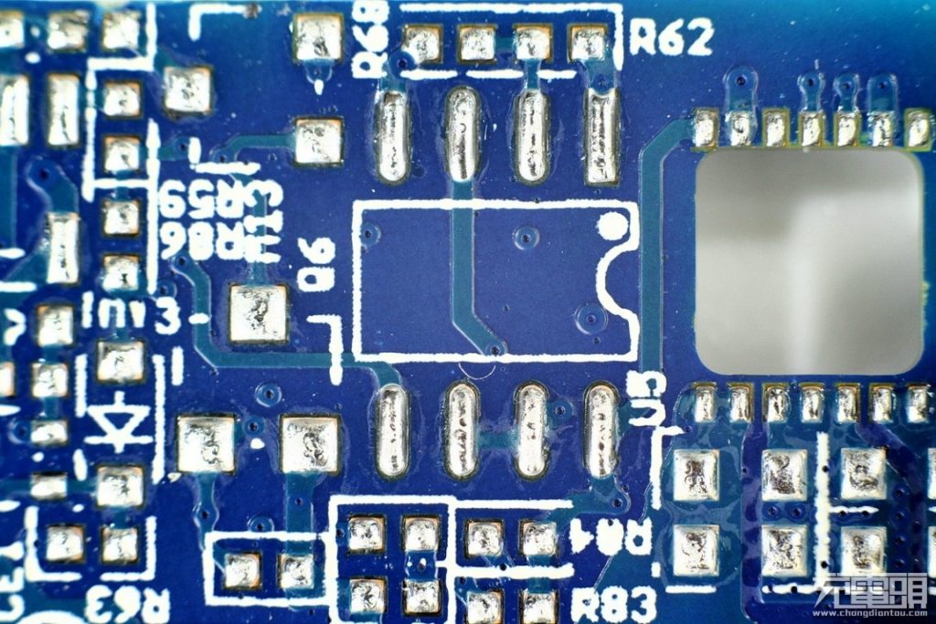

Reserved empty welding position.

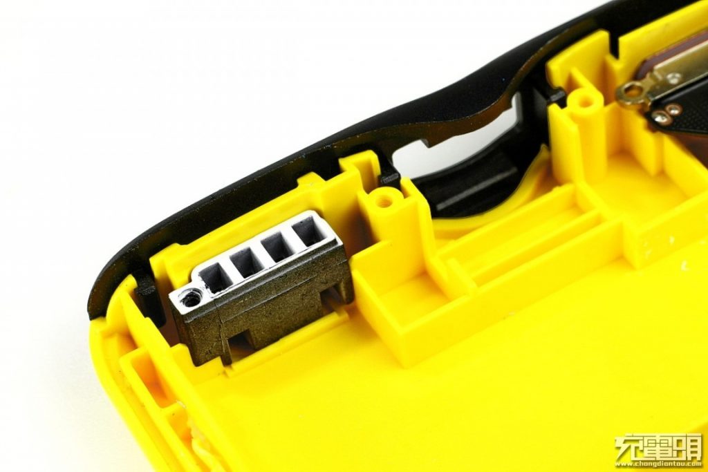

The LED indicators have a special isolation compartment to prevent light leaks.

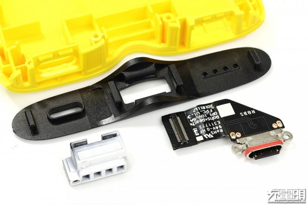

Remove the output panel, the LED isolation compartment, and the USB-C female socket.

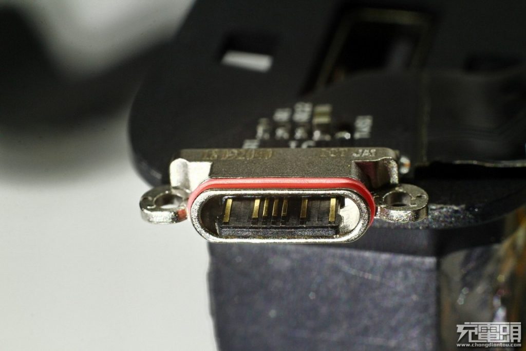

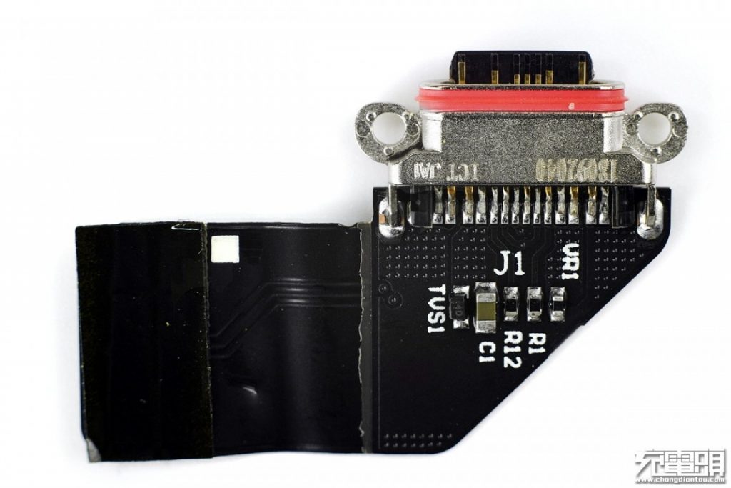

The USB-C port is a little different from the conventional type. It uses the same model as the phone, in which the internal plastic core is slightly longer than the metal casing.
Close-up of the internal of the USB-C port. 7 Pins.

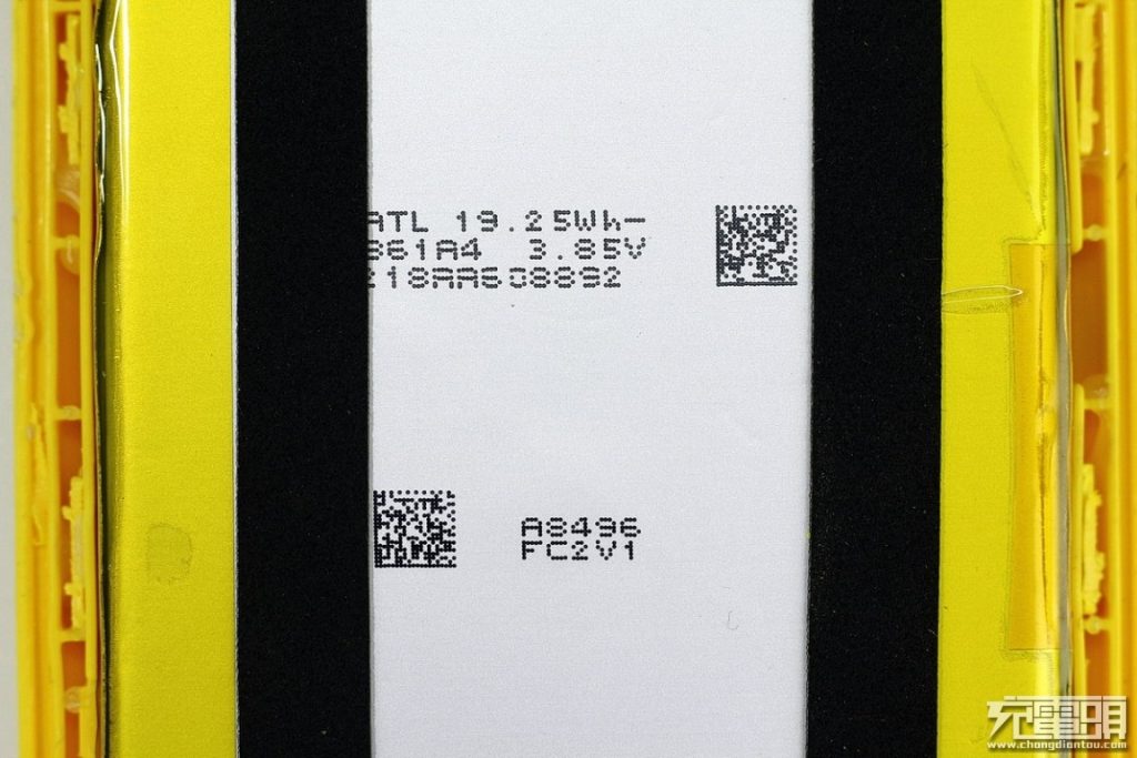

The battery cell is from ATL, 19.25Wh a piece, and a standard voltage of 3.85V.

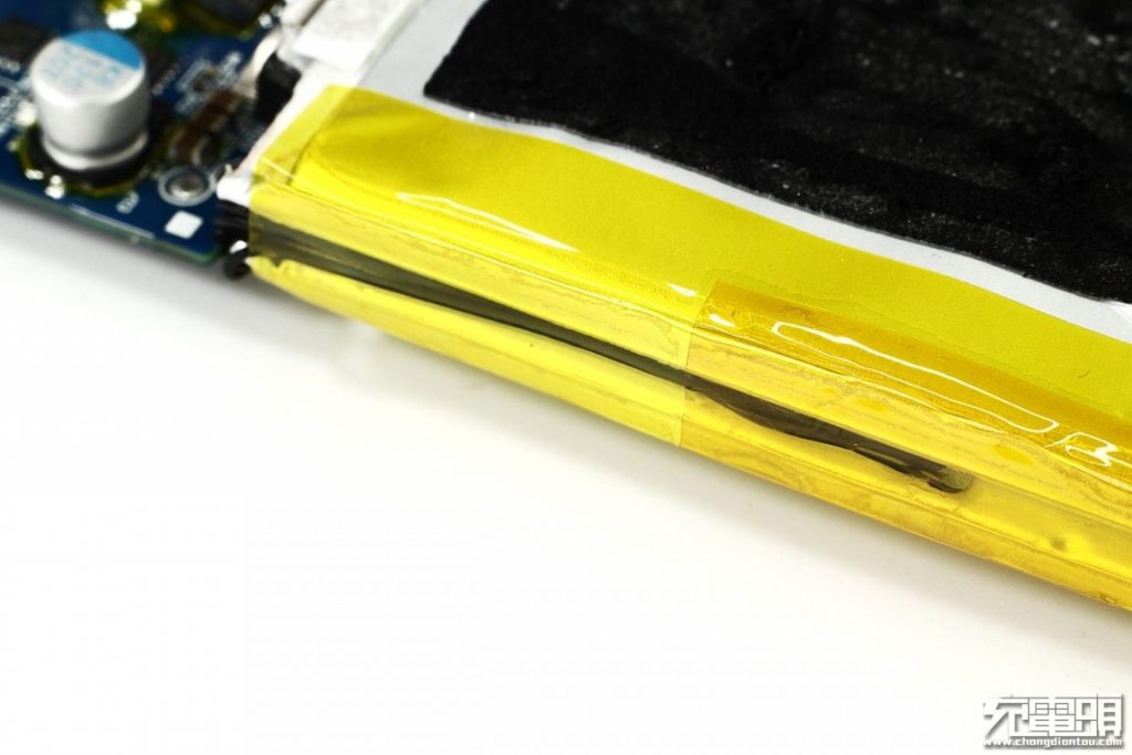

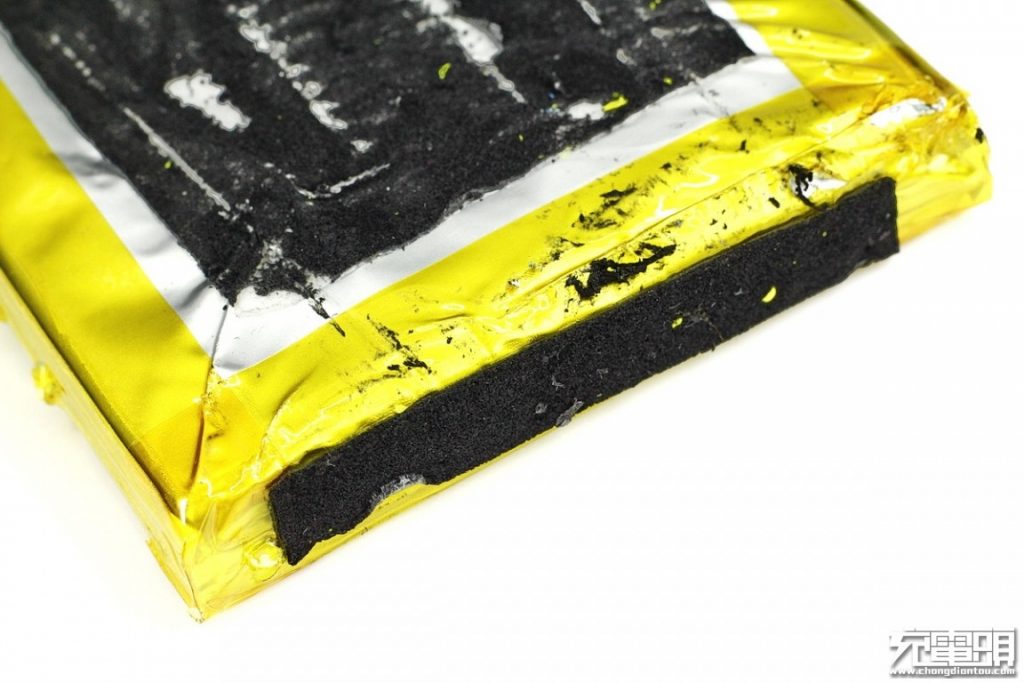

The cell is wrapped around by insulating tape and looks neat and tidy. A shock-proof sponge is attached to the bottom of the cell.

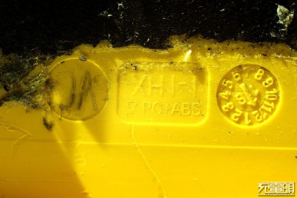

The casing is made of PC+ABS material.

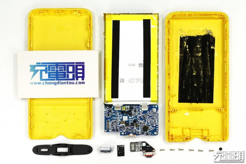

All the components.
