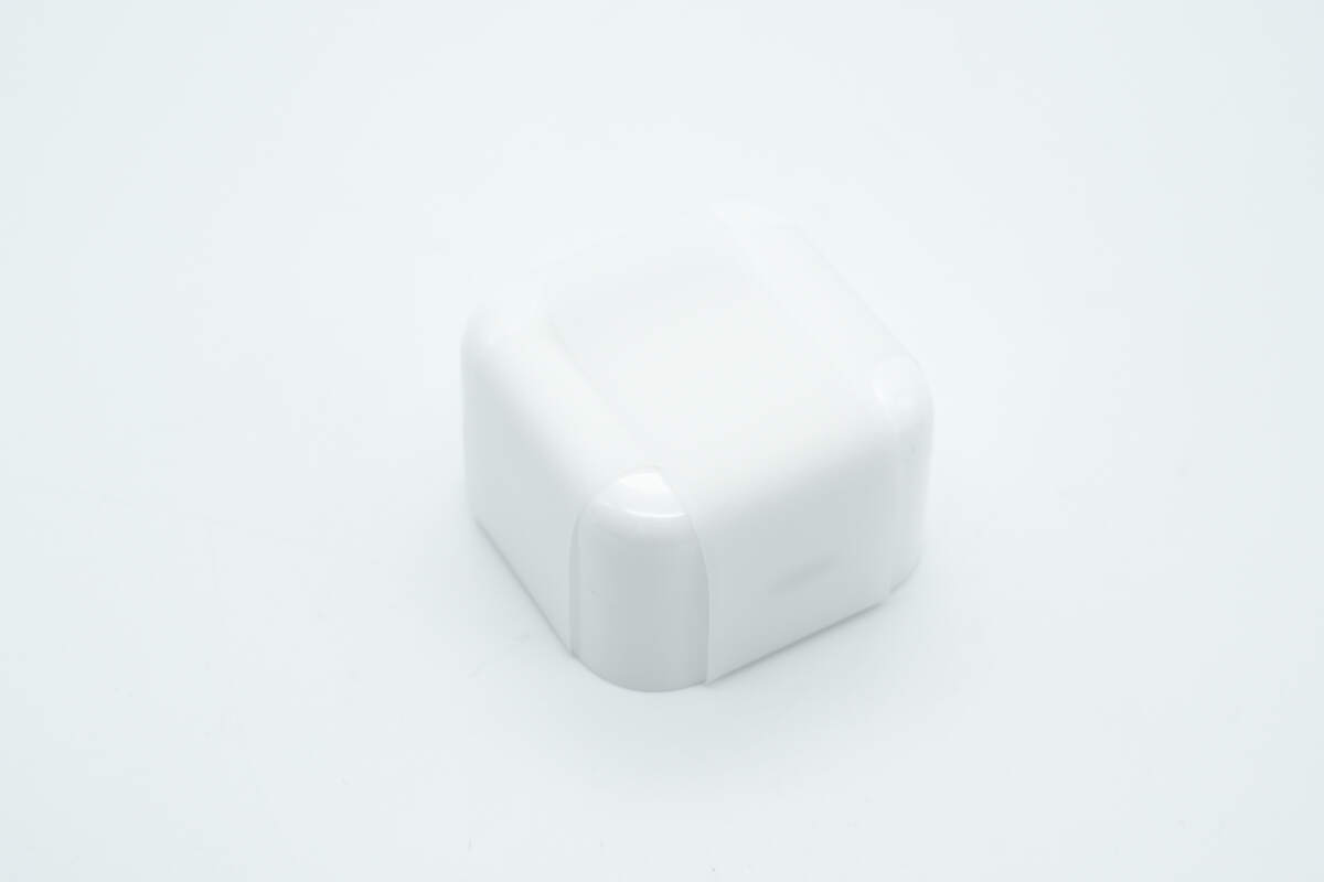

It features a design similar to the 35W dual USB-C charger (model A2579).
Teardown of Apple 40W Dynamic Power Adapter with 60W Max (A3365)-Chargerlab

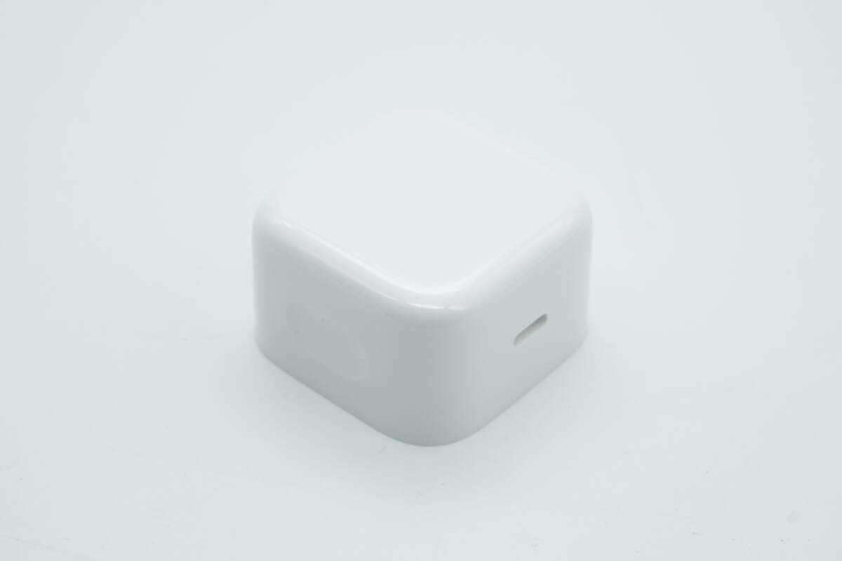

The small recessed areas on both sides of the body facilitate easy plugging and unplugging.

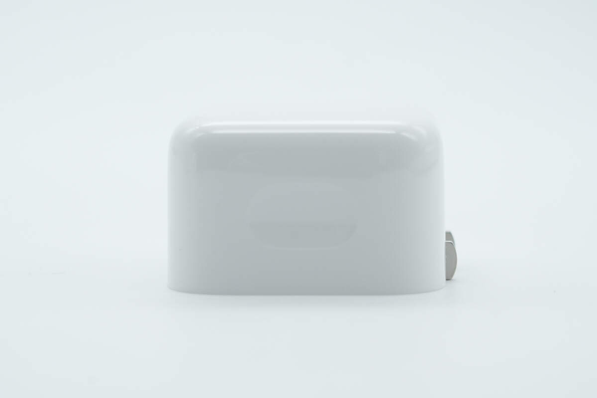

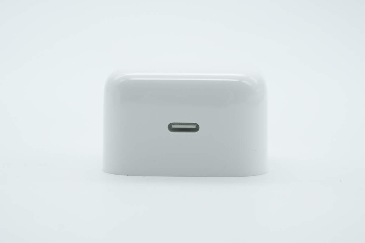

The output side features a single USB-C port with a white plastic insert.

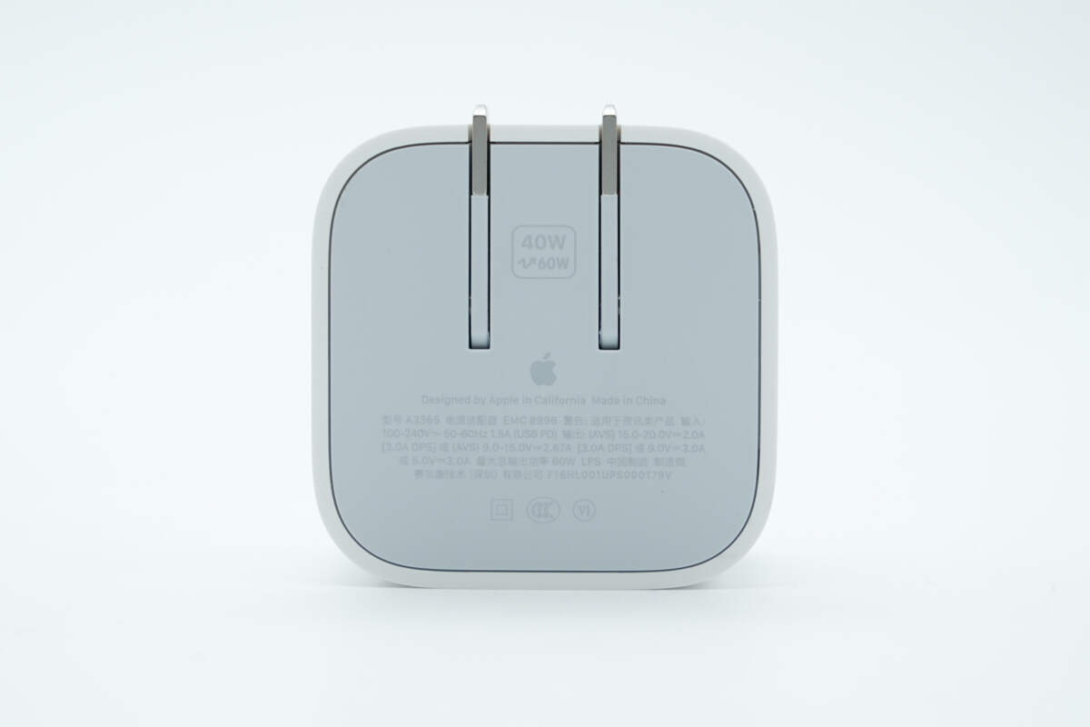

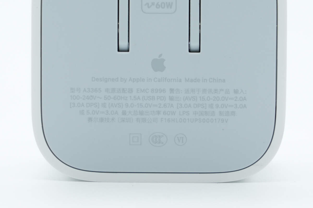

The bottom is printed with specification details.
Model: A3365
Input: 100-240V\~ 50/60Hz 1.5A (USB PD)
Output: (AVS) 15-20V 2A \[3.0A DPS] or (AVS) 9-15V 2.67A \[3.0A DPS] or 9V 3A or 5V 3A
Maximum total output power: 60W LPS
The charger has passed CCC certification and Level VI energy efficiency certification.

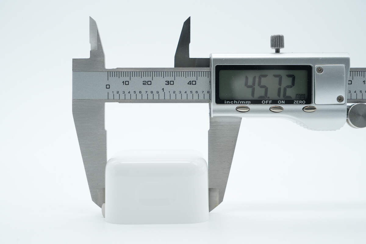

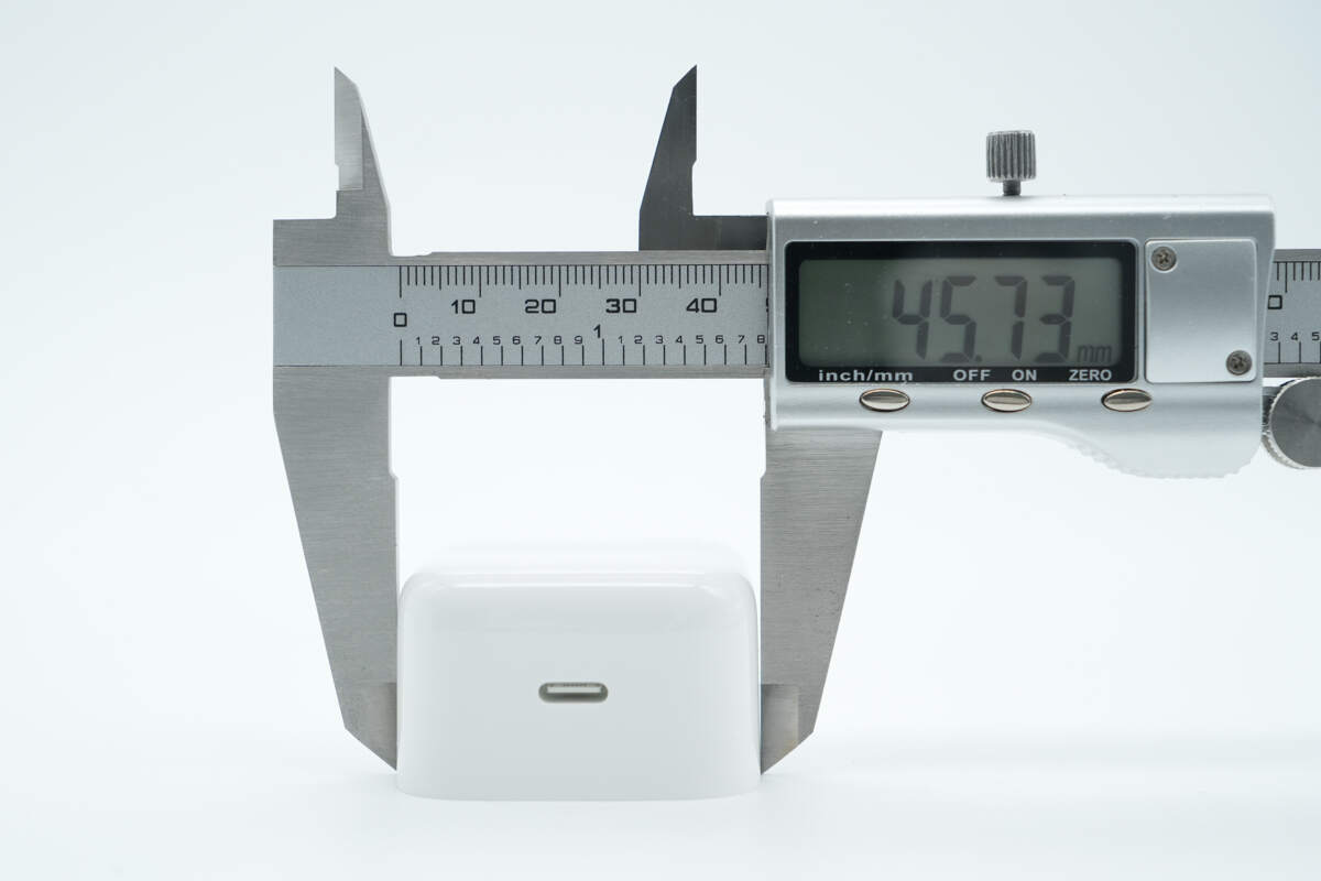

The length of the charger is about 45.72 mm (1.8 inches).
The width is about 45.73 mm (1.8 inches).

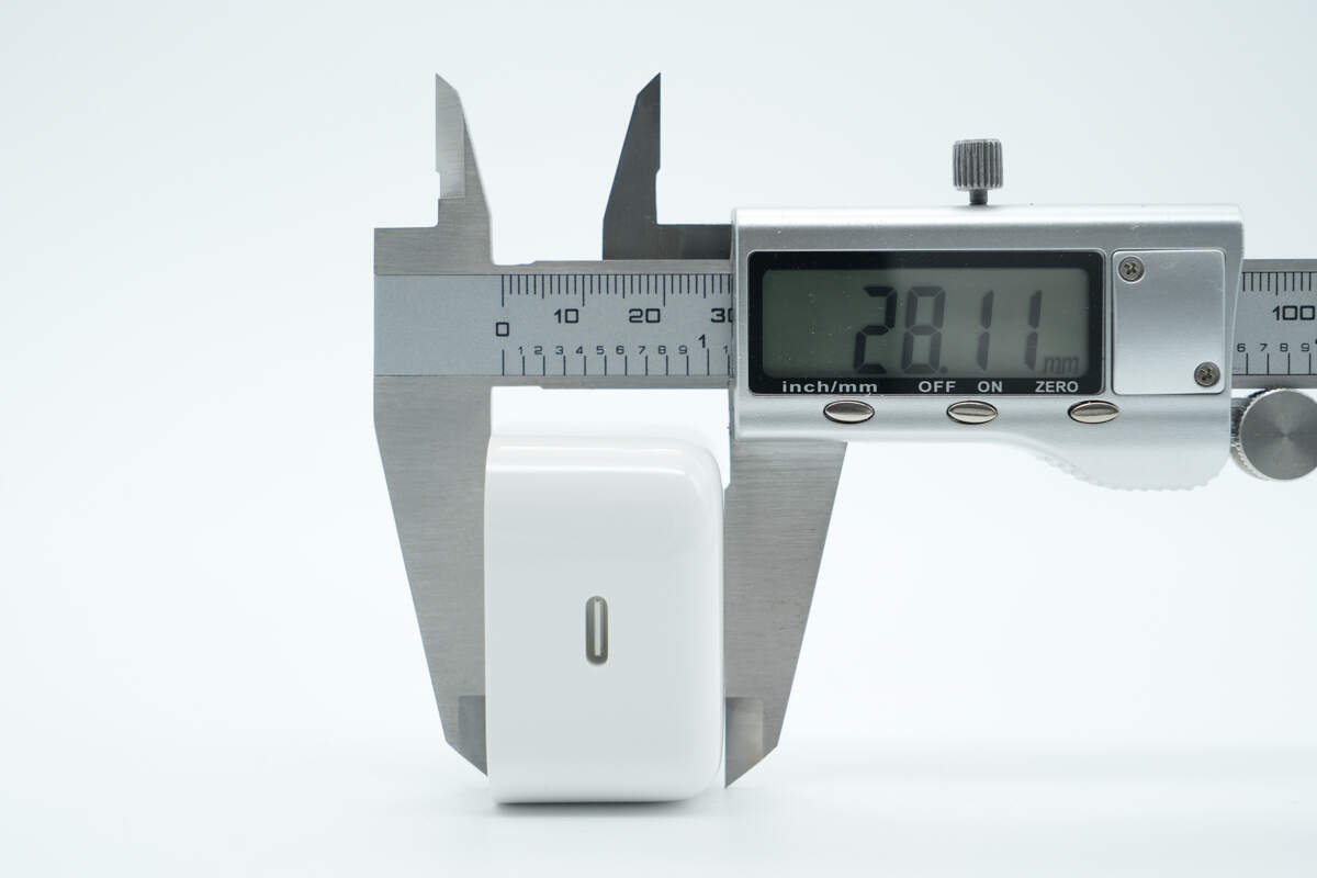

The thickness is about 28.11 mm (1.11 inches).

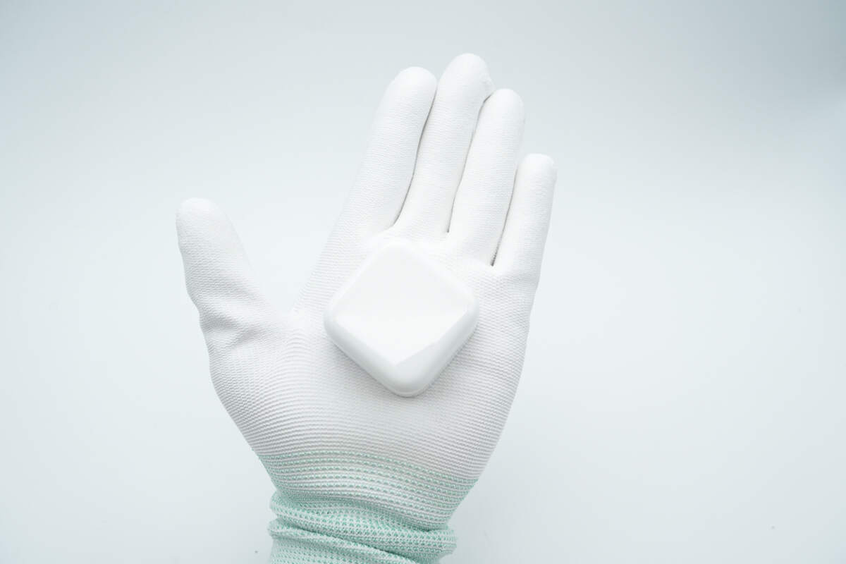

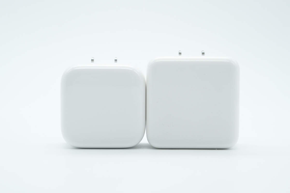

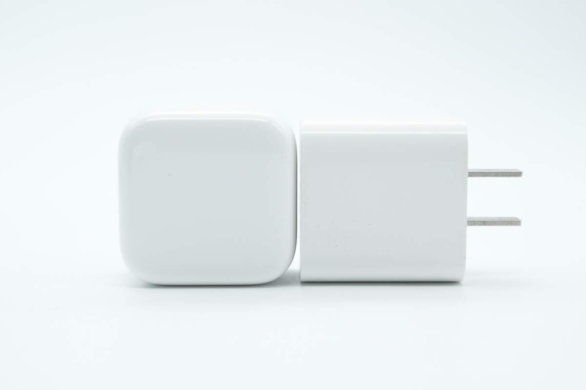

Its size is nearly identical to that of the Apple 20W charger.
It is slightly smaller than the 35W dual USB-C charger.

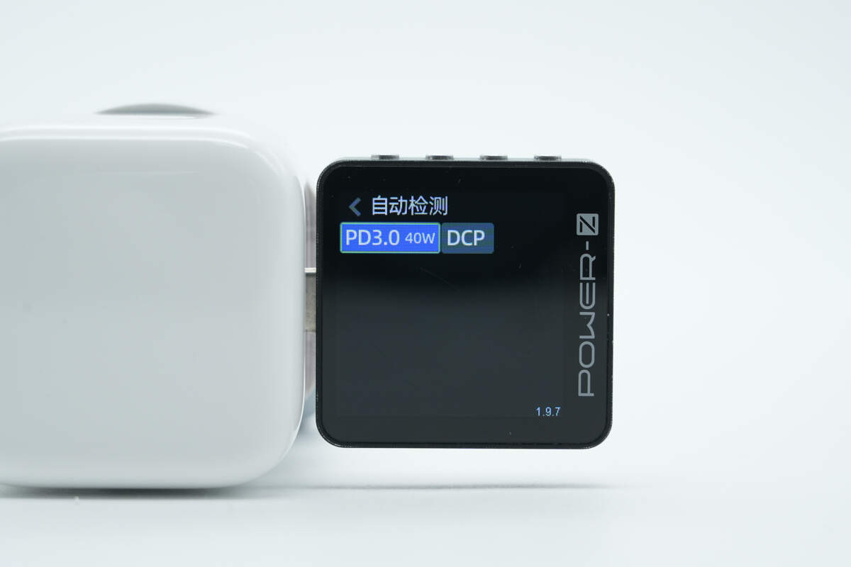

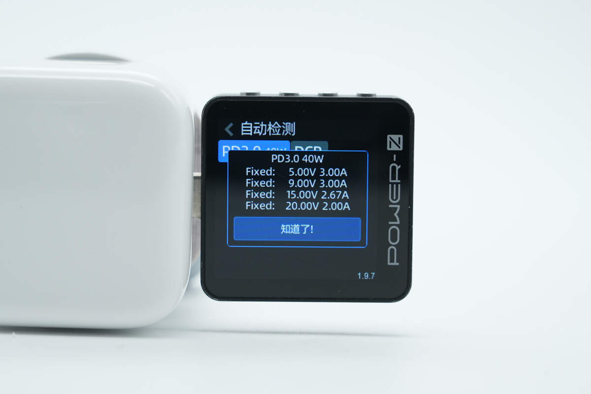

ChargerLAB POWER-Z KM003C shows that it supports PD3.0 and DCP charging protocols.
And it has four fixed PDOs of 5V3A, 9V3A, 15V2.67A, and 20V2A.

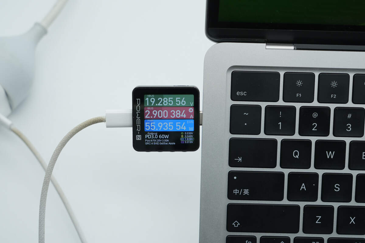

When charging the MacBook Air M3 2024, the charging power is about 55.94W, successfully activating the 60W dynamic fast charging feature.

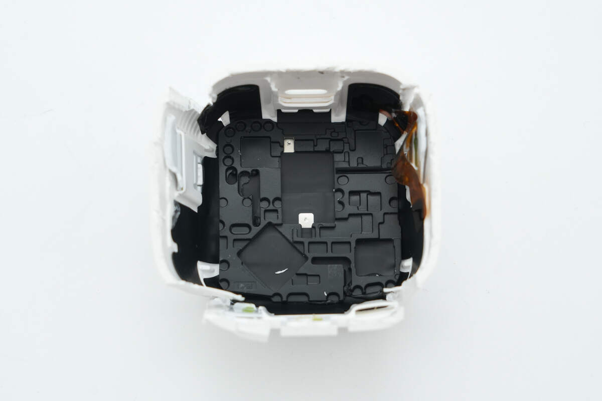

Remove the bottom casing, and it is revealed that the enclosure uses a combination of snap-fit clips and ultrasonic welding for sealing.
The input side features a contact-based power delivery design. The inner side of the casing is lined with a graphite thermal pad and has been treated for insulation.

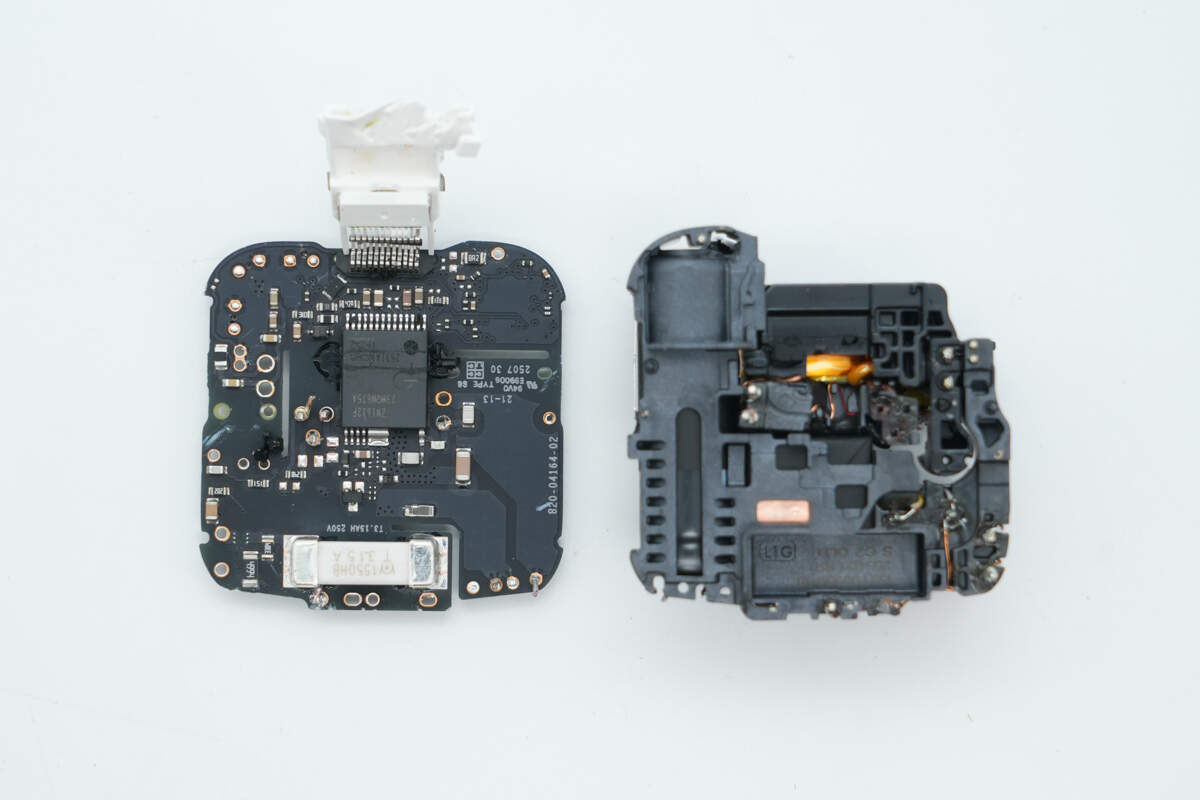

Remove the PCBA module.

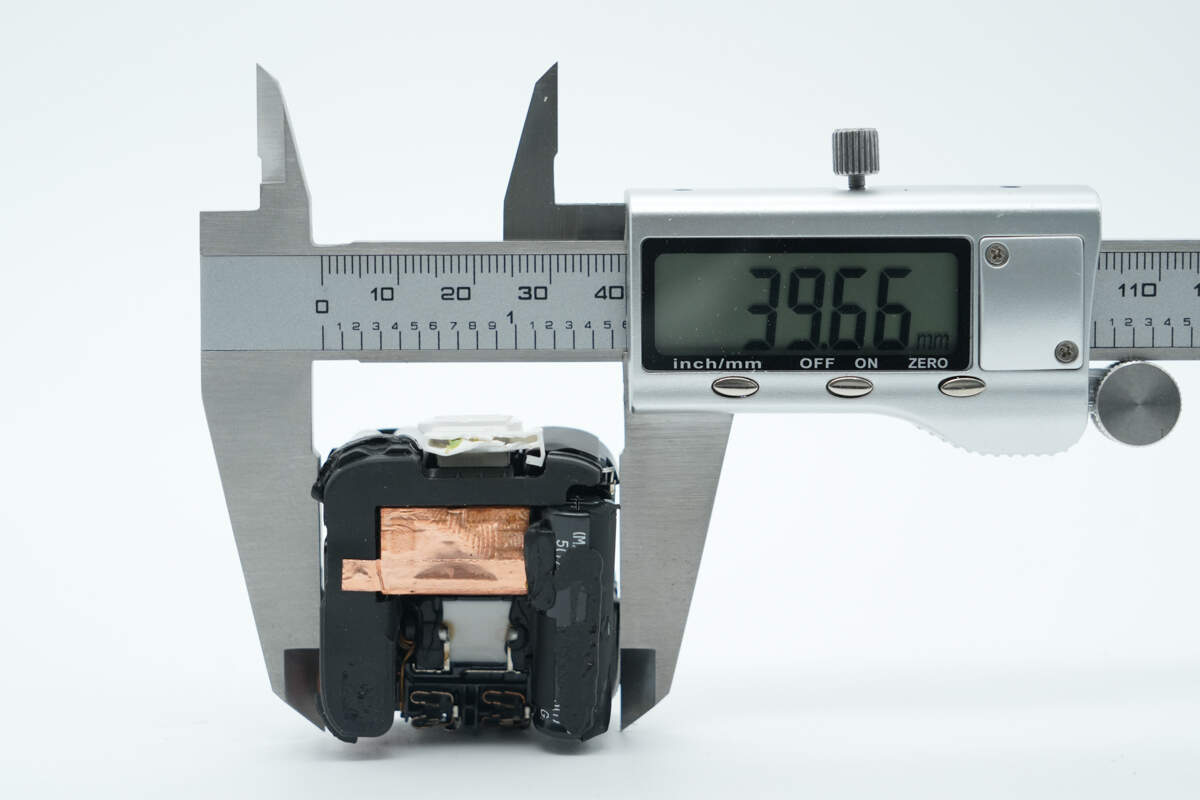

The length of the PCBA module is about 42.12 mm (1.66 inches).
The width is about 39.66 mm (1.56 inches).

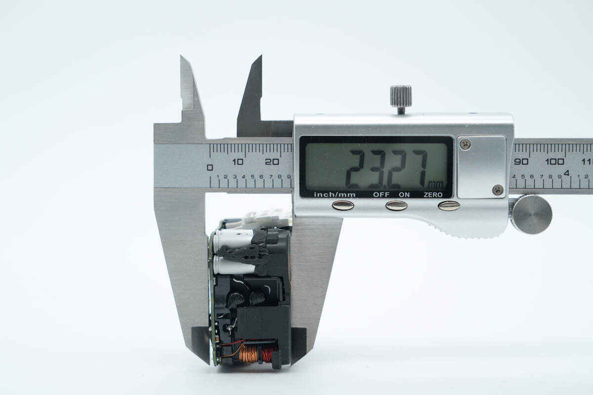

The thickness is about 23.27 mm (0.92 inches).

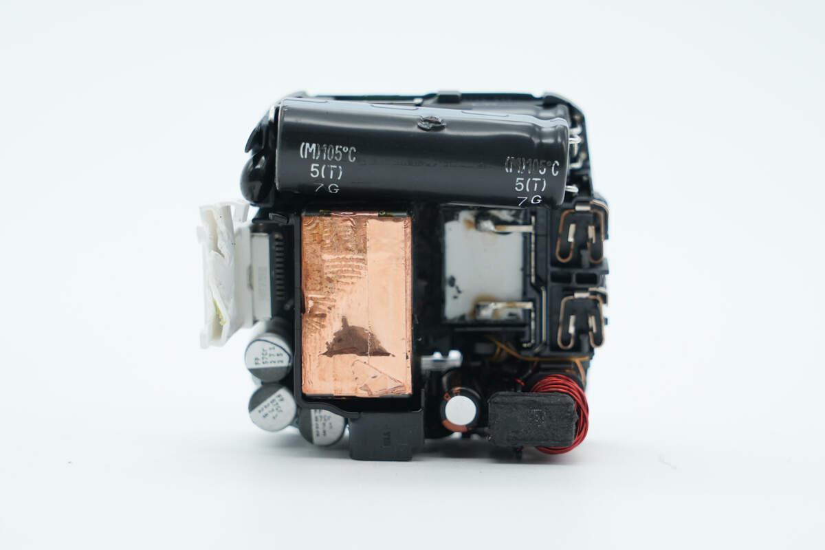

A protective pad is also placed between the two high-voltage electrolytic filter capacitors on the other side.

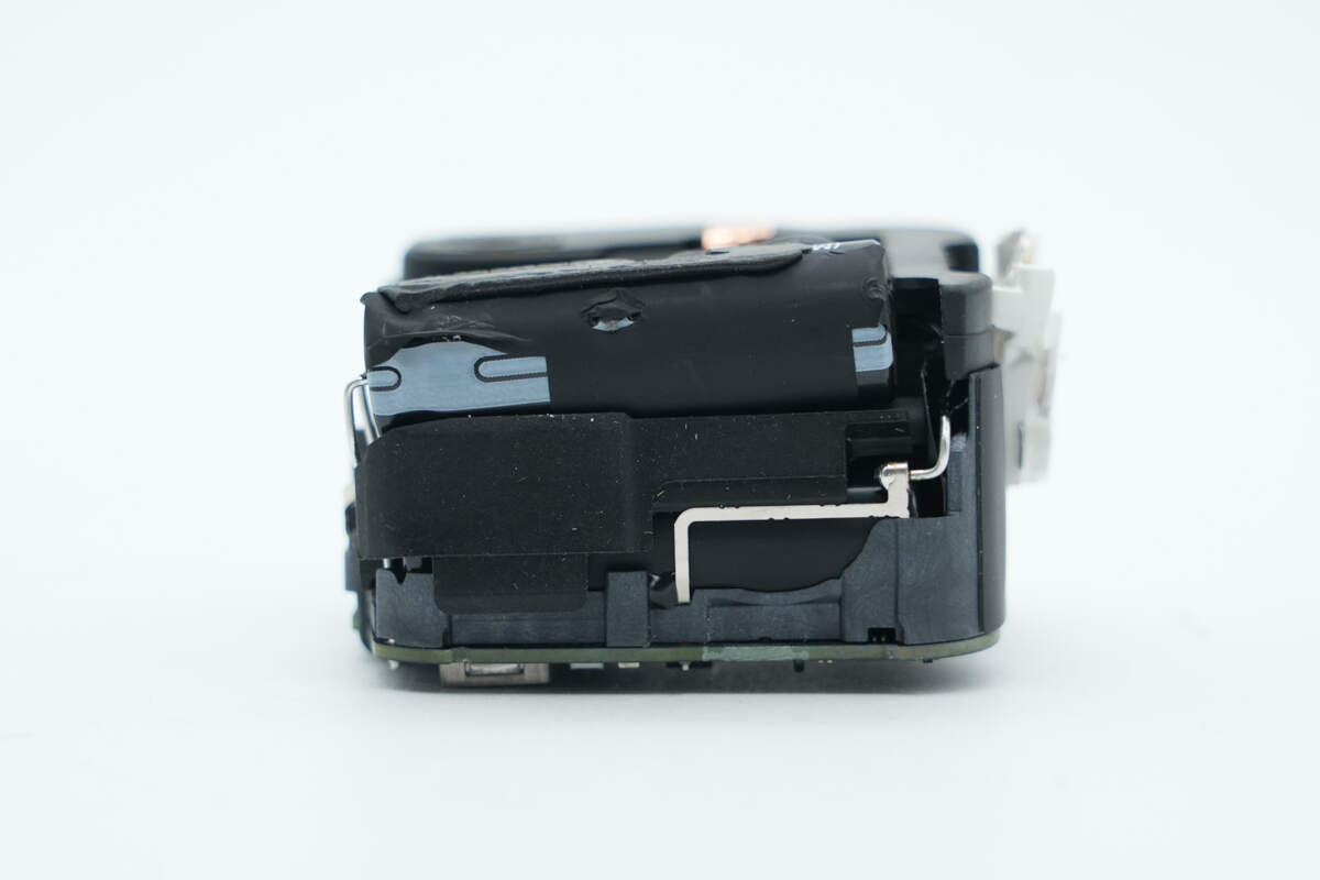

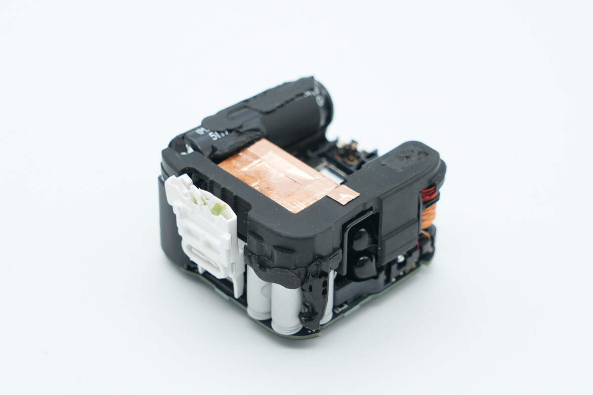

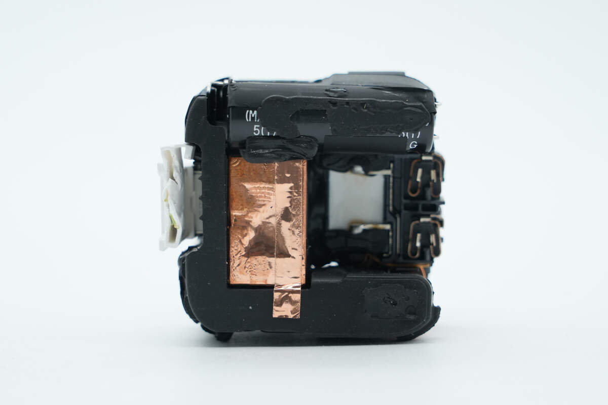

The top-mounted high-voltage electrolytic filter capacitor and the transformer are secured with adhesive for added stability and insulation.
The solid capacitors for output filtering are also secured with adhesive, and an insulating sheet is attached to the left side of the plastic casing.

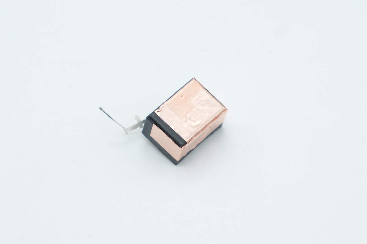

Remove the foam pads and black adhesive. The transformer is wrapped in copper foil, and the side near the secondary winding is reinforced and insulated with a plastic casing.

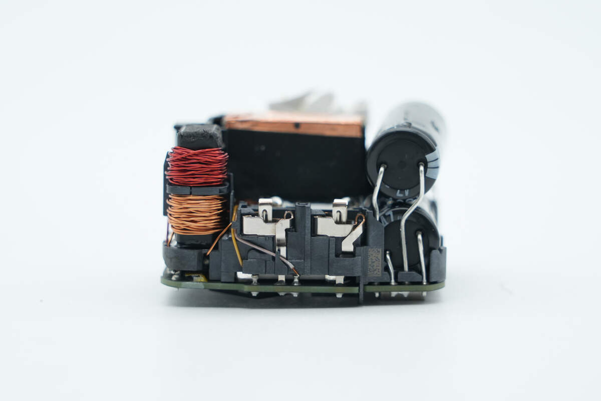

The PCBA module's input side features metal contact plates for power delivery along with a supporting plastic frame.

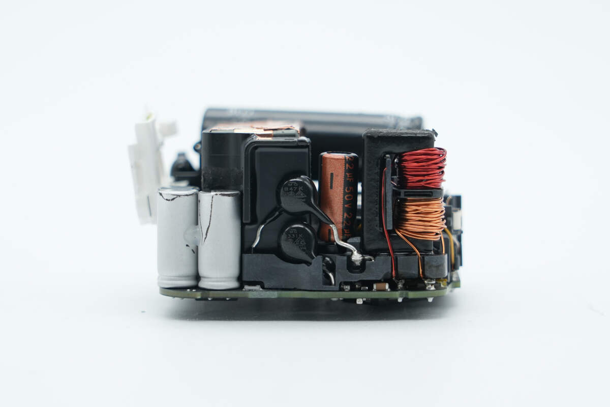

This side contains common mode chokes, a capacitor supplying power to the master control chip, and Y capacitors.

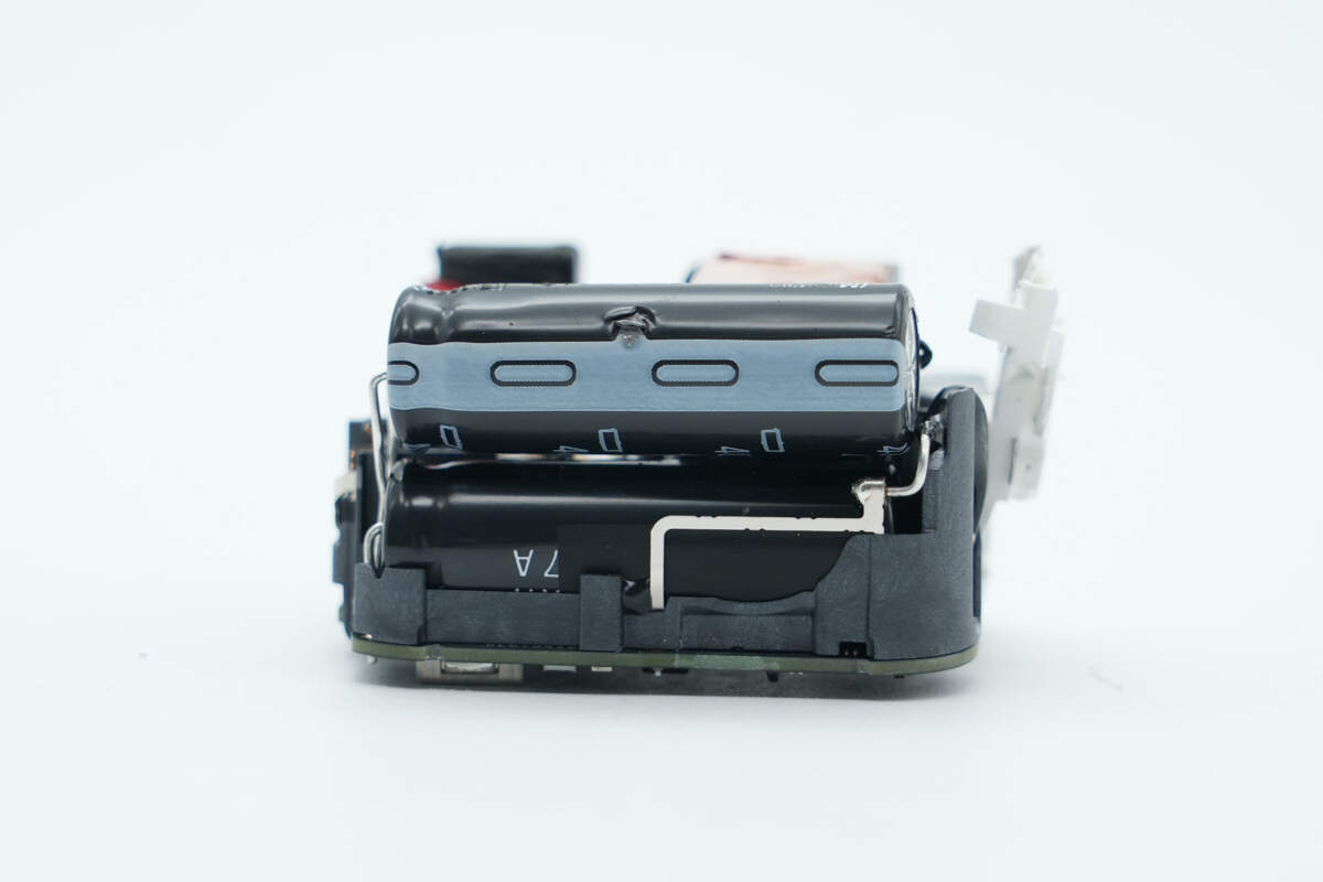

On the opposite side, two high-voltage electrolytic capacitors are mounted horizontally.

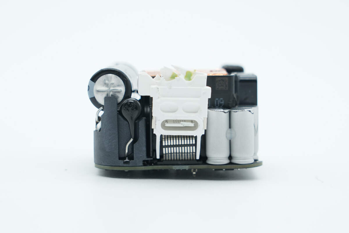

On both sides of the output, there are Y capacitors and solid capacitors, respectively.

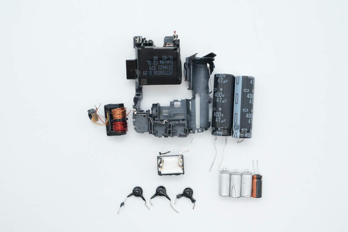

Remove the capacitors, transformer, and other components. A plastic bracket is installed at the bottom to provide support and isolate the PCB.

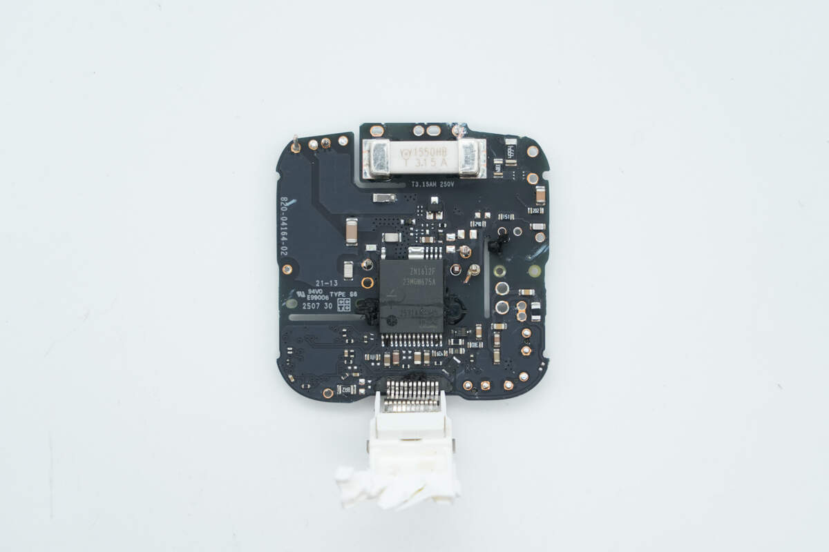

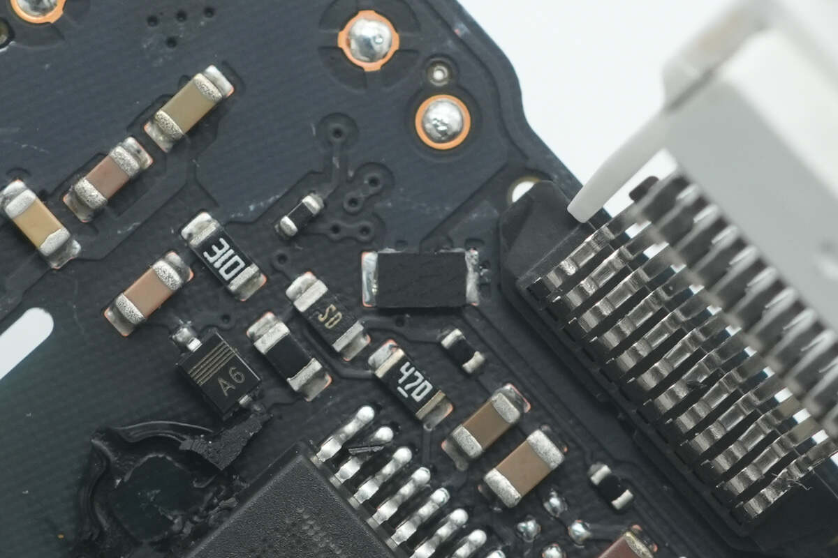

The front side of the PCB features an SMD fuse and the master control chip.

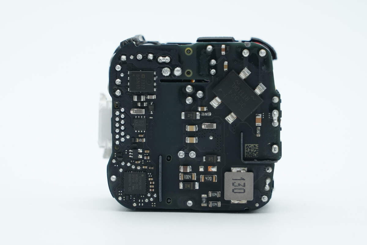

The back side of the PCB contains the bridge rectifier, differential mode choke, synchronous rectifier, protocol chip, and output VBUS MOSFET.

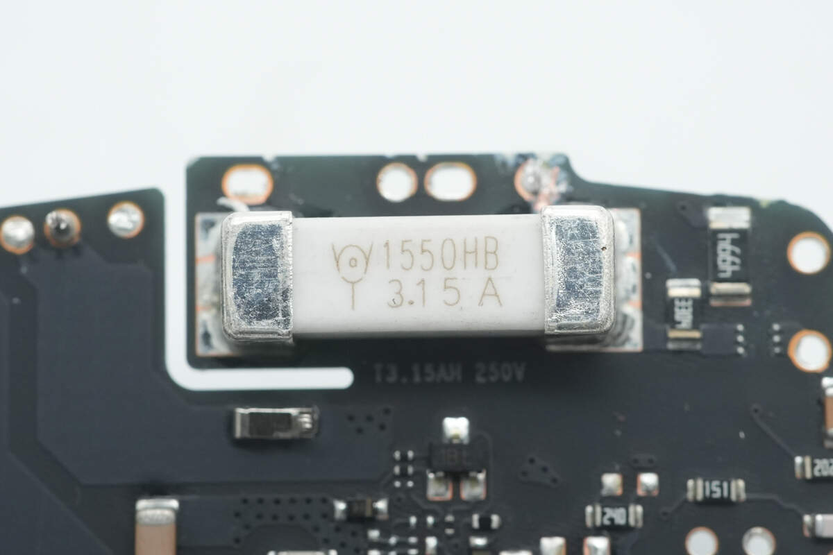

The SMD fuse is from WalterFuse with a rated current of 3.15A.

It is connected via soldered copper strips.
The input-side bridge rectifier is from DIODES, model RTT10KL, and uses a TTL package.

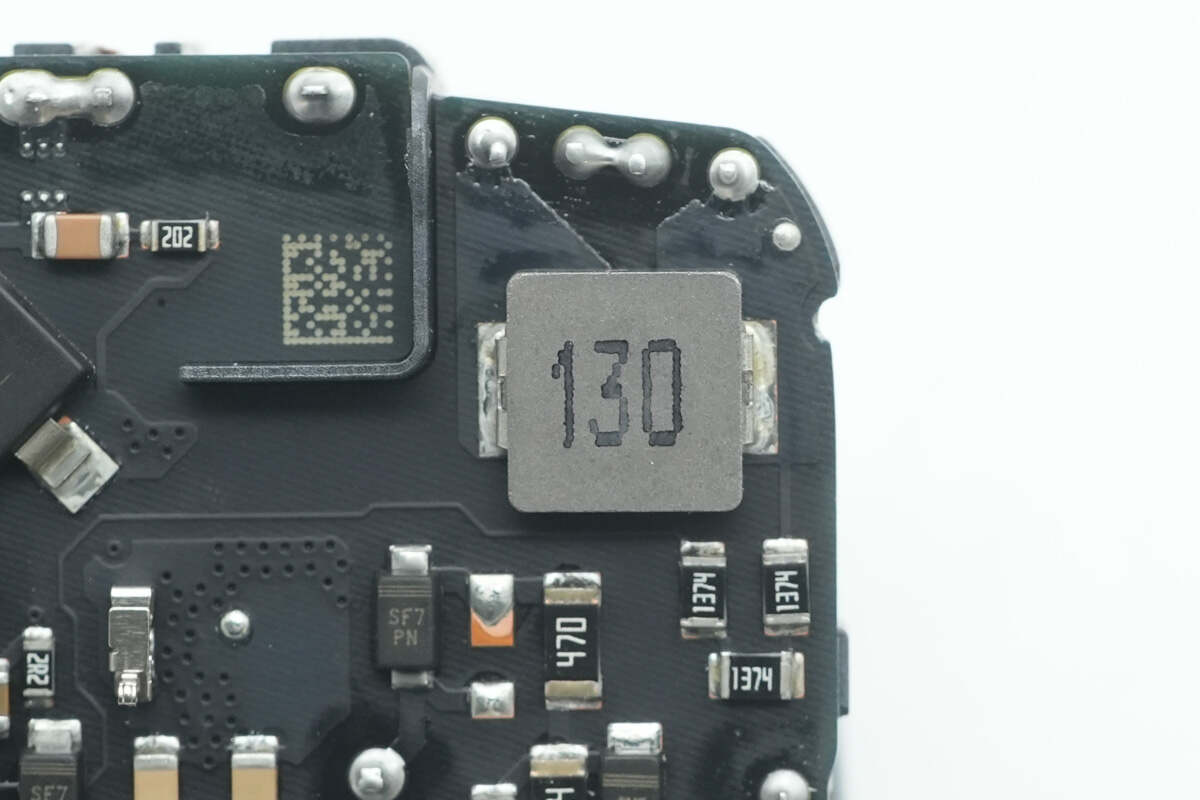

The differential mode choke has a specification of 13μH.

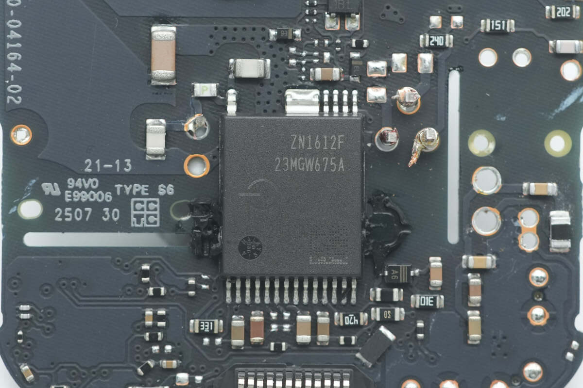

The master control chip is from PI, marked with ZN1612F, a custom model for Apple. It integrates the primary controller, high-voltage MOSFET, synchronous rectifier controller, and feedback functions, offering high integration and reduced external components. This simplifies fast charging power circuit design. The chip uses an InSOP-T28D package.

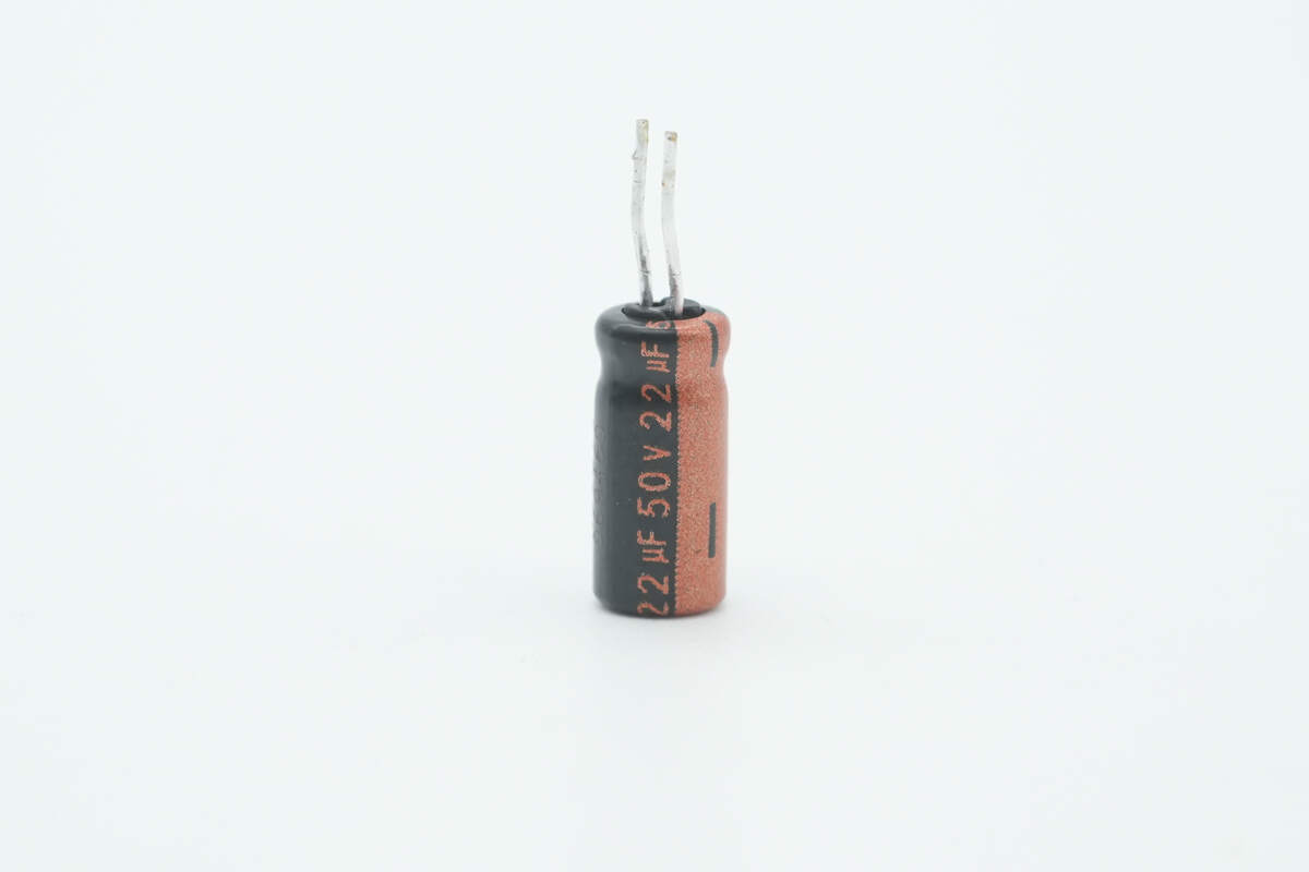

The capacitor supplying power to the master control chip is from Lelon.
It is rated at 50V, 22μF.

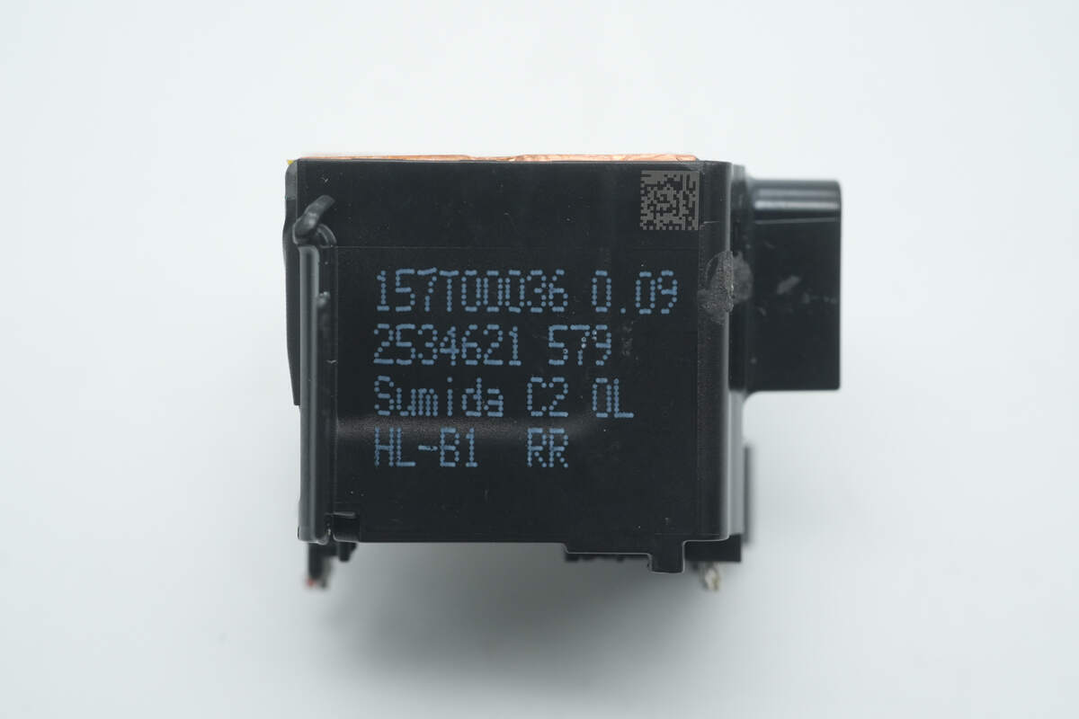

The transformer is manufactured by Sumida.

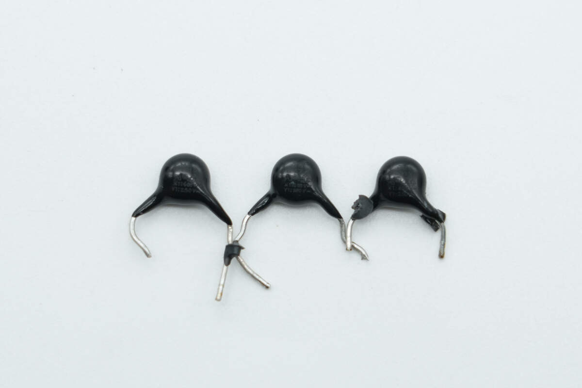

Close-up of three black Y capacitors.

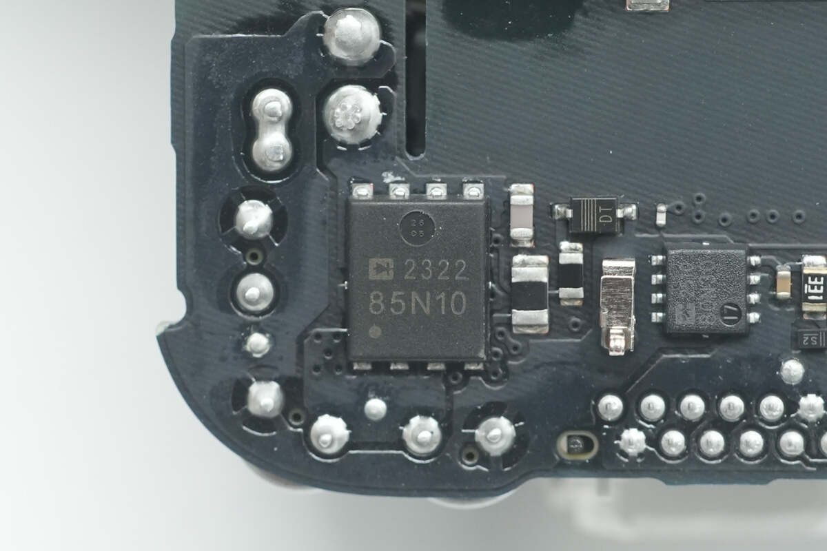

The synchronous rectifier is from RECTRON, model RM85N100DF. It is an NMOS transistor with a voltage rating of 100V and an on-resistance of 4.6mΩ, packaged in a DFN 5x6-8L form factor.

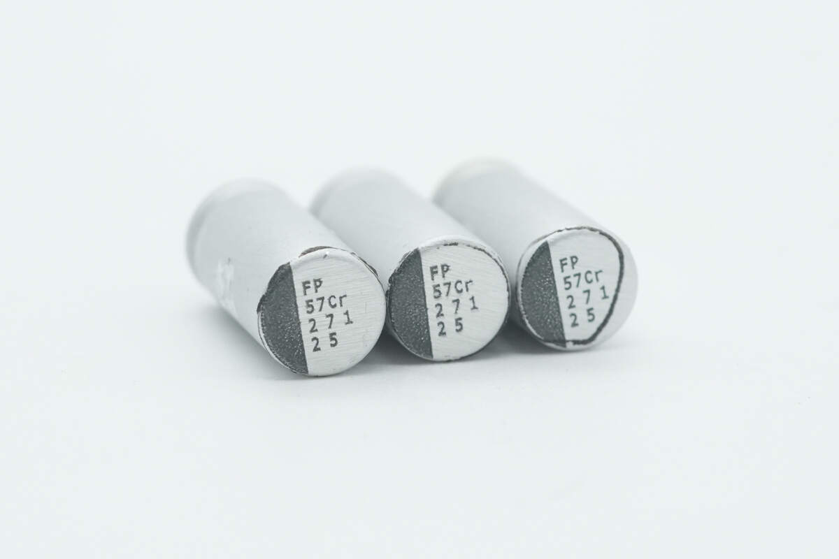

The three solid capacitors for output filtering are from Nichicon, each rated at 25V 270μF.

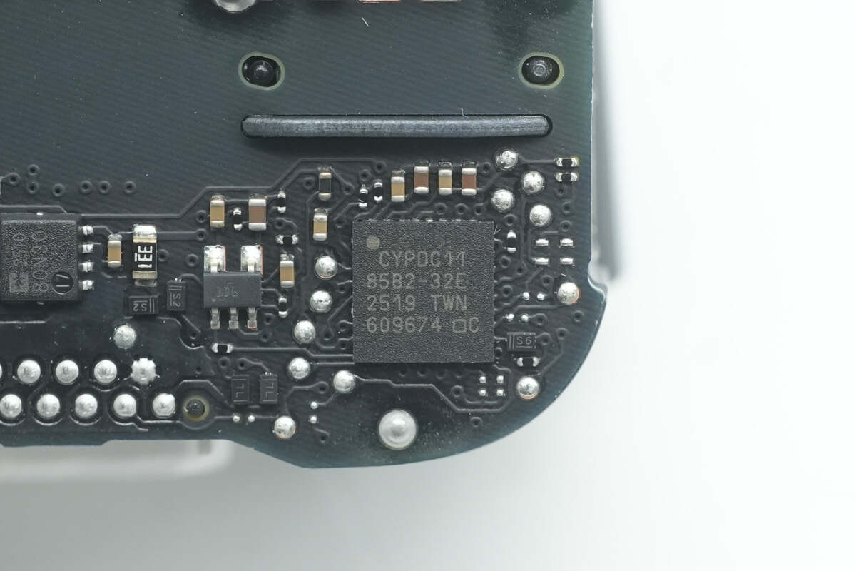

The protocol chip is from Infineon, model CYPDC1185B2-32E, housed in a 32-pin QFN package.

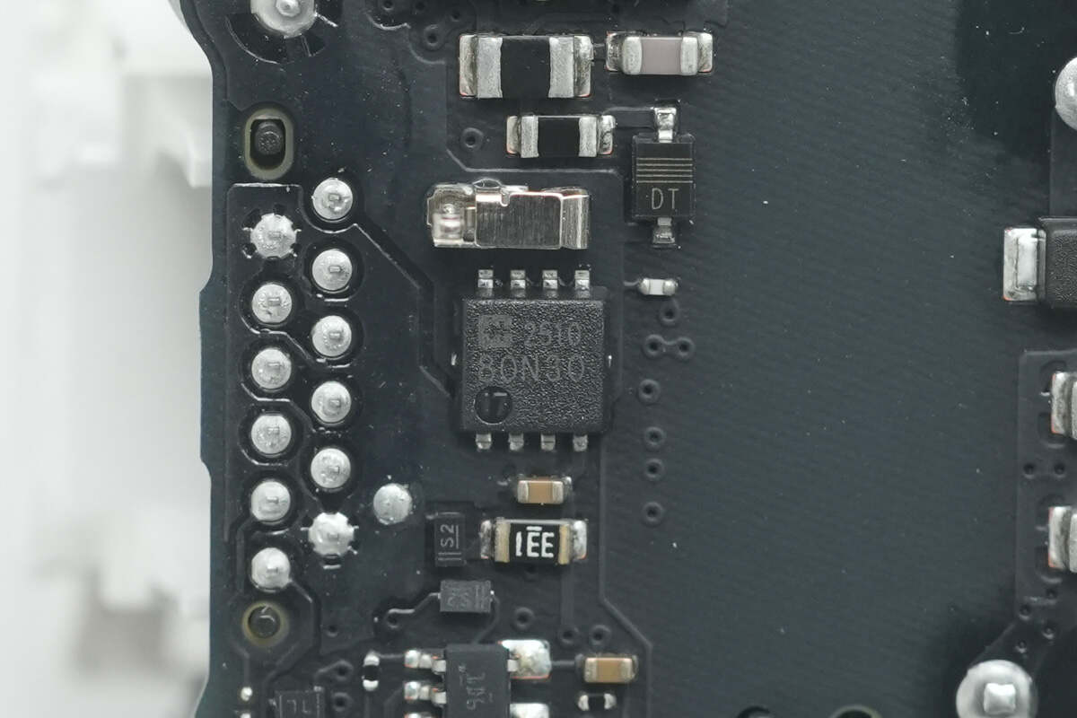

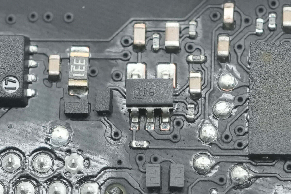

The VBUS MOSFET is also from RECTRON, model RM80N30DN. It is an NMOS transistor rated for 30V with an on-resistance of 3.8mΩ, packaged in a DFN 3x3 form factor.

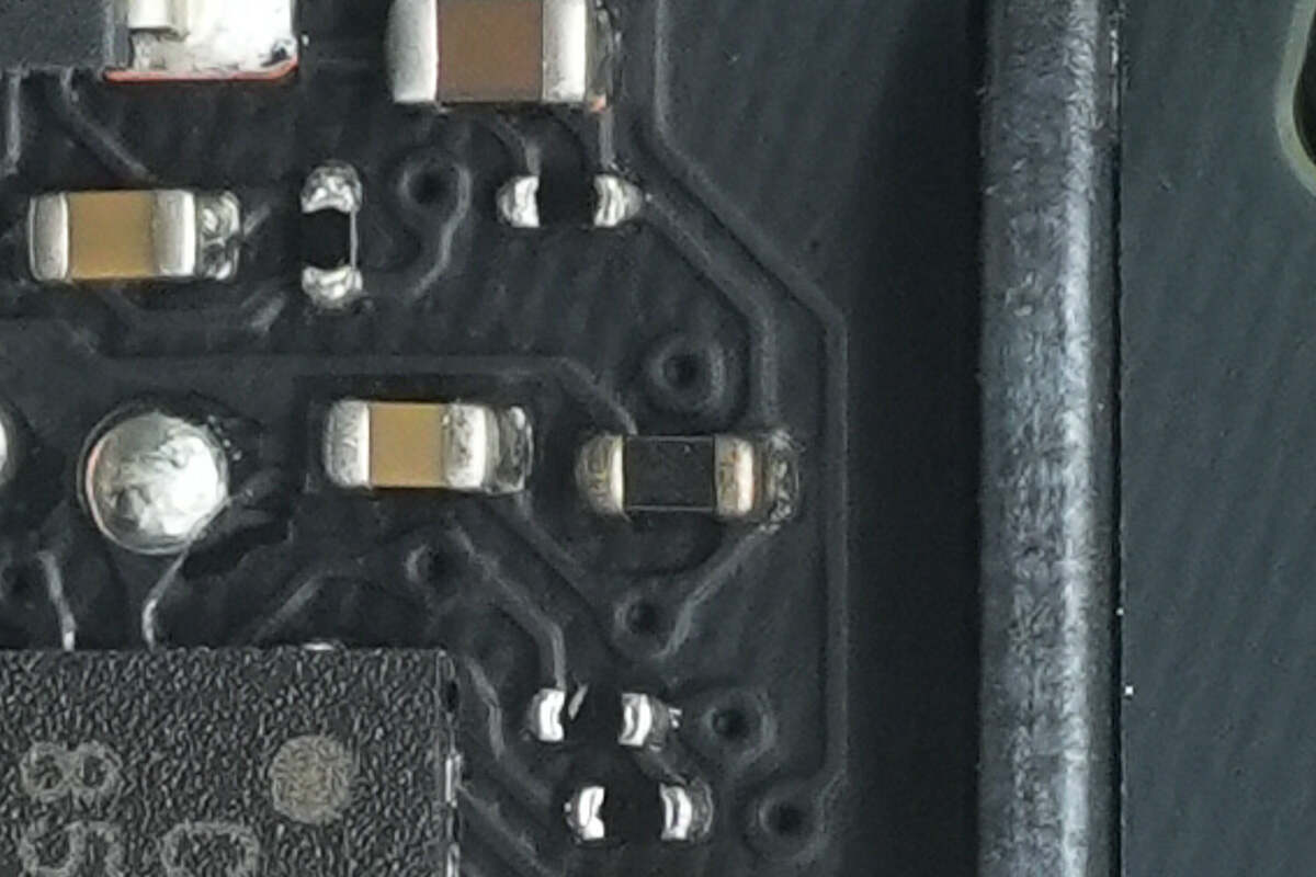

The thermistor monitors the internal temperature and dynamically adjusts the power level to reduce output power when the temperature rises.

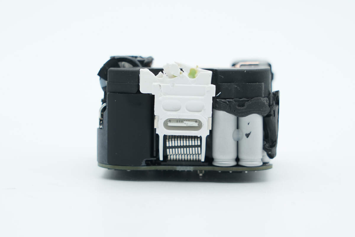

The pins of the USB-C socket are extended and soldered onto the PCBA.

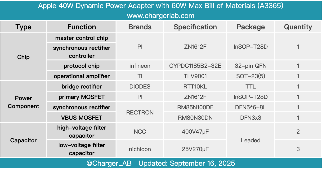

Here is the component list of the Apple 40W Dynamic Power Adapter with 60W Max for your convenience.
