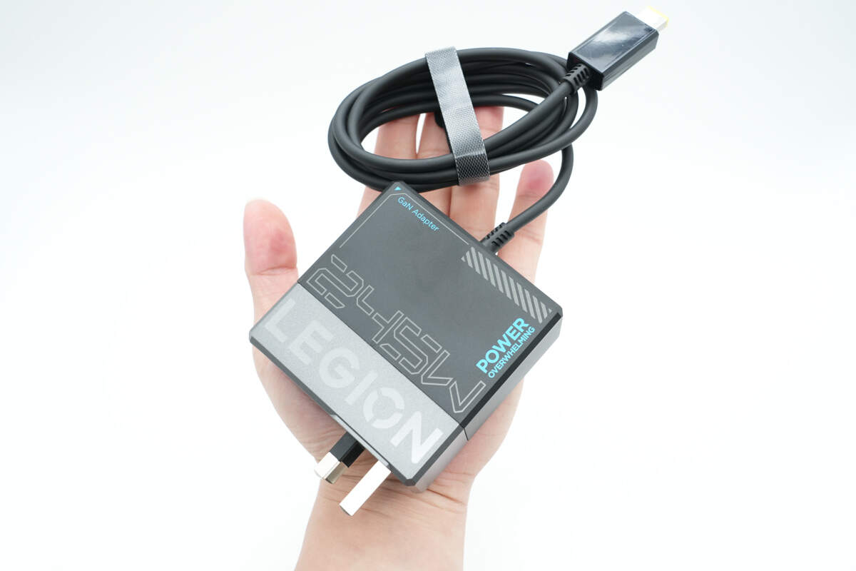

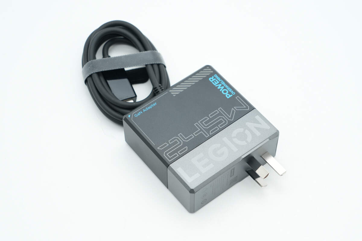

Lenovo Legion has recently launched a 245W GaN adapter. Compared to other adapters of the same power rating, this one is more compact and lighter in weight. It supports 20V 12.25A output, delivering up to 245W, which allows Legion gaming laptops to unleash their performance fully. It comes with a built-in 1.5-meter Lenovo Slim Tip cable and features an AI-powered display that accurately and precisely shows the real-time power output. Let’s take it apart to see its internal components and structure.

Teardown of Lenovo Legion 245W GaN Adapter (LA245)-Chargerlab

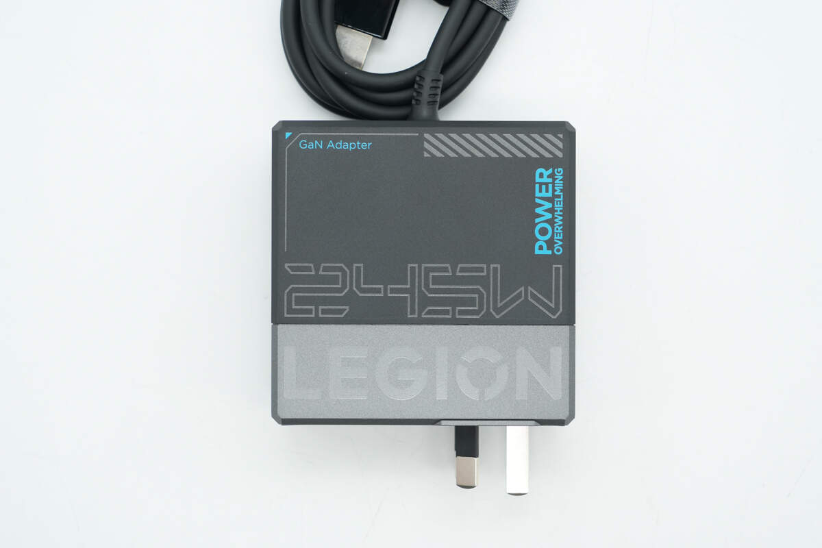

The adapter features a silver and black contrasting color design.
The front is printed with "LEGION," "245W," and "GaN Adapter."

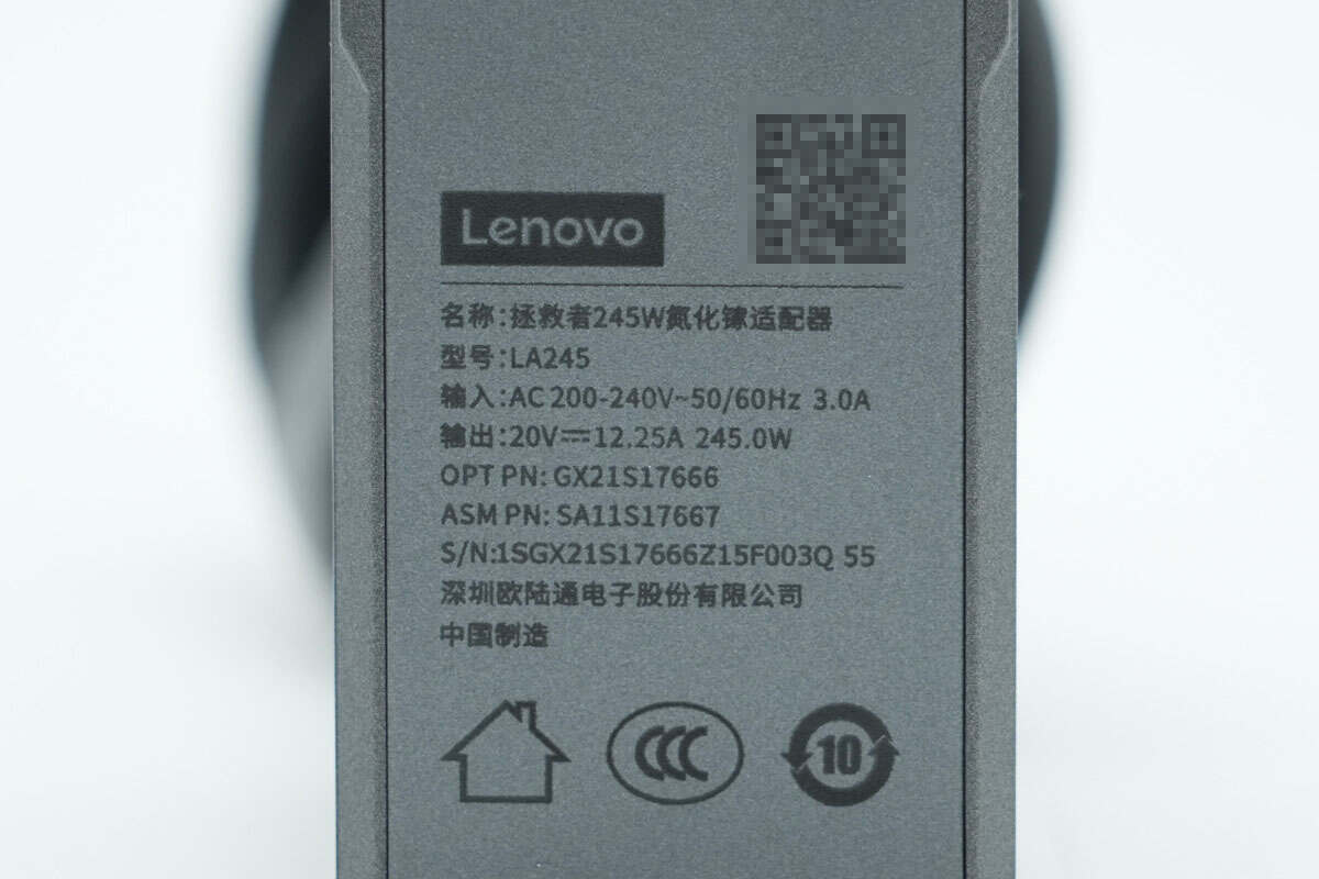

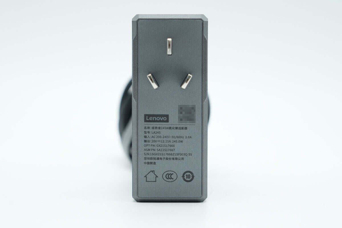

The input-side casing is printed with spec info.
Model: LA245
Input: 200-240V\~50/60Hz 3A
Output: 20V12.25A 245W

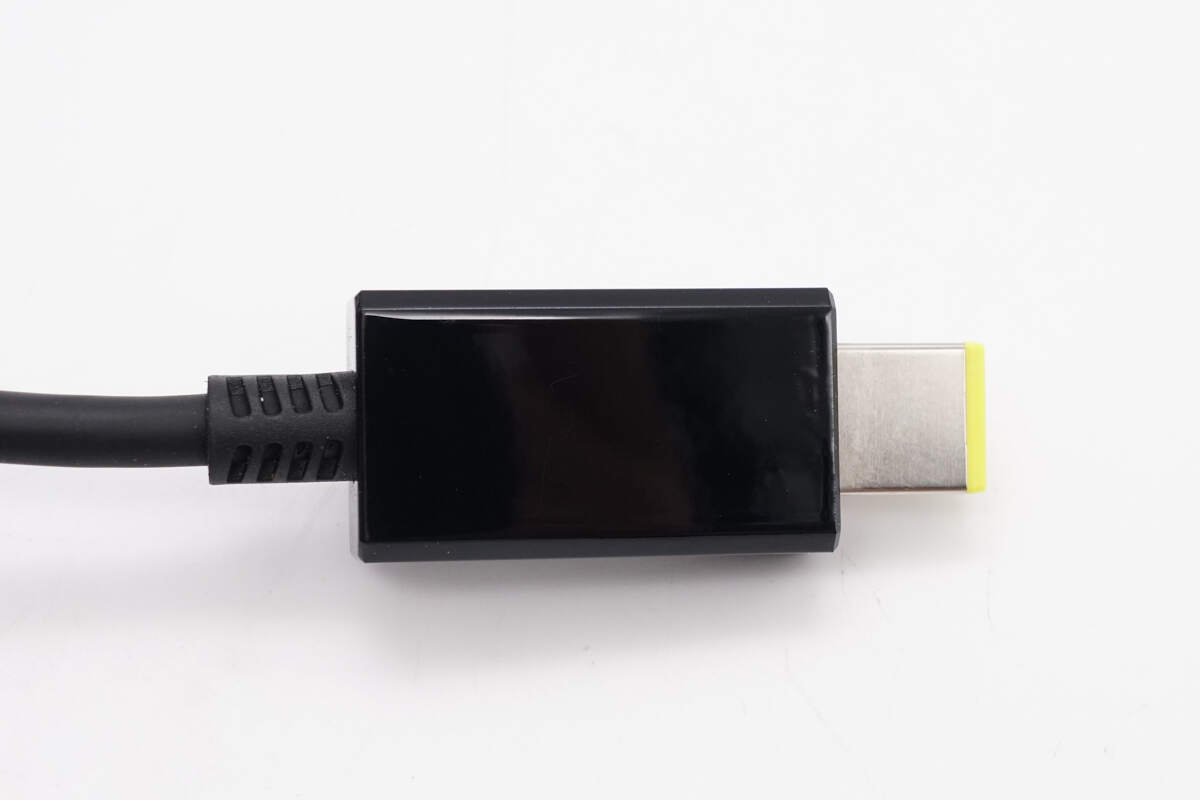

One side of the connector features the LEGION logo.
The other side has a built-in digital display that can show the charging power.

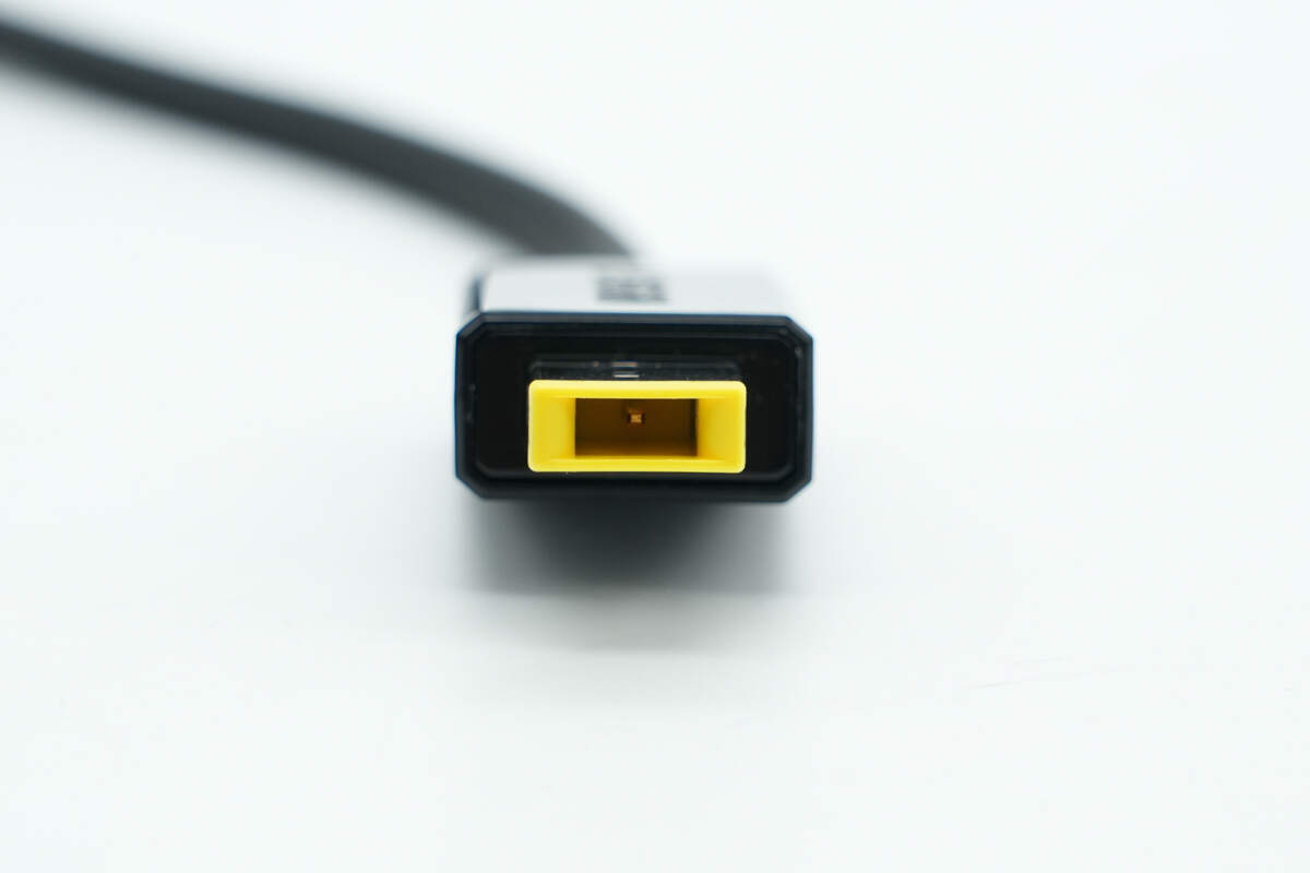

Close-up of the Slim Tip connector.

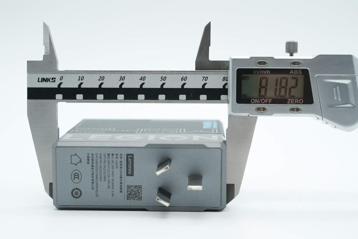

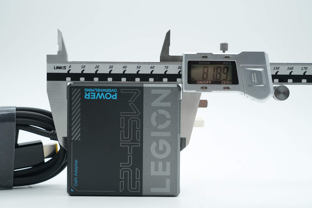

The length of the adapter is about 81.89 mm (3.22 inches).
The width is about 81.82 mm (3.22 inches).

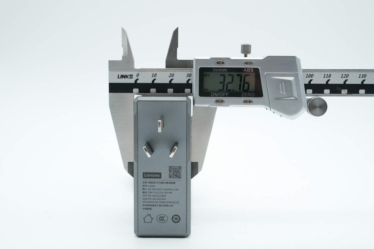

The thickness is about 32.76 mm (1.29 inches).

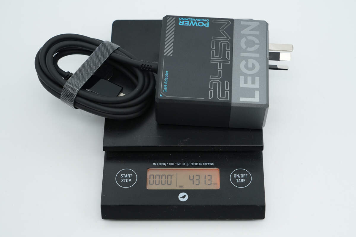

The weight is about 431 g (15.2 oz).
When used to charge the Legion R7000P, the connector’s digital display shows a charging power of 202W.

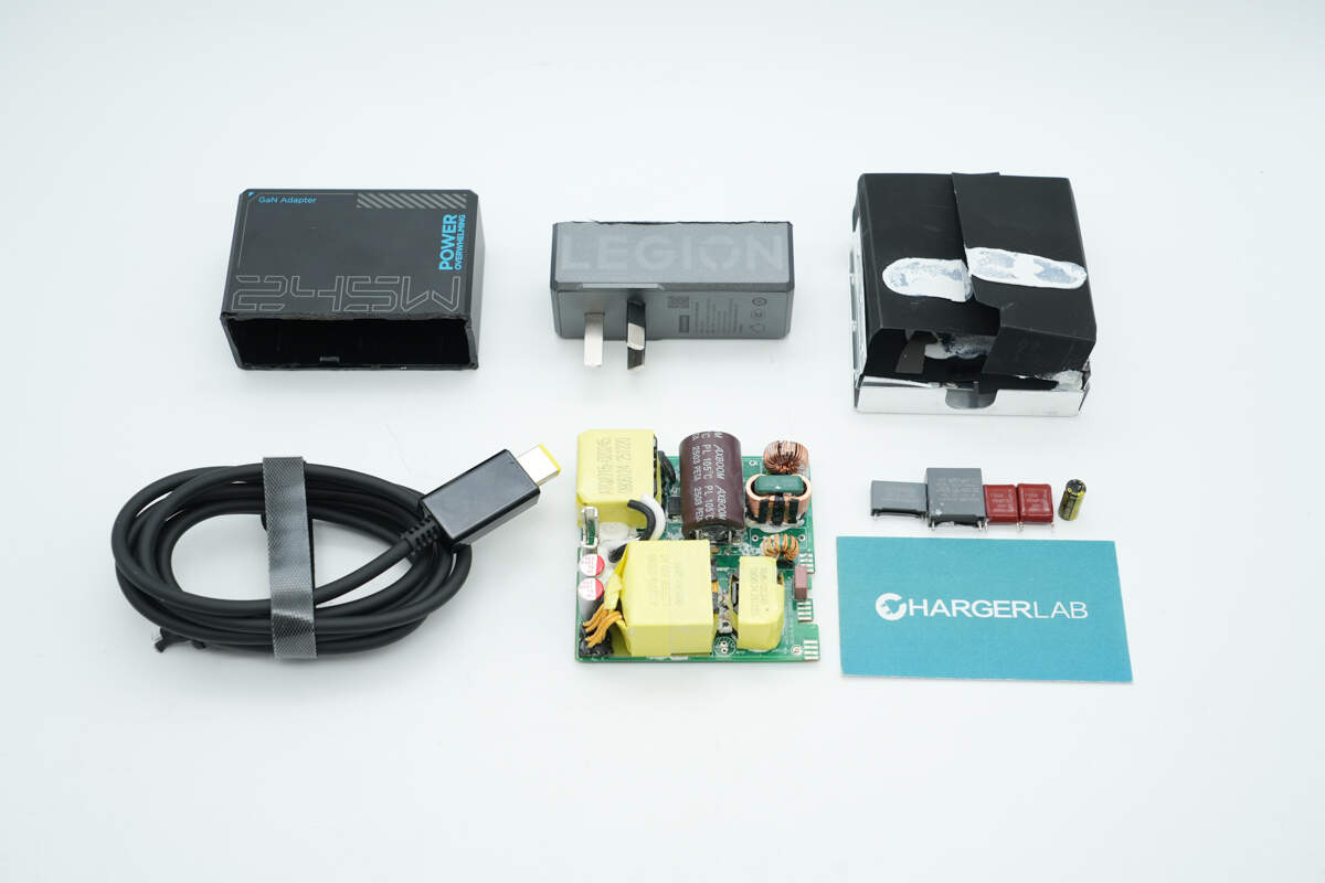

Cut open the shell to remove the PCBA module.

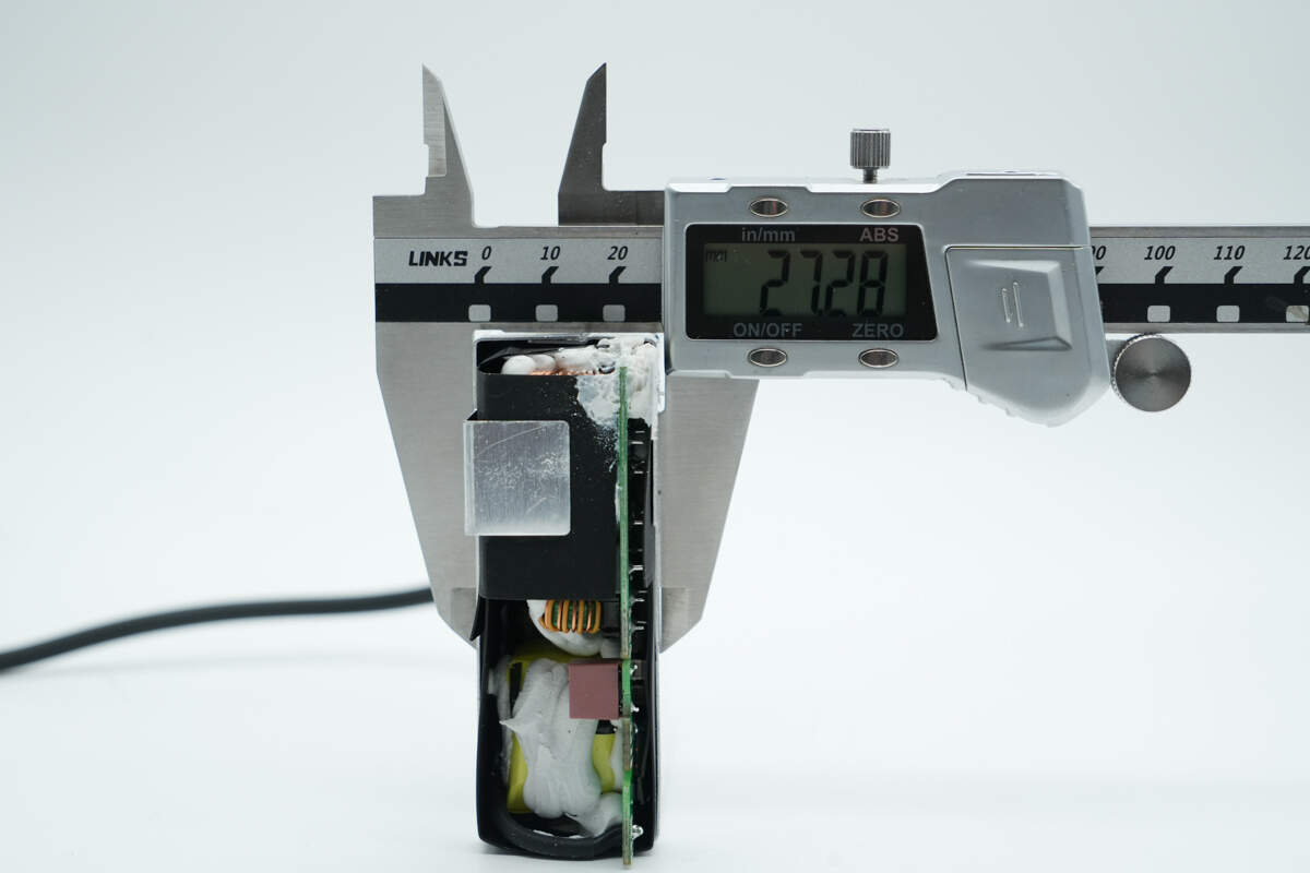

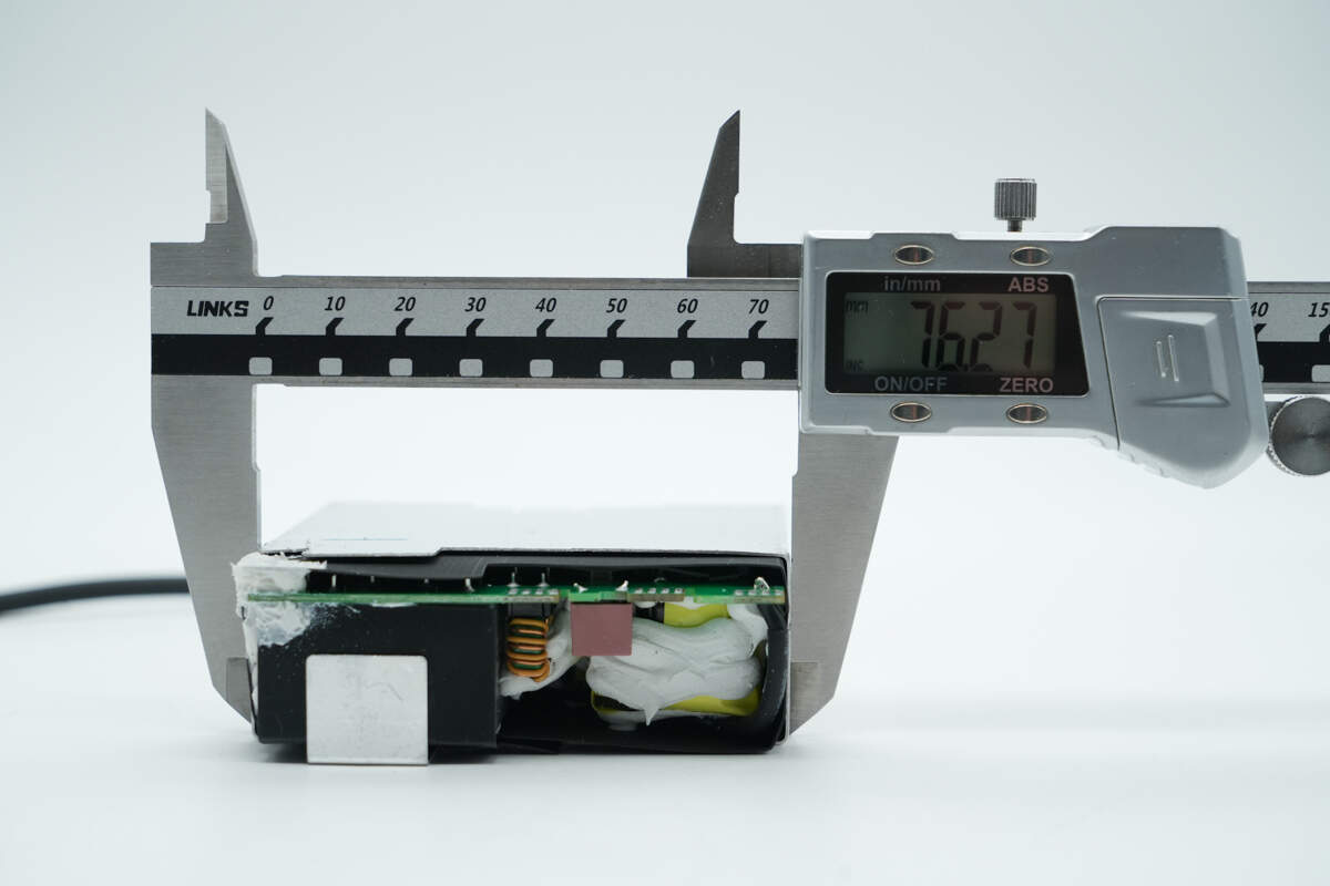

The length of the PCBA module is about 76.67 mm (3.019 inches).
The width is about 76.27 mm (3.0028 inches).
The thickness is about 27.28 mm (1.074 inches).

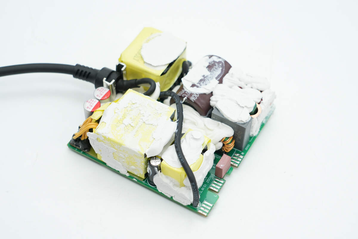

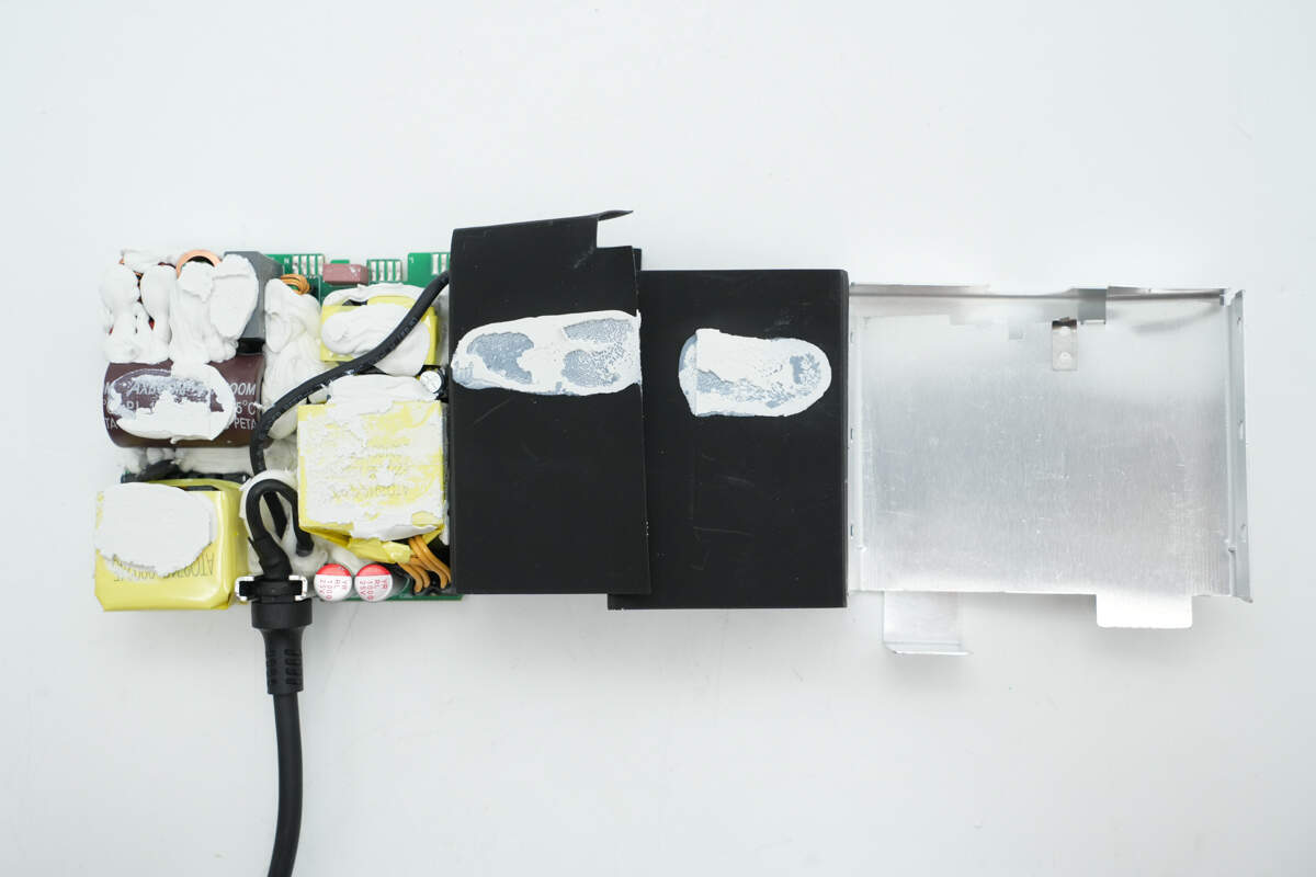

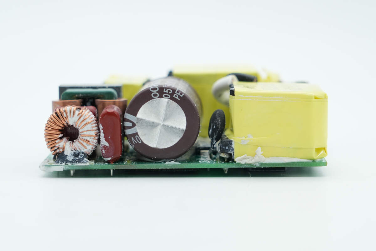

The PCBA module is covered with metal heatsinks, and both sides are secured with a snap-fit structure.
Remove the heatsink, and inside, there are Mylar sheets for insulation.

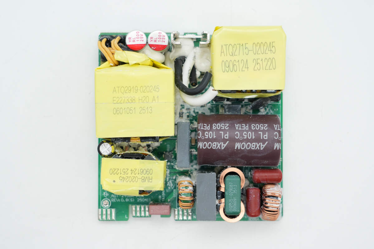

The front of the PCBA module contains components such as the transformer and capacitors.
The output cable is secured with a metal plate for added stability.
The central area on the back is covered with thermal adhesive.

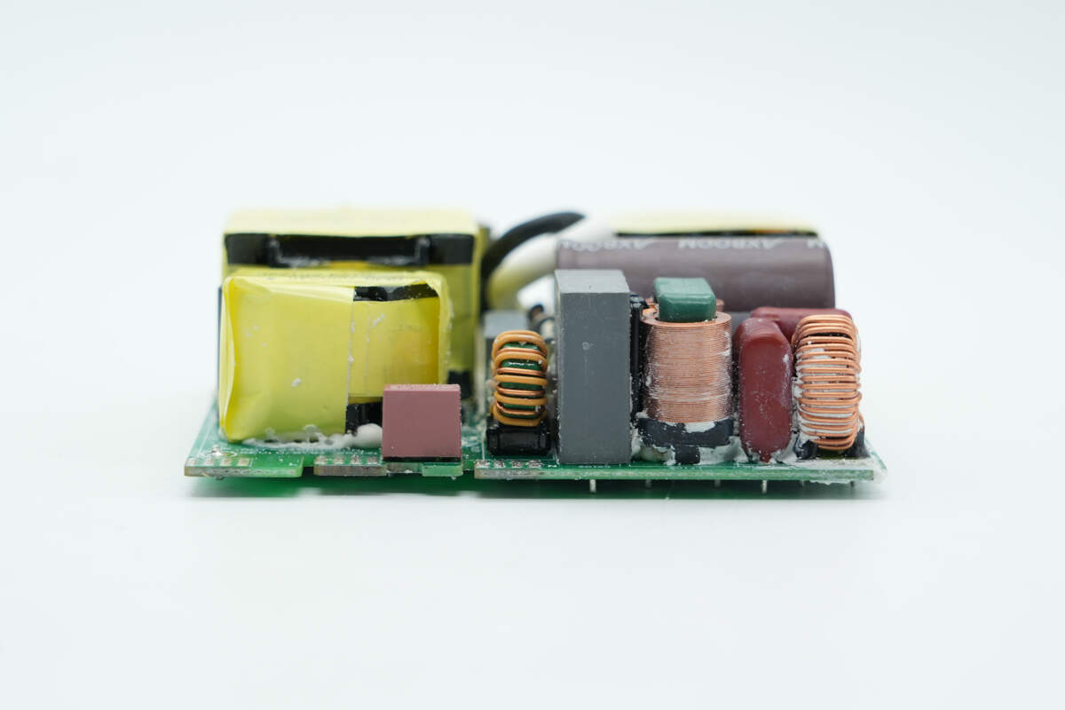

The front side of the main board includes components such as a time-delay fuse, common mode choke, electrolytic capacitors, PFC boost inductor, resonant inductor, and transformer. A resonant capacitor is also located at the center.

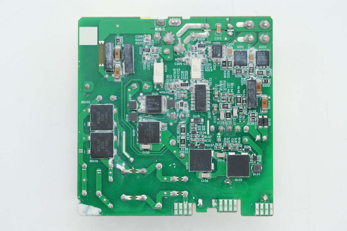

The back features a bridge rectifier, master control chip, along with supporting components such as the PFC MOSFET, LLC MOSFET, and synchronous rectifier.

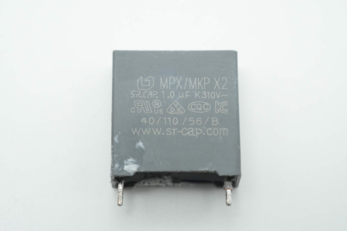

The safety X2 capacitor has a capacitance of 1μF.

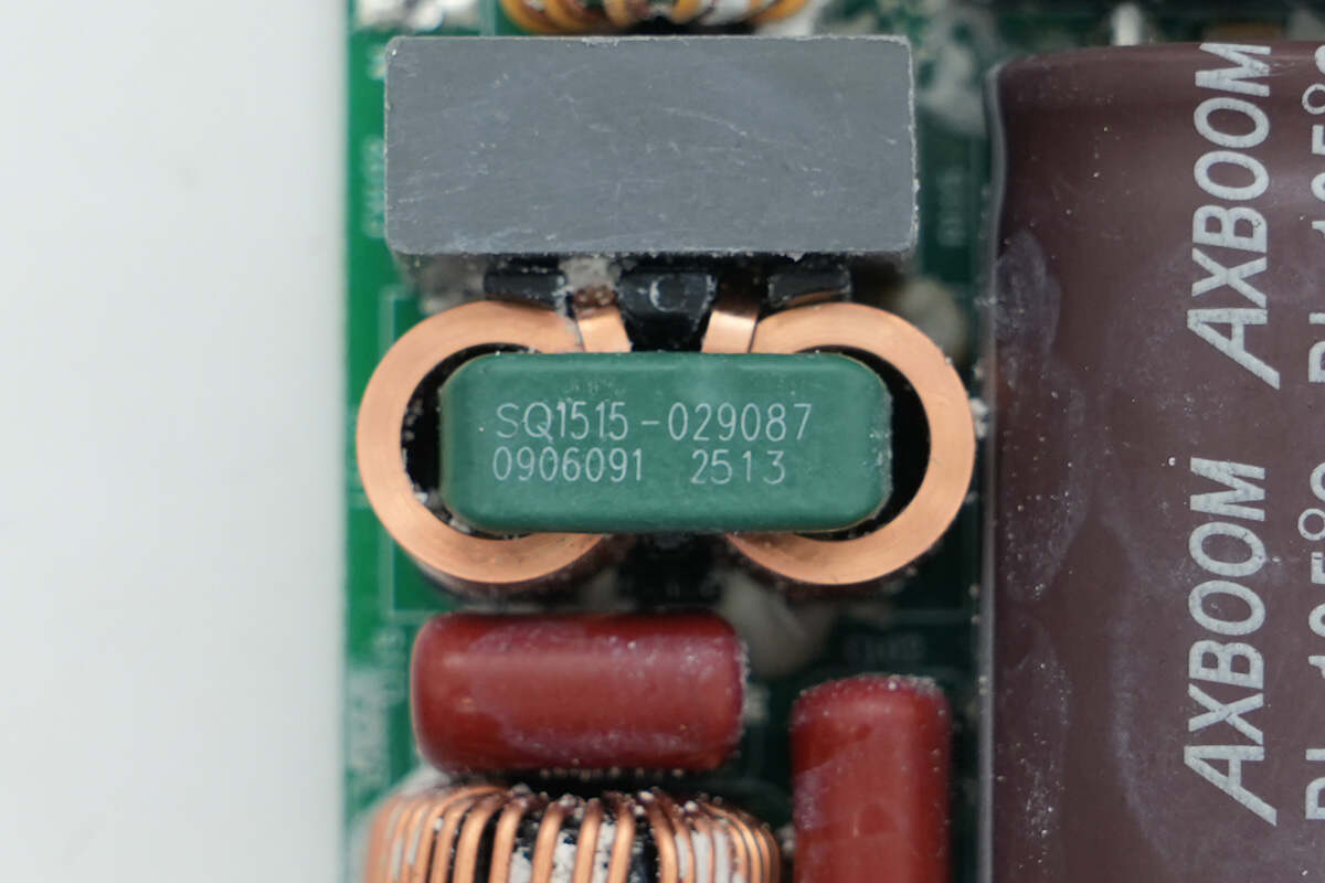

The secondary common mode choke is wound with flat copper strips and uses a green magnetic core.

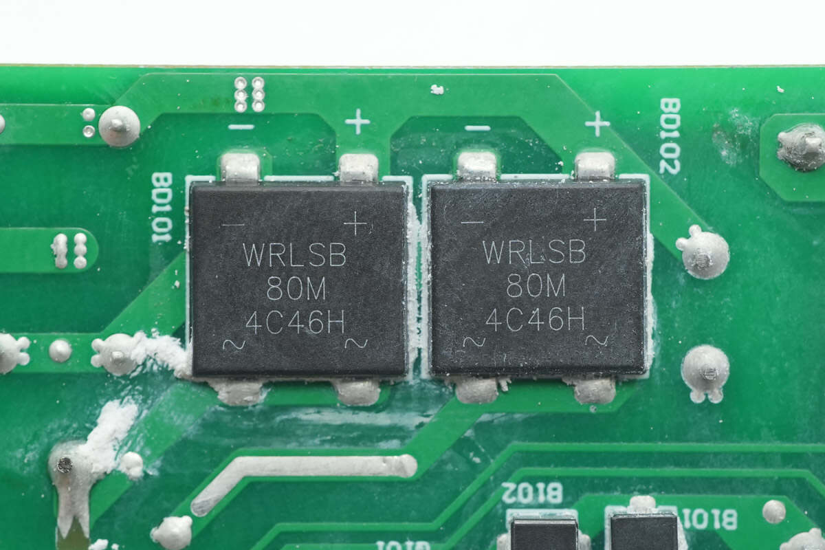

The bridge rectifier is from World Industrial, model WRLSB80M. This soft recovery bridge diode features a gentle recovery curve and smooth turn-off characteristics, which help minimize harmonic oscillations caused by the diode junction capacitance. It uses an LSB package that offers excellent heat dissipation, enhancing reliability for medium to high wattage adapters. A single diode can handle over 60W.

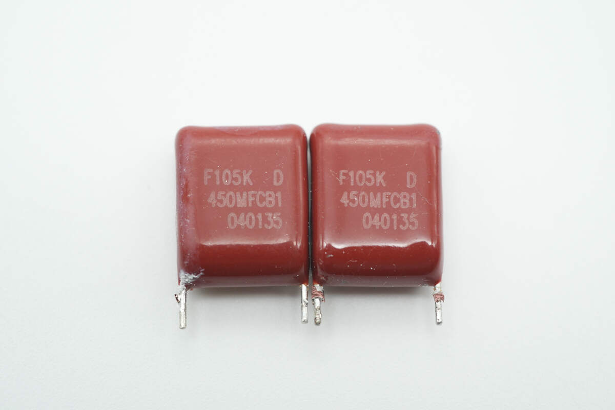

The two film capacitors are rated at 1μF, 450V.

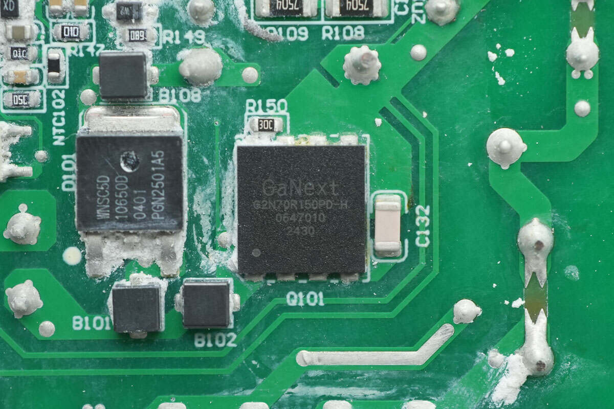

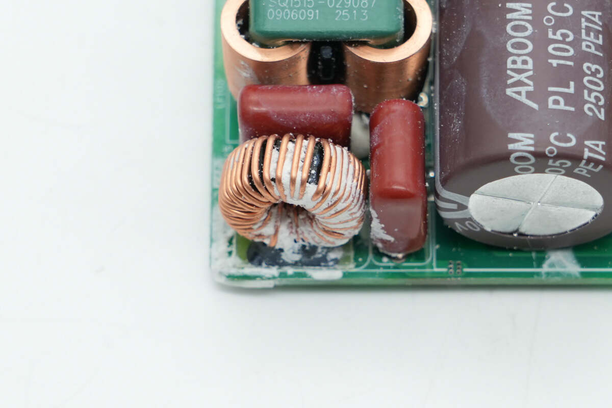

One side of the module includes an electrolytic capacitor, an NTC thermistor, and a PFC boost inductor.

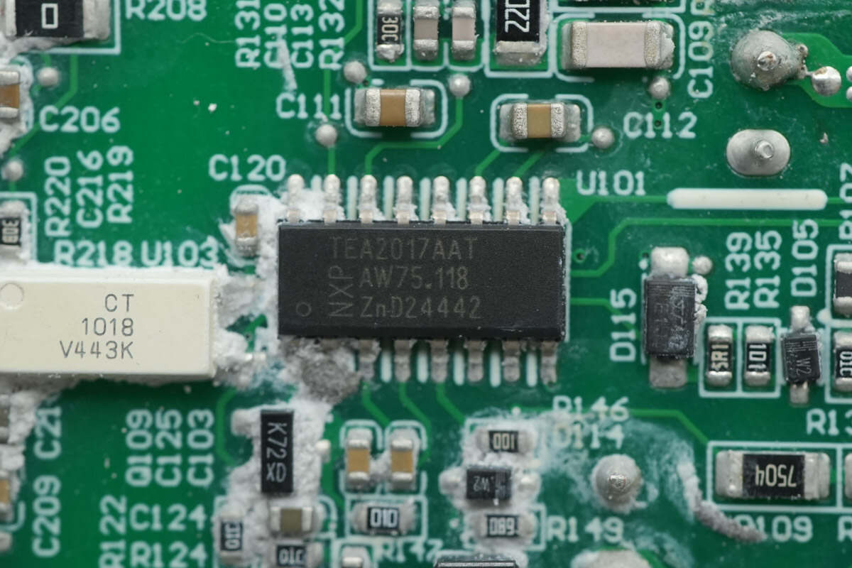

The master control chip is from NXP, model TEA2017AAT. It is a digitally configurable LLC and PFC combo controller designed for high-efficiency resonant power supplies. The chip integrates both LLC and PFC controller functions. The PFC section can be configured to operate in DCM/QR, CCM fixed frequency, or a multimode supporting all operation modes, optimizing PFC efficiency.
The PFC MOSFET is from GaNext, model G2N70R150PD-H. It is a GaN power device with a voltage rating of 700V and a transient voltage tolerance of 800V. The nominal on-resistance is 150mΩ, and the gate voltage rating supports ±20V, allowing it to be driven by traditional silicon MOSFET drivers. Compared to enhancement-mode GaN devices, this greatly simplifies the gate driver circuit design. It uses an HDFN 8×8-8L package.
The PFC boost inductor uses an ATQ2715 magnetic core.
The PFC rectifier is from WeEn, model WNSC5D10650D. It is a 650V-rated SiC diode, comes in a TO252 package.

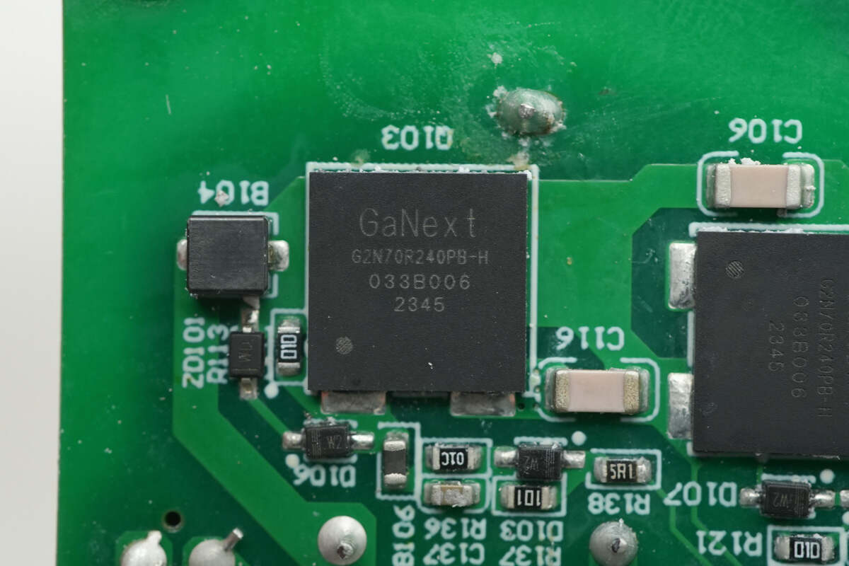

On the other side, there is a resonant inductor, a capacitor that powers the master control chip, a transformer, and a solid capacitor for output filtering.

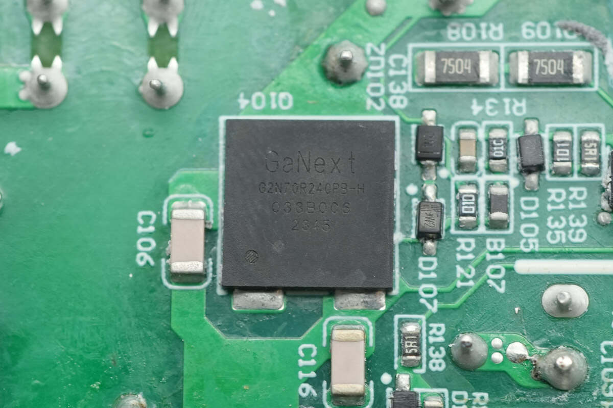

The LLC MOSFET is also from GaNext, model G2N70R240PB-H. It has a voltage rating of 700V, with an on-resistance of 240mΩ. The gate supports a 20V driving voltage, making it suitable for QR or ACF flyback topologies, totem-pole PFC, inverters, LLC, and other soft-switching applications. It comes in a PQFN 8×8 package.
Close-up of the other LLC MOSFET.

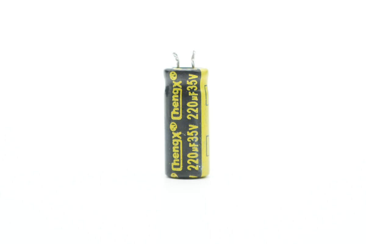

The capacitor that powers the master control chip is from Chengx. 35V 220μF.

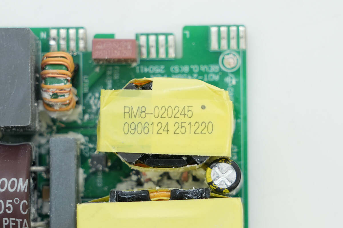

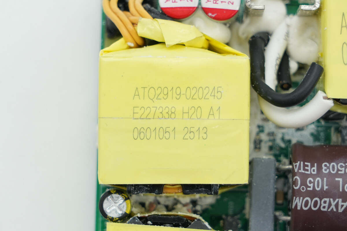

The transformer uses an ATQ2919 magnetic core.

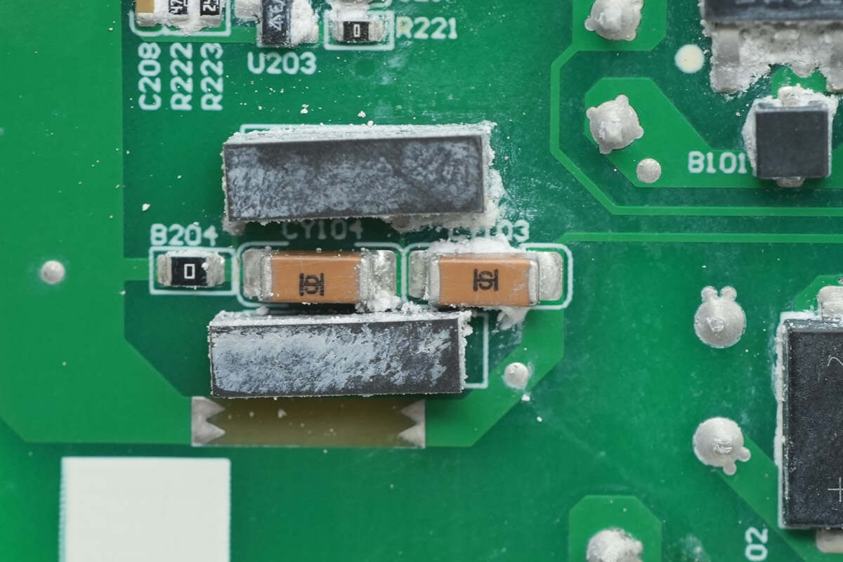

The SMD Y capacitors are from Holy Stone. Two capacitors are connected in series to increase the voltage rating and enhance safety.

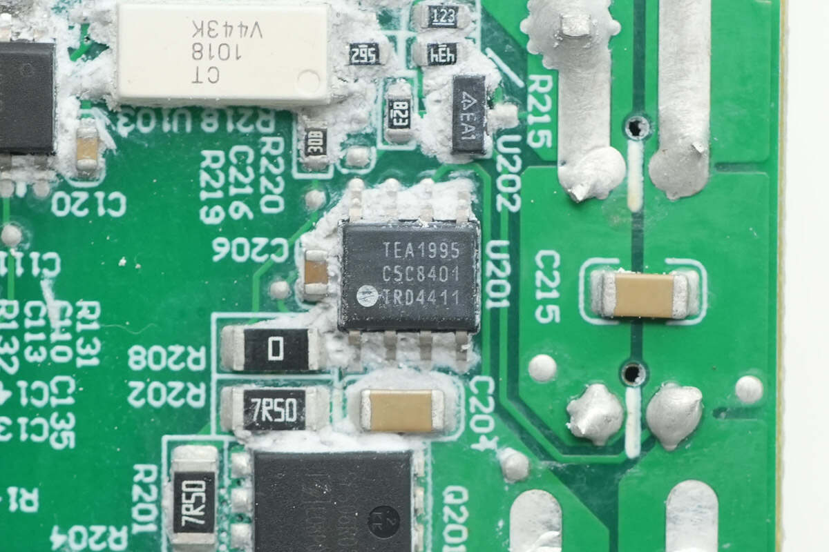

The synchronous rectifier controller is from NXP, model TEA1995. It has two independent synchronous rectifier drivers built in for LLC architecture switch-mode power supplies. The controller simplifies external components, supports a 38V operating voltage, and comes in an SO8 package.
The synchronous rectifier is from Oriental, model SFS06R03GF. It is an NMOS transistor with a voltage rating of 60V and an on-resistance of 3mΩ. It comes in a PDFN 5×6 package.

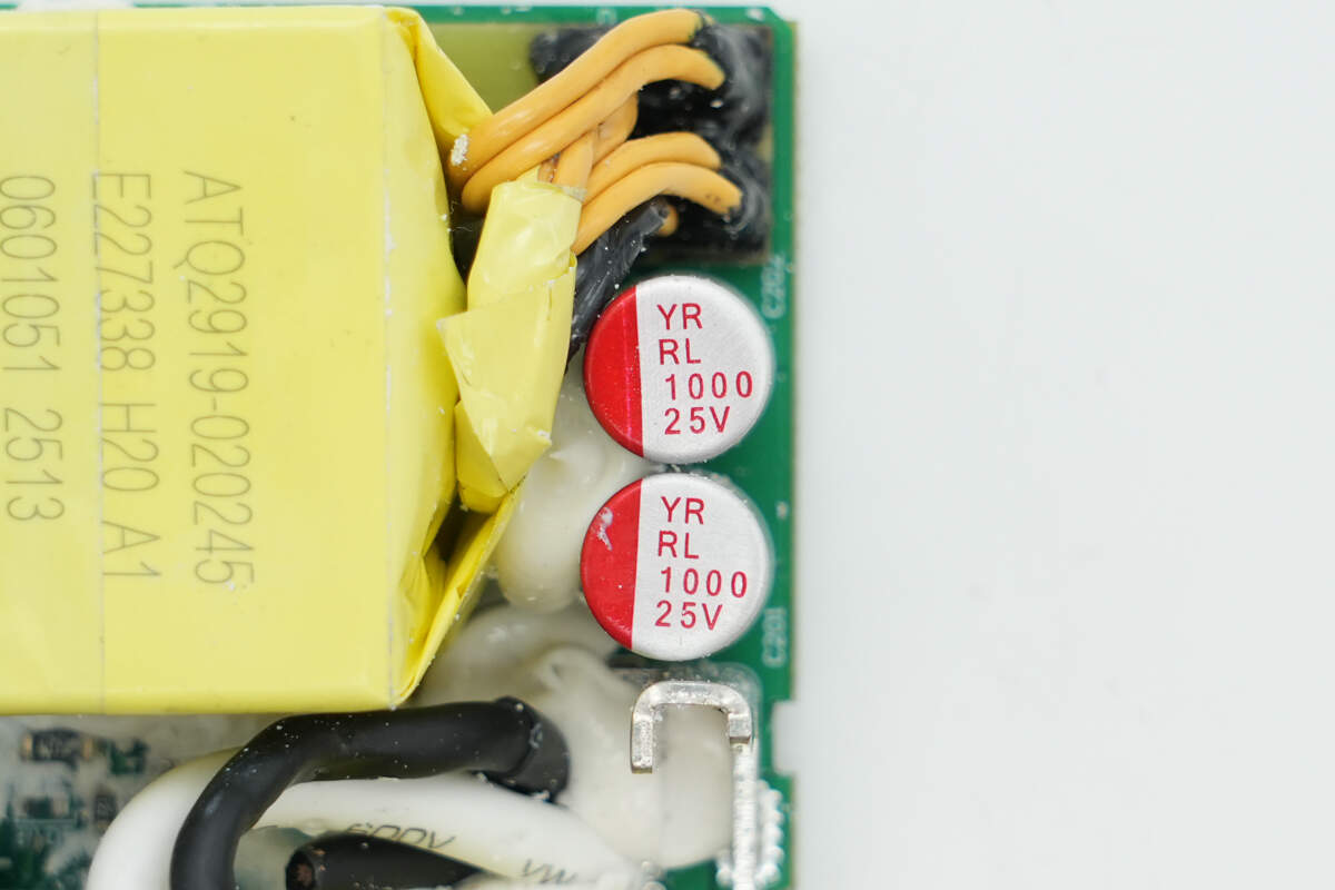

The two solid capacitors for output filtering have a specification of 25V, 1000μF.
