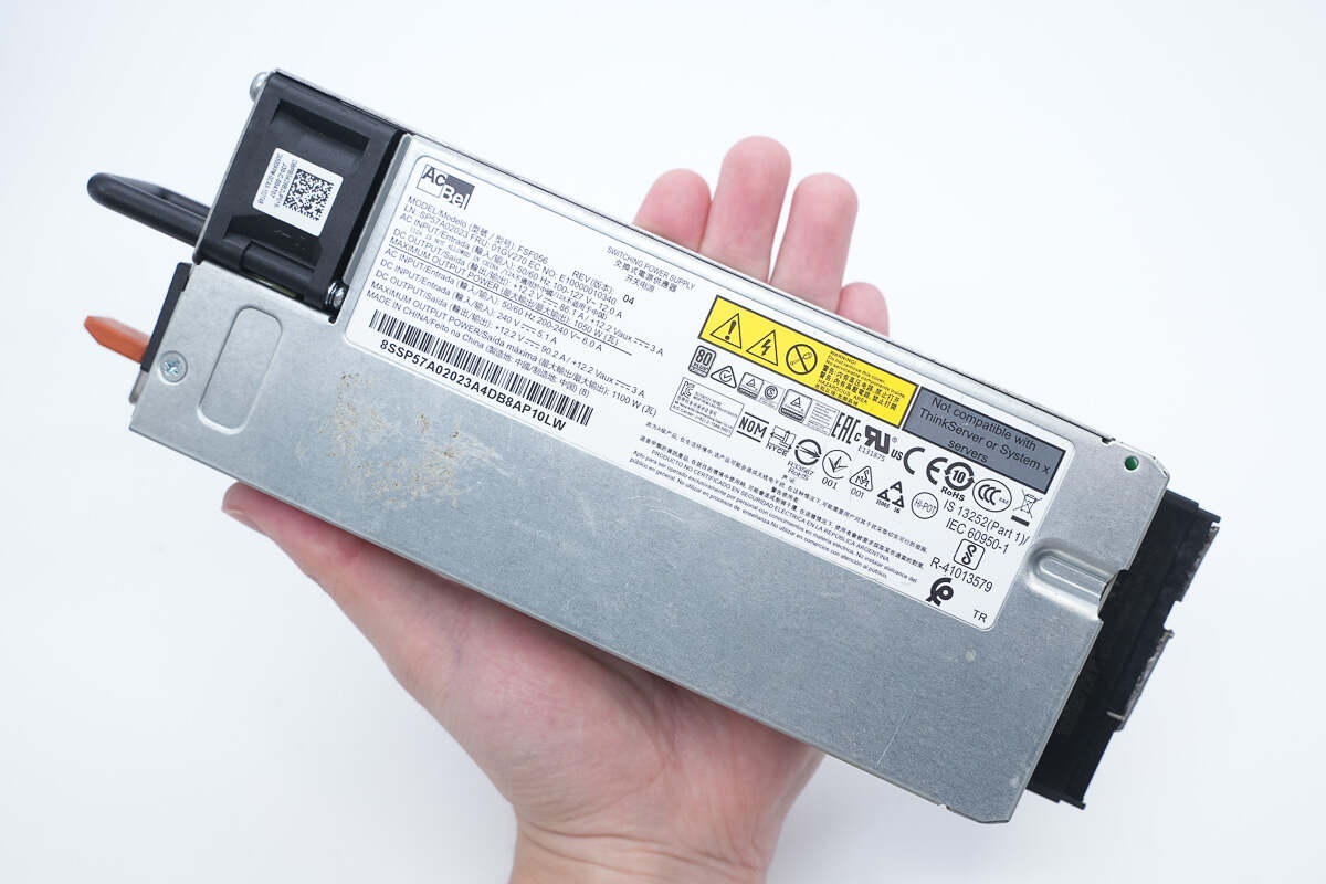

We recently obtained an AcBel 1100W Platinum Server Power Supply. This power supply supports an input voltage range of 100–127V, delivering an output power of 1050W under these conditions. When the input voltage is between 200 and 240V, it achieves its rated output power of 1100W. The power supply’s rated output voltage is 12.2V, with an auxiliary output of 12V and a rated output current of 3A.
The power supply module features a long rectangular metal casing, with a cooling fan, handle, indicator light, and power socket on the input side, and a gold finger connector on the output side. This power supply module is designed to provide power for Lenovo servers and adopts a PFC plus phase-shift full-bridge architecture. Next, we present the teardown to take a closer look at its internal design and components.

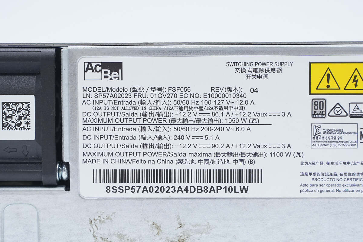

A nameplate is attached to the front side.
Teardown of AcBel 1100W Platinum SiC Server Power Supply (FSF056)-Chargerlab
Model: FSF056
Input: 50/60Hz 100-127V\~ 12A
Output: +12.2V 86.1A / +12.2Vaux 3A
Maximum Output: 1050W
Input: 50/60Hz 200-240V\~ 6A
Input: 240V 5.1A
Output: +12.2V 90.2A / +12.2Vaux 3A
Maximum Output: 1100W

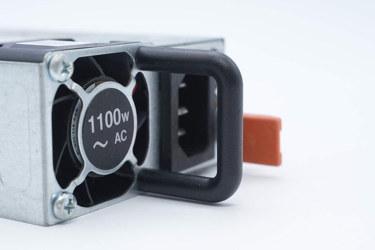

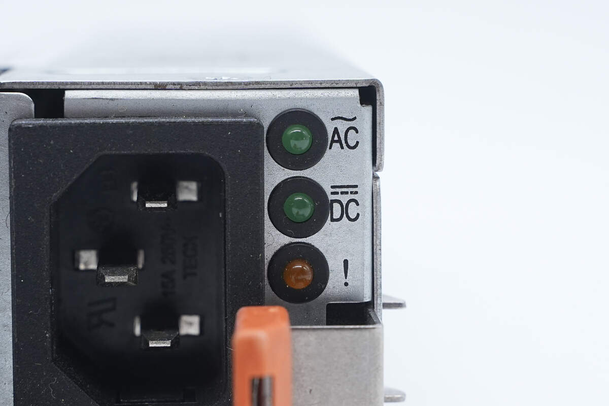

The input side is equipped with a handle, a cooling fan, indicator lights, a C14 inlet, and a trip handle.
The protective cover of the cooling fan is labeled with a power output of 1100W.
The handle is used to pull out the power module.
Close-up of the LED indicator lights.

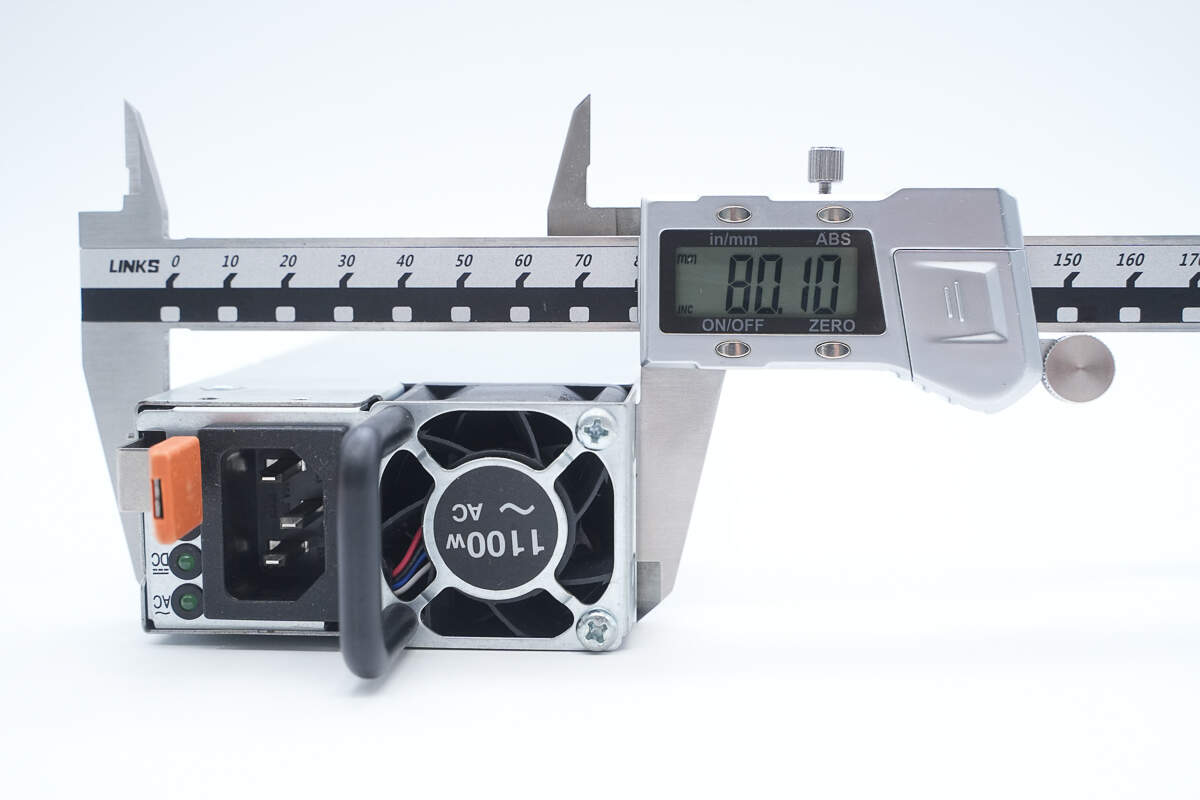

The length is about 212 mm (8.35 inches).
The width is about 80.1 mm (3.15 inches).

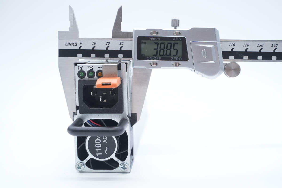

The thickness is about 38.9 mm (1.53 inches).

The weight is about 1006 g (35.49 oz).

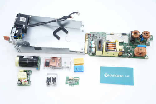

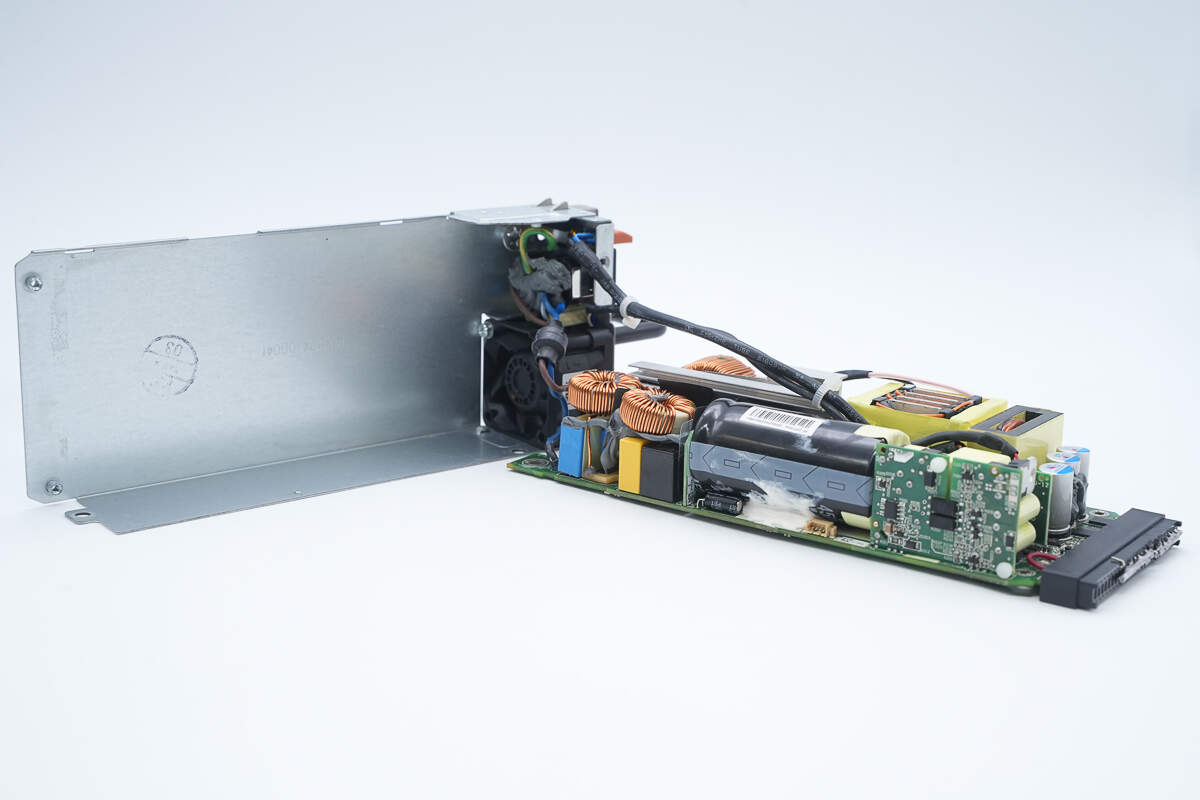

Unscrew the fixing screws and remove the casing.
The PCBA module is wrapped in a black Mylar sheet for insulation.
The PCBA module is fixed inside the housing with screws.
The PCBA module is secured inside the casing with screws.

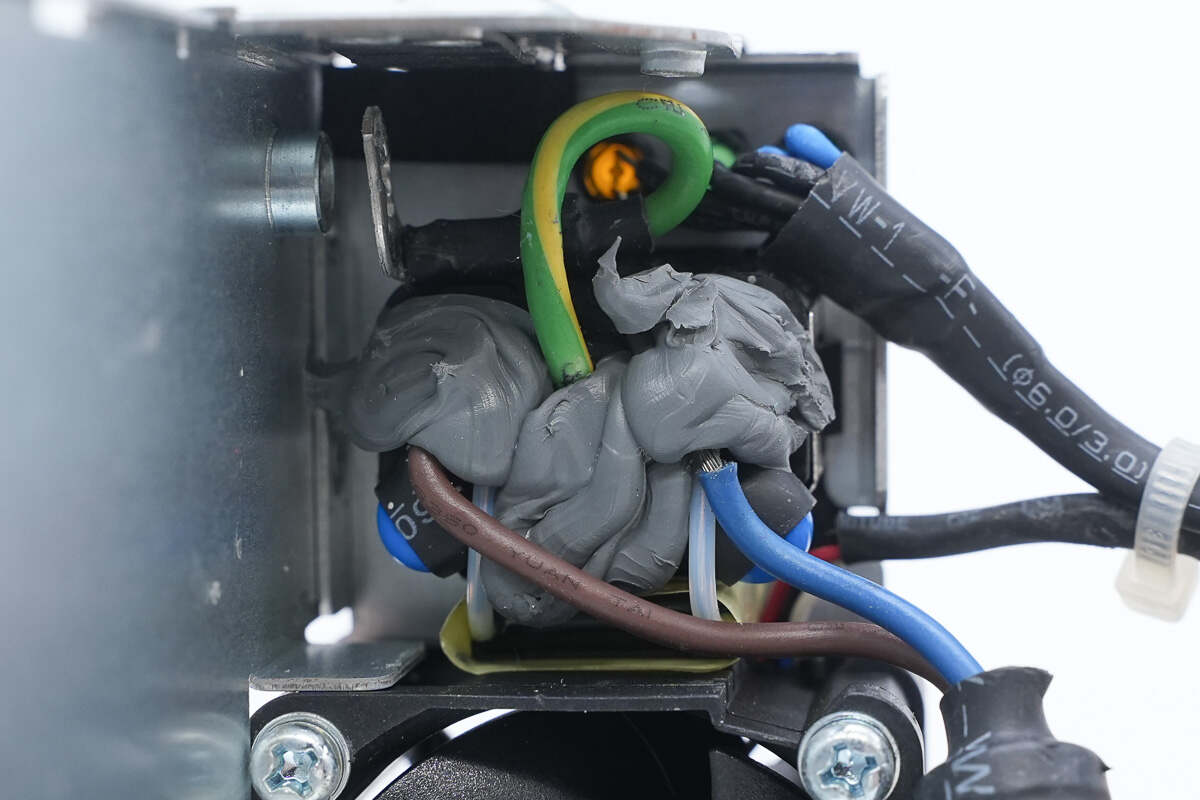

The power socket is insulated with adhesive sealing.

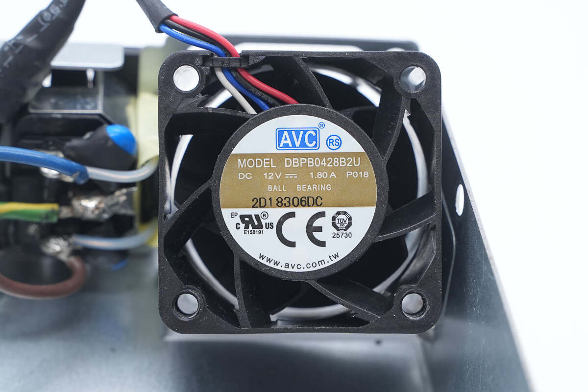

The cooling fan is manufactured by AVC, model DBPB0428B2U, with specifications of 12V and 1.8A.

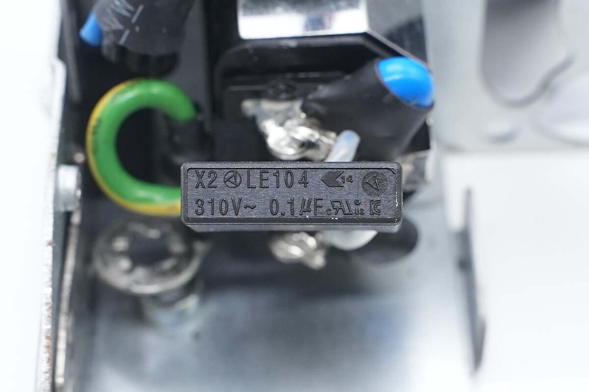

The safety X2 capacitor is rated at 0.1 μF.

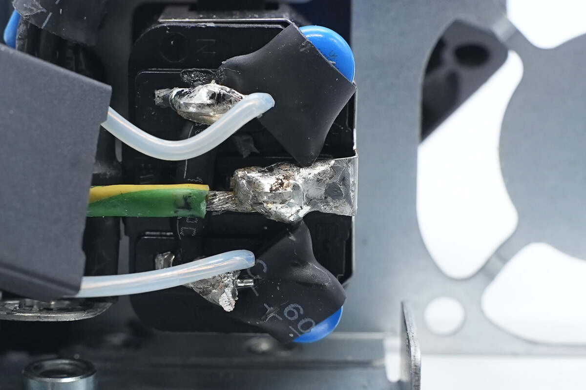

The blue Y capacitors are connected by soldering.

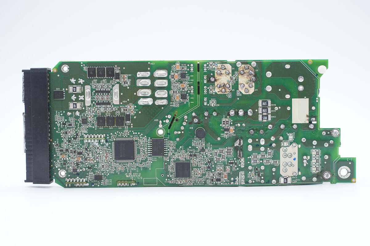

On the back of the module are the PFC controller, phase-shift full-bridge controller, digital isolation chip, and synchronous rectifiers.
The back of the module contains the PFC controller, phase-shift full-bridge controller, digital isolation chip, and synchronous rectifiers.

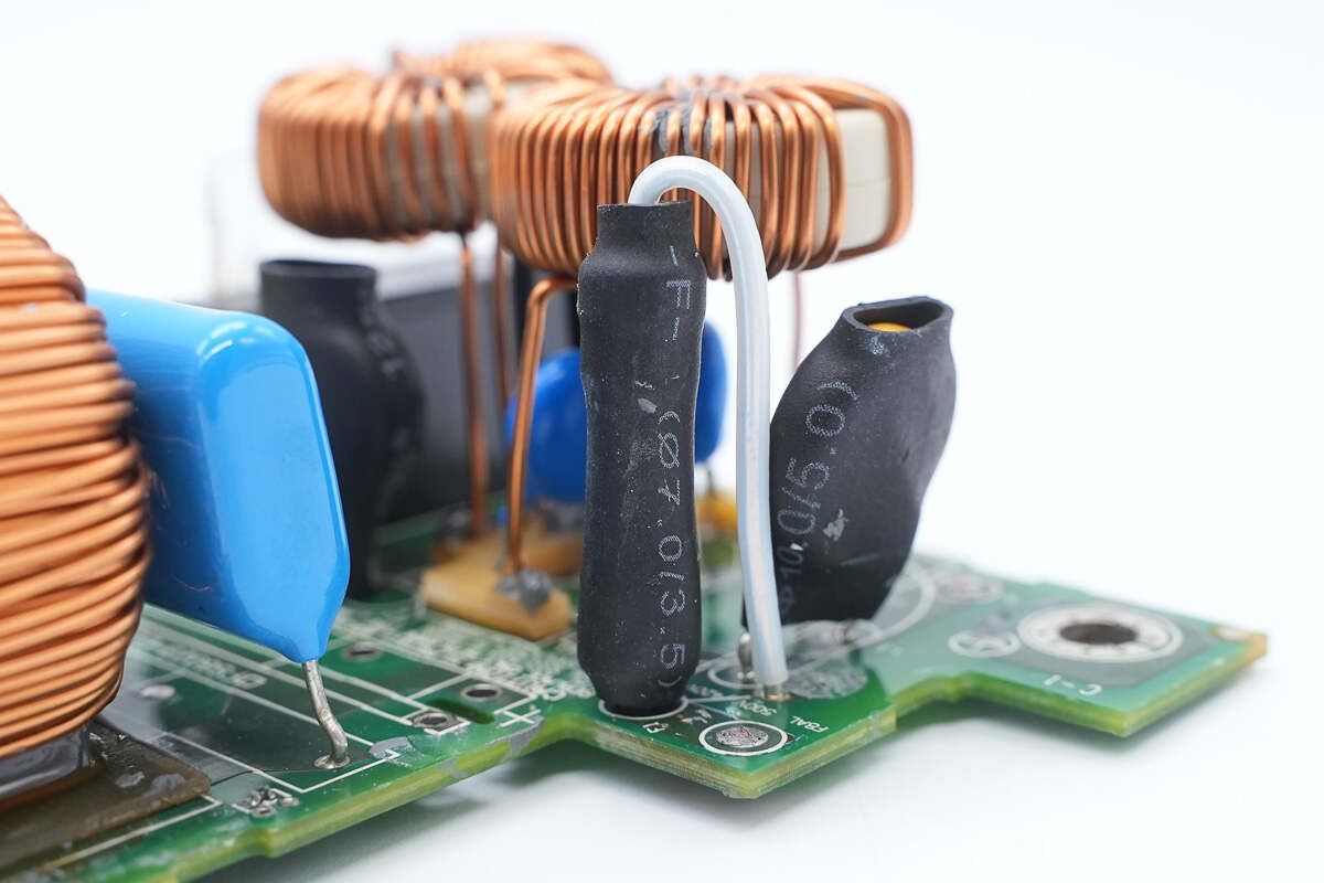

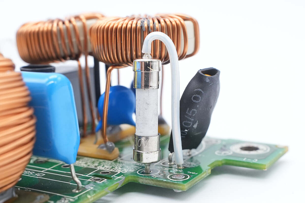

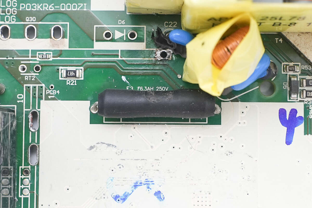

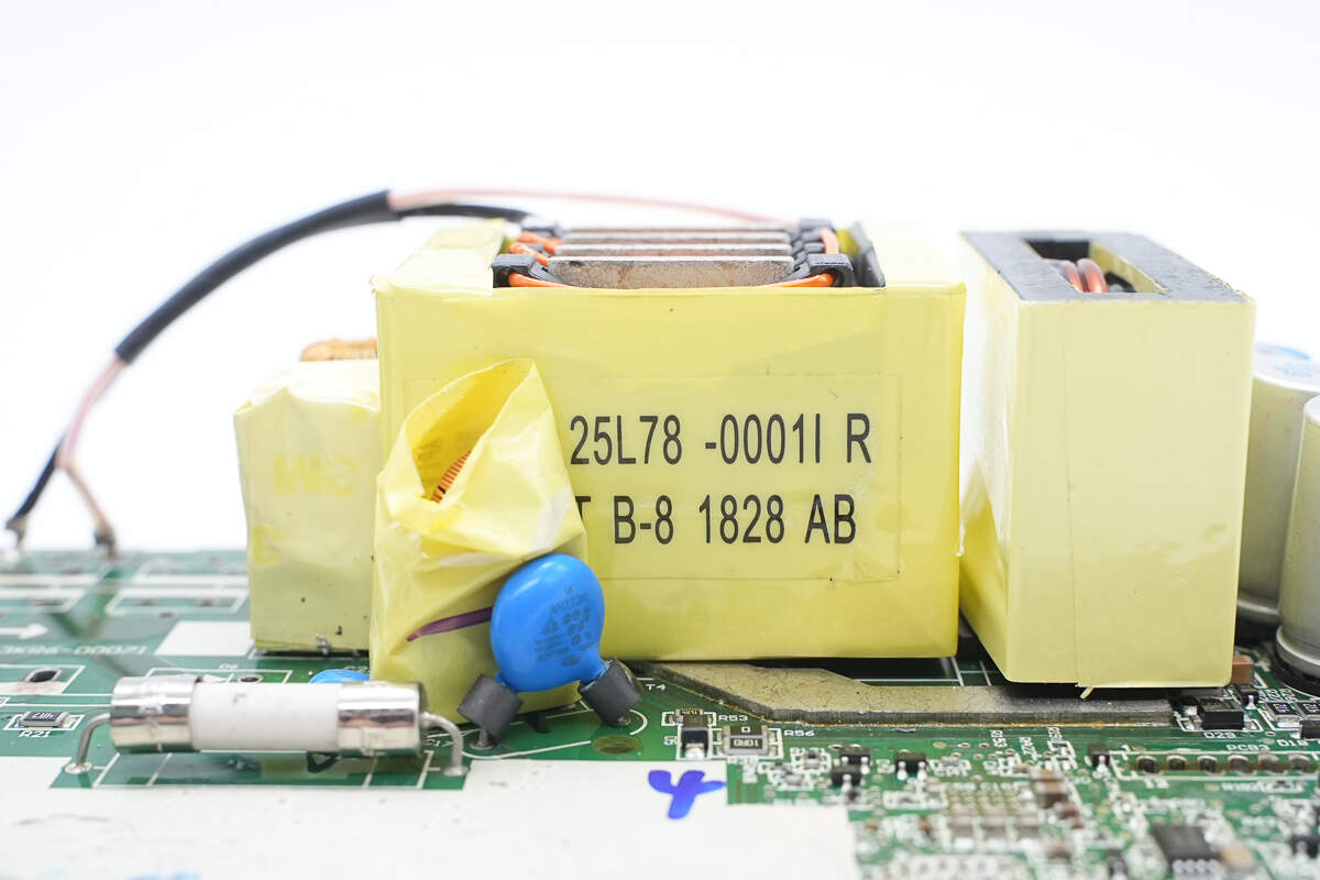

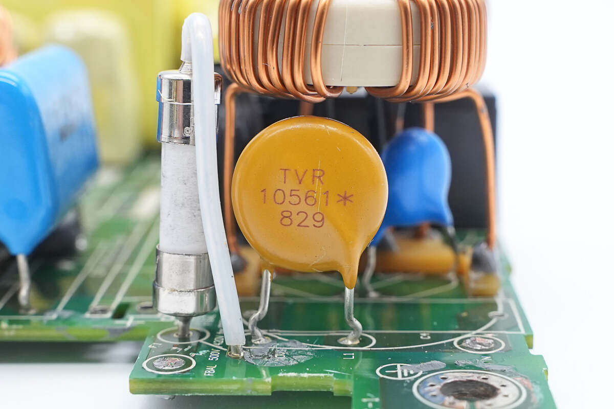

Both the fuse and varistor are insulated with heat-shrink tubing.

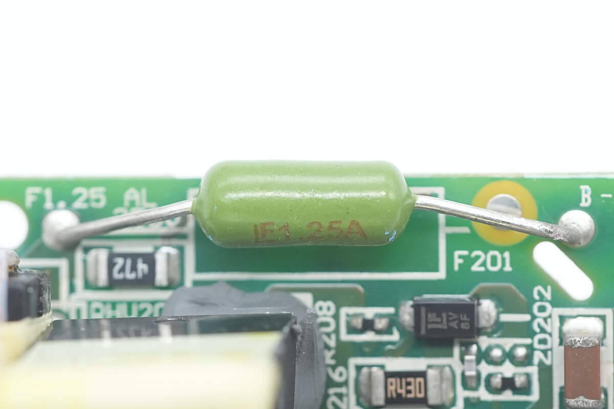

The fuse is rated at 8A.
The varistor is model TVR10561 and is used to absorb overvoltage surges.

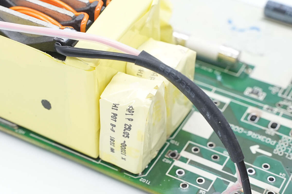

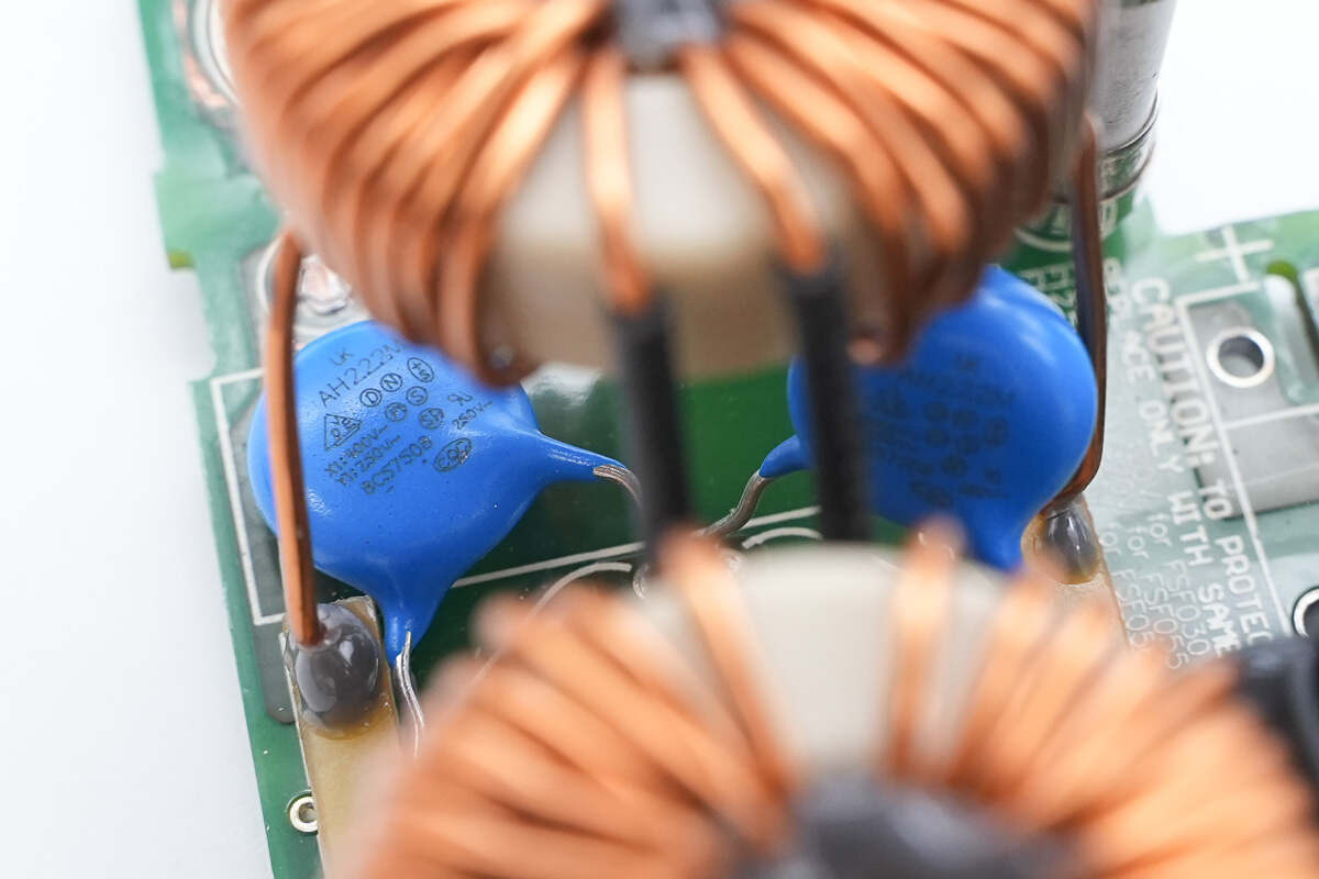

Close-up of two blue Y capacitors.

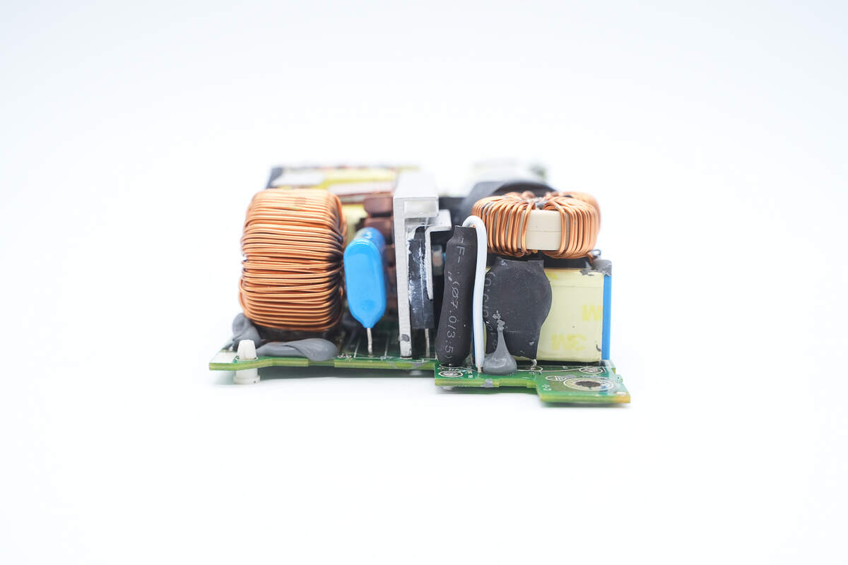

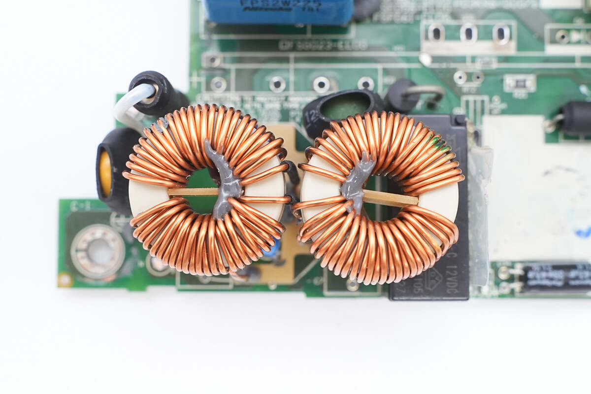

The common mode chokes use toroidal cores and are internally insulated with bakelites.

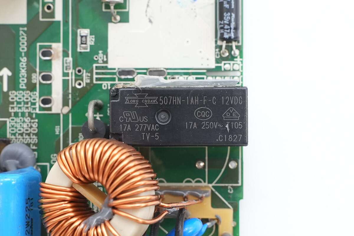

The relay is from SongChuan, model 507HN-1AH-F-C, featuring one built-in normally open contact with a contact rating of 16A at 240VAC, and a coil voltage of 12V.

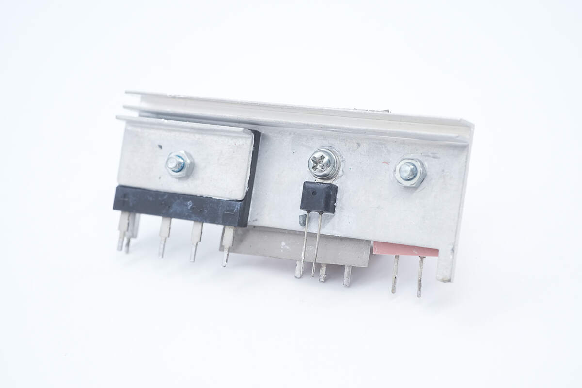

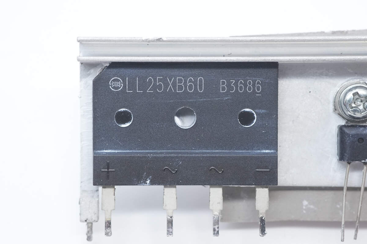

The other side contains the bridge rectifier and the thermistor.
The bridge rectifier is from Shindengen, model LL25XB60, rated at 25A 600V, and uses a 5S package.

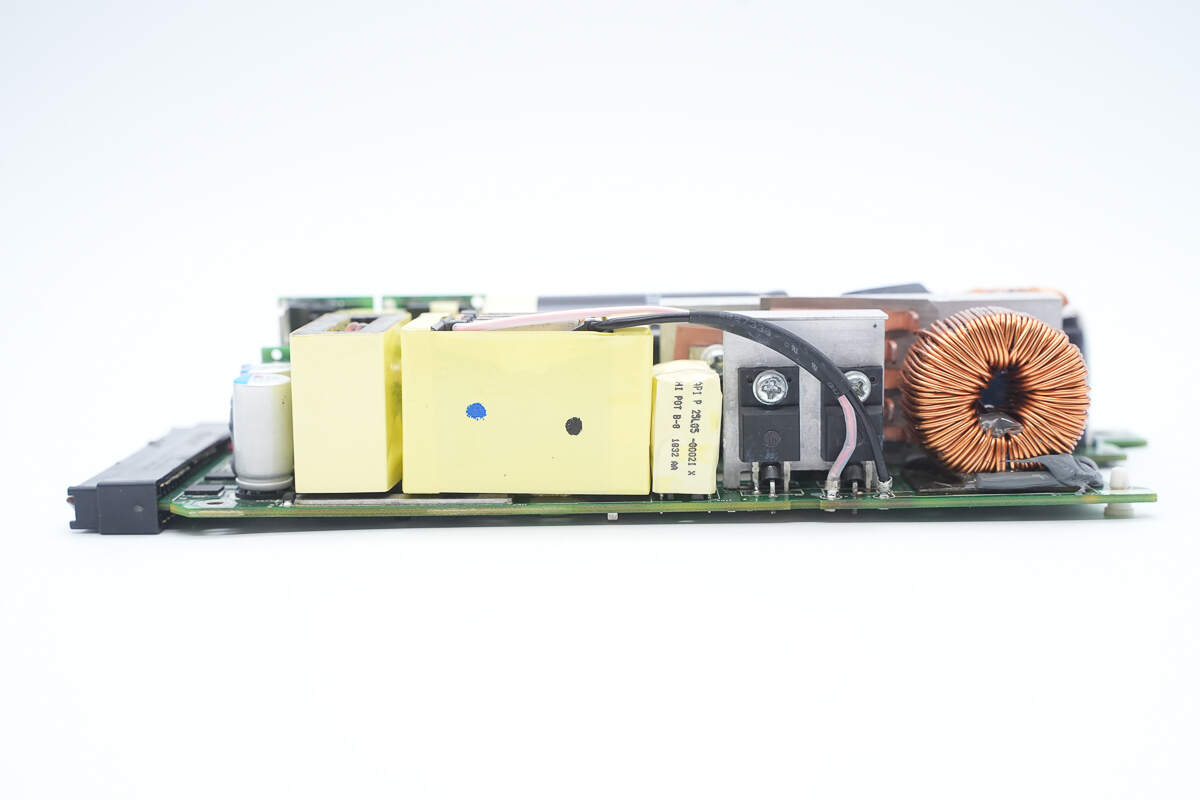

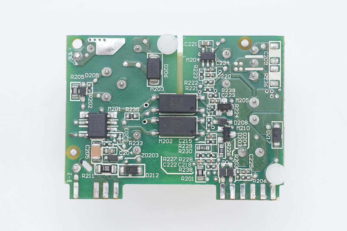

This side is equipped with filter capacitors, a filter inductor, a transformer, an isolation transformer, phase-shift full-bridge MOSFETs, and a PFC boost inductor.
The film capacitor is from Nitsuko, rated at 450V and 2.2 μF.

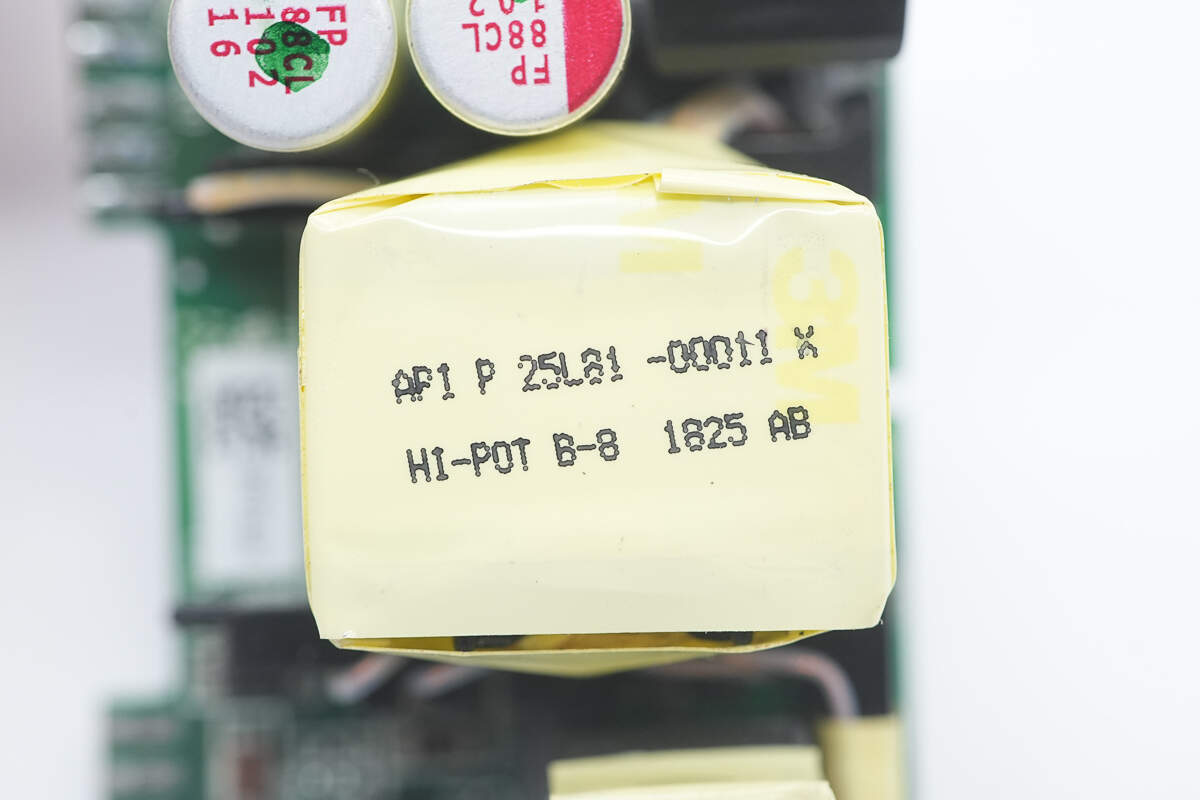

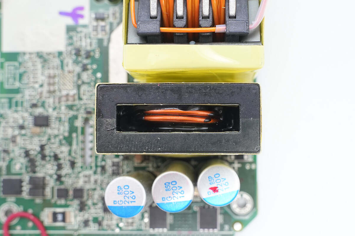

The PFC boost inductor is wound with the magnet and insulated wires.

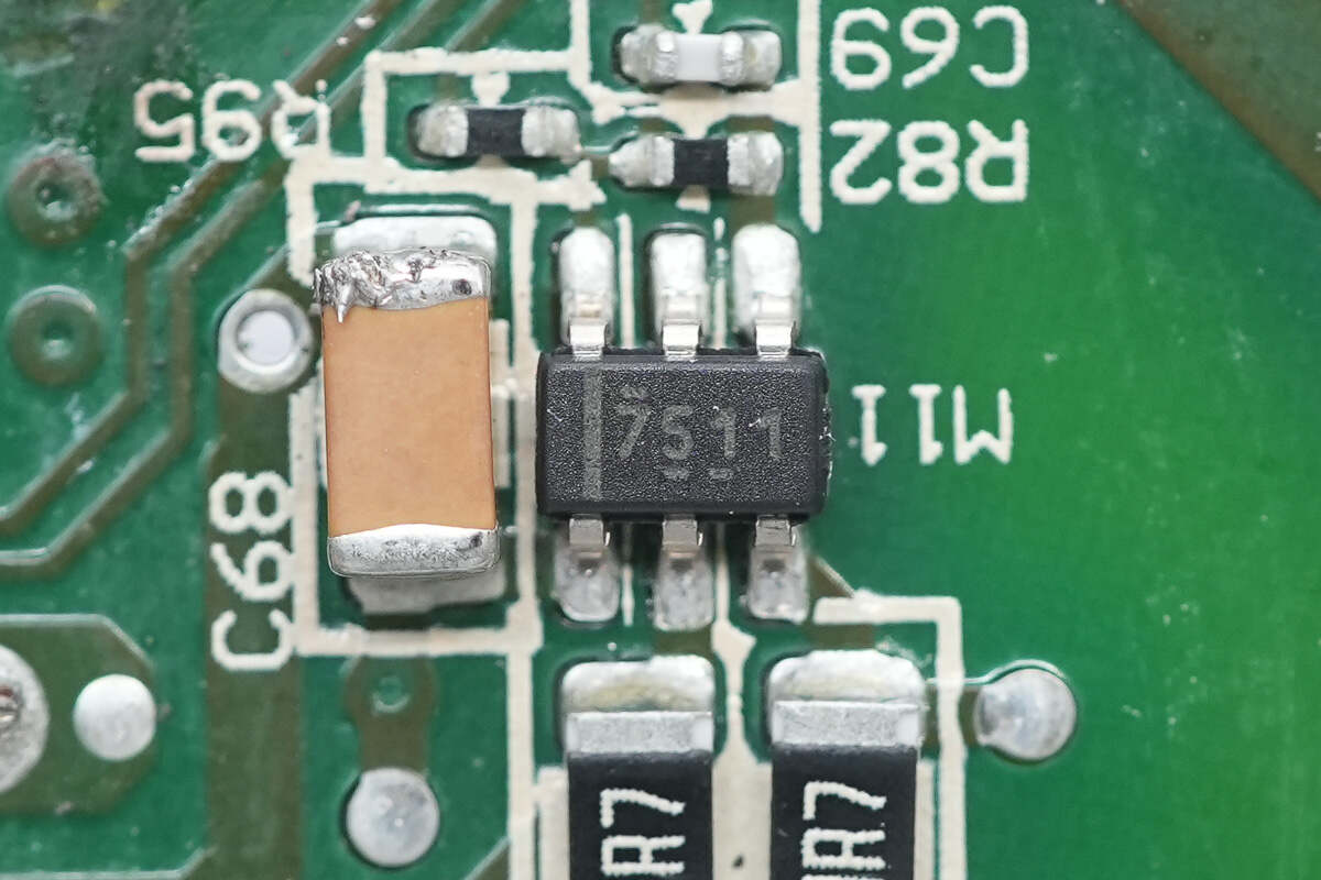

The driver used to drive the PFC MOSFET is the UCC27511 from TI, a single-channel high-speed driver featuring a 4A peak sourcing current and 8A peak sinking current. It is available in a SOT-23 package.

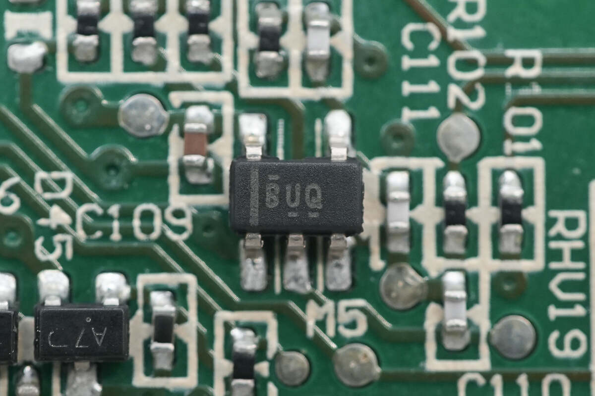

The Op-Amp, marked with BUQ, is the OPA376 from TI. It is a precision, low quiescent current op-amp with rail-to-rail input and output capability. It comes in a SOT-23 package.

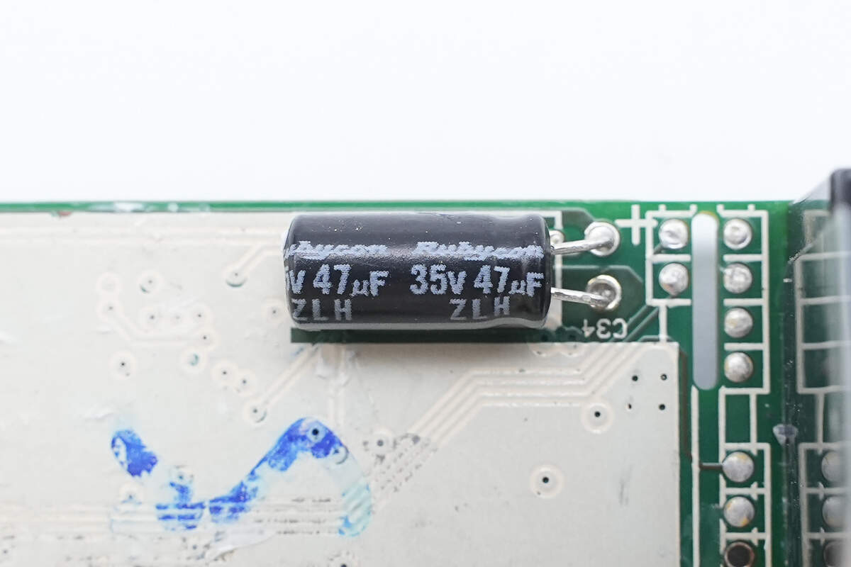

The filter capacitor is from Rubycon, with a specification of 35V 47μF.

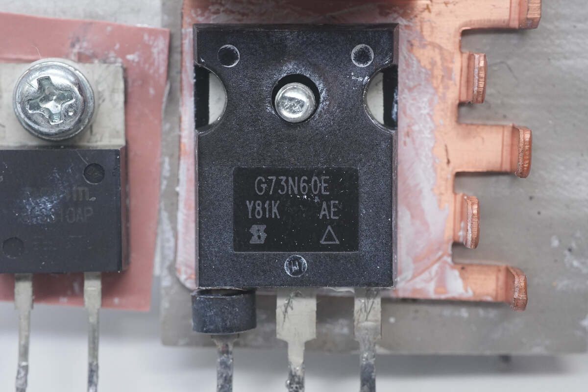

The PFC MOSFET is the SiHG73N60E from VISHAY, an N-channel MOSFET with a voltage rating of 650V and an on-resistance of 32mΩ. It is housed in a TO-247AC package.

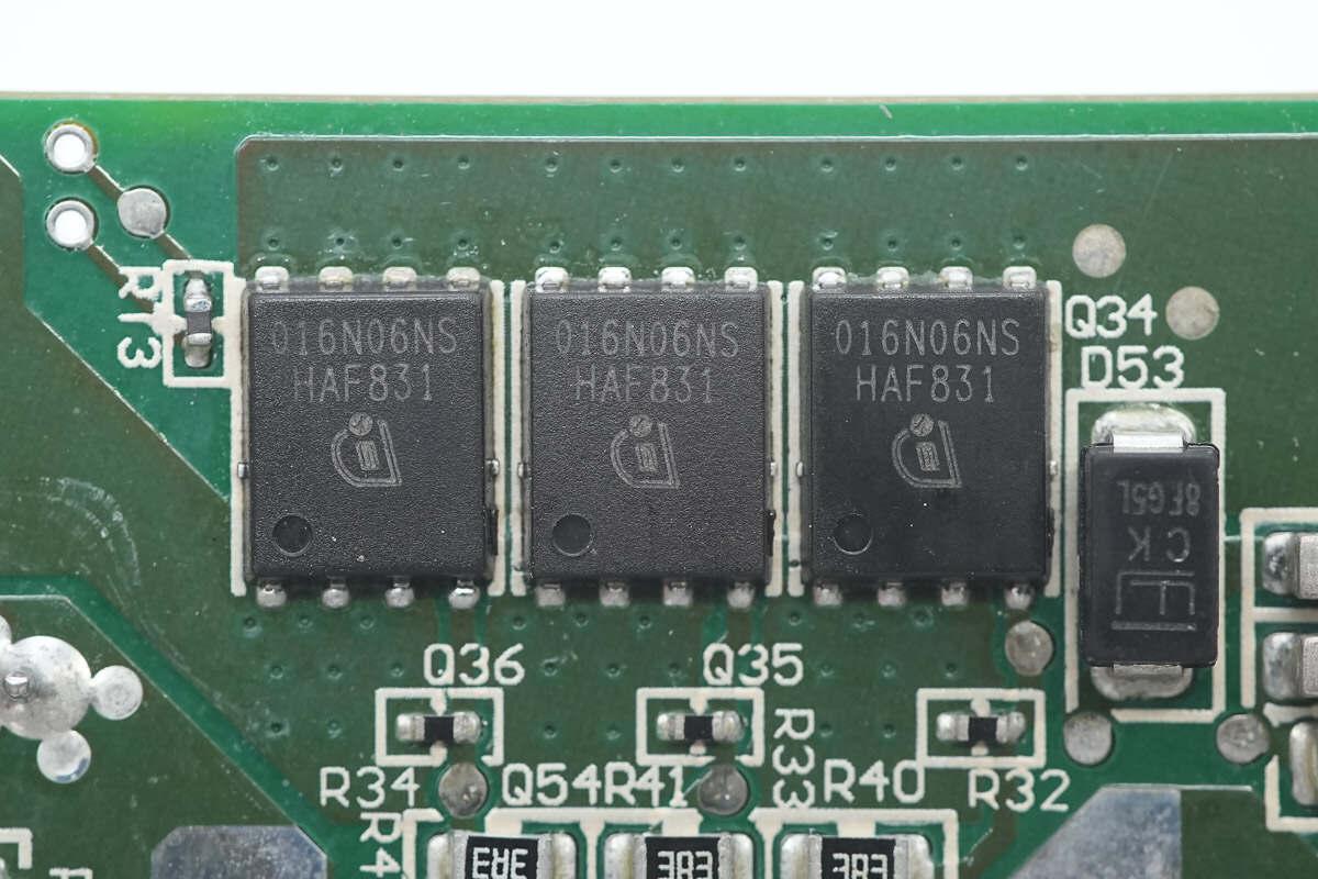

Three 25mΩ sense resistors are connected in parallel for measuring the current of the PFC MOSFET.

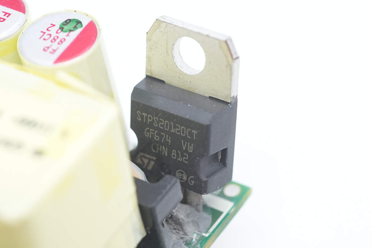

The PFC rectifier is the SCS310AP from ROHM, a SiC diode rated at 650V and 10A. It is packaged in a TO-220ACP case.

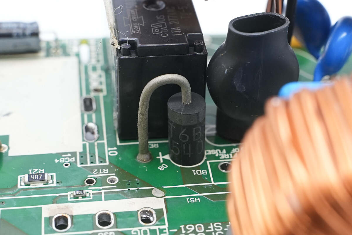

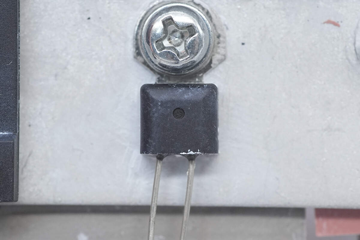

The thermistor is fixed to the heat sink with a screw.
Close-up of the PFC bypass diode.

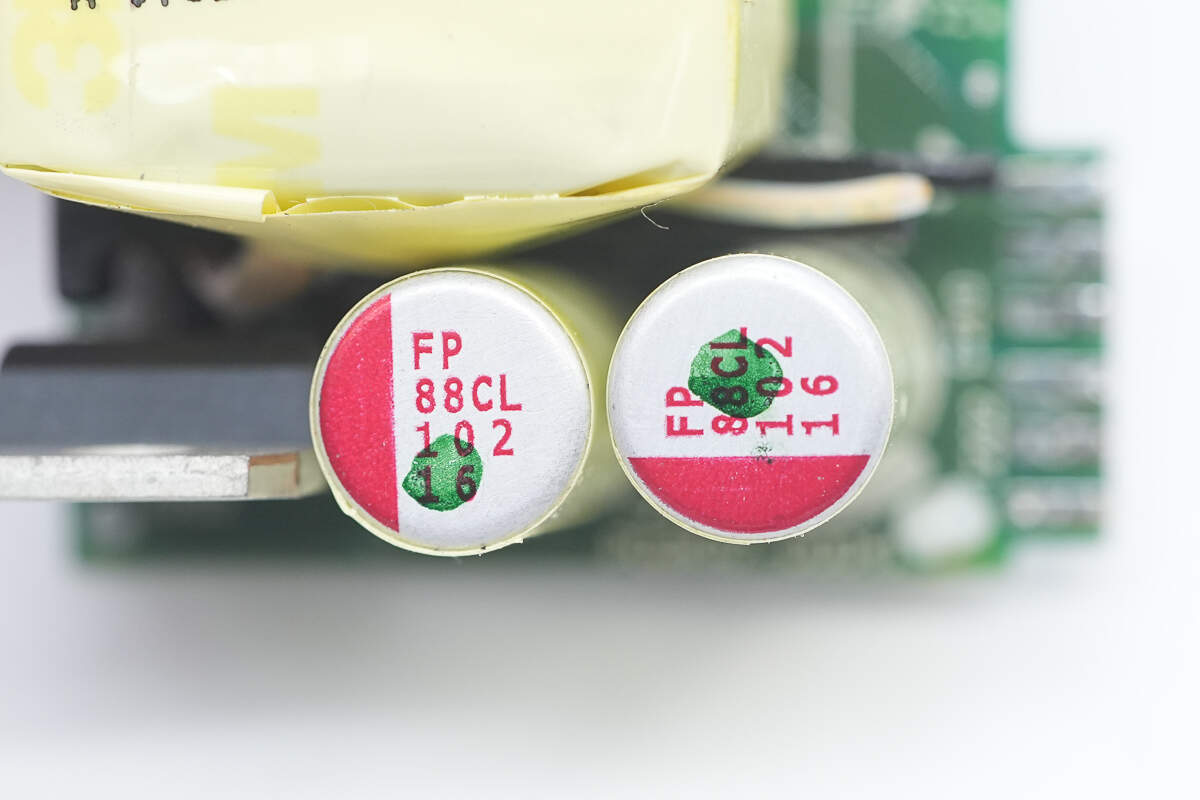

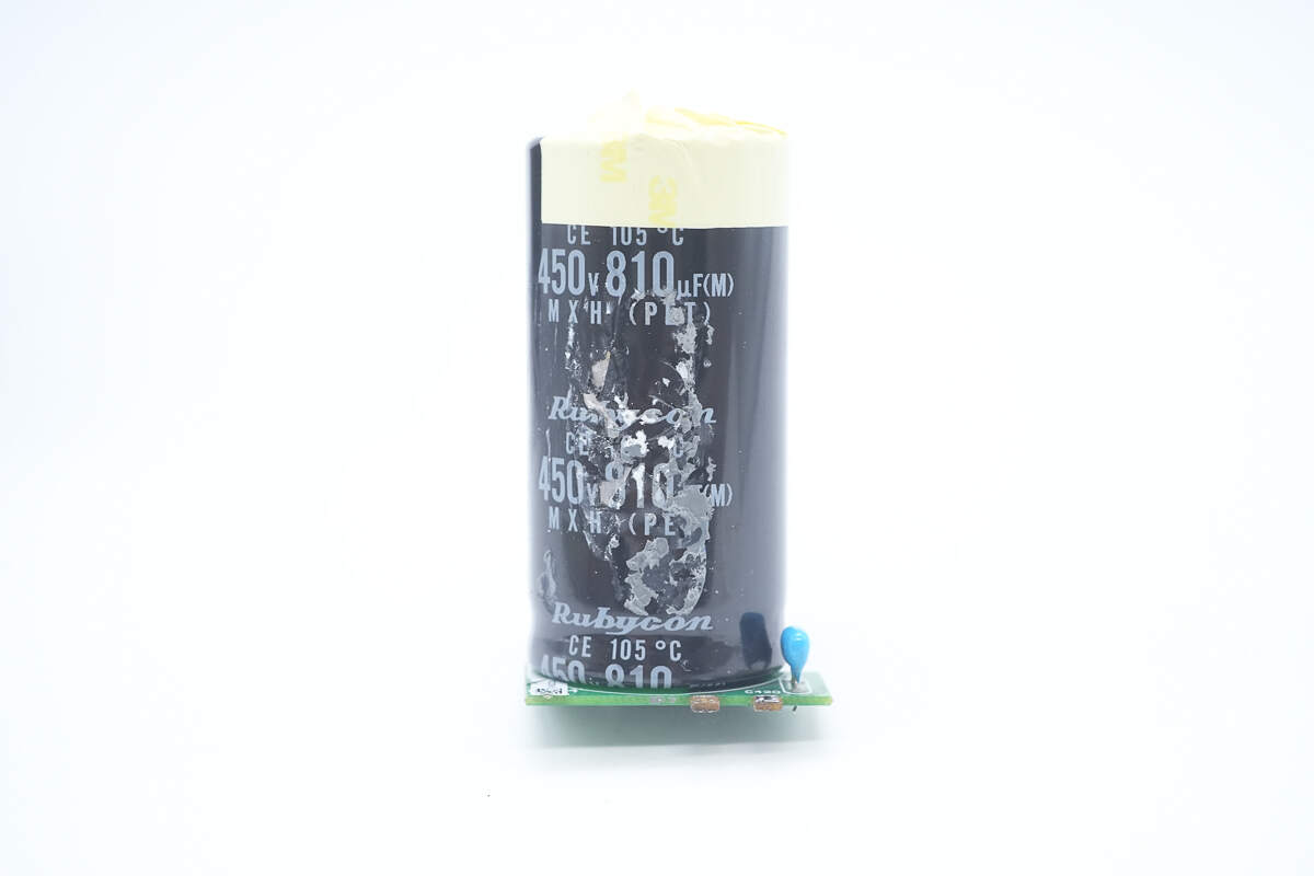

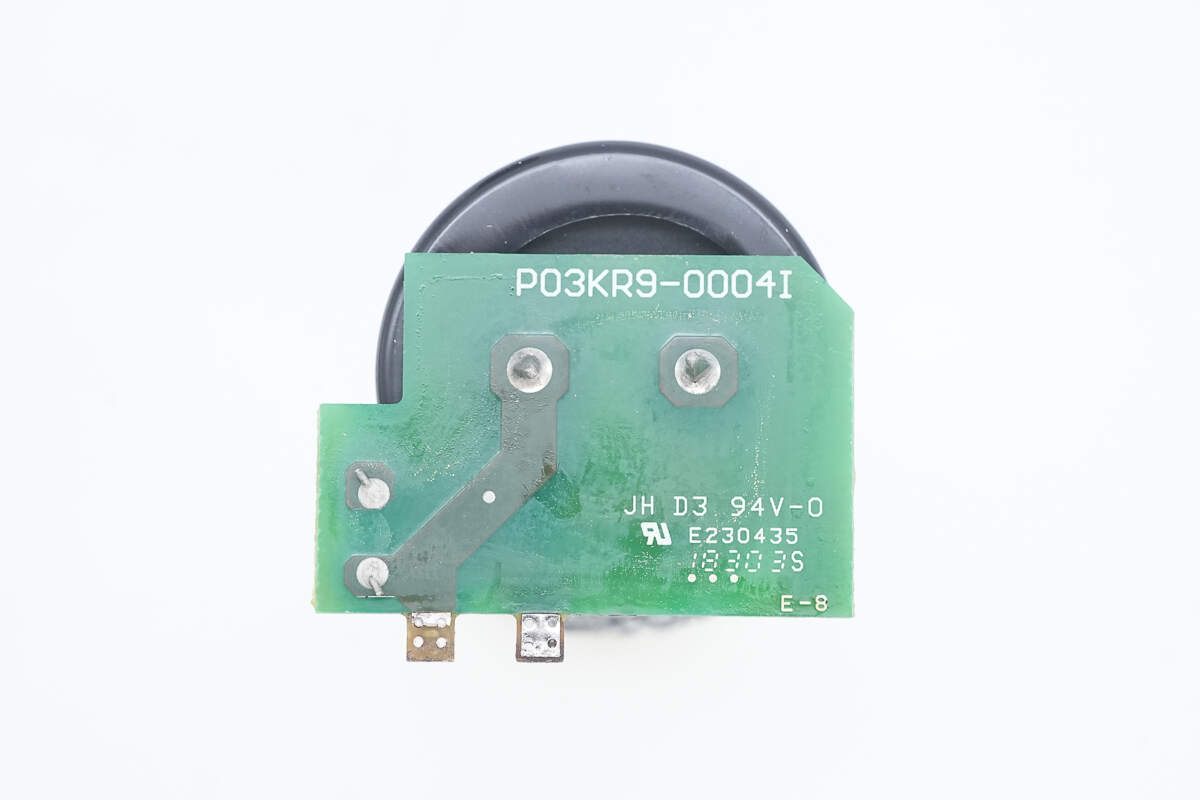

The high-voltage filter capacitor is from Rubycon, an MXH series electrolytic capacitor with a rating of 450V 810μF.

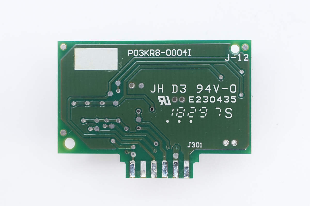

The capacitor is soldered onto a small PCB.
There is a 0.1μF ceramic capacitor on the small PCB.

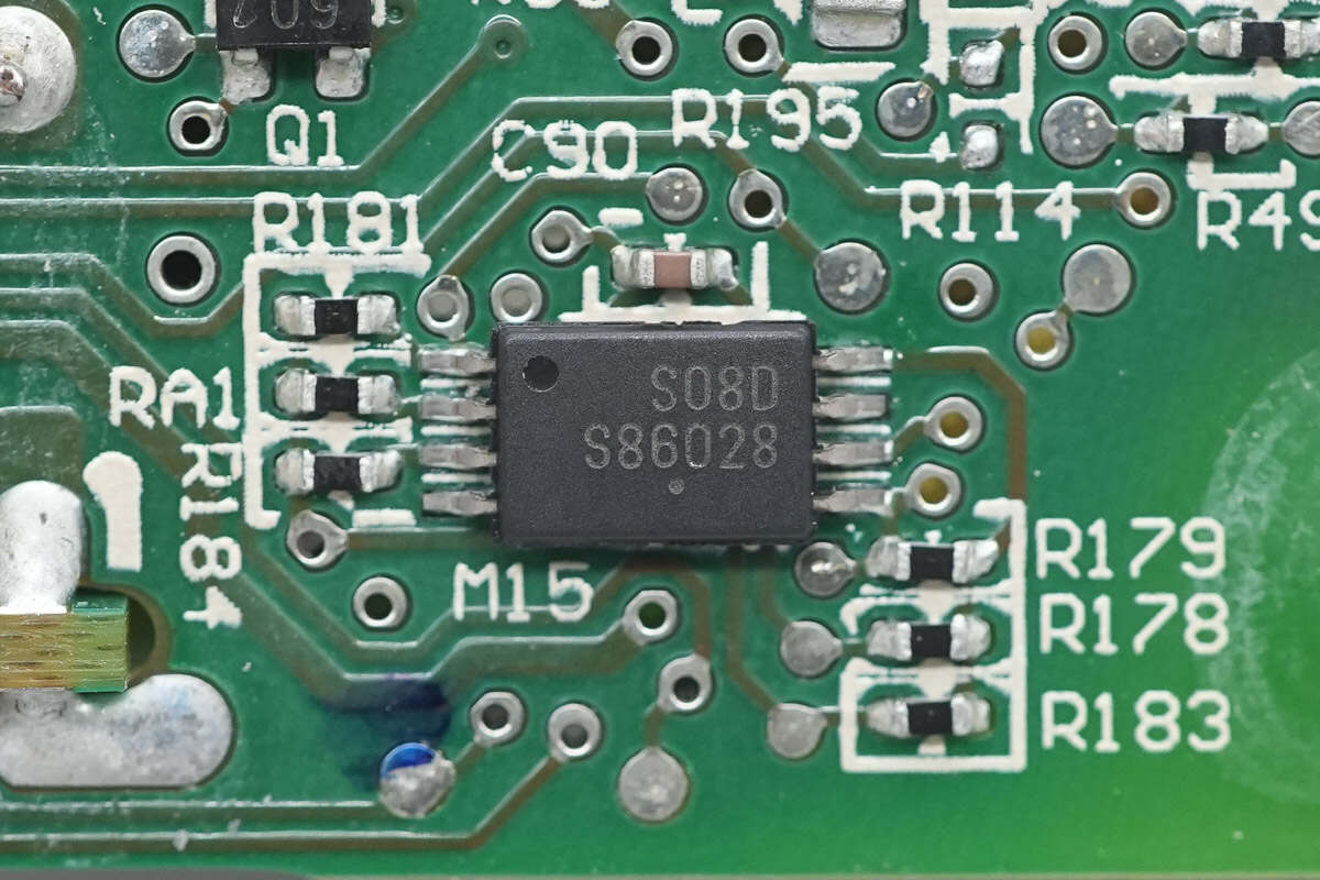

The memory is from Onsemi, marked with S08D, and comes in a TSSOP-8 package.

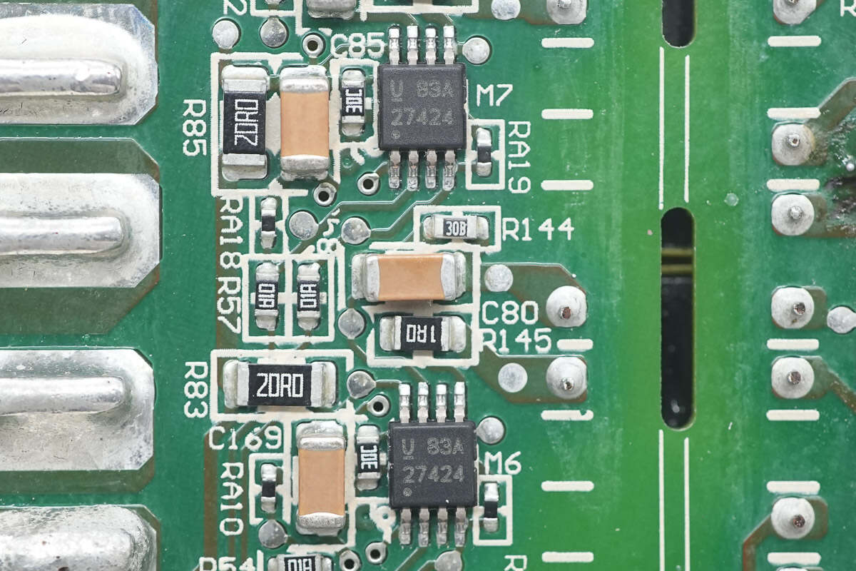

The driver for the isolation transformer is the UCC27424 from TI, a dual-channel gate driver with a 4A output current. It comes in a VSSOP8 package.

The fuse is rated at 6.3A 250V.

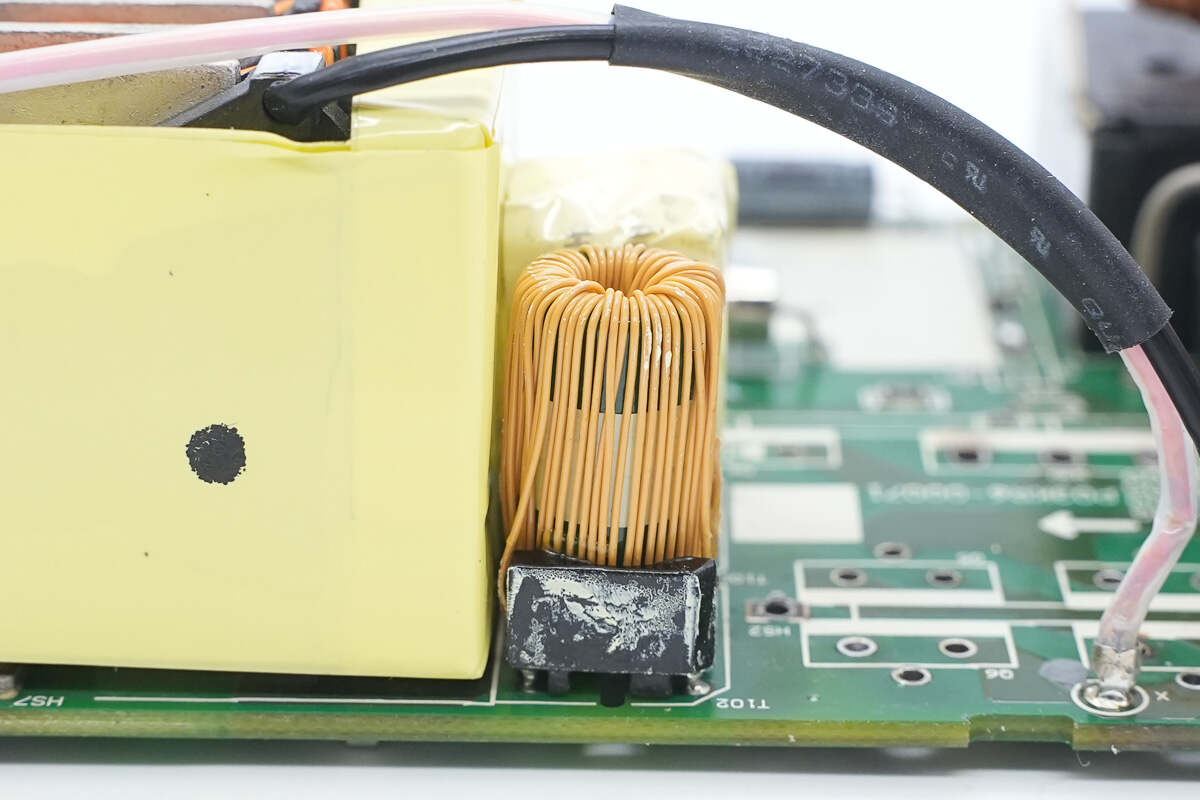

The current transformer is insulated with tape wrapping.
The transformer core is insulated with tape wrapping.

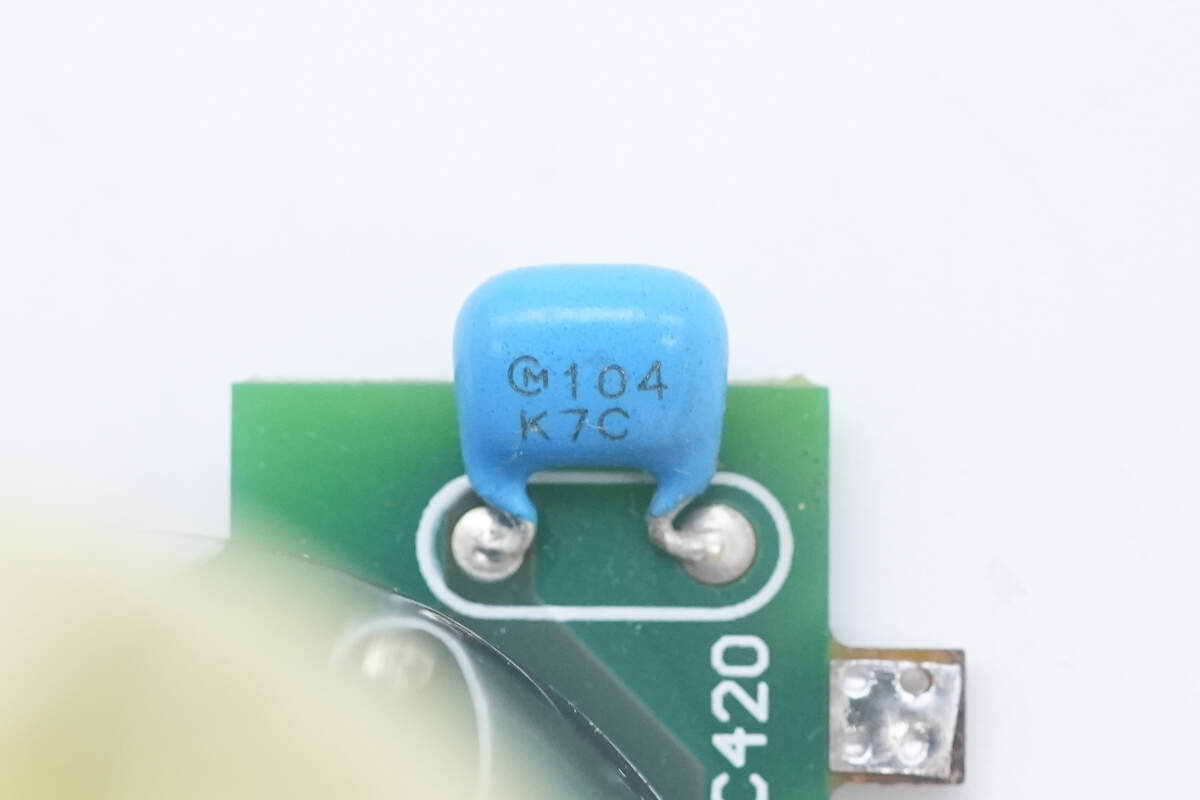

The blue Y capacitor is from Walsin.
The synchronous rectifiers are from Infineon, model BSC016N06NS. They are N-channel MOSFETs with a voltage rating of 60V and an on-resistance of 1.6mΩ, packaged in a TDSON-8 case.
The three synchronous rectifiers are of the same model.

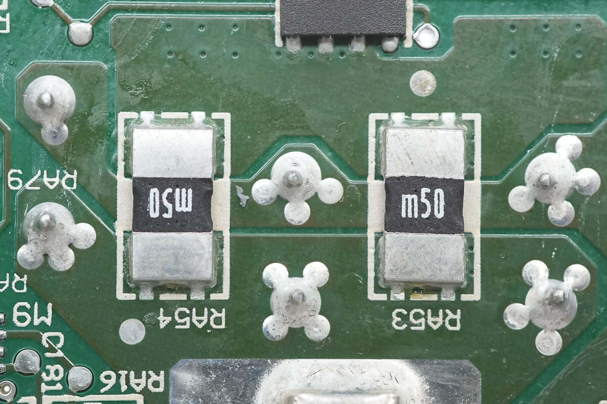

Two 0.5mΩ resistors are used for output current sensing.

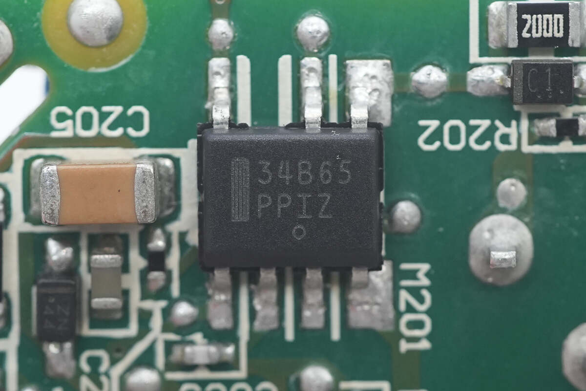

The switching power supply chip is the NCP1234BD65 from Onsemi, marked with 34B65. It is a current-mode flyback controller with a fixed switching frequency of 65kHz, packaged in an SOIC-7 case.

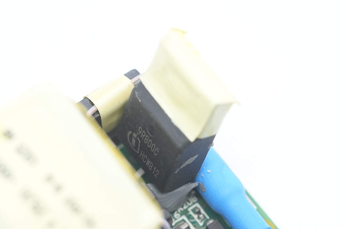

The auxiliary power MOSFET is the IPA90R800C3 from Infineon, marked with 9R800C. It is an N-channel MOSFET with a voltage rating of 900V and an on-resistance of 800mΩ, packaged in a TO-220 FP case.
The transformer is tightly insulated with tape wrapping.

The rectifier is from STMicro, model STPS20120CT, rated at 120V 20A, and packaged in a TO-220AB case.

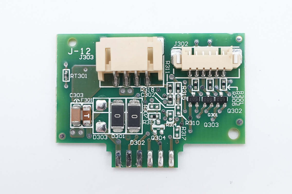

The connecting PCB includes connectors for the fan and indicator lights. The fan power supply is protected by a fuse.
