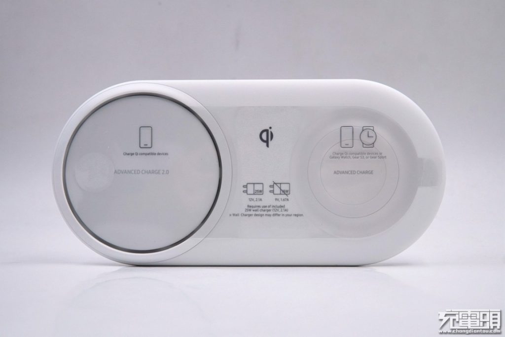

There is a sticker on top with printed instructions: the left side can be used for phones, while the right side can be used for phones or Samsung watches.
Samsung Wireless Charger Duo Pad (EP-P5200) Teardown Review-Chargerlab
Pilling off the sticker reveals a clean minimalist design.

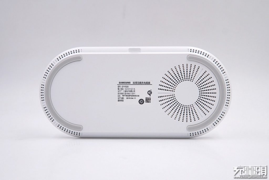

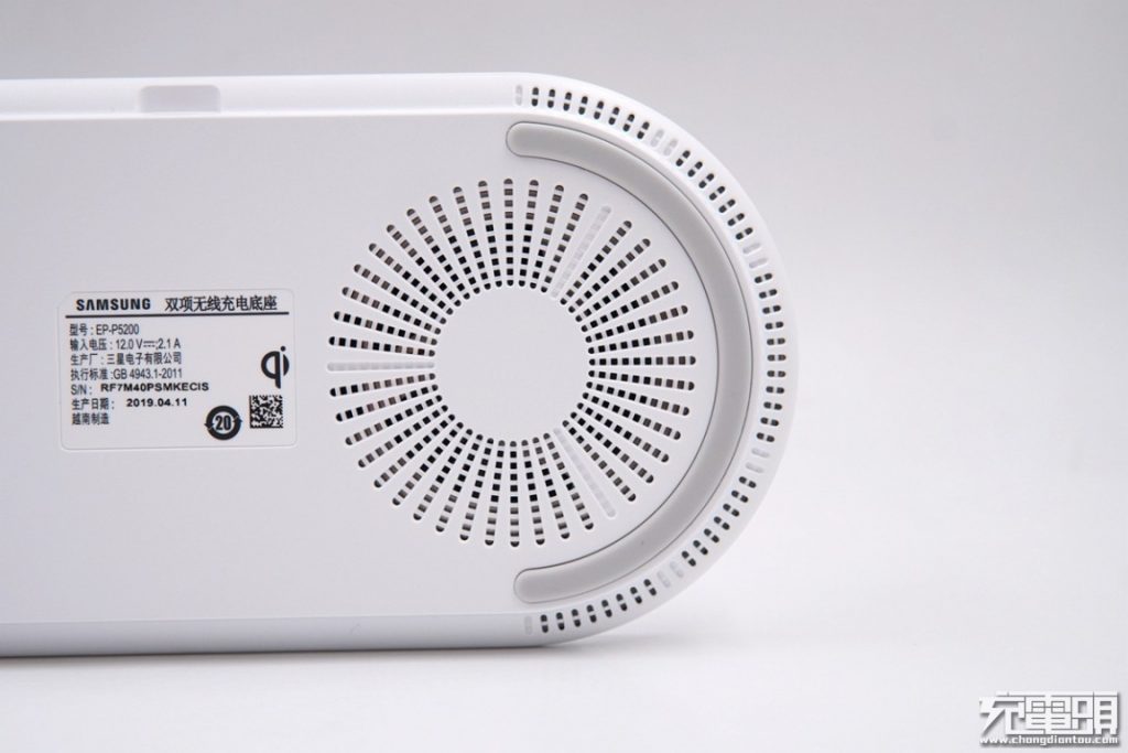

Ventilation holes on the sides and bottom.
Close-up of the ventilation holes.
Specifications on the bottom.

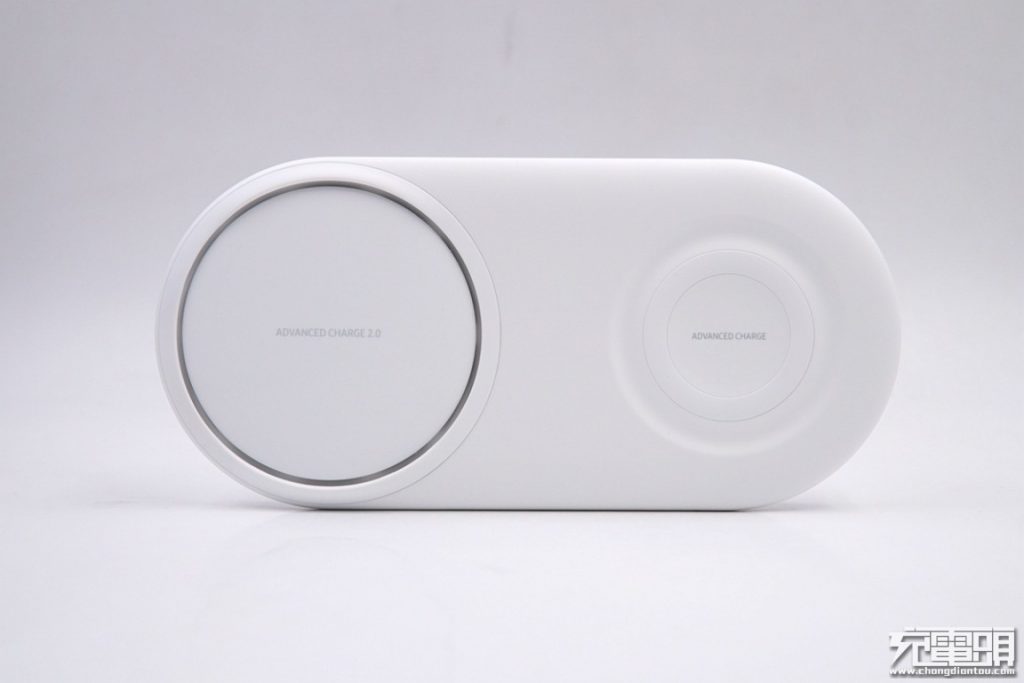

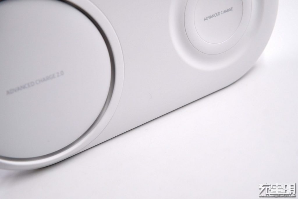

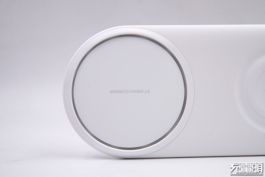

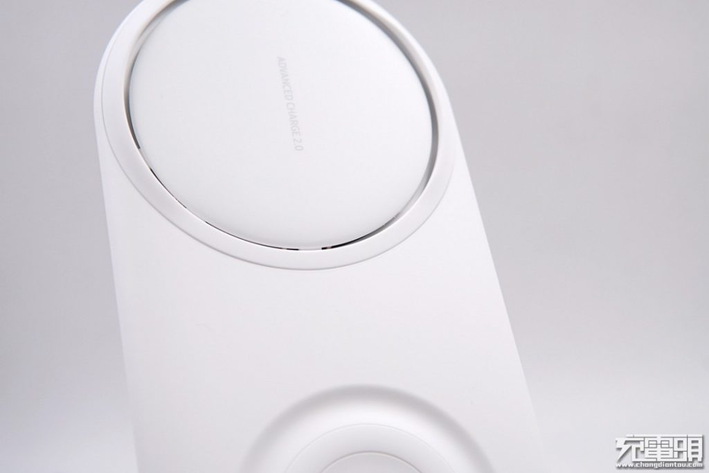

ADVANCED CHARGE 2.0 area on the left.

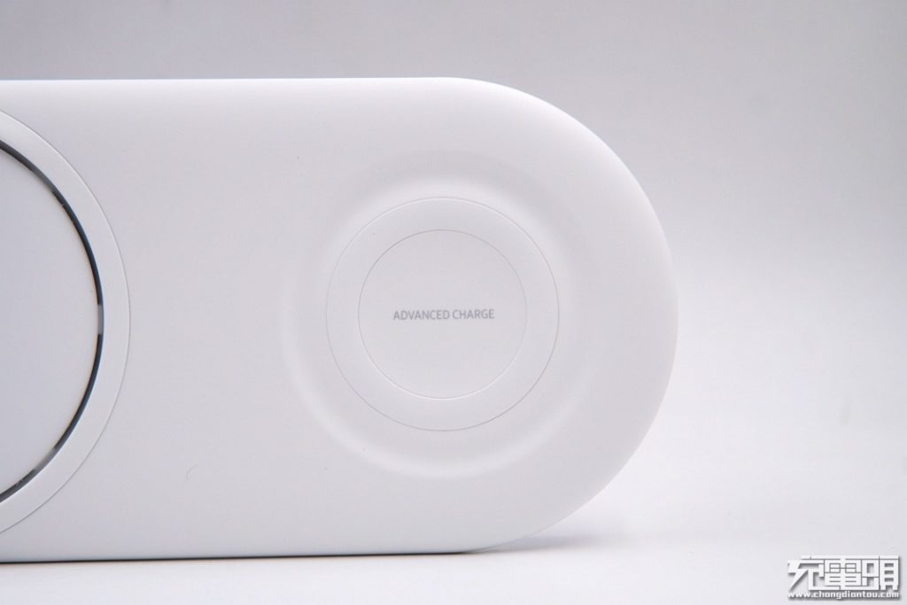

ADVANCED CHARGE area on the right.

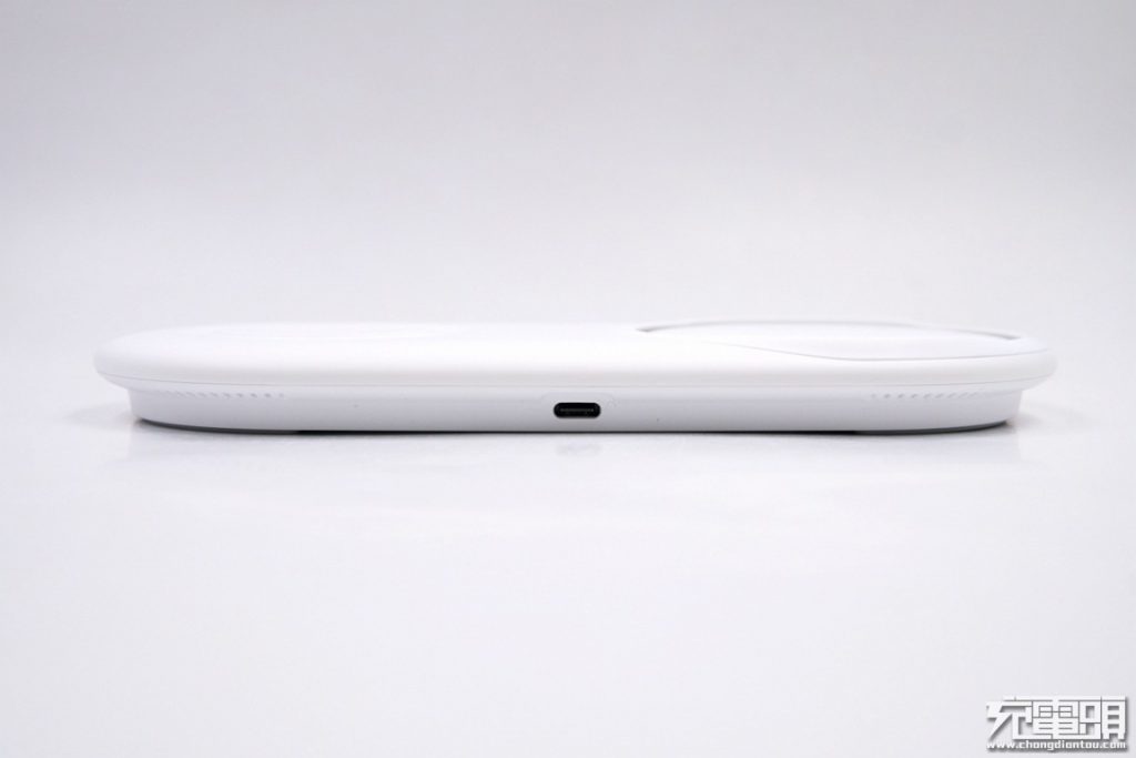

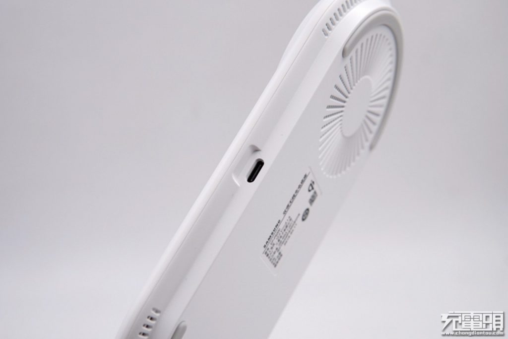

USB-C port in the center.

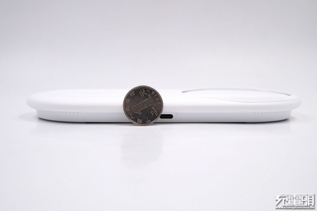

A thickness of 18.05mm (0.71in).
Close-up of USB-C port.

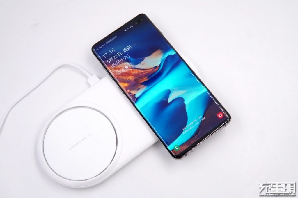

It starts charging instantly when we put the phone on top. Our Samsung Galaxy S10+ shows it gets fast charging when it is on the left of the pad.
Our Samsung Galaxy S10+ shows it gets fast charging when it is on the right of the pad.

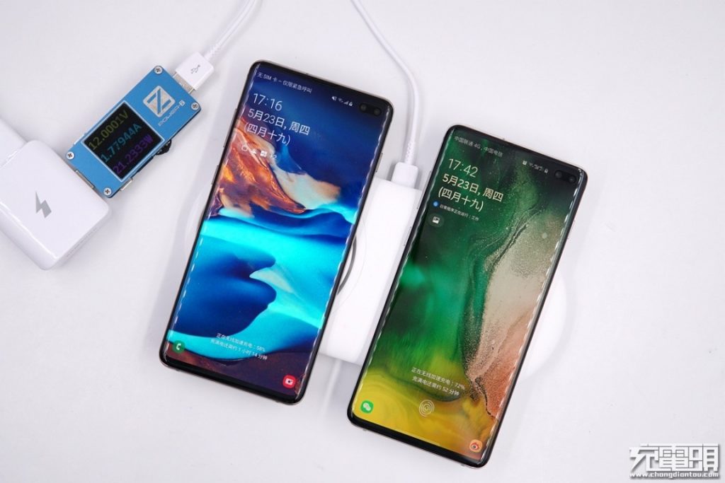

Using ChargerLAB POWER-Z FL001Super tester, we read a power output of 21.23W (12.00V/1.78A). Both the two Samsung Galaxy S10+ are getting fast wireless charging.

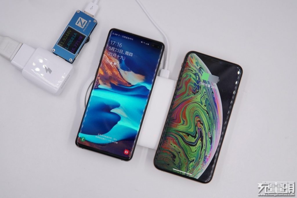

Charging the Samsung Galaxy S10+ and iPhone Xs Max at the same time, our ChargerLAB POWER-Z FL001Super tester reads a power output of 16.78W (11.92V/1.41A). The Samsung Galaxy S10+ is getting fast wireless charging while the iPhone Xs Max is getting 5W normal wireless charging.

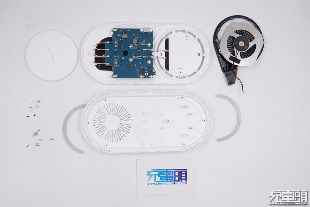

Removing the rubber pads on the bottom reveals several screws.

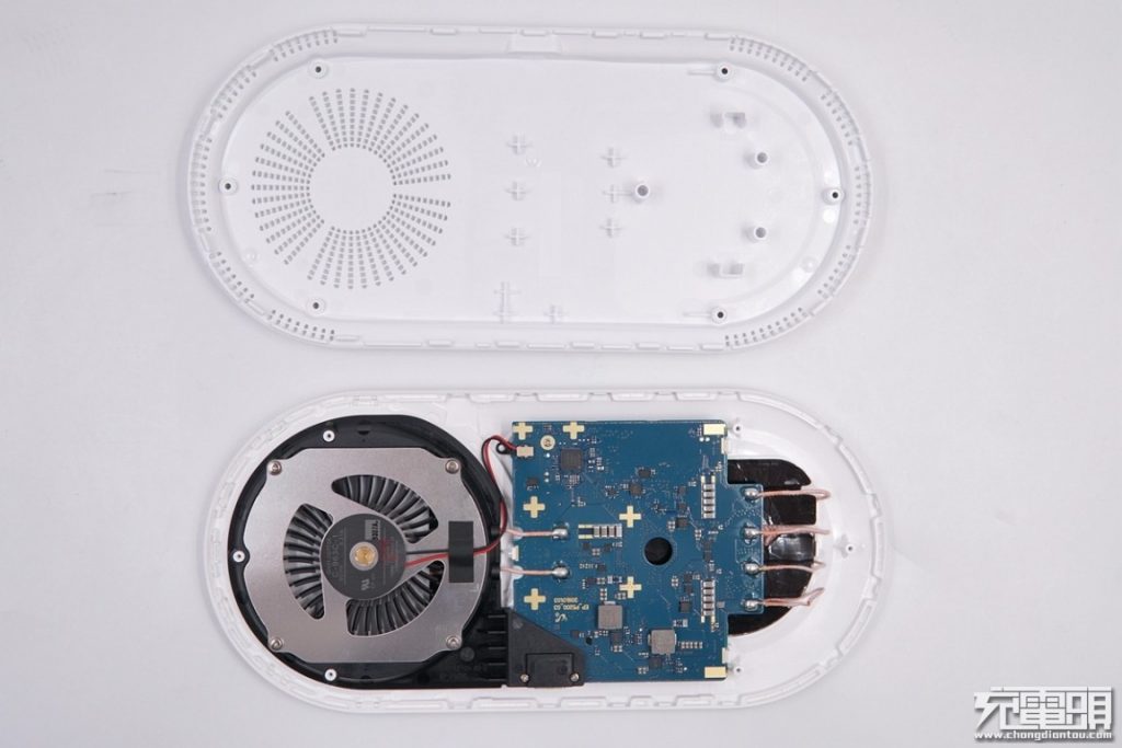

Unscrew and open the shell.

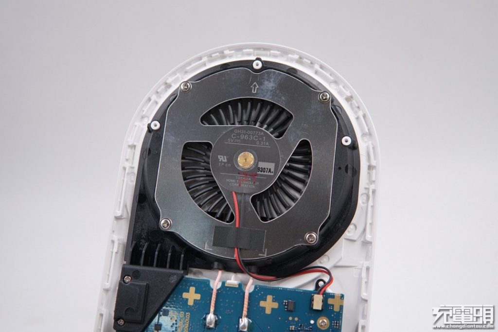

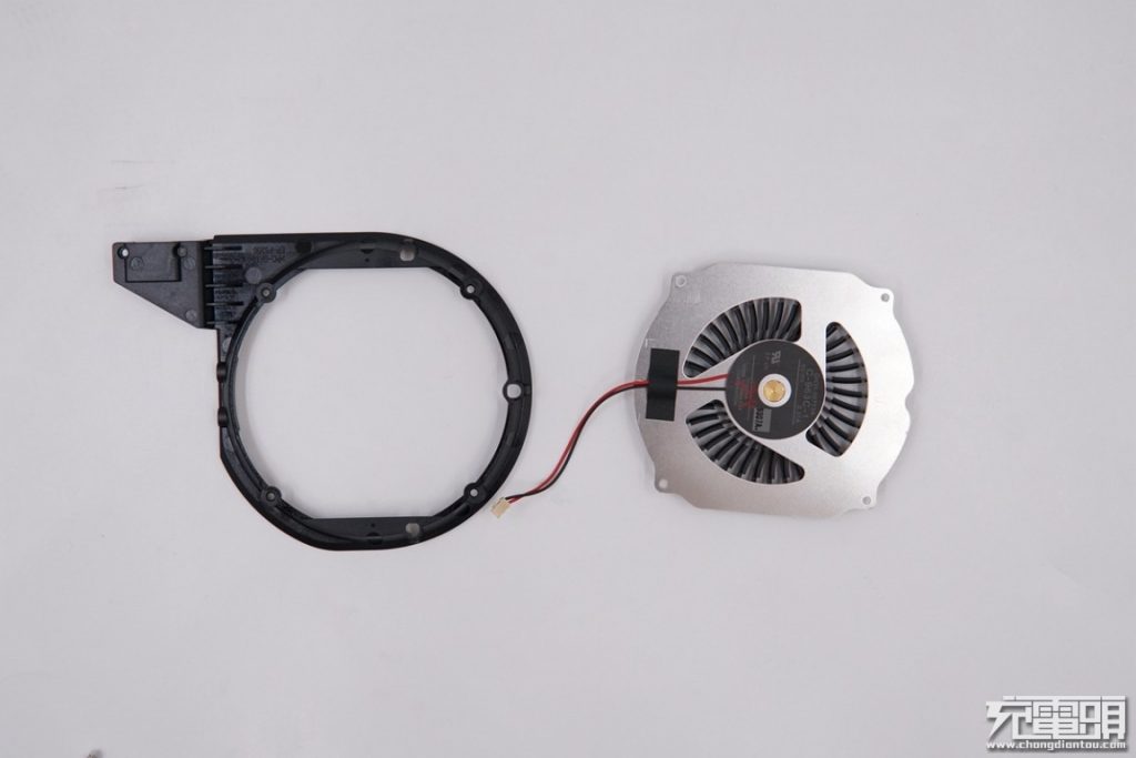

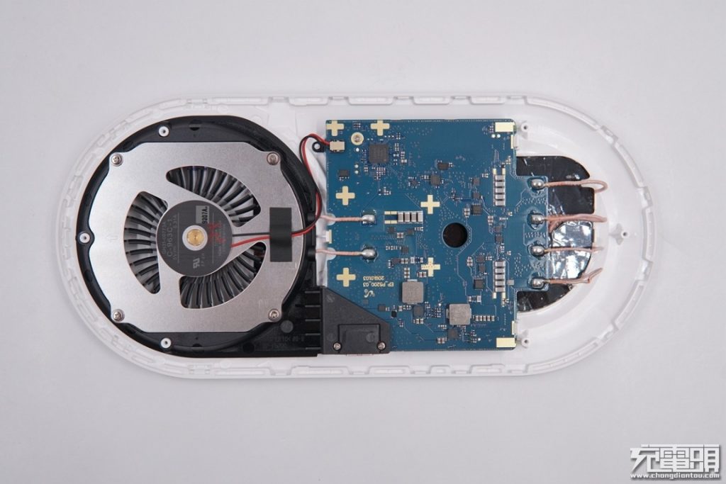

A fan occupies almost half of the internal.
A Toshiba 5V 0.31A centrifugal fan.

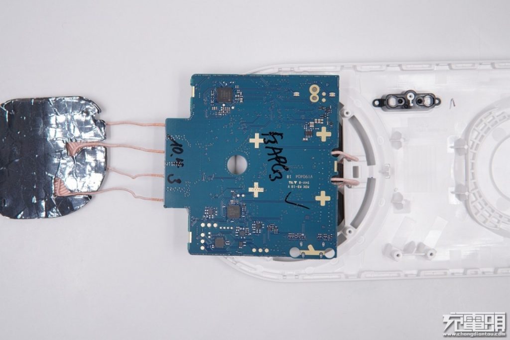

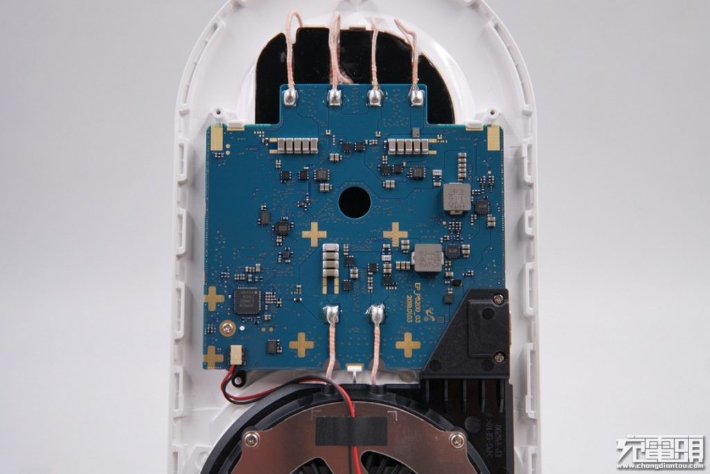

There are 3 sets of coil outputs on the PCB.
The input goes through two independent step-down circuits for wireless charging.

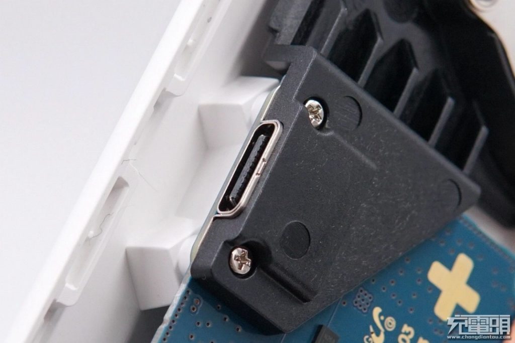

The Type-C port is screwed to the housing.
The fan is similar to the ones used in laptops.

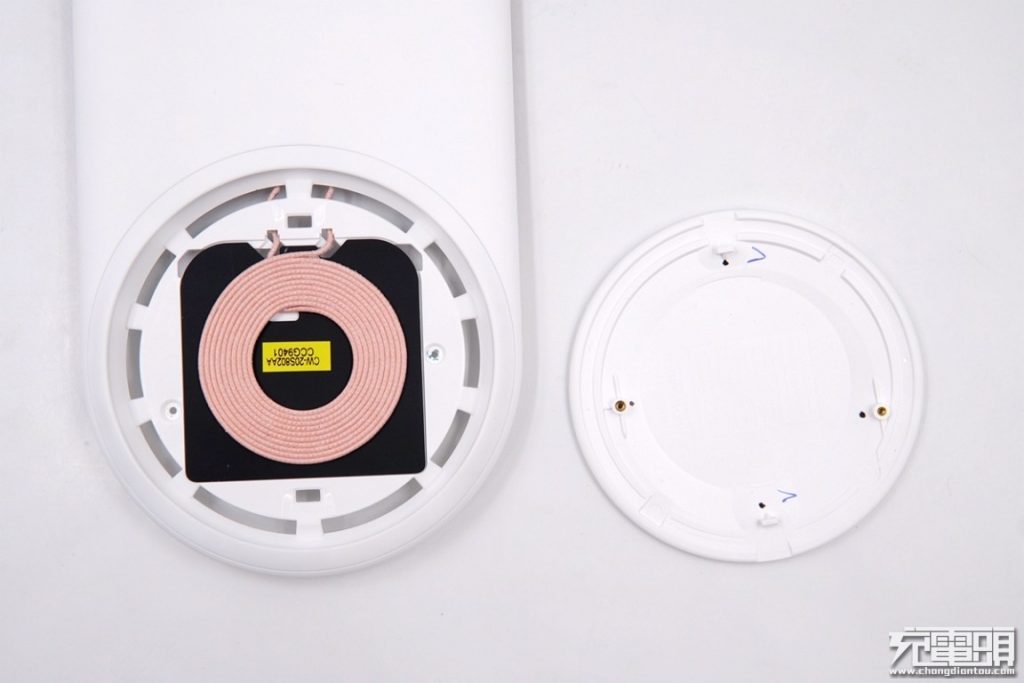

Vents around the wireless charging coil.

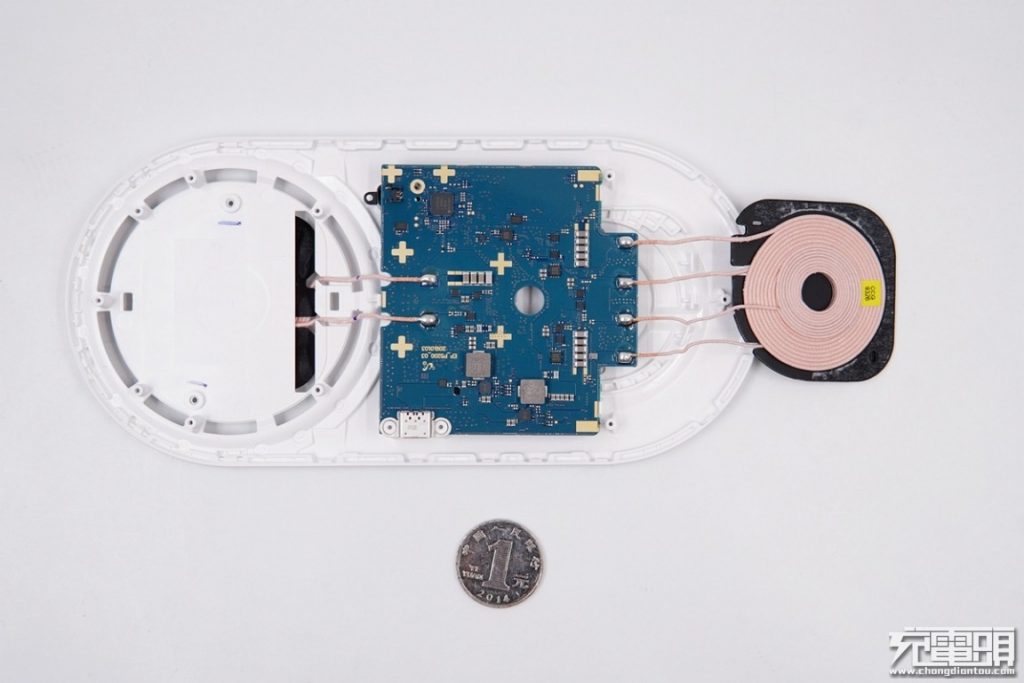

The two coils are stacked up to offer better compatibility for different devices.
An MCU controller and a wireless charging controller on the back.
A wireless charging controller with two buck and drive circuits.
Size comparison to a 1 Yuan RMB coin.

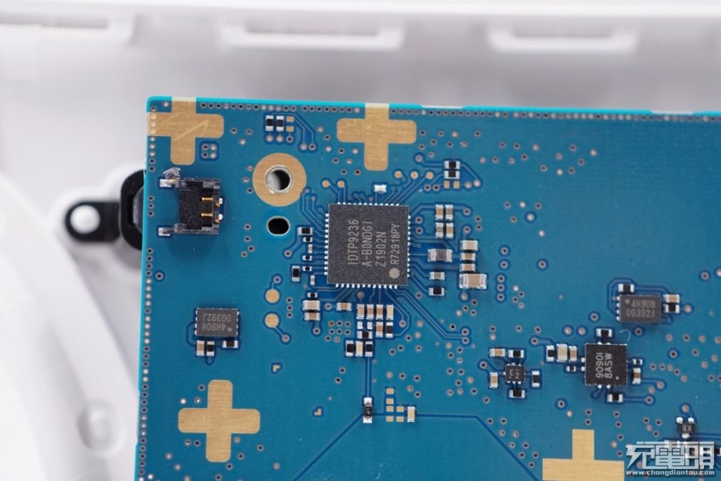

IDT IDTP9236 wireless charging master control chip on the back of the board.

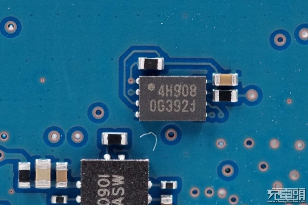

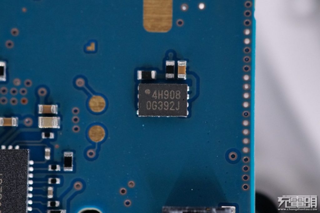

Another memory chip for IDTP9236.
An IC chip, function unknown.

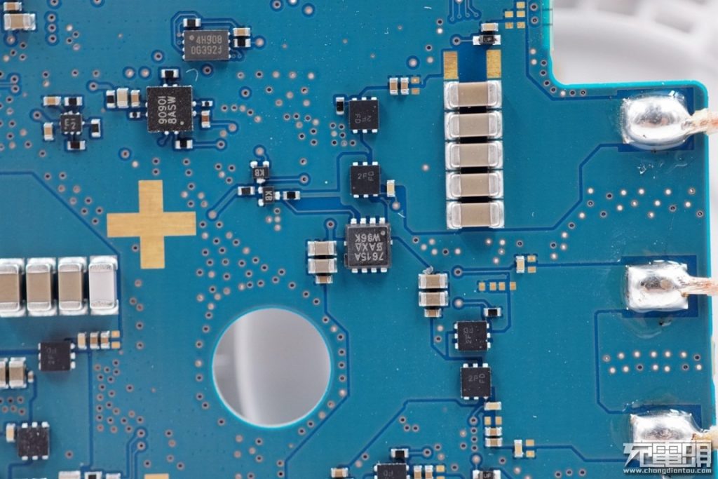

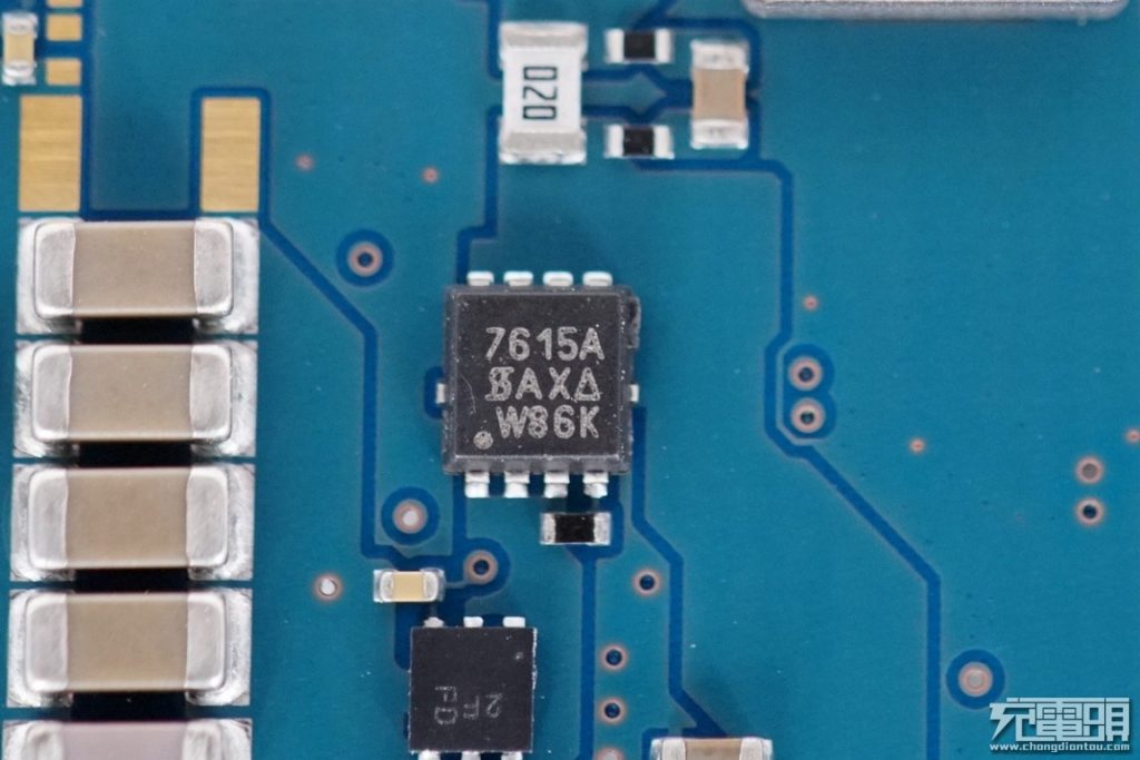

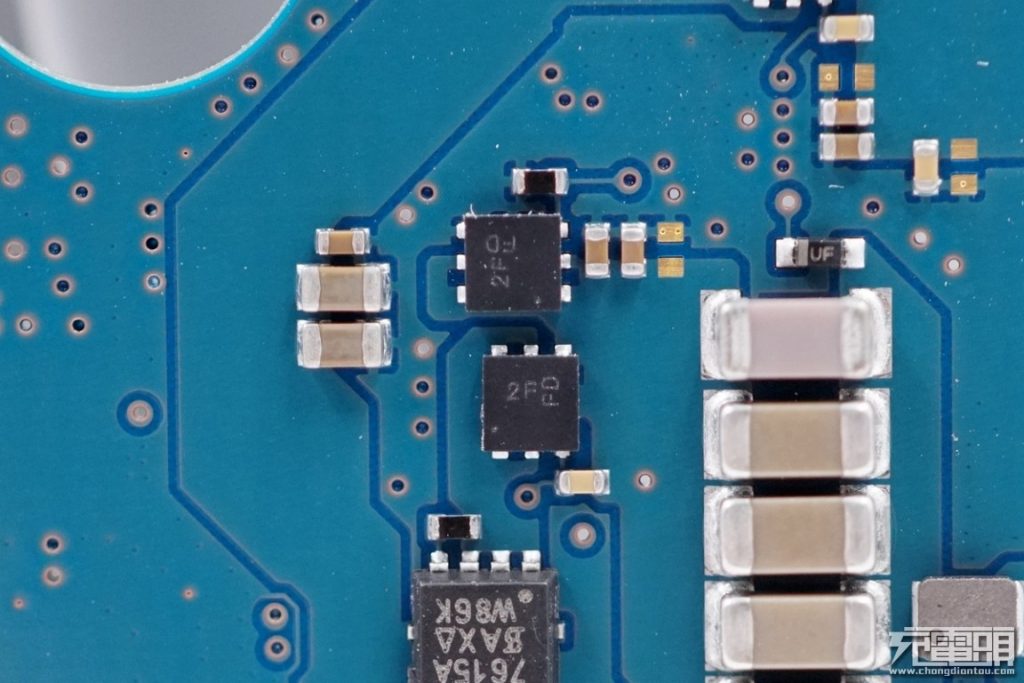

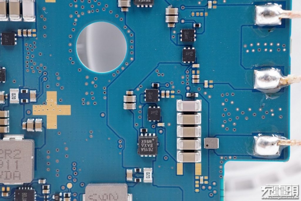

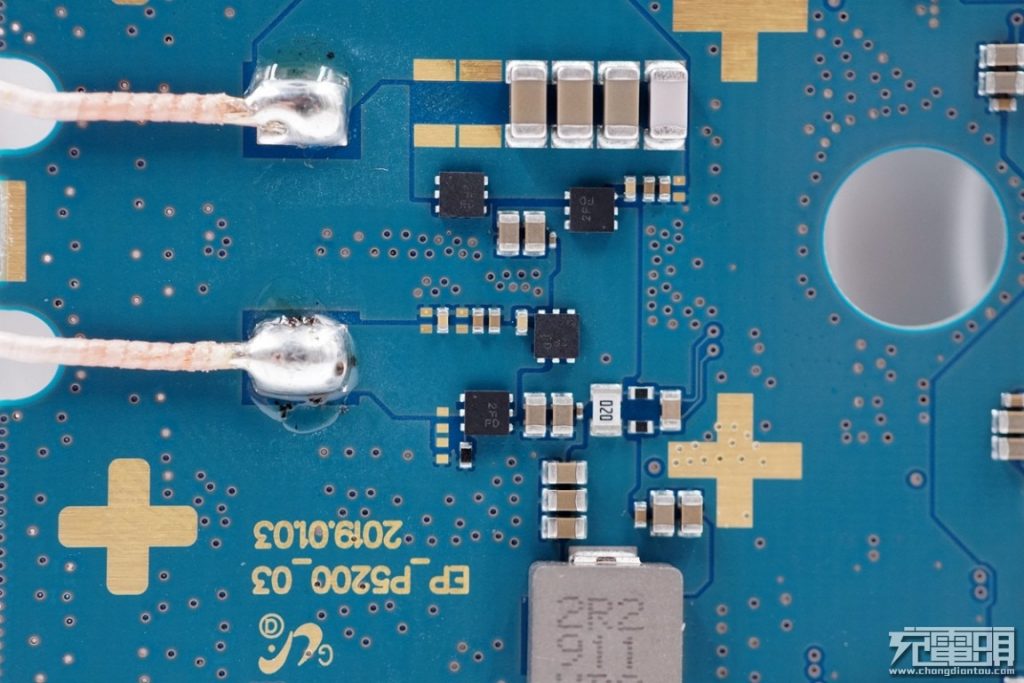

Wireless charging drive circuit, four tubes form the H-bridge driver, and the SI7615A is used for power switching.
Another set of coil drive tubes.
DFN2x2 tubes.
SI7615A for switching the power supply of coils.

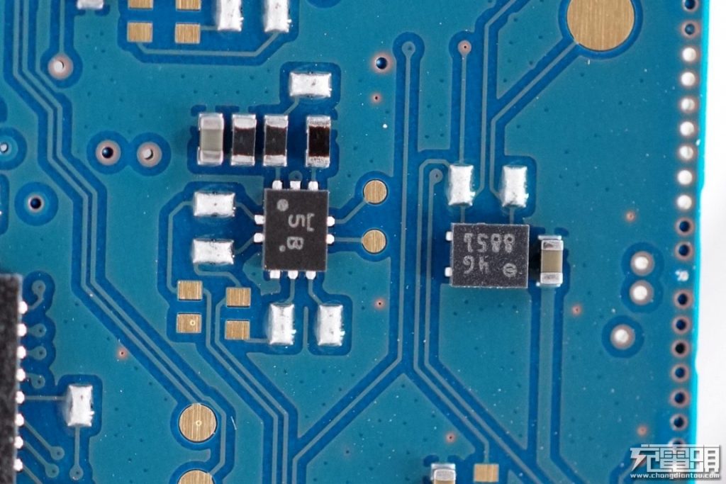

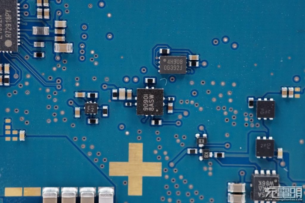

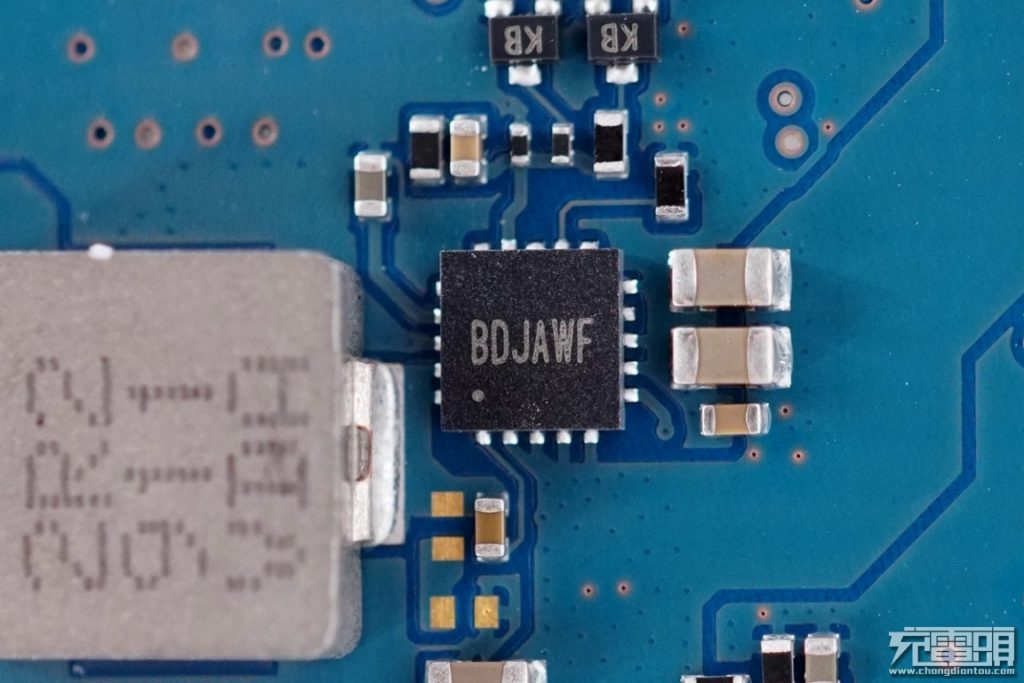

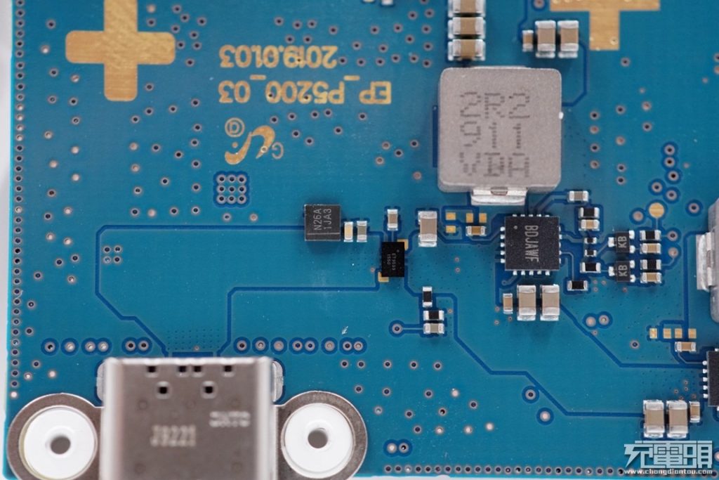

Silergy synchronous rectification step-down IC, two independent ways.
BDJAWF lettering.

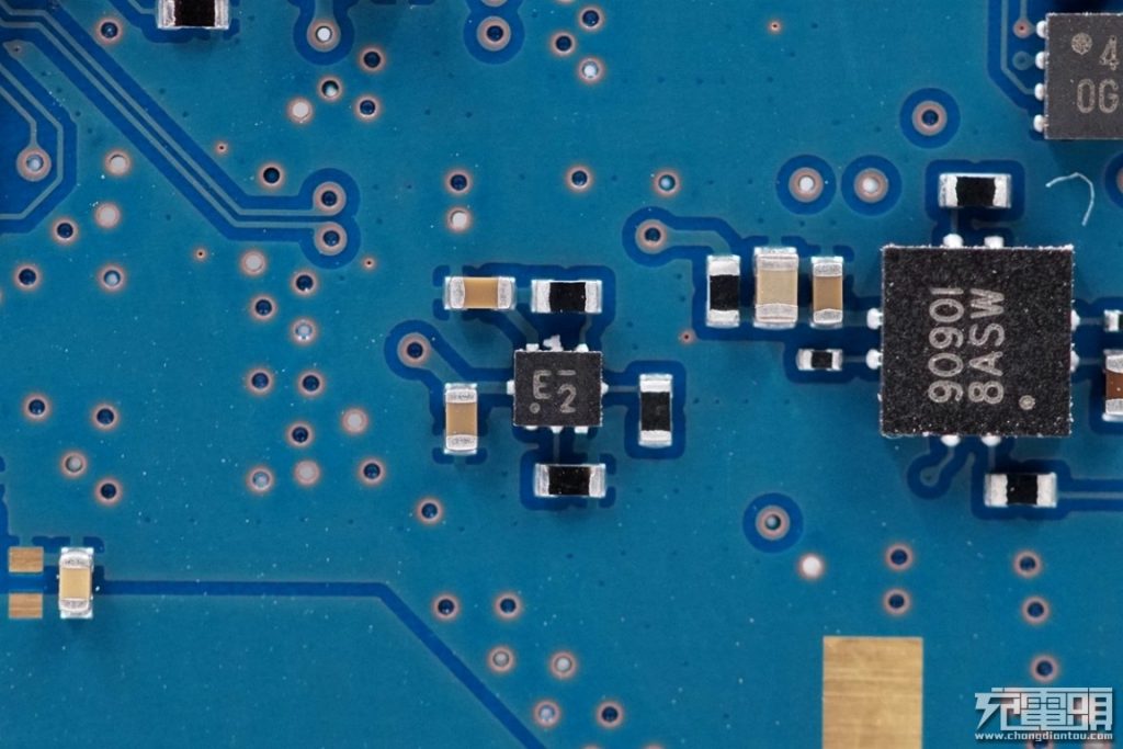

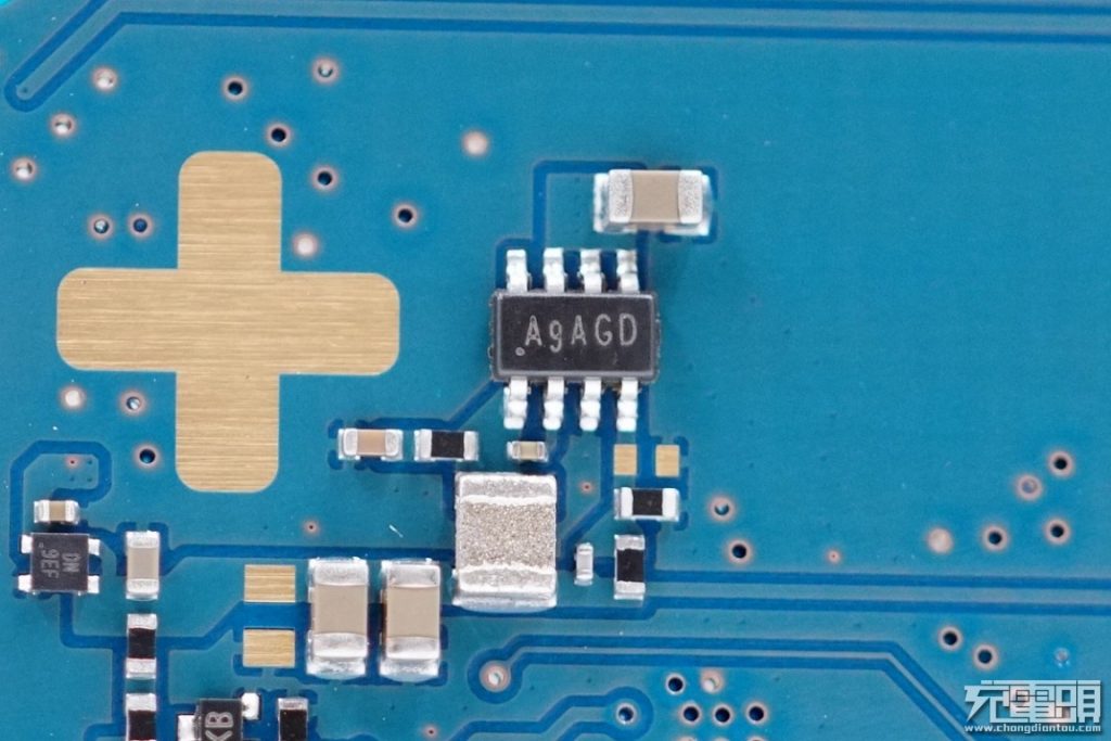

Input TVS components and overvoltage protection tube.
ETEK ET9539 provides overvoltage shutdown and overcurrent protection as input protection.

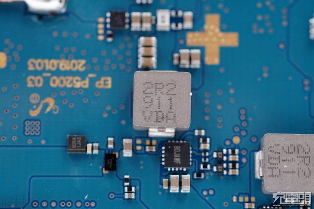

2R2 step-down inductor.
The buck output goes directly to the wireless charging power stage through a 20mΩ resistor.

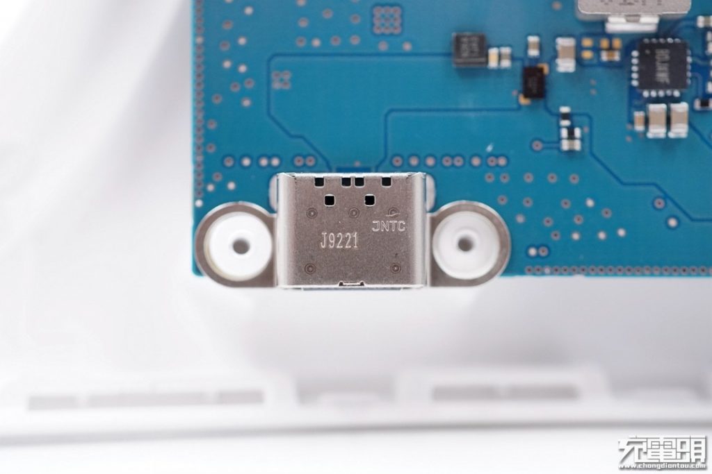

Type-C port from JNTC.

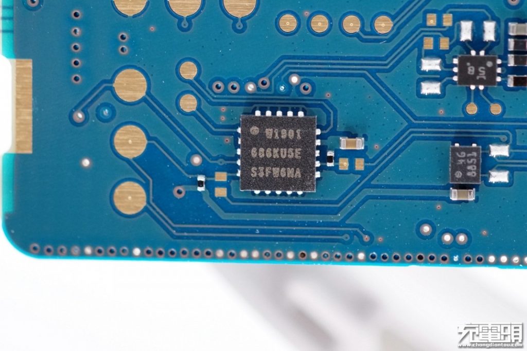

Step-down IC from MPS powers the wireless charging chip.

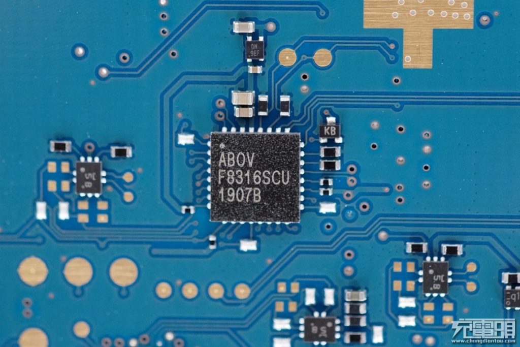

ABOV MCU for wireless charging protection and other functions.

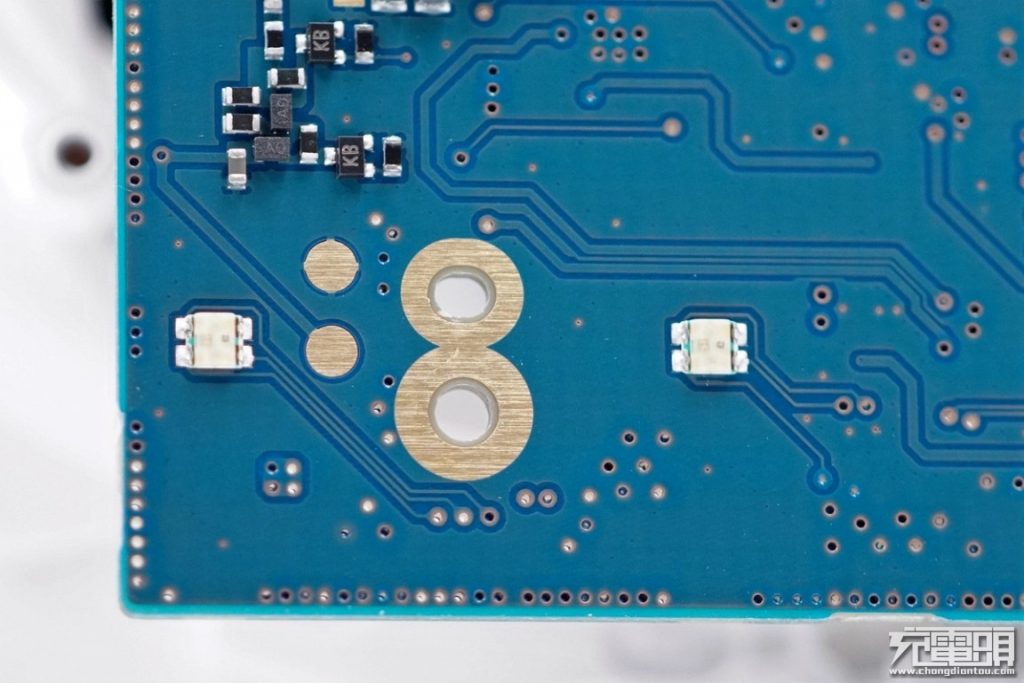

Two LED Indicators.
